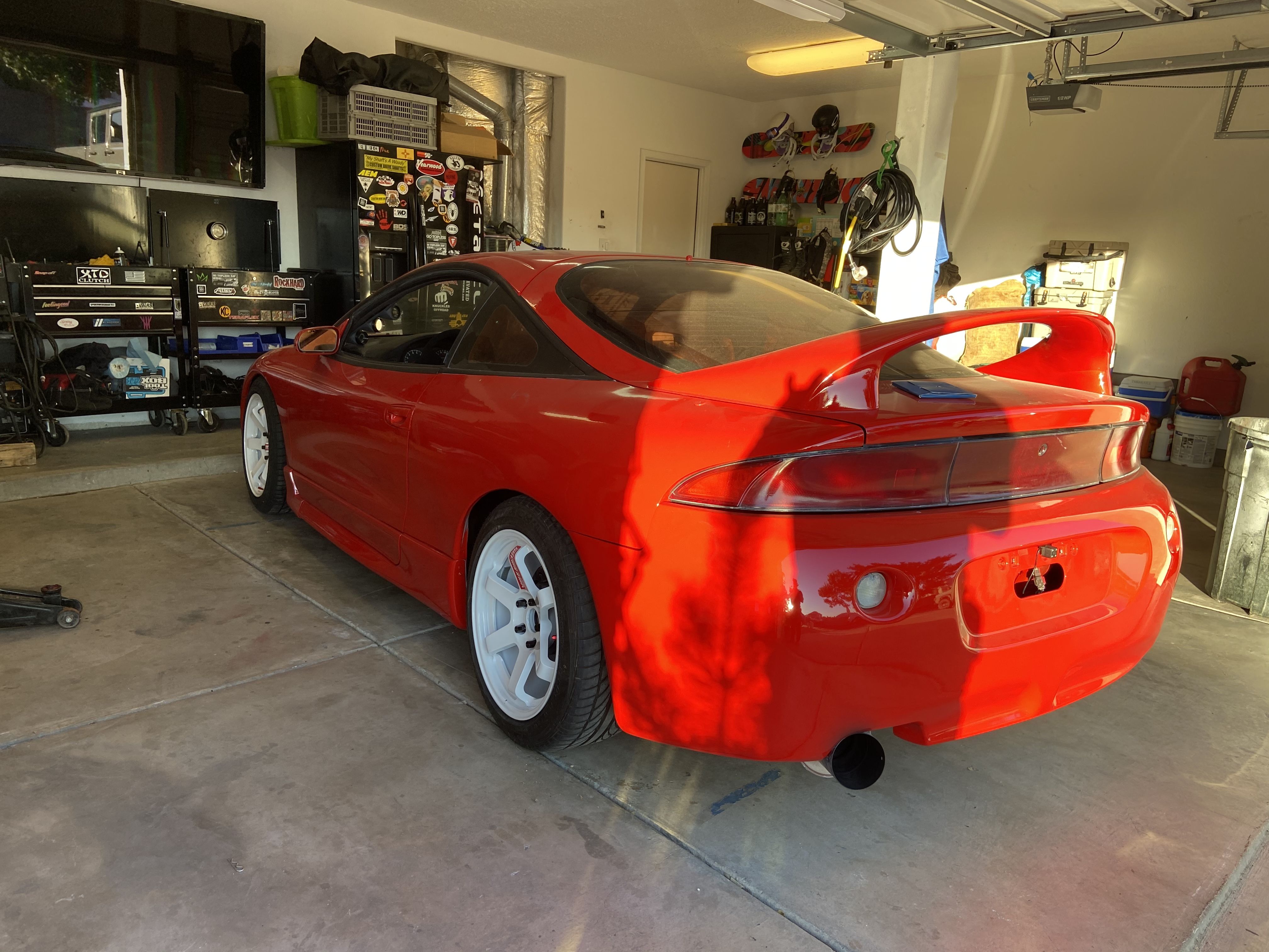

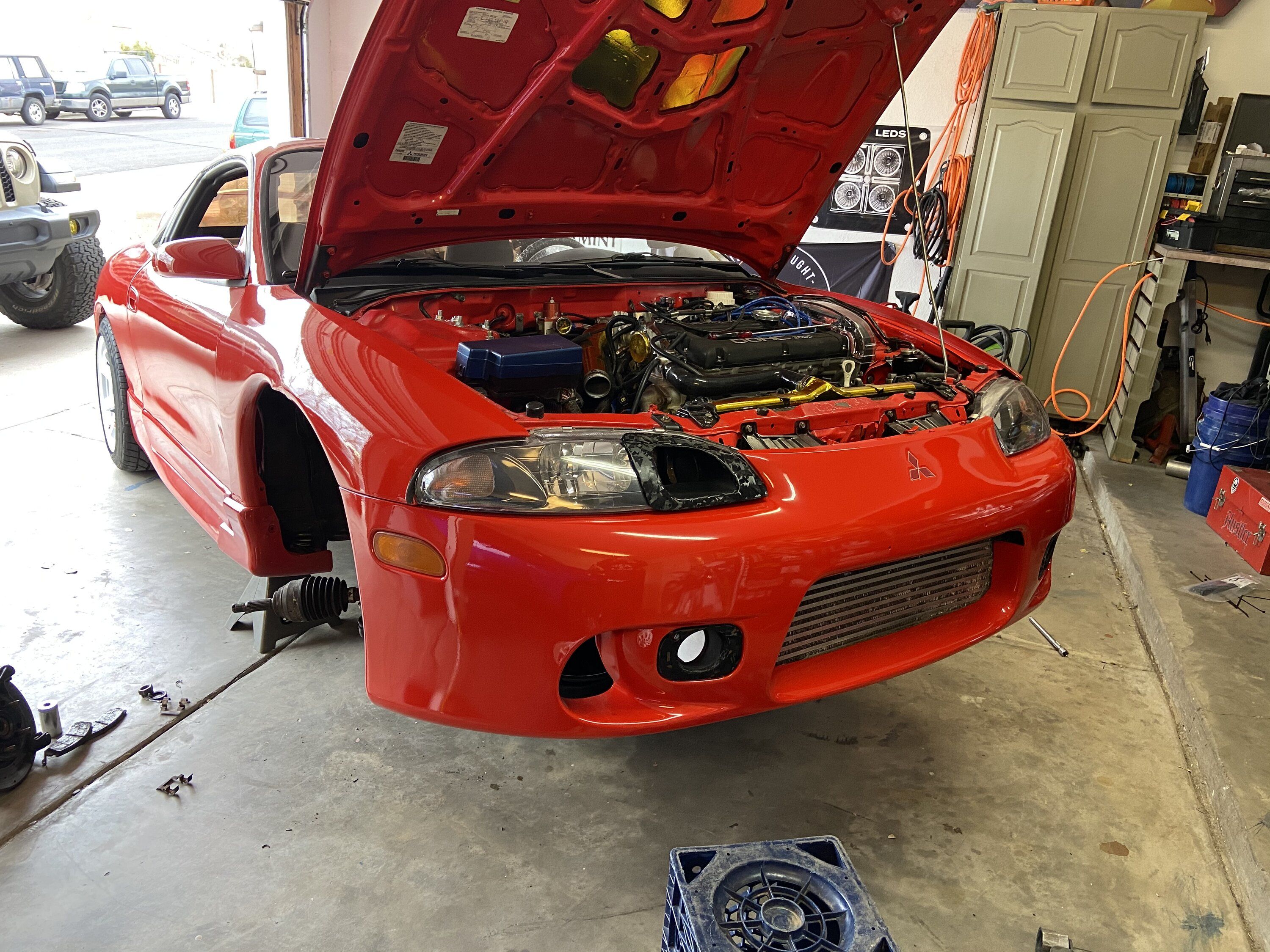

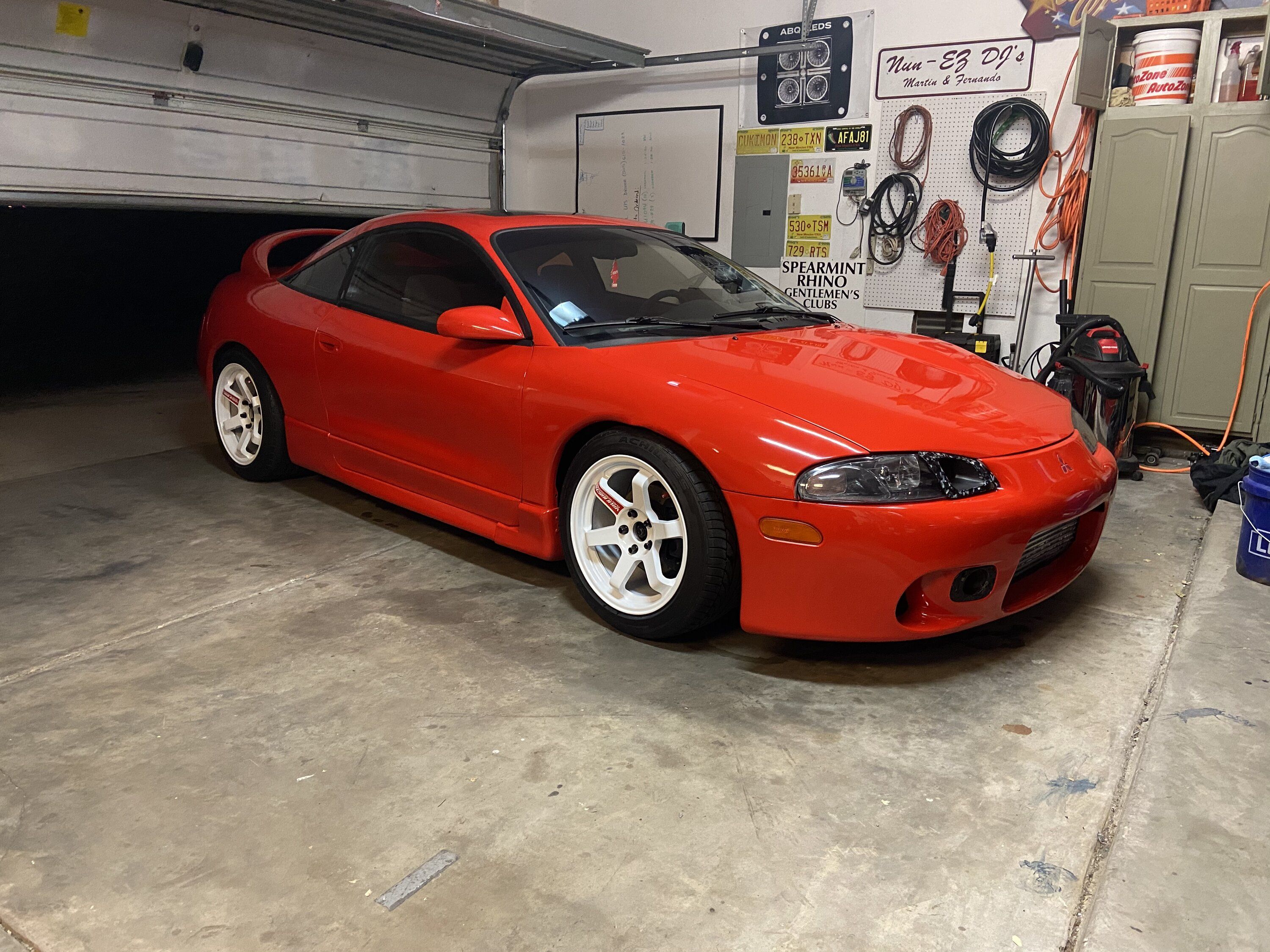

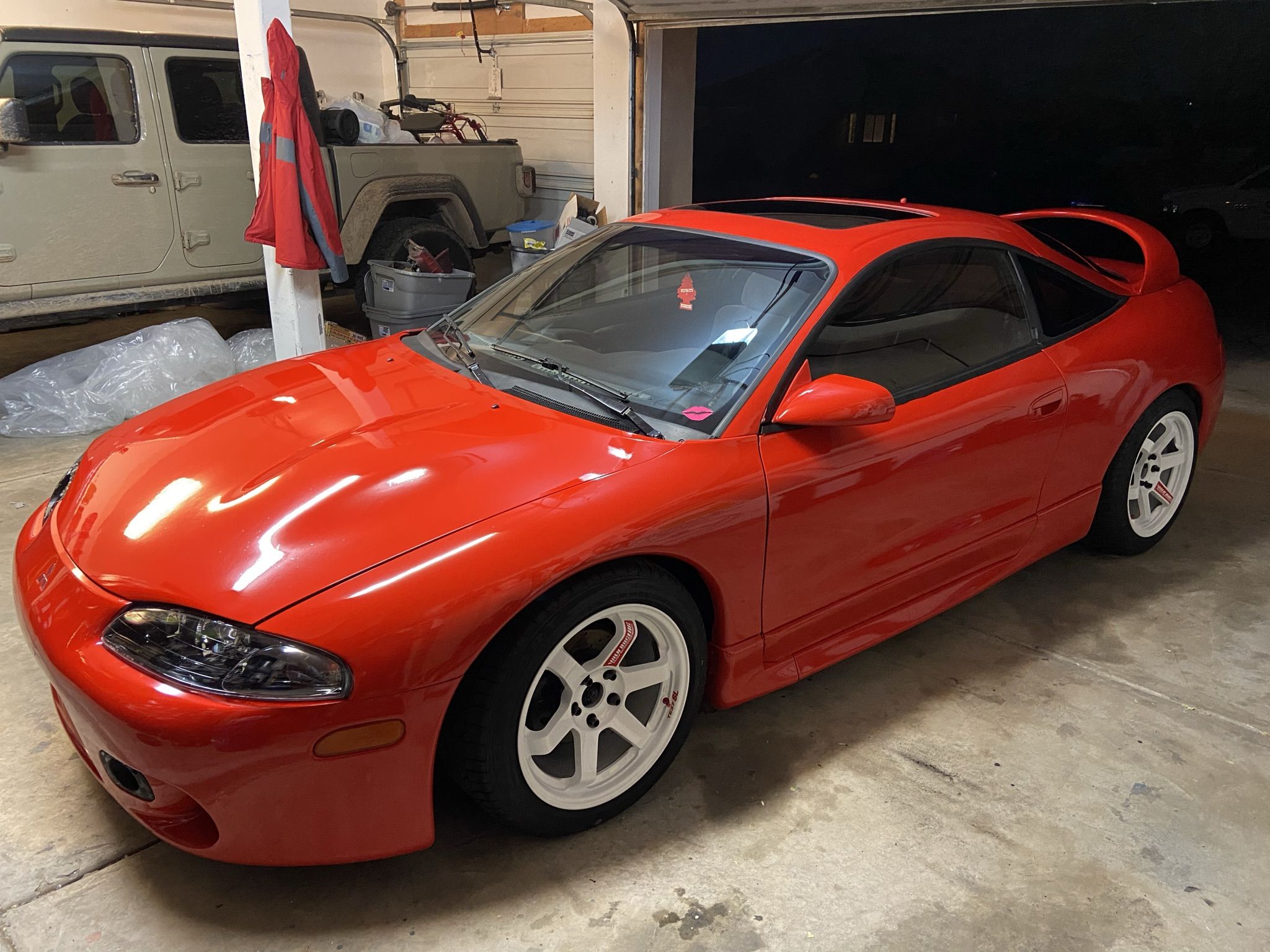

98 GST rescue
98 GST shell/rebuilt engine core. Under reconstruction... rebuild 99% complete

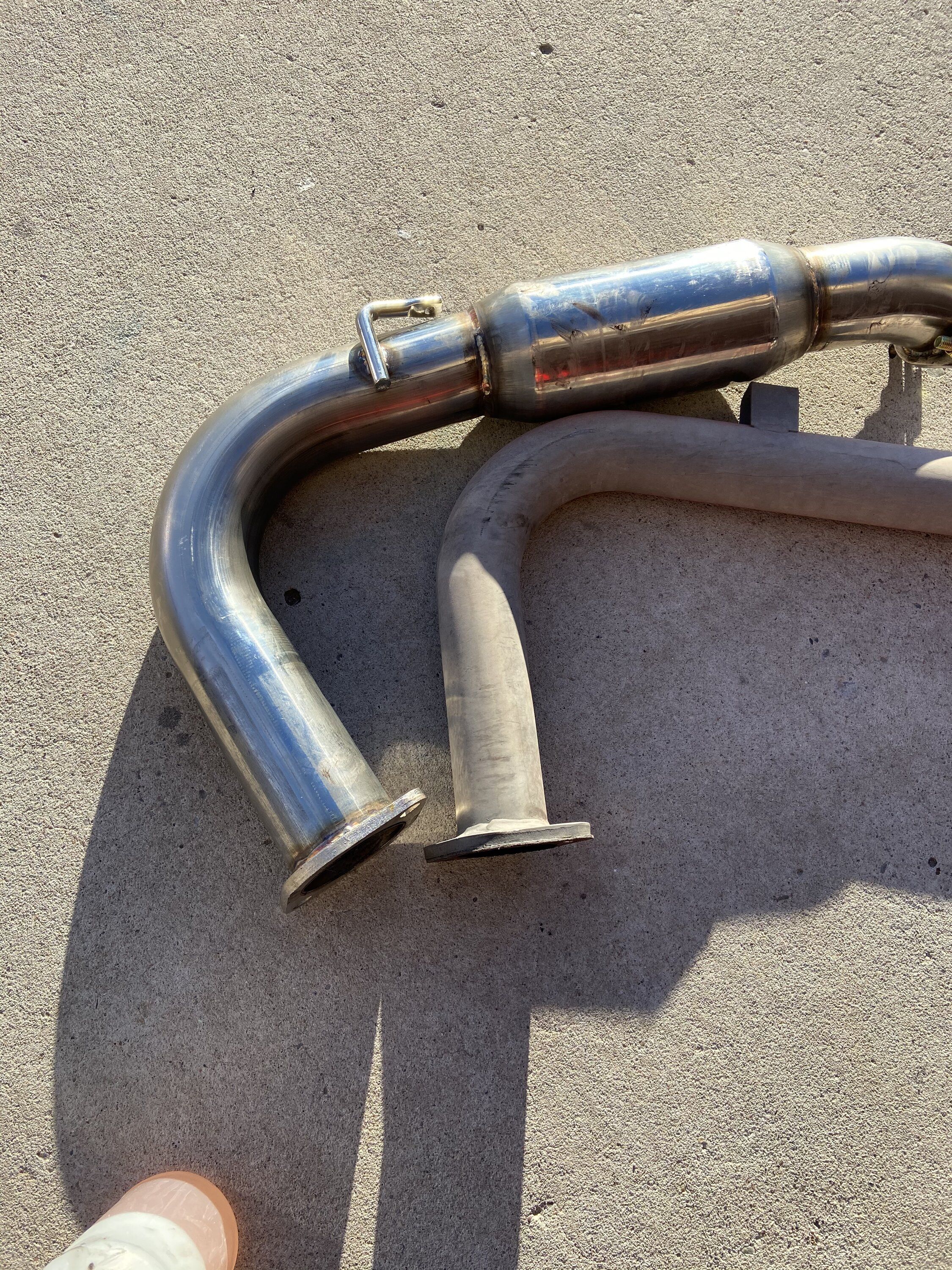

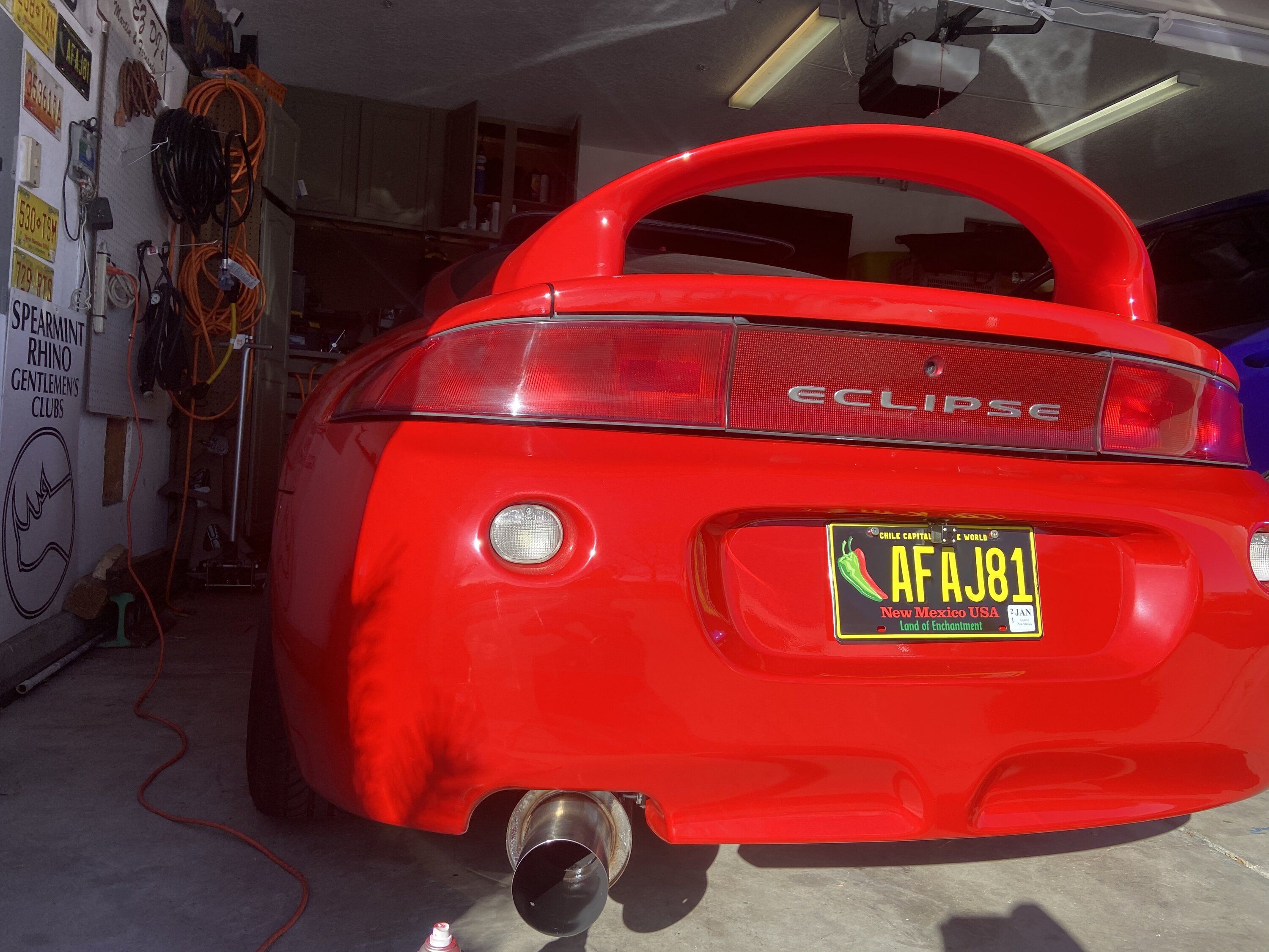

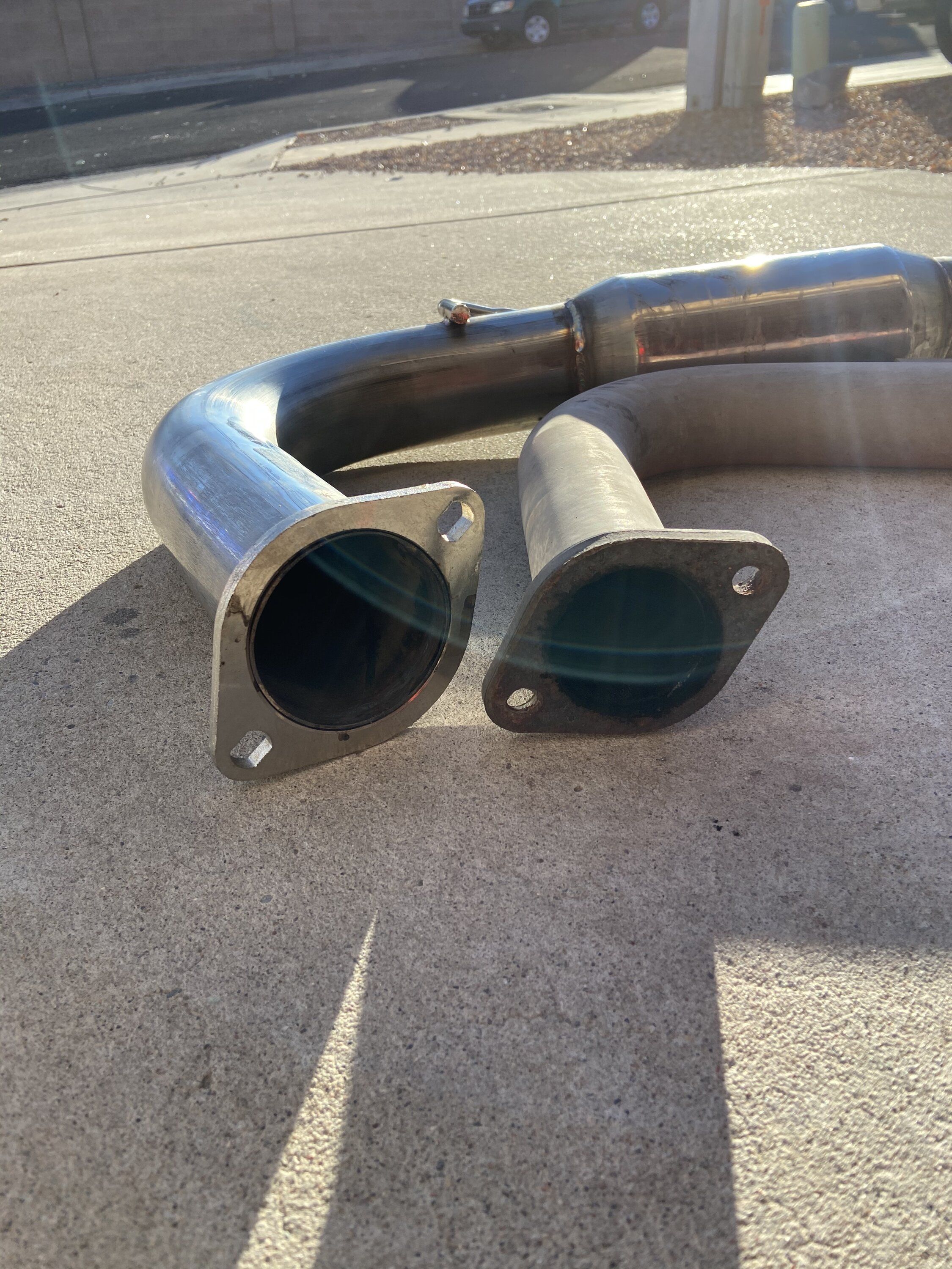

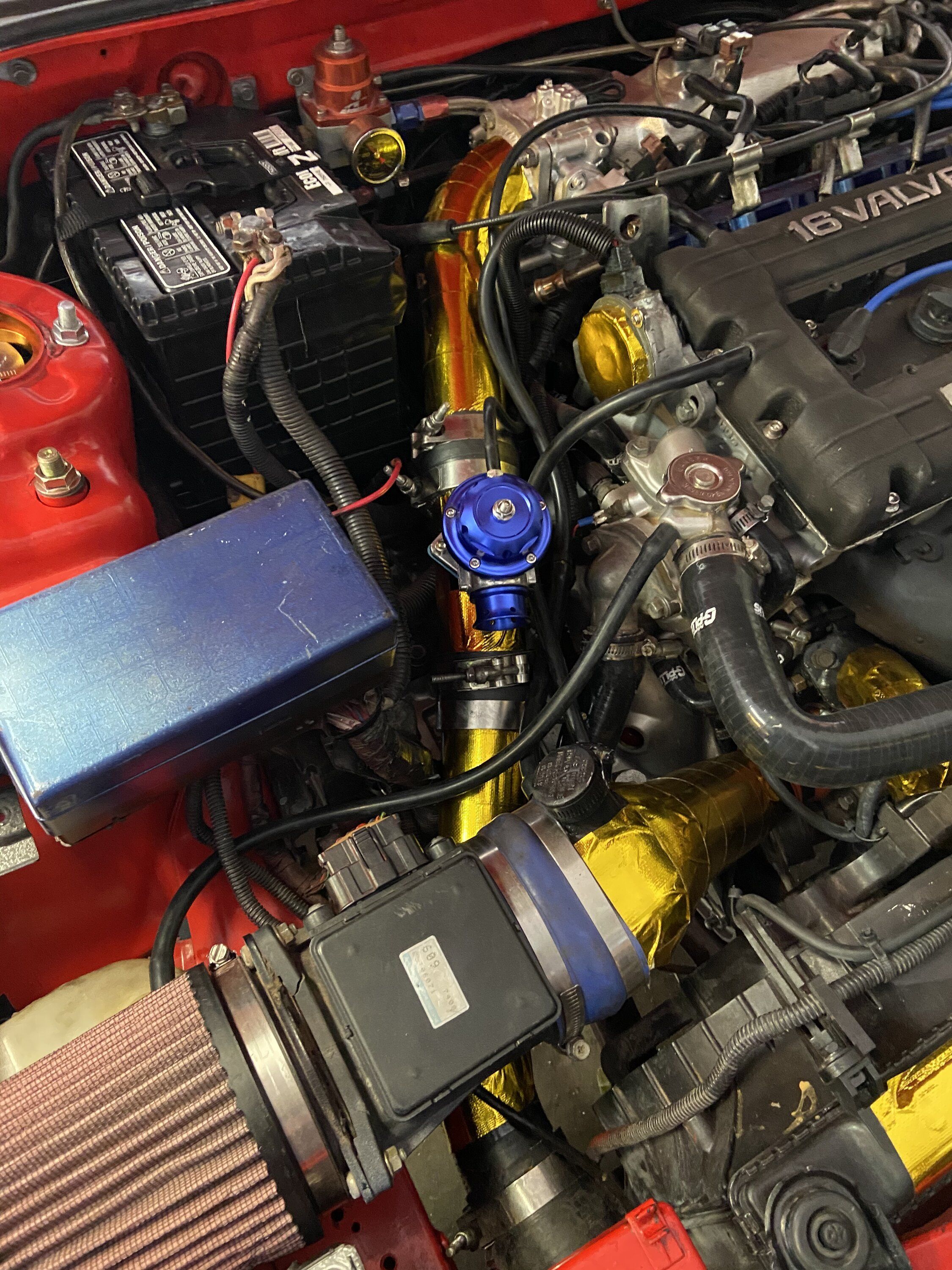

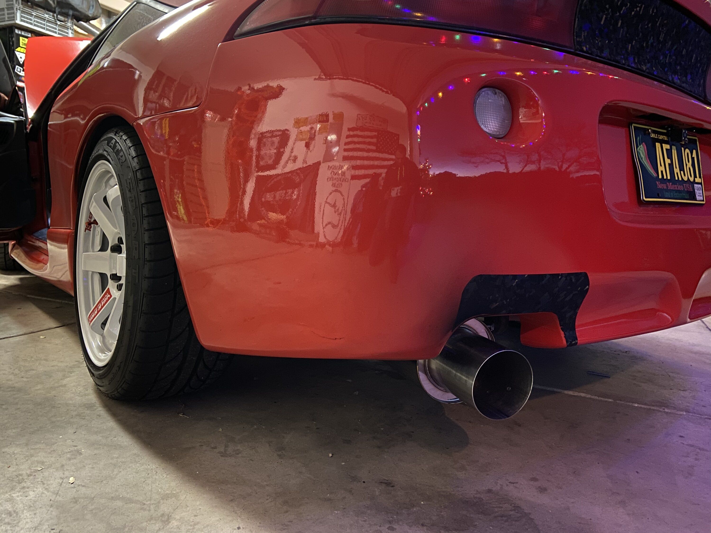

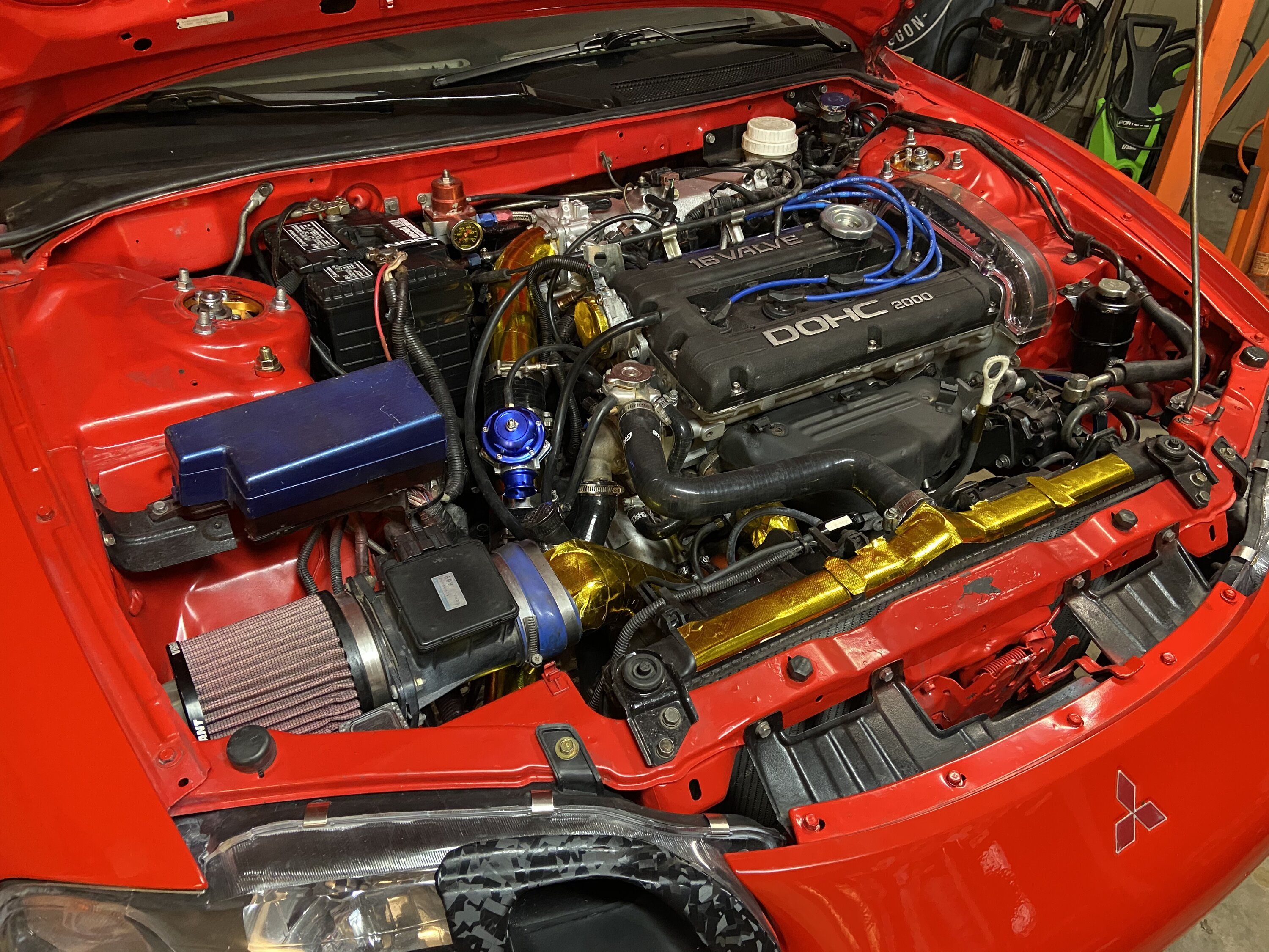

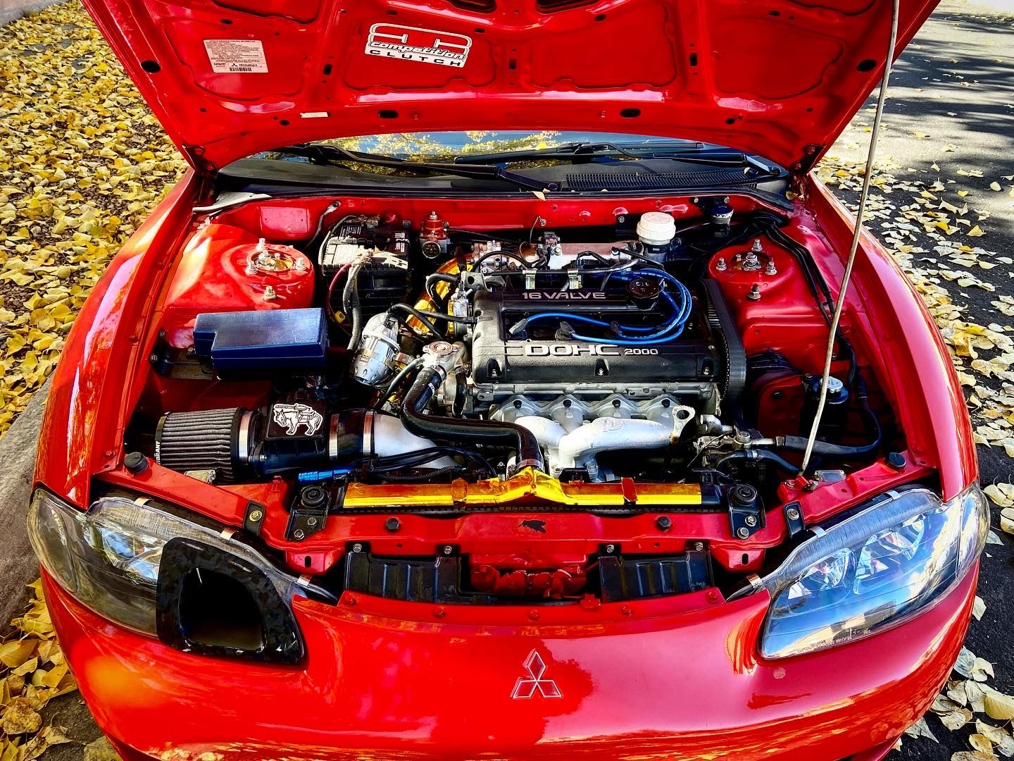

Also I installed a generic 3 inch exhaust today. The HKS 60mm was tiny in comparison. Plus for $108, it’s hard to complain. I think I’ll buy a muffler at some point. Vibrant street power is what I would like.
A Blow off valve is on the way too. My HKS set up isn’t working right. Not sure the cause, but the issue is it doesn’t blow off. I cut the spring a coil to soften the release/pressure needed. No luck even with another vacuum source.

Ordered a couple of couplers because I initially had to cut one in half when assembling the car. It worked for a bit.

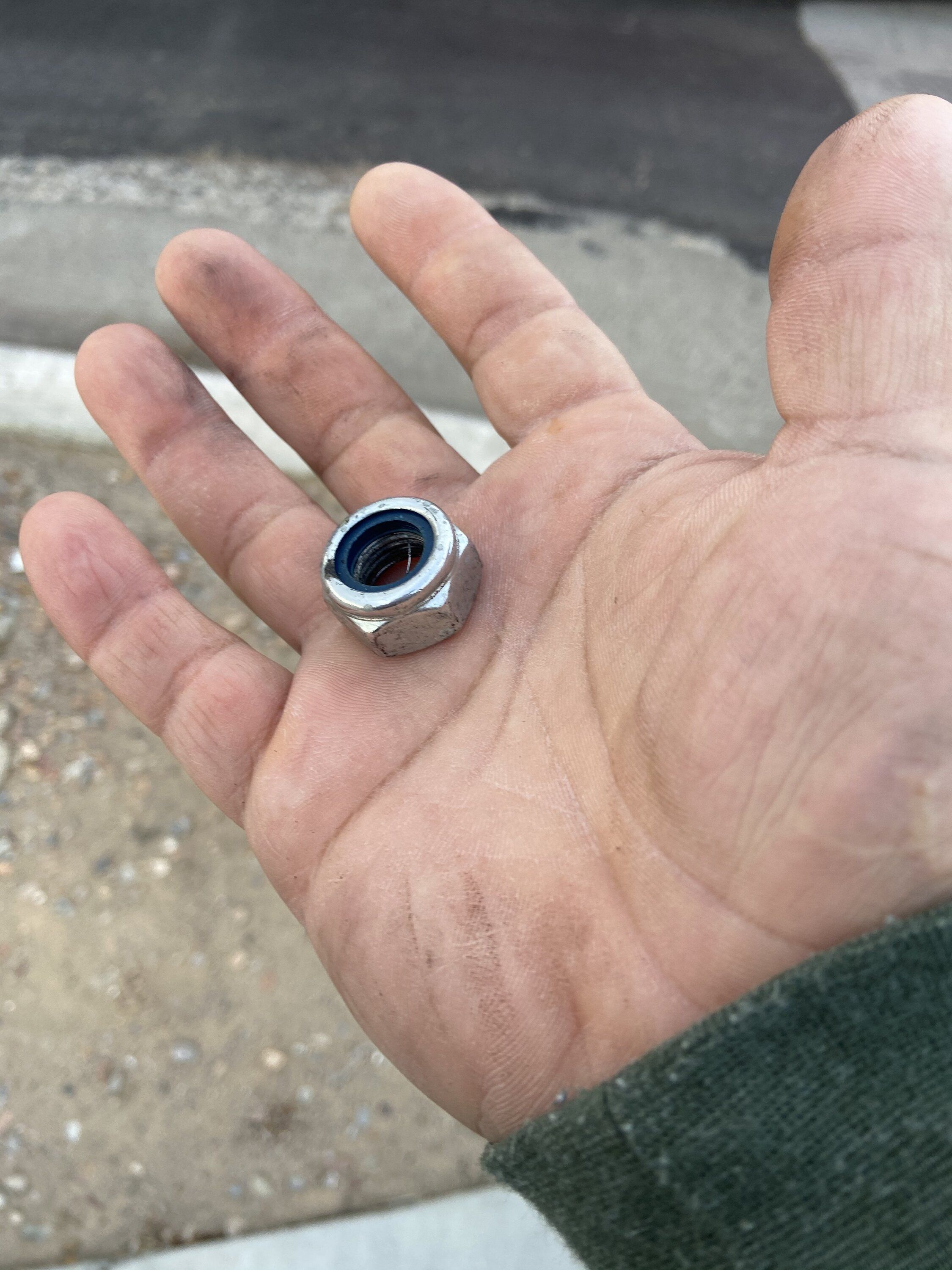

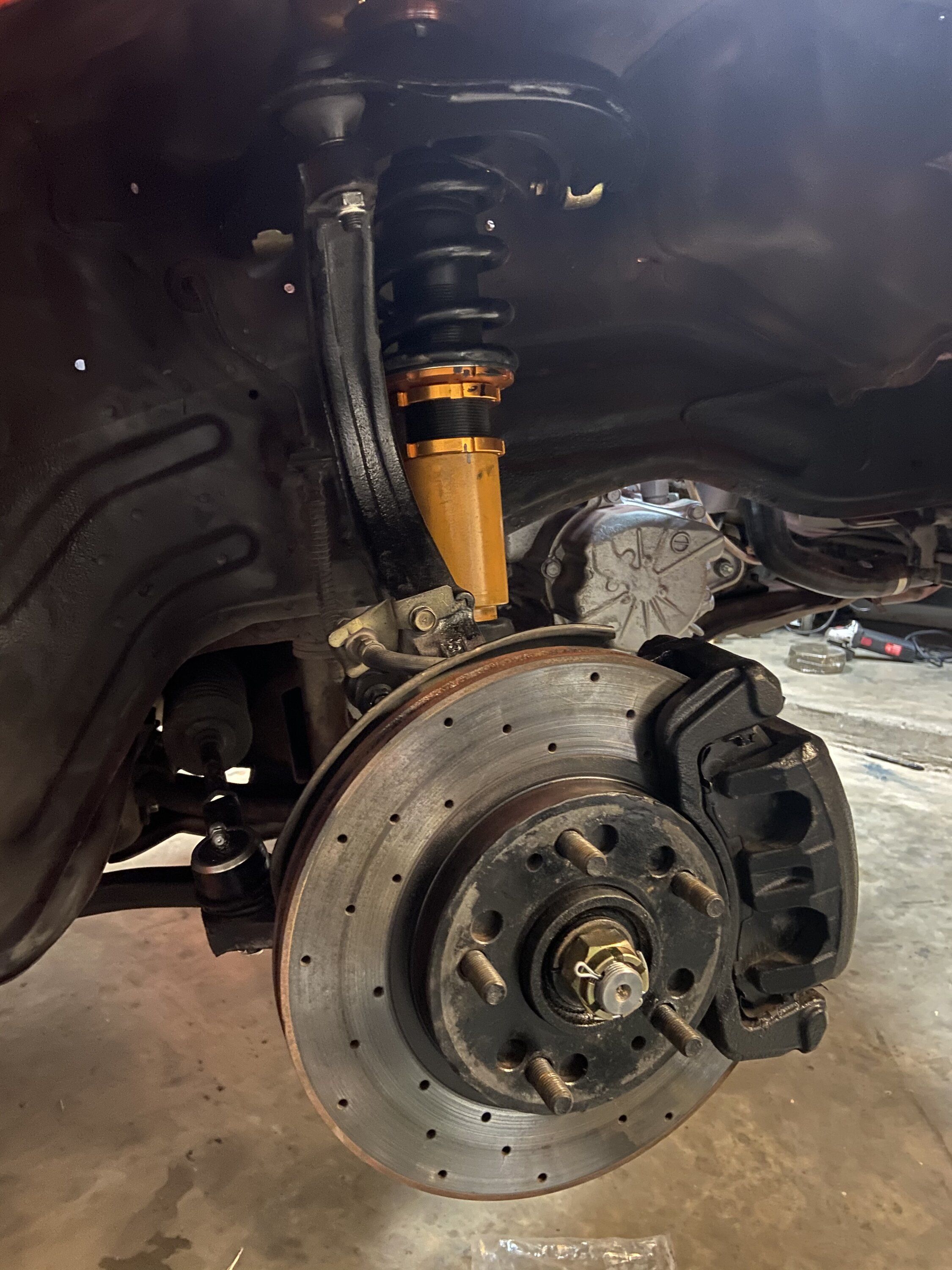

lost a nut off the ball joint. Luckily it was when I came to a stop. It was actually right under the joint. Pretty lucky I guess. Could have been on the road doing 75-80. Not lucky enough to not have it happen.
Going to try and fix it a little and roll the fenders while she’s under the knife for the clutch

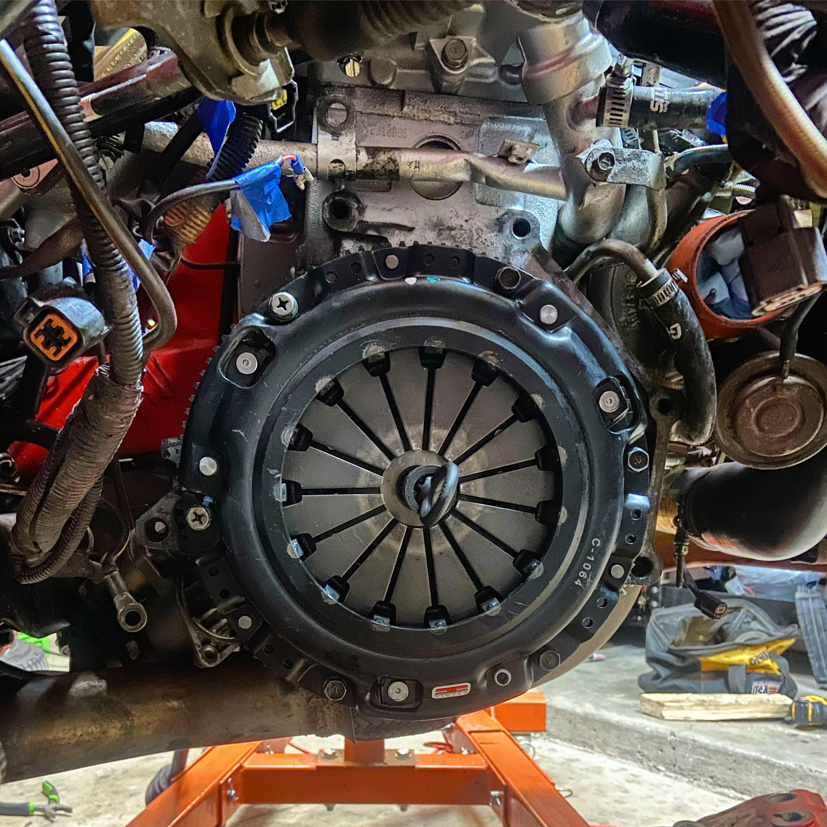

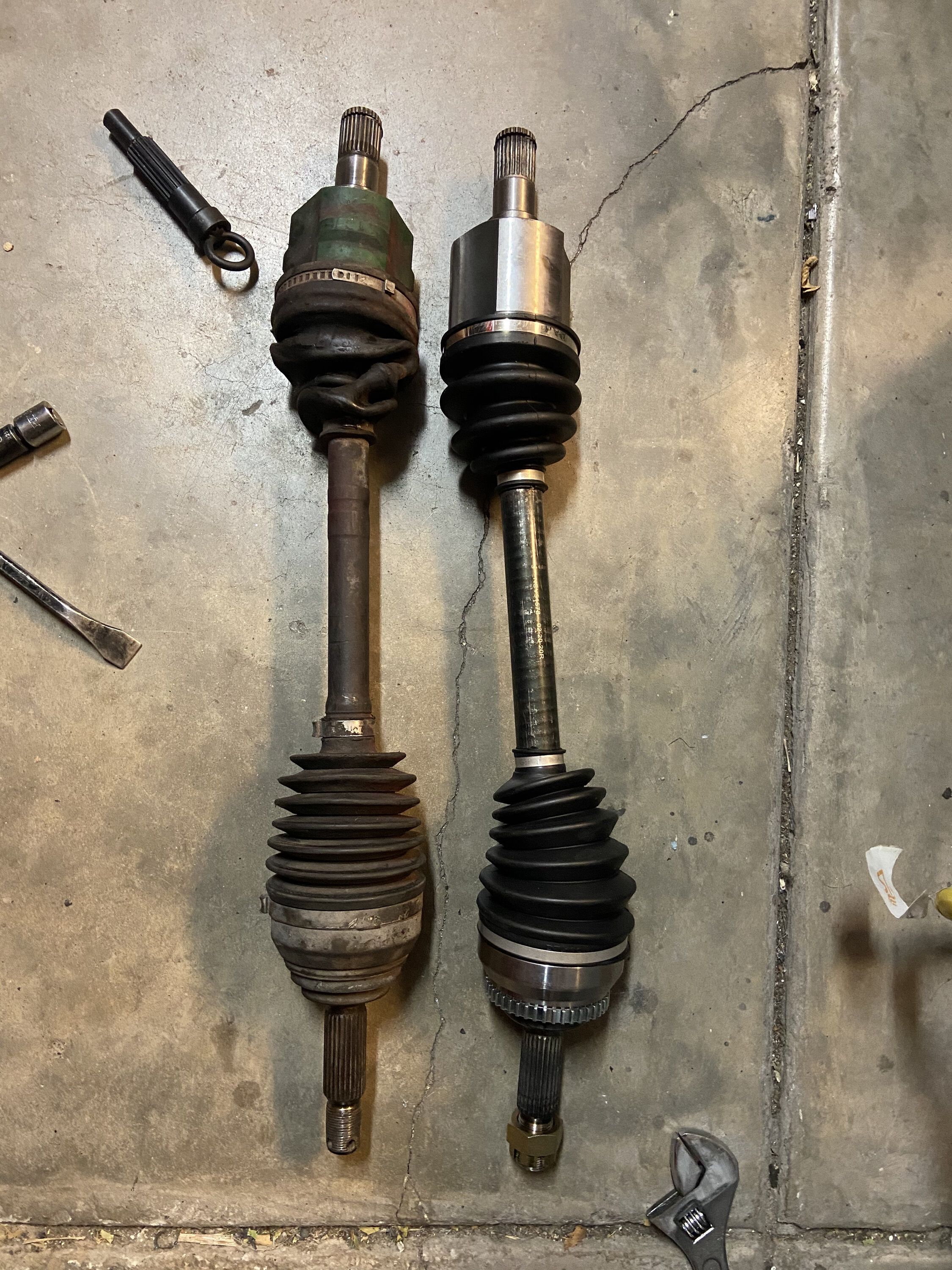

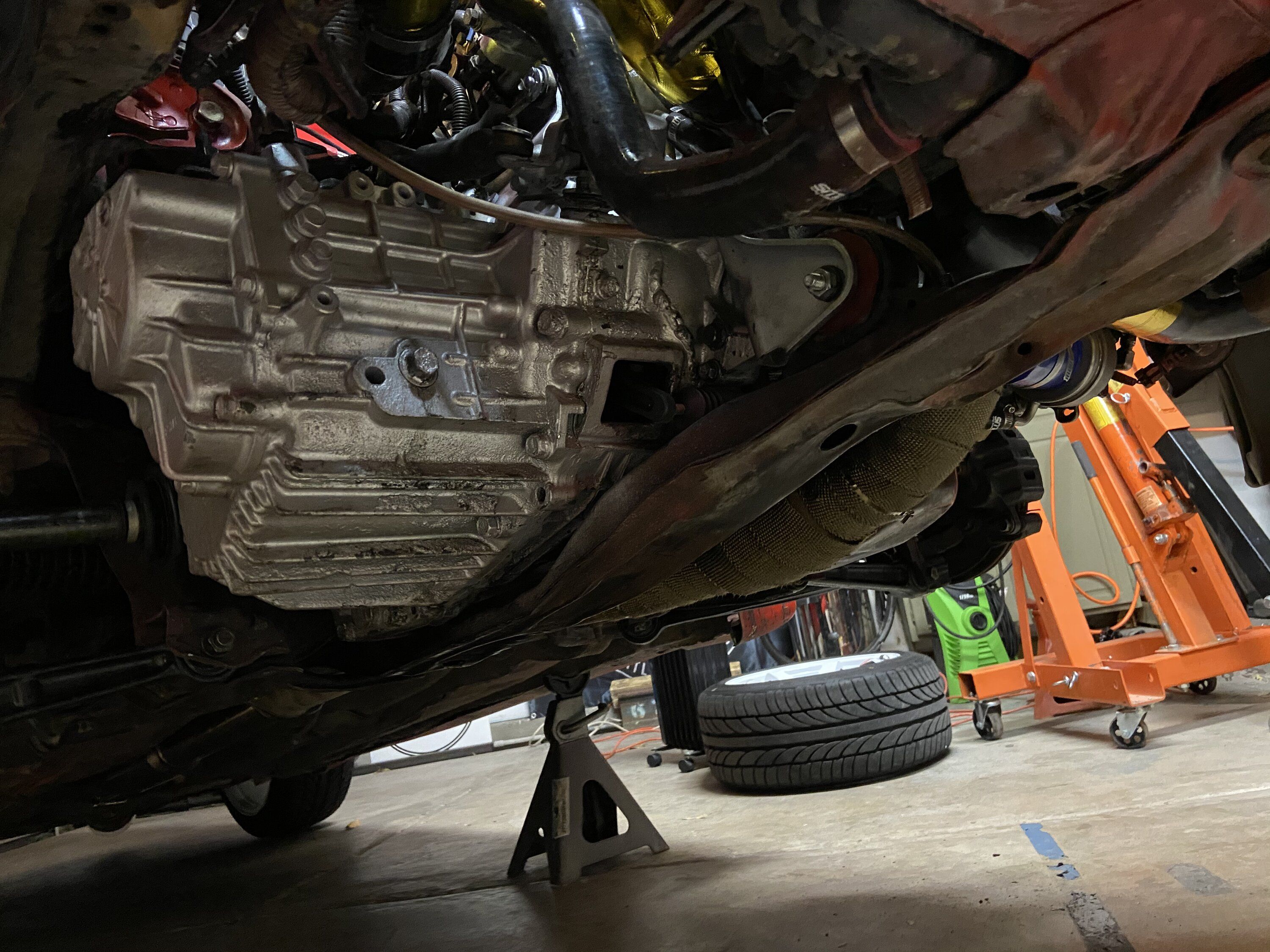

Clutch job done!
- Comp stage 4 2600lb
- Comp forged fork
- new axle seal
- new passenger axle (driver side was already replaced
- fresh Synchromesh

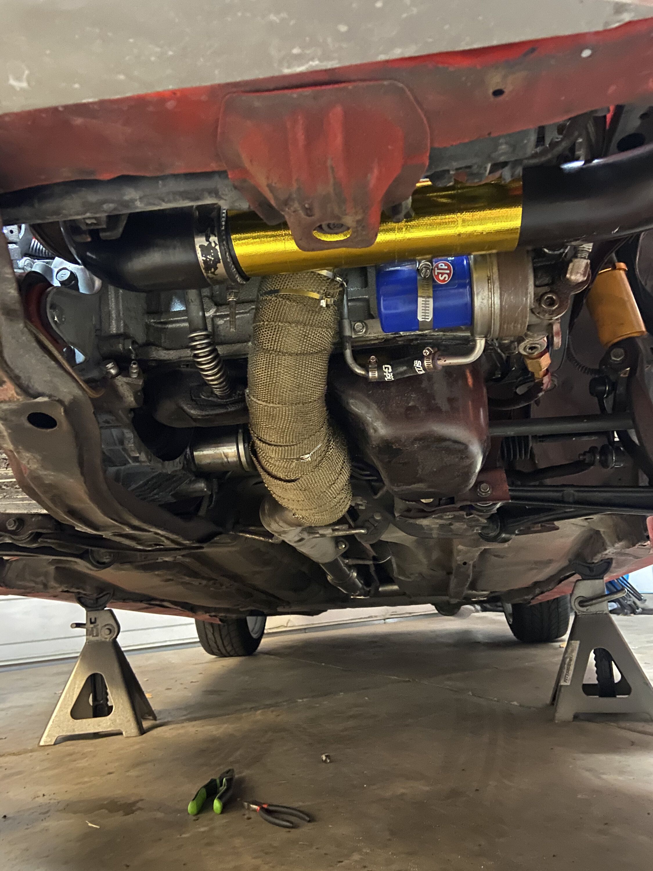

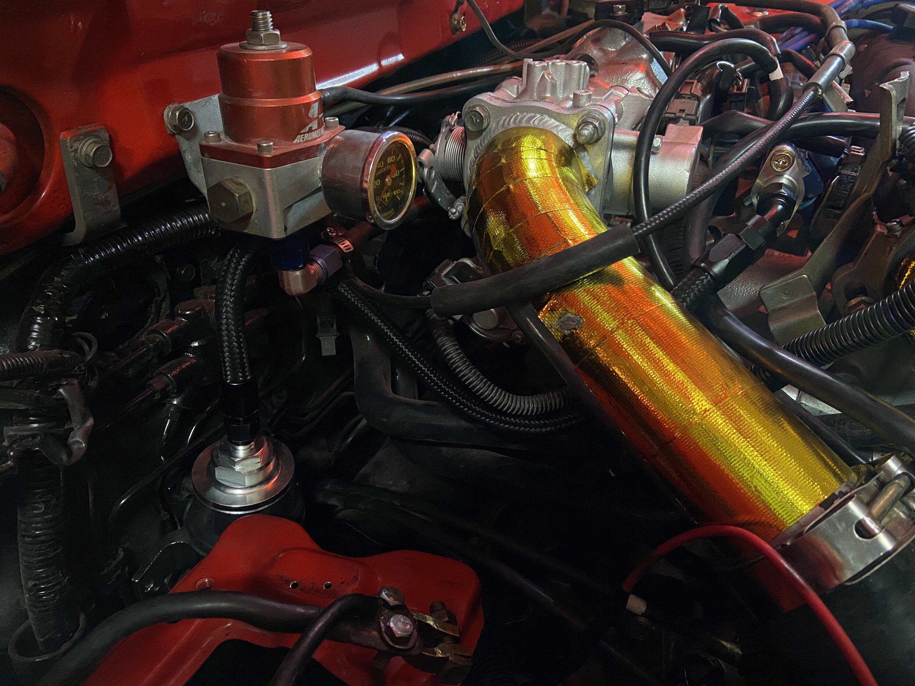

heat wrapped the down pipe.very poorly might I add ; ) LOL . But I didn’t want to take the dp off. And didn’t want to deal with the wet wrap. So I did a good job for what it was. I’ll redo it later when I drop the turbo/dp eventually.
also added a little more heat tape on the charge pipes and replaced 2 couplers.
going to roll the fenders and fire her up tomorrow

still baby steps on the clutch break in. Feels like engagement is like all the way to the floor. I’m hoping for adjustment/bleed to fix the feel of it. Seems to be ok otherwise. Engine sound much smoother since the TOB Isn’t whining. Also have a lot less chatter since it’s sprung disc.

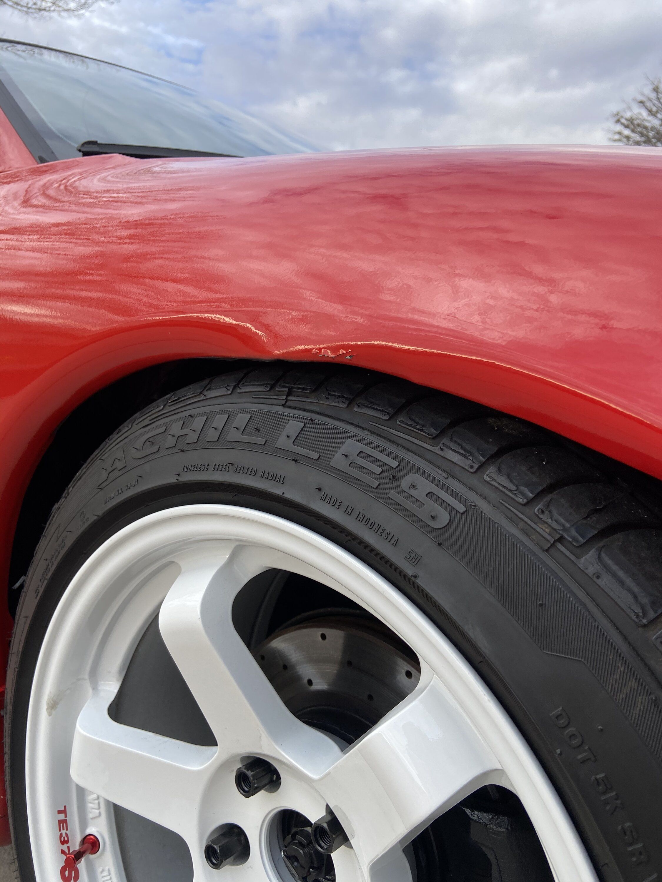

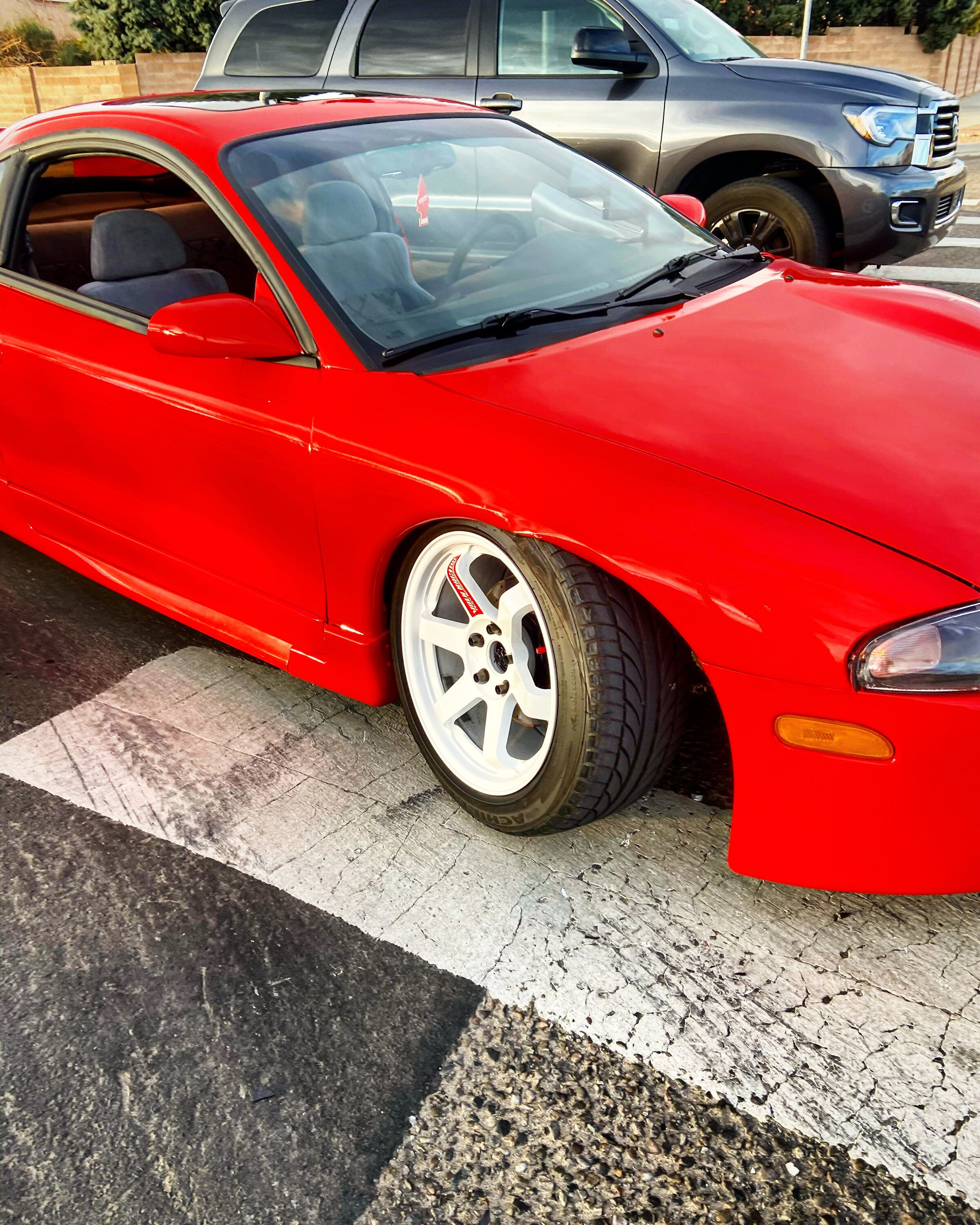

I did end up rolling the fenders. No more rubbing.
I would like to run a 245-255 when these tires wear out.

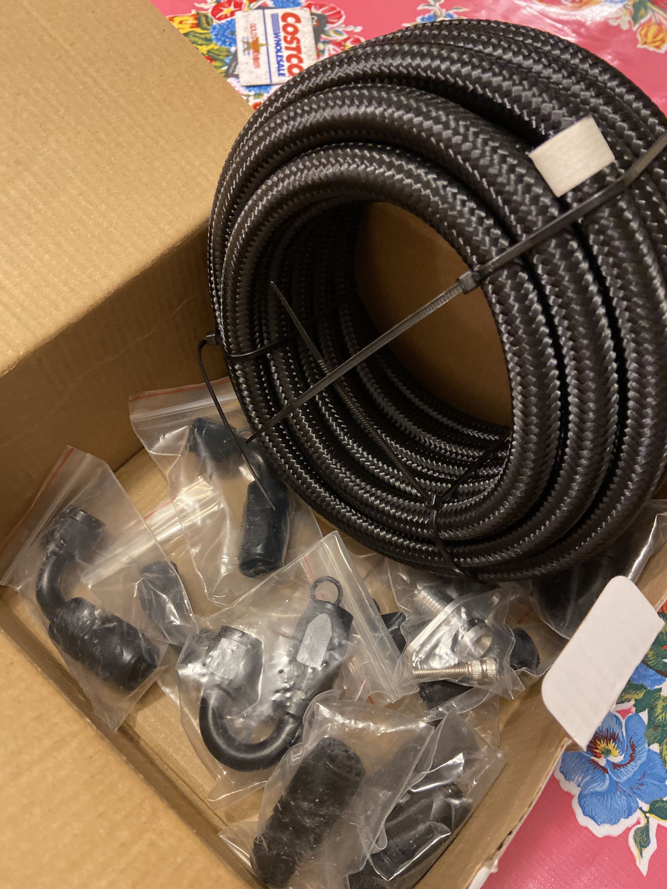

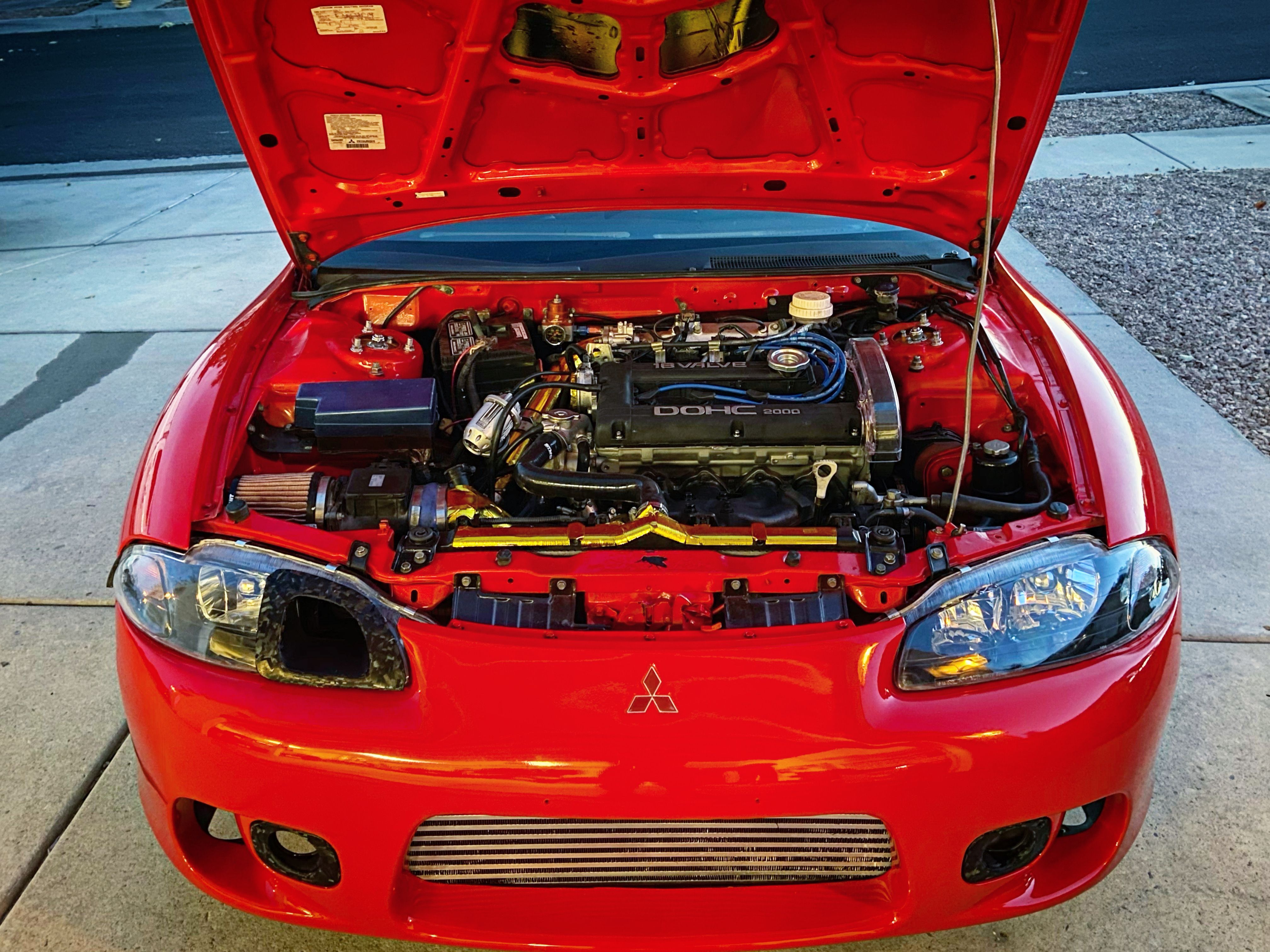

E85 line parts should be here this week. I’m trying to have them built and installed this weekend.
injectors will be installed too. I’m trying to link up with twisted motion for a td05 20g for a dyno test/tune review

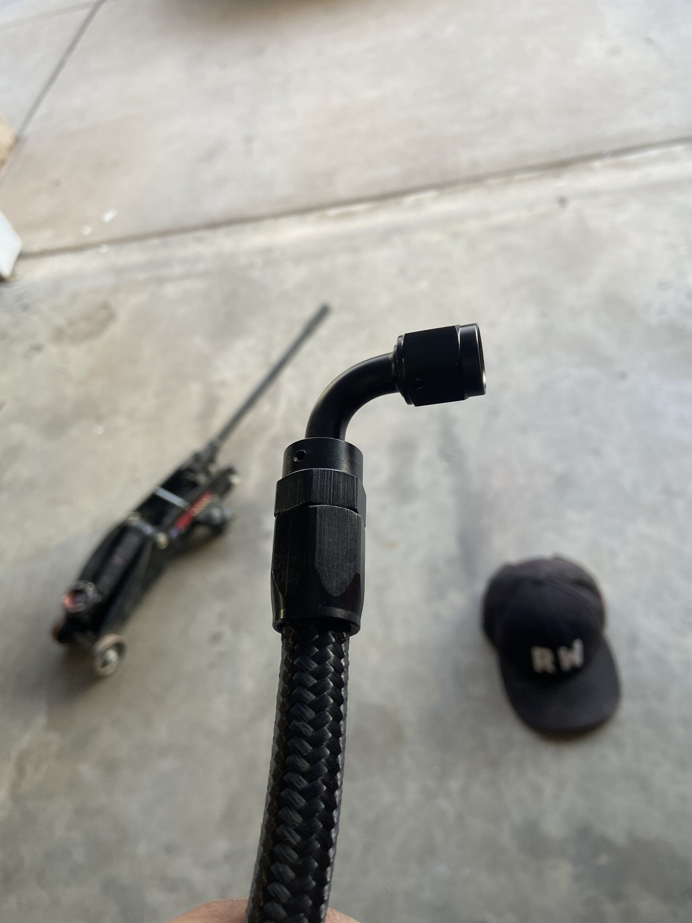

-replaced the lines and filter
-replaced the injectors with the 1000s (low z)
-drained the tank, flushed it, and topped it off with e85
-zip tied all the vacuum lines
-new BPR7ES plugs
-oil changed

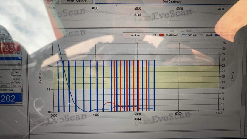

took it to the tuner. It’s awesome, he’s right down the street!
but- bad o2 and knock sensor... got them ordered.
First of all, car feels great. I’m feeling better about driving it on the road. And I will say that e85 goes QUICK LOL
But I’m starting to feel a bit underwhelmed. Understanding it’s a small 16g @ 16psi (still going to turn up the boost) I was hoping to be in the neighborhood of 300. Reading about 16g/e85 setups being closer to 350hp had my hopes up. Of course they were running “25-28psi”. Which would lead me to believe that is is possible on this set up and 10 more psi. My log graph numbers showed 250hp/280tq, but then wheel hp drops a few points. I guess I’m just itching for more. I understand that I’ll be better off going with a bigger turbo to hit my goals of 300-350.
