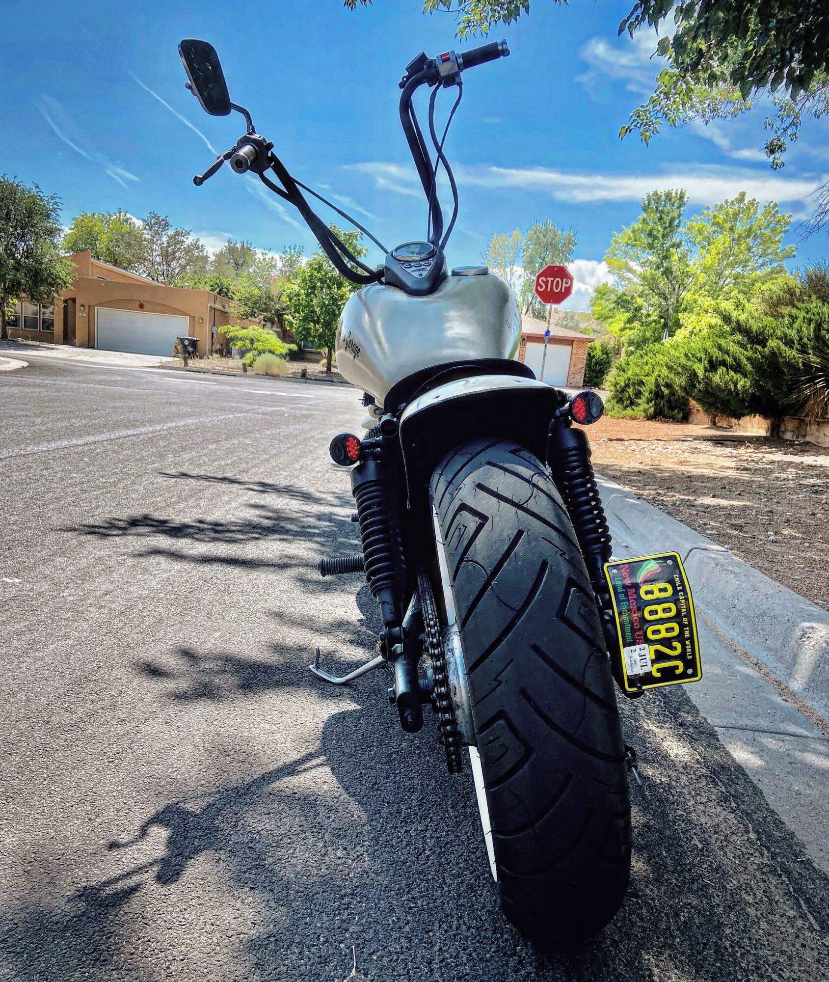

here’s a bobber build I’ve started: 06 Kaw’ Vulcan 500

I’m finished my bobber and my trailer.

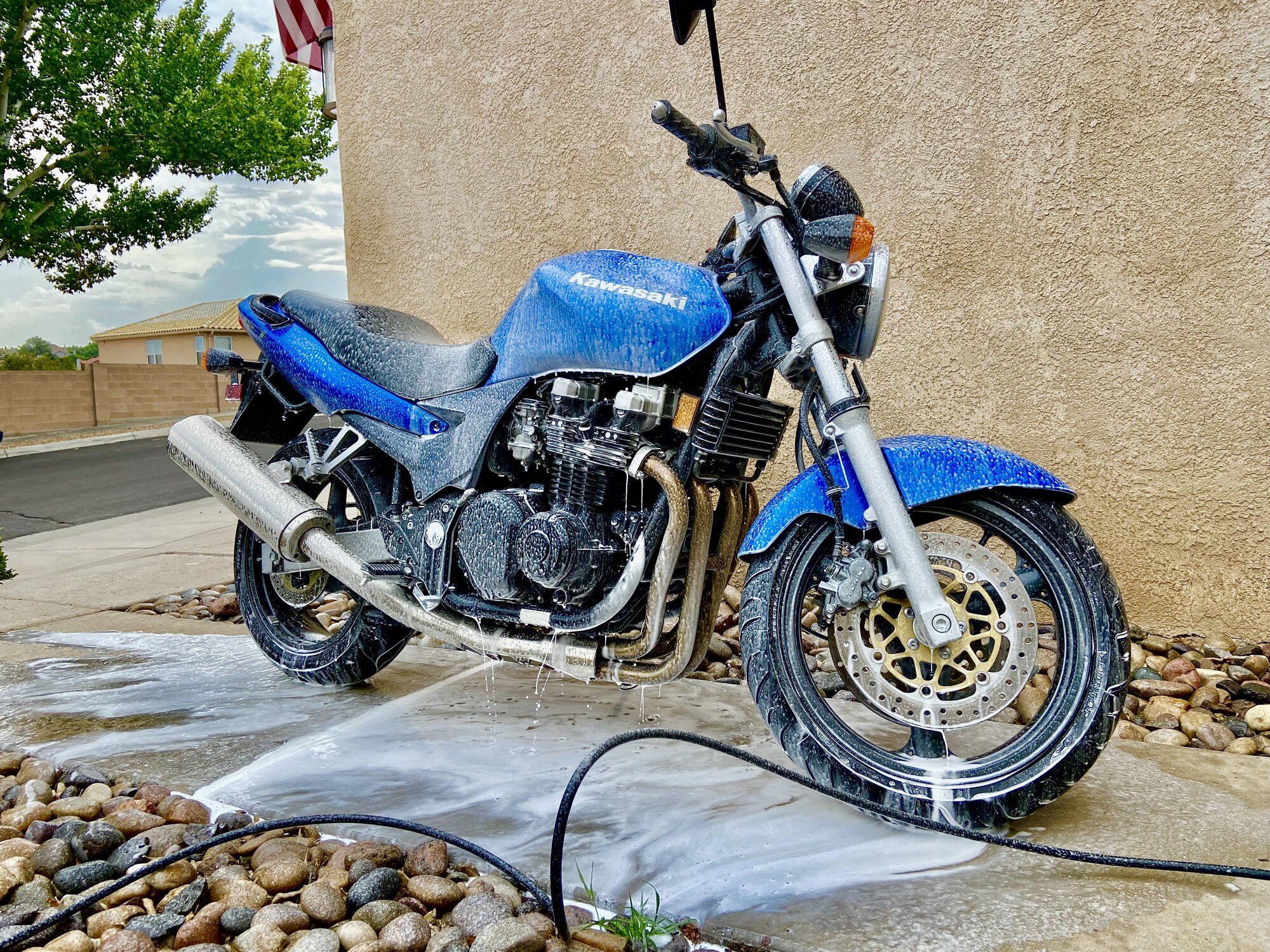

Sold the bobber got a naked. This thing is quick. Factory numbers says 12.2 standing quarter mile! It’s going to take a little modernization to make it better to look at.

got another bike, I’m head over heals for it. Also have been focusing on self care more than other projects with my time.
