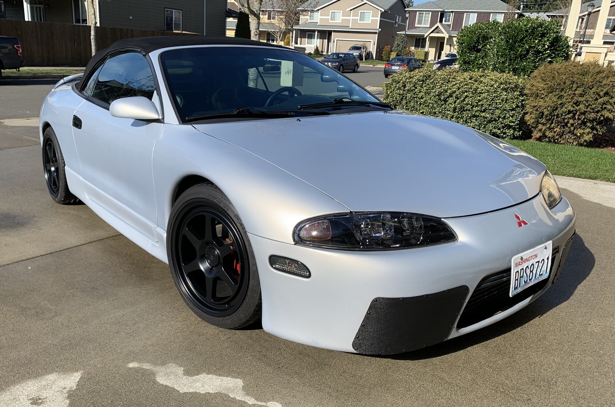

I bought this car from a coworker who drove it daily for many years. It was just another cheap beater car for him, and he neglected it like most do with cheap cars. Aside from some ugly 20" rims, the car was mostly stock with a few good bolt-ons from the owner previous to him. I've wanted a DSM since the late 90's, so I bought it from him for $800 and started on my journey to restore it and turn it into an IASCA Sound Quality competition vehicle. Not many people have tried to build a high end SQ car in a convertible, so I figured why not give it a try.

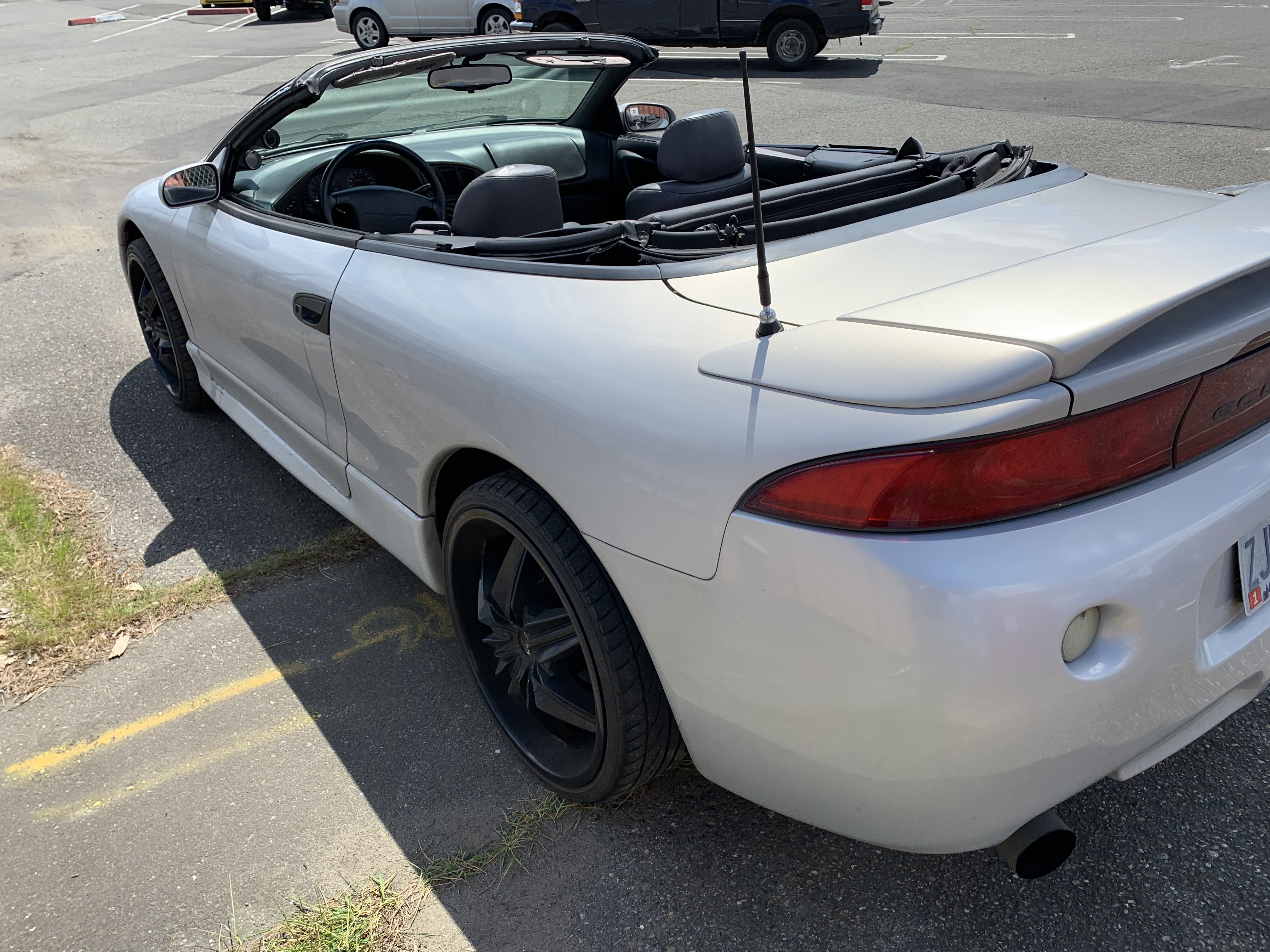

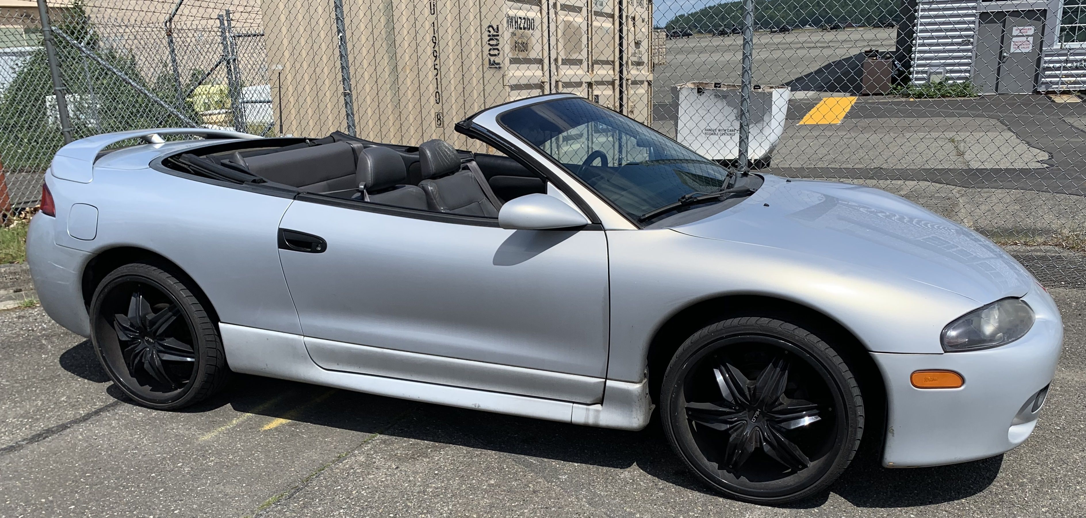

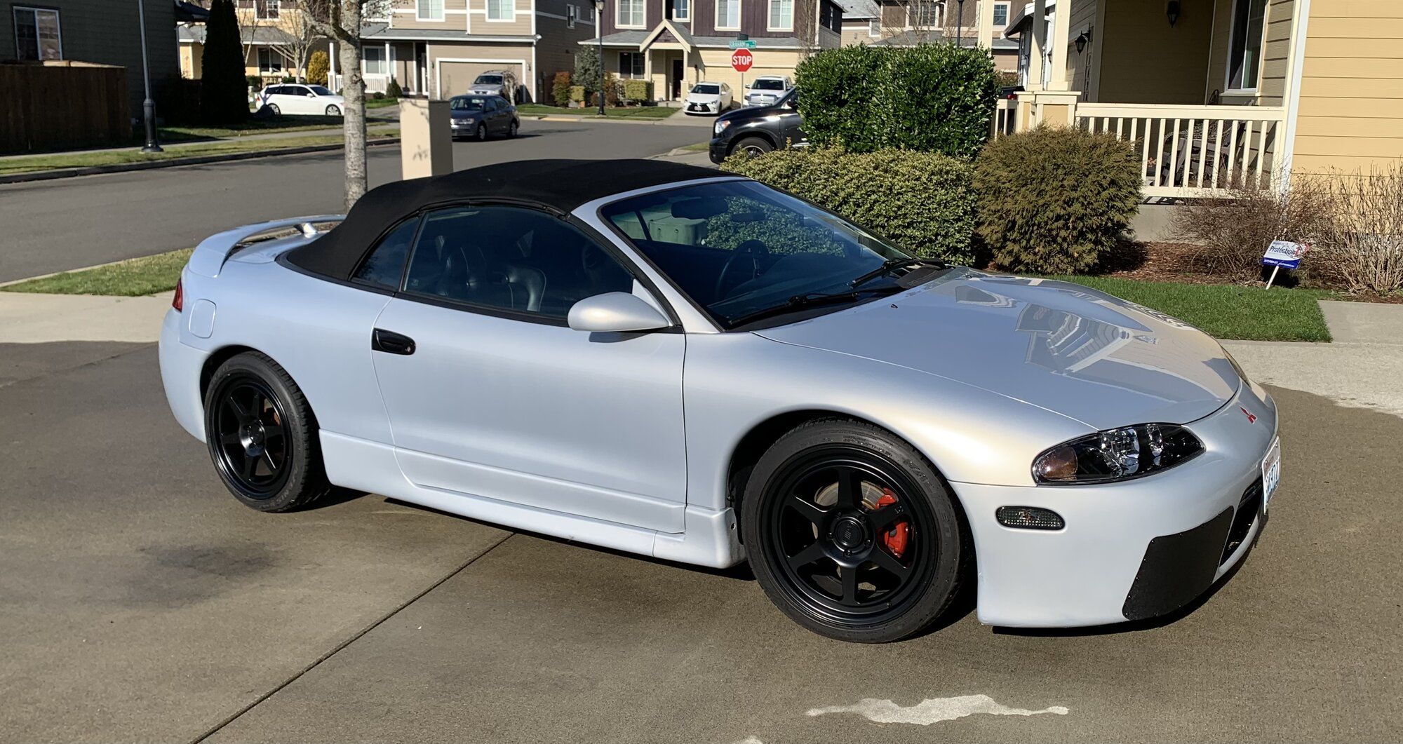

This is what the car looked like when I bought it.
I had some terrible rims and low pro tires, it hadn't been washed in what looked like years. The convertible top had patches on it where my buddy had to cut his way into the car when both door handles broke. It ran like crap because he had put a timing belt on, but was a tooth off on the exhaust cam and the balance shaft wasn't lined up. The valve cover was cracked and leaked oil like crazy, there were vacuum and boost leaks all over the place, coolant leaks and the list went on.

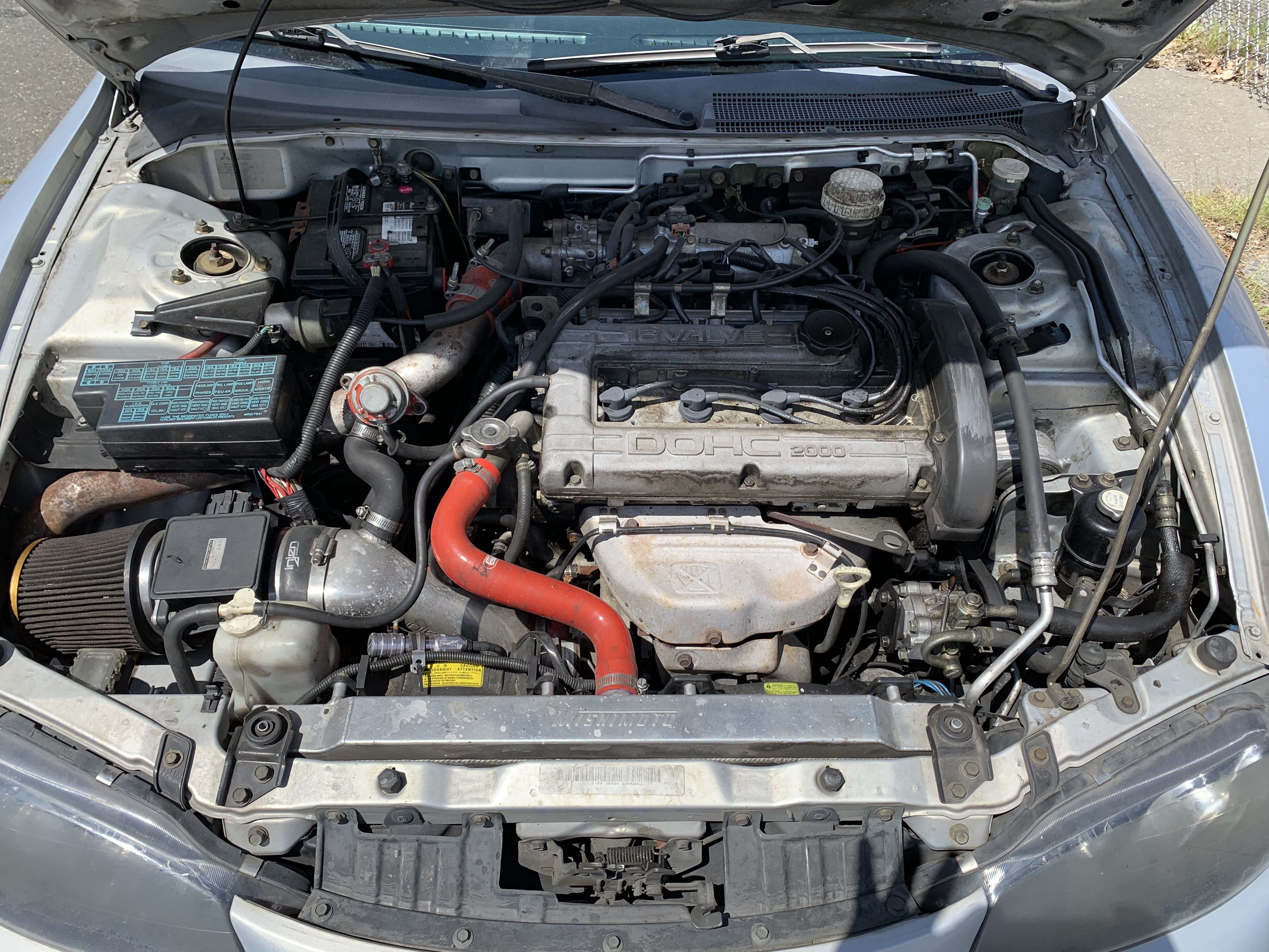

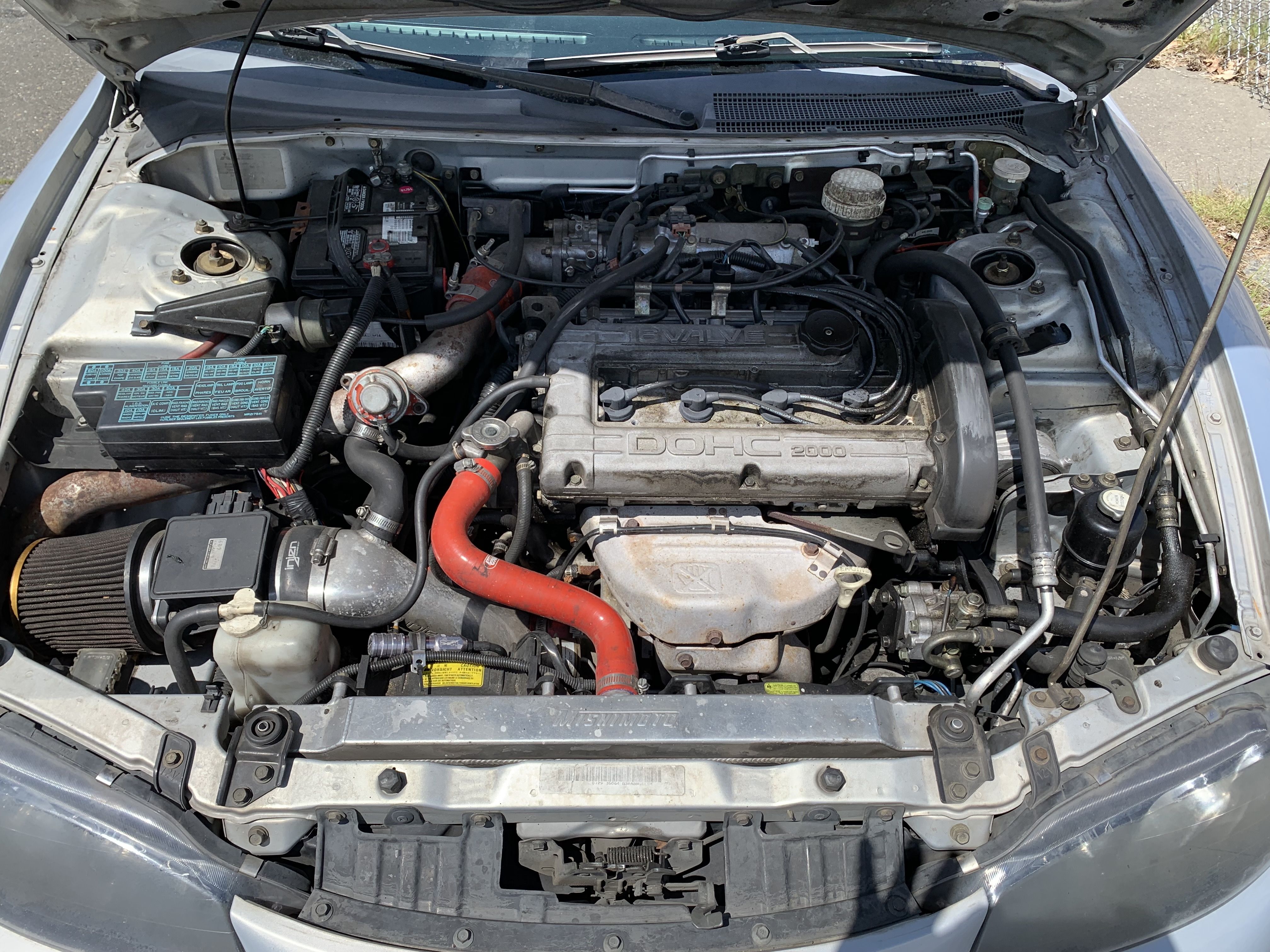

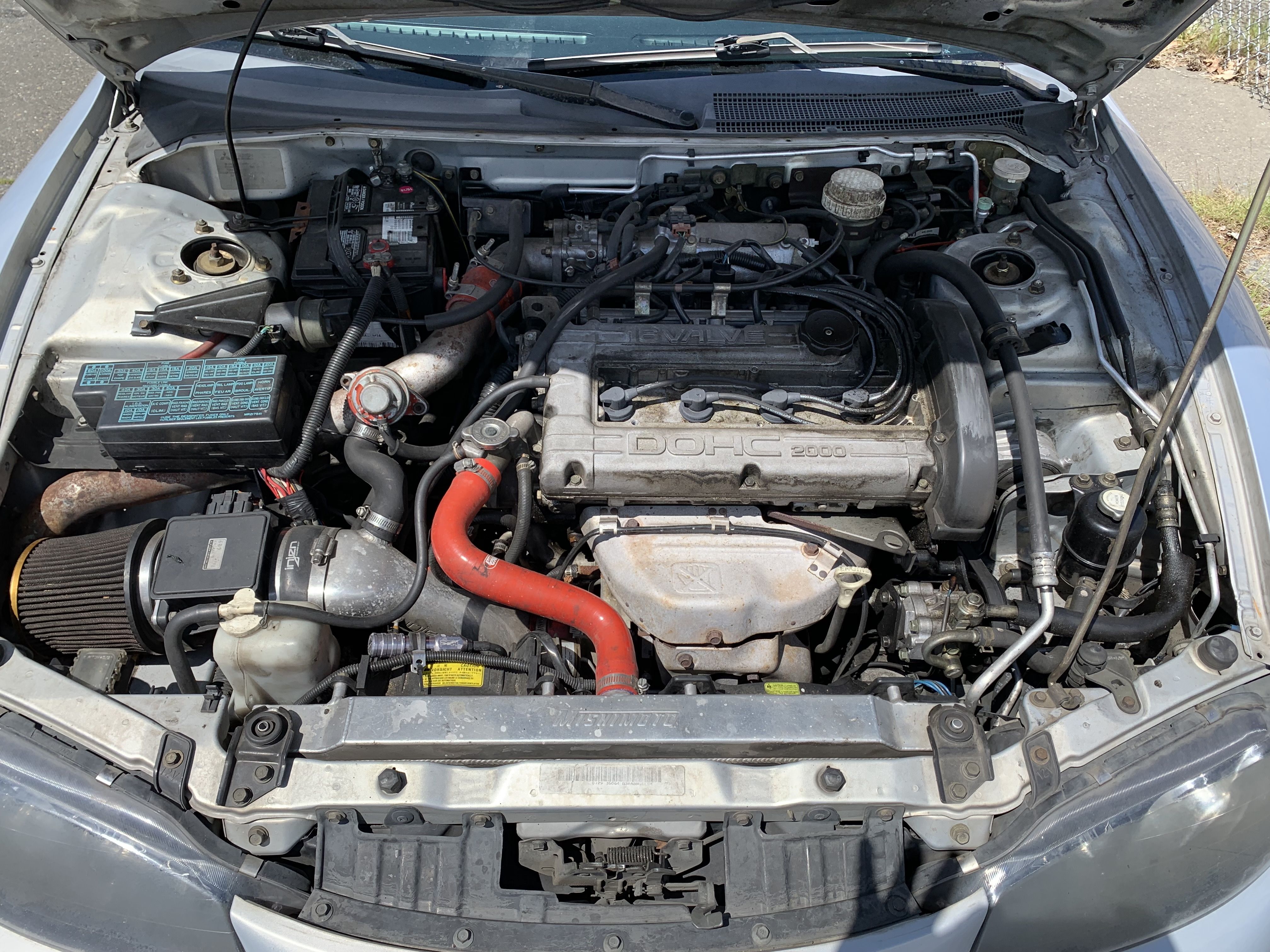

This is what the engine bay looked like when I started.

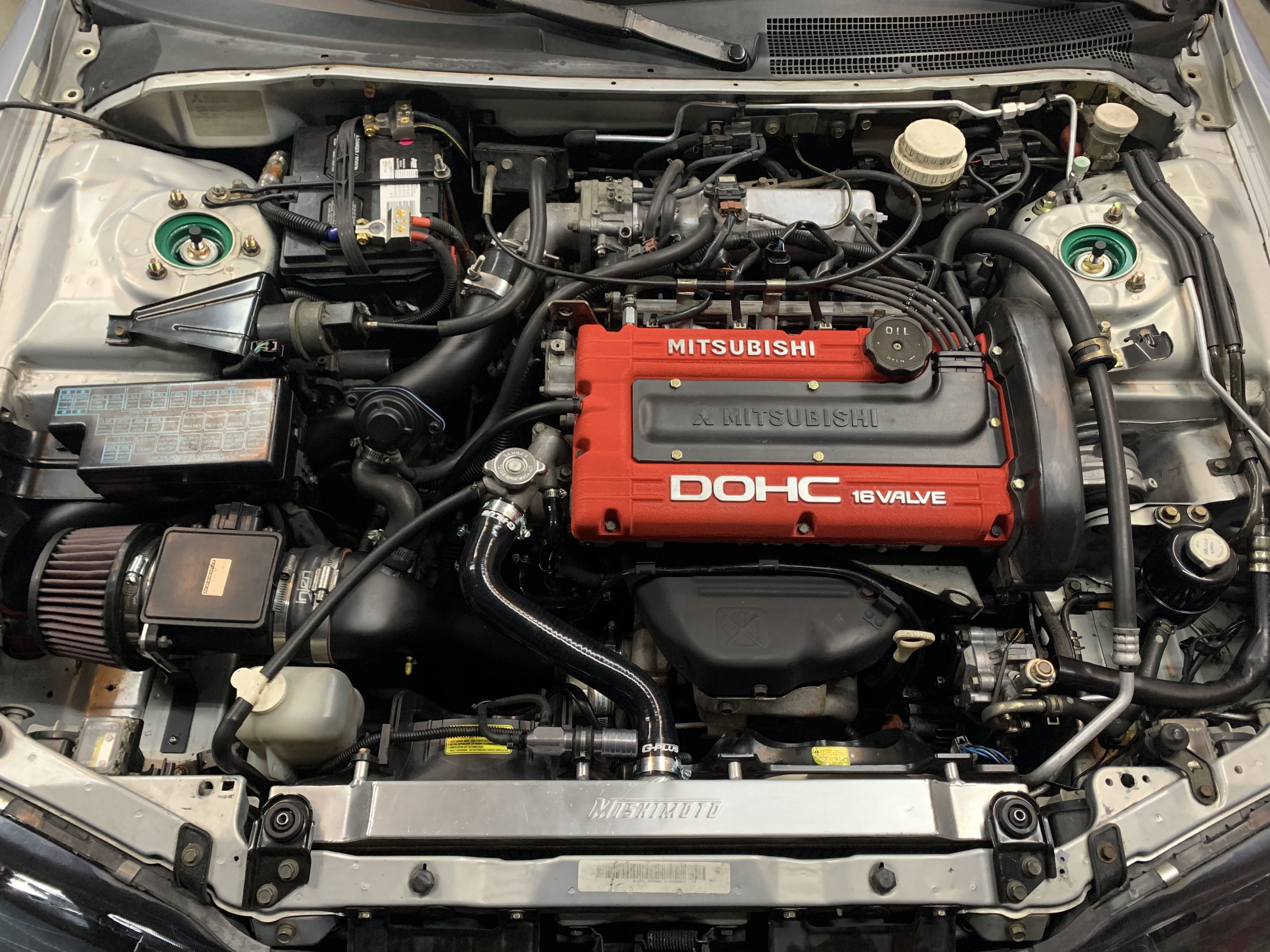

I started with the engine repairs first; a new Gates timing and balance belt set with OEM tensioner, pulley, water pump etc. I had to find a new valve cover because of a HUGE crack in the corner by the cam gears, and while replacing that I put in a set of 3g "no tick" lifters, new plugs, wires, coil packs, and fuel injector o-rings. I also changed out the engine and transmission oil, as well as the oil and fuel filters. Engine mounts were good except the front anti-roll mount, so I replaced that too. I fixed the wiring and replaced the oil pressure sensor that the previous owner installed, as well as the boost gauge that was janky.
After that I was able to get the car running enough to drive it some and start figuring out the CEL codes. I had P1104 and P1105 codes, so I replaced the boost solenoid (it wasn't even installed), I didn't hook up the vacuum lines, just the electrical connector. I also replaced the fuel pressure solenoid and now no more CEL.
Boost leak test revealed a TON of leaking vacuum lines all over the place, so I replaced every single vacuum line in the engine bay. While I was doing that I also replaced all of the old and cracking/leaking coolant lines with new ones. I had to put in a new thermostat, and then I had to pull the thermostat housing off of the head and replace the o-ring on the coolant tube from the water pump because it started to leak from there after I fixed all of the other leaks.
I pulled and cleaned all of the I/C piping, painted the rusty steel upper I/C pipe and BOV, I put on new gaskets and silicone couplers that were the correct size, unlike the ones that were on it.
I fixed the wiring in the engine bay, someone had replaced the battery terminals at one point and cut the wires from the fusible link to short so they were stretched across the upper I/C pipe and dangerous, so I ran 4ga wire to a distribution block and then into the fuse block. I replaced all of the grounds in the engine bay with 4ga OFC wire, and ran a second run of 4ga OFC from the alternator to the fusible link.

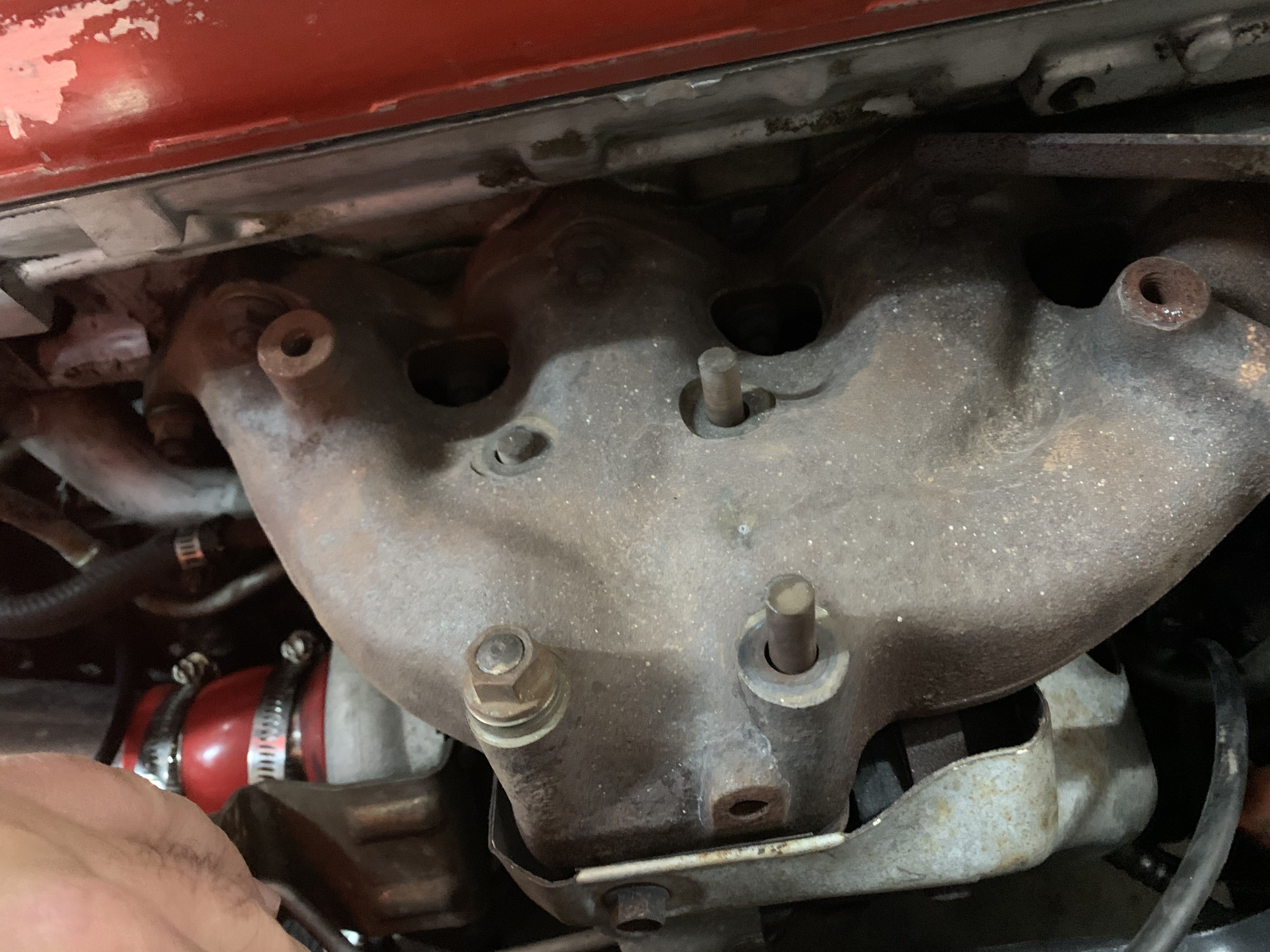

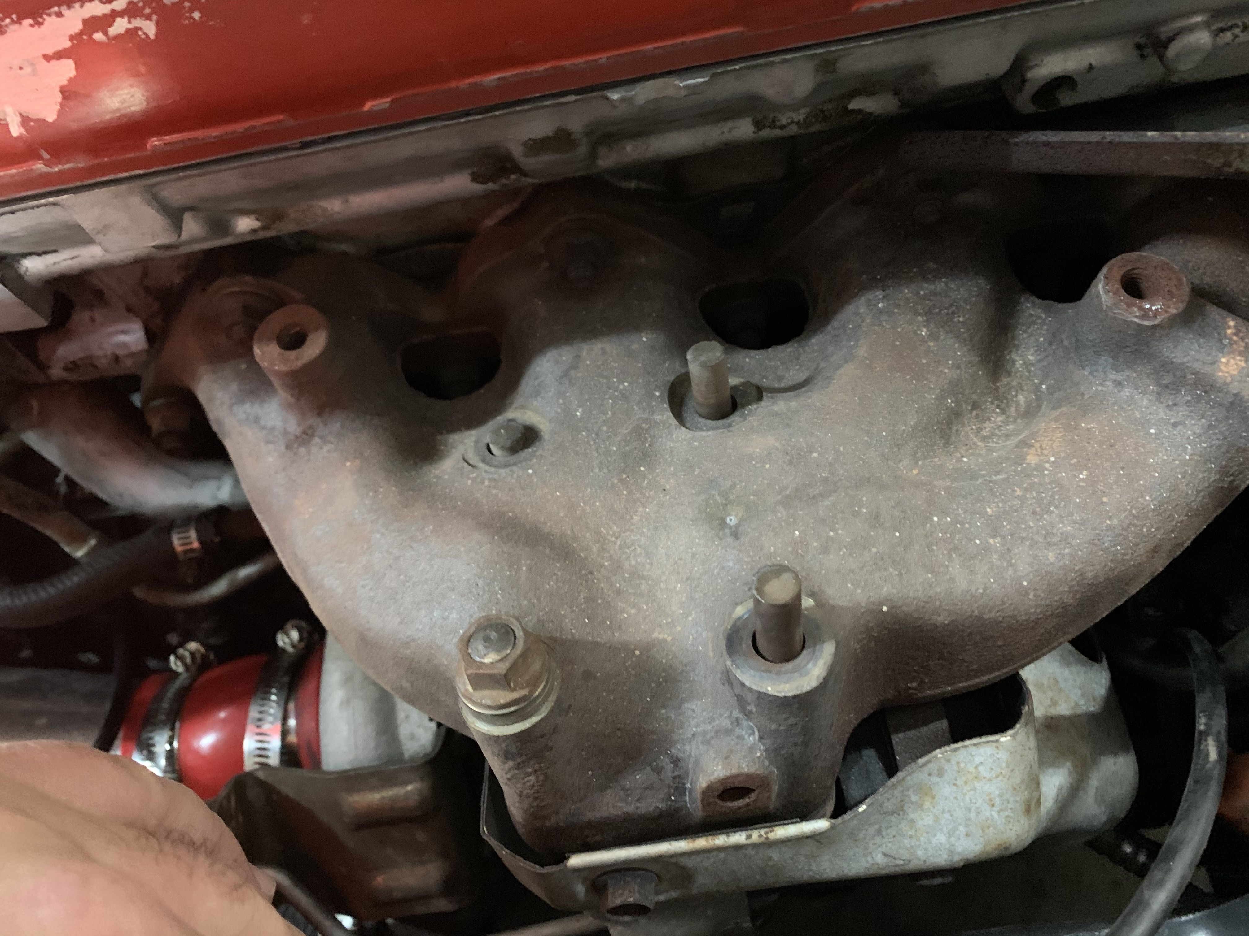

The turbo was only held on by a single nut on the stud, all three of the bolts had snapped at some point and the exhaust manifold had 5 loose nuts as well. I replaced the broken bolts and re-torqued the manifold and everything works great now and no exhaust leaks.

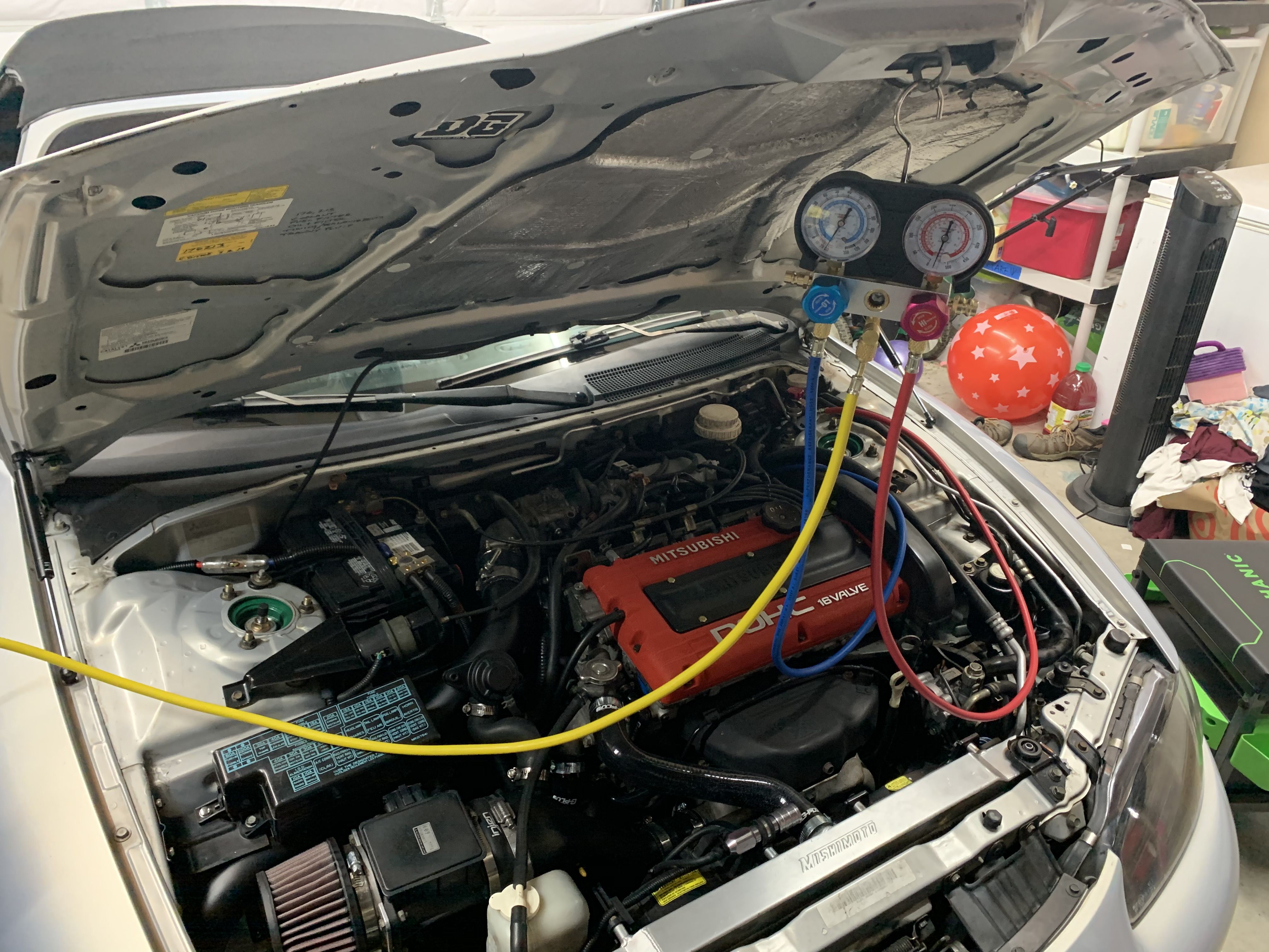

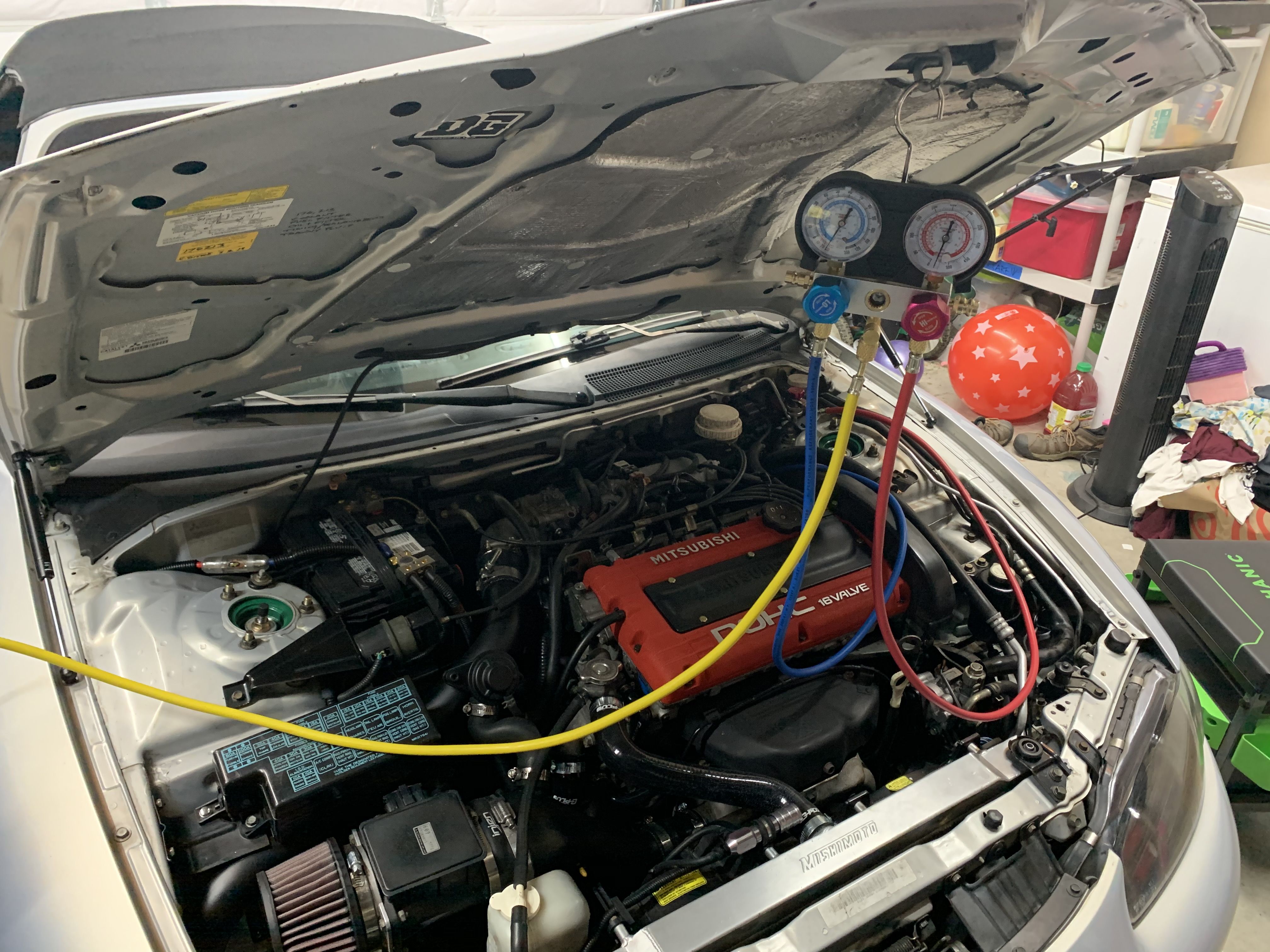

The A/C wouldn't hold a charge and I found the short high pressure line from the condenser to the drier was broken in half, so I replaced the line and drier, pulled a vacuum and it held for 12 hours. Pumped it full of refrigerant and now I have ice cold A/C!
I added a Megan Racing downpipe with an O2 sensor bung and installed my AEM wideband UEGO.
That just about did it for the engine bay, next I'll go into the suspension, brakes, and exterior
