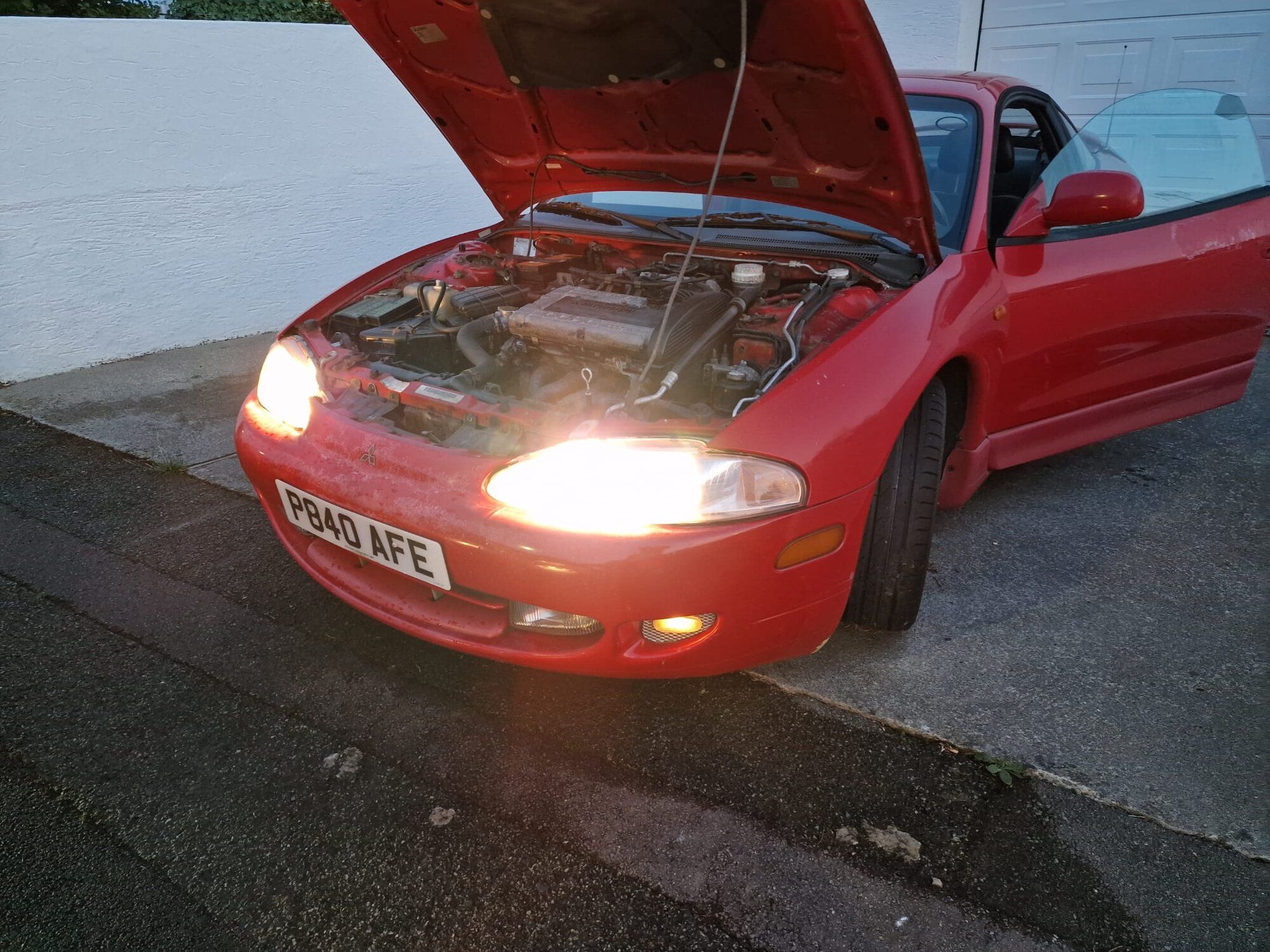

So with a lot of help from a fellow UK DSM member, we replaced the timing belt, balance shaft belt, water pump and pulleys, put some fresh fuel in and this was the result

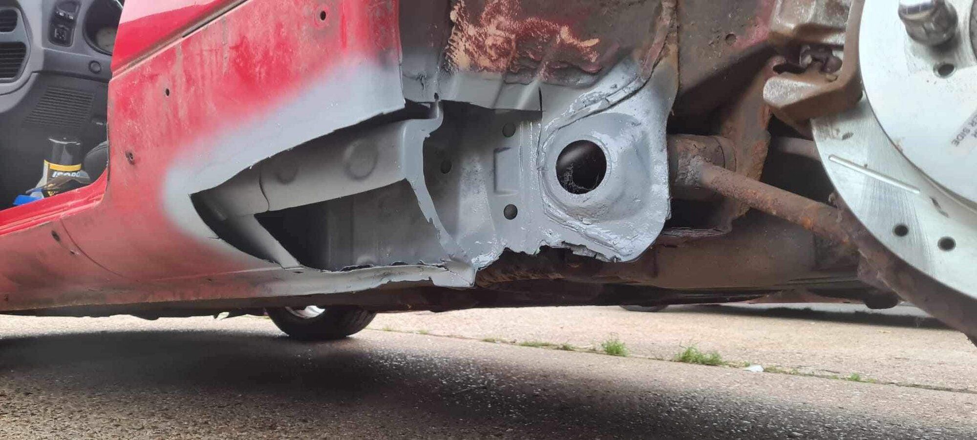

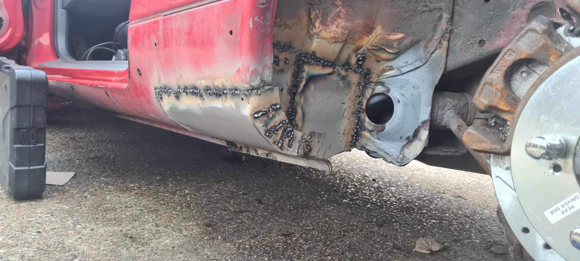

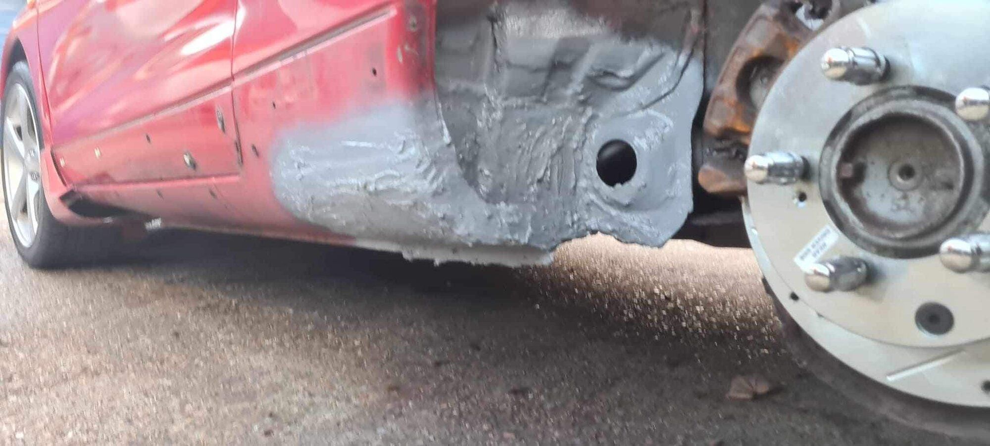

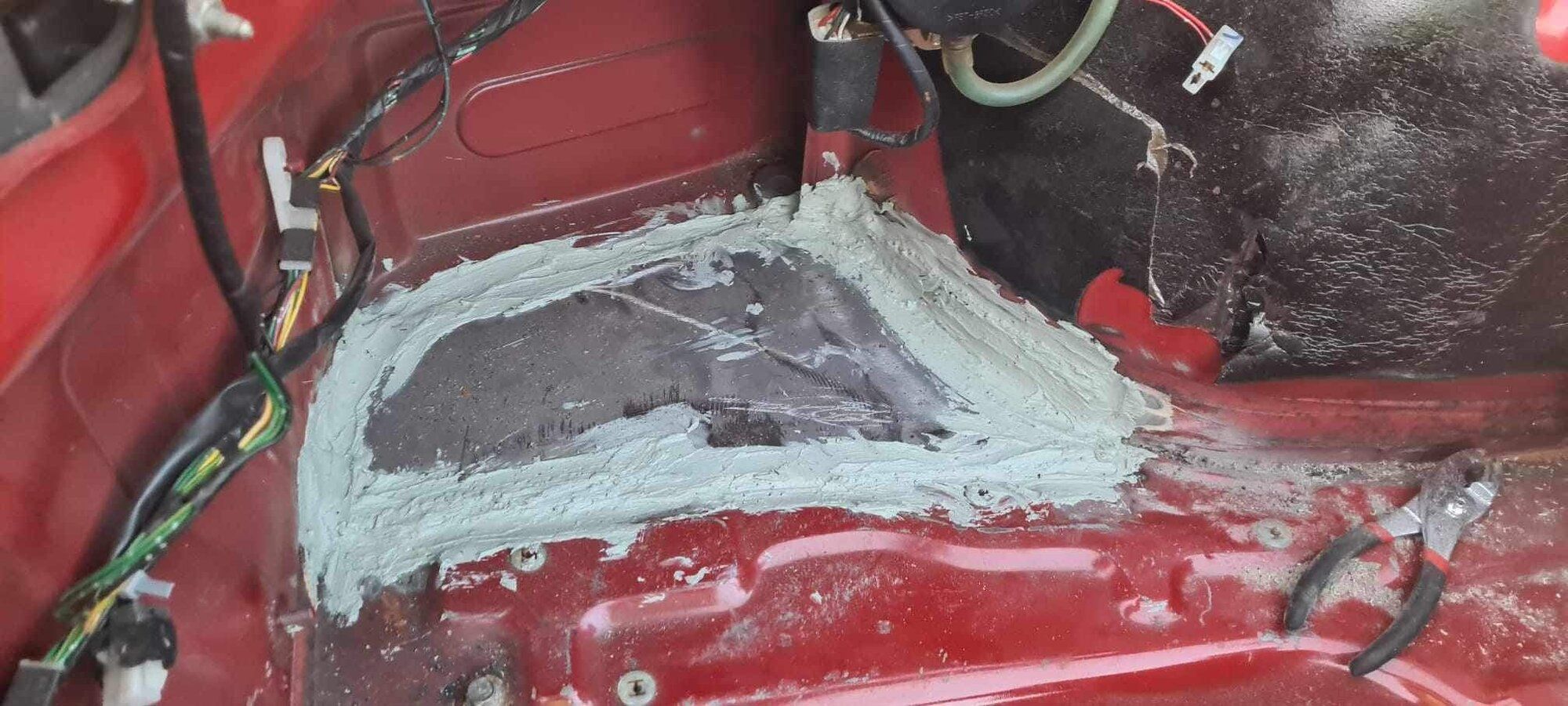

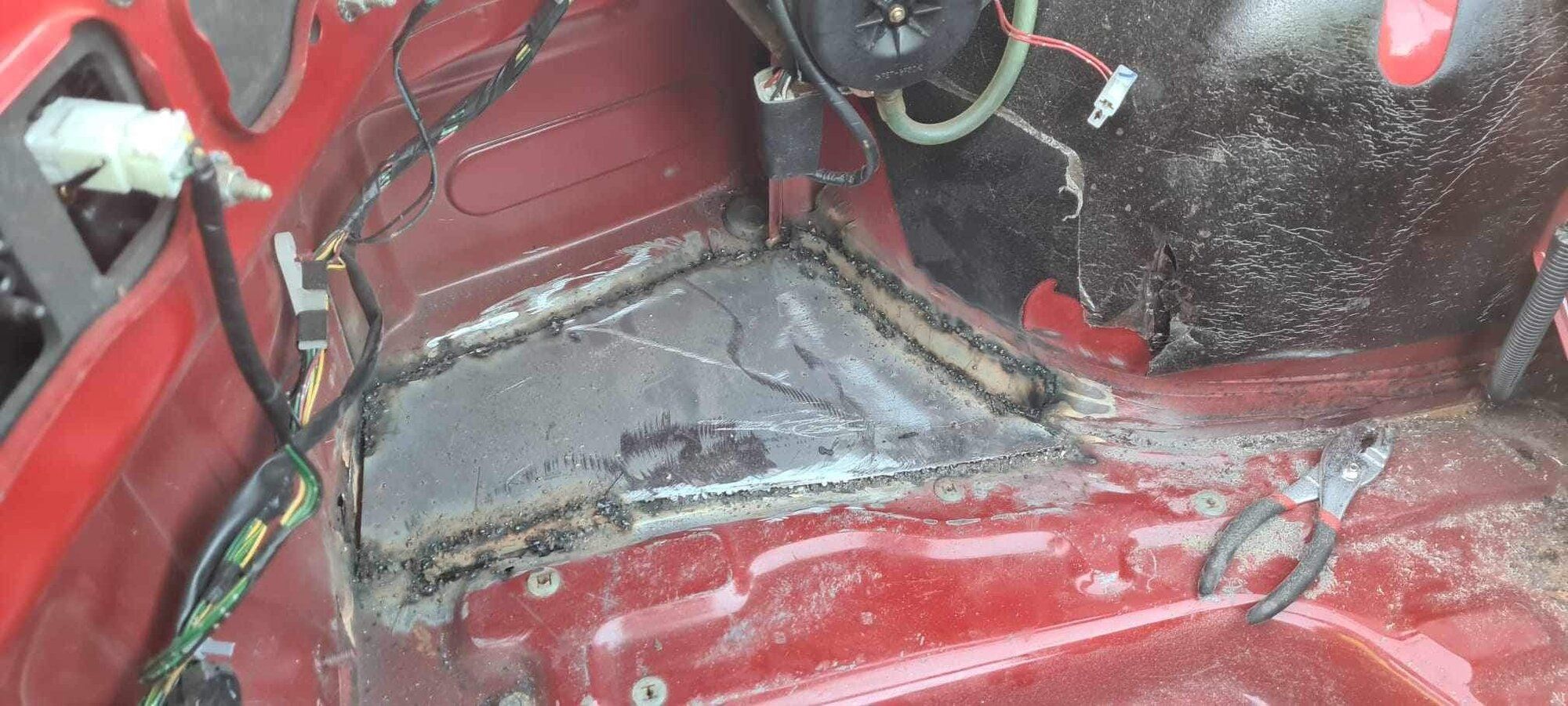

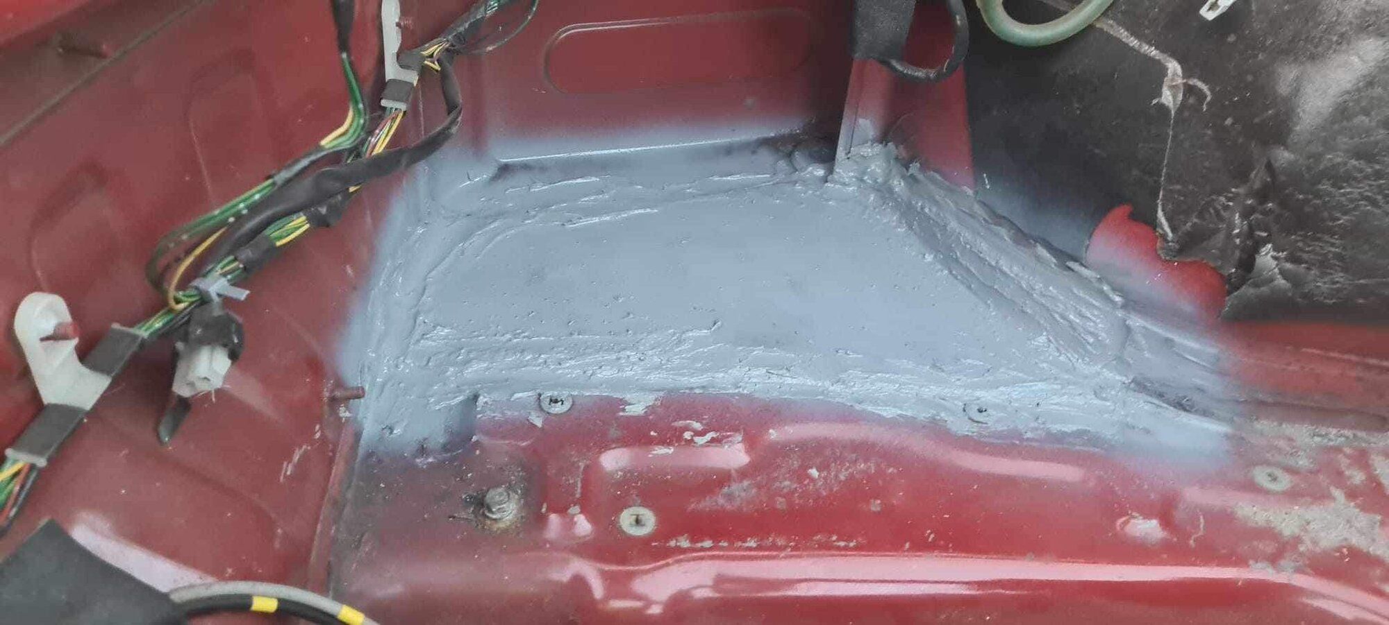

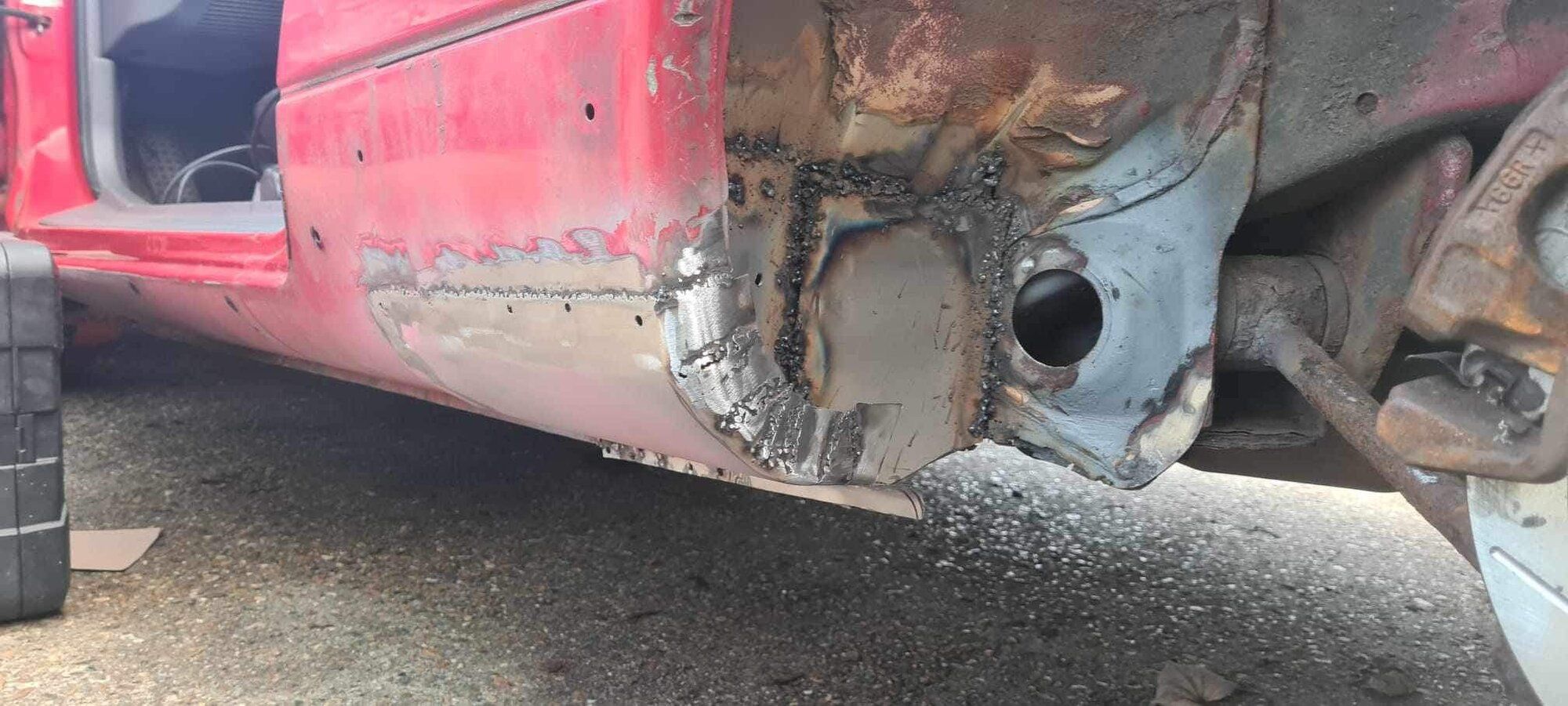

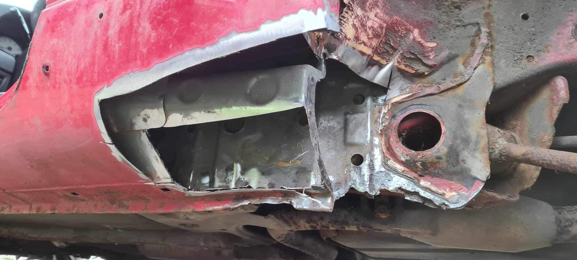

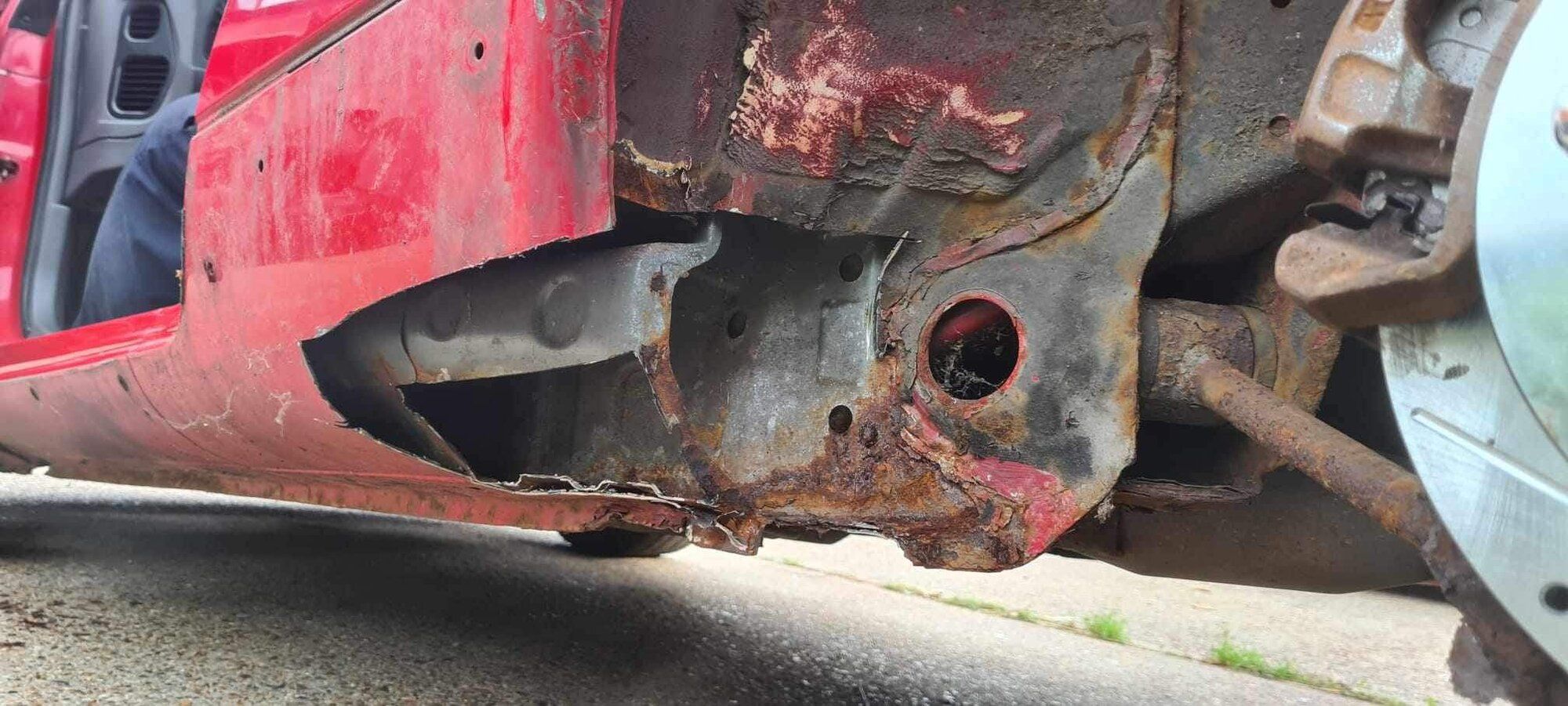

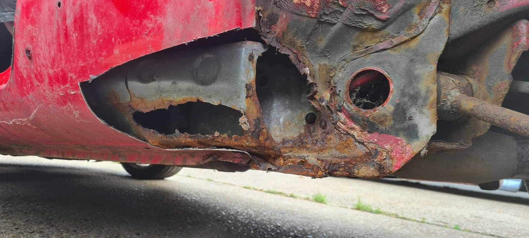

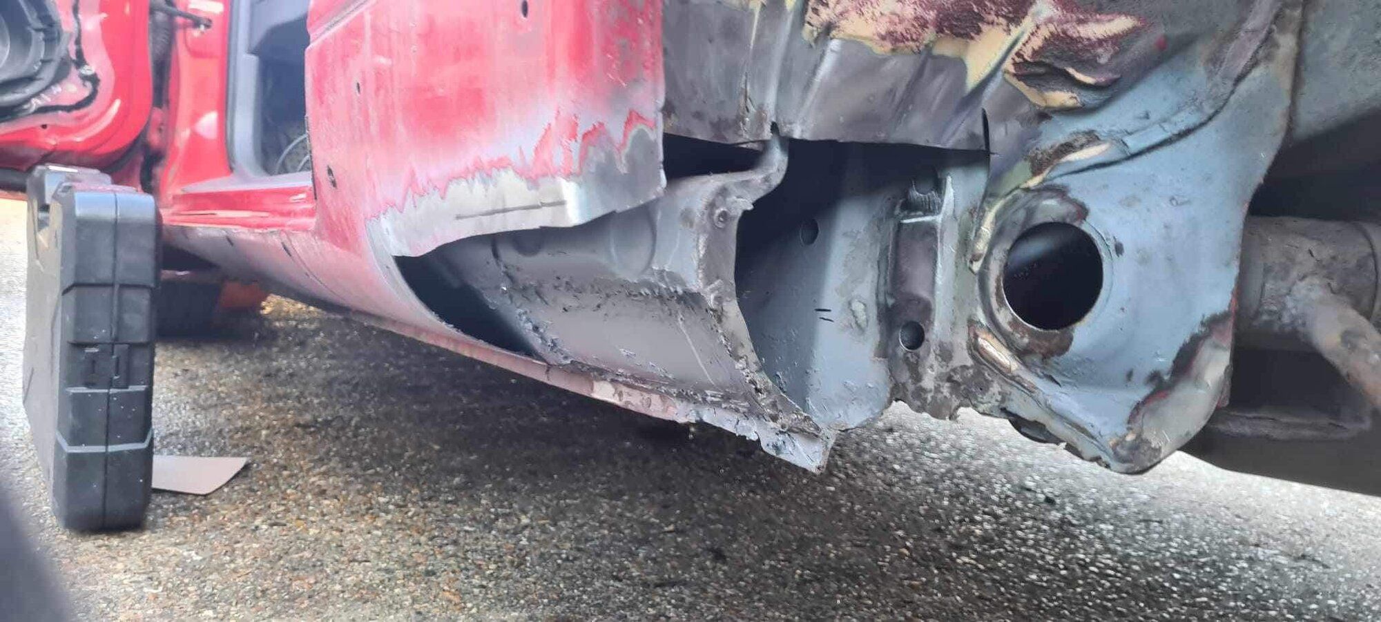

Have done some more work on the DSM today, I have started the welding a couple of weeks ago, I am by no means a professional welder, but want to try and do as much to the car myself as possible.
I had some bad rust at the drivers side rear inner and outer sill, also some of my boot floor needed replacing.

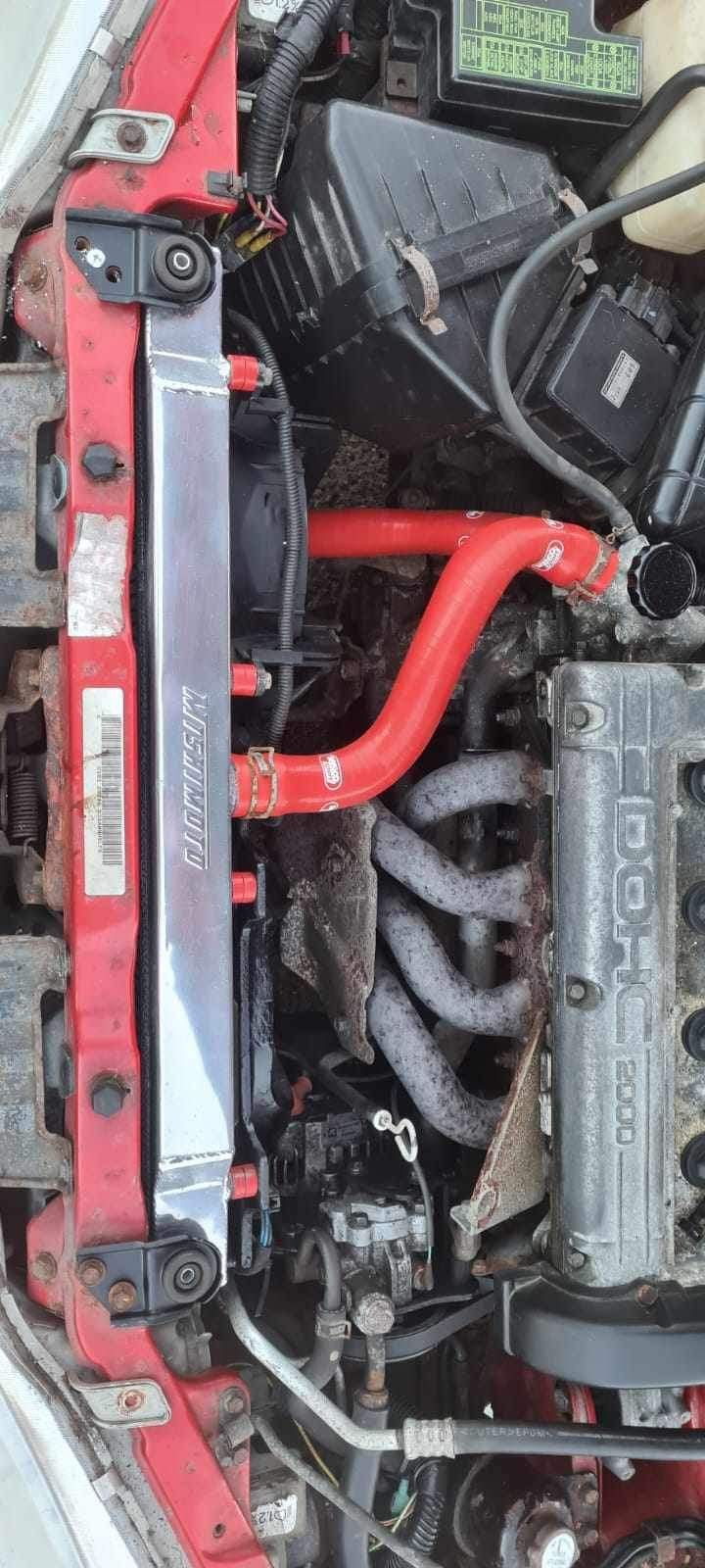

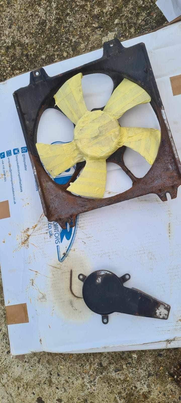

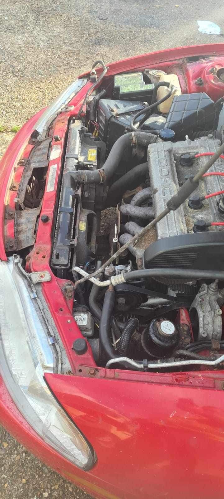

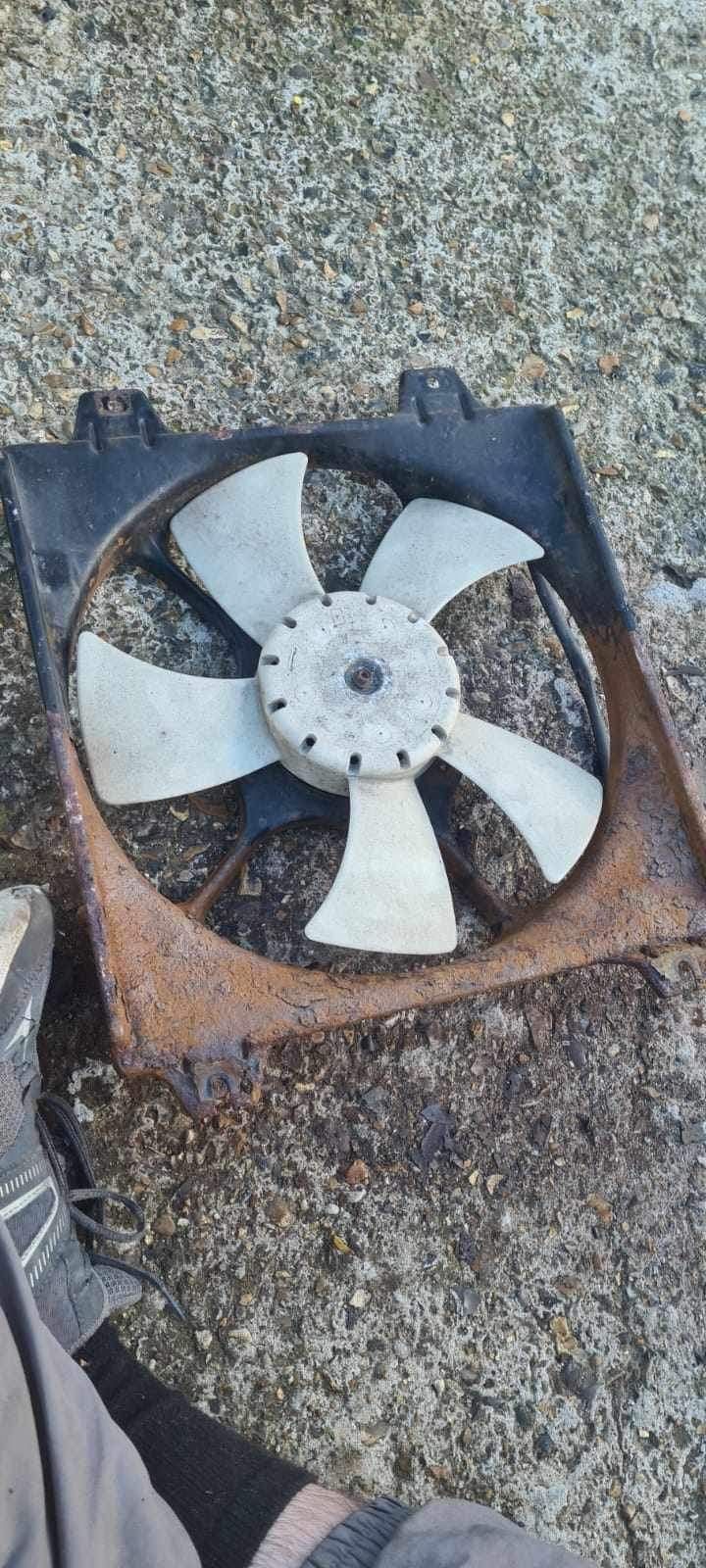

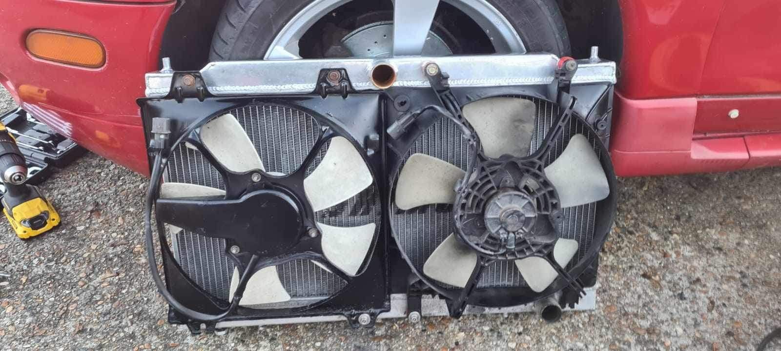

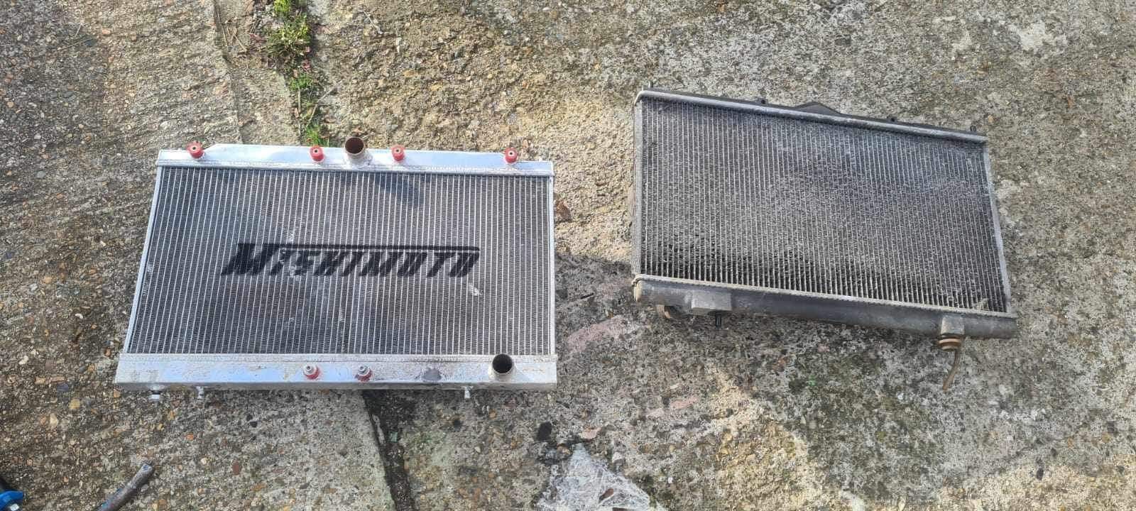

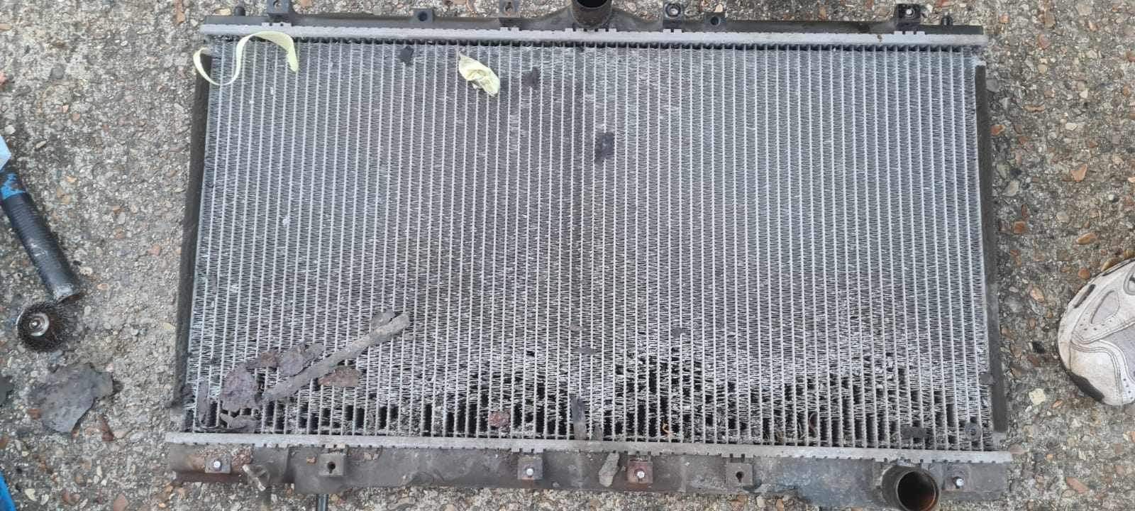

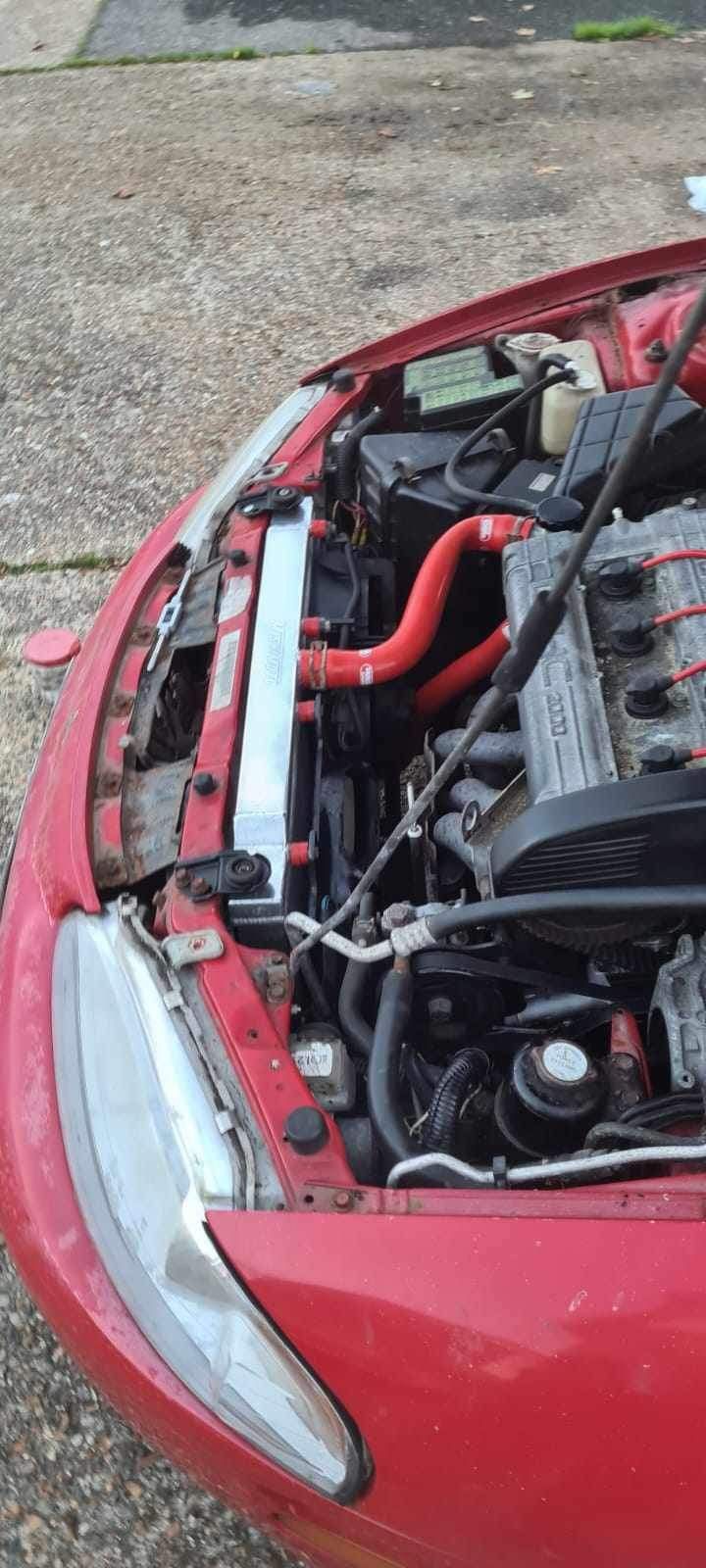

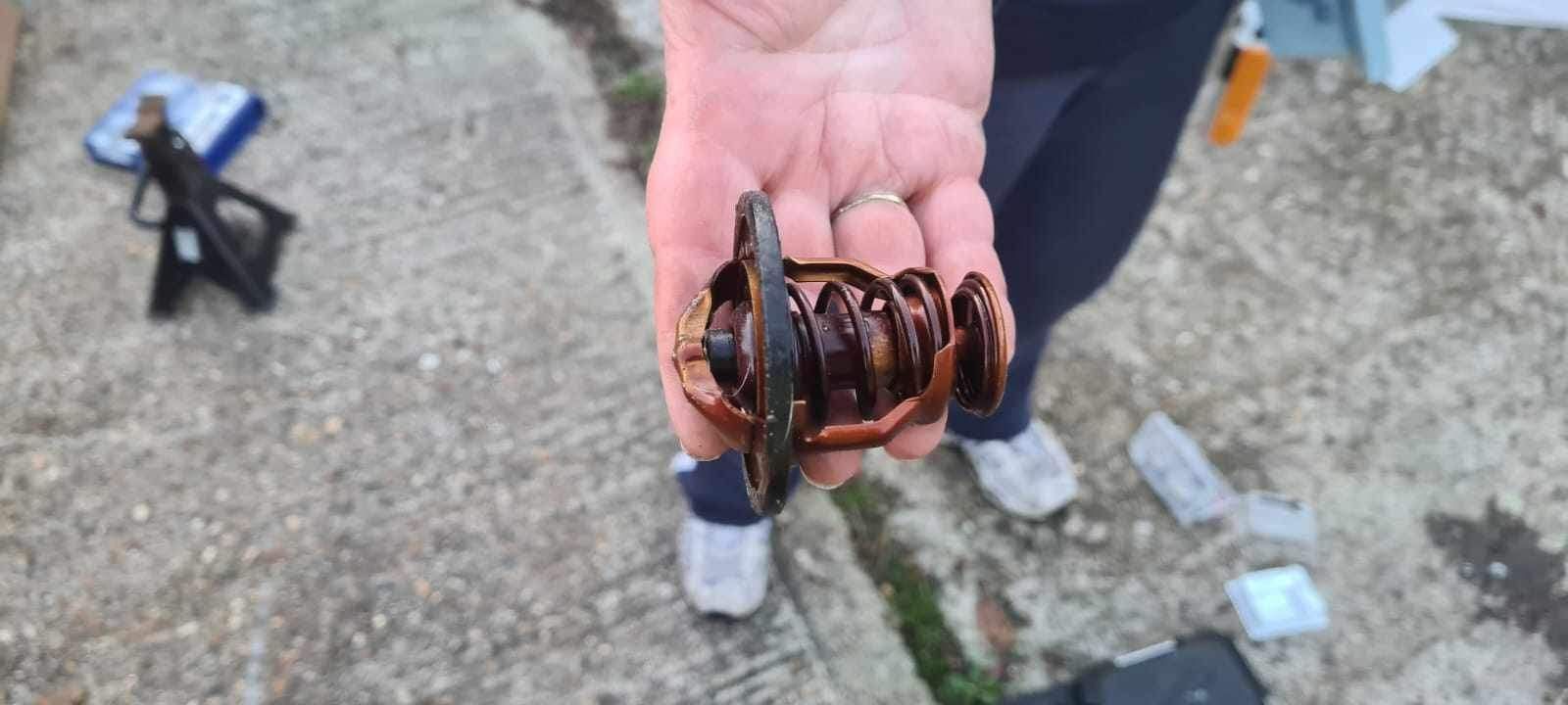

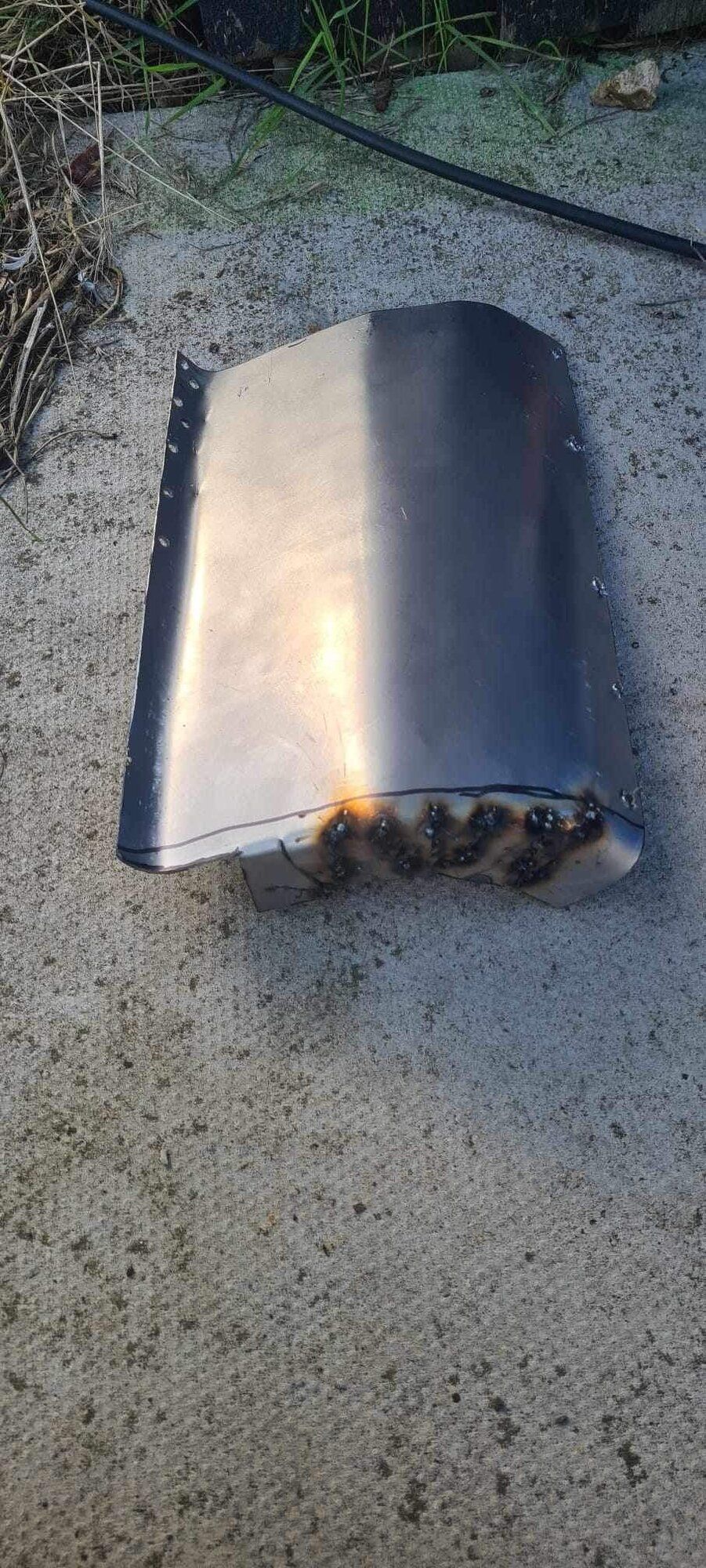

Next job I did today was to sort the cooling system, my rad was just a little worn I think, changed the thermostat out, fitted a alloy radiator and silicone pipes, bled the system up, also rust treated the fan housing and painted it.
