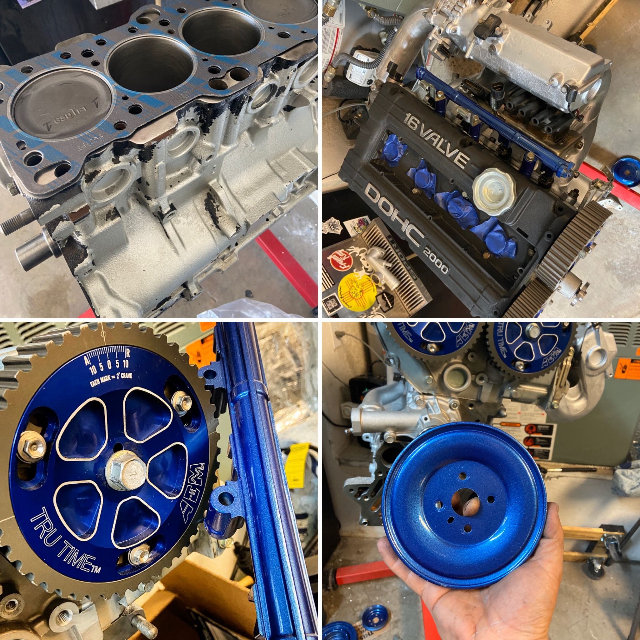

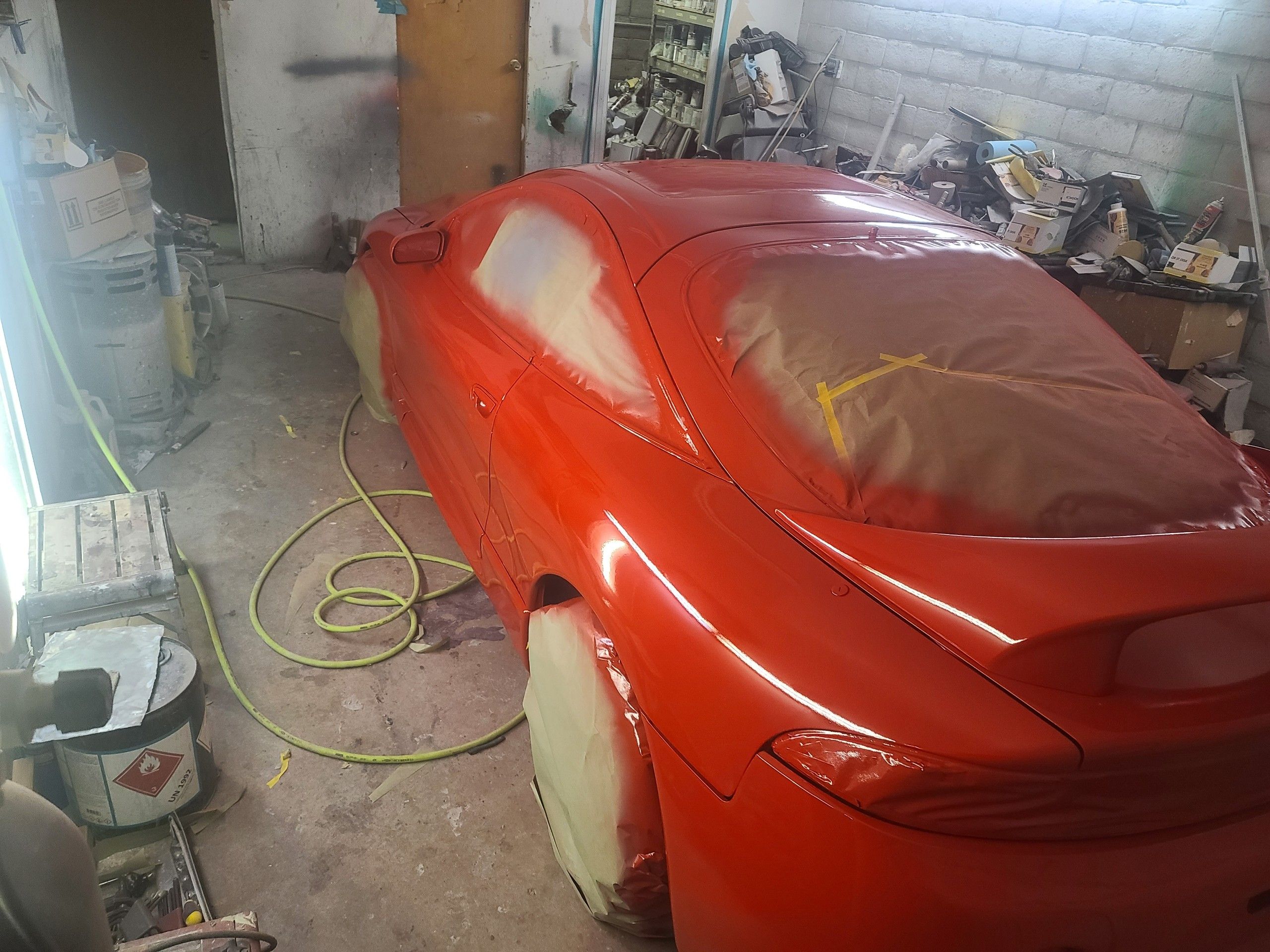

98 GST rescue
98 GST shell/rebuilt engine core. Under reconstruction... rebuild 99% complete

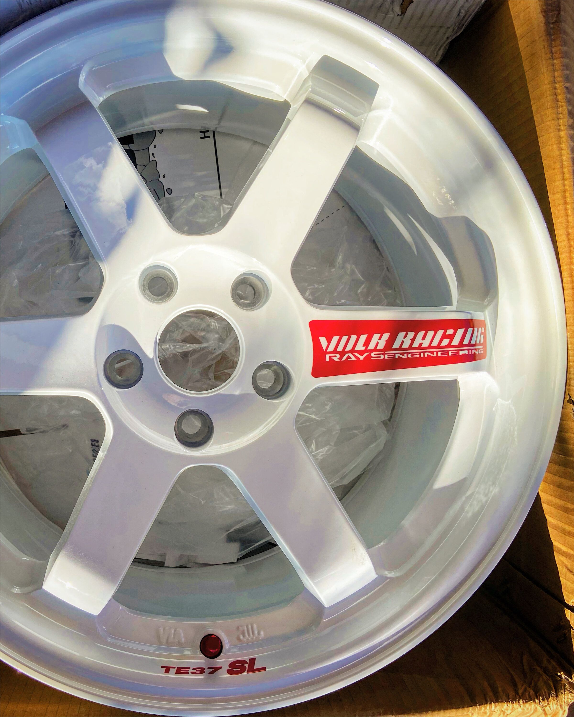

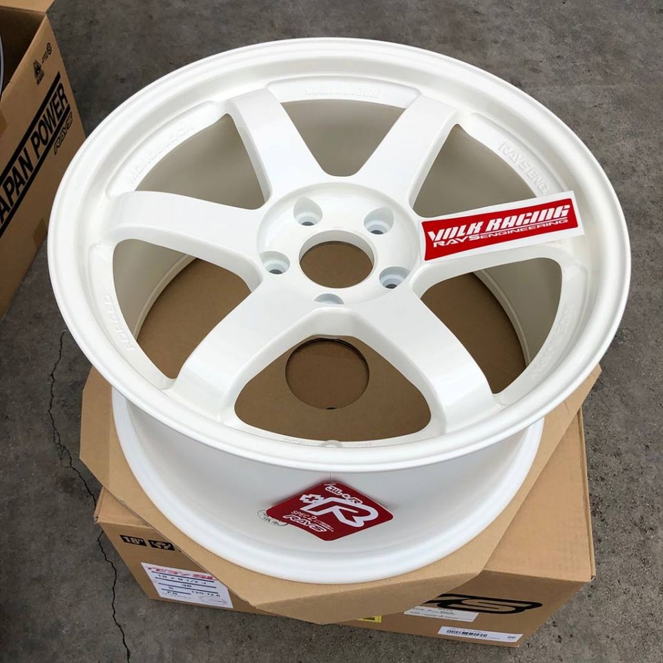

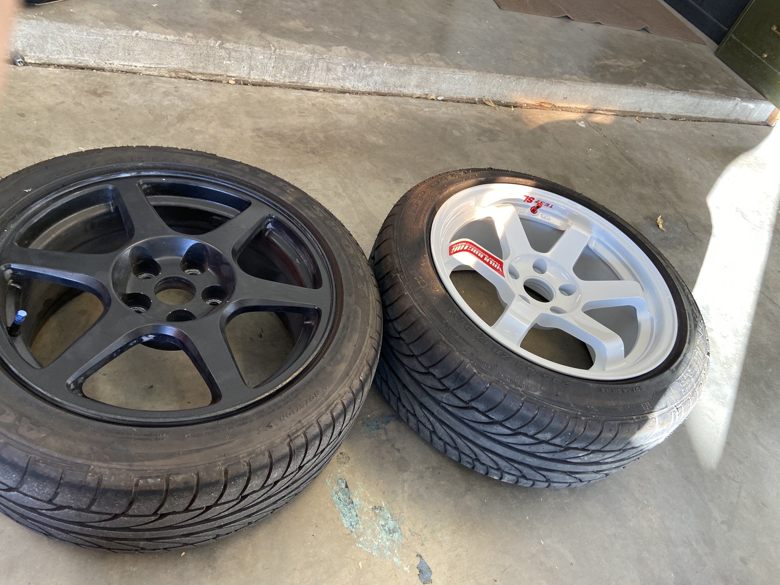

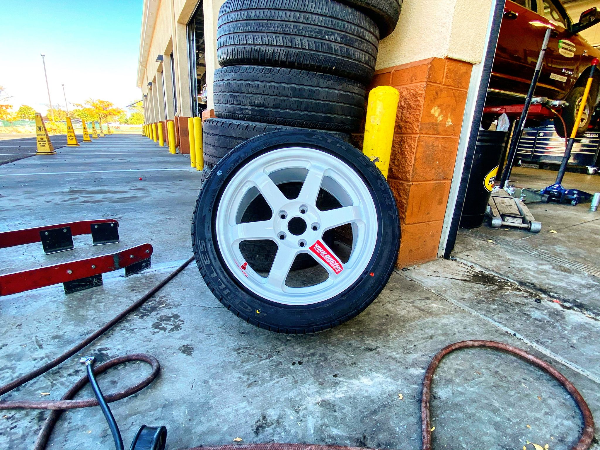

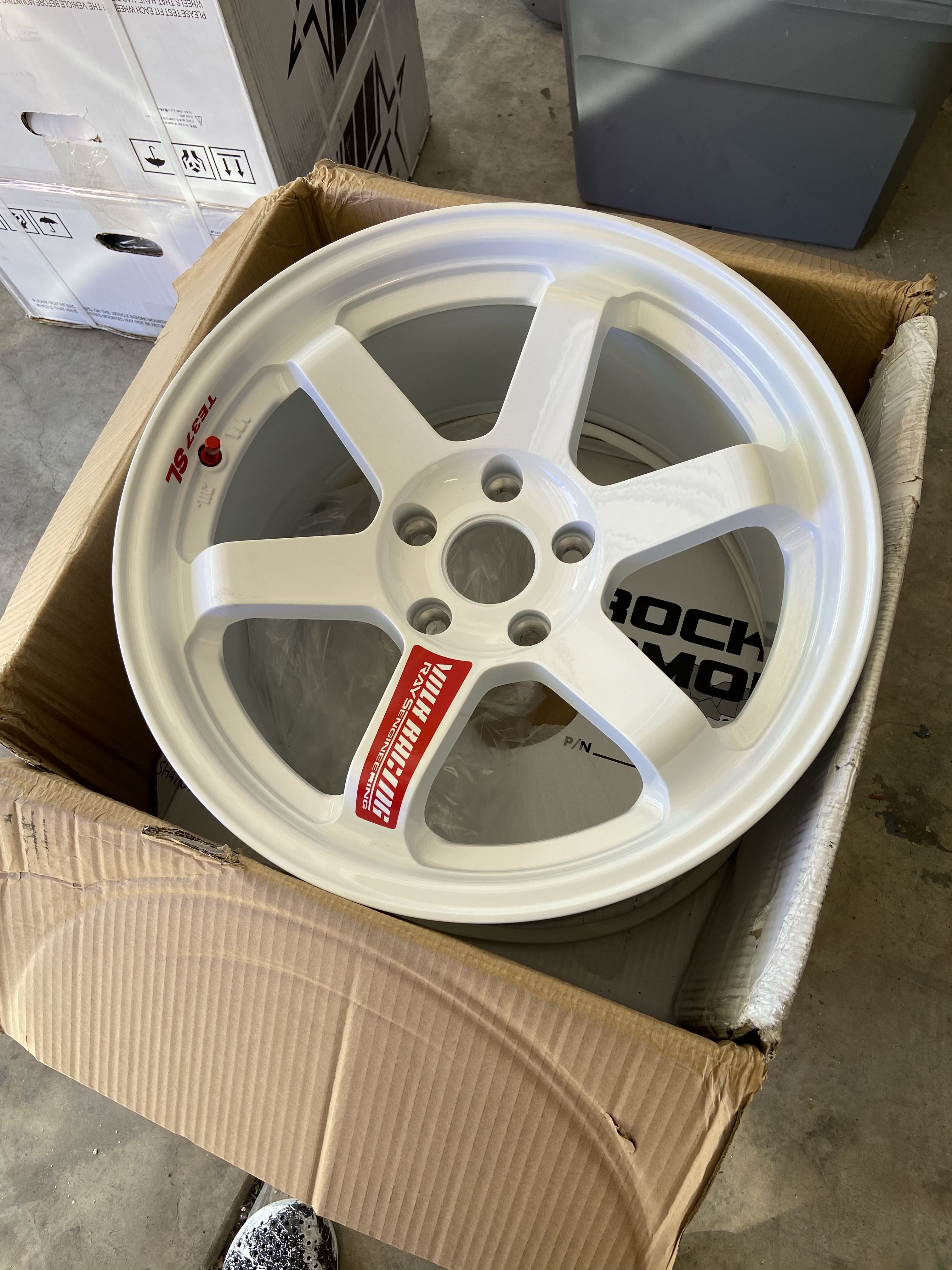

Wheels ordered!
Starting to get real excited about this build up. More I think of it, the more I’m considering a side dump.
I really want to get it Dyno tuned. After the alignment

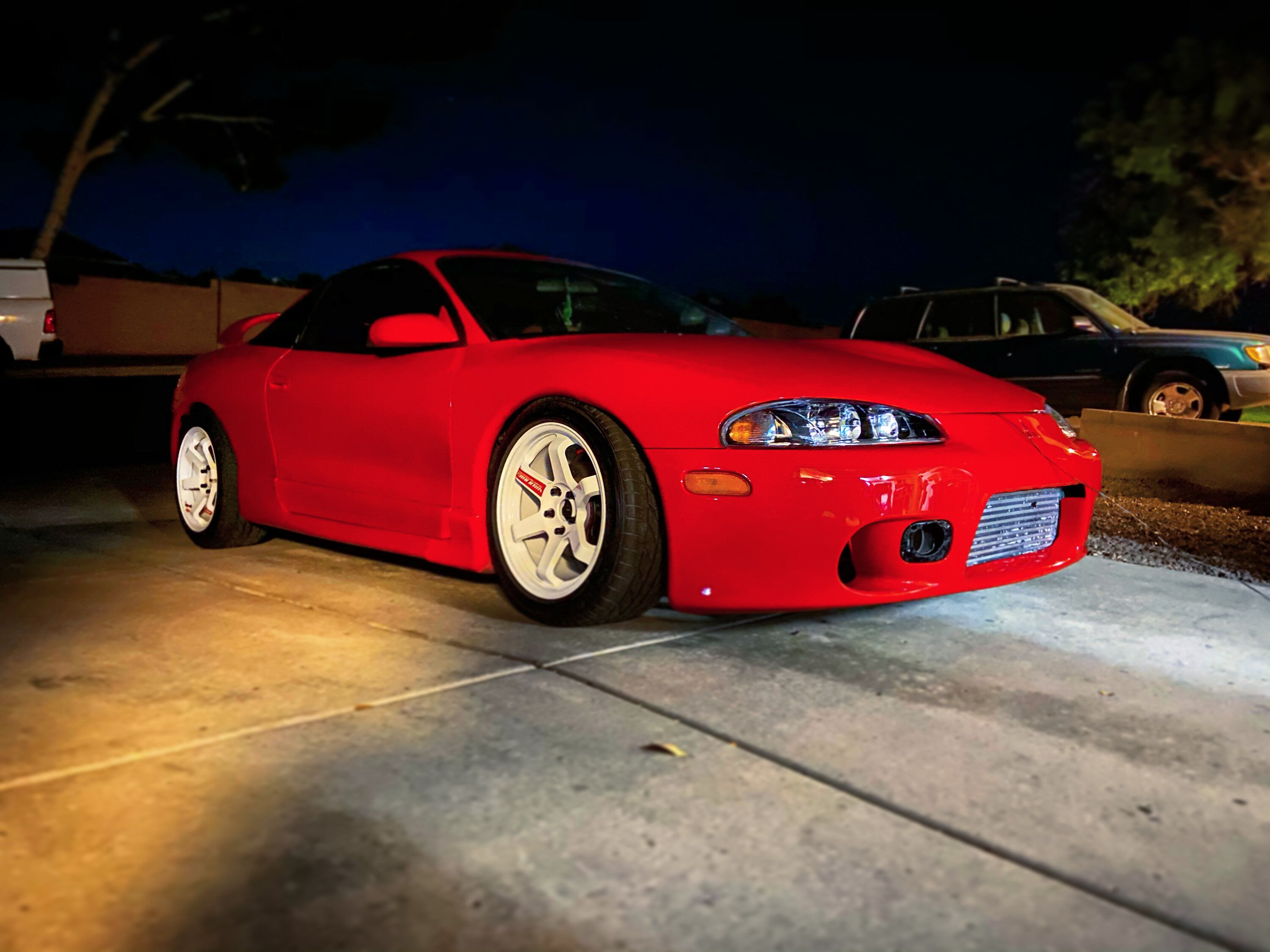

digging those wheels
thanks! I went with the most solid size. The TE37 design is pretty period correct and timeless. I was between these and RPF1s. I’ve had 3 sets of RPF1s before. I had a set of real TE37s before too. Couldn’t justify the cost for this build.
can’t wait to get them installed. I’ll be listing the Evo 8 wheels locally for about $250-300

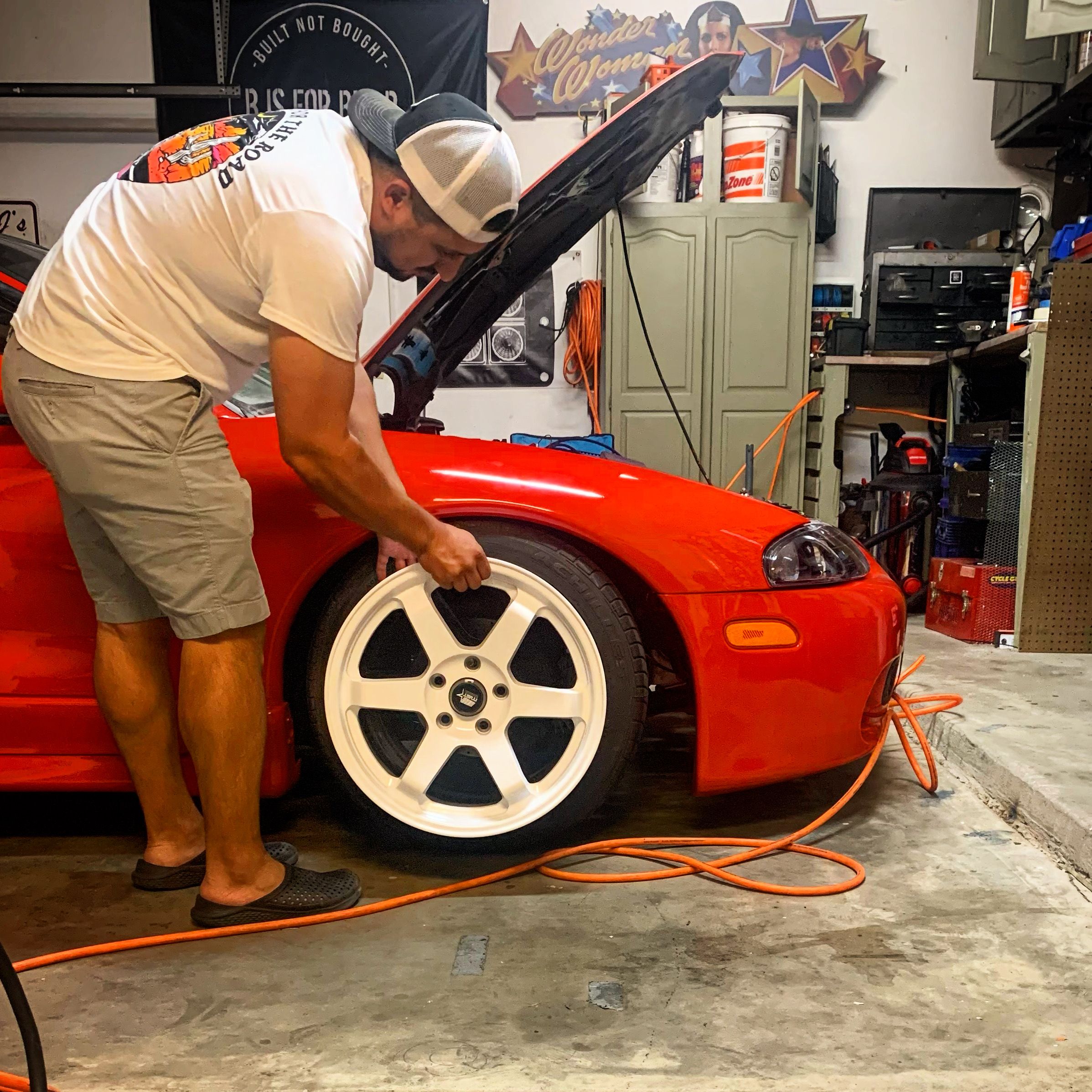

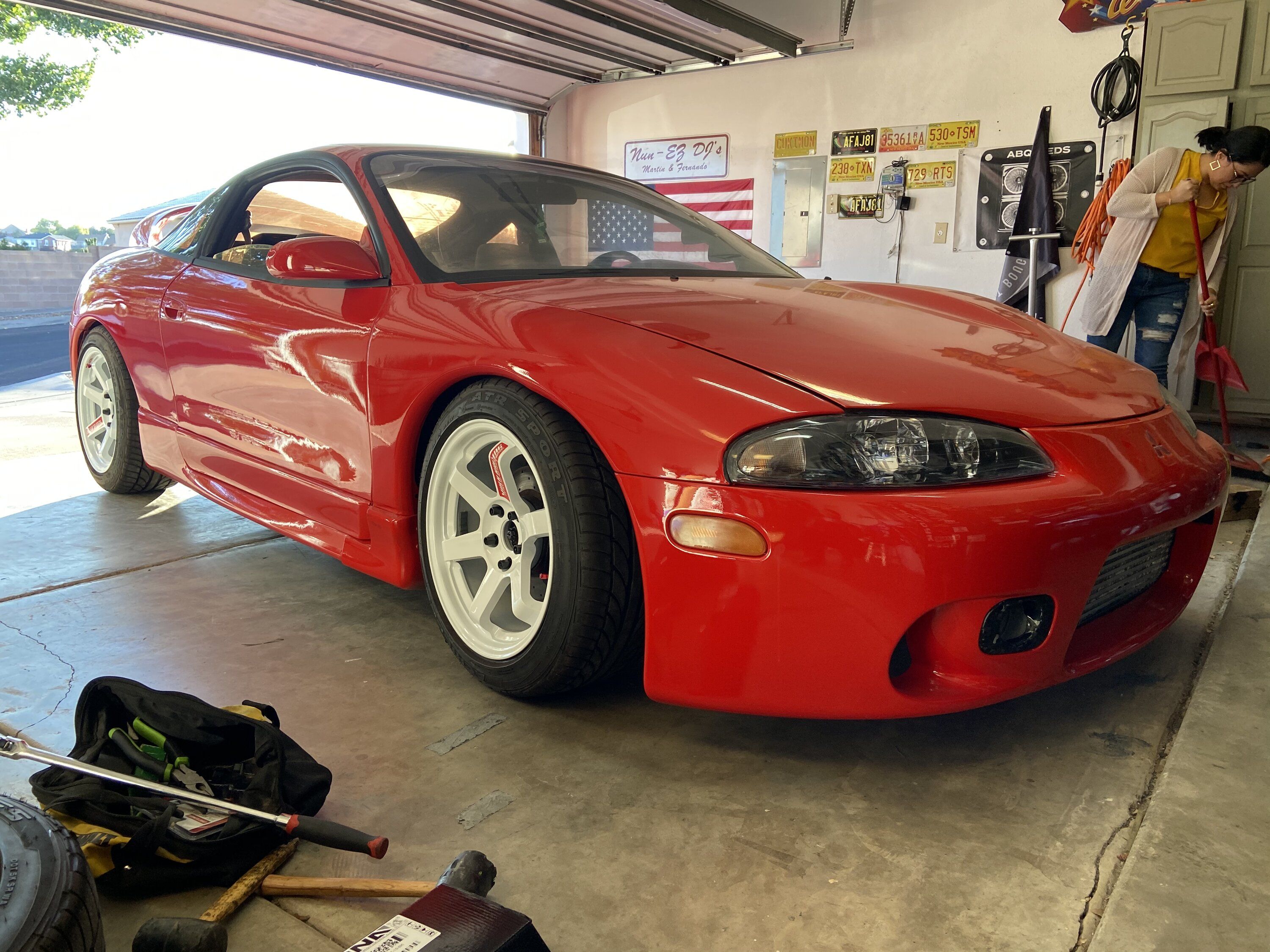

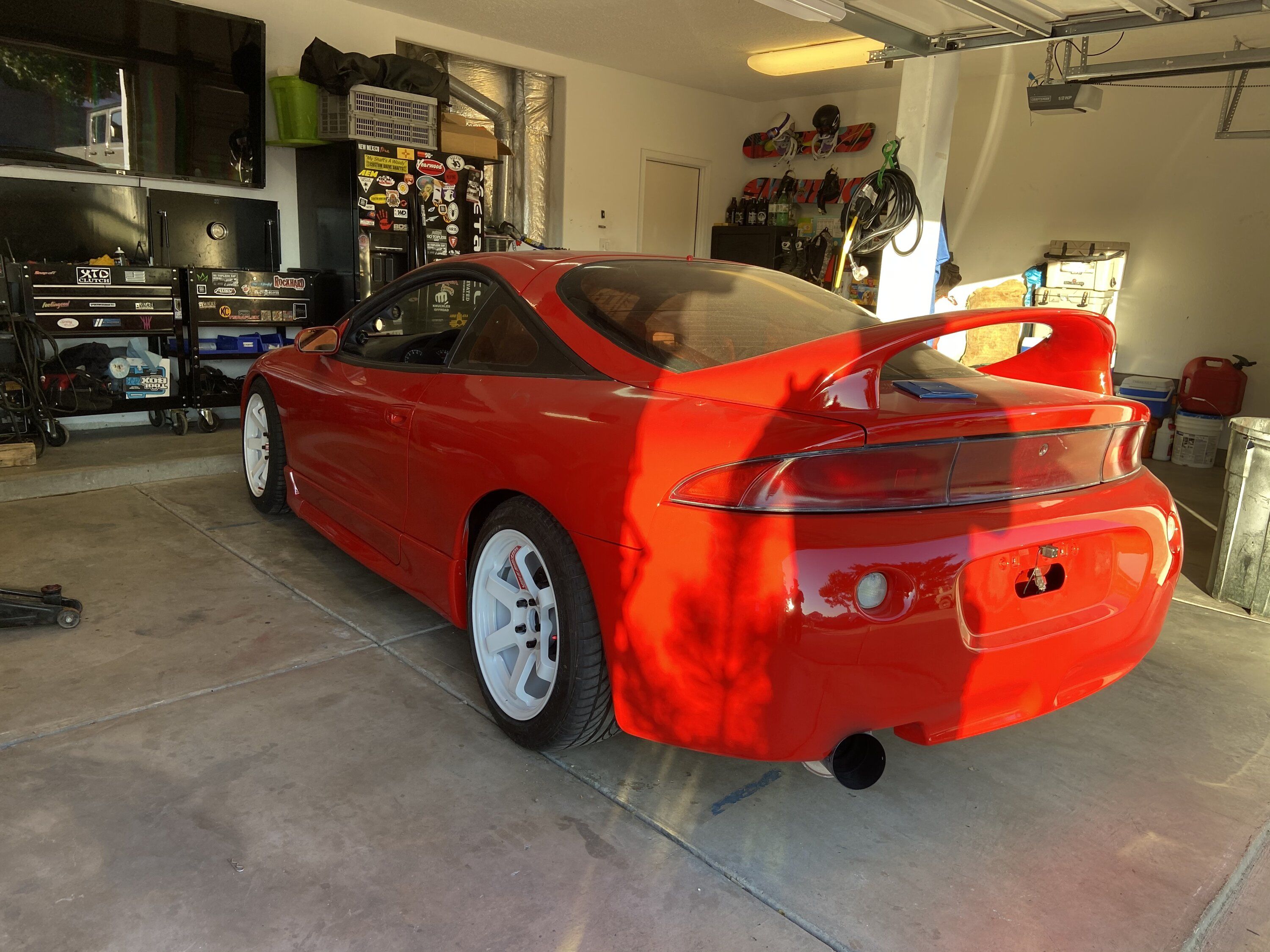

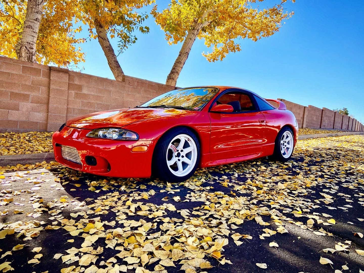

Wow. Took it for a drive this afternoon. I’m going to have to raise it up a bit and try rolling the fenders a bit. It’s rubbing with the 235s on Evo wheels! I had better get the other wheels mounted and dial in the suspension ASAP
Added the decals to finish the look of the wheels. Also picked up a valve stem and forged lugs to complete the package as a whole.
Unfortunately I’m waiting on a tire. I took it out for a test spin and gouged the tire on a bump. It rubbed a fender tab. Sliced it so bad I’m surprised it didnt blow. So now I’m waiting on it so I can have it mounted and dialed all in.

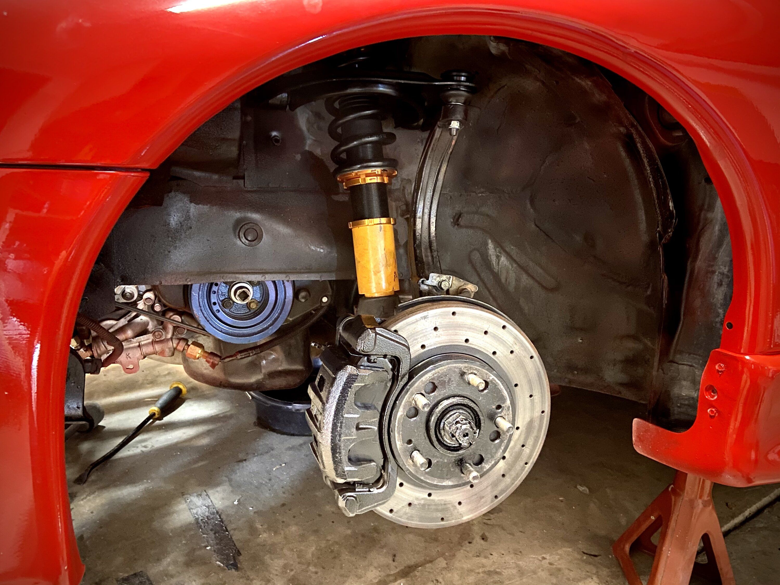

While I had it on the jack, I decided to check the wheel bearings and ball joints. Found the uppers to be bad. Ordered the full set.
Still waiting in the tire to show up so I can have the wheels swapped over. I’ll now be waiting on the rest of the suspension bit to get it aligned.

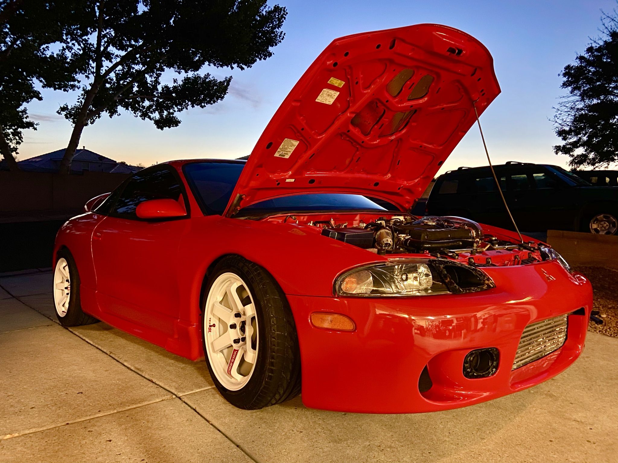

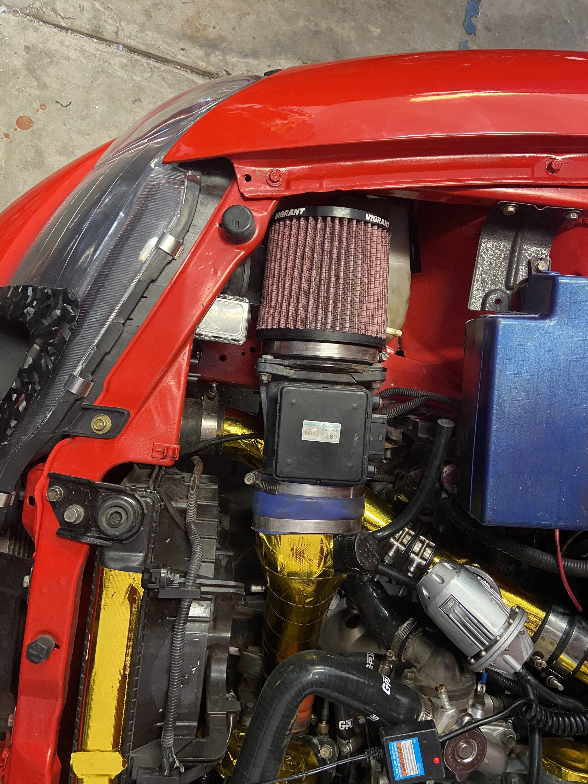

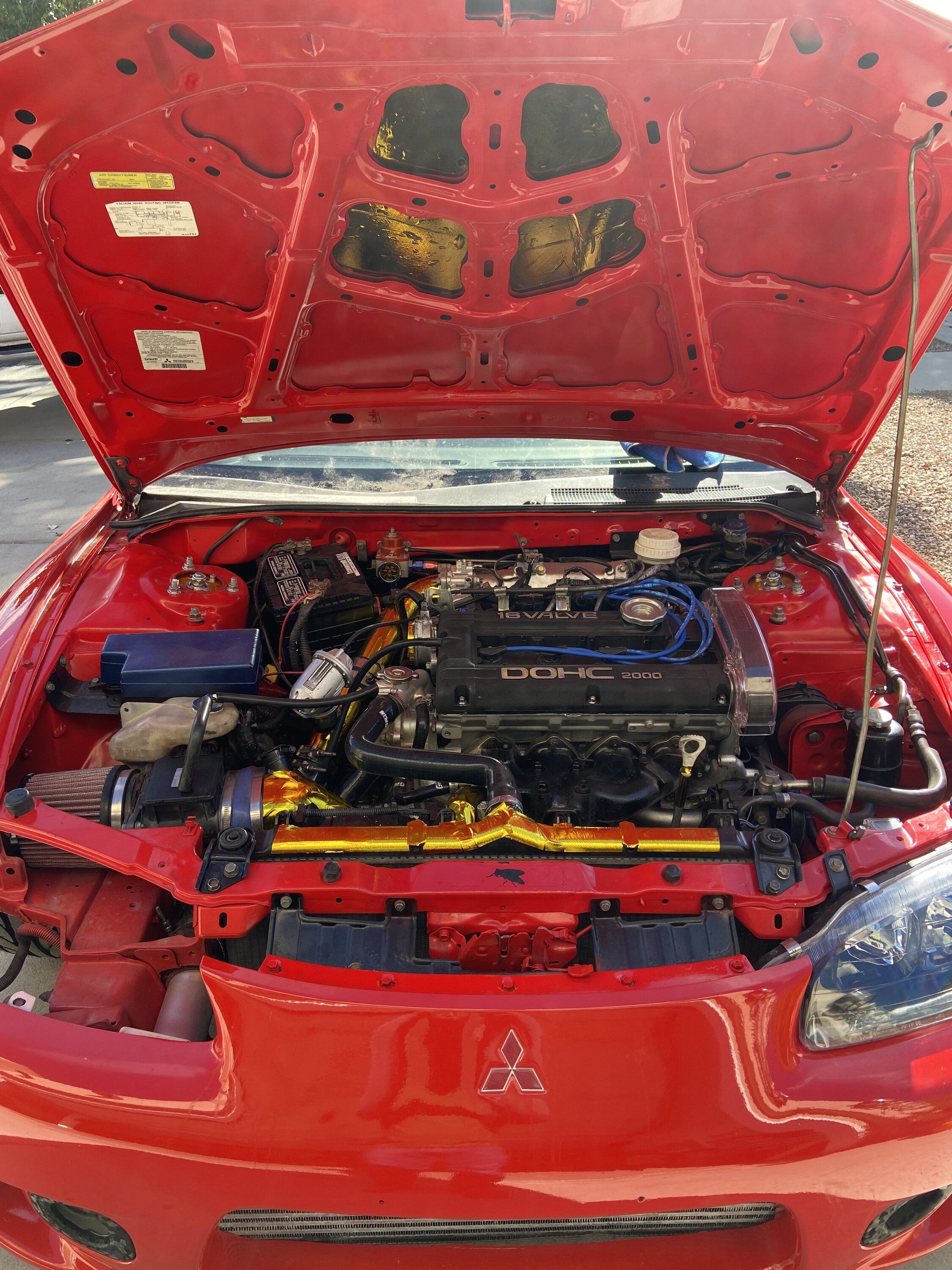

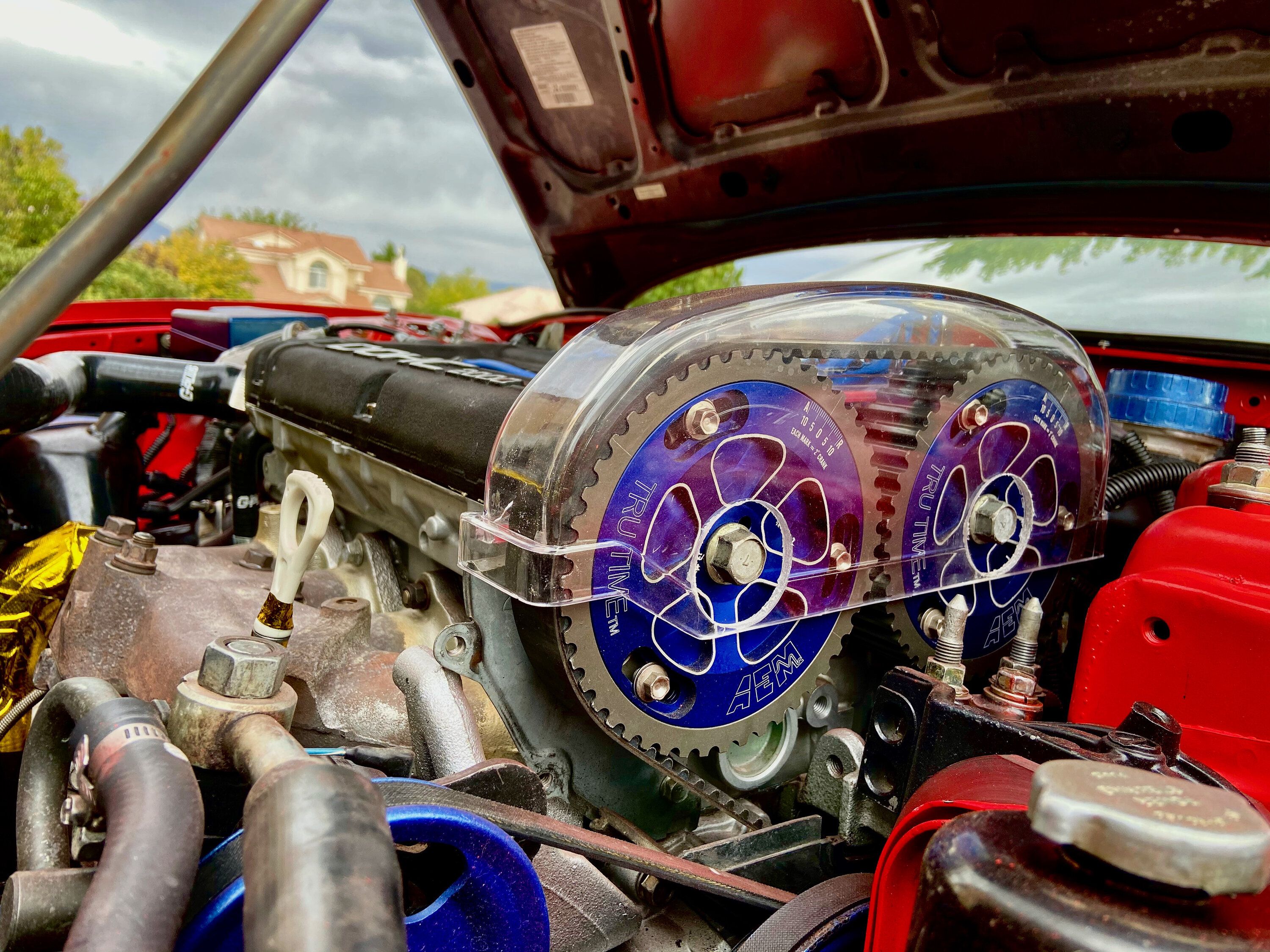

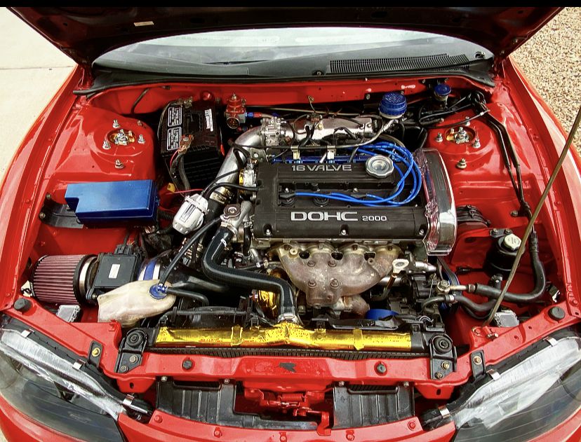

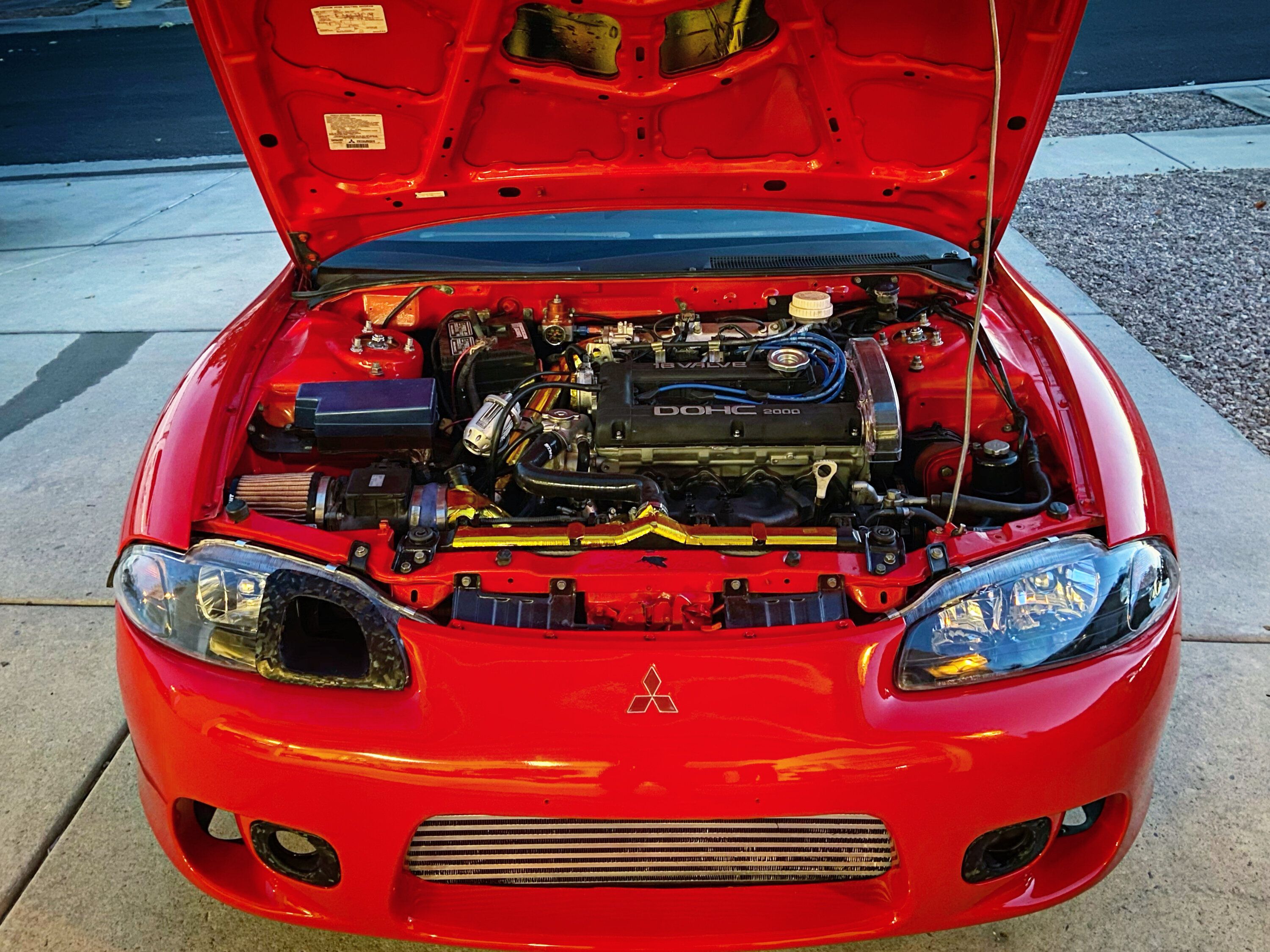

Washed it. Got rid of overspray most every where. Also, installed an eBay clear timing cover.
unfortunately, I must have gotten something too wet while pressure washing the engine bay. I’ll let it dry till tomorrow afternoon and try at it again. But damn. This car is everything I would have hoped it to be so far (aesthetically). the gold foil project will brighten up and contrast the engine bay nicely. It’s going to be fun.
The coilovers will be needing a dial in for sure. I’ll do that when I replace the ball joints.

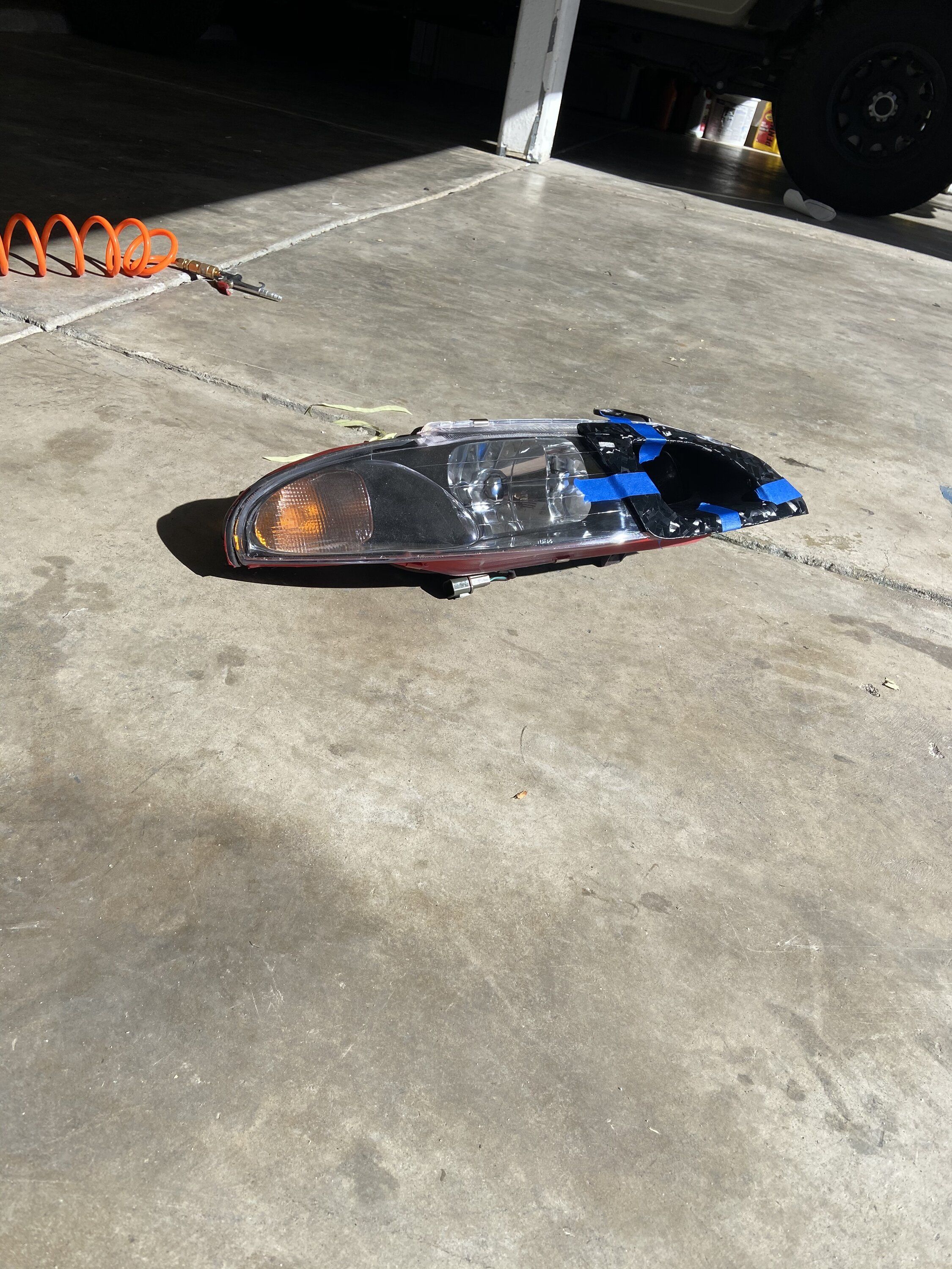

X- cut headlight for duct

I installed my wideband and primary o2 sensor. Did an oil change while I was under there.
AFR averages to 13:1. This is good news to me. I can run this tune till I hit 500 miles for a proper tune!

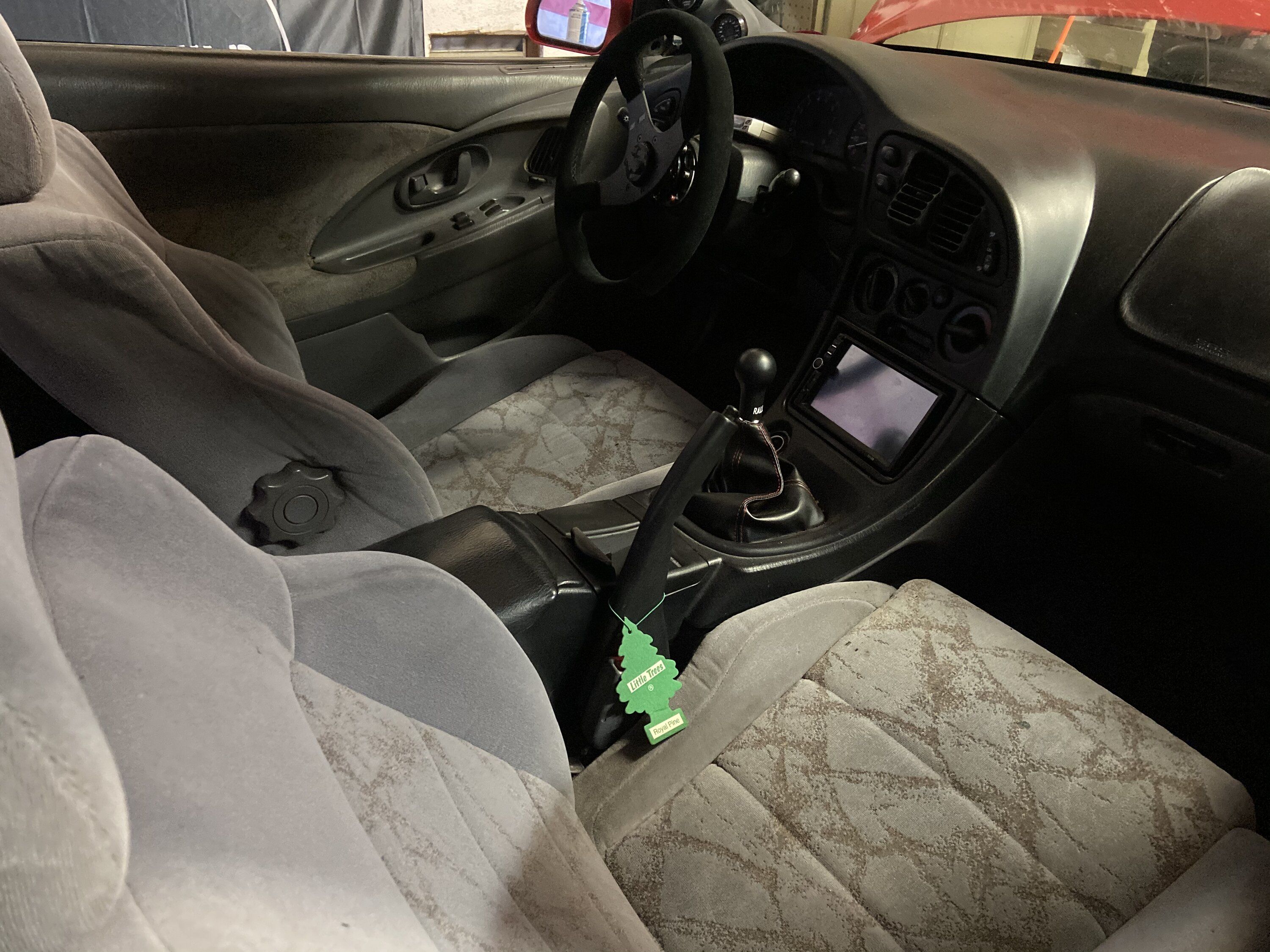

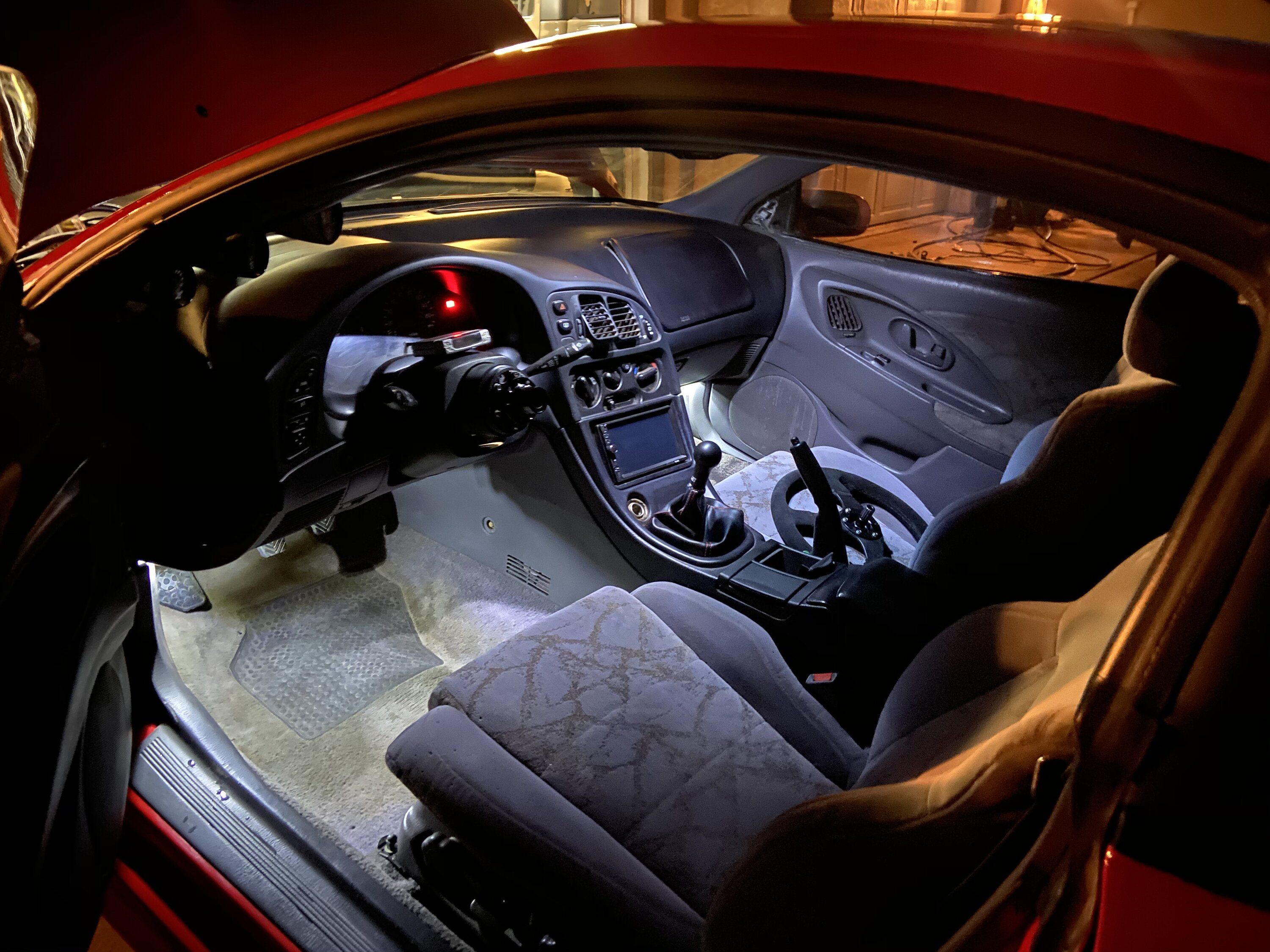

-cleaned the interior and fixed the passenger seat slider.

-added heat foil to the hood and charge pipes
- cut the headlight, wrapped the Carbonetics duct with “forged cf”

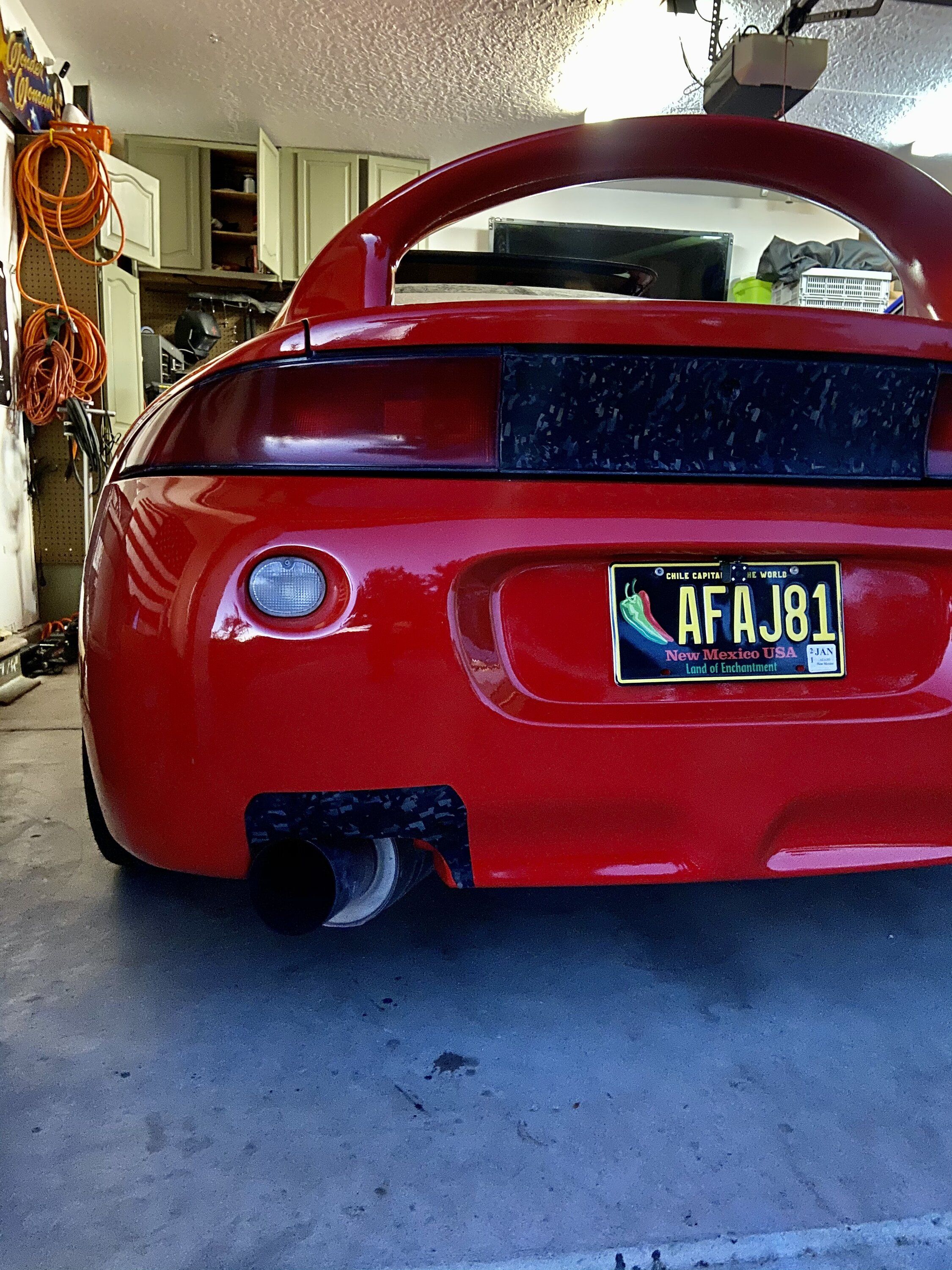

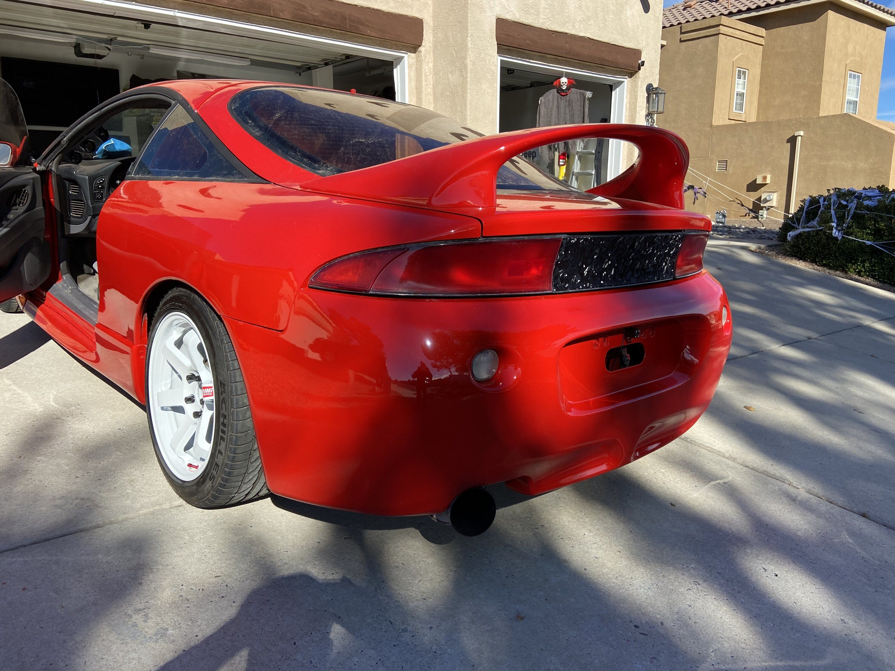

-wrapped the center tail light with the “forged cf”

-wrapped the bumper like an “exhaust gaurd”

-replaced interior bulbs with LEDs I had laying around
-reinstalled the radio after removing it to make better brackets
- squeezed the radiator overflow bottle into the factory charge pipe hole. It was already cut a bit. This will do till i relocate the battery to the trunk and have an overflow and a catch cans in its place.

AND my control arms will come in. Plan on installing them on WED as well as replacing an axle seal. I’ll adjust the ride height and get it aligned Thursday.
Got the axle seals, control arms installed last night.

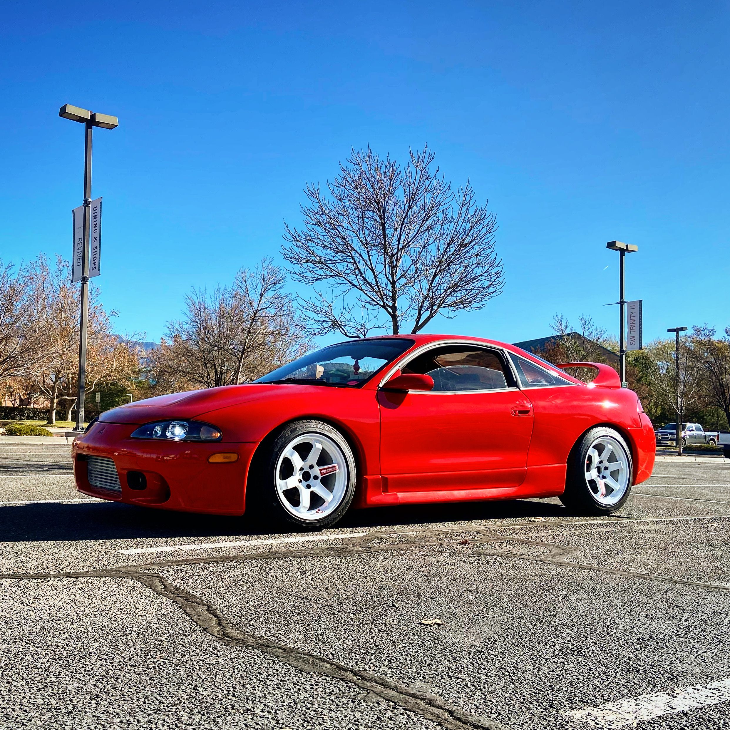

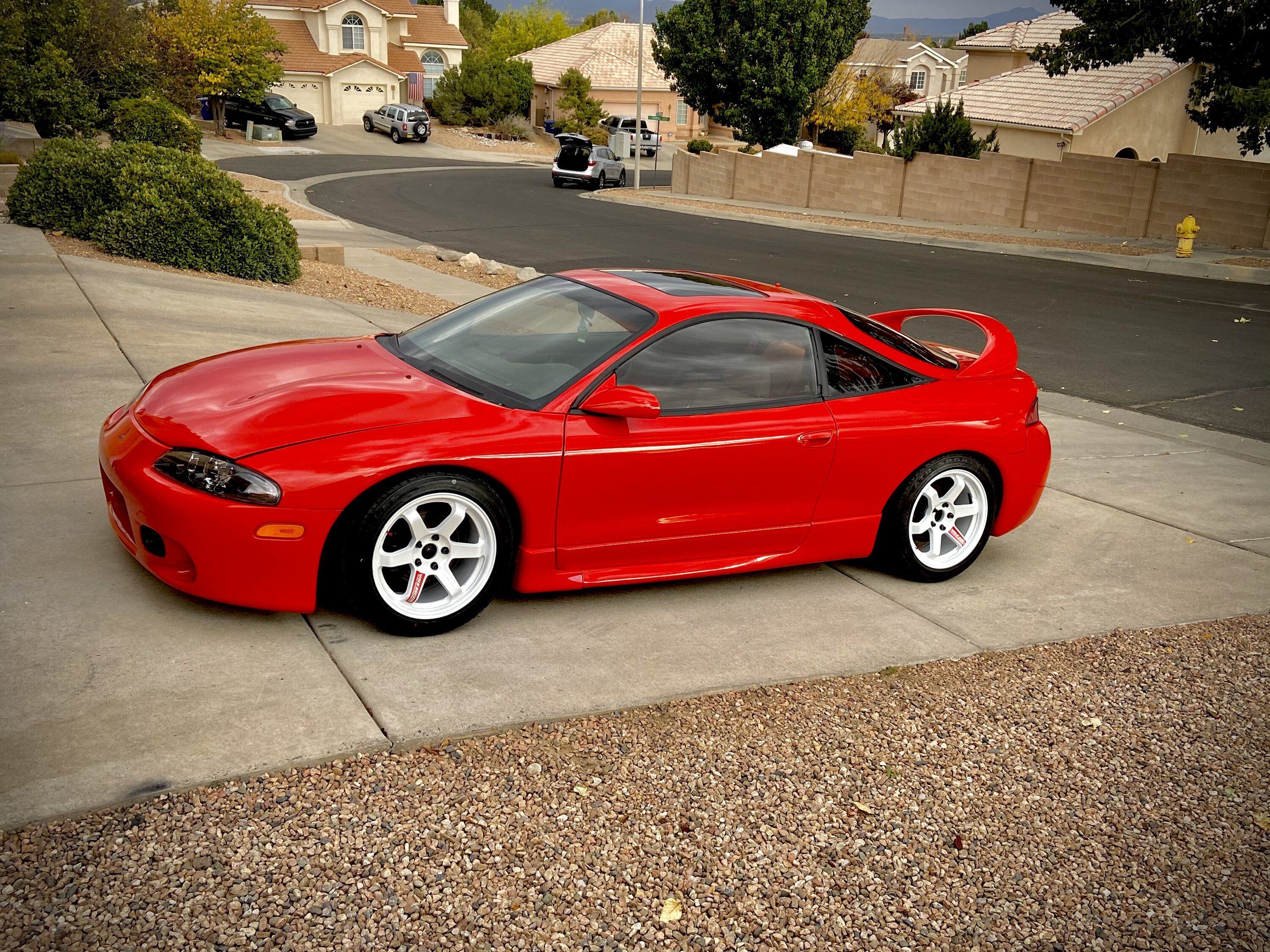

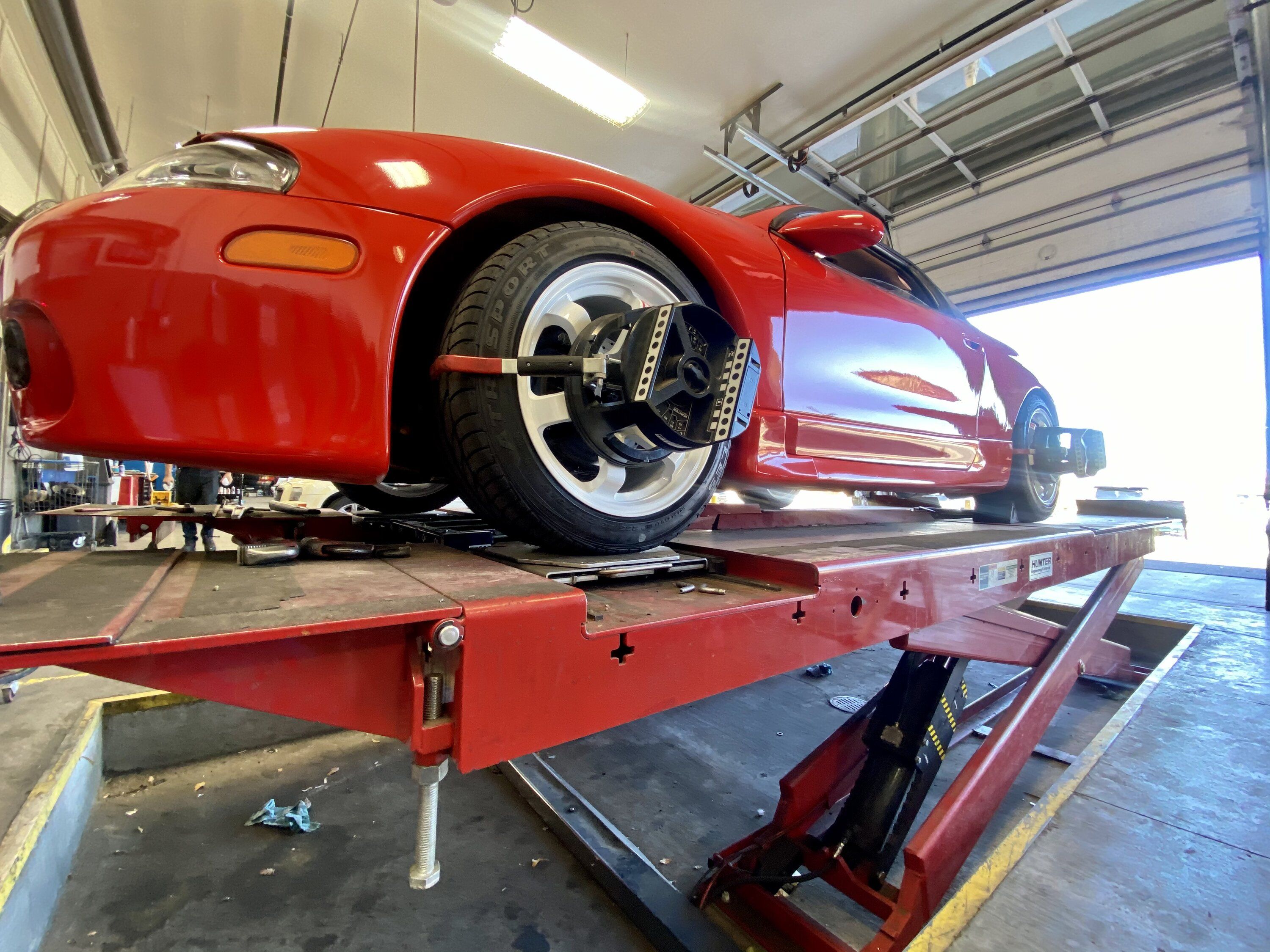

Drove it in for an alignment today. Rode much better with the suspension up a little bit. So I raised the front 1 inch and raised the rear .25. She’s more “level” now. I really liked the slammed look but I’ll roll the fenders before I try that again
Tomorrow I’ll install the battery tray/tie down. And give her a little spray wax for Saturday mornings first Cars+Coffee. Less than a year ago she was still an incomplete shell and engine was on a stand!
Didn’t get a chance to install the battery tray om Friday or today.

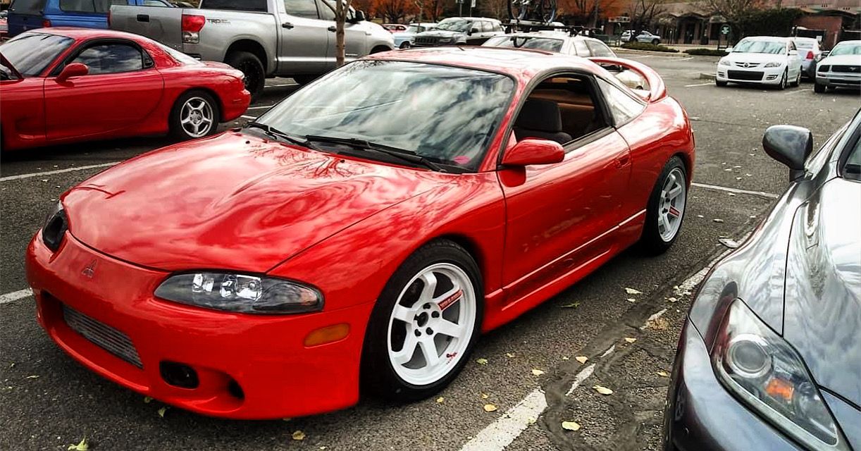

But I did make it to Cars and coffee. I didn’t get a chance to take pics. Our group included a Viper, ISF, Blown Coyote Mustang, Chevelle 383. An MR2 turbo was missing (last minute complications).
the car was pretty well received. Lots of people said the same thing, “ you don’t see clean 2gs anymore!”.

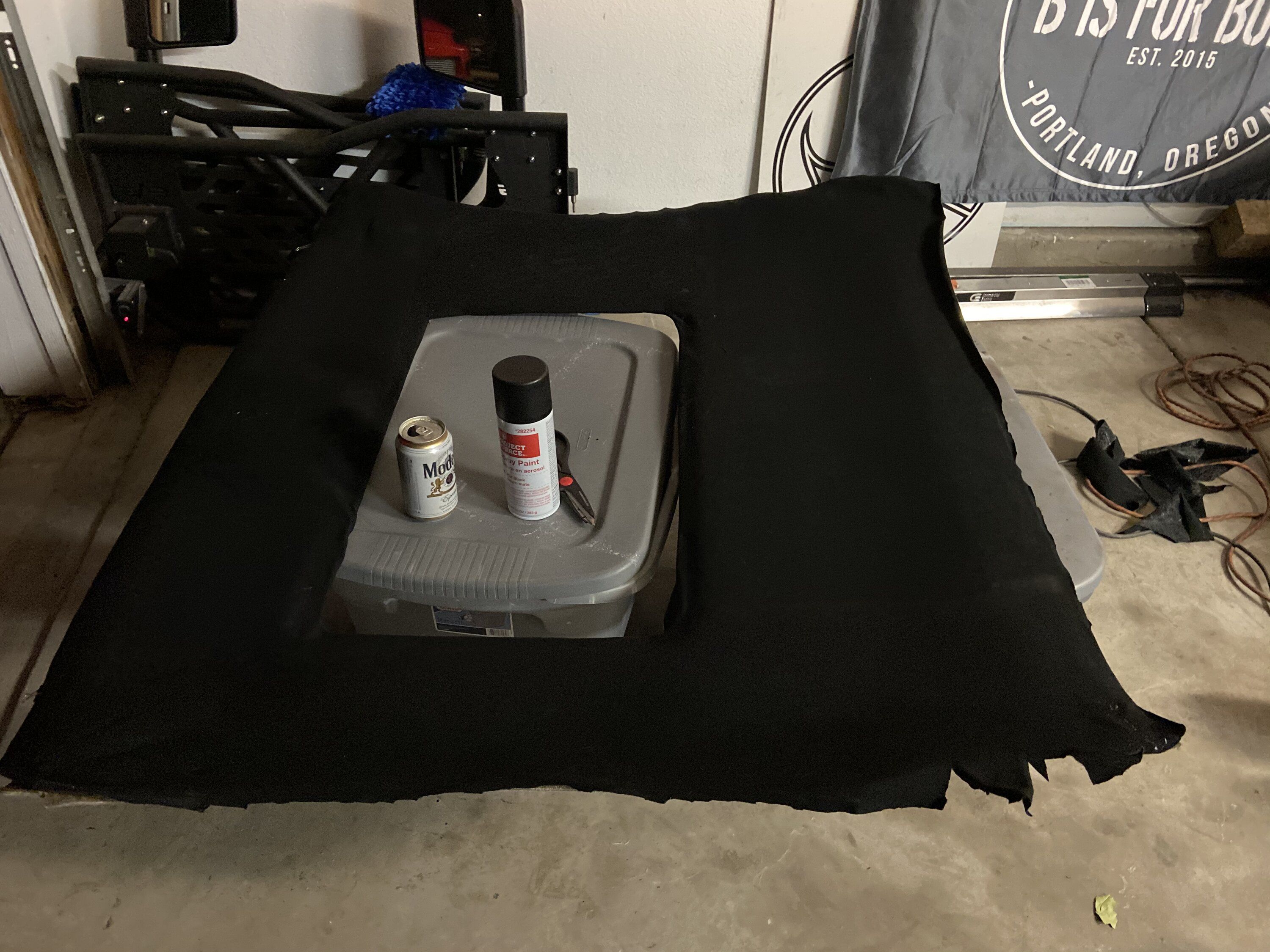

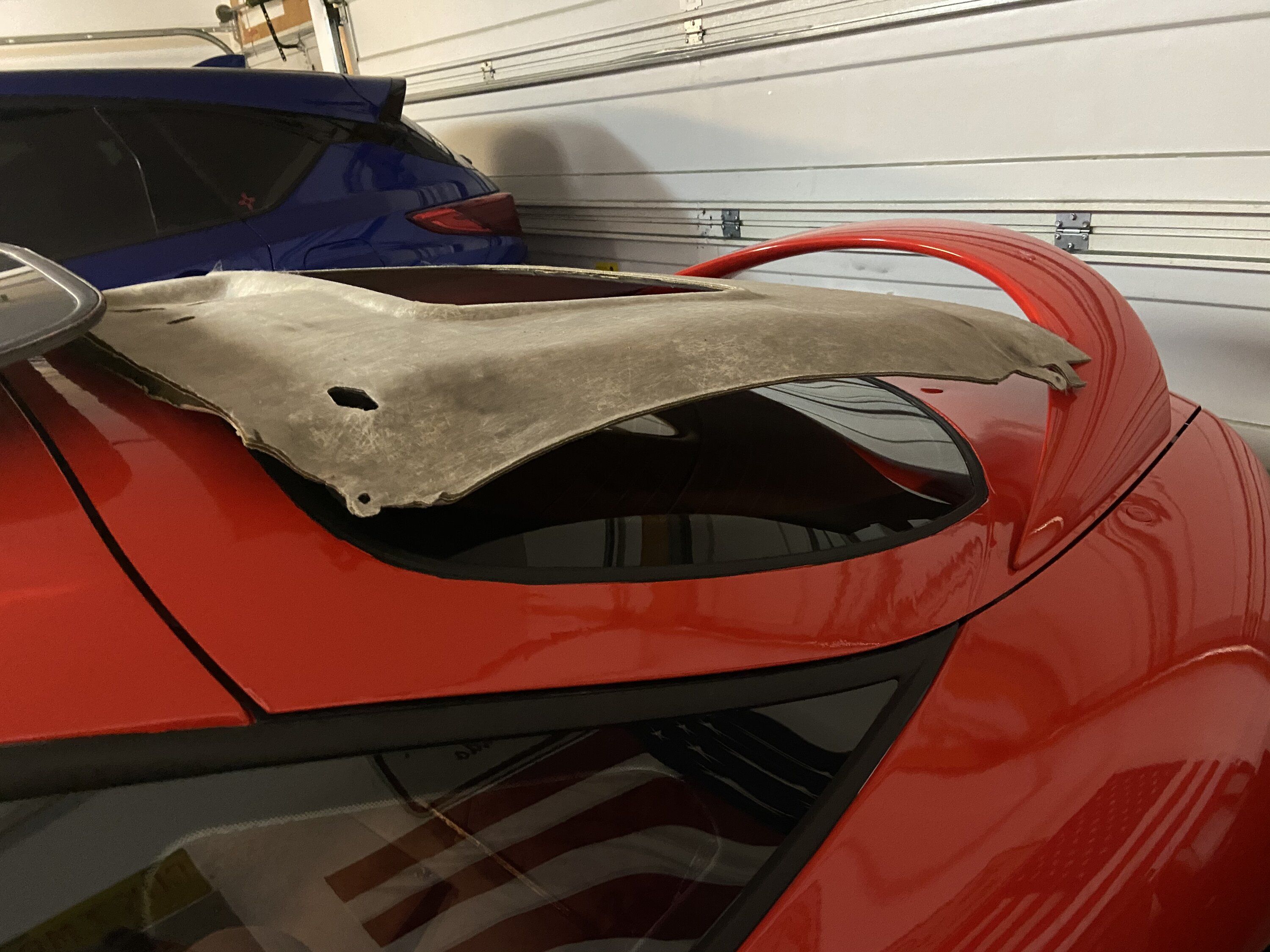

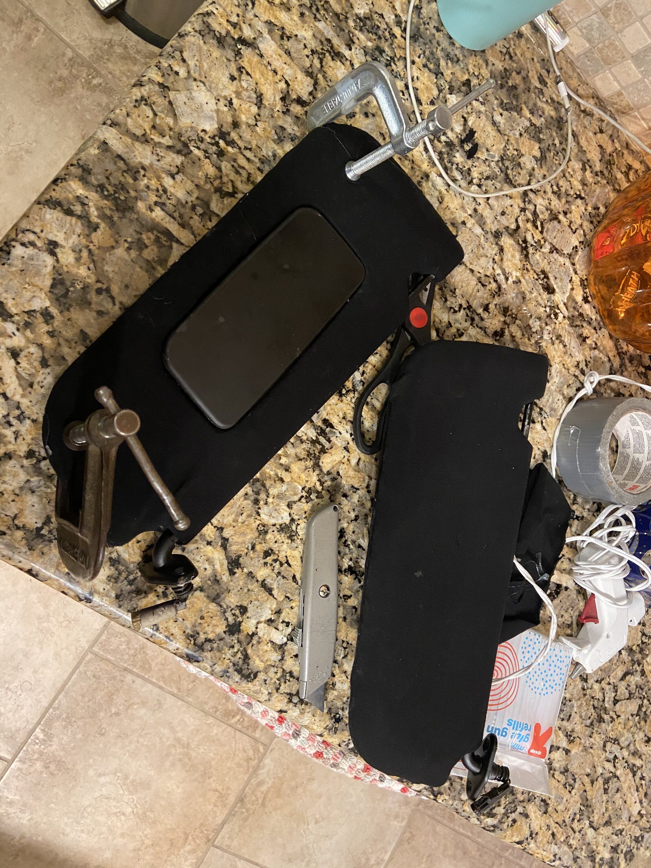

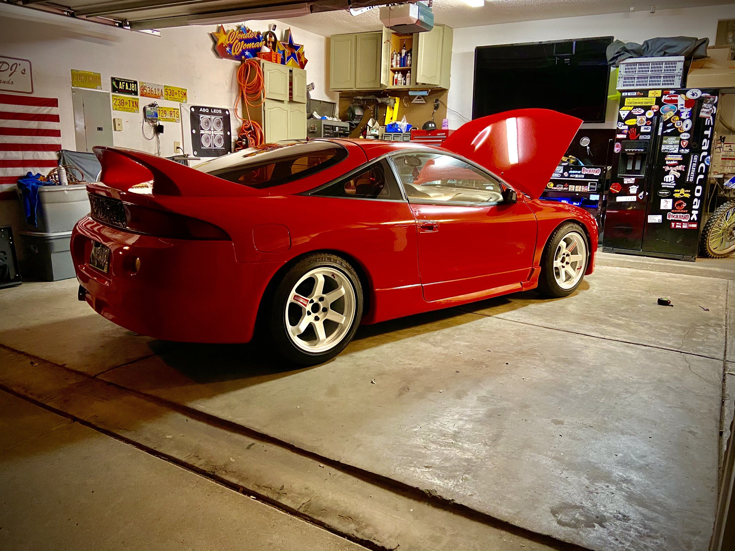

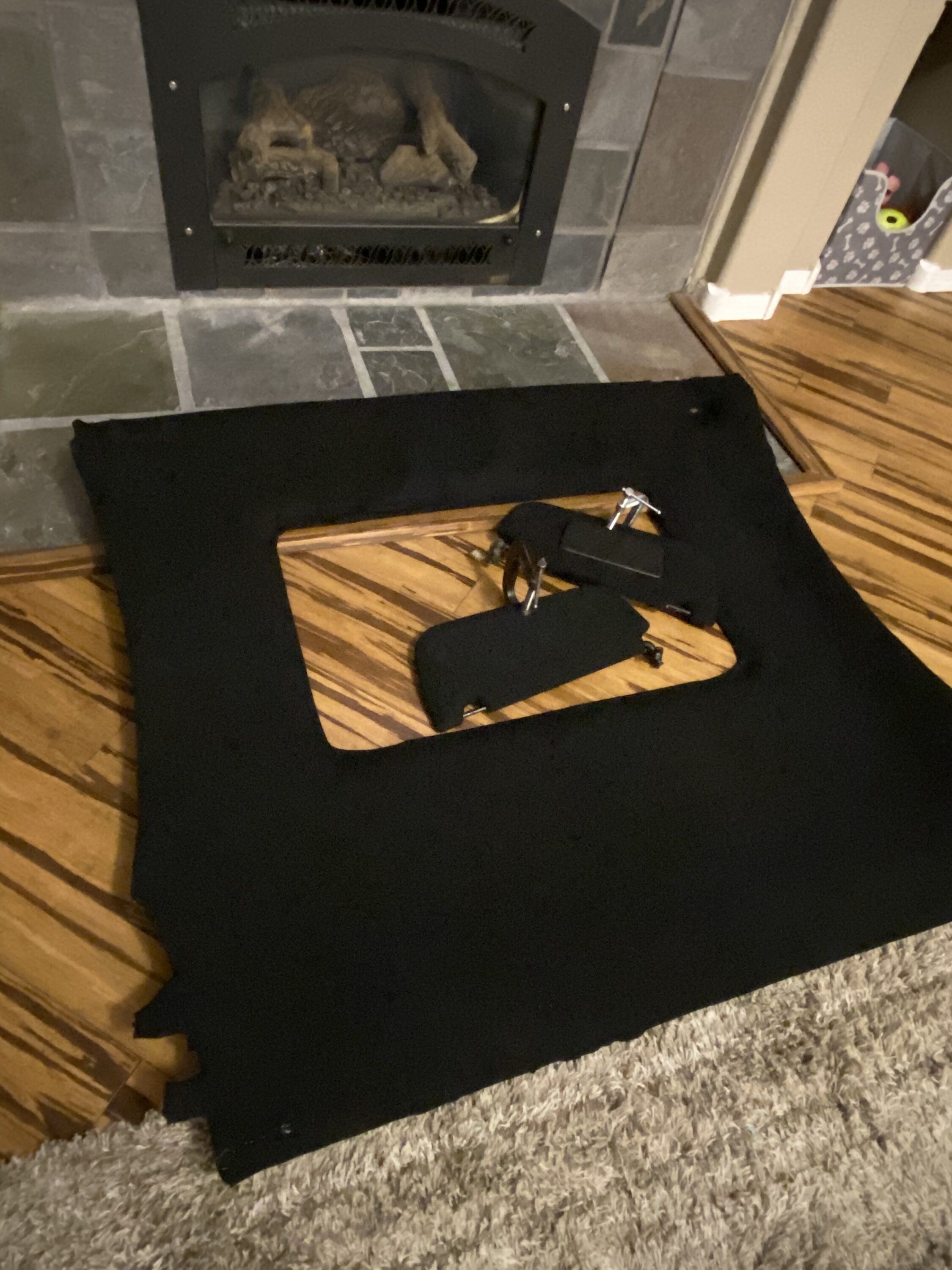

Headliner was torn and sagging. Idk if the plastic trims were tan or just that faded. I touched those up in black and wrapped the visors and headliner in a almost t shirt like material. Whole thing was under $30 and I makes a huge difference!
Went to another Cars and Coffee. This time I had my bud with the ISF give me a run. He was pulling on me, but not as bad as I thought he would!
my next goal is weight savings. I’m going to remove the backseat, do a proper delete with carpet. Side dump will help eliminate about 60lbs. If I can get it around 2600lbs I’ll be tickled pink. already has no ac, no cruise, no abs, no rear wiper, no antenna, smaller battery/tray, aftermarket steering wheel ... lots of other things. But I’m guessing maybe 2800lbs? Ditching the rear seat + passenger airbag and exhaust should be really close to 100lbs.
