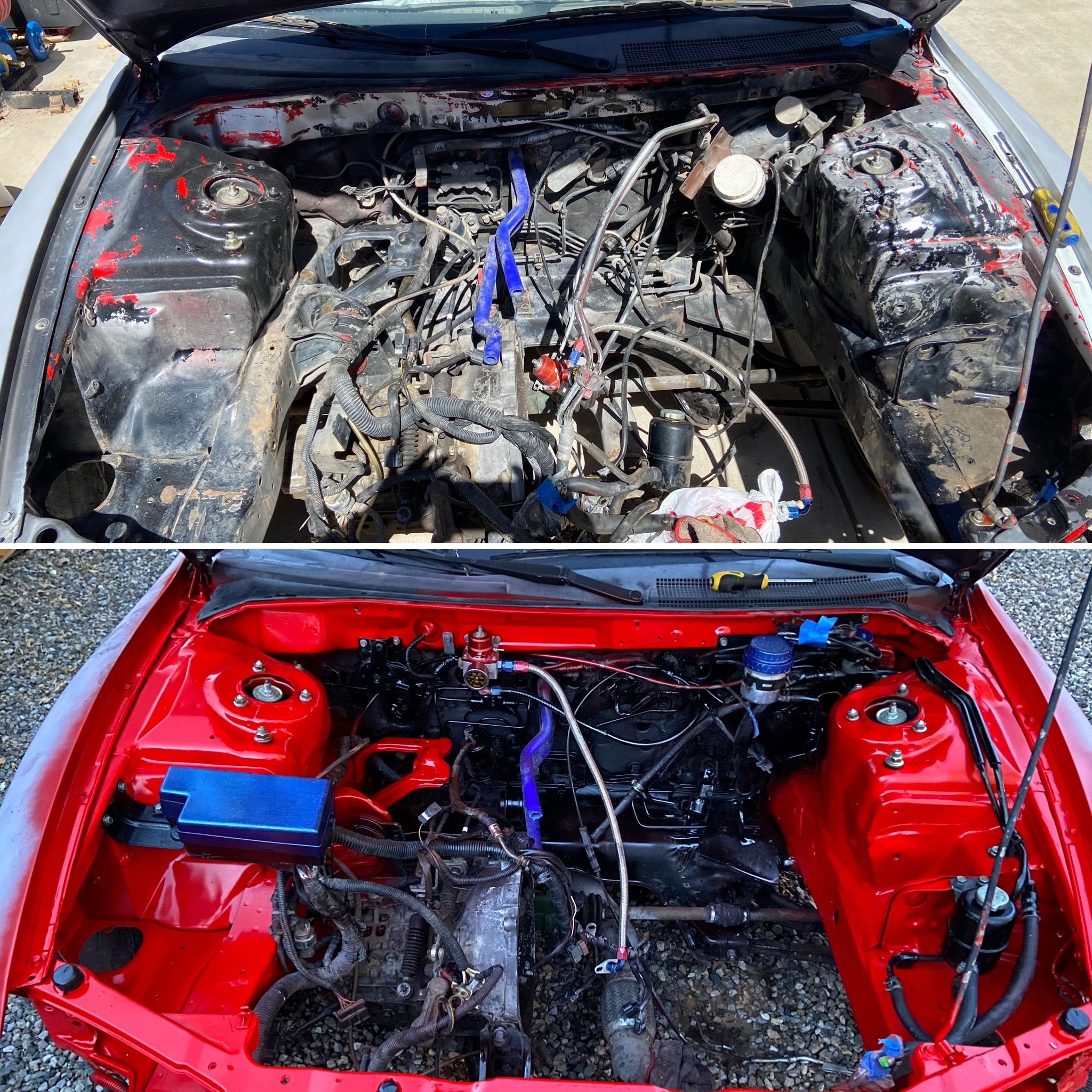

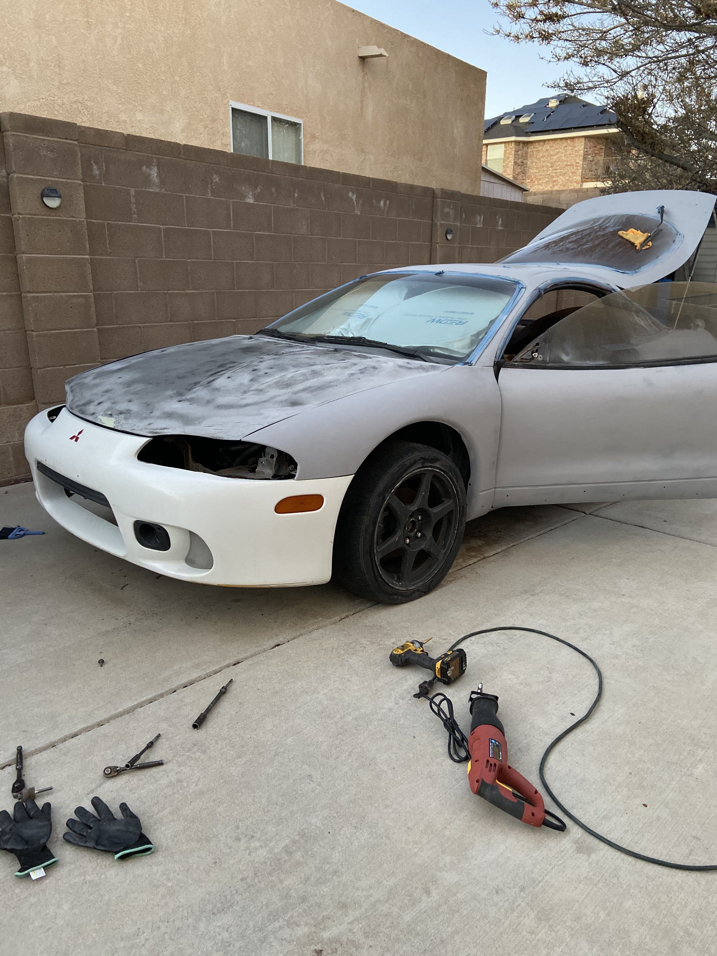

98 GST rescue
98 GST shell/rebuilt engine core. Under reconstruction... rebuild 99% complete

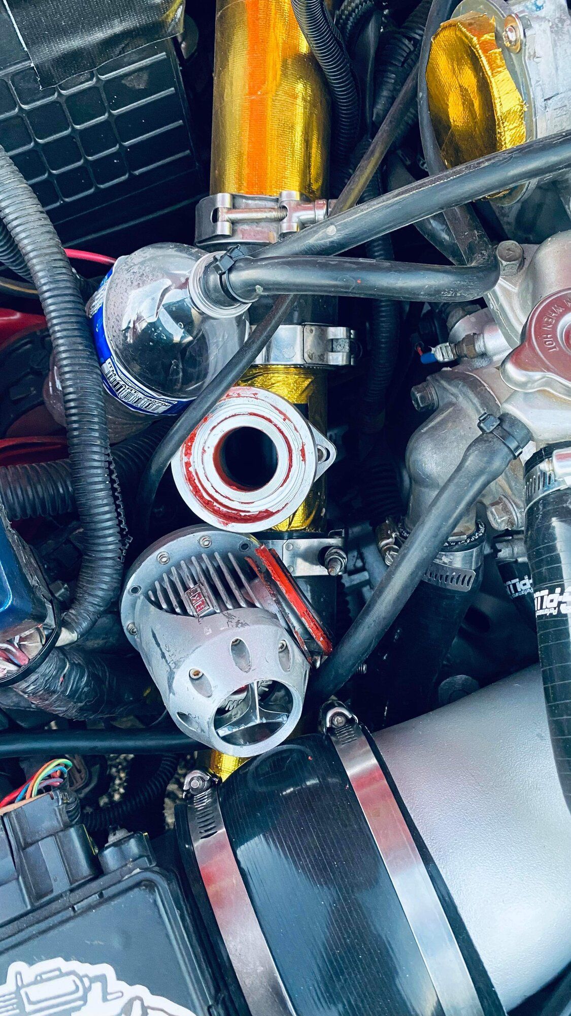

BOV Popped off during tune.

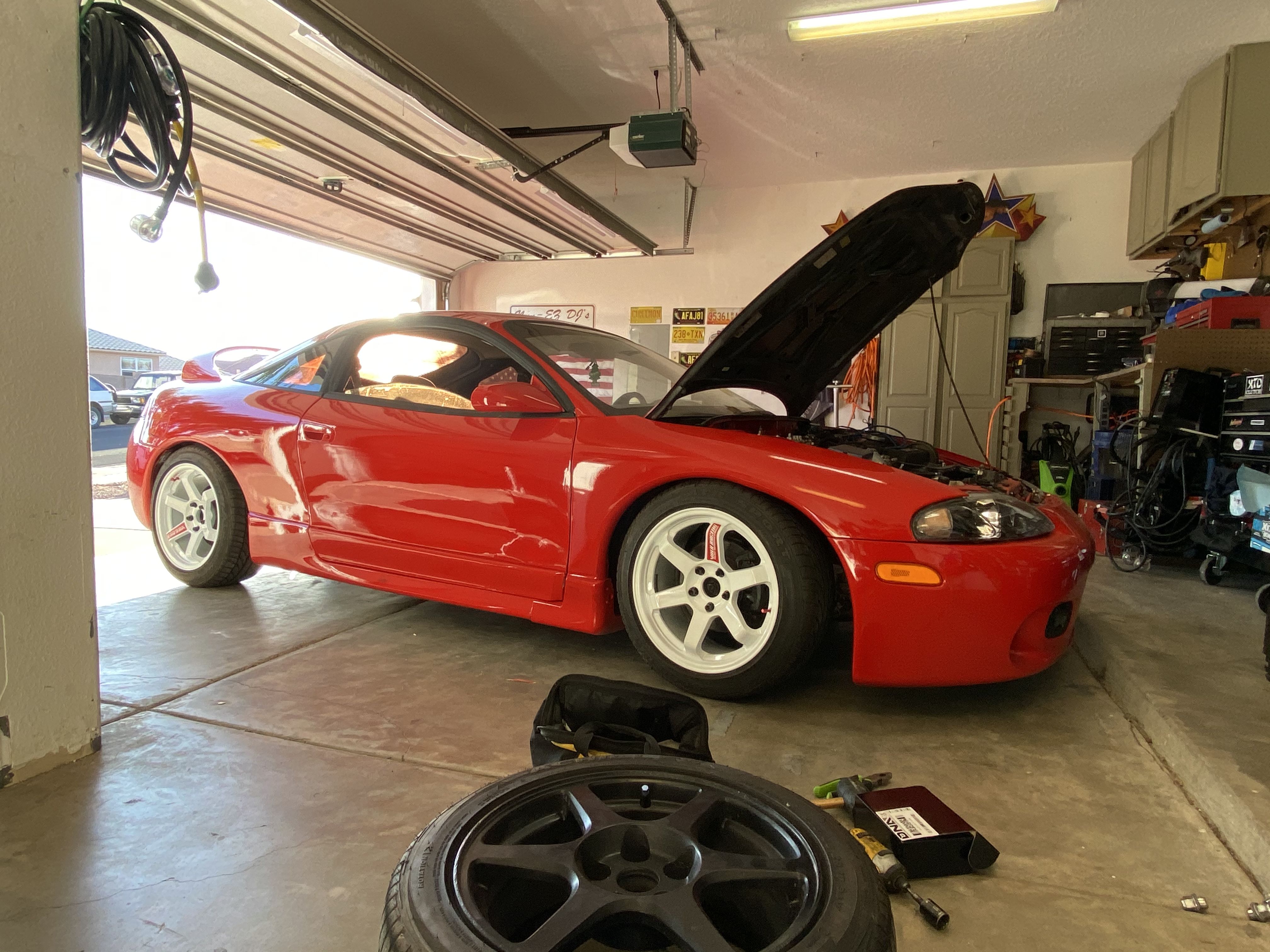

Before I stopped driving it a few weeks back, I tried adjusting the clutch pedal. Clutch seems to be not fully engaging on the high rpm’s. I tried replacing the clutch slave. And bleeding it throughly as well as adjusting again. Can’t seem to narrow the issue.
my problem now is car is running great with the tune… I need to make sure the power makes it to the ground.
E dyno was off the charts on evoscan due to tires and clutch slipping. I would guess 375-400 @ 20psi

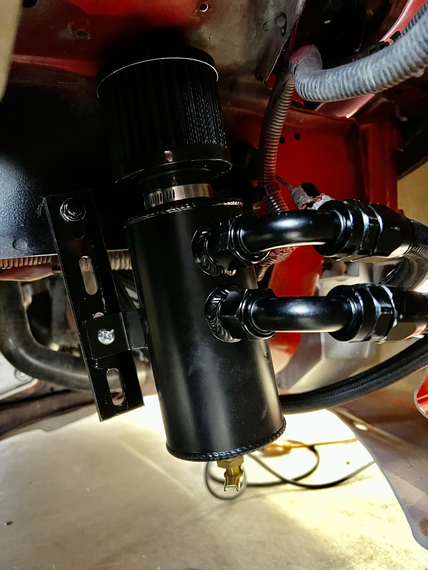

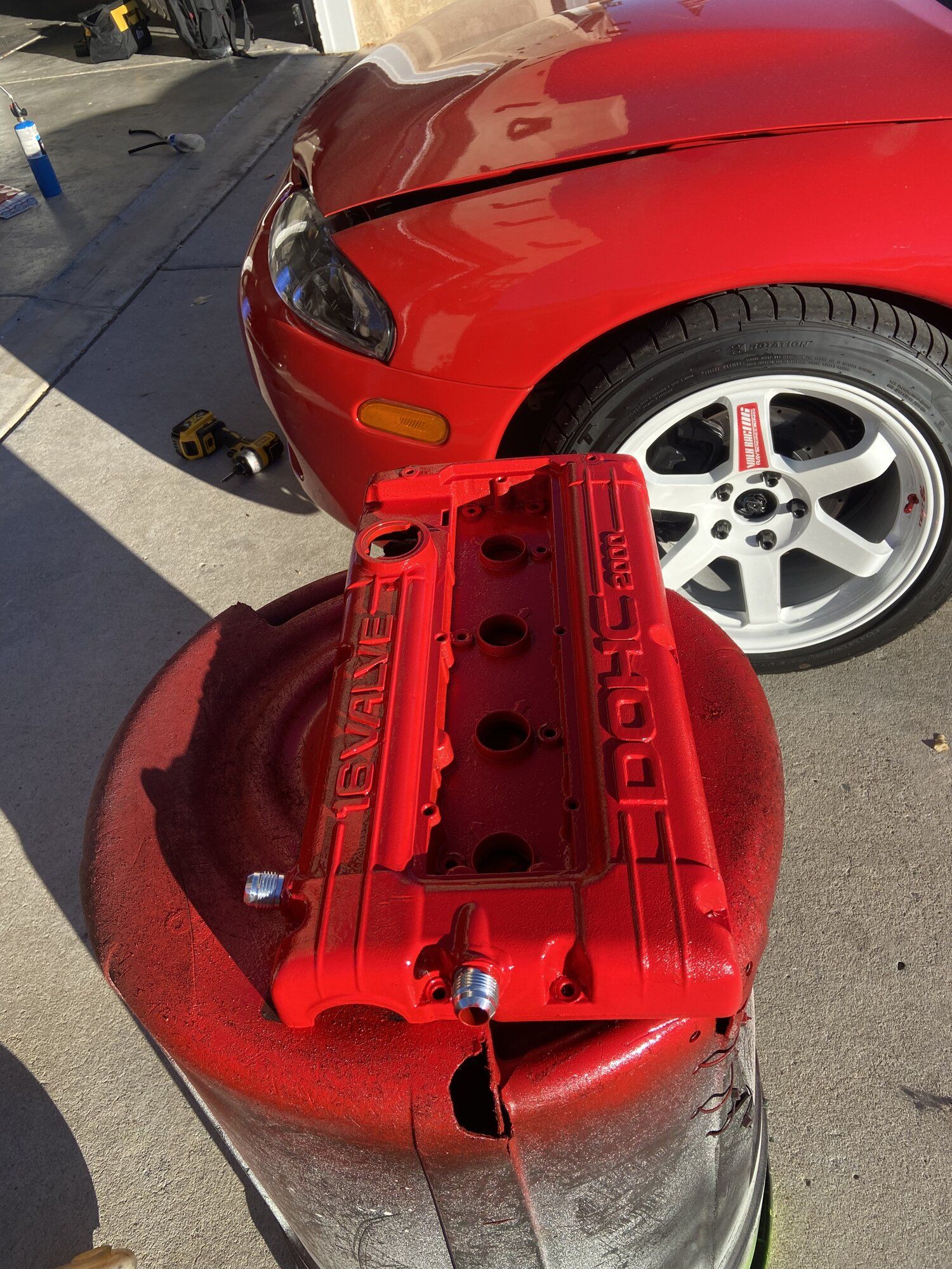

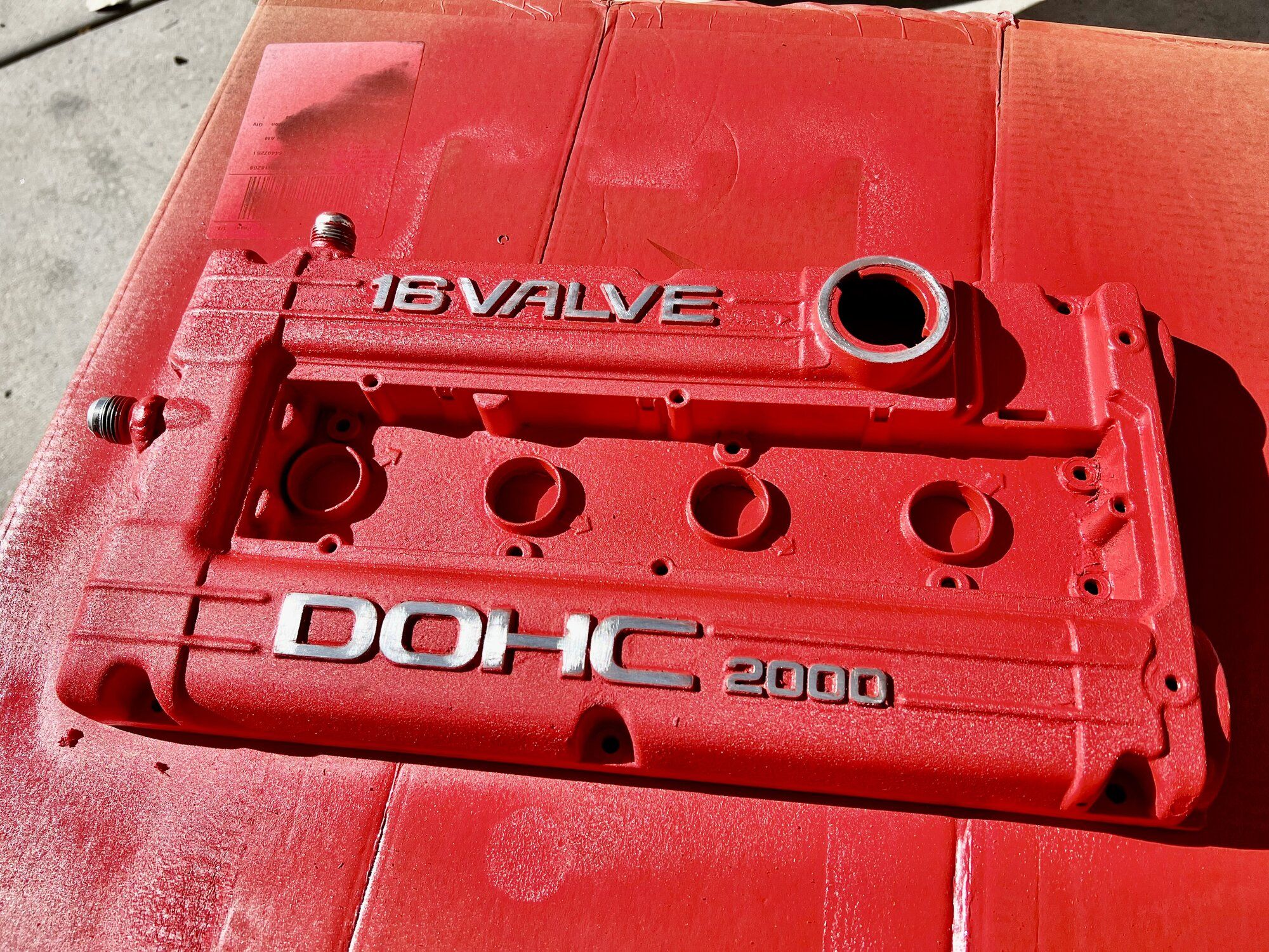

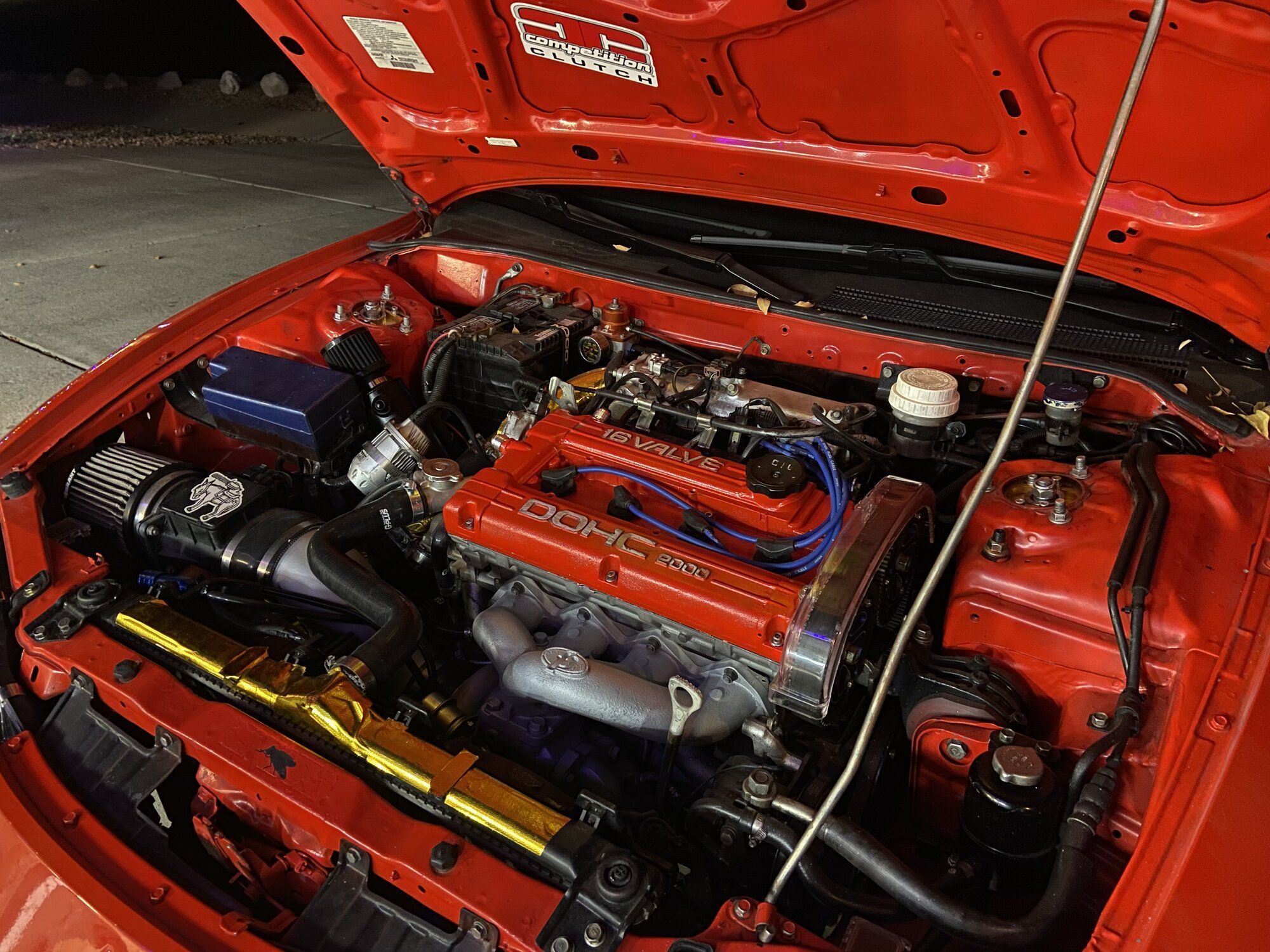

Got roasted for my water bottle catch can LOL. I’m planning on using the aluminum brazing rods to attach the bungs to the VC. Can’t decide between gloss red or wrinkle red or… wrinkle blue. Probably wrinkle or gloss red. I almost* want to shave it flat too so it doesn’t say 16 valve DOHC… thoughts?

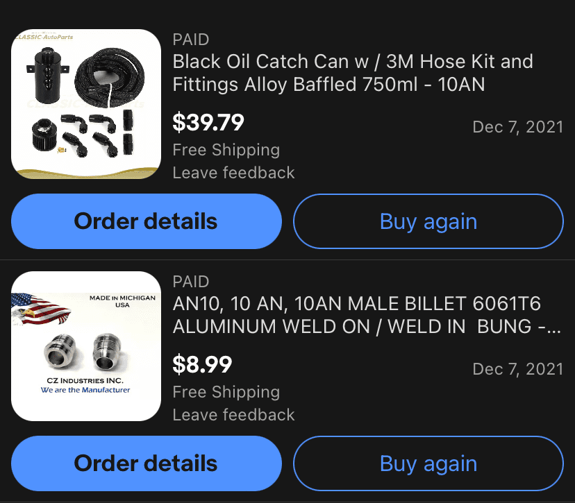

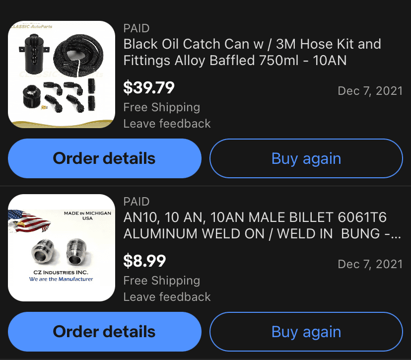

Seller on EBay flaked on me for the can. Ordered the exact same one from Amazon. The delay will stop me from knocking ir out this weekend. If the bungs get here I may start it I’ll probably pull the valve cover and cut and paint it.
ill be playing with the clutch this weekend for sure

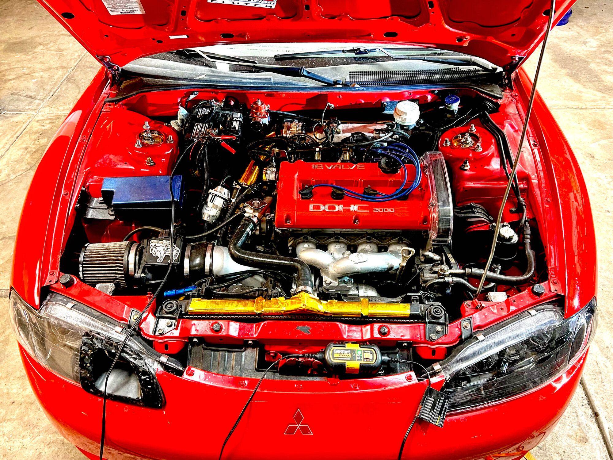

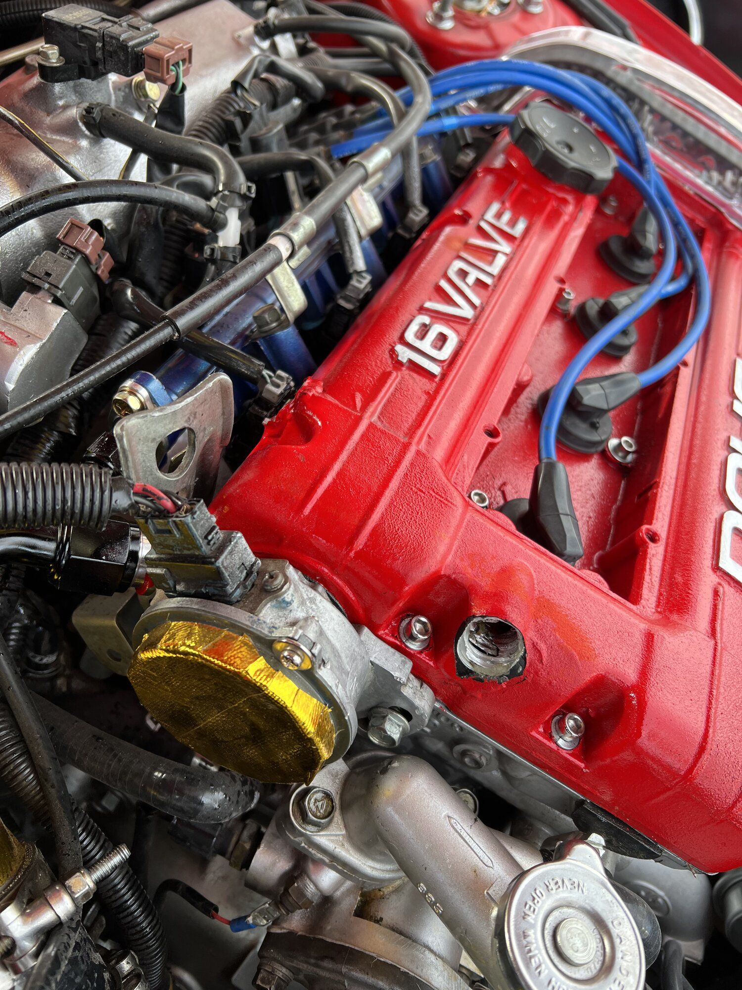

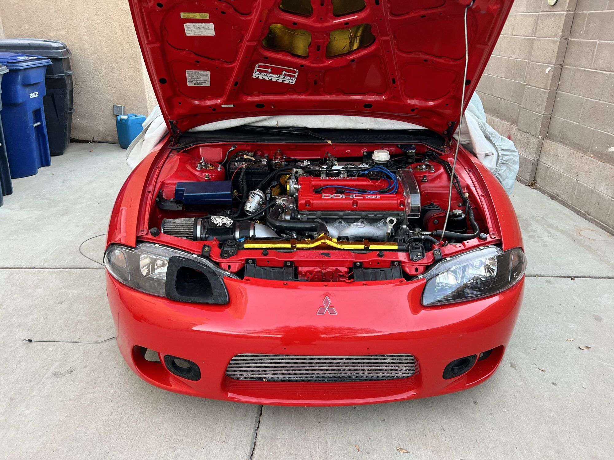

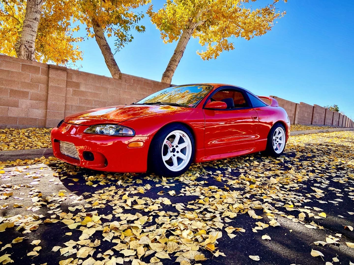

Well it’s starting to look like I had hoped it would.

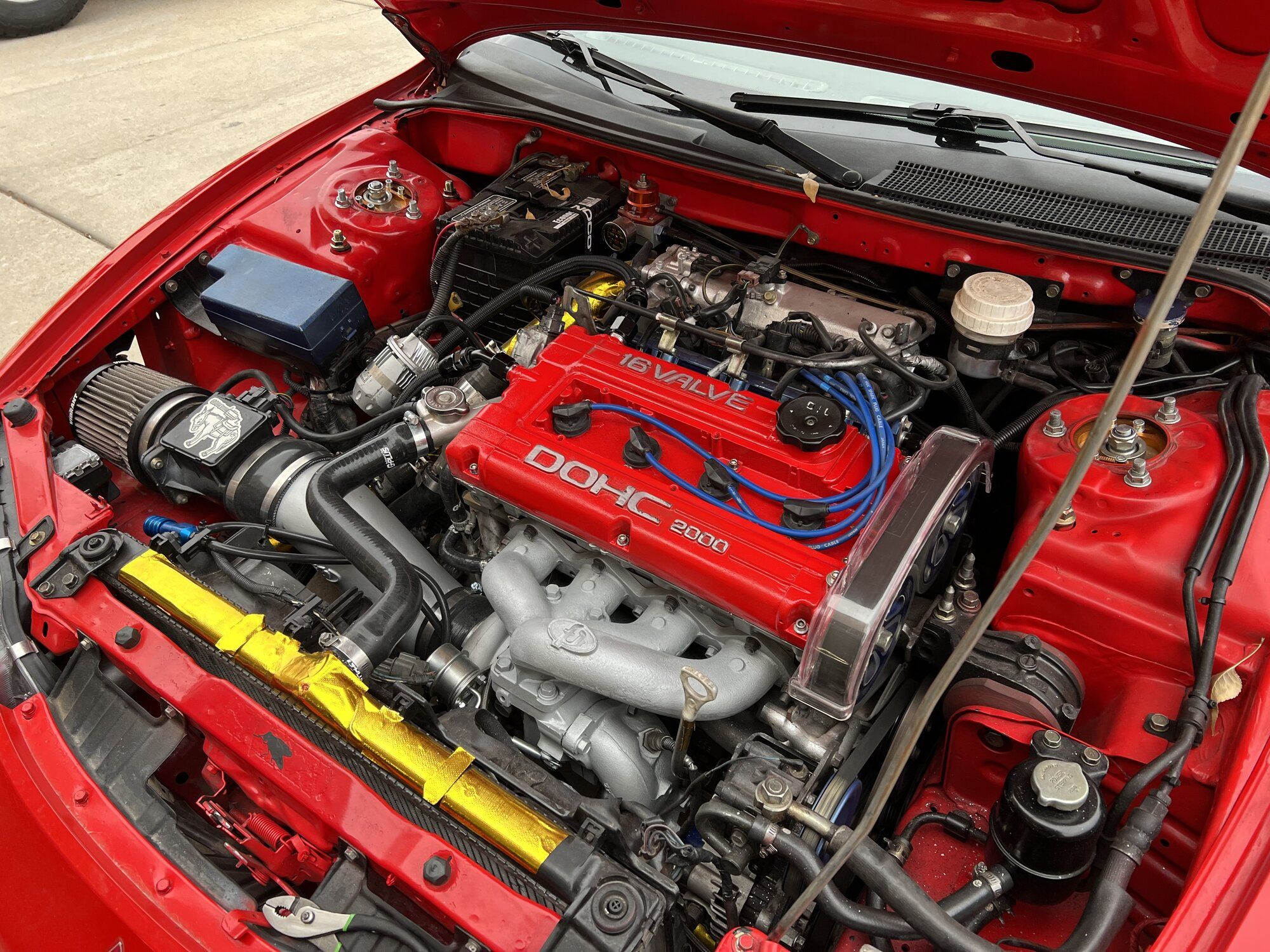

I went with gloss red over wrinkle (matte) red. There’s still texture from the wrinkle black underneath. It’s fine. I trimmed the cam gear cover (adjustment bolts from the AEM gears were rubbing), i think it looks kinda cool.

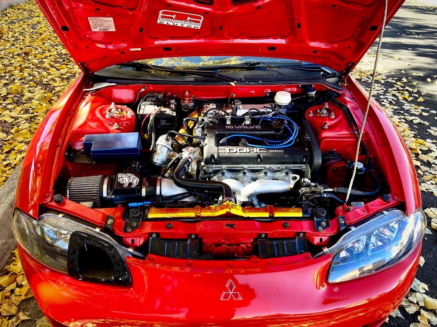

The 10an braided nylon lines still need to be made. I can’t fit the catch can anywhere. It’s too tall! It may end up right where it’s at in the picture.
I need to bleed/adjust the clutch. I wanted it to be cleaned up a bit. It’s killing me to see it out of the garage- even under a cover.
Oh… and the water pipe is hissing… turbo may need to come out for a patch job. It’s the hard pipe coming from the pump to the t stat housing. Took finesse to fit the turbo. It either cracked or rubbed through. It’s probably rubbed a Pin hole through
hey man clean car! if you do the relocation for the battery to the trunk, you should be able to fit the catch can where the battery used to be! and it would be alittle cleaner!

Welp, the epoxy didn’t hold.
Took it to cars and coffee today, ran great. Still shifting funny. But otherwise is golden.
Going to have to get the VC welded. The bungs aren’t long enough to really wedge in and be held. $80 is what I was quoted. Seems steep. But I’ll price around. I have the time to wait. I’m in no hurry.
