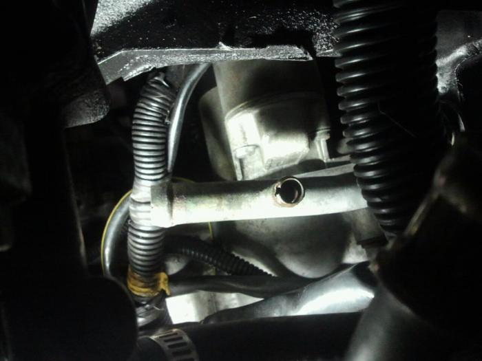

Now I discovered a coolant leak from the Heater Core hose. :ohdamn:
Located my leak. Won't seal due to it. Hrm..how to address, how to address.
I thought about JB weld or quicksteeling around it and then sanding it down, but the thought of something breaking off and clogging my cooling system has me scared.
