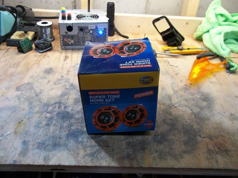

Got a great deal on some Hella Super Tones (so great that I bought a set for the Fiesta too).

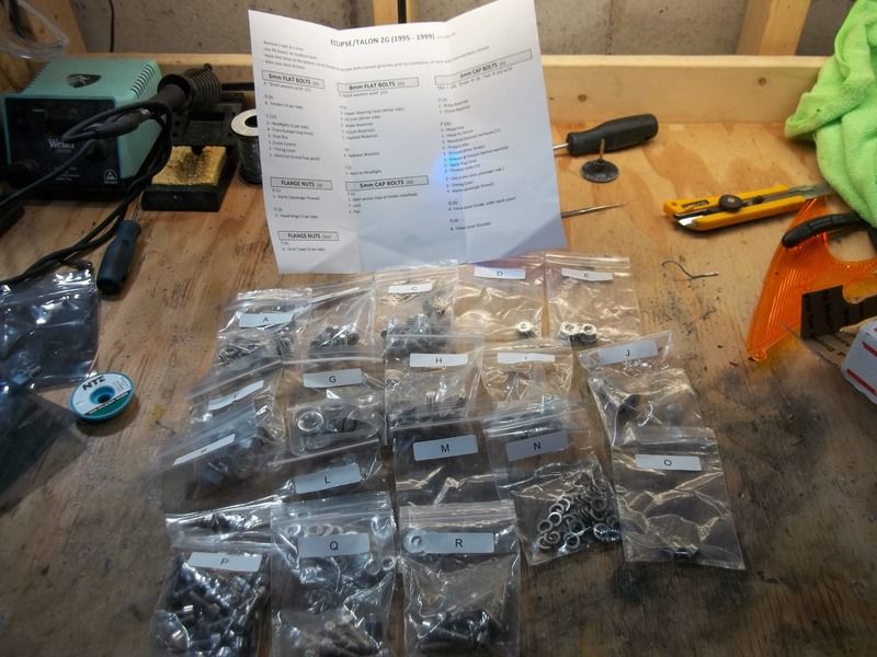

Also bought all SS hardware from a seller on eBay, no more rusted bolts in the engine bay, yay!

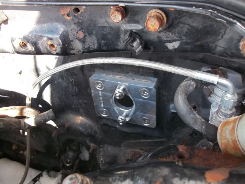

Installed my booster delete plate.

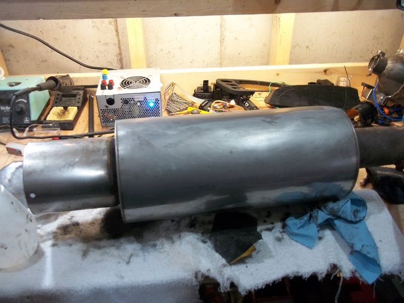

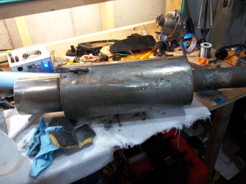

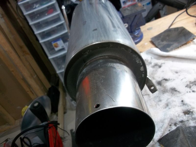

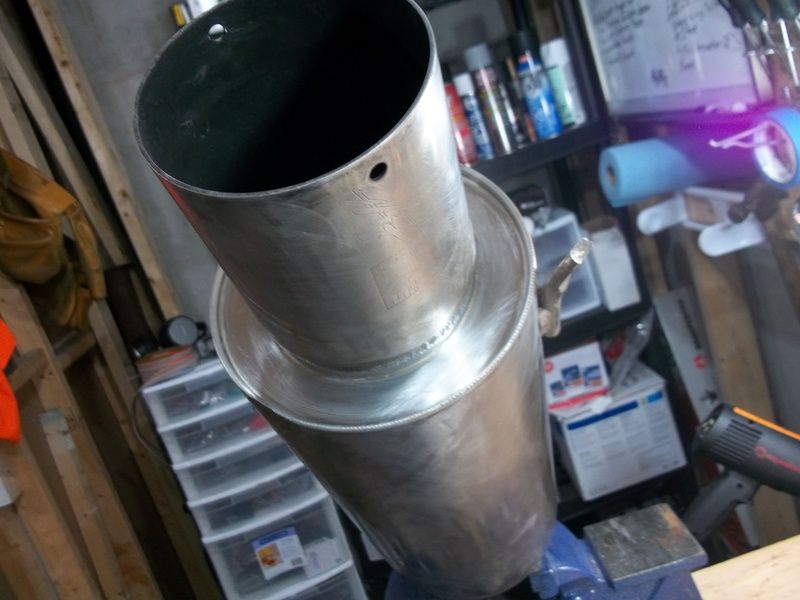

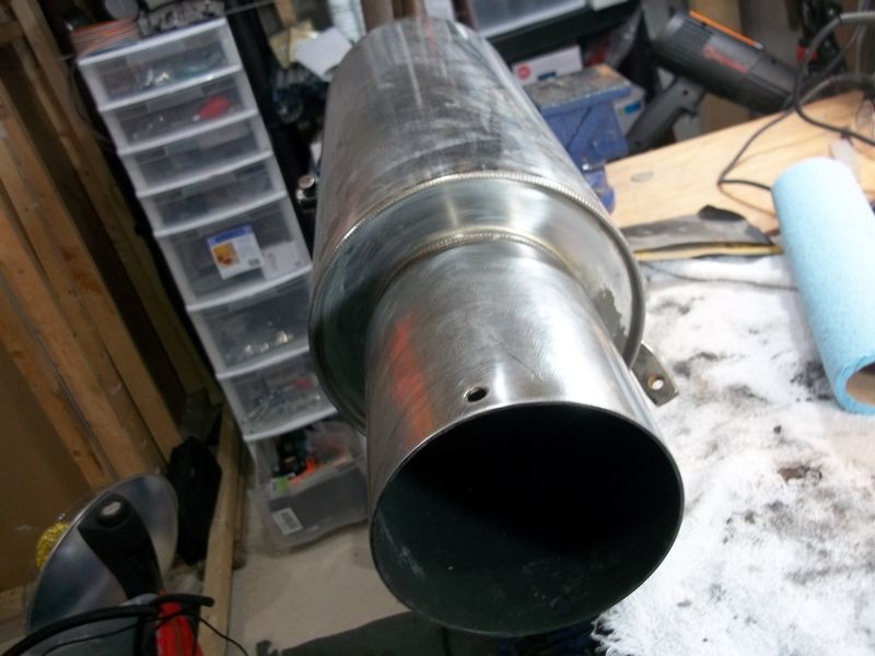

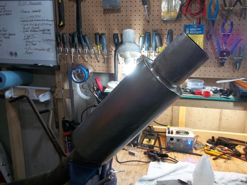

Finally, started cleaning up my HKS Hi Power Cat back so I can install it. This thing looked horrible but it's coming along nicely now, need to finish polishing it.
Starting to wet sand it.
All the dirt and oxidation off.
More dirt and nastiness.
Cleaned up.
Its come a long way but I've got more wet sanding to do and then I need to polish it.

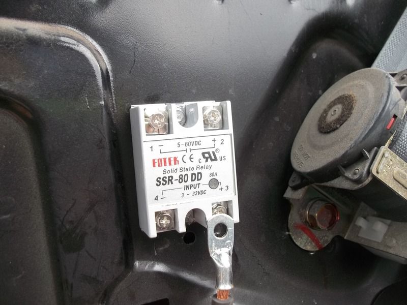

First I mounted up my SRR that feeds the Fuel pump rewire. This is mounted behind the rear interior panels. I might actually move some of my EHPS stuff here too.
I need to shave down the wiring stud to fit into the SRR.

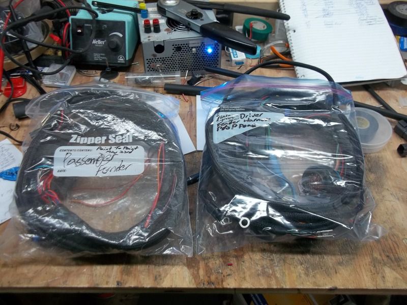

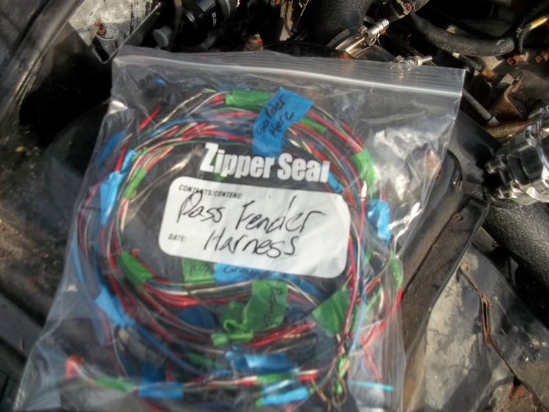

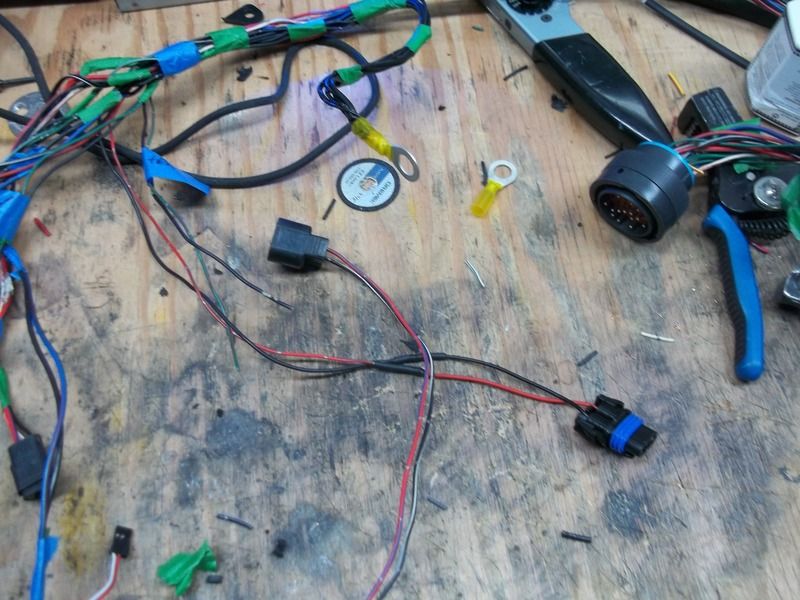

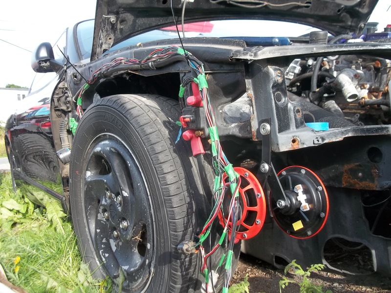

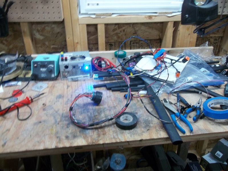

Back into the passenger side fender harness, to finalize the lengths for the reverse light switch, Boost control solenoid and a couple other things.
Bagged up and ready to be soldered or have connectors crimped on.

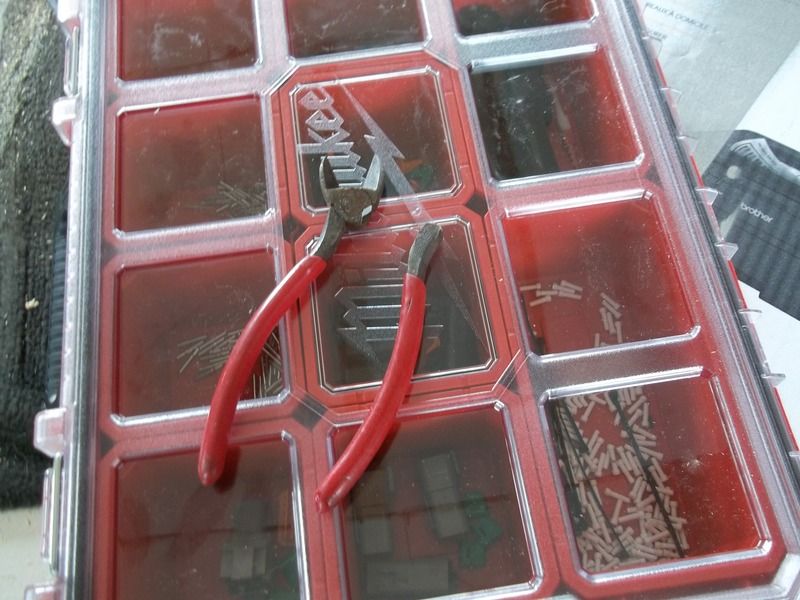

Some where around here I managed to break a set of dykes that my old man has had forever, oops.

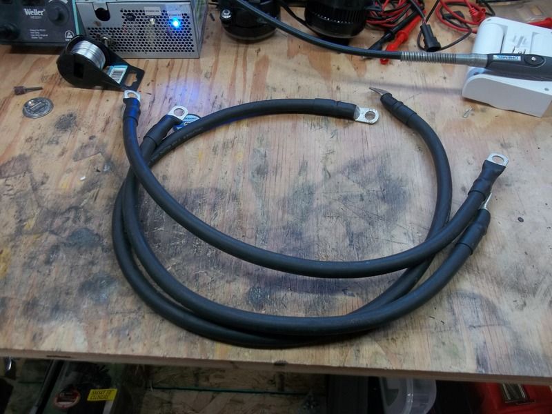

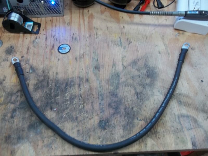

Finished up my ground cables.
And my starter cable (firewall to starter itself).

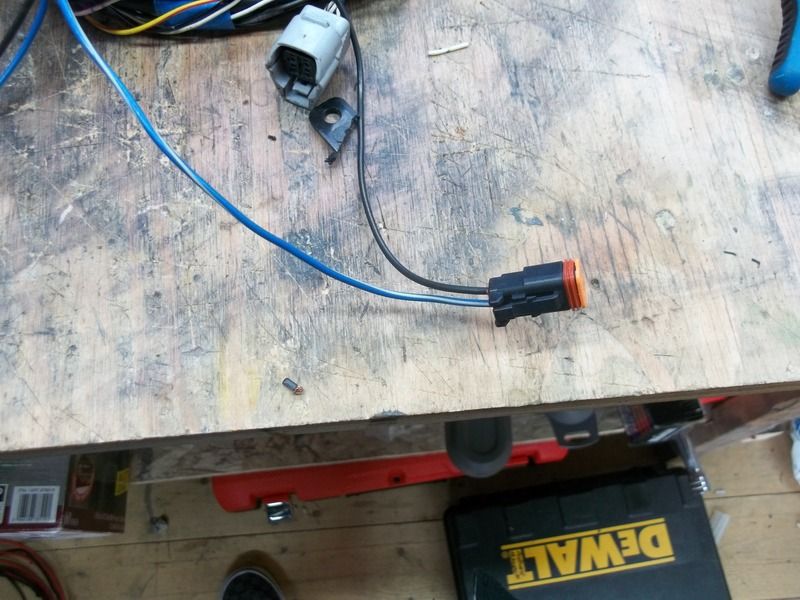

Soldered (or crimped) connectors on to both passenger and driver side harness; fog light, EHPS pump, fan, etc.
Reverse and fog light on the passenger side.

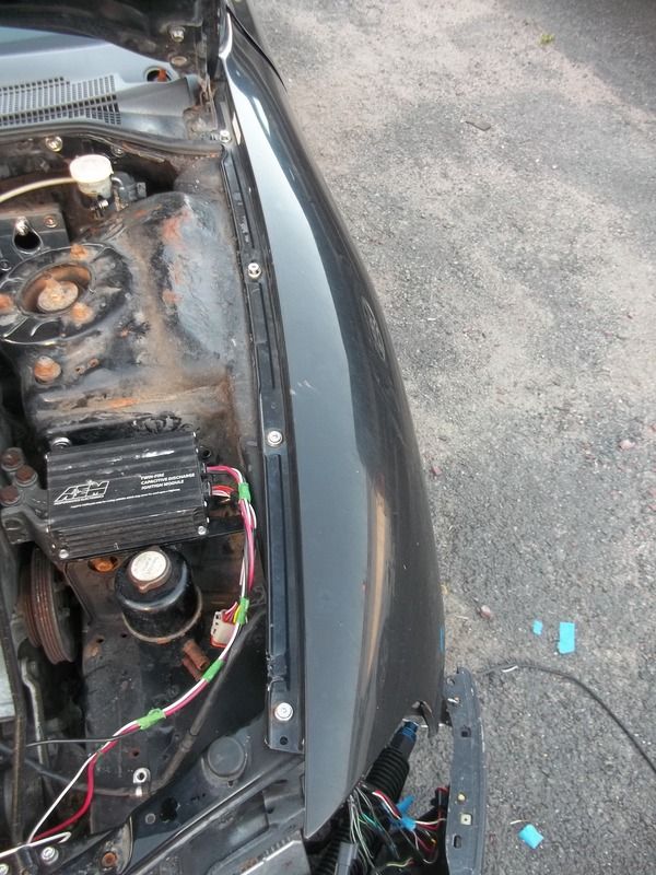

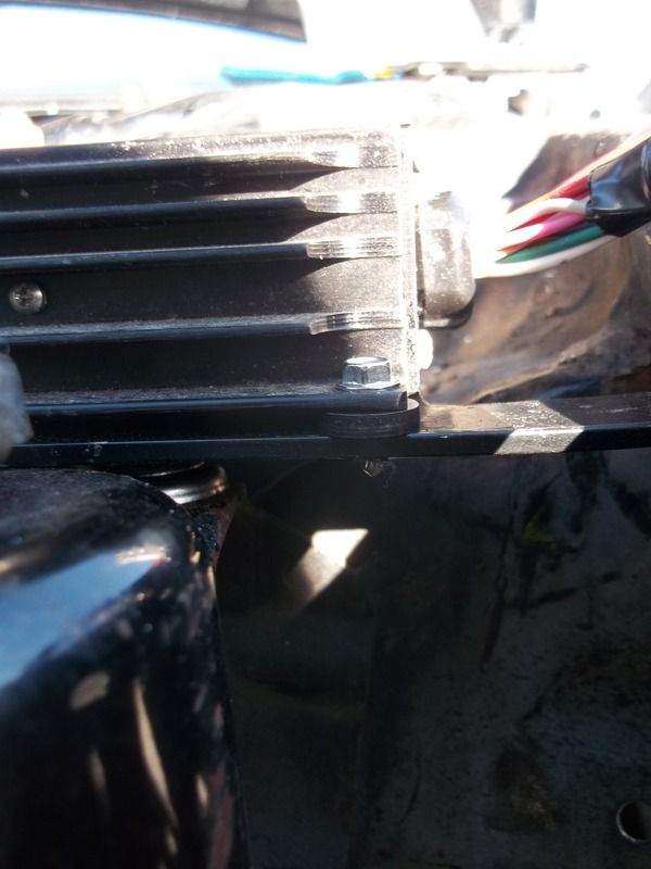

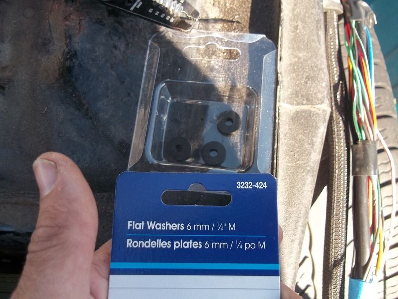

AEM COP mount that I had welded up.
Used some faucet washers to give a bit of a spacer for some isolation.

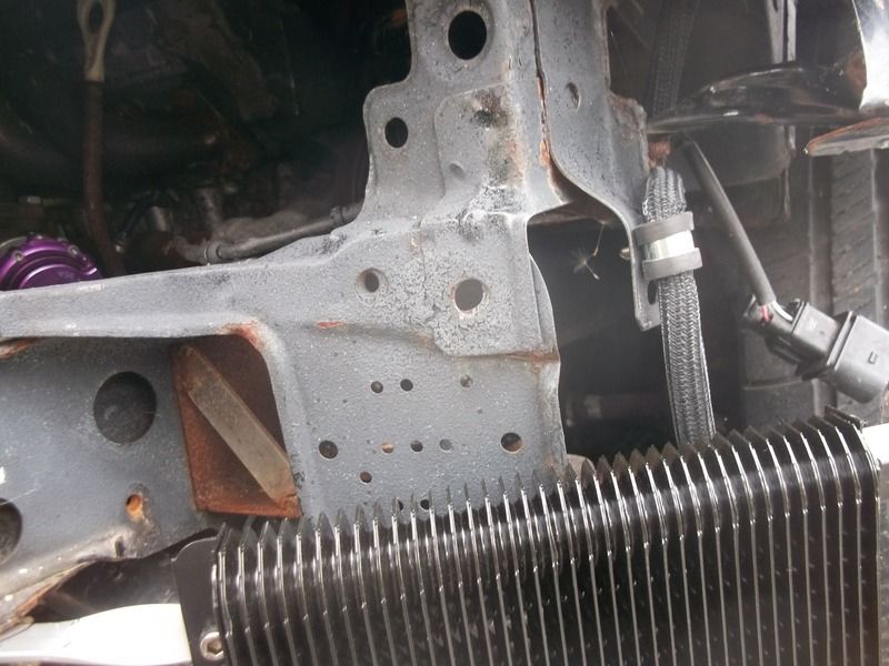

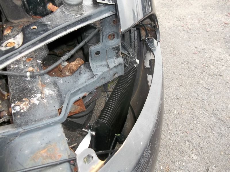

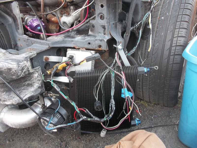

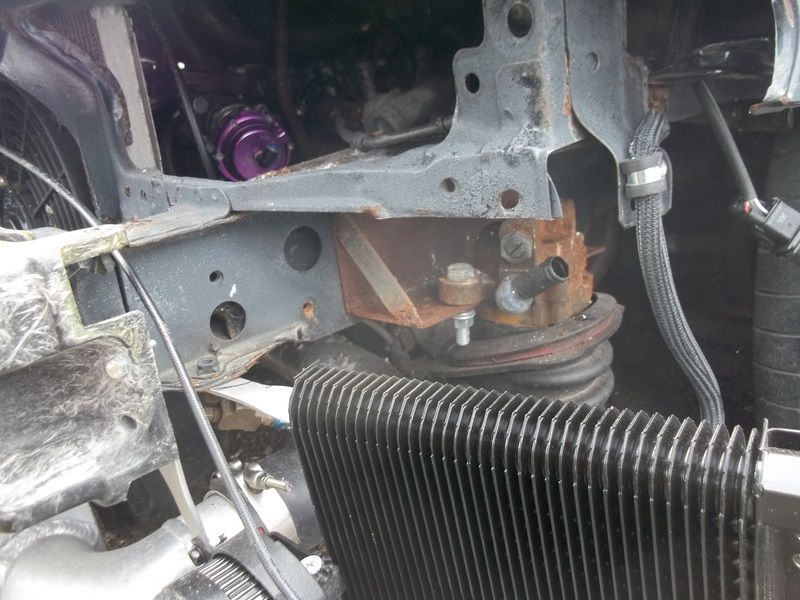

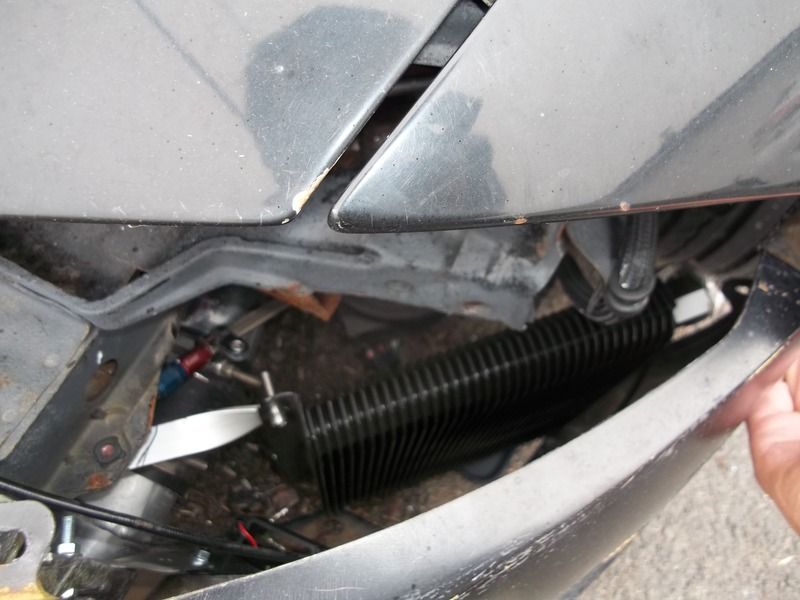

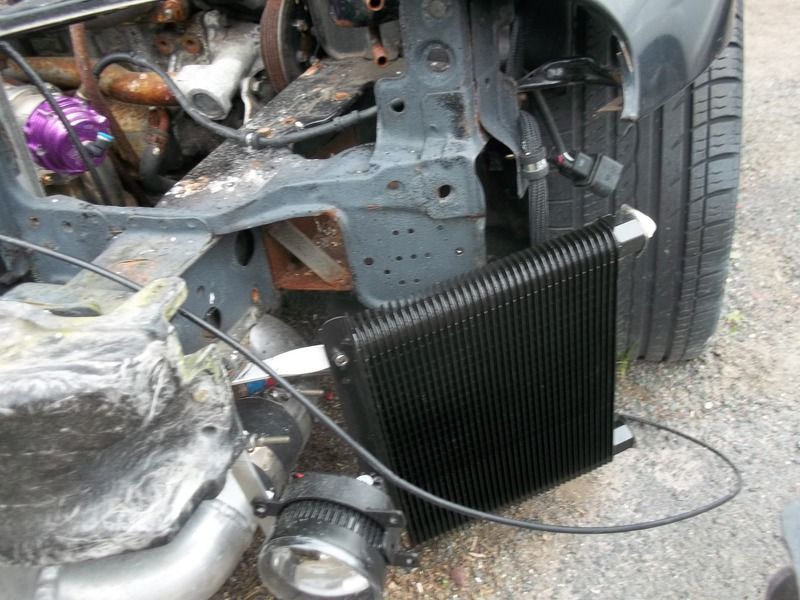

Mounted up my oil cooler.
Had to cut a bit to get it to sit where I want.
Perfect!

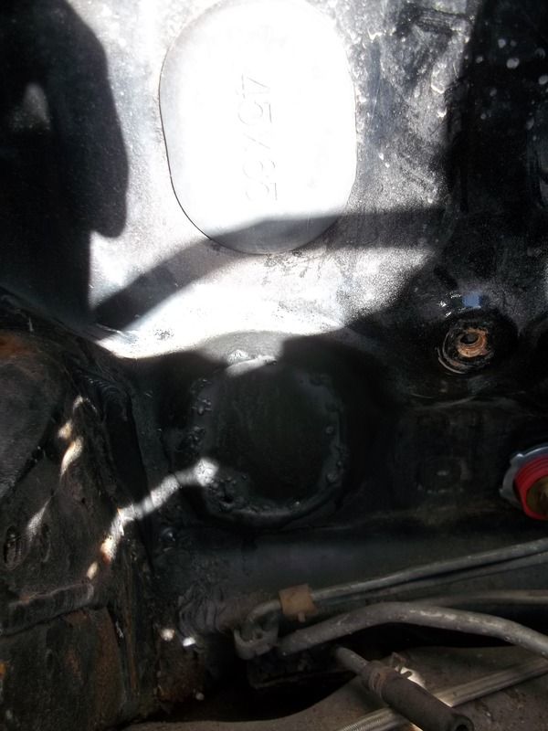

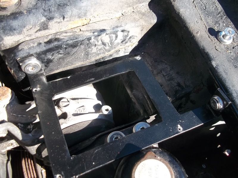

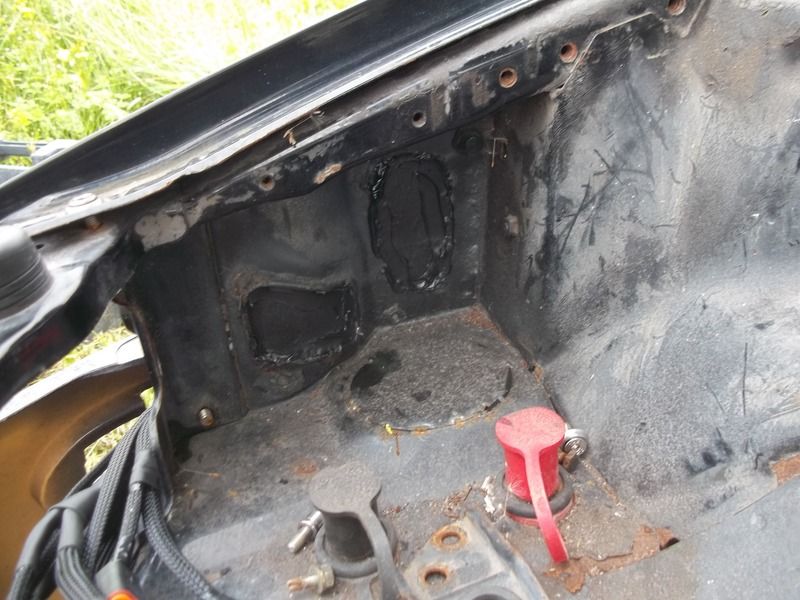

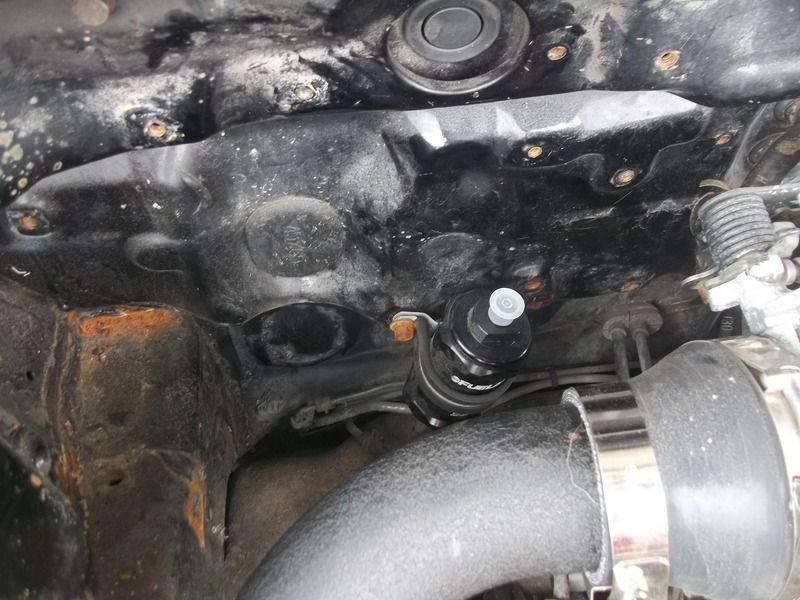

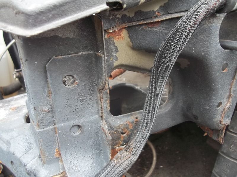

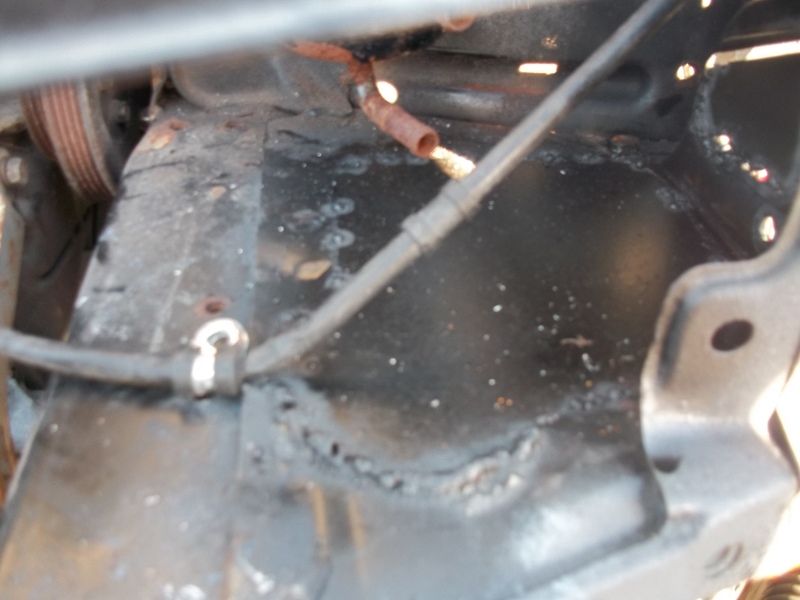

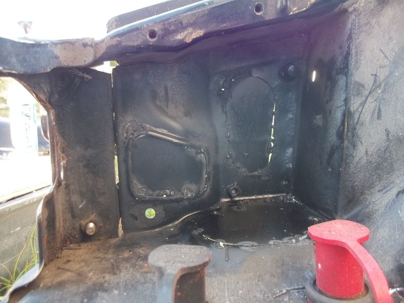

I hate all these unneeded holes in my engine bay.

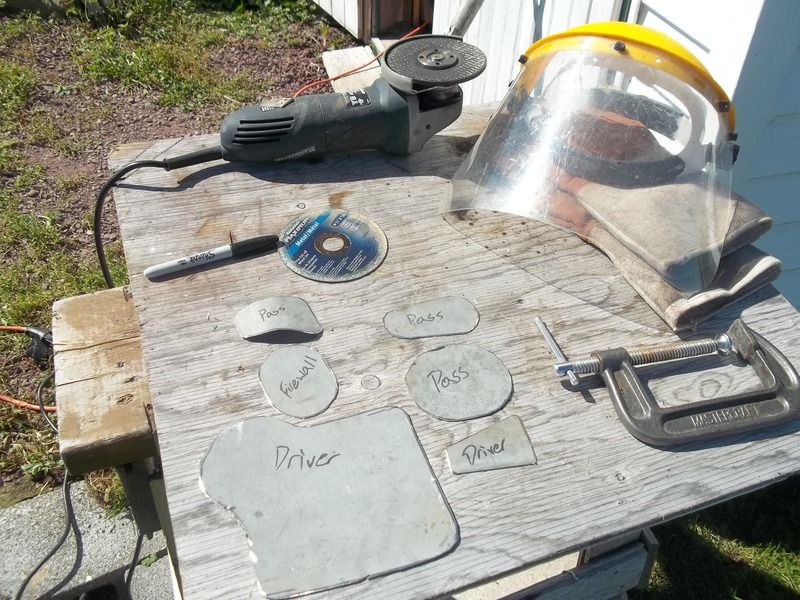

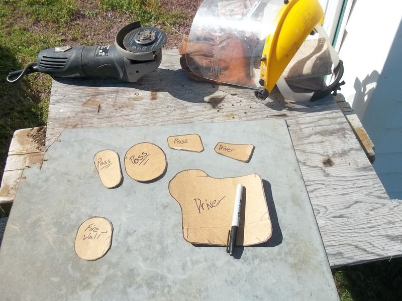

Templates made and some steel cut.
Block offs welded in, I need to seem seal them and make them pretty.

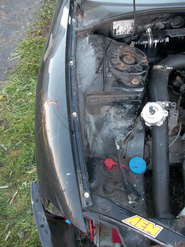

Also fixed the bolt holes on my fenders so I've got 4 bolts on either side (retapped).

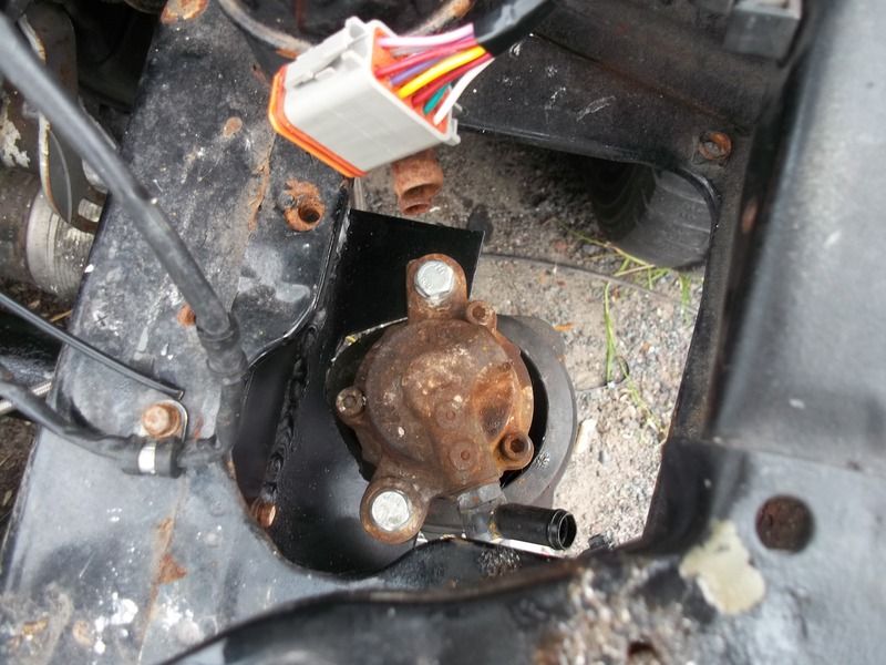

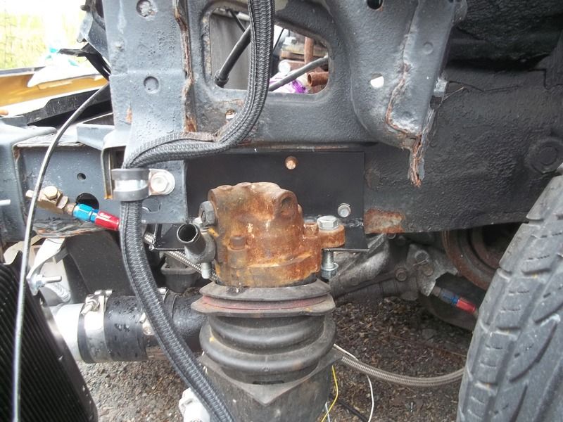

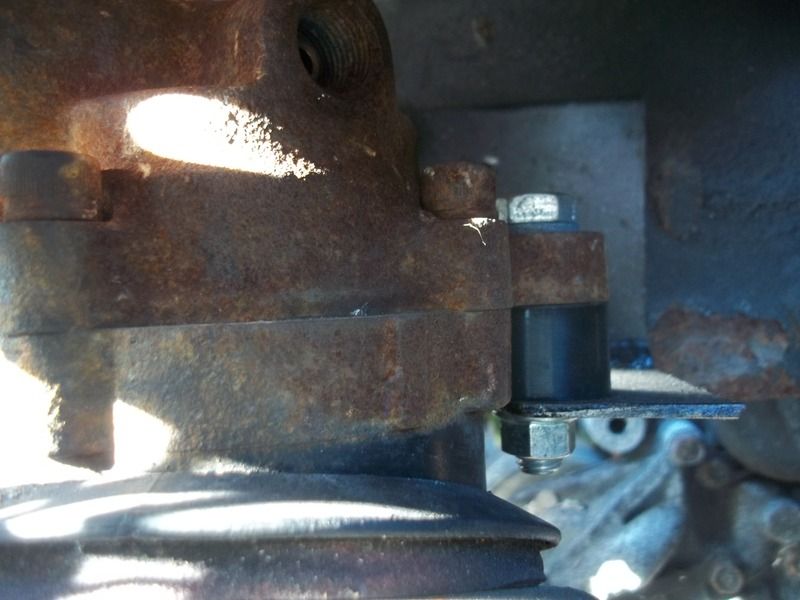

Got some rubber mounts for the EHPS pump. Hopefully this will keep noise/vibration down. I'm thinking I will weld the mount to the frame (already did that with the battery mount).

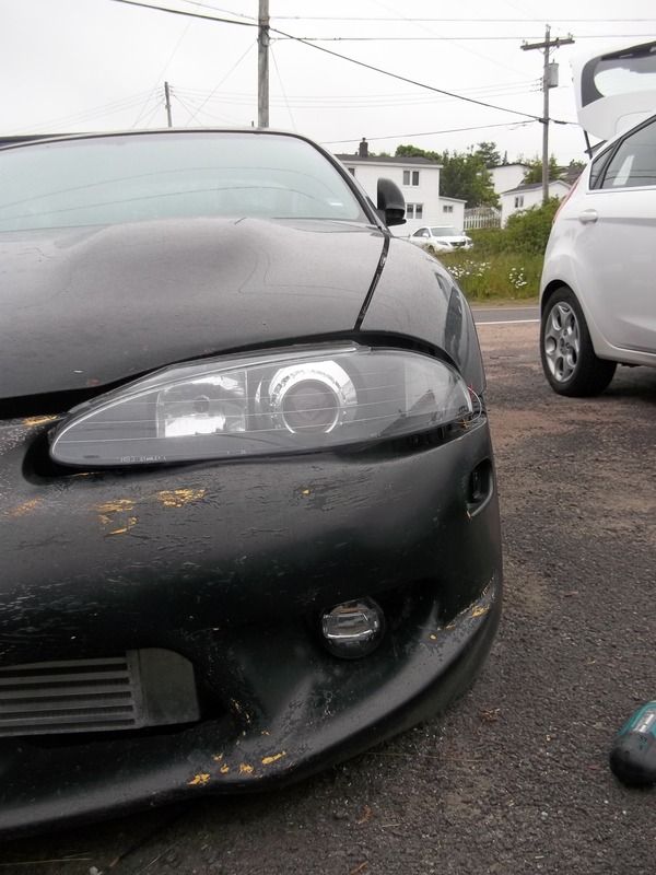

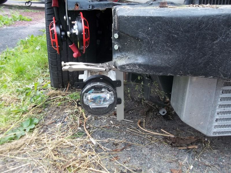

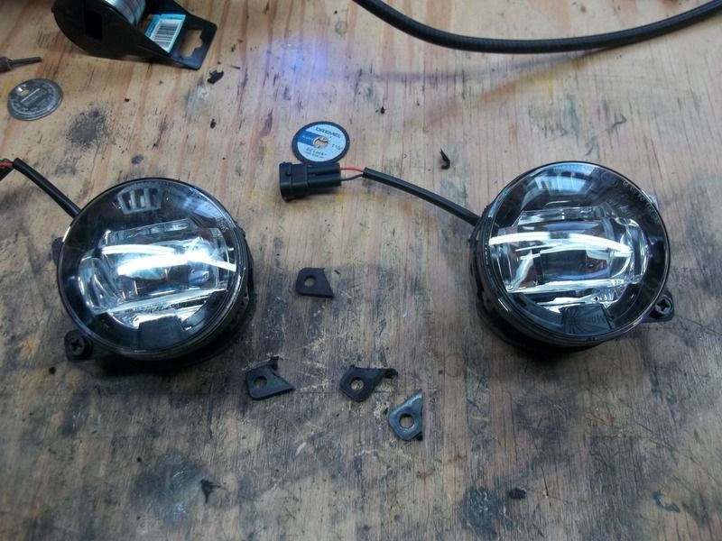

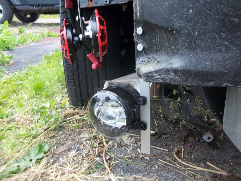

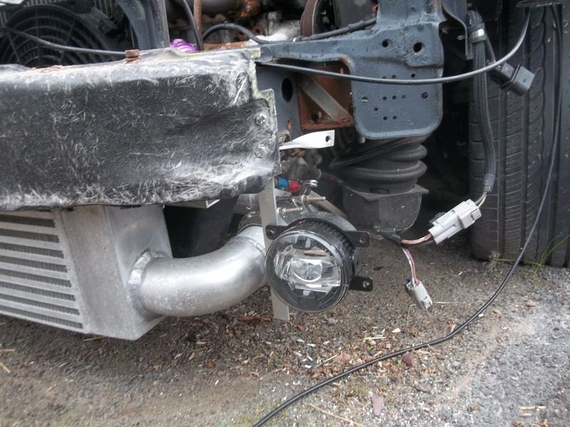

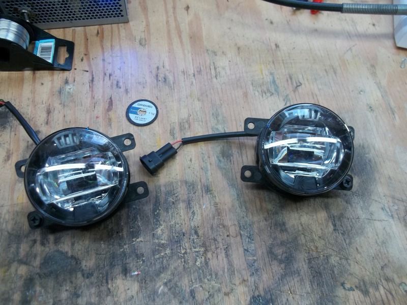

I had picked up some Morimoto LED fog lights for the Fiesta but I decided to use them on the Talon instead of the BMW X5 LED Fogs I picked up. Made some mounts that bolt to the crash bar and place the fogs in the outside 'mouths' on the bumper.
Oh no, the fogs aren't straight! This is why I love aluminum for making mounts. 2 seconds with a pair of vice grips and they're straight.
Tossed the bumper on and I love it.
I had to trim the mounts on 1 side off, couple minutes with the dremel and it's like they were never there.

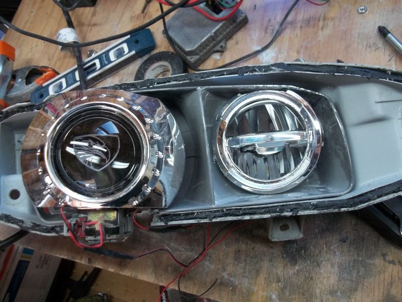

What happened to the X5 LEDs, well, I put them in my headlights to act as DRLs and auxiliary fogs (though they might not work very well in the position).

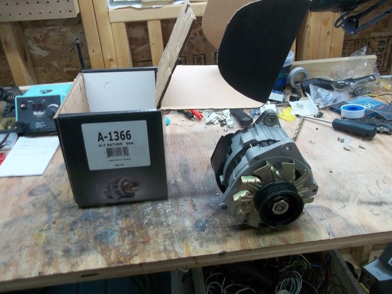

Got my hands on a 96A Saturn Alternator, this will be converted to a 1 wire set up.

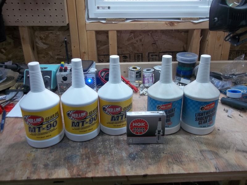

Maintenance stuff - MT90, MTL, Shockproof and plugs.

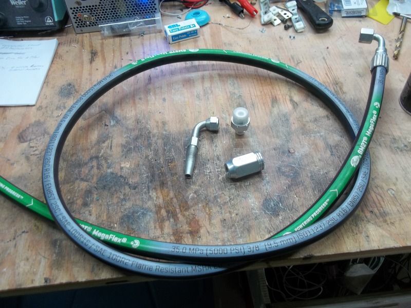

Custom PS high side line with a fitting that will allow me to do a field splice - it's much like at
AN fitting just rated for a much higher PSI.

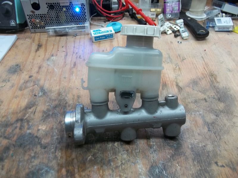

4 port Lancer master cylinder for my booster delete.

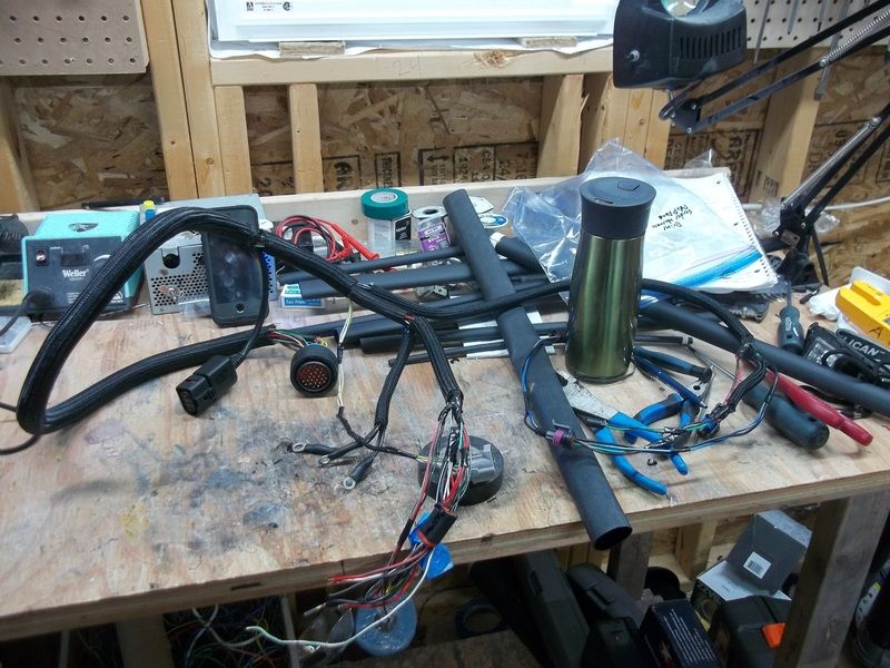

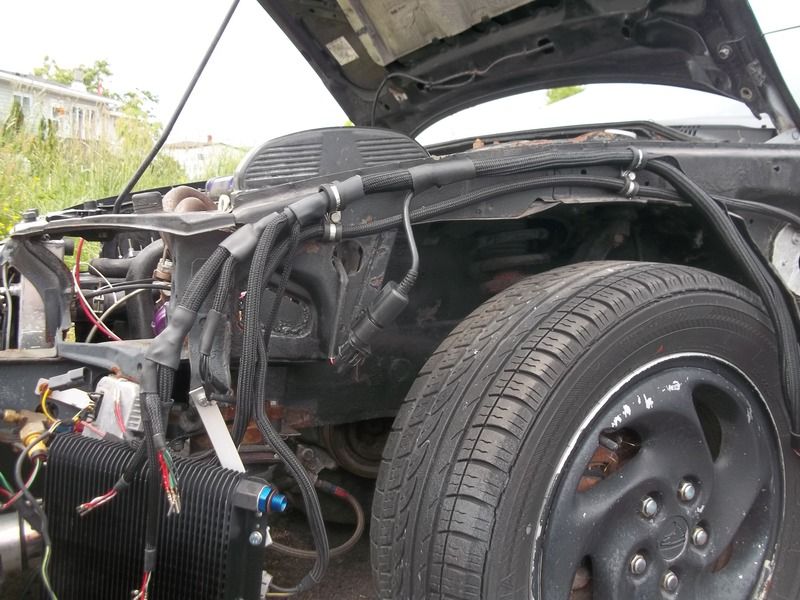

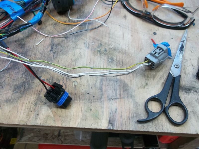

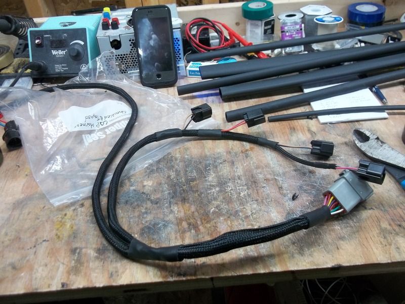

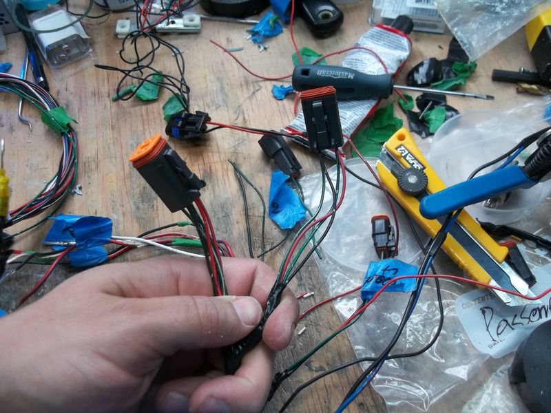

More wiring stuff, point to point and loomed the COP harness.
Back into the fender harnesses, had to had some 4 pin connectors for my bumper and headlight markers/turn signals.

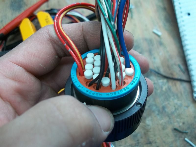

Made sure all the wires/plugs were in the correct spot on the cannon plug.

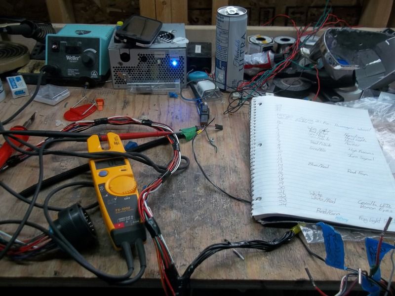

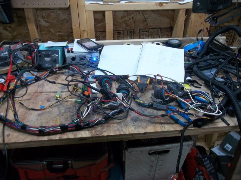

Did point to point testing on both Driver and passenger fender harnesses. Plus made sure my pin outs were correct, I'll make a digital version of those too.

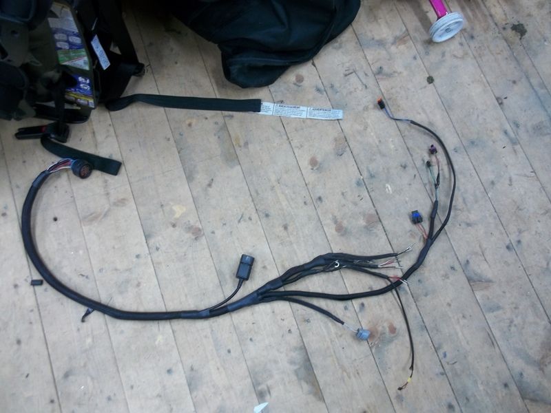

Then I went on to looming both harnesses.
Shot of the harnesses all loomed.
Packed up to go out to the car.

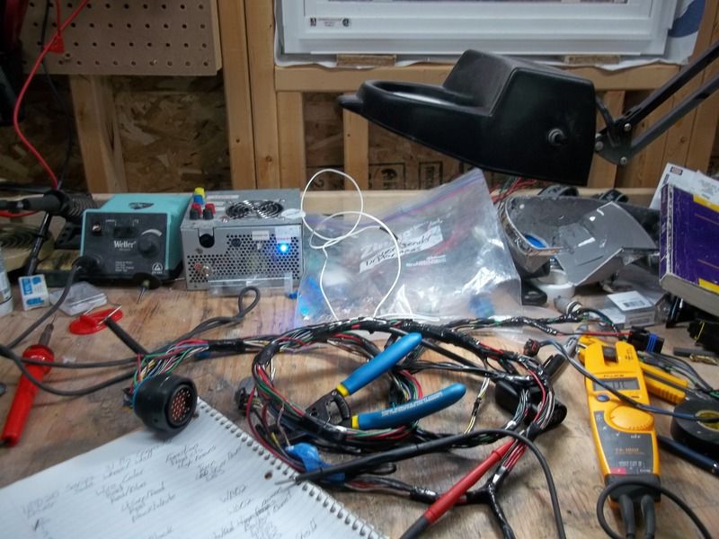

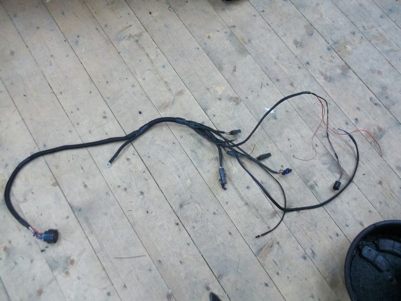

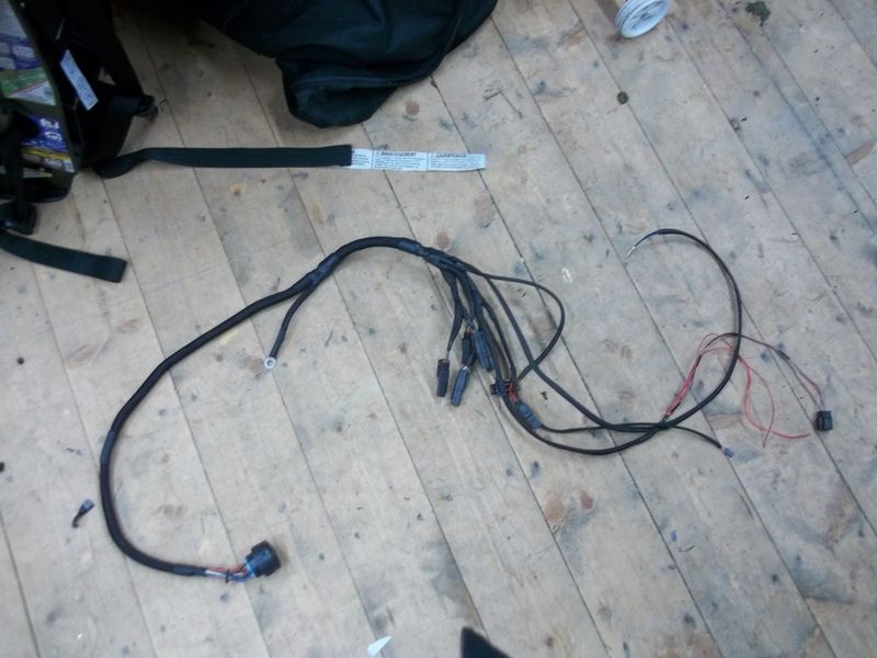

Chassis harness back on the bench - need to confirm some wires are there plus run wires for my Corolla LEDs.
I REALLY hate this harness now.

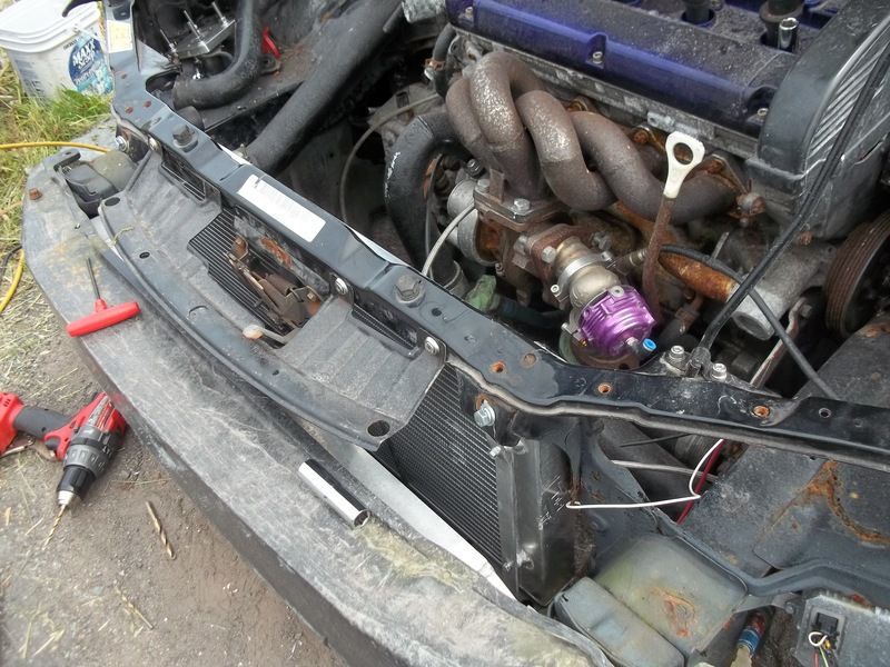

Picked up an aluminum radiator for a MK3 GTI. I had to do some minor mods to the core support so it would slip under. Right now the stock hood latch is still there but to get both 12" fans installed it's got to go. I'll run some Aerocatch hood pins to latch the hood down.
This freed up a ton of room in the engine bay.

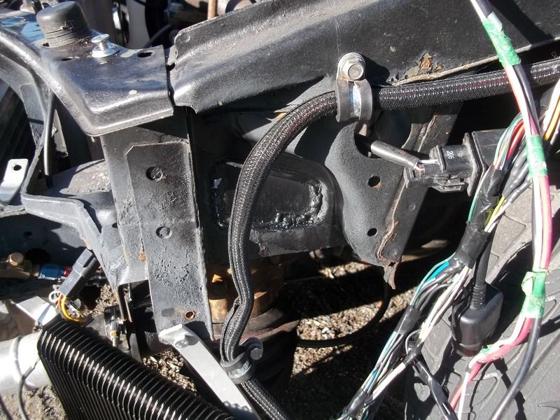

Fender harnesses installed, still need to route/secure some things under the frame rails but I didn't bring my jack out.
Seam sealer on all the block off plates.

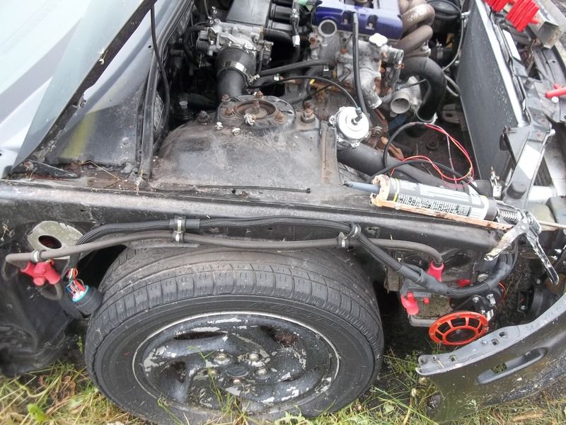

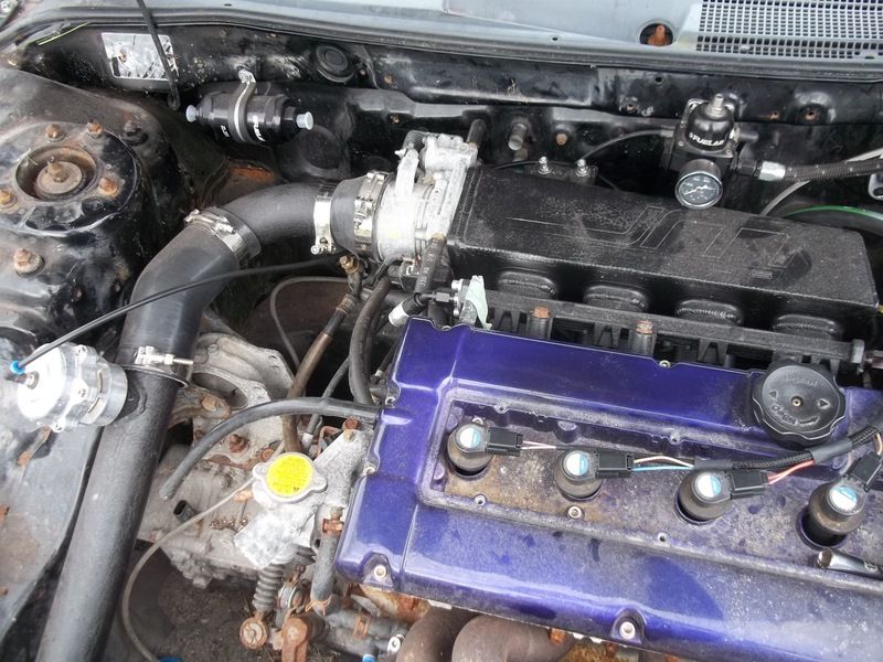

Vacuum lines run to the BOV and IAC (can't see it because it's behind the motor.

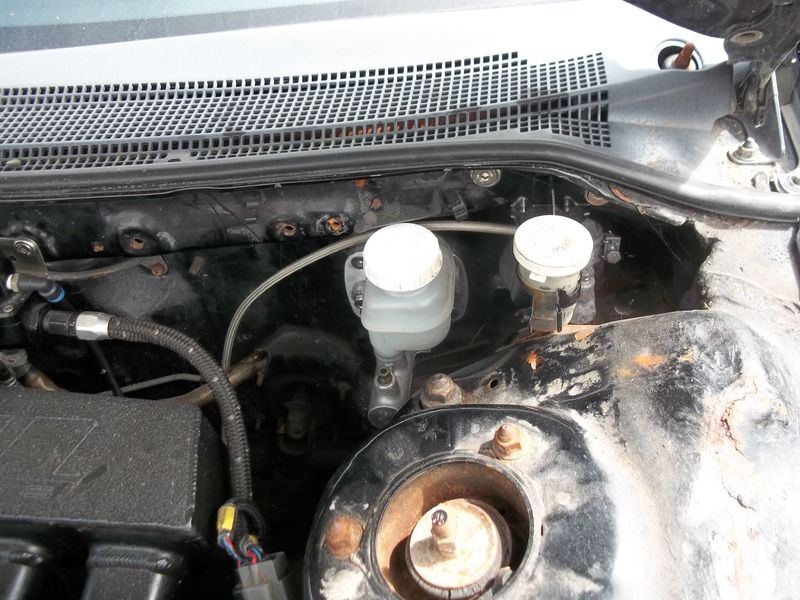

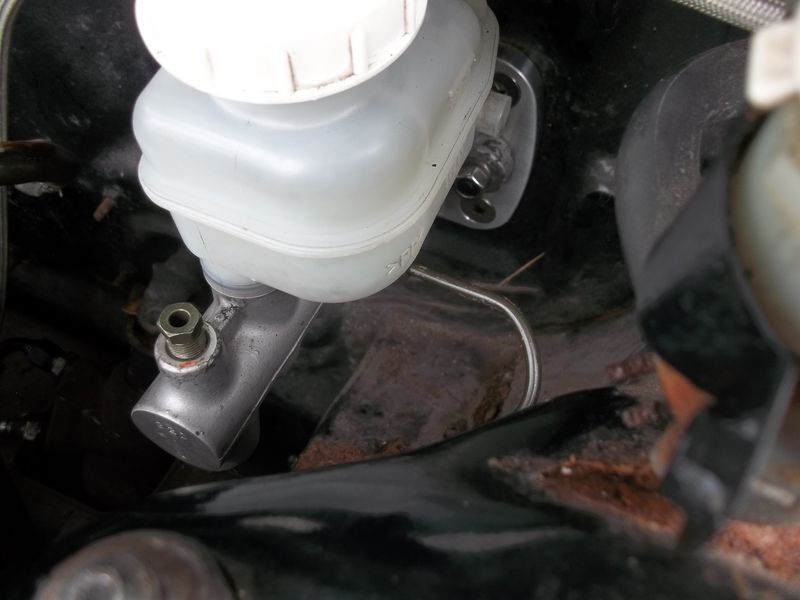

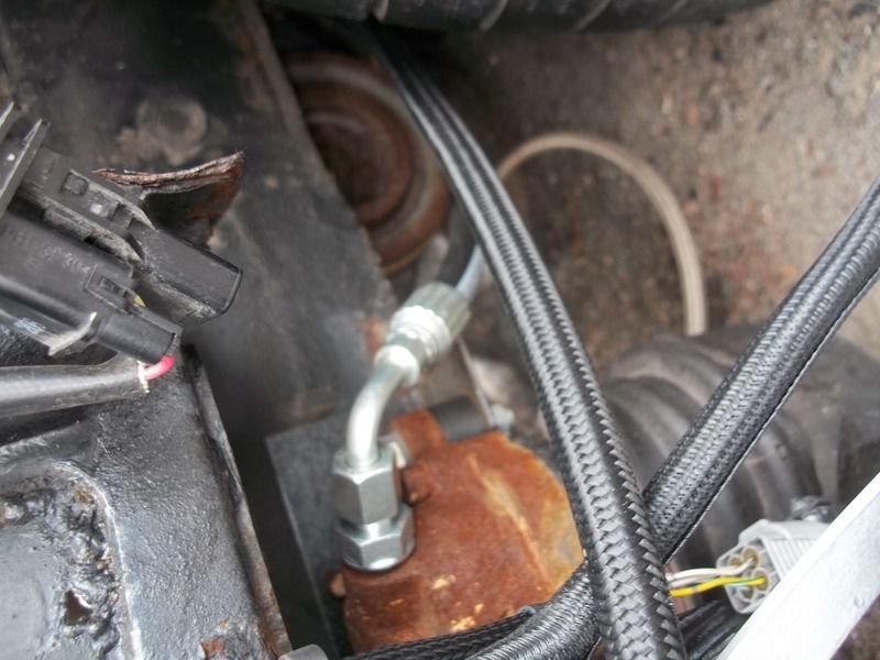

Master cylinder installed. Running a Wilwood adjustable push rod that I still need to fine tune the adjustment of.
Started running the brake lines, 4 ports will make it a lot easier.
Moved the fuel filter down lower on the firewall, need to get an SS bolt. I would have done the rail to filter line but I couldn't find the fittings and didn't feel like gutting the car.
PS high and low lines run under the frame rail, just need to cut them and connect it all up. Running without a PS cooler for now.

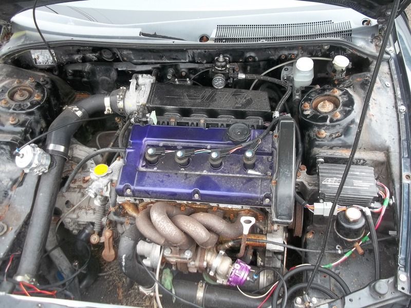

Overall motor shot, getting closer, just need a couple more things.
