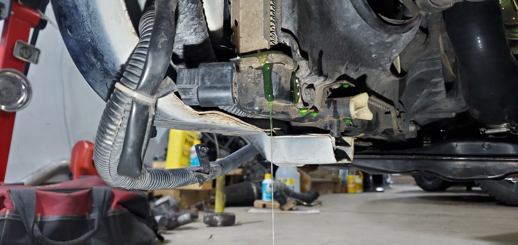

I finally filled my transmission today. Been waiting on a transfer pump I ordered so I can do it easier. Definitely was. I fixed a tiny fuel leak under the fuel filter. I guess I just didn't get the fitting as tight as I should have. It was only dripping slow.

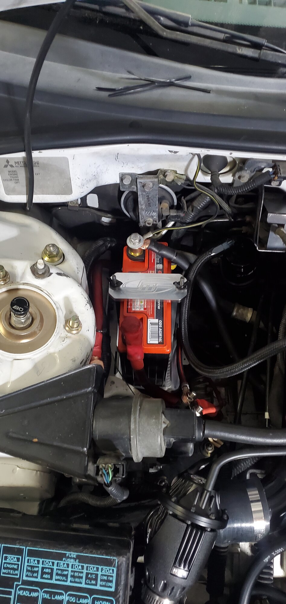

However, I have a potential theory, hopefully someone can confirm it, or tell me I'm just retarded. Early on, I relocated my battery to the rear. I have not built an actual mount for it. No real reason, just haven't gotten to it, I know it's necessary. Don't need to be told that 😄 If the positive terminal arched to ground while moving, could that have caused a power spike or whatever that could affect the fuel pump?

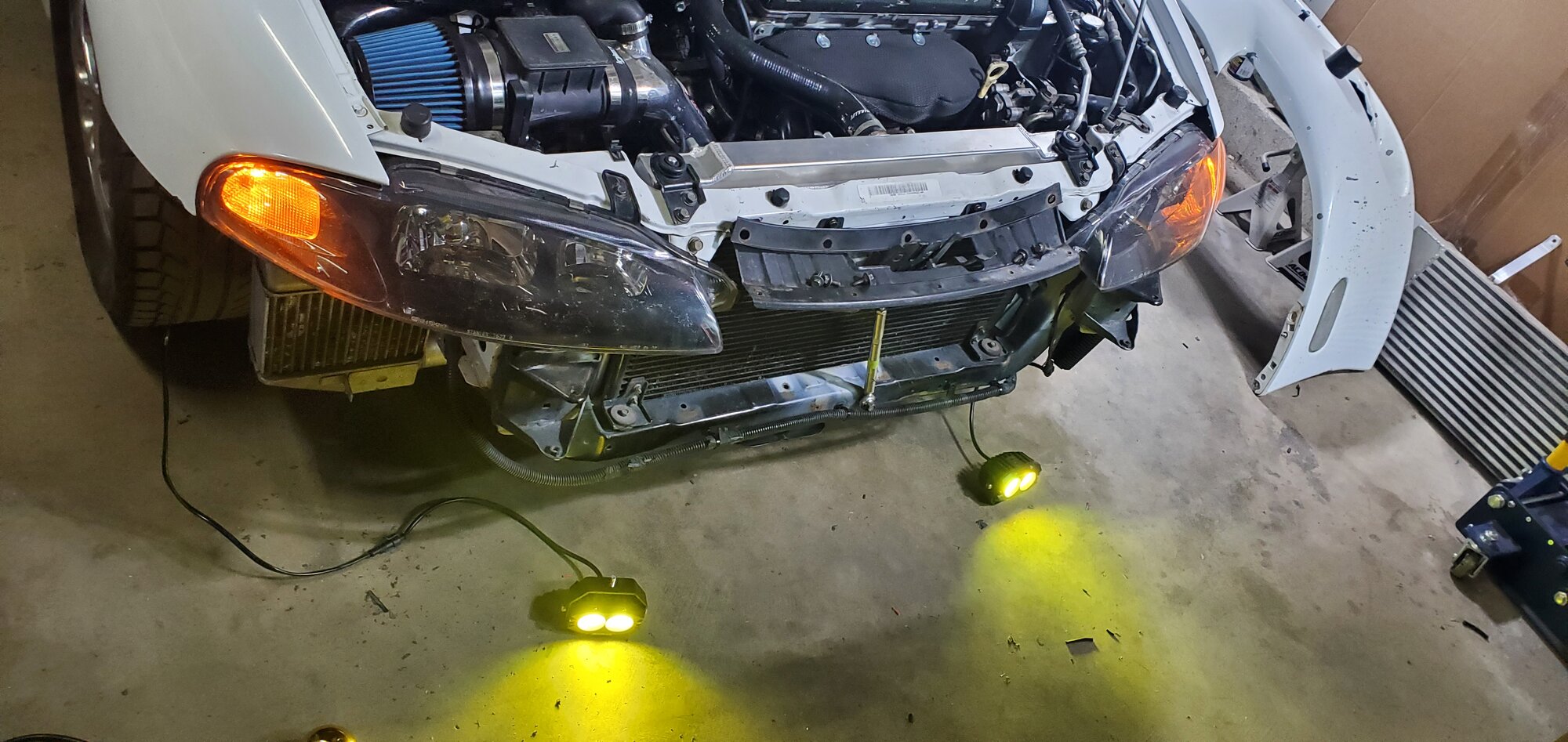

Also got the fog lights (half) installed that I pulled from my wrecked car.

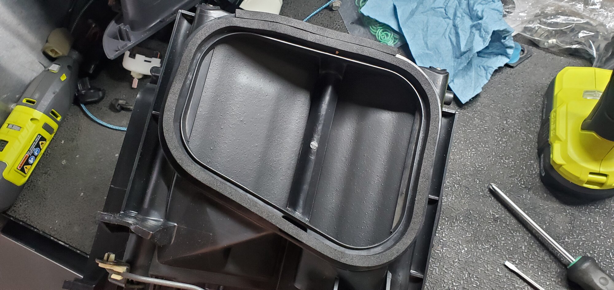

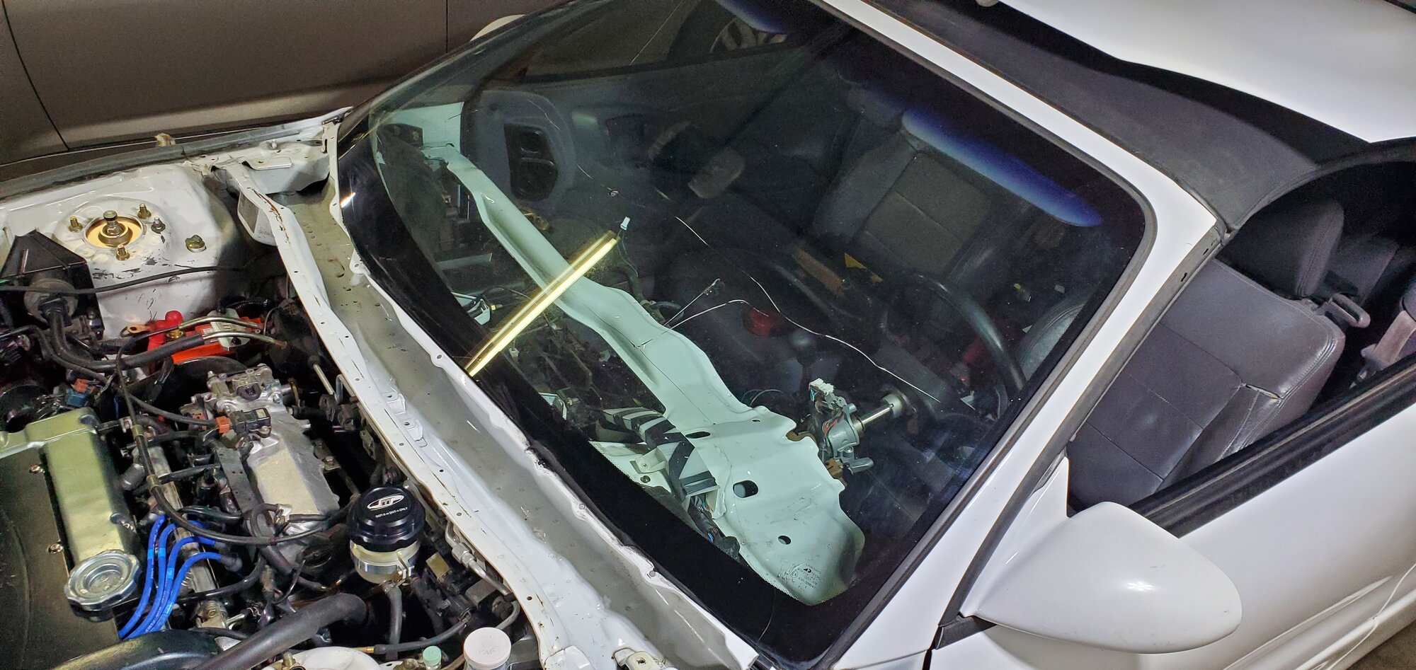

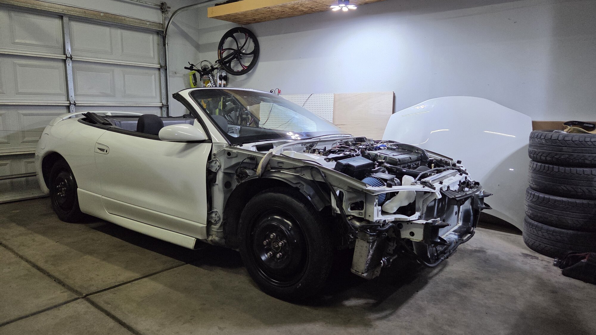

Been a few months, so it's time to get this update posted. In the last update, I hinted at a change, and no, it wasn't the front end panels being gone, although those being off were to be a slight indication. I got my windshield replaced. Since parts are hard to find as we all know, I decided to remove everything to keep the glass tech from having to do it, and potentially breaking something else, that I couldn't readily replace. I'm glad I did as the canal that the wiper motor sits in was filled with all sorts of debris and dirt and was absolutely unacceptable for my standard of having the car clean. The tech did a great job replacing the window and even assured there was zero rust under it. The old glass was even the original factory windshield. Makes me happier that I bought this car.

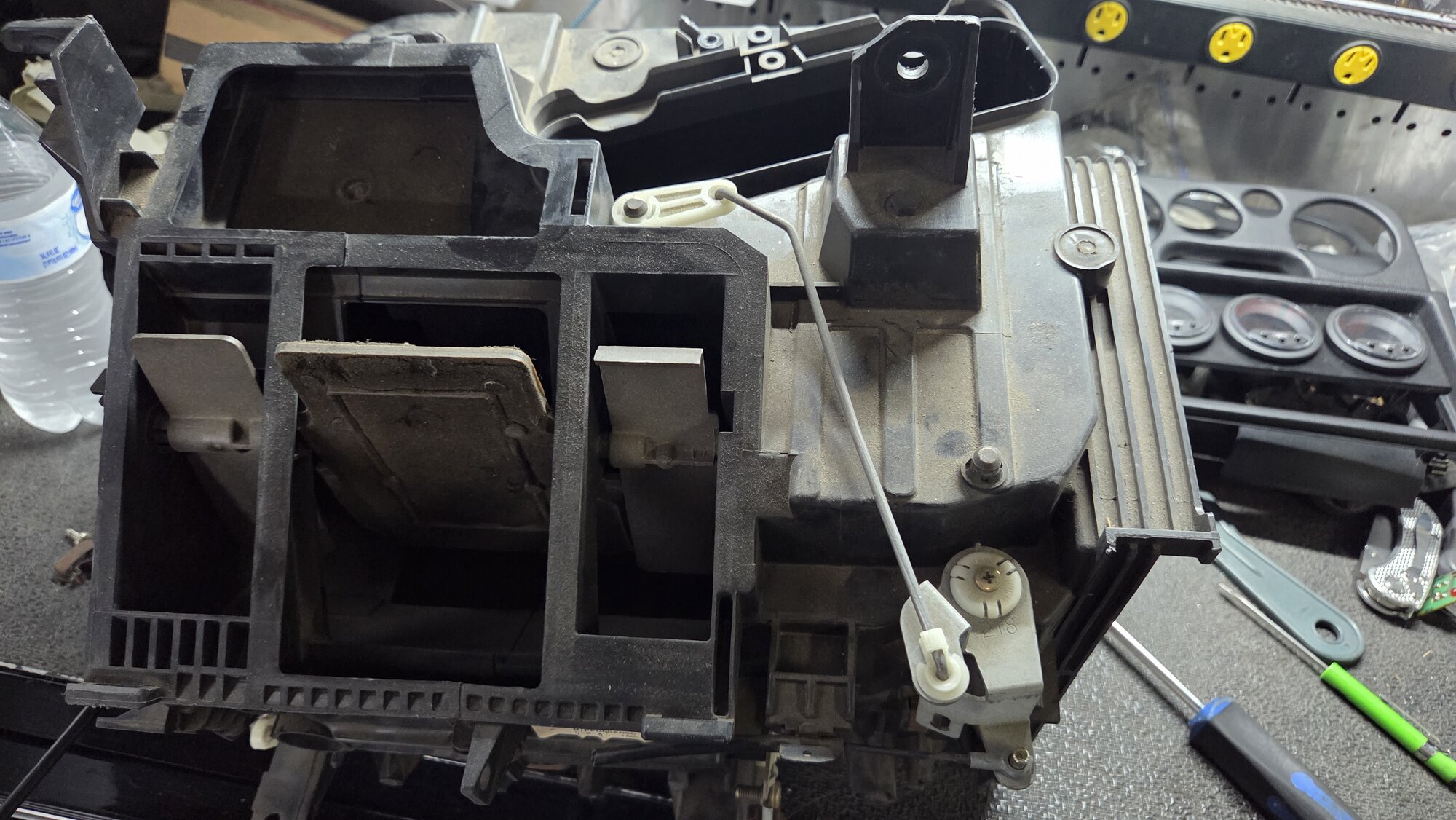

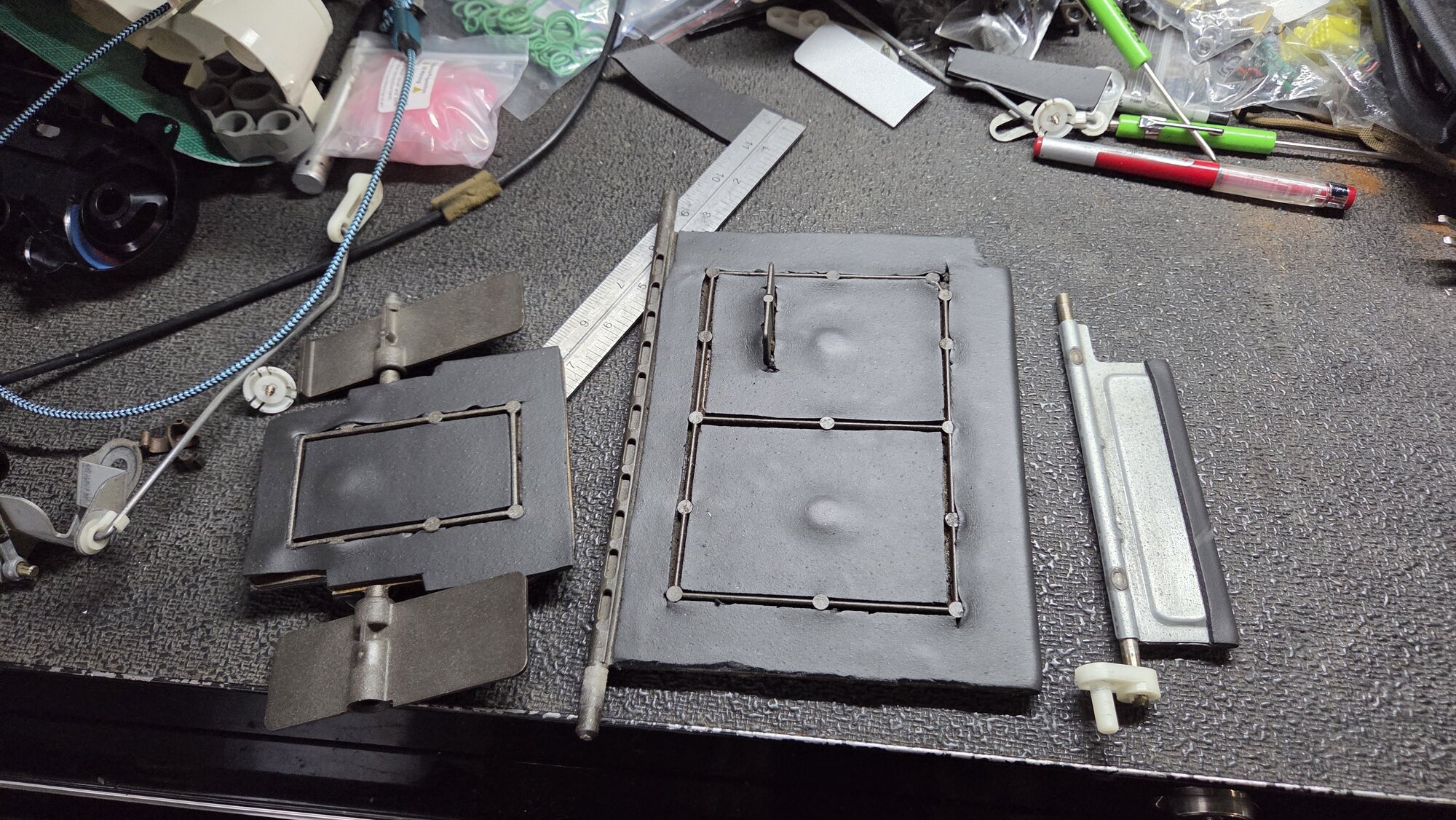

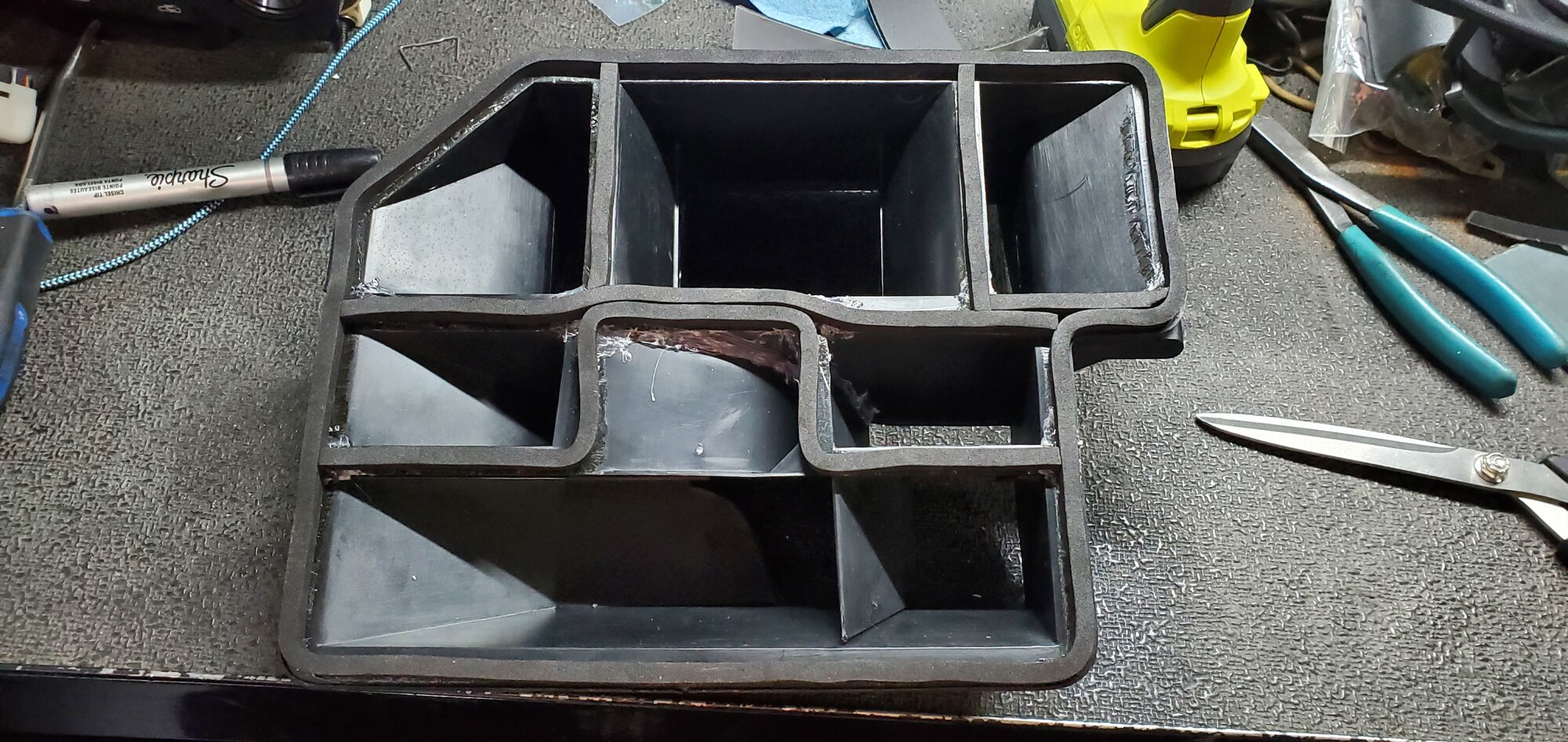

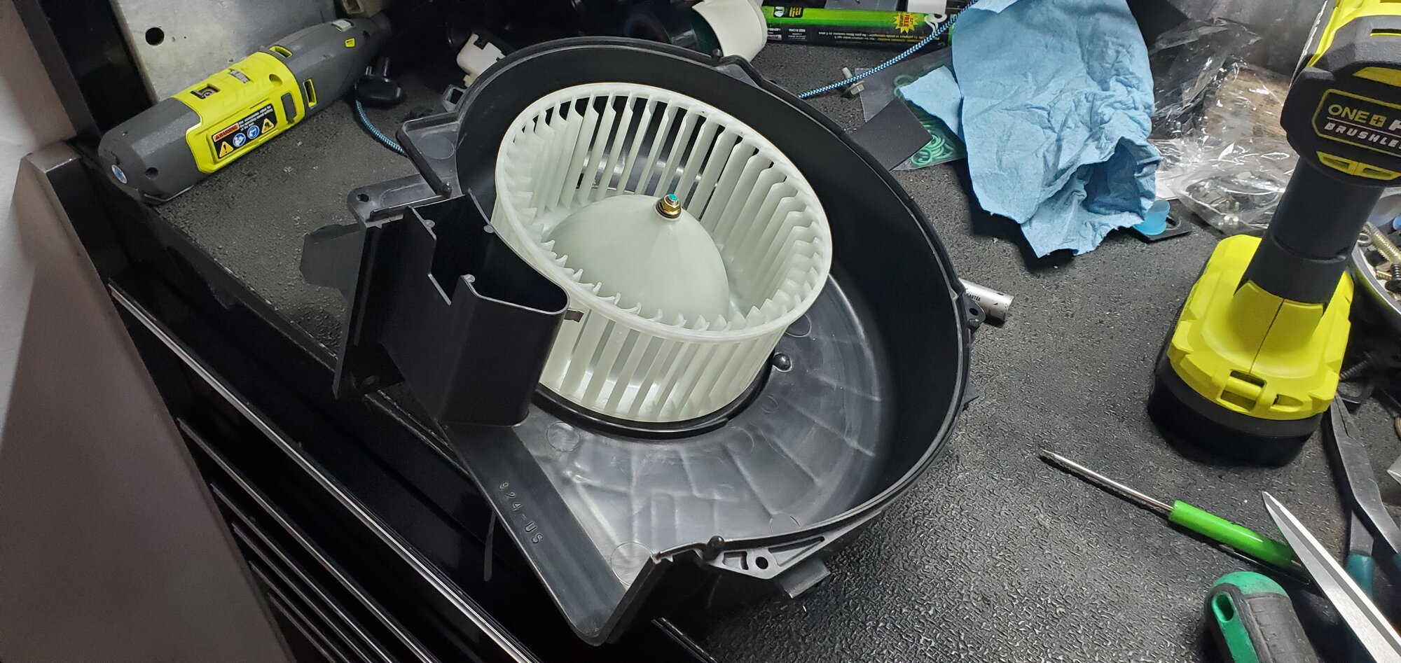

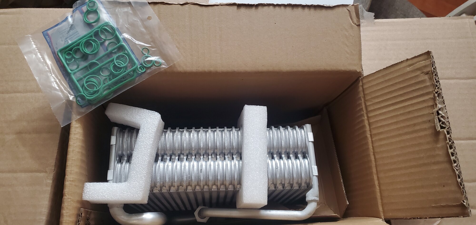

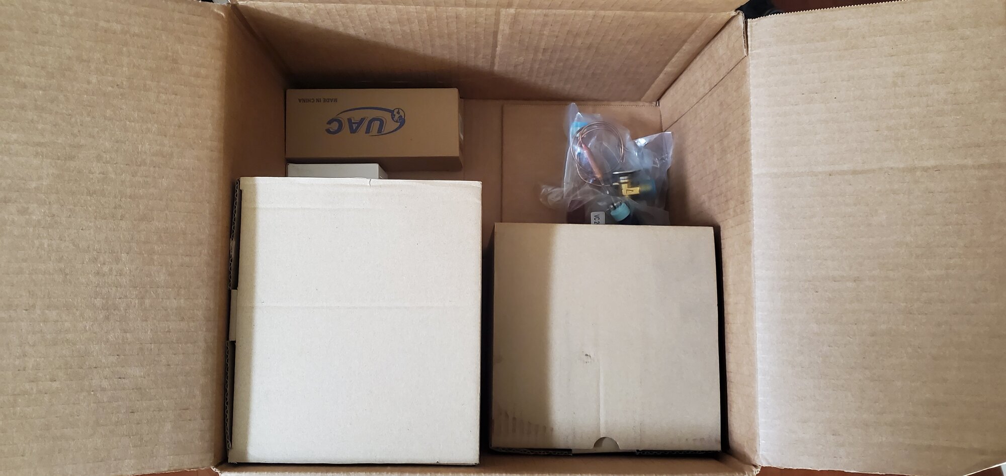

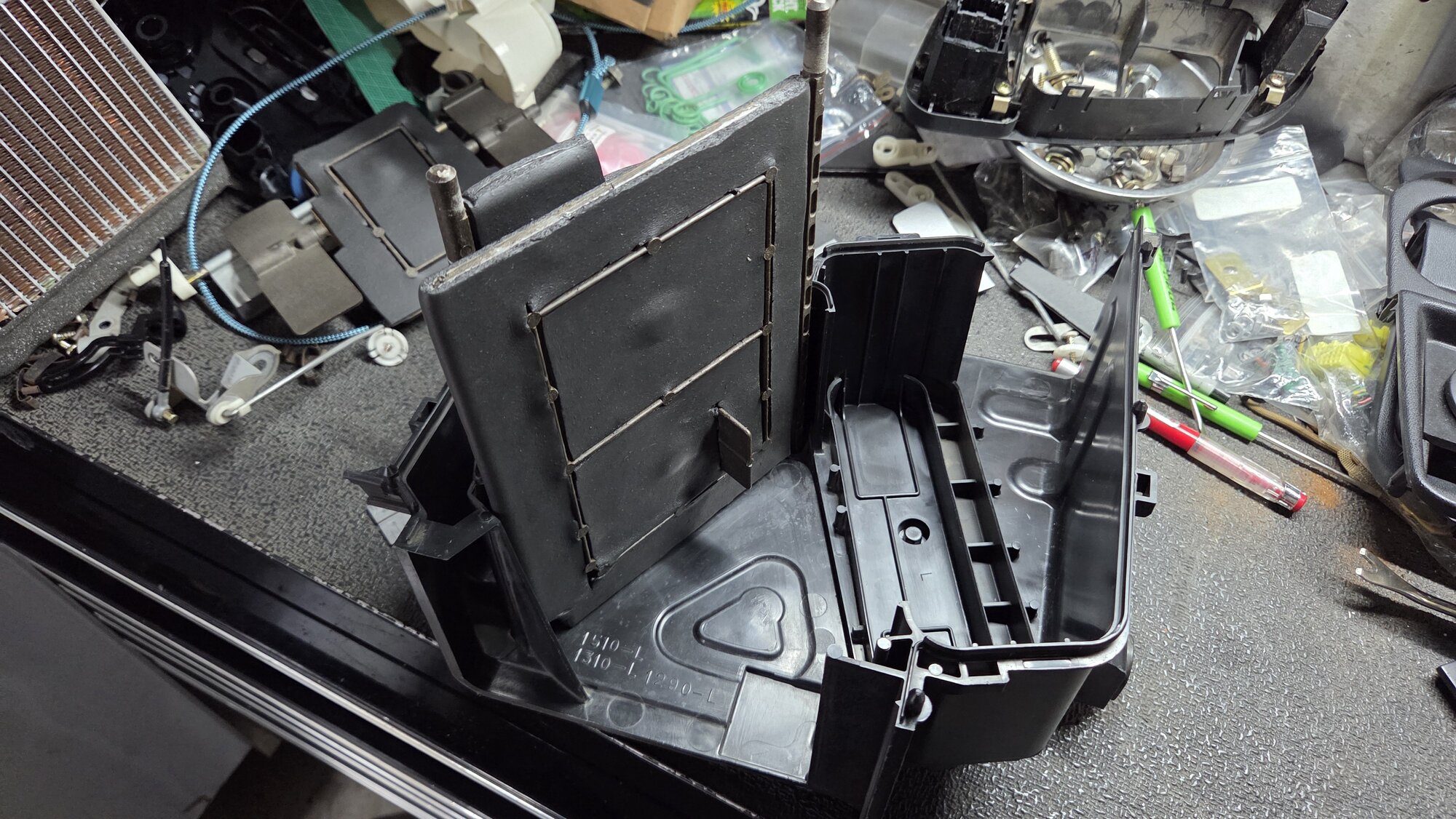

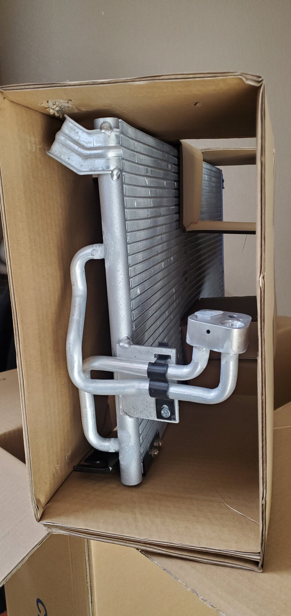

Since I choose to remove the dash for this as well, I decided to install all the new HVAC parts I had already ordered a month prior. I ordered EVERYTHING, minus a compressor and all the lines:
Condenser
Blower Motor
Blower Motor Resistor
Evap Core
Evap Expansion Valve
Heater Core
Accumulator
O-Rings
Shredder Valves
Service Caps

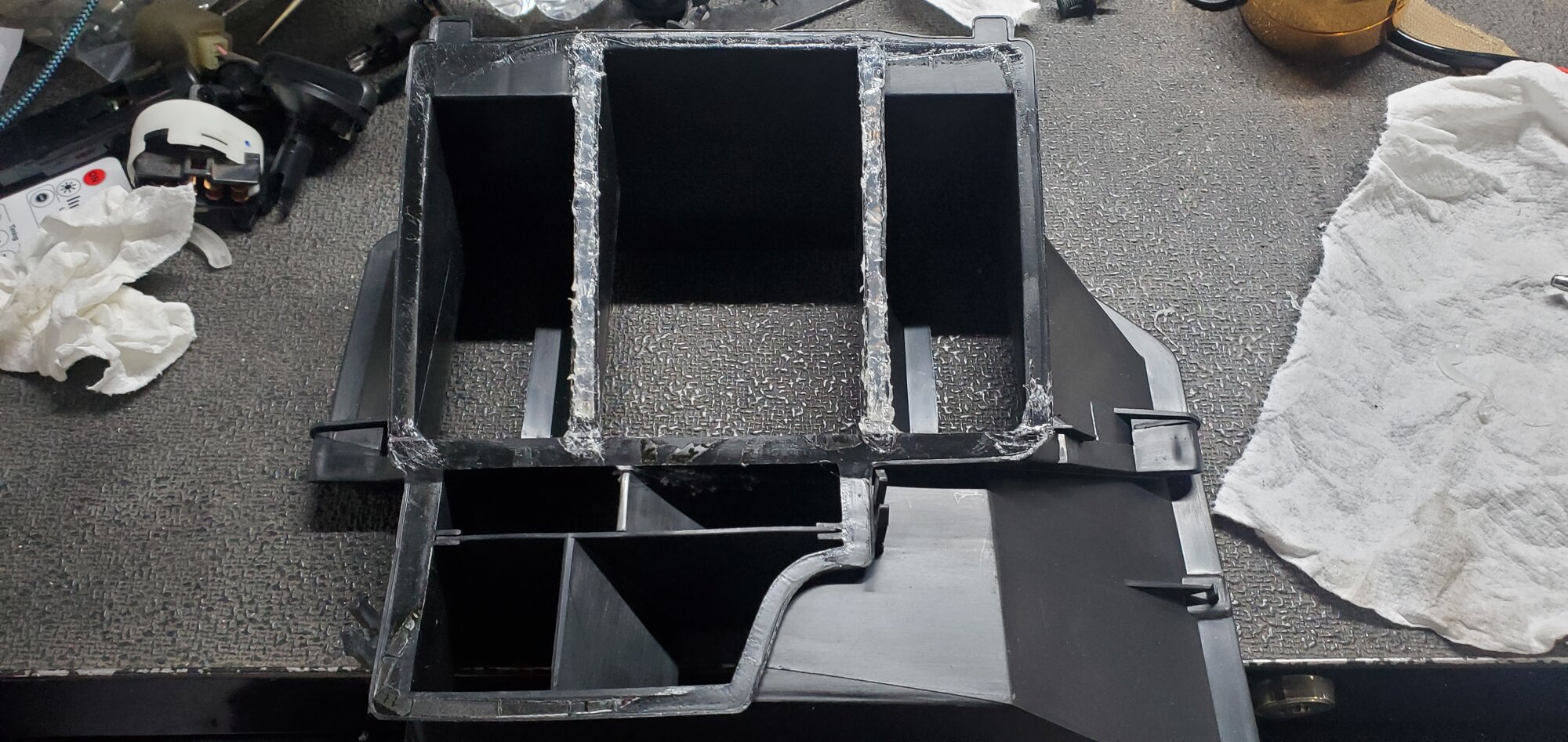

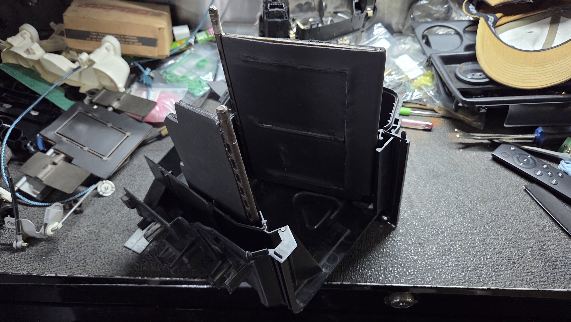

I bought everything possible, as I want the entire system to function flawlessly. As I mentioned, I did not get a new compressor or lines, for one reason. I'm converting to electric A/C. Once I find a suitable electric compressor, I'll buy it, and mount it in the back under the soft-top storage area with my battery. As for the lines, the hard lines are good, and I'll just need to build my own flex lines reaching from the rear where the compressor will sit, up to the OEM locations under the hood. I even went and bought the crimping tool specific to these lines. So it is all waiting on me to find the right compressor.

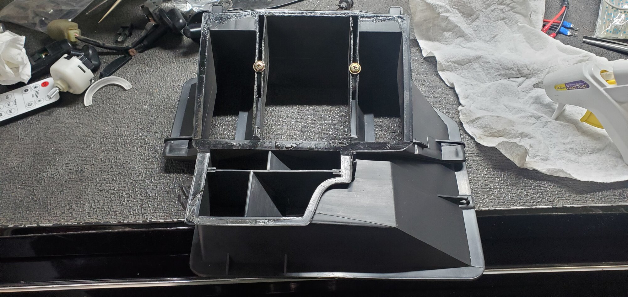

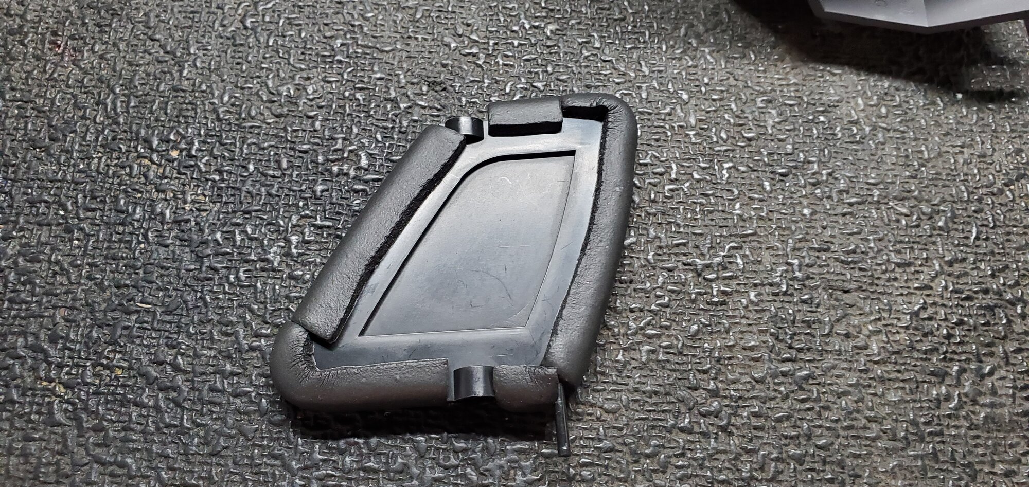

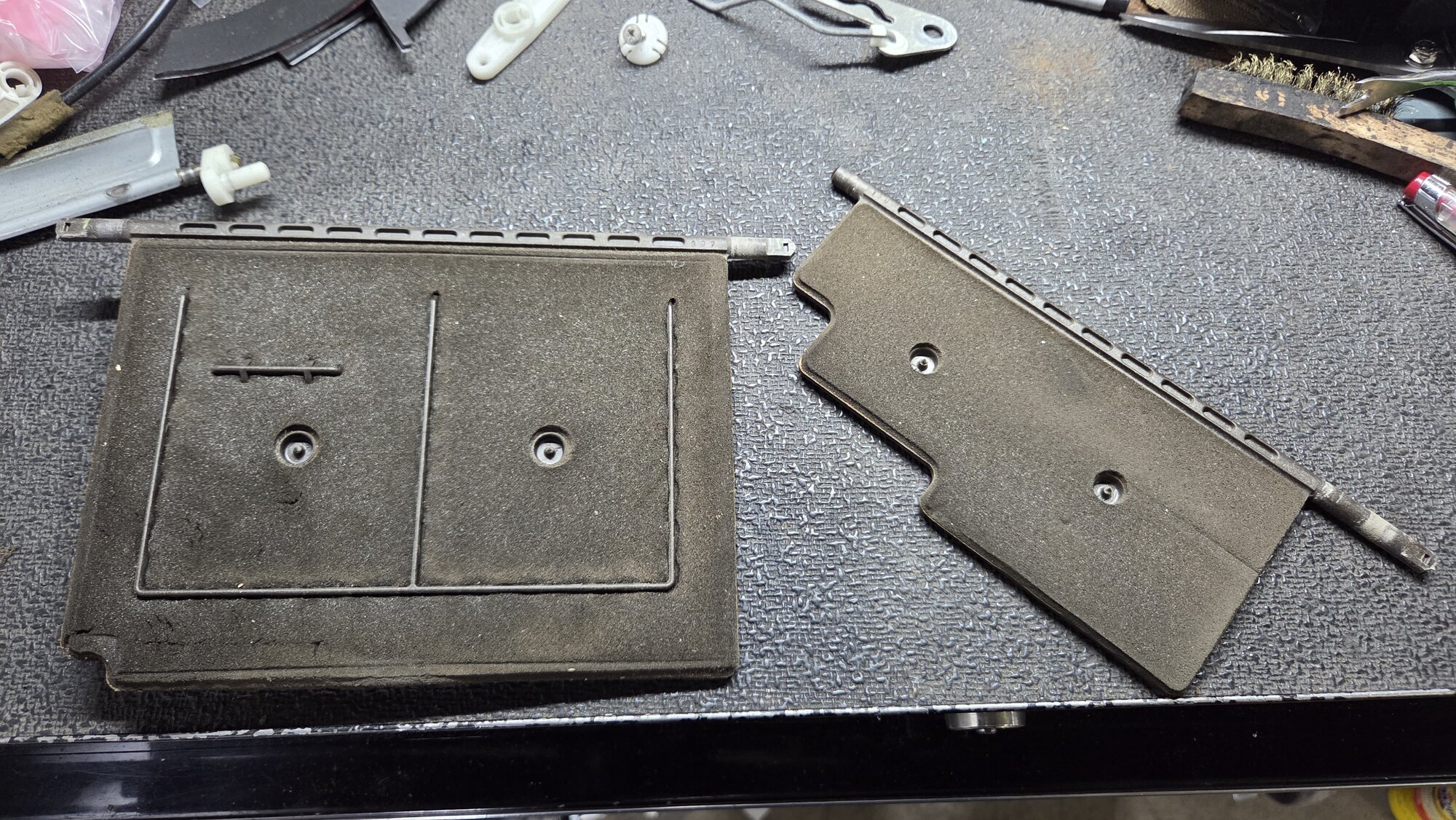

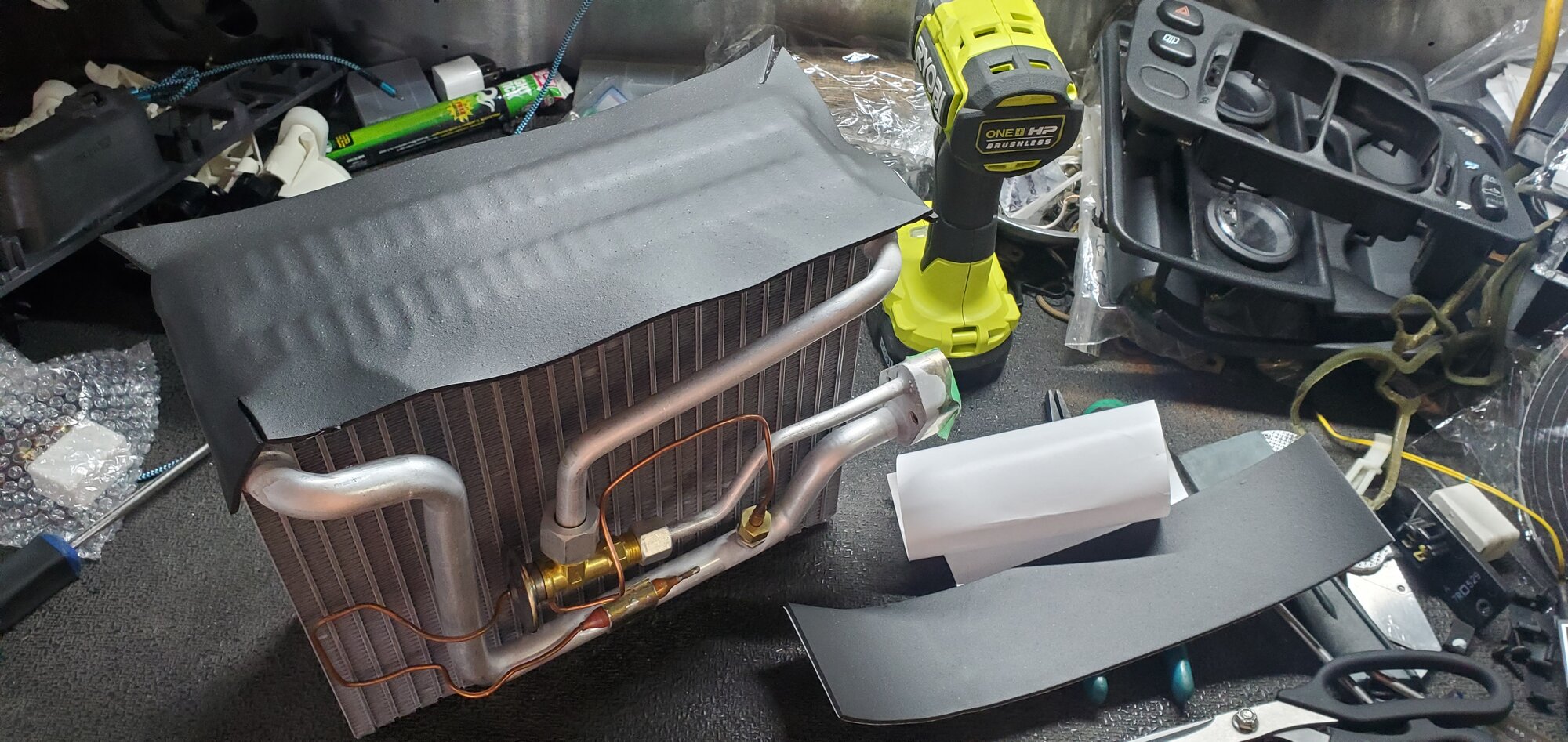

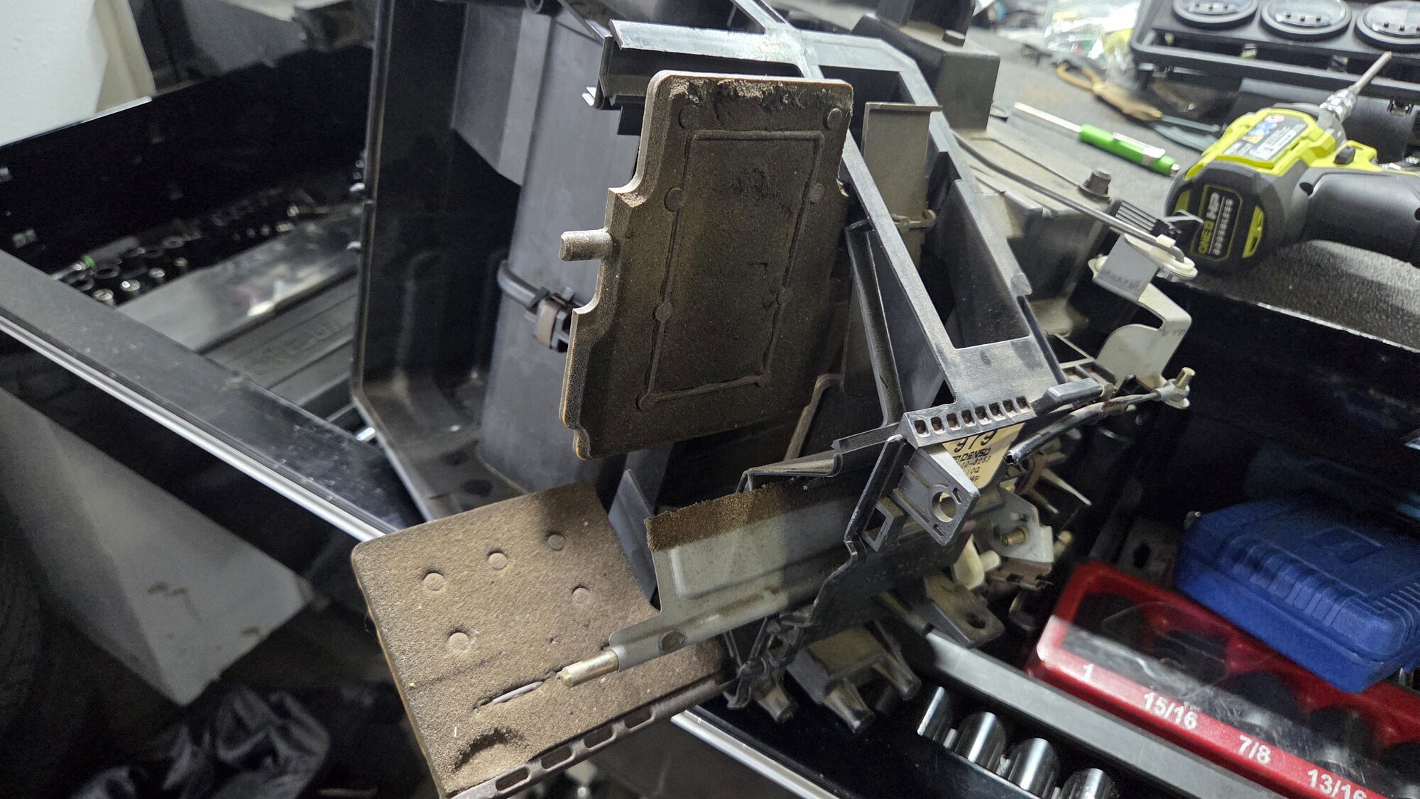

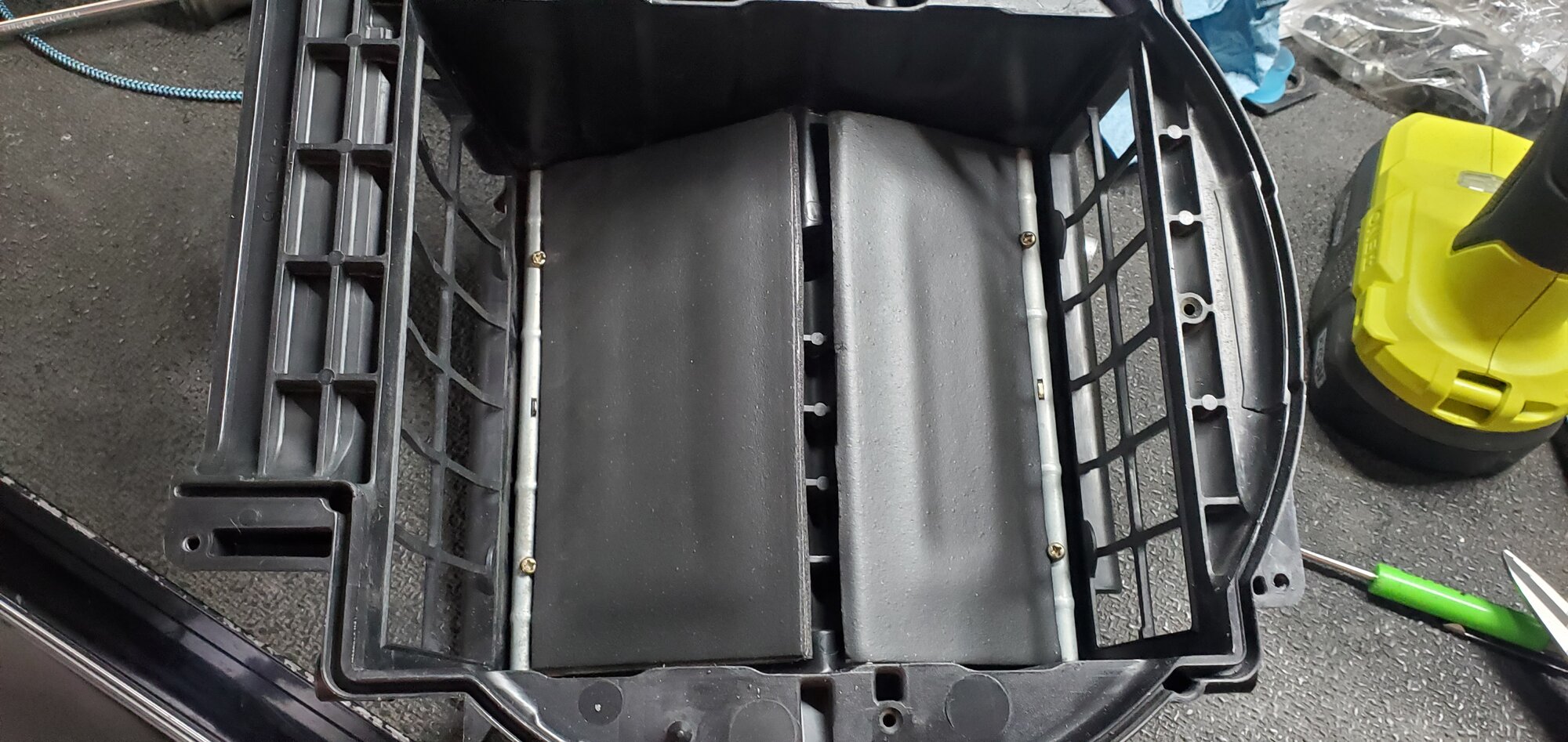

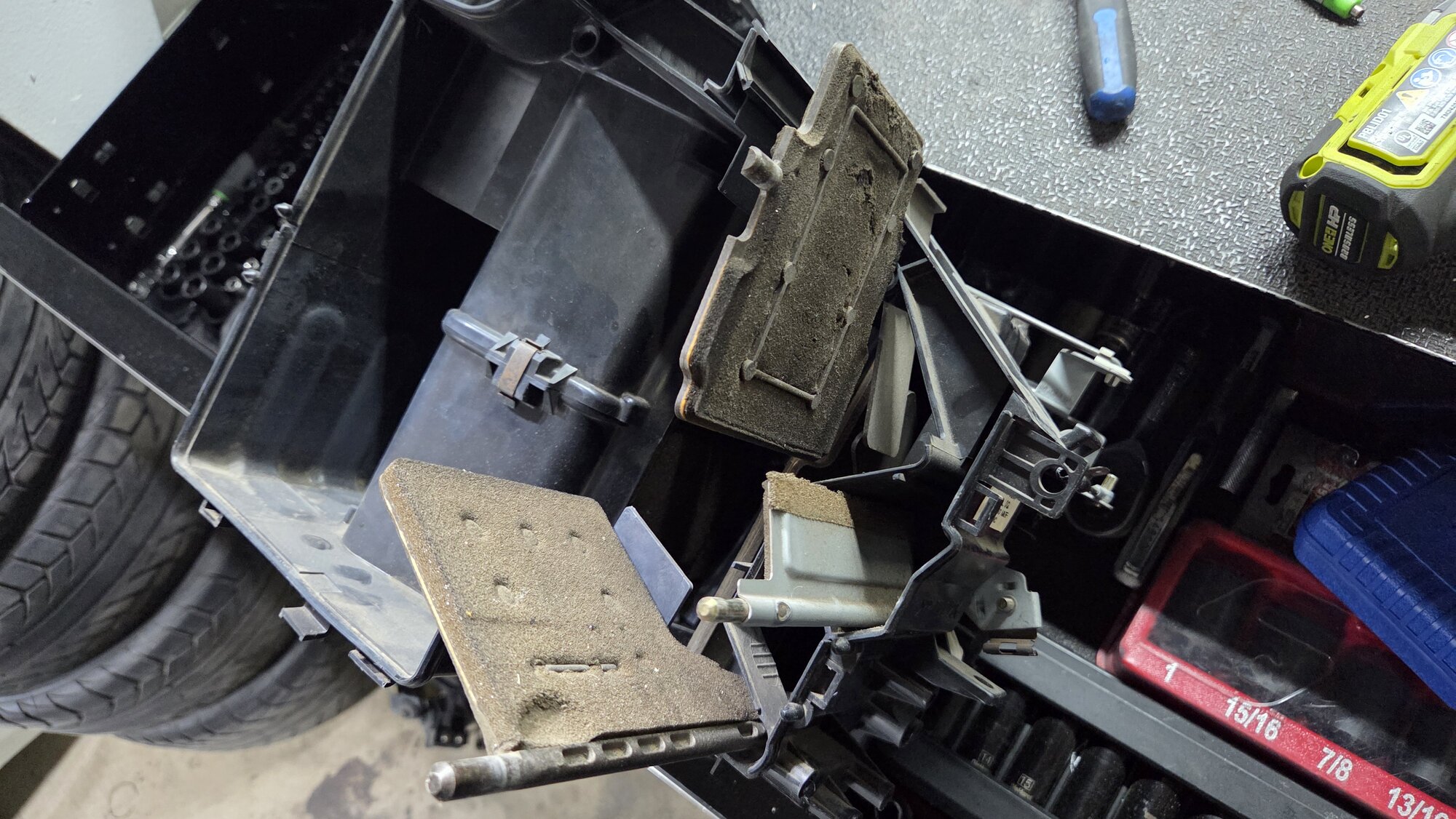

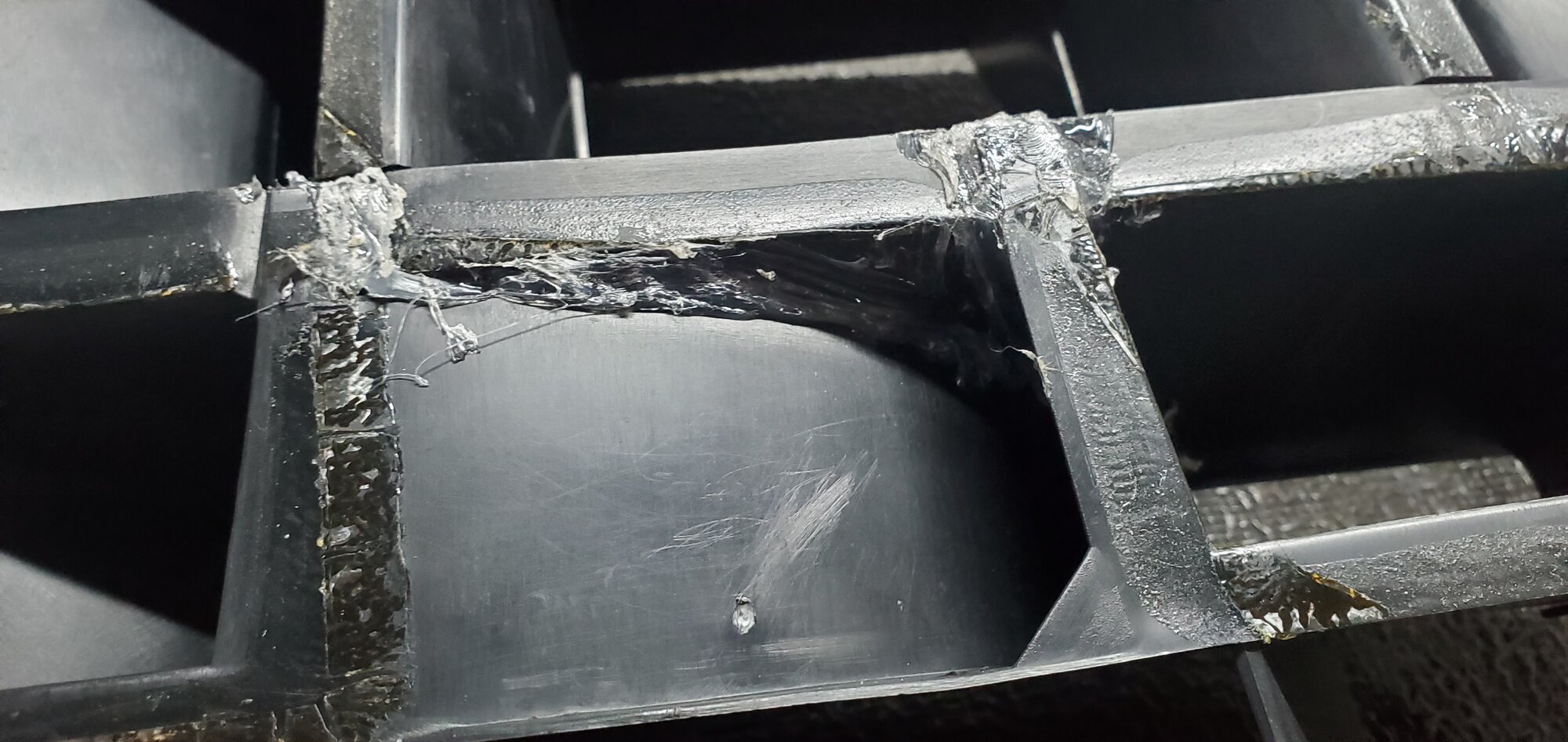

While I was replacing these parts, I also decided to replace all the material that had been dry-rotting from the blend doors, and replace all the other seals to prevent as much air-leakage as possible once I have the system up and running again. It was a long and tedious job, but I got it done, and glad I went that far.

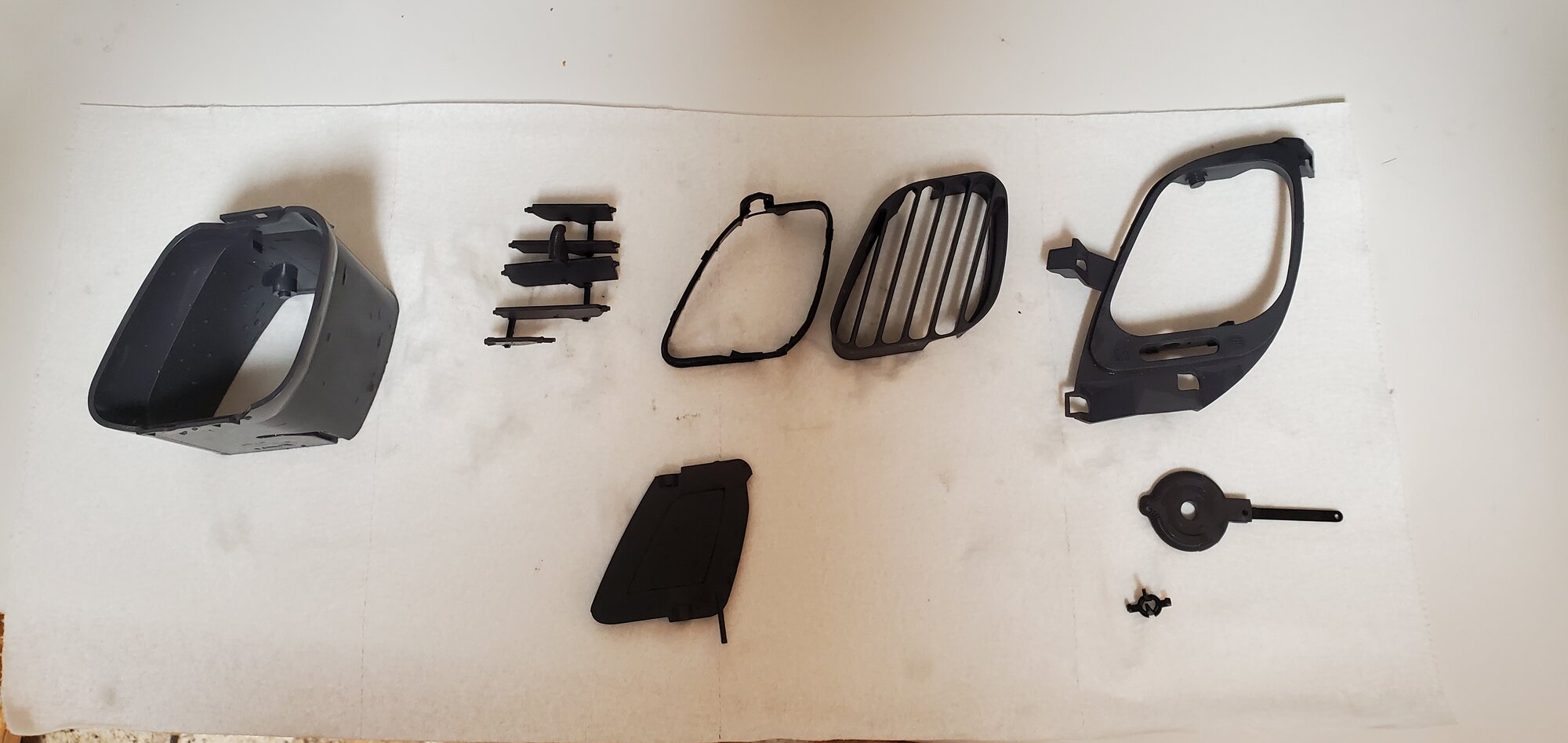

As you all can see, I even replaced the seal in a door vent. That was just the driver door since I already had the door panel off for the next item to update. I still haven't removed the passenger door panel, but once I do, it'll get the same treatment.

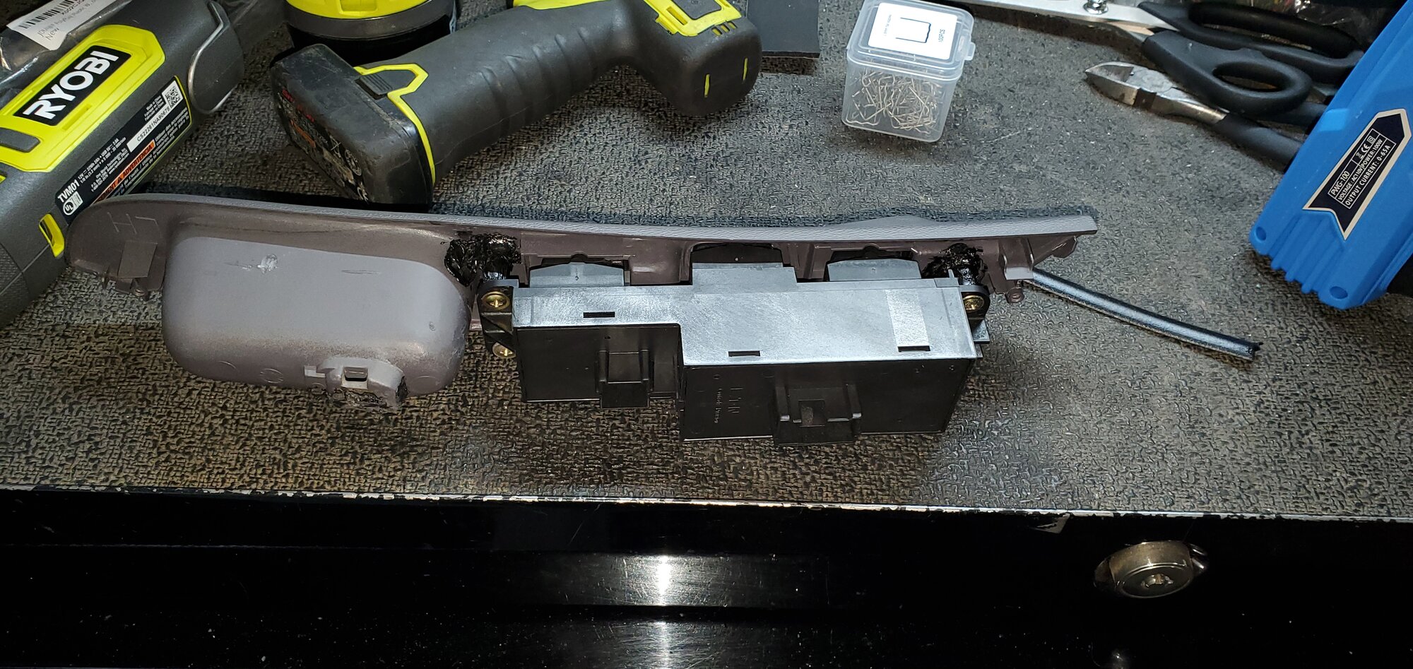

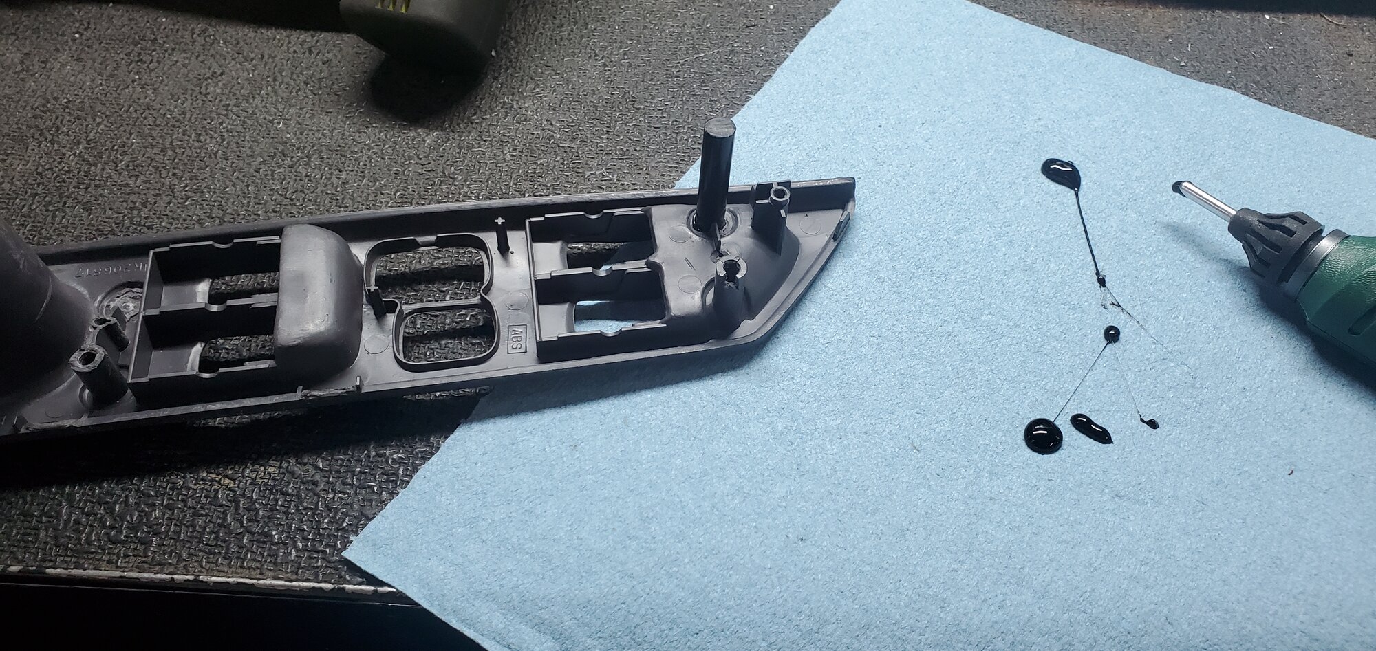

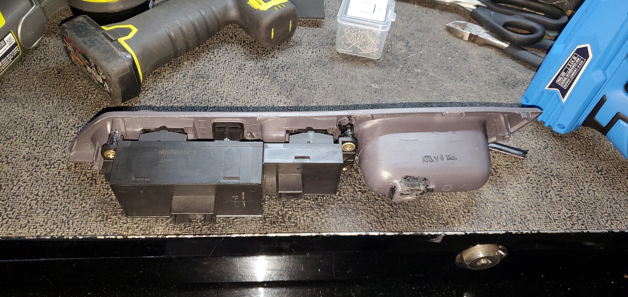

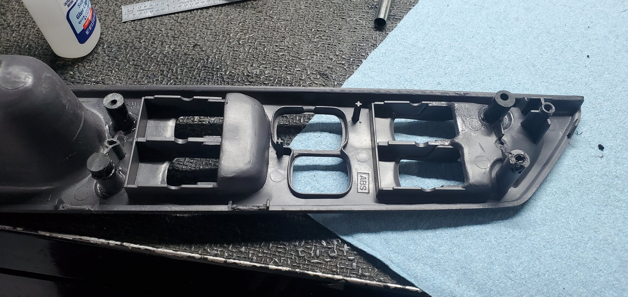

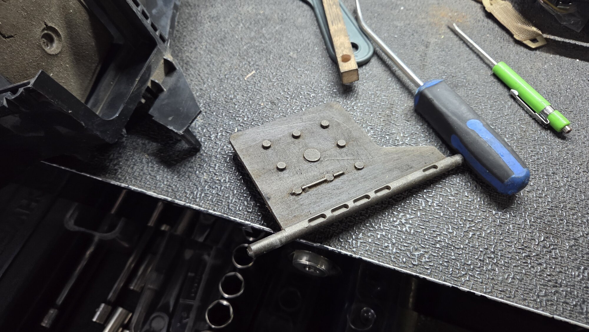

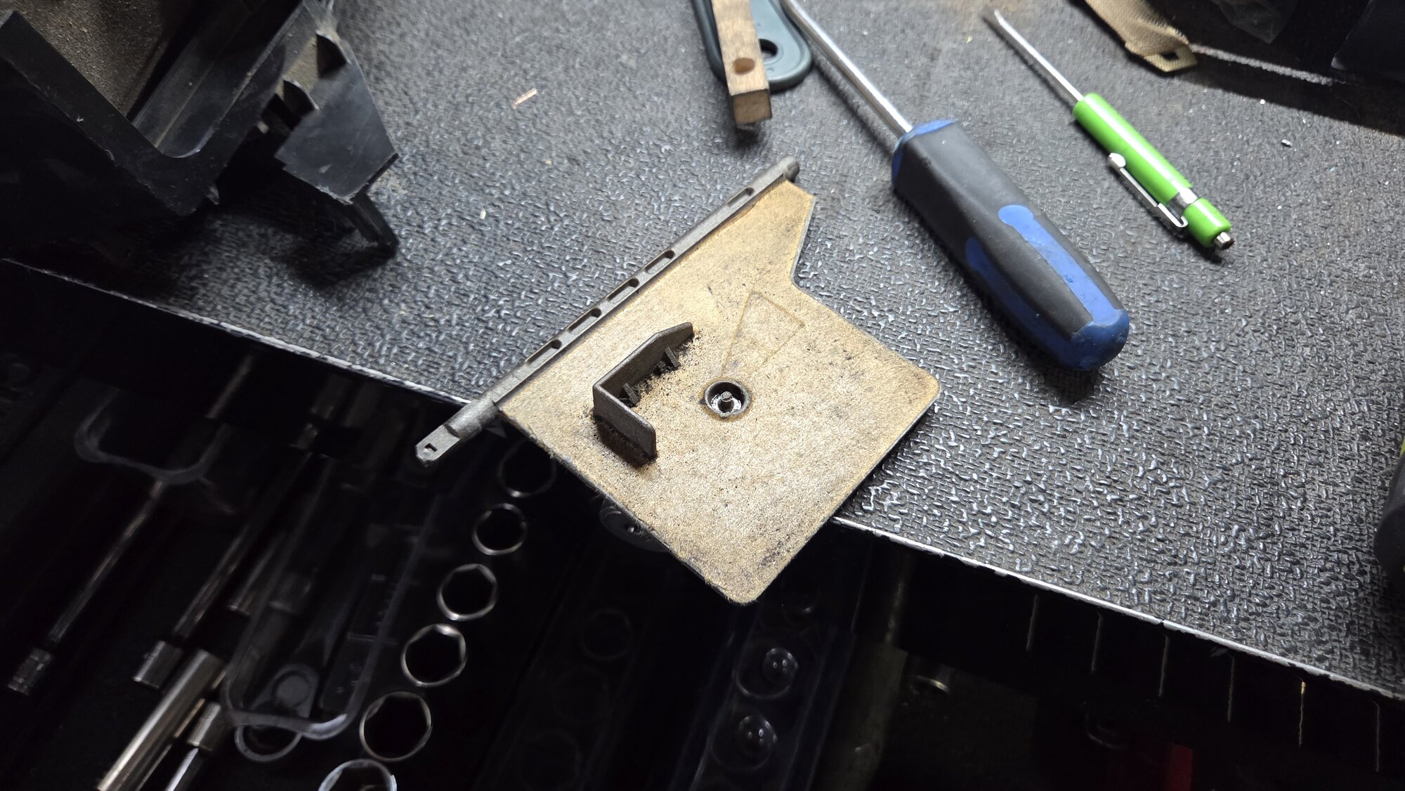

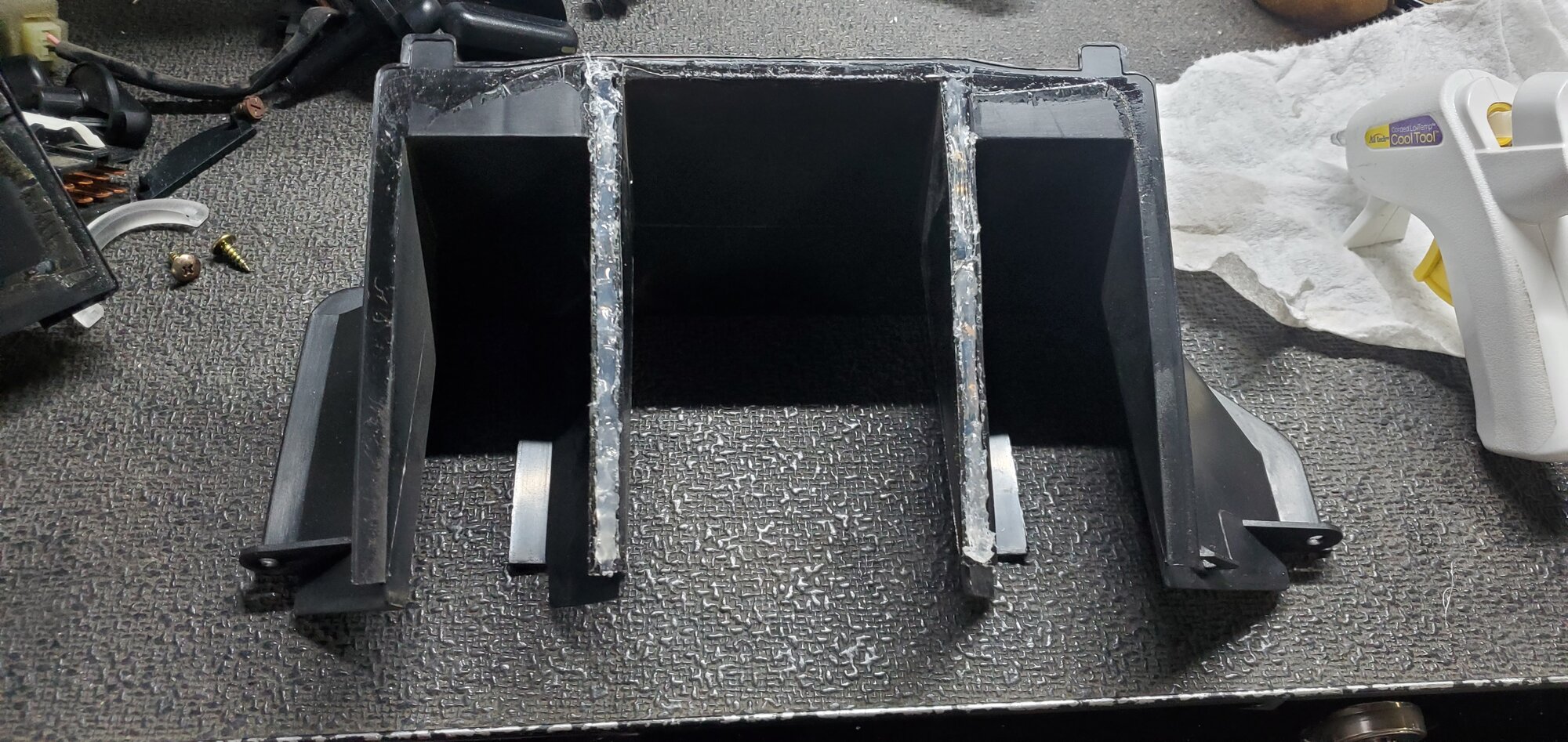

Next thing is the driver door window switch, or more precisely, the mounts for the switch assembly. We all know how brittle these are, and mine of course was no exception. Since I now have certain tools, I decided to try to fix it. So I bought some plastic rods from Amazon and a new, better, glue gun along with black glue sticks. Using the glue gun coupled with my plastic welder, I attached portions of the plastic rods to recreate the screw mounts on the underside of the trim panel. It seemed to work out for a while, until it didn't....
It worked for a few weeks, then one day the front portion gave out and went back to being broken. So I pulled the panel back off, and threw in another piece of metal with the plastic welder, and a lot of hot glue. It's solid now, but not sure how long that will hold. But it might. I made the glue flow in and around things, so it may very well never come off without doing it myself. That's good though. In the event that it does break again, I have a new idea to attempt, we shall see... one day...

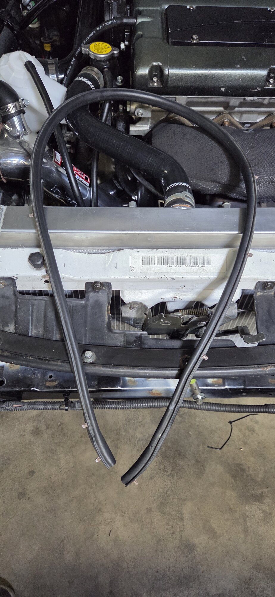

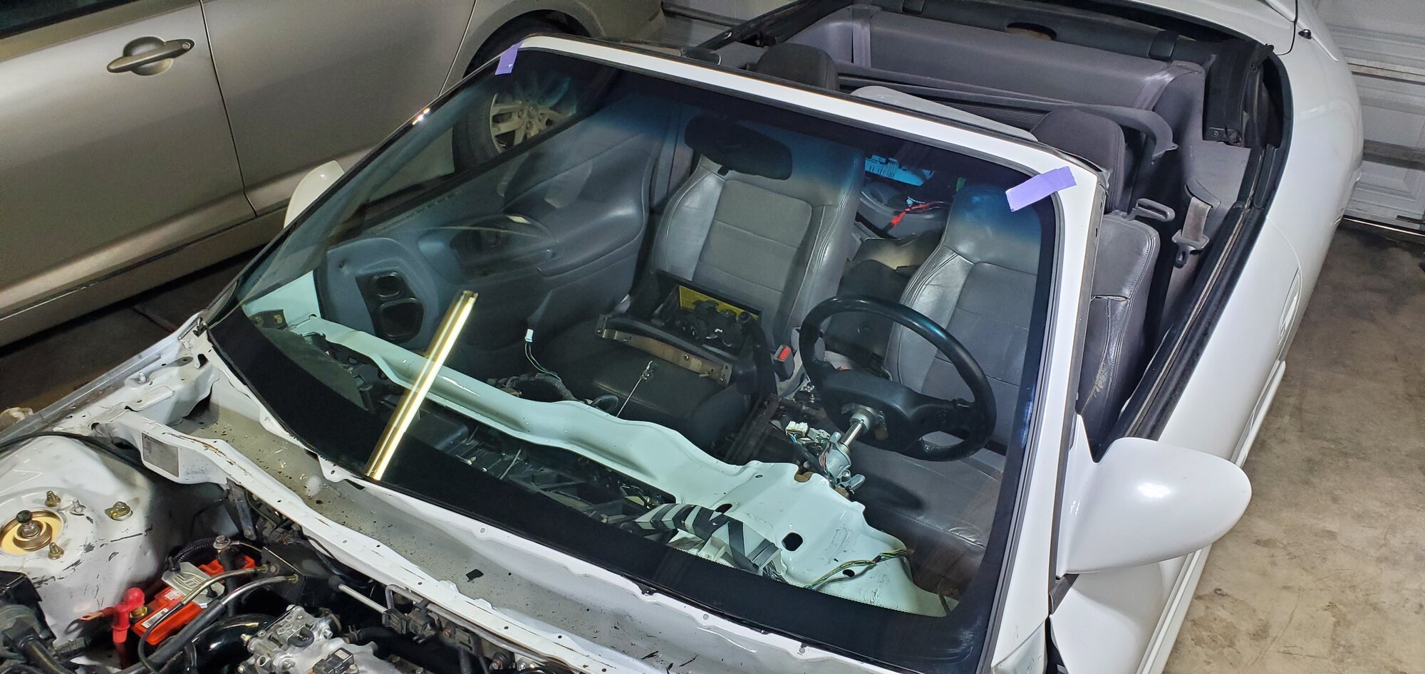

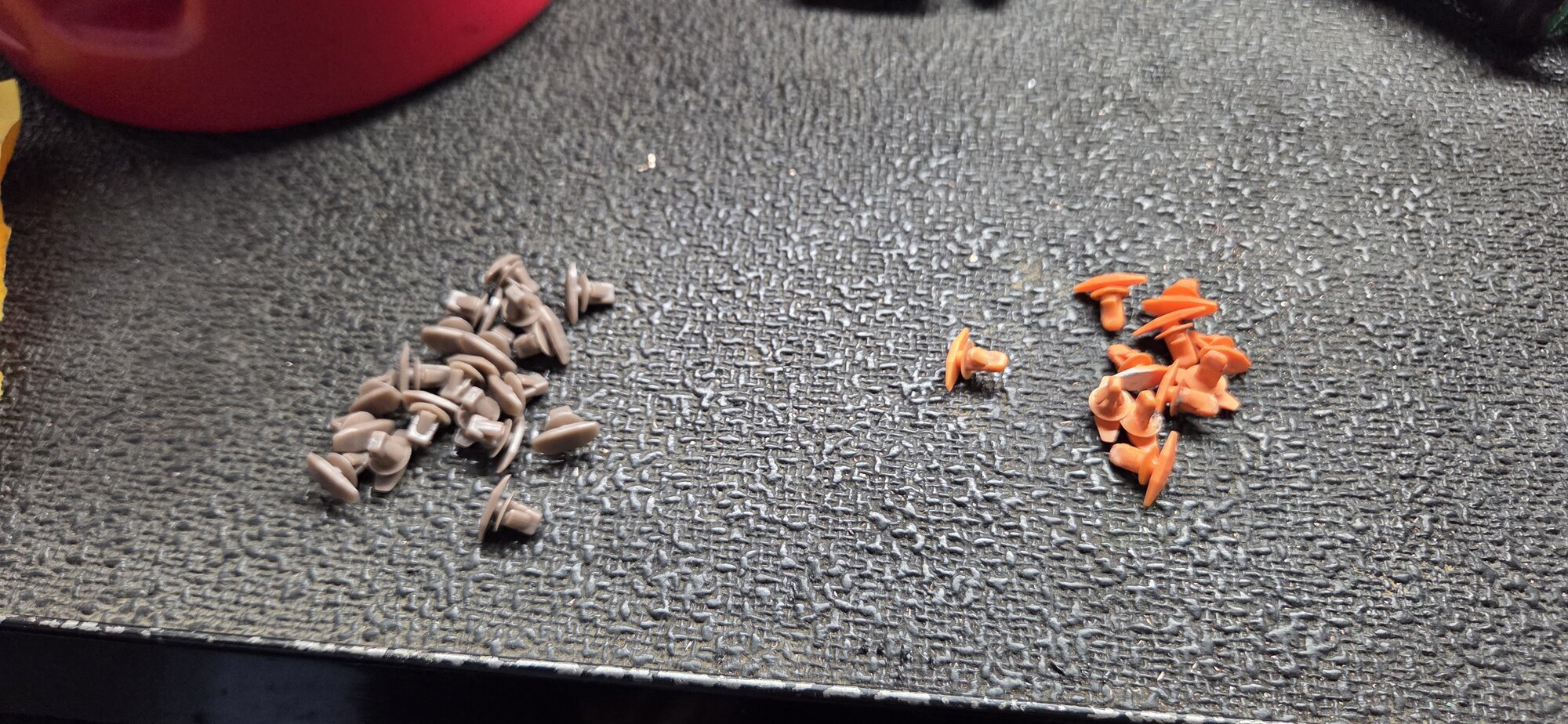

After the windshield replacement, I replaced my window sprayers with 3G Eclipse sprayers off Amazon, as well as the tiny clips that hold the seal in front of the window cowl at the top of the firewall. No more seal looking like crap from clips being broken.

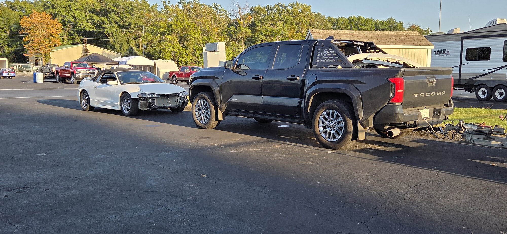

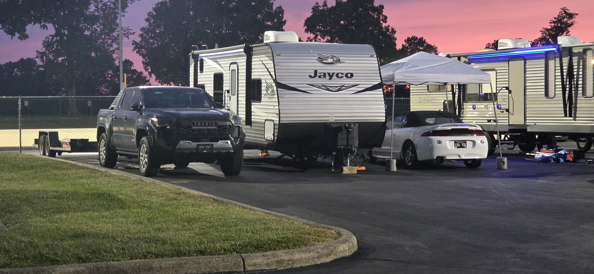

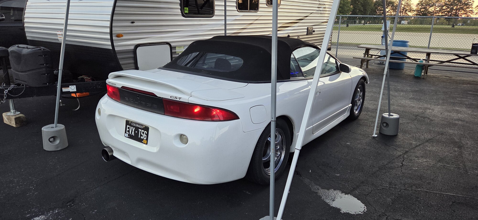

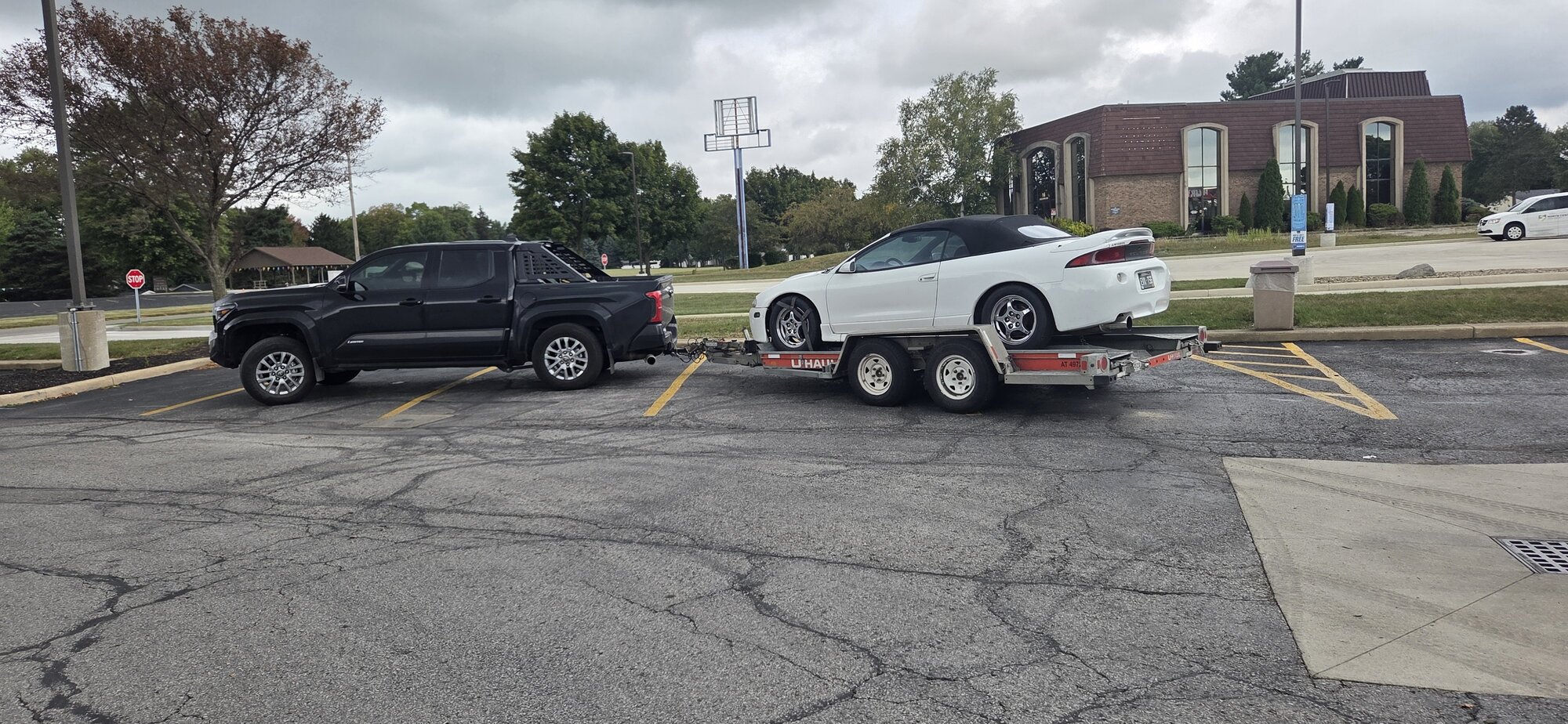

I also bought new tires and re-wired my aux gauges. This was all in preparation to go back to the Shootout. I hadn't attended the Shootout in six years, and this time I was determined to return with my own car. The last two times I went, the car I had wasn't able to go with me. I knew I wouldn't be driving it there though, and since I had destroyed my DD in March hitting a deer, I had already decided upon buying a truck. Which I did, a 2025 Tacoma. I know it's not the best option for towing a car across the country and back just for a weekend, but I wanted this truck to be my new DD anyway and it works out for everything else. I did have a Trailhunter model allocation in the color I wanted (Bronze Oxide), but things didn't work out with the car I had on loan to me until the truck was built and at the dealer. So I had to get one basically a month earlier than the Trailhunter was arriving. So I settled on a black Limited model that has mostly everything I wanted anyway, and was also $10k cheaper. Plus I got a full black interior which the Trailhunter does not get at all, and I prefer the black interior. Overall I'm happy with the truck and once I got the tow-mode to activate (user error), it towed the spyder fairly well with very minimal struggle.
After handling this long trip, there's plenty of plans I have to make it a more capable towing truck so that it'll be even better for next year's Shootout.

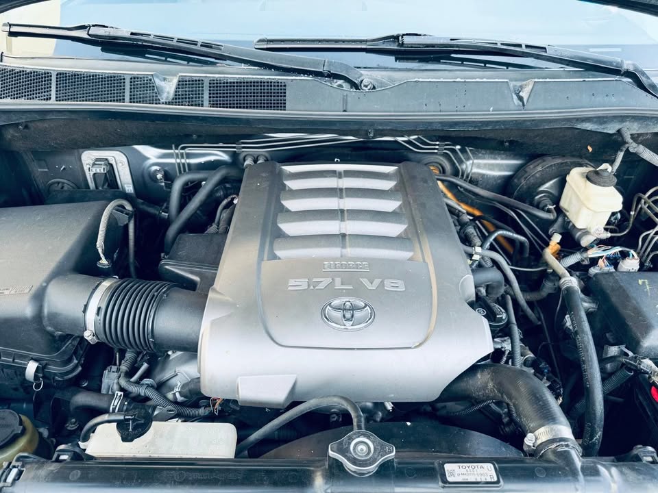

Before coming out to Ohio this year, I had only managed to get 18 miles on the engine. Not that great. However, while in Ohio, I've put another 110 on it and she drives quite well. Boost hits around 4500 rpms, but leading to that, she isn't really slow at building the boost. I managed 22psi of boost as well. I haven't been too hard on the car yet due to the OBD issue still being present, and the CEL is on. However I don't believe the engine light issue is due to anything major (yet) as the car runs well. I know I got three boost leaks to fix, among a few other improvements to make, but she seems very stable in idle, and consistent in how she's performing. I'm planning to replace the entire wire harness under the dash to rid myself of the OBD issue, but that'll be a long term issue as I need that harness specifically from a spyder. So the search is on. If anyone knows of one somewhere, please let me know. It's the harness with the OBD plug and goes to the ETACS and the doors (the door plugs are the reason it's spyder specific). My goal is to hopefully race the spyder at the Shootout next year, so along with the few improvements, I have mods planned as well. Not much time to make it happen, more to come...
I just picked up a Tundra yesterday. I knew I wanted a truck so went with the bigger one so I could tow more and carry more weight. Its a nice truck for the year and looks brand new! Im excited to be able to drive to the shootout next year (except the distance LOL) 16 hrs is not a fun trip
Very nice. I'd love to have a full size truck, but sadly it wouldn't fit into my garage. Even the Tacoma with only the 5ft bed barely fits. Don't want to leave it outside since we get hail here seasonally, and more frequently this year.

For all that work under the dash , what material did you use to replace the dry fuzz in the evaporator , heater and blower assembly?
I’m currently in that same process myself and wanted to make sure it’s well sealed, but was unsure of options.
Also the seal on the top vents you showed I noticed that peeled off.

These are the materials I used, both from Amazon:
So far it seems ok, but I don't yet have the system complete, so I won't know until that happens.
