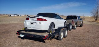

I found this GSX right after my 99 GS's transmission seized while heading to work one night. I wasn't really searching for one to buy, but was just browsing craigslist. It caught my eye since it was a GSX for only $1000, and I thought something was wrong with it. It turned out that the owner had an issue where it failed to start for him one night, and he bought a truck the next day. Then fixed the car and just parked it at his mom's house because he was just done messing with it. Fast forward to now. It had just been sitting for two years alone under a tree getting its clear coat baked off. He said he only wanted $1k since it had been parked and he didn't know if it'd still start up. So we hooked the battery to a his truck to jump it, got nothing. I messed with the battery cables and secured them better, and she started. A little rough at first, for the obvious reason, but shortly just started purring like she had never been sitting. We then noticed fuel dripping from the feed side of the fuel rail and quickly shut it off. It needed a new o-ring, and it had a flat tire, so no test drive, but after my inspection of it, and getting to hear it at least run, I knew I wanted it. So my wife and I talked and asked him if he'd be willing to hold it for us for two weeks so that we could gather the cash and come back. He lived an hour from town, so with our work schedules, and now one running car, we had to wait to come back. To our surprise, he agreed, and didn't even want money up front to hold it. His only requests was that his car went to a good home where it wouldn't be riced out and abused. So I showed him pictures of my old spyder and others I've had and he was satisfied. So when we came back, I had new O-rings for the fuel rail, he had the tire issue resolved, and I finally got to test drive it. Most of the switches inside were bad, and didn't work. It was a bit dirty from sitting so long, and had a nice collection of pine needles, but nothing was nasty at least. It drove well, and I was even more convinced I wanted it. The owner even admitted he wasn't so sure he wanted to sell it after the drive since it had been his first car, but now it's mine. I didn't try to lower the price on him since he was upfront and honest about everything, and it all checked out. And since it was more sentimental with selling it, I didn't want to add any bad feelings.
So I paid him, promised to give him updates once in a while and drove off. She runs pretty good after being revived from two years of sleeping, and I couldn't be happier. There are a few little issues, but that's to be expected from a 23 year old DSM. I want this one to be a perfect DD with some extra power, but looking mainly to keep it original. The only issue there though, is I want to keep it a 2GA car, but still like the 2GB body more. We'll see. Depends on if anyone buys the GS. If not, I may do the body swap, but will still keep the 2GA parts so that I have all the original pieces, minus the interior. I'm changing that to black regardless of the 2GB swap.

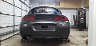

Finally took some better pictures than I already had, but due to my busy work schedule, these are all at work. So they're not very interesting, but show it better than the pictures I took when I bought it.

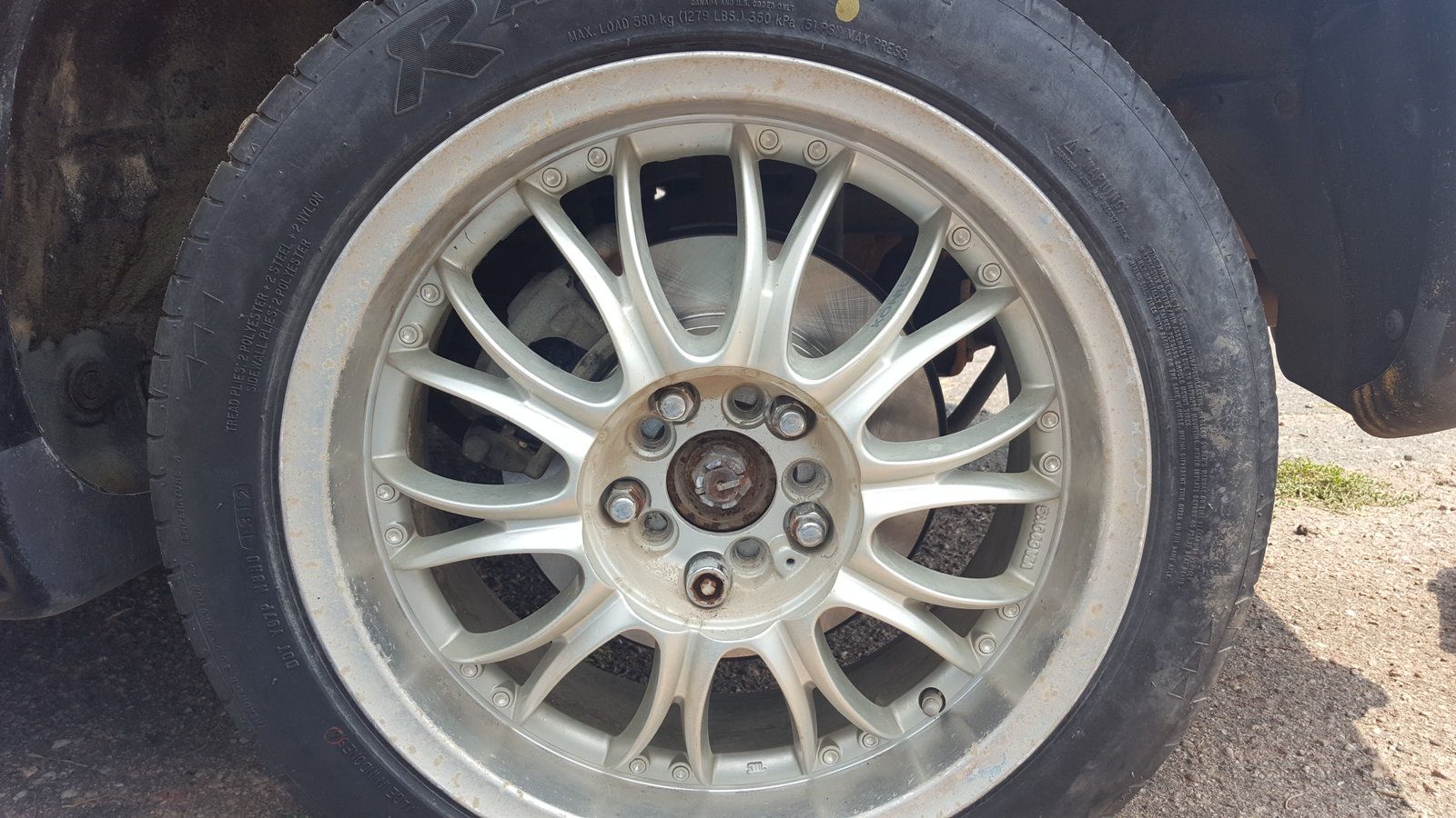

We also got a storm warning on Sunday for 80% snow and up to 4" of it. So I put on my OZ wheels I kept from the OZ GS so I'd have something other than summer tires with nearly new tread....
...Yet this is all the snow we got :D Oh well, I'm ready for the snow when it really comes.
