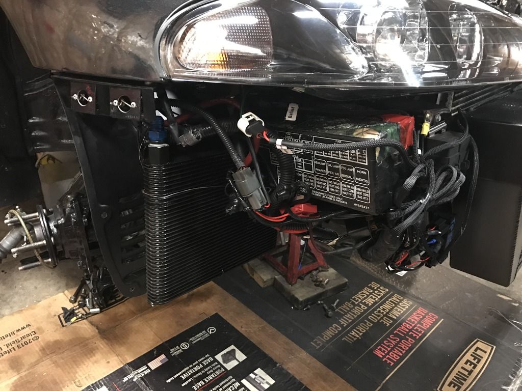

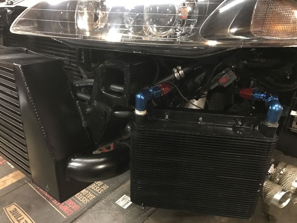

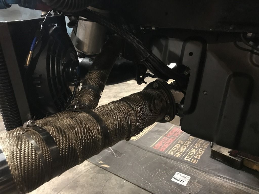

Wanted to mount a fan and get a little better setup for my oil cooler. Made a small frame work out of 1/2" angle and mounted my cooler and fan. Then found a good spot to attached it to, choose the inner frame and positioned it so not to affect mounting the bumper cover or getting the dump tube and side exit in there. Had to make up different AN lines for the oil cooler so I went with the blk FTP line I've been using in the engine bay. It's so much easier to work with instead of the SS line.

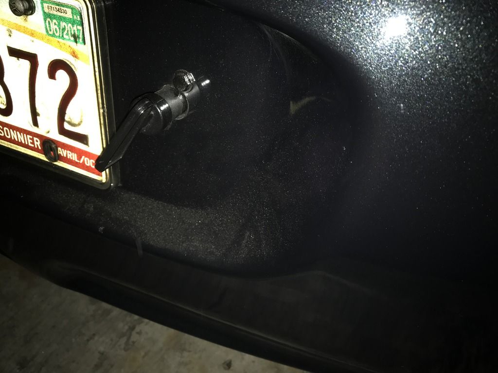

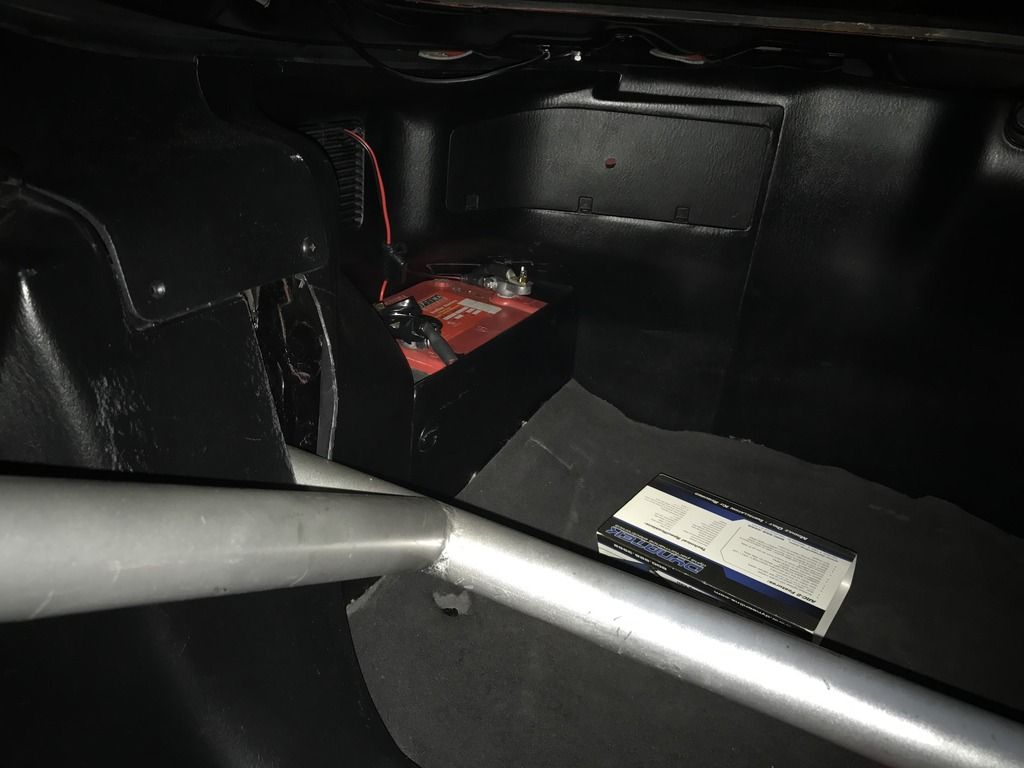

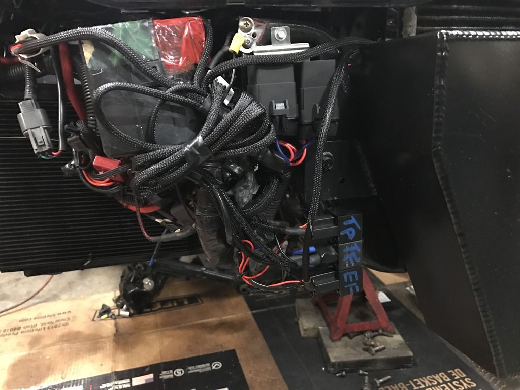

Next, I moved my battery from the front area by my main fuse box to the rear of the car and also installed a main shutoff switch.
So now since I moved the battery to the rear, this opened up room to have all my electrical reside here. I put my trans pump, trans cooler fan and oil cooler fan all on 12v relays and mounted them as well as the relays for my HID retro fitted lights.

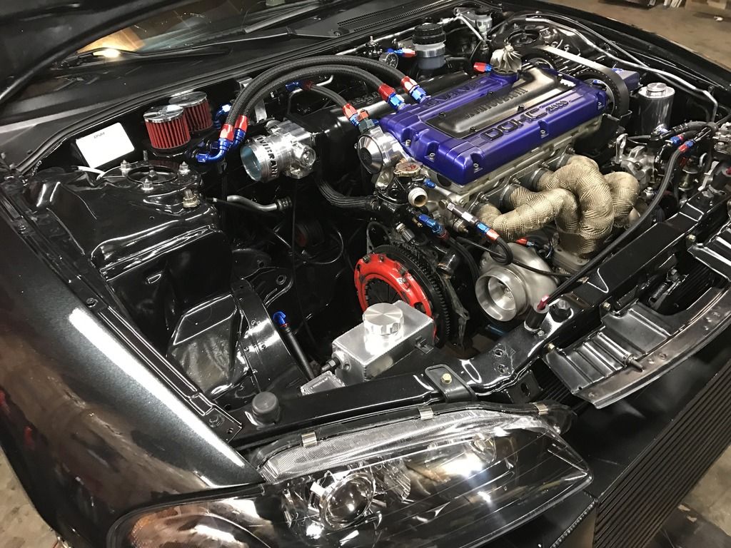

how do you like the magnus intake manifold? Was considering it over the JMF sheet metal manifold.
Wow super surprised your running a TMZ SBC clutch kit! What spec is it if you don't mine me asking, as well why this over a Twin Disk setup?
Thanks,
Its full ceramic B-series and I ******* love it. Really, it reminds me of my old 2600 for street driving around town and that's what I use the car for now mainly. I'm still gonna drag race it a bit but for the most part it's a street car. I had a QM 6 post full race (flywheel and disc) in the car for a summer and it was a complete f***ing nightmare for me, destroyed my syncros and just made the car a pain and I didn't want to drive it and that pissed me off cause I love to DD all summer. So after speaking with Tim and doing my research choose this clutch. Last summer was my first time running it and mind you I never put the car on high boost but I did make some 9800-10000 shifts and it was no issue, That was my biggest concern going back to a single as i hate getting locked out og any gear.
I would love to try a new QM 8 post with some street discs sometime maybe as I know lots of guys run that setup and like it. The QM race TD just didn't work out for my car as it's pretty close to 3250lbs.
Thank you for the insight on your clutch choice. You have the exact same clutch that I just pulled out of my parts car. It has the B disk as well and makes sense since this parts car was putting down 600 on E. Maybe I will get it refurbished and have it as a back up clutch. Knowing your happy with it makes me feel more confidant about using it.
No problem. Yeah I'd certainly try and use it if there's nothing wrong with it. Nice clutch IMO

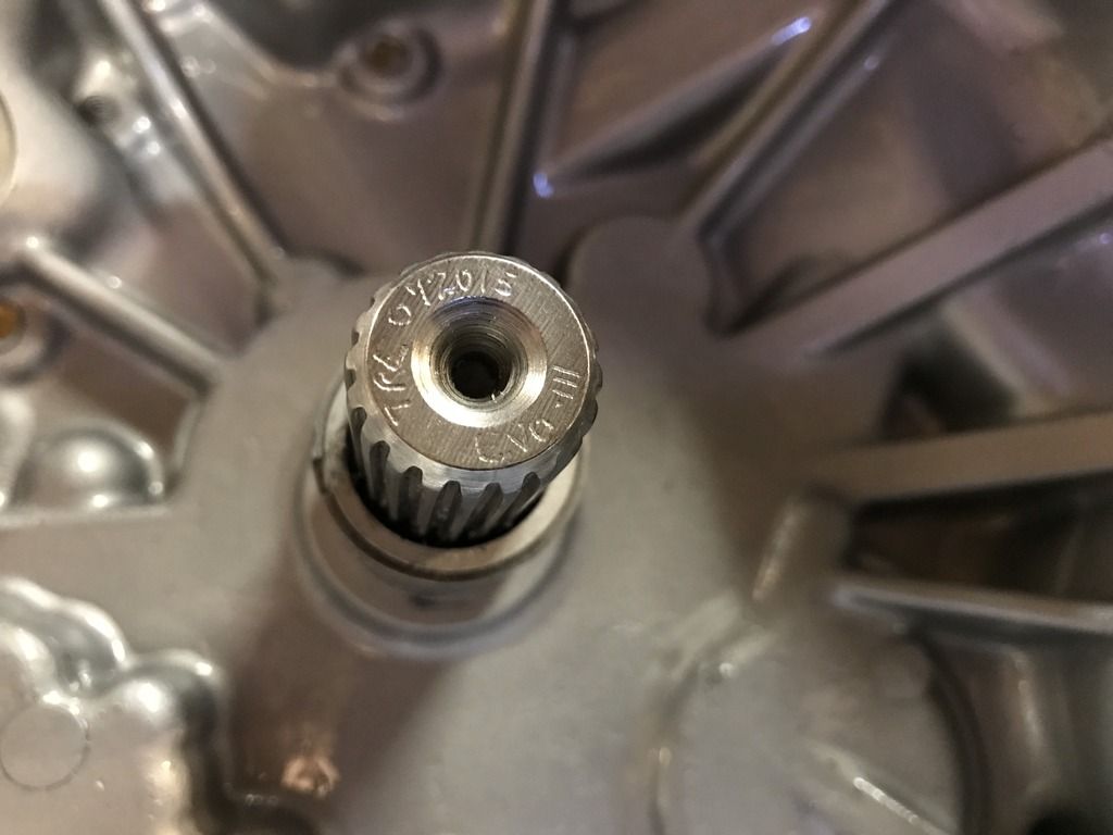

couple pictures, noticed the input shaft just shining and seen this engraving. That isotropic process leaves a nice finish.

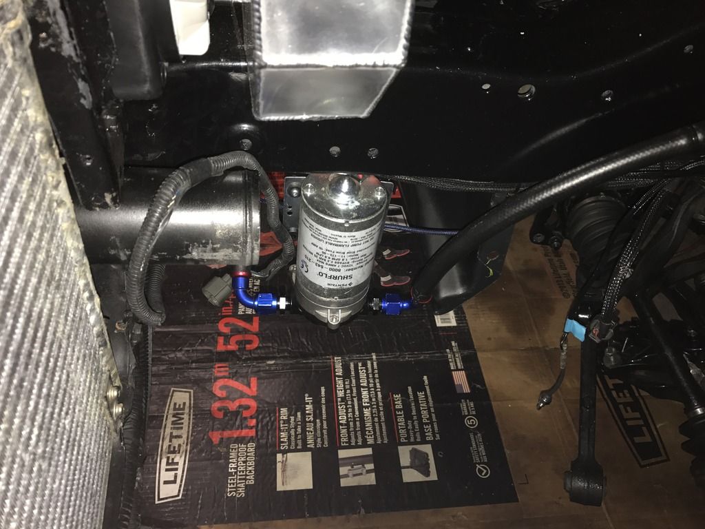

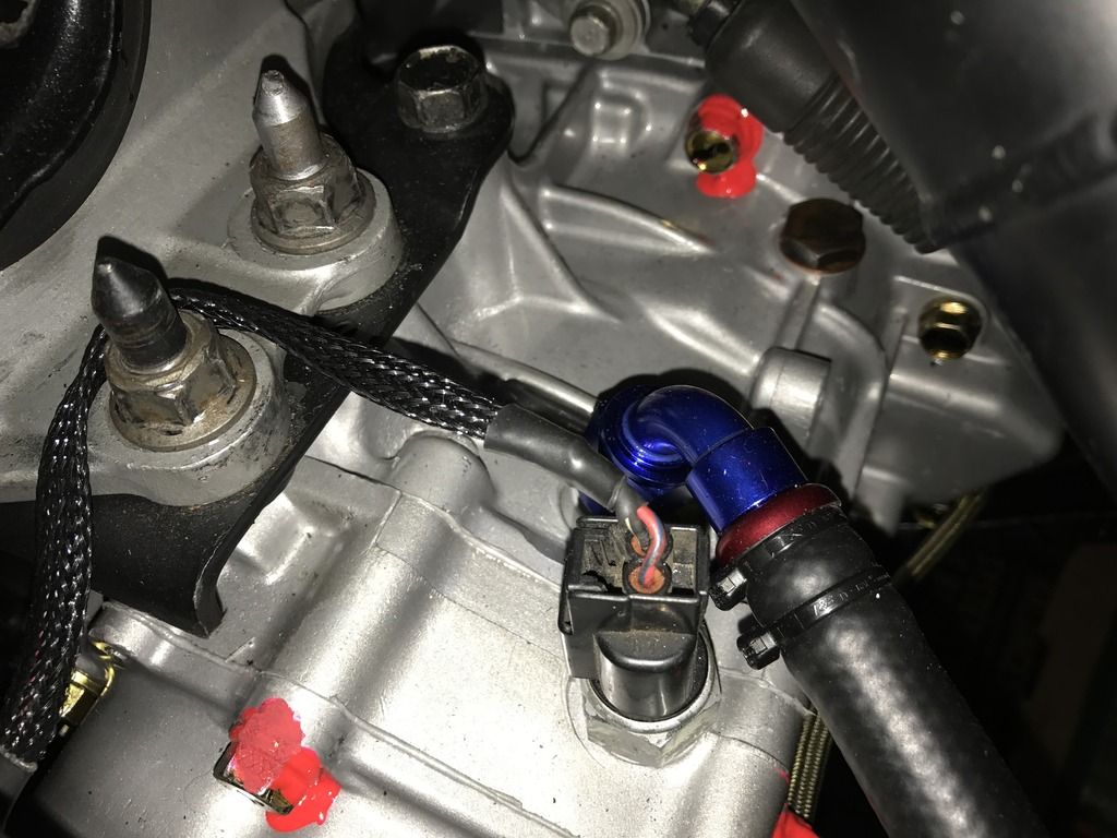

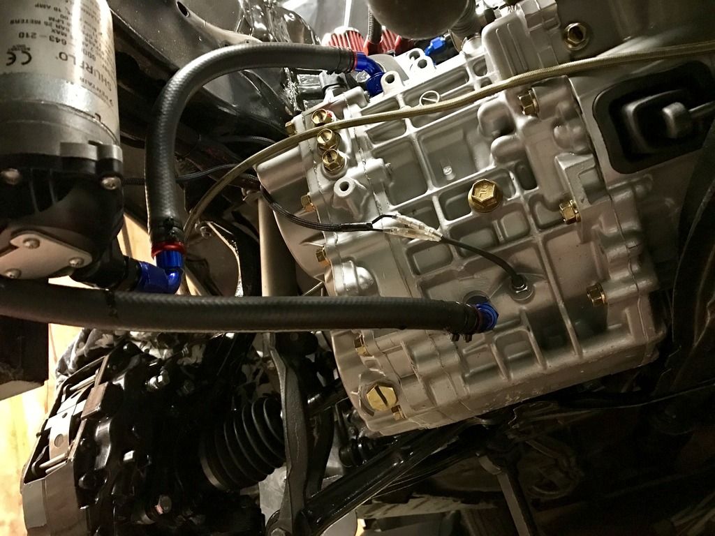

So bit of an update regarding my trans cooler setup. Welded the fittings and moved the suction point from the drain plug to the spot you see in the picture also drilled and taped for my temp sensor.

I really hated the idea of moving the fusebox by the wheel, but this one is clean!

I actually relocated my underhood fuse block to the stock Side Mount Intercooler location very similar to him. Instead of terminating all left over plugs - I secured them in a similar spot as his. Now when I install the engine and engine harness I should only have to lengthen a couple connectors and a power wire down in to there.
OP....I really admire your trans cooler setup. It's what everyone wants but never does on the m/t
