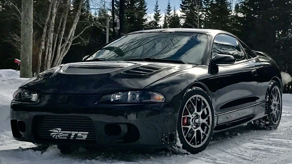

Does that hood keep things cool underneath?
That's the only reason I run it. I prefer stock but this one is growing on me and the way it evacuates heat is like nothing I'd experienced before, and with these cars at my hp level, heat is my biggest enemy at least it was for me.

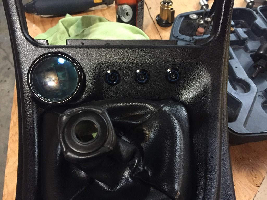

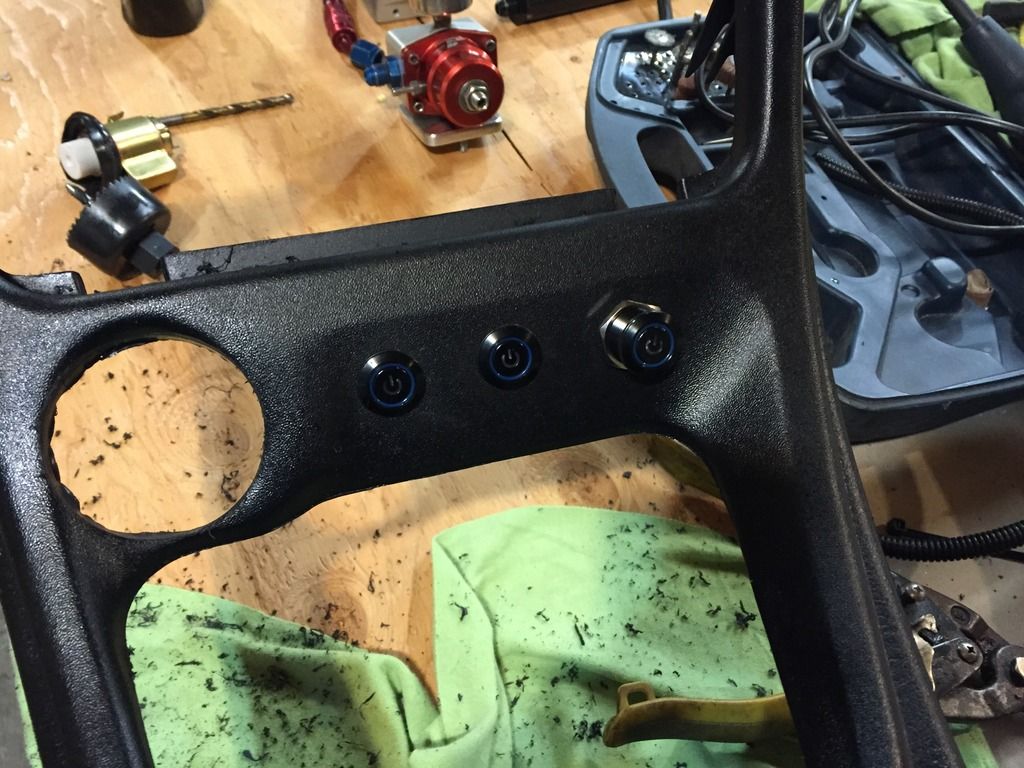

First thing I tackled was to install the three new switches I aqquired to run my transmission pump, cooler fan and engine oil cooler fan. These are all on their own relay and the switches I've installed are controlling the low amp side of the relay. I really like the quality and flush installation fitment. They're blue LED and are a push in and latch style, the outter ring lights up when they're on and only the power symbol is lite when they're off.

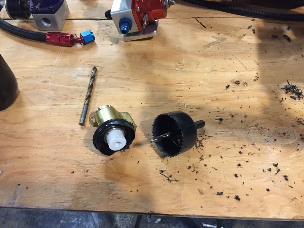

Next I proceeded to drill out my cig lighter so I could install my dual engine and transmission oil temperature gauge I picked up, it was cheap and looks to be made by the same outfit that makes prosport stuff. I ran prosport years and years ago and they always seemed to work good, I just hated them LOL. But when you're looking for a duel temp gauge your choices are limited, so I went with it, oh and the read out blue LED as well to match switches. So here's what I did to drill it out, I just machined a small piece of nylon in order to act as a guide for the drill bit and the hole saw. I used armour-all as a cutting fluid and it worked out great, just drilled slow to keep heat down.

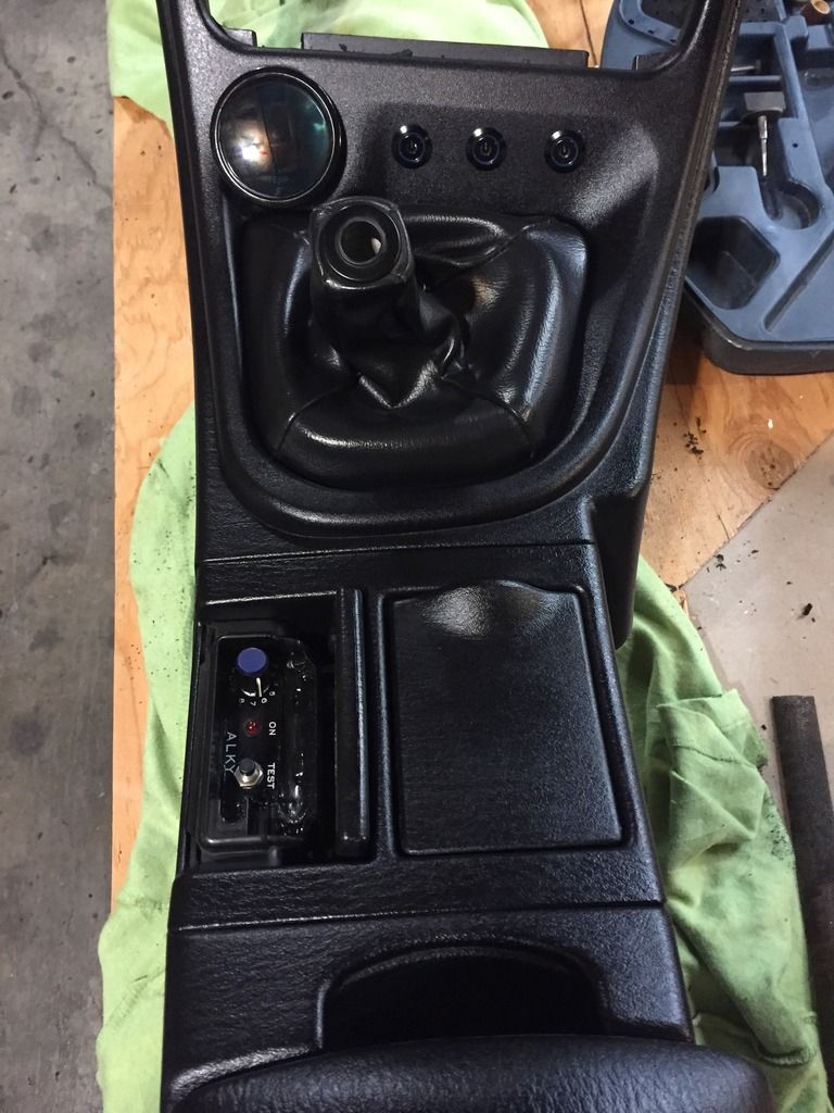

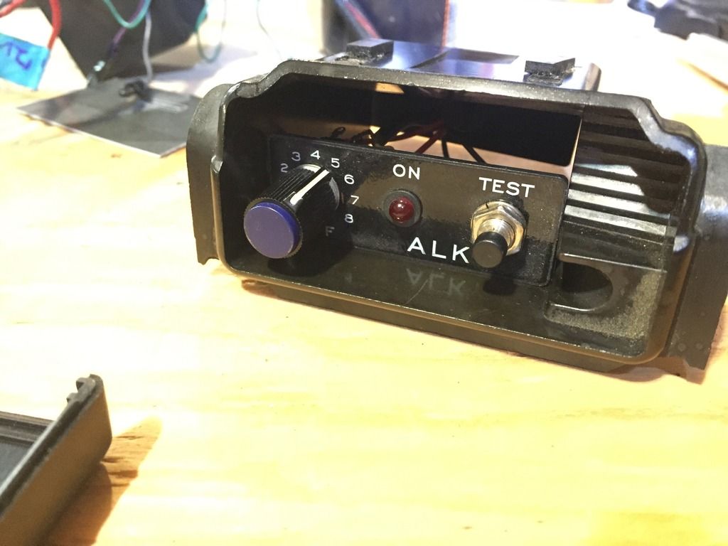

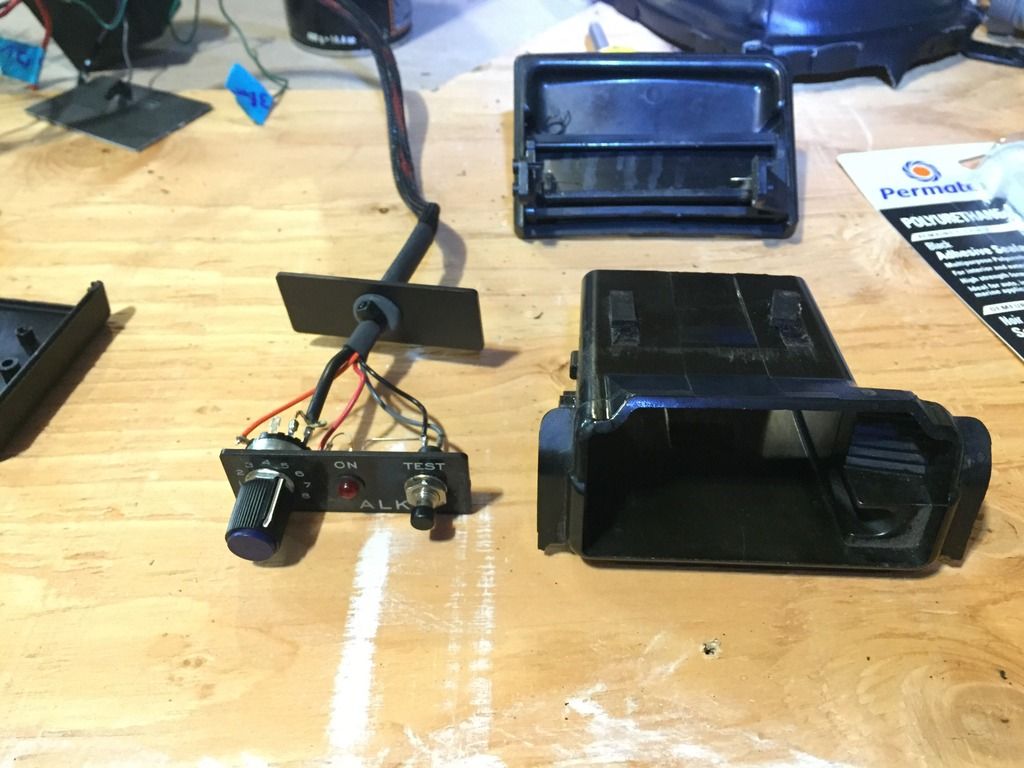

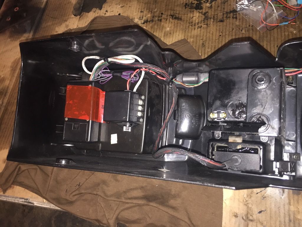

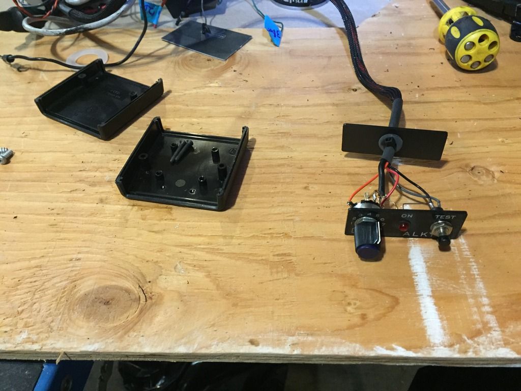

Next I wanted to get my methanol controls out of my glove compartment and my ash tray was looking like a valid spot and I had an idea to get it to work with the existing ash tray space.

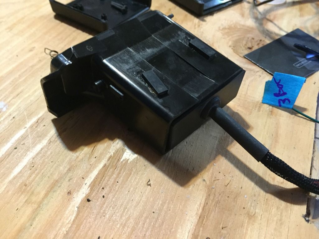

So first I disassembled the controller as it was just a bit to big to fit and I knew it would if it was apart. I then mounted it into the space with some epoxy and black urethane. worked out good and easier to get to as well.
This is where I mounted the control box I just used epoxy so tape holding it on till it setup.

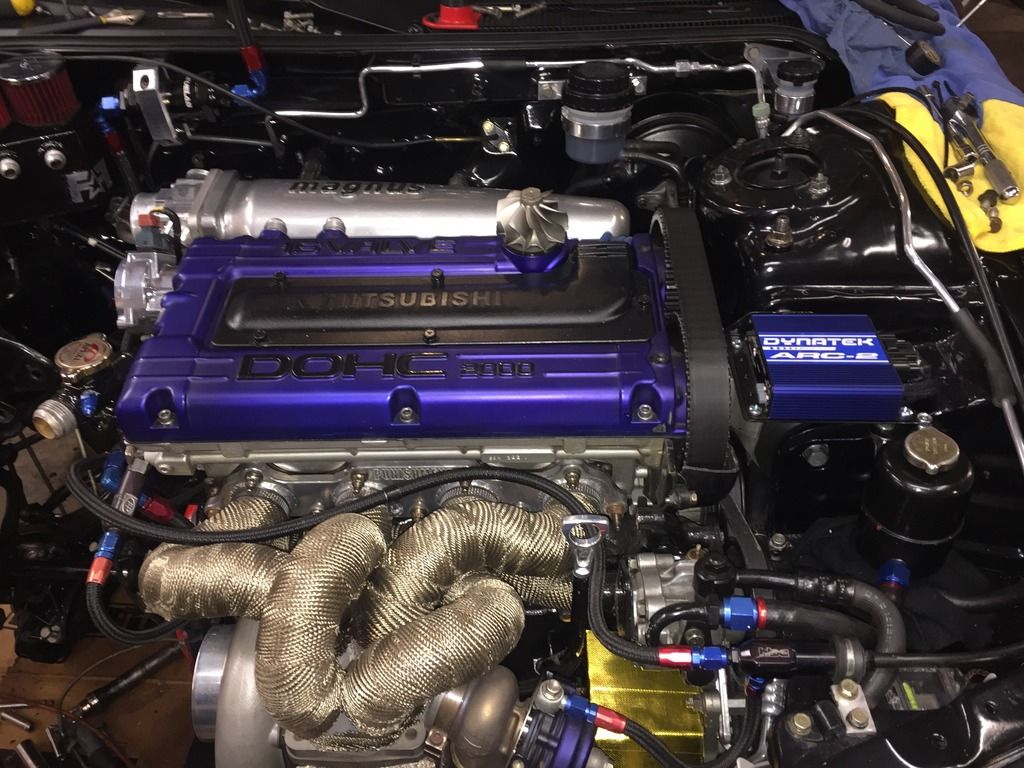

Looks great man! Your engine bay pic is awesome. Braided -an power steering and Mbc lines, turbine oil cap, bad ass manifold etc...

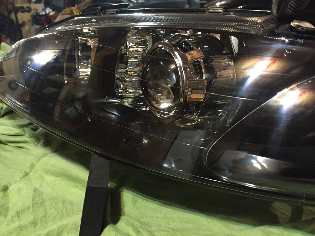

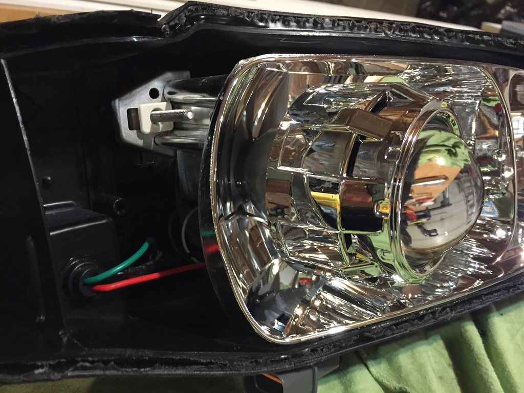

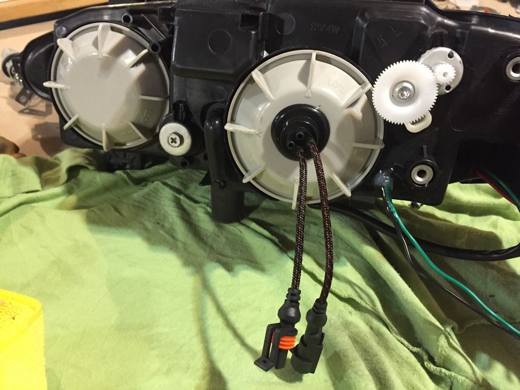

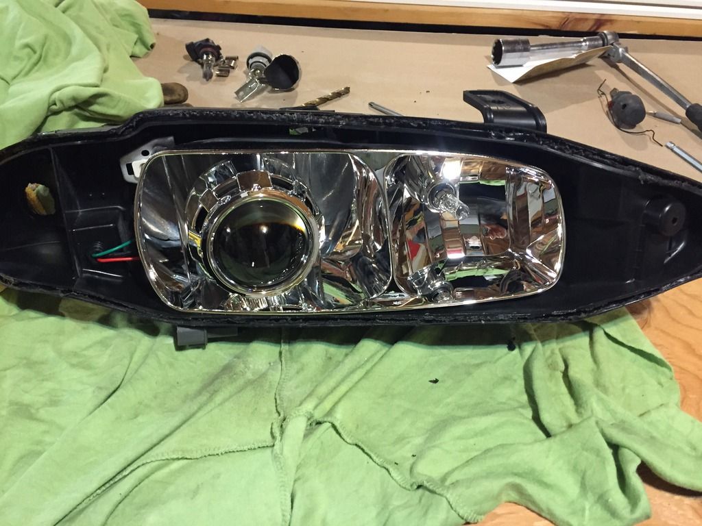

So next was my headlight HID retrofit using OEM style lights and Morimoto H7 mini Bi-xenon projectors. Morimoto quality is very good IMO their optics are awesome very crisp cutoffs, even the relay kit, wiring, all top quality stuff, I was pleasantly surprised.
I like the H7 mini as it has a bulk head fitting built into the projector that fits through the original OEM light bulb hole in the OEM reflector, so mounting them is pretty easy and you still retain the factory headlight adjustments. Now you'll need a dremel tool to modify the back of the reflector so the nut and washer can sit flush tightening the projector in, it's really pretty easy. MAKE SURE THEY'RE LEVEL meaning your projected cutoff is level horizontally. It's easy to get them off a bit, so light them up(projectors in the headlights) before you commit with any JB weld (which I used as added insurance to hold projector in the OEM reflector) and do the final tightening of the bulk head nut holding in the projector.
I used the heat gun in a card board box process to open up and close the headlights, it works great. Gotta use common sense tho, have the box big enough so you're not pointing the heat directly at the headlight in anyway and seal the box up tight to keep the heat in. Leave the headlight in there for approx. 10 mins, wear gloves and work quick when you pull them out and the lense will pull right off. You may have to reheat the headlight, if it's not hot enough the first try. Google or youtube the process, it's pretty simple.
Here's some pictures
