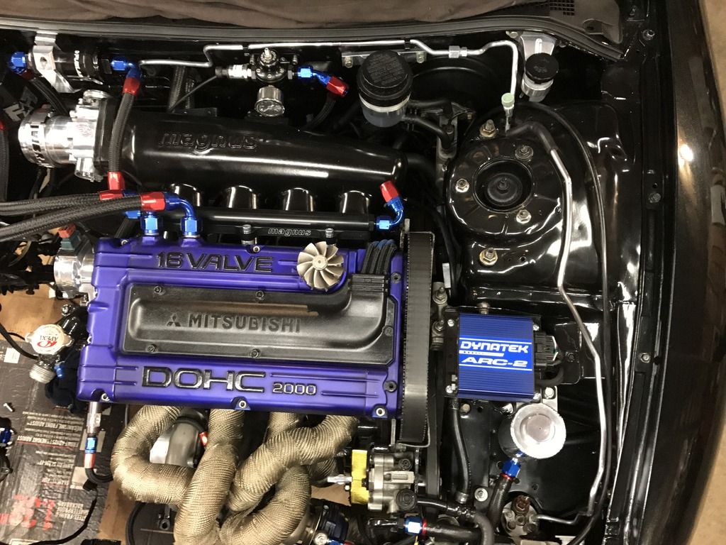

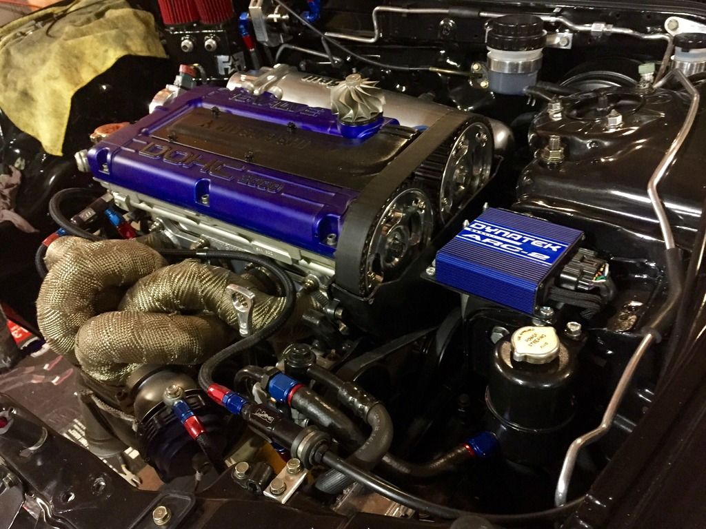

Mounted my ARC2 box and de-pinned the ARC2 harness and made my own with some braided nylon loom and 3:1 heat shrink also tucked the wiring out of sight. Then I mounted my coils on top of my AC compressor bracket and got the wires covered up. I much prefer the coils out of sight and wires too.

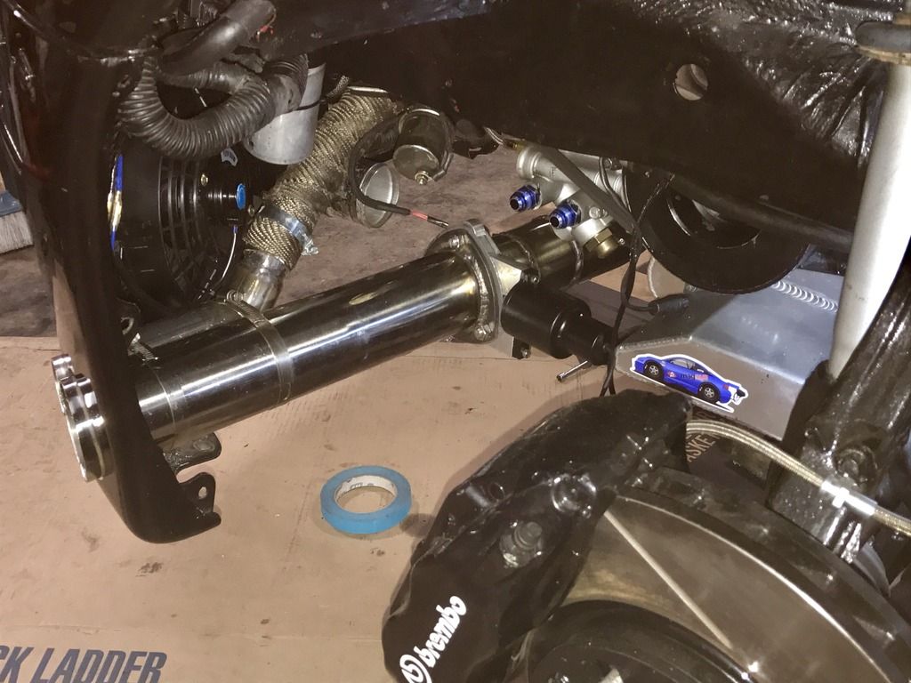

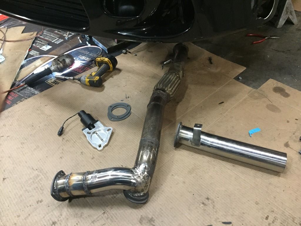

So I've wanted to do this for some time now and sense I've had an old 1G meagan DP hanging on my garage wall, (decoration I guess LOL) I cut it up and put it to use. So I went with a QTP exhaust cutout valve and I'm happy to say the quality is like I'd expect, and price isn't too bad. That angle was difficult for me to achieve where it Y's off but after some cutting and rewelding, I finally got something I was some what happy with. This will aliveate any back pressure issues I might of had and piss off my neighbors a bit more. I still have to fab up my wastegate discharge pipe as it discharges right beside the exhaust outlet and then cut both of them at the same angle where they exits the bumper. Here's a couple of pic of what I made.

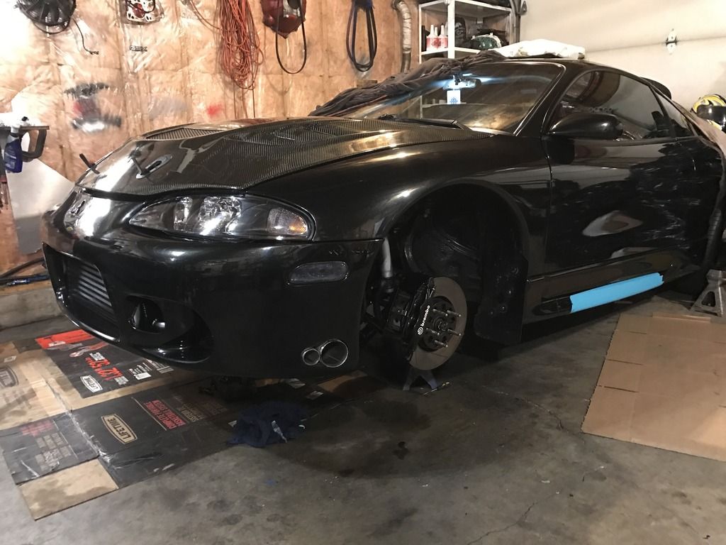

So I've been working on the car and thought I'd share some progress.

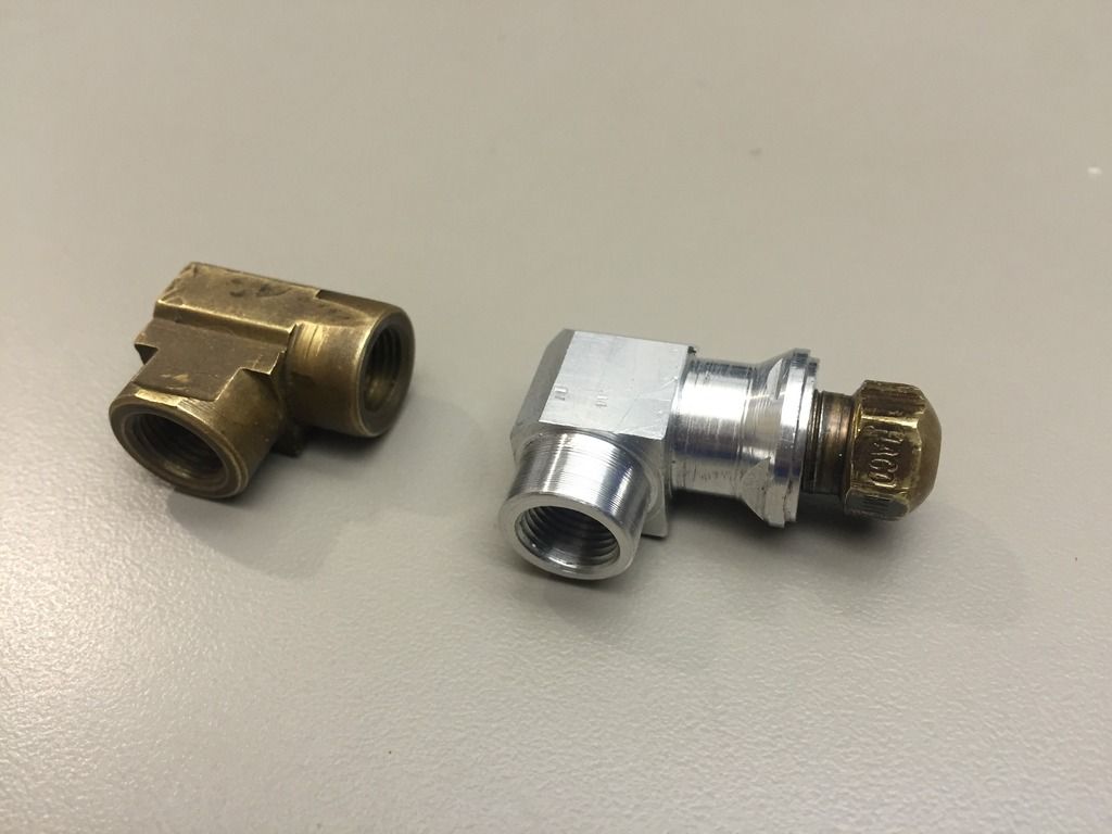

Here's an aluminum meth nozzle body built to be welded into my new UICP I've got to get fabbed asap. Original setup always leaks a bit of boost during a BLT

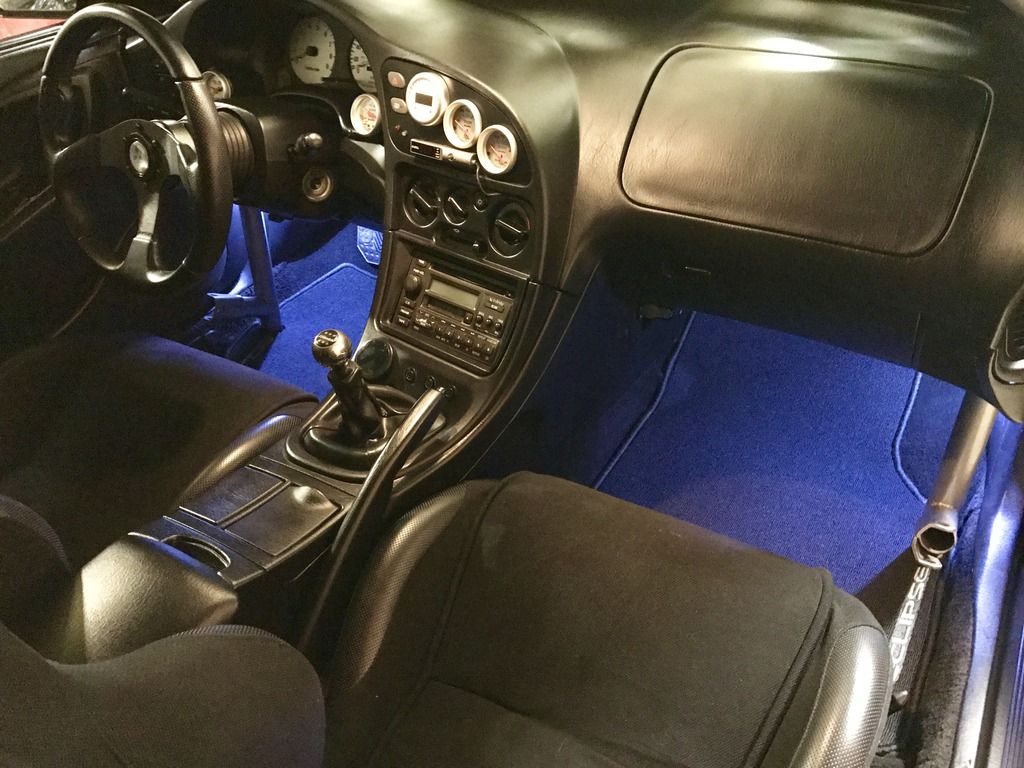

Got some OEM black floor mats for Christmas and switched lighting over to LED, got them notched for the cage which was a PITA. Happy with the results tho

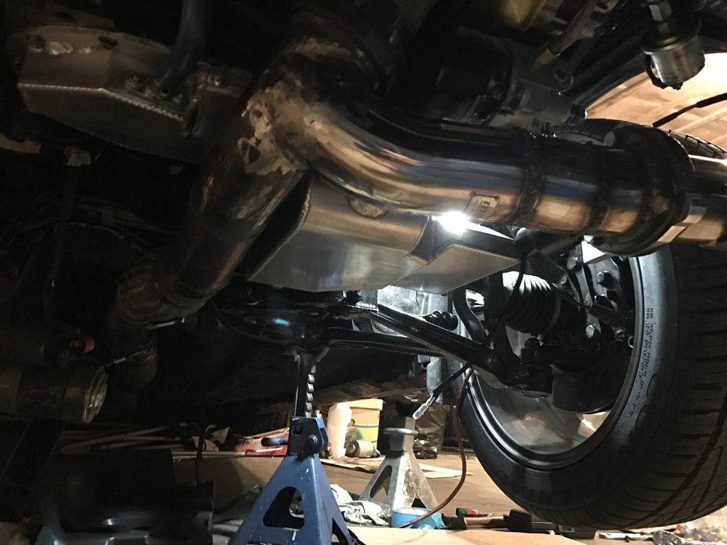

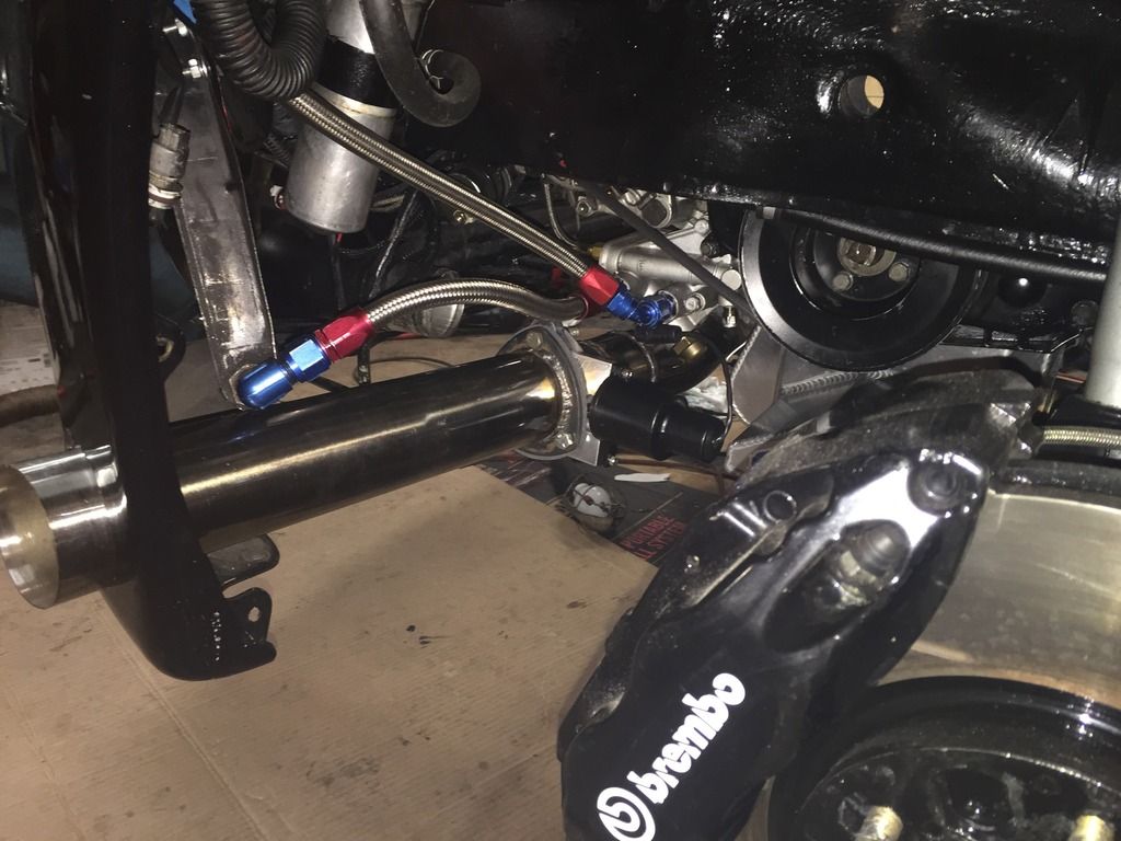

Next got my side exit exhaust finished up for the most part, still gotta wrap the down pipe.

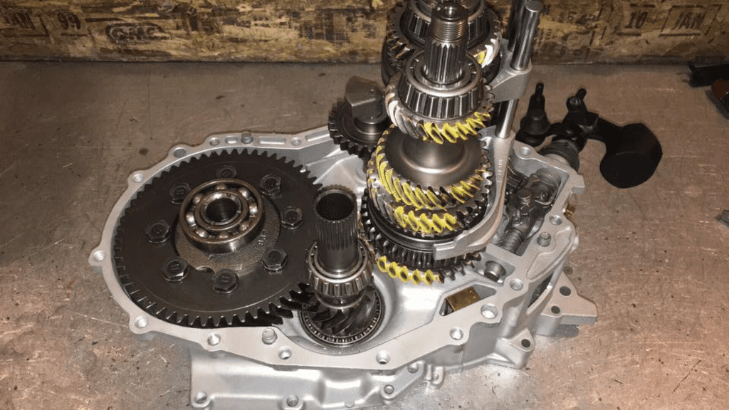

So made a couple changes fuel system wise with some magnus goodies and picking up my TRE Stg4 with the evoIII gear set all new gears with all the bells and whistles like his gear detailing, shot peening and isotropic finish. New 4 spider CD. My old shep stg3 built 07ish never missed a beat for 5-6 years at 600hp range. So I'm hoping with Jons magic I get the same results but better, the lubricator and cooler should help prolong the life of the trans, fingers crossed LOL. I have to go get the trans this weekend, it's at my shipping address in Calais ME.
Jon @ TRE posted this on FB, Pretty sure it's mine.
Loving this!!! What a great build!! Now this gives me ideas on some of the parts that I need to start collecting. :)
Youll love that transmission i got the shot peening, and gear detail should last a long time.
That's what I'm hoping for. Jon's the man for sure, smart smart guy. Can't wait to row through the trans with all his tricks, detailing and gear finish should make for a nice shiften combo. Running redline 75-140ns this year for the first time too
