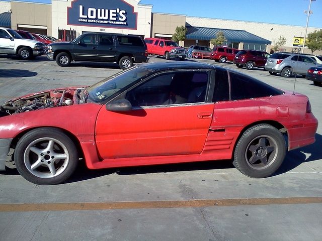

93 Eclipse 4g37 turbo.
Not exactly how i drew it out.

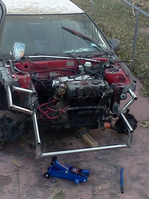

Reused and modified the old square tube front end since it had my front fender supports and light mounts already.

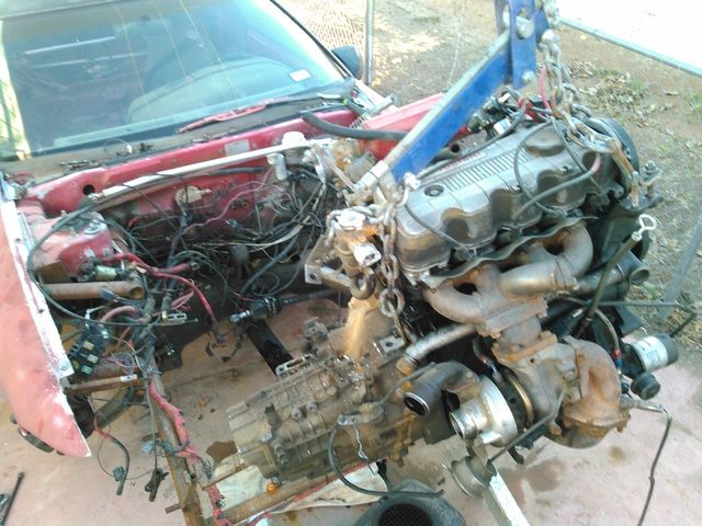

A few decent bumps and that motor is on the ground. Thanks for proving me wrong, for saying you could save this build unlike the rwd guy...

The manual transmission is a bolt on affair when switching from auto. The bolts that held the auto to the block will work for the manual. Use the manual transmission mount and it will bolt right up. Make sure you remove the pilot bearing on the crank(If it has one) before you install the flywheel.

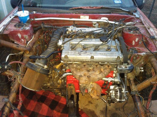

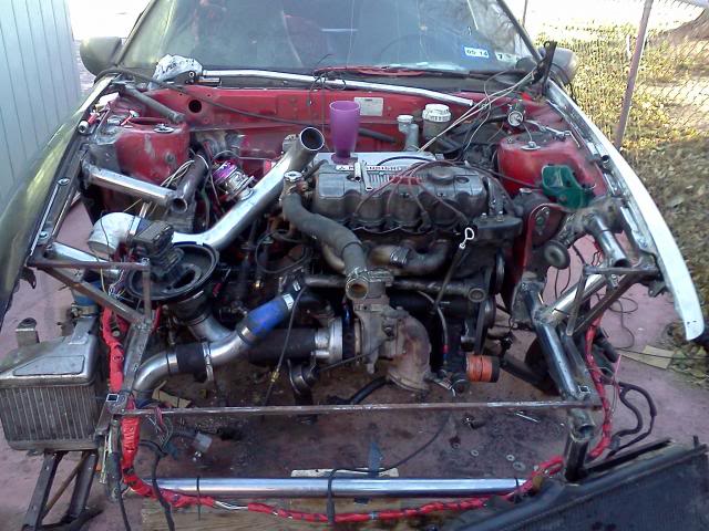

Got some more stuff done today.
Headlights are on. Ic piping is hooked up. Brake booster is back up. Safc neo is back in. Suspension is back on. Tires are on. Cross members bolted up. Filled up cooling system with water. Spark plug wires are back on.
So i decided to hook the battery up and make sure everything i have hooked up is working. Safc fired up. Starter wasn't doing anything. Hooked the grounds and power up for that cause i forgot those. Head lights work. Parking lights and dash didn't work, and only had a left turn signal. right turn signal turned on the flashers and made the left dash signal and all dash lights blink. Hazard button did the same thing. So i started checking everything, fearing that i might have eliminated a wire i should of kept. Since i basically pulled pins/wires of everything i didn't need. After almost 3 hours i found the problem. I crossed two wires when i depinned one of the chassis harness so i could pull it out of the fire wall sleeve. Its a good thing i had an intact one laying around to compare too. Everything works so far...
Still need to mount and plug the ecu back in. hook up my intake pipe and maf. Hook up my tps adapter. Put the stereo back in. Put the clamps on my ic pipes. Add clutch fluid and bleed it. Add transmission fluid. Add a quart of oil. Hook up my fans. Add some of the grounds i didn't put on yet. Drop the front end back on the ground and tighten the lug and axle nuts. Then its vroom vroom time.
you should make a strut tower brace that ties the top of the 2 strut towers together. if it would have been me i would have either tube chassied the entire front end or got a front clip off of a rear-ended car and welded that on. but really it doesnt look that bad.
something you could do just so you can find the settings that work best for your welder. take a scrap piece of plate and weld it to a scrap tube. then set it tube side down and hammer on the plate like you are trying to hammer it into the ground. when the weld shears you will be able to inspect penetration and brittleness at the joint. then you can adjust your speed and distance from the puddle. since your welder doesnt have real amp adjustment.
i would probably due some corner gussets out of small chunks of round tube. and your mix of square and round looks a little ghetto. but really i live in a farm town, some of the stuff i have seen driving around on the public roads makes this look like a factory job.
Do you know anyone that has a pipe bender or access to one? Im sure you know the weakest point of any structures a weld no matter how good it is, keep practicing like zedicus said. Dont know if I missed it earlier in the build thread but what welder you running?
Once again love the dedication man, may not agree with everything but im still hooked on this thread.
remember you can only get better with time. All the frame work you've fabricated can always be undone if need be with a little time and effort.:thumb:

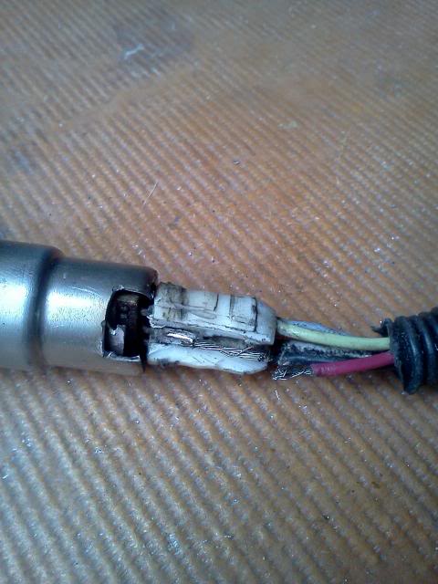

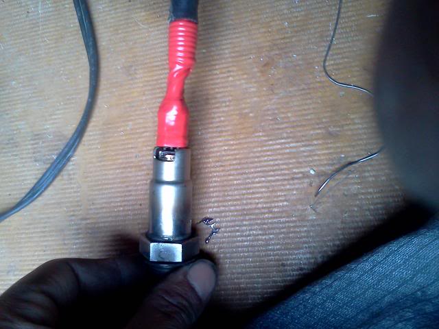

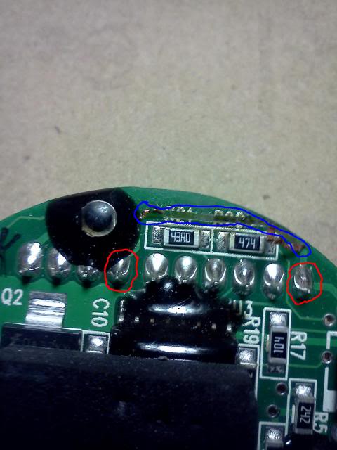

So i decided to fix my wideband gauge, sensor, and my broken down pipe. Since im pretty sure the tune is going to need adjusting.
My gauge blew out when my downpipe broke off and was hanging on by the sensor. The power for the sensor broke, shorted out and blew the gauge.
First i took the sensor apart and found the problem. The lead in blue melted, its path ran between the two terminals in red.

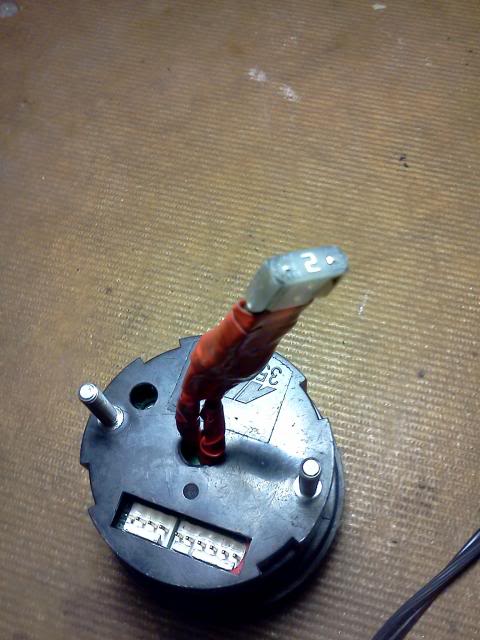

So i soldered a wire onto each of the terminals. Drilled a hole in the back of the housing and ran the wires out.
hooked up a 2 amp fuse to the wires. Hopefully if something happens again to cause it to short out, it will blow the fuse and not fry anything else in the gauge.
Tested it, and that fixed that.

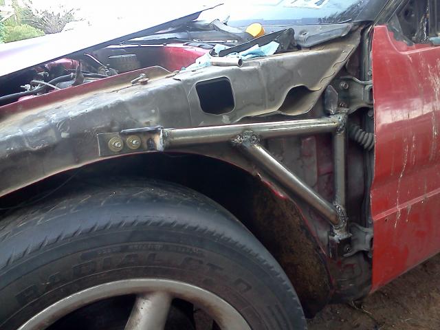

Also got one of my fender braces made.
With just the one brace on, the car feels ALOT more stiff when turning. I think i just became a fan of fender braces. Will try and get the other side done this week sometime.

Driverside fender brace was finished.
After driving around with both braces on for a while now, they definitely make a big difference. The steering wheel feels alot tighter(as in no play) and its a bit harder to turn at a dead stop (manual rack). As for taking corners, it feels like there's less weight transfer side to side during turn in. Once it's set it feels alot more stable throughout the corner. Leaves me thinking i should of added these years ago.

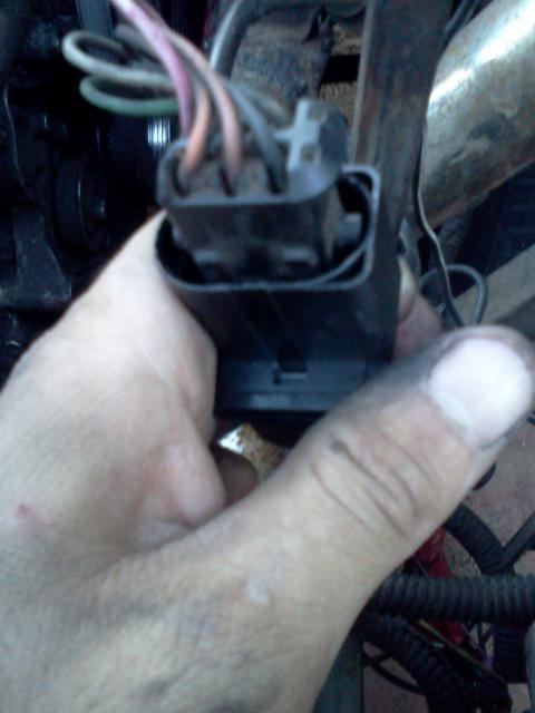

My wideband sensor finally went out as well. Picked up one from autozone for 49.99 plus tax with one year warrenty. The sensor i went with is Bosch 07014. Its all over the net that you can use this one with aem. The plug is different but still works. So if you want a visual on what that is here you go.
Just remove the gray clip from the gauge harness end and it slides right into the new sensor harness.
Once you push it all the way down its very secure, wont have to worry about it coming undone. Could use some rtv or die eletric grease to keep water from getting in it. Also you have to make sure you plug it in, in the correct orientation.

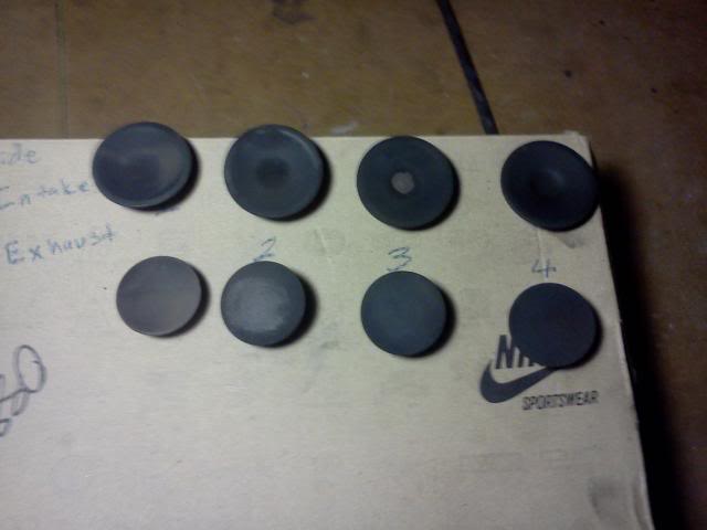

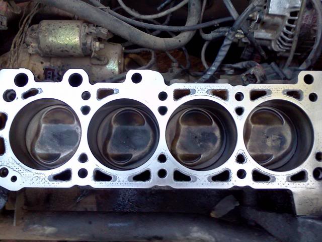

I was actually pretty excited to take the head off to see how the pistons looked to be holding up after 2 years of boost.Once the head came off i saw the problem. The entire front half of the block was covered in oil underneath the head gasket, so it had been leaking. That's great news since it means my oil rings are okay. And now for what i consider to be icing on the cake with a cherry on top. I didn't clean the pistons up at all, just wiped down the block deck.
The cleanest pistons tops i've ever seen out of all the 4g37 motors i've opened up. The tops look perfect, not a single sign of detontation or anything. Couldn't be happier with how its handled 20lbs on the 14b.

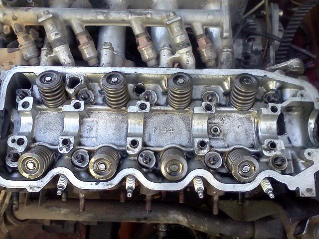

Okay so i got my arp head studs and installed them. So now that i'm satisfied with my head getting proper clamping force it was time to retune it and start having fun with it. Well so i thought. Was quickly disappointed again. Came to find out it has a nasty miss at 3-4k. I haven't put my foot down on it since i swapped out the head due to the boost issue, and the head nut situation, so this seemed to pop up out of now where(turns out its probably been an issue for a very long time). So for the past 2 weeks i've been trying to figure out just what the hells going on. Tried leaning it out, enriching it, advancing timing, retarding timing. Nothing made a difference. 99% of the time it missed in that rpm range, the other 1% it pulled just fine. Eventually figured out it was rpm dependent. It didn't matter how much boost or what the throttle position was, it missed at that specific range. So im thinking its something electrical. So i decided i had to get my data logger working again. Got it working and started logging. First off noticed my engine temp sensor was bouncing all over the place. Narrowed that down to loose pins on the plug. Fixed that but didn't make a single difference surprisingly. After that the logs looked perfect, nothing seemed out of the ordinary when it started missing.
Completely lost i decided to go over everything. First thing i did was put in new spark plugs, did some pulls and then removed the plugs to see what they could tell me. Aha plug number 3 looks lean as shit. Ohm out injector 3 and it fine. Tested the others and they were good. Replaced injector 3 with a spare in case it was clogged. No change, miss is still there, but that cylinder doesn't look lean no more. So then i go through and ohm out the injector wires, all were fine. So i pulled the pins from the ecu for the injectors and tightened the pins, did the same with the injector plugs. Still misses. Looked up how to test the distributor, primary coil comes back right at the limit for replacement, secondary, can't get a good reading for some reason, same thing for power transistor. So i'm thinking it might be my distributor or maybe a bad injector driver in my ecu. Not 100% sure whats wrong so i keep testing stuff.
Wondering if my valves are sealing right i go through and readjust all my valve lash settings. Get those good. Time to see what a compression test and leak down test say. Compression test came back at 180 across the board, leak down was just as good with at the most 7% leak down. Those numbers made me very happy since that's as good as new practically.

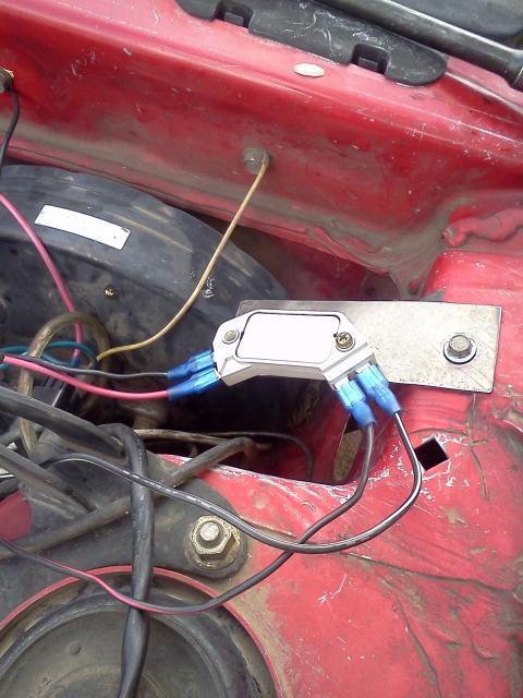

So its either my ecu or distributor. At first i was leaning more toward the ecu, but after a lot of reading up on ignition systems (admittedly before i just figured either they work or they don't, not no in between iffy things) It all started to make sense. Lately my car has run like crap for the first minute of the first start up of the day, and then smooths out once it warms up. I just figured it was due to the fact that i'm running way bigger injectors than stock and the startup enrichment procedure the computer goes thought didn't play well. Also has a slight miss every so often when idling. Turns out that could be a symptom of a coil with too much resistance and/or a power transistor going bad. So then i go back and do what i need to do to be able to get a good reading from my secondary coil. Finally figured out a way to do it, and it comes back right at the limit as well.
So now i'm convinced of the issue, the distributor is going bad. The upull it yards here don't have any 1.8s and i don't want to drop over 200 on a new one. Definitely don't want to order a used one either, so i start seeing what else i can do. Stumbled across a thread on talk in the 1.8 section talking about how the mazda mx-3 guys distributor may be similar in the way it works compared to ours, and how they run external power transistors and coils. Thread didn't have any solid answers just a link to the mx-3 write up. So i checked it out, looks promising. Dig up a circuit schematic for our distributor and see how the internals are set up. Pulled apart a spare harness i had to see how everything was wired together, and also ripped apart a spare distributor to see how it looks and to understand the schematic better.
As far as i can tell it looks like it should work, so i head out to autozone and pick up part # dr100. Wired it in, flicked the key, and its good Internal power transistor succesfully bypassed. Take it for a spin, First 2 pulls perfect! next one misses some but pulls through it and clears up. Play around and have some fun. Still misses but no where as bad. Just need to replace my weak coil and it should be golden. Hopefully in the next 2 weeks i'll be able to add a msd/accel coil.

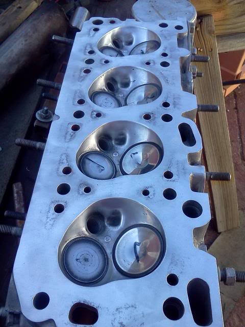

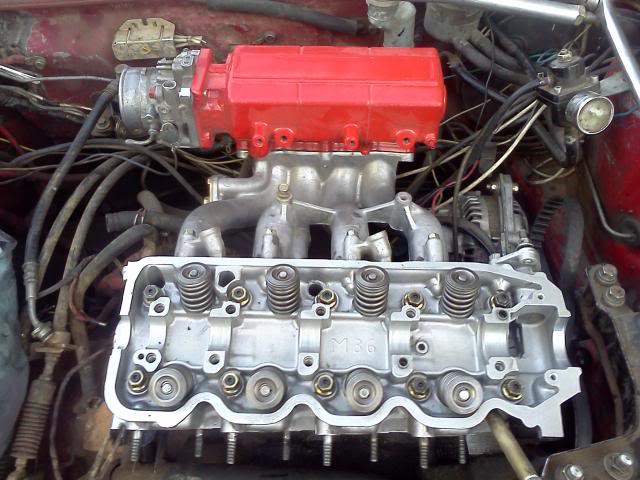

I neglected to mention some details about the head i swapped in since i wasn't able to push the car to see the fruits of my labor, if any. The work i put in it seems well worth the days i spent on it. Lapped all valves. Intake side was ported a lot, and i would say a good amount of work to the bowls removing the sharp edges and opening up the sides. Exhaust side got the same treatment, but it was also polished. Intake and exhaust(stockers) valve faces and combustion chambers were polished to help lower combustion chamber temps. The ass dyno says 15lbs of boost feels like 20lbs on the old head. And full boost 20lbs + is just wow. I actually get some wheel spin in 4th gear now. Need to come up with some more cheap traction upgrades now.

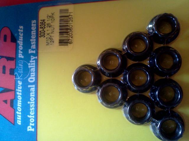

arp head nuts.

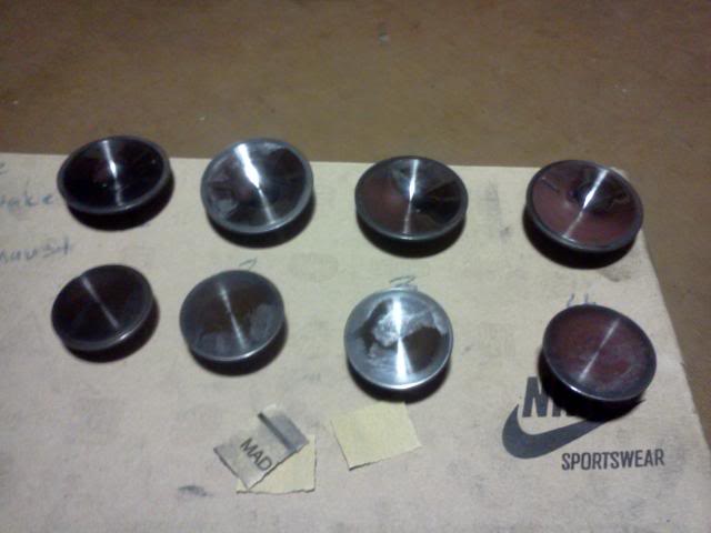

Valves before polishing.
Valves after polishing
Kidneys polished

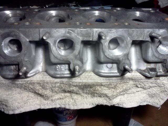

Had ported this head along time ago. Went back and did more porting/reshaping on the exhaust, then polished it again.
Can't remember if i touched up the intake side some or left it how i originally ported it.
The power transistor wired in and mounted.
wiring diagram i made
ecu pinout diagram i made.

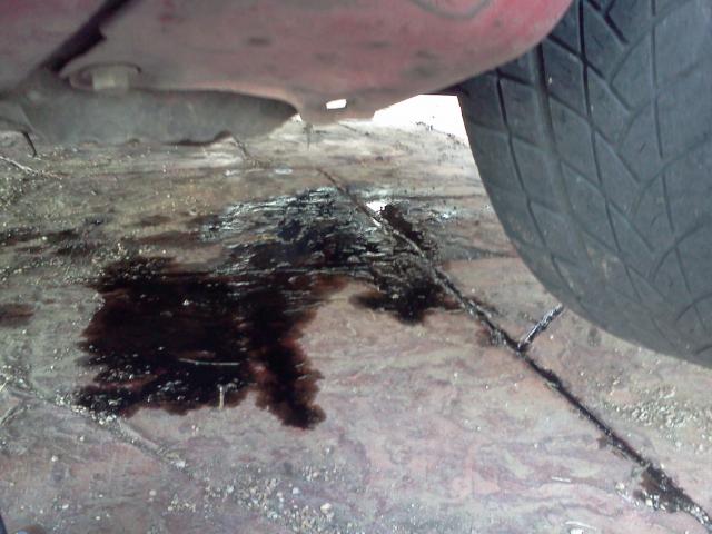

So had a pretty big engine failure today. basically was getting on it to see how much boost its set at. before was just letting off once it hit 20. Anyone was letting it keep building boost while i watched my wideband to make sure it didn't start going to lean. I'm guessing it was hitting around 23lbs, and my a/f ratios were looking good still. So about the 3rd time i let it boost that high my clutch slips(at least i think). So i let off and then hit it again and it slips again. So i just drive home normally after that, in a bad mood that my clutch can't handle the power. But i'm not positive its the clutch and not the tires. So i hit the internet looking to see if there are any options for a better clutch setup. Not a single off the shelf option that would be better than what i already have. That really blows. Also found an article saying to log vehicle speed and compare the graph from that to rpms to determine if its wheel spin or clutch slippage. So i stroll outside to setup my logger to log speed. That's when i see it.
A huge puddle of oil underneath my car. Also see a trail of oil leading down the street. I'm thinking WTF were did all that shit come from. Checked dipstick, its bone dry. Jacked the car up and see that its all coming out of the bell housing. Damn you rear main seal! But that's actually good news since well duh obviously my clutch slipped when the block decided to piss all over it.

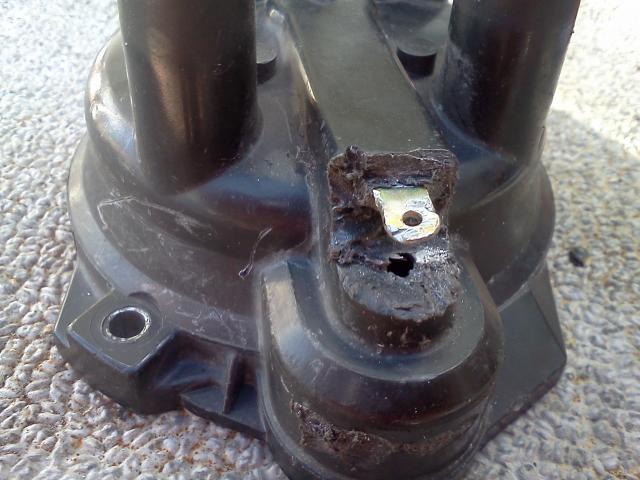

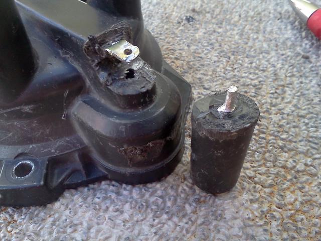

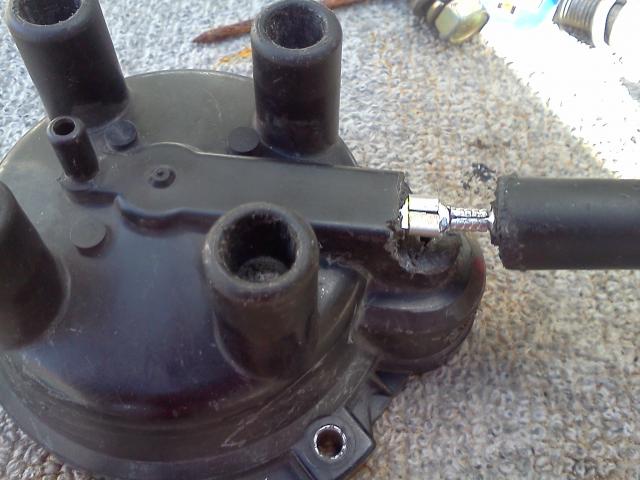

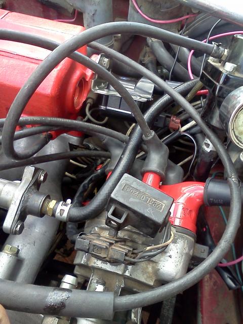

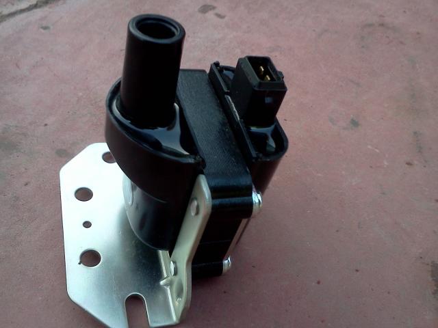

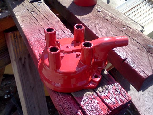

Finally got my external coil. Its also a H.E.I. type AND plugs into the stock harness! Zero rewiring needed to use this coil. Autozone part # C1603. Only $30 bucks and LIFETIME WARRANTY!!!!

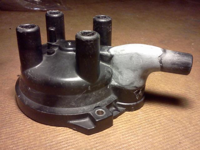

Cap modifing
Hack the cap up until you get this tip exposed. Its going to have a aluminum rod thats pressed into it. Once you cut through on the underside, remove the rod from the bottom and discard.
I then used a extra cap and broke one of the towers off.
I connected the two using a spade connector. Trimmed the "electrode" end of the broken tower to fit inside the spade connector nice and tight.
Ohmed it out real fast, got zero resistance... so time to seal it up. Used quick steel.
Made it my favorite color.
Coil is mounted on the side of the upper intake.

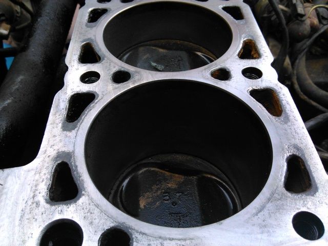

About 3 weeks ago i got tired of it and decided to try and fix it myself. Ripped the head off and for the first time ever checked the block surface for flatness. Needless to say it was bad. With an .08 feeler gauge it slide under the flat edge every which way all over the place. Hot dog down a hall way.
Spent a good 3 hours or so working on it. Got it down to where a .02 feeler only slide under in a few places. Honestly i wasn't expecting such good results trying to resurface it myself. But shit, the head gasket seals great now, hasn't pushed any coolant at all.

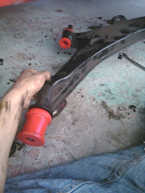

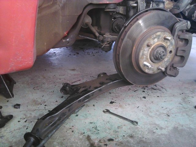

Decided to order some prothane control arm bushings. Put those in last week. Despite everything i've read about them being squeaky, mine haven't made a peep.

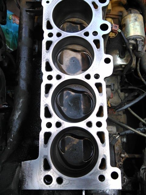

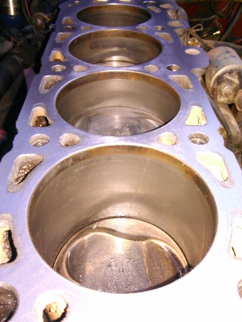

Block deck before
Block deck After
Control arm old bushings gone
New bushings on

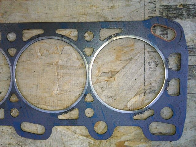

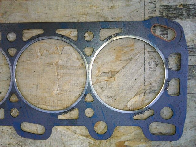

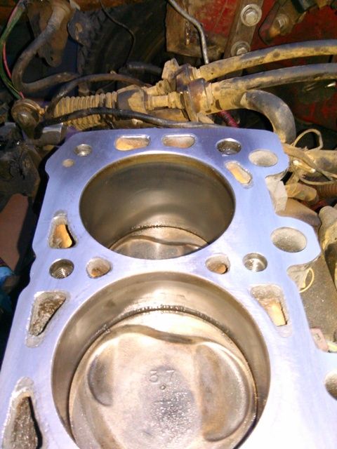

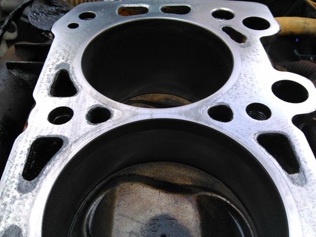

So i was having some fun with it the other day, and blew the crap out of the head gasket.
Blew in 8 different spots on these two cylinders. I honestly don't know how i was able to make it home like that.
Head nuts seemed a little too easy to take off. I didn't get around to retorqing them yet after i did the head gasket, so that might of been the reason.
Also i was over boosting pretty bad. My gauge goes up to 20, but the needle was burried way passed that. A/f looked good still with high 11's. Might of had something to do with it, but didn't see any signs of det damage in the combustion chambers or on pistons.
More than likely its the block deck still, and those two cylinders are on the low side. Either way, im making sure i retorq the head after 100 miles before i get on it this time.
241,116
Got 100 miles on the new gasket, and just got done re-torquing all my head nuts. A little surprised how loose they were. I got a good 30* of rotation on just about each one. So that actually might be a good possibility of why the other one blew.

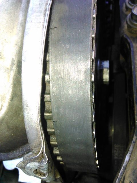

Think my timing belt is okay? LOL.

I got to admit this engine does look nice in there....
