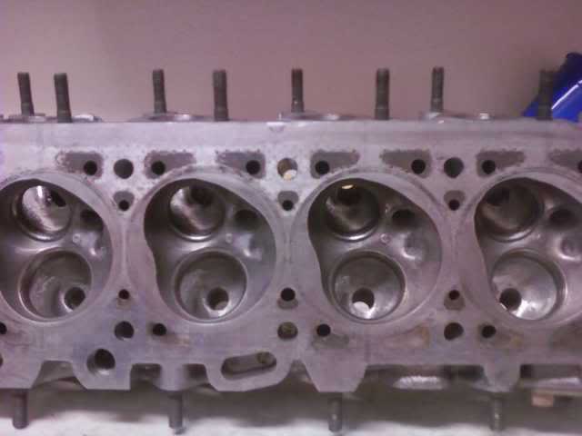

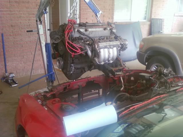

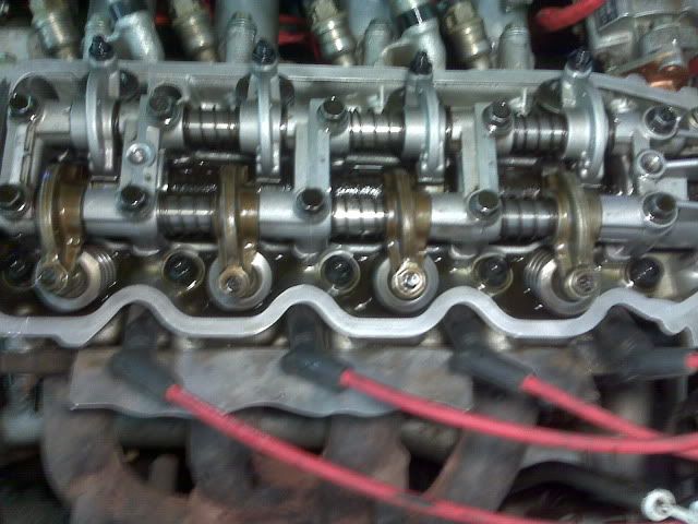

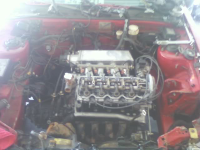

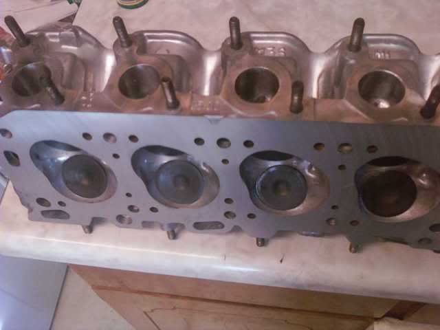

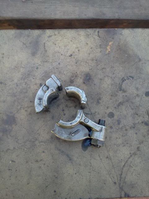

Got the engine out and ripped the head off to see the damage.
Despite the blown head and the knocking rod it still pulled hard. The rod knock never even got worse. Those acl race bearings are no joke.

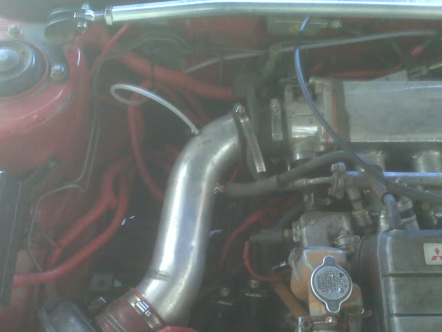

So i decided it was time to get the totaled 93 back up and running. reworked the front end, made a custom solid steel tranny mount, and it was finally ready for an engine to go back in. So i pulled out the original motor for it out of the closet. It had around 200k on it so far. Dropped the pan and checked the rods, no play, bearings were still okay. Got a new head gasket and ordered some arp studs for it.
The bottom end is original and the valve train is original as well. Everything else has been replaced on it at some point in time.

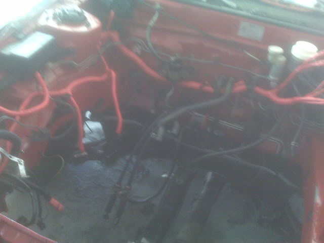

Got the engine in and everything ready to rock.
So it took me about a week to get the fuel dialed in just right, playing with the maf, fuel pressure and safc to get some good 10's during full boost. Got my fuel setup just right so it started to take over dd duties again. Ran into some overheating issues. Played around with that for the next 2 weeks before i figured out it was a timing issue. Ignition timing was way to aggressive. Got my timing right and my overheating due to detonation went away. about another 2 weeks later i switched my timing method and set it up to run constant static timing. So now she's set no more issues.

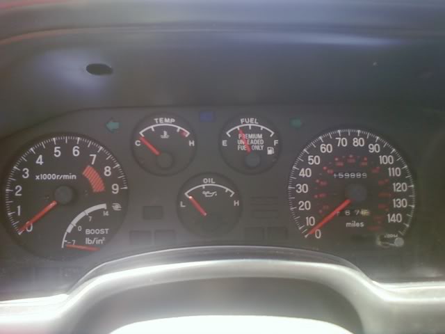

So now my goal was to make out the 390's. I wound up getting about 12 lbs of boost out of them. DD'd it like that for the next few months. Got tired of 12lbs and decided it was time to go bigger. Put in some 450's and upped the boost to 15. My clutch started to slip. Ordered a ebay 6puck.

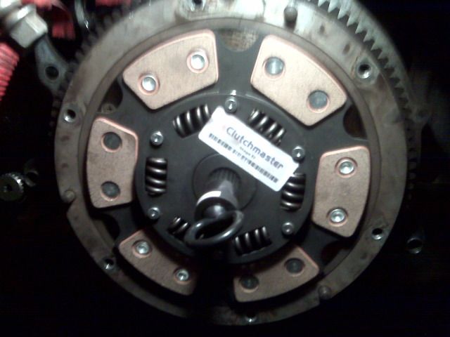

Now this thing took forever to break in. At around 4k miles it finally stopped slipping during full boost.
Now my goal was always 15psi of boost....but injectors werent maxed yet and i wanted to see just how much this old engine could take. up it went again. got about 16-17 psi out of them, with spikes to 18 from time to time.

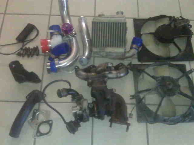

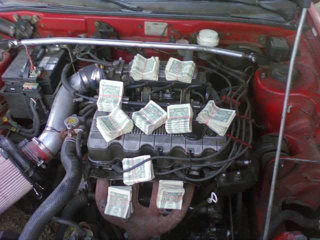

Initial build cost:

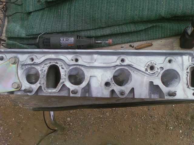

Turbo manifold, intake manifold, mustange tb, 390'cc, oil pan drain, afpr, $500

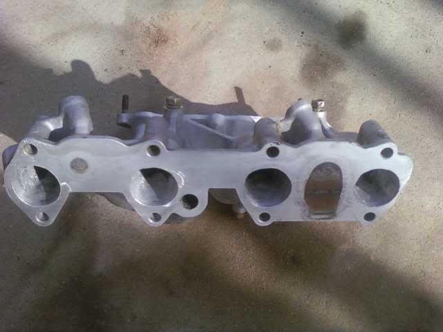

machine work to fix warped flanges on intake $40
225 hp fuel pump $50
safc neo $175
sidemount, ic piping, bov $125
14b turbo , j pipe, down pipe, o2 housing, stock wastegate actuator $170
t3 to mitsu turbo flange adapter, external wastegate block off plate $70
aem uego $180
Boost gauge $25
Total cost about $1400

May I ask what your impression is of the quality on the ebay clutch? I've seen a lot of people like the XTD's and a lot of people that don't. I'm afraid of any chinabay stuff, but I know my stock clutch hates it's life. Would you recommend one?
The ebay clutch sucks. Haha. It took so long to break in due to the pads being uneven. After about 1,000 miles i dropped the tranny to see why it was still slipping. On both sides of each puck only the middle section was making contact. The ends still looked completely new. So in all there was about 1/2 to 1/3 of each puck that wasn't making contact at all. I dont think its completely broken in yet either. It has around 6k or so i would imagine and still occasionally it will slip. When it slips it produces a nasty vibration that leads me to believe that the pads still aren't making 100% percent contact.

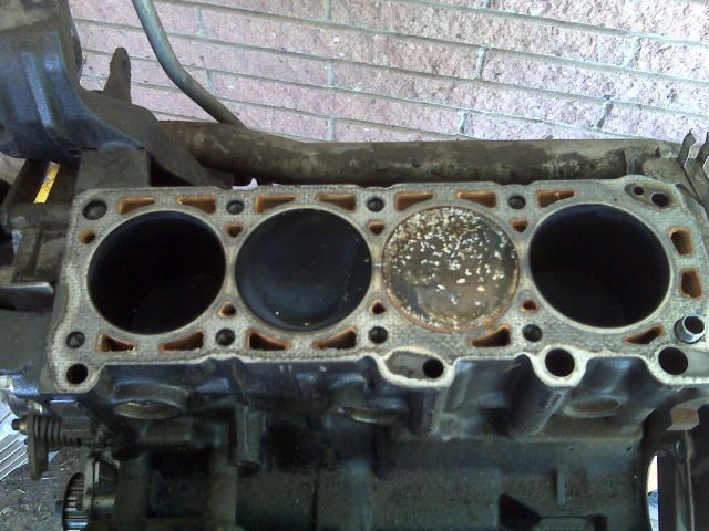

Bought it with the intention of fixing it, but once i tore the motor apart i found a busted rod and the block was cracked. So it sat for a few years, and was used as a parts car.

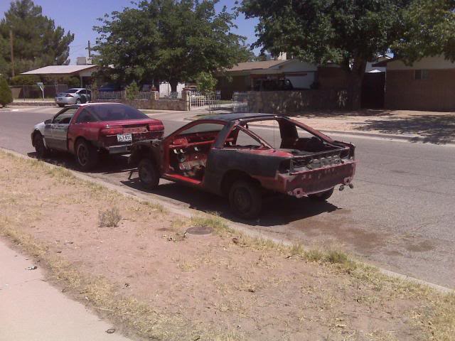

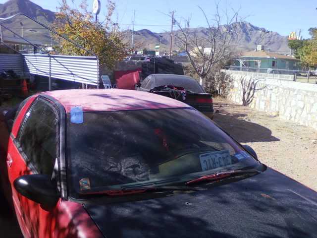

Used it to pick up another 93 from alb that was a 1.8 with a bad auto tranny.
Towed it all the way home from alb using an a-bar style tow hitch. and a ball that i drilled and welded onto my stock rear bumper. Now that drive isn't easy either because it extremely hilly and some mean hills at that. I'm surprised i made it up about half of those giant hills. Anyway got that car, then got my gsx back, made the new 93 reliable to drive and then brought suzie back to life. I then stripped just about everything off this car and junked it for scrap metal.
Car tipped the scales at 1060lbs, got 64 bucks for it.

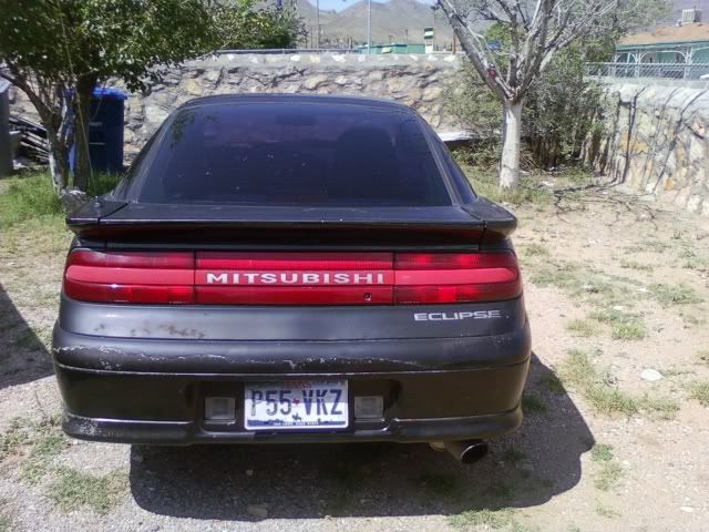

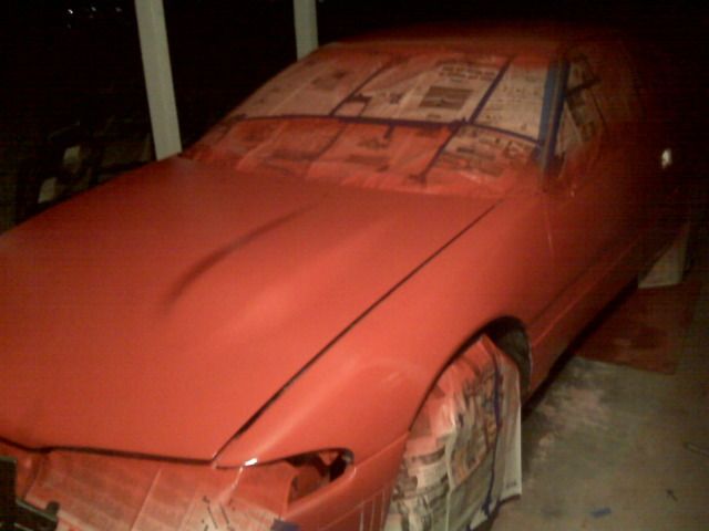

The second 93 eclipse after i got it back from alb. Bought it for 200 with the intentions of fixing it then selling it. Never named this one.
So the issue with this was it slipped out of gear. It was auto and i know jack about autos. besides that it leaked coolant and leaked a shit ton of oil. It left pools of oil after every drive. Converted it standard since i had enough spare parts laying around that all i had to do was go to the junkyard to pick up the hard line for the clutch system. Got tired of all the leaks so i ripped the engine out and replaced every gasket on it and did a balance shaft elimination while i was at it. All leaks were fixed. It became a dd for a while. replaced the headliner, got visors for it, and then decided to try my hand at painting it. Stripped all the trim, wing, mirrors, rear lights and bumper.

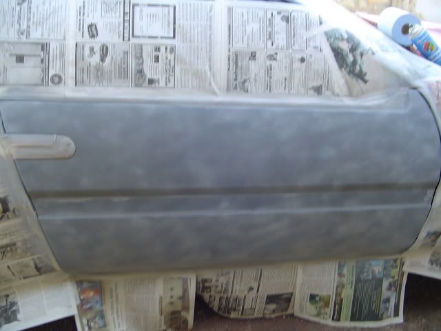

I didn't get the spray gun dialed in right until about the last coat so it was kind of a bumpy paint job. Used safety red rostoleum paint from lowes with a harbor freight hvlp gravity feed gun. Turned out decent tho i thought.
Didn't paint the front bumper since it the bottom right corner was cracked. Didn't feel like putting the money into it to fix it properly. I just drilled a few holes and ziptied it back and left it the original color. Didn't put the side skirts back on either because i cracked one of the end caps pretty good. Wound up selling it for 1,200. Had around 168k when she went to her new owner.

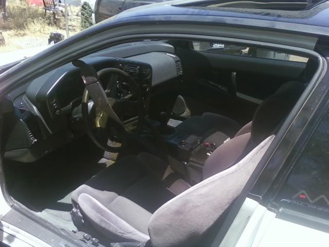

1992 eclipse gsx. 6/4 combo. Named her kayla. She was 100% percent stock, but had issues. picked it up for $1500. Went to the drag a few times with it. my best time was a 15.5 bone stock with some boost leaks and injector problems.
When i bought her, it didn't shift right and it didn't boost right at all and had a tick which po said was the lifters. Turns out the shift cables were both broken on the tranny end and the waster gate rod was unhooked. She was also missing a rear end link for the sway bar.. Fixed those she was good for about a month. Then the tranny locked up, wound up cracking the middle section and loosing all my gear oil. Sat for a few months while i tried to find a transmission. Got it back up and running and started fixing more things on it. It was retarded how many loost bolts it had. Cross members were loose, the gussests were loose, the rear axle nuts were loose. Im surprised it never fell apart. Had a bad front wheel bearing, and a bad rear wheel bearing, replaced the entire front knuckle and replaced the entire rear lateral arm. Ebrake cables were frozen and it had a bad rear caliper. replaced ebrake cables and caliper. It had a slight miss and kept throwing an injector circuit code. Replaced a bad injector, replaced injector pig tails, and replaced worn ecu pins on the harness end for all injectors and the coils. Injectors seats were bad, replaced those. fpr leaked boost, replaced that. bov leaked, replaced with hks ssqvII, fixed the leaking side mount. Turbo compressor housing o ring leaked, replaced with a better condition 14b. Exhuast manifold was cracked, replaced that with a 2g mani. o2 was bad, replaced that. knock sensor was no good, replaced that. coil was slightly out of spec, replaced that. tb biss screw oring was bad, replaced that. pvc leaked, replaced that. Finally got all the boost leaks fixed and all the issues worked out and had a good running gsx. Installed an aem uego, boost guage, and dsmlink v2. Tuned it for 15psi. Gave her to my lawyer to hold onto for about 4 months. Got her back and she was good for about another month. That tick that it had wound up being a rod bearing, and it spun on me. So i parked it. So it needed a complete bottom end rebuild and new timing components. Held on to her for a few more months then decided to sell it. Didn't want to put the money into all the parts i need for a rebuild. That and i hated how it was so hard to find the awd specific parts. So i wound up selling it for 1000.
awd was amazing in the snow and rain. Had alot of fun with it. I will admit i miss the awd, but not the hassles that come with it.

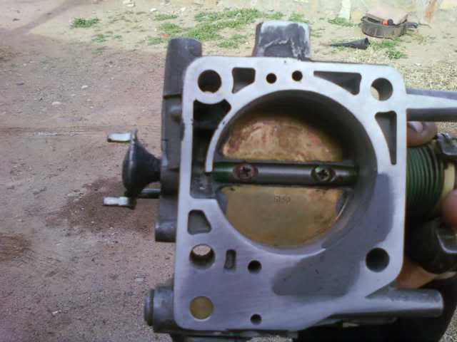

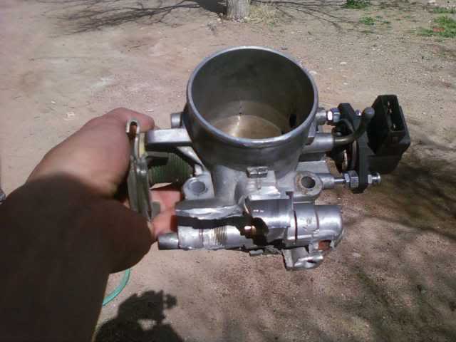

2.0 n't tb prepped to be installed on the 1.8 manifold

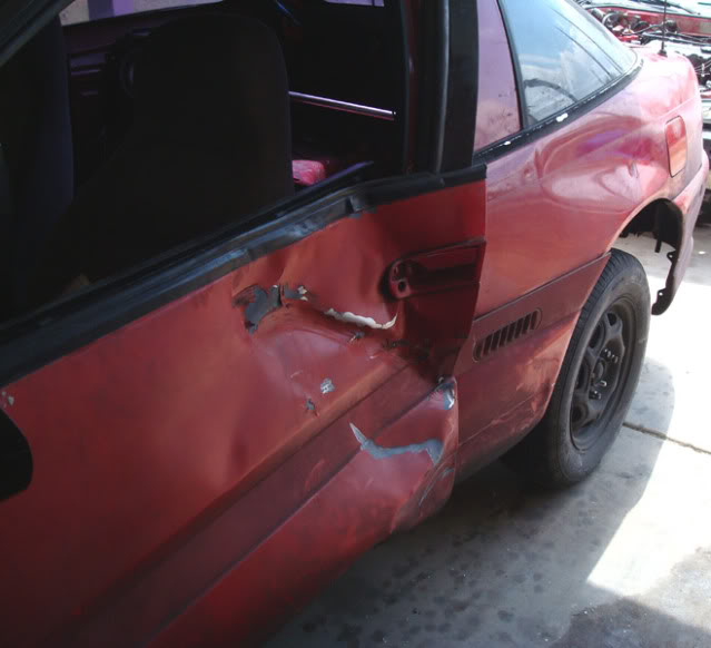

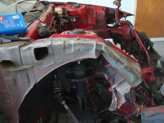

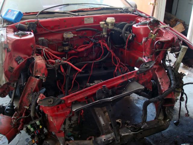

second crash happened and took out my front end again, and passenger door. People love to pull out in front of me and just stop.
You can see that the driver side front is bent some, it was worse but i hooked up a chain to it and a tree, threw the car in reverse and pulled it out. Before i did that my a/c fan was making love to my exhaust manifold.

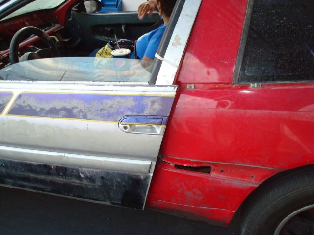

A door taken from a pos 90 laser that i had for a few months, getting prepped to rattle can
This is where the safety red came from. Door turned out pretty good and has lasted the years. Its still that same paint job from back then, just faded from the sun.

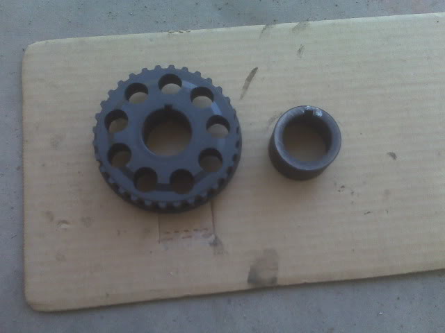

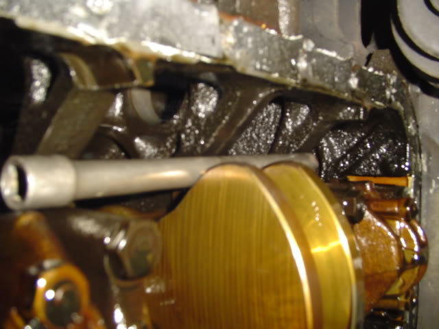

So i went ahead and did a balance shaft delete. I tried every trick in the book to brake that crank bolt loose. Starter bump, the car on the ground with blocks in front of the wheels, in gear, ebrake tight, and a friend standing on the brakes. Damn bolt just didn't want to let go. Wound up jamming the crank up this way. with a 2 foot breaker bar and a 5 foot pipe for leverage.
When it broke loose finally it sent such a harsh shock through the breaker bar/pipe that my hands were numb for a good 5 minutes.

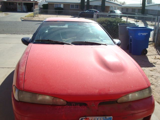

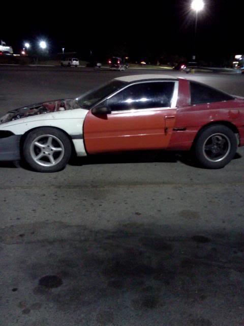

Ran into some bad luck and one day doing 90 on the freeway my hood flew up on me. Boy did that do some damage.
Pounded it out the best i could, sanded it down to bare metal and threw on a cheap can on $1 walmart paint to keep it from rusting for now until i got around to bondoing it. Got a new windshield and hood.

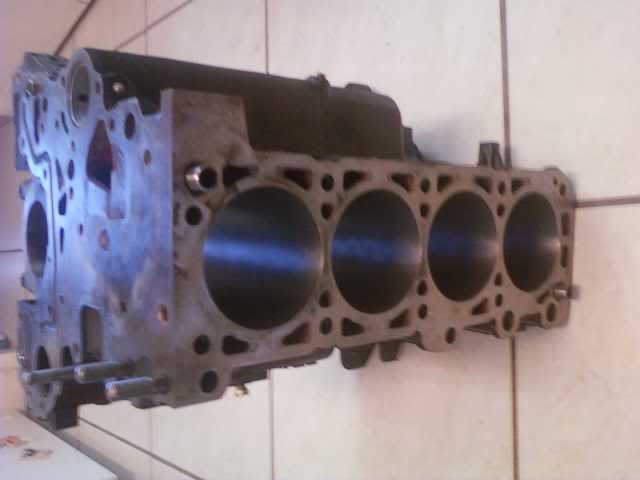

Managed to save up a grand to go toward learning to rebuild an engine
Bought a junkyard motor, tore it down and started with my first build.

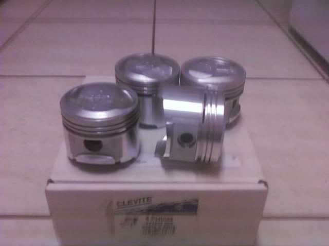

.25mm oversized clevite pistons
Bored/honed and hot tanked the block

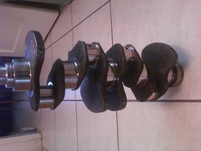

cut and polished crank
Ported the head myself
Then sent it to get a 3 angle valve job, with new oem valves and springs, and had it milled .2mm

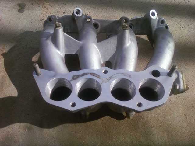

Ported bot the upper and lower intake manifold
Prepped another 2.0nt tb, this time i was gonna keep the tps

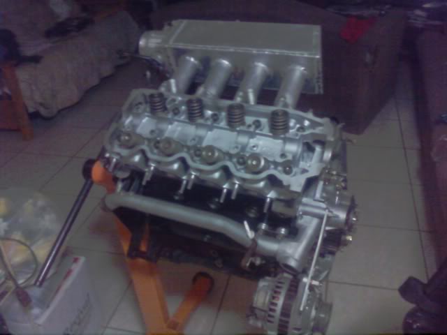

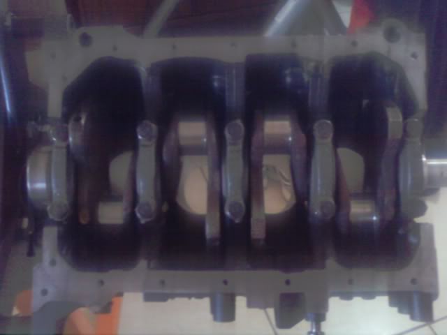

Started assembling my first bottom end. Crank in after plastigauging and checking clearances.
Go the rest of the engine together. Bought a cherry picker. Bought some urethane motor mounts and put those in the old mounts. Pulled the original engine out, nicknamed old faithful. Dropped the rebuilt engine in. Went to fire her up....and nothing. Messed around with it for about an hour, gave up and pulled the motor back out and dropped old faithful back in, pulled the head off, and put the built head on old faithful from the rebuilt engine. Still didn't fire up. turned out my distributor i was using on that new head decided to crap out. Only reason i pulled the new engine is because i didnt measure the ring gaps, so i thought thats why it wouldn't start. Oh well lesson learned the hard way...but its one i'll never forget.

Saved up some more, did some more research. Tore the rebuilt block down. took the block to get rehoned. Bought new bearings and rings. This time i got the rings in .03 even tho my pistons were .02. File-fited them to the tightest that the spec sheet allows for for the 4g37. Picked up a reground cam(284/294) and a custom smim. Got another head, but reused the valvetrain this time. Had a 3 angle valve job done and only had it shaved .1mm this time. Got it all assembled and ready to go in.
I kept going through head gaskets left and right. As soon as i started the car on a fresh head gasket, within 5 minutes it was leaking oil. had no idea why, but the car drove normal, just didn't have the power i expected. So i didn't take very good care of it, it was just a toy that i beat the crap out of since i had other dsm's as back up at this point. Anyway after about 15k i lost all compression in one cylinder. Which was entirely my fault. i ran it bone dry on oil and the ring threw in the towel. I would of kept driving it, but it spit out so much oil and smoked so bad everytime i took it for a short drive i got a nice dose of exhaust poisoning. So needless to say after 3 days of that i said f that and parked it and started on a new rebuild on another engine i had laying around.

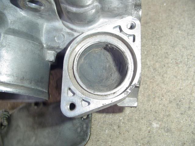

So i was at the junkyard one day walking around looking at the cars. The junkyard to me is like going to a mall for a girl. Haha. Anyway i stumpled across an old colt. Kept my fingers crossed, popped the hood and saw it was the 4g32. Looked at the bottom and noticed it was exactly what i had been looking for, for the past few years. One of the early 4g3x blocks that didn't come with balance shafts. Now from surfing fourms about the 4g32 i learned that the block without balance shafts, had a spacer where there the balance shaft gear would be on the crank. So i snagged the spacer, and the 4 exhaust side rockers. they were the mechanical slider type. These parts got me excited again to pick up where i left off with the 1.8
That spacer on the right replaces the entire balance shaft gear on the crank. It fit perfectly on the 1.8 crank. You just have no more timing mark. There's more than a lb of weight difference between the gear and the spacer.

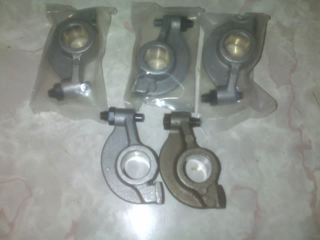

After countless hours of scouring the web i finally found part numbers for the exhaust side rockers to the 4g32. After countless more hours i finally found a vender. Ordered 4 new rockers to complete my set.
Spent a day figuring out how many little metal spacers had to go where on the intake side to get the rocker adjustment screws to sit in the center of the valve tip.
So i went back to my big cam. Finally no more destroying hydrolic lifters. They are noisy as hell tho. I also put my smim back on.

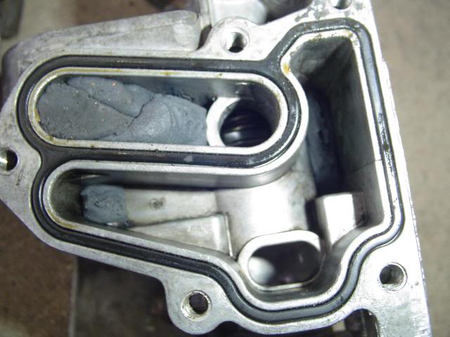

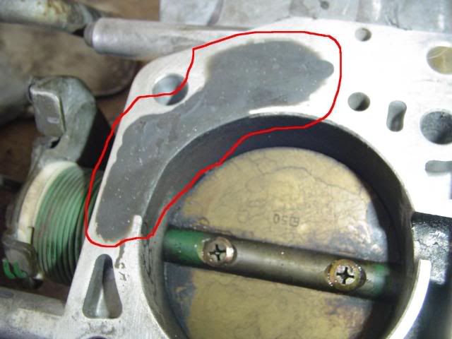

By now i've figured out why my head gaskets keep leaking and why it feels underpowered. Its detonating almost 24/7. Probably due to the high compression im running. With that .1mm shaved head it bumped my compression up to around 10:1. So i switched from a 6 to a 7 to an 8 rated ngk plug. Still not doing anything. Went with a ngk racing plug with the short ground strap rated at 9. A little better but still detonating. So then i played around with water injection. Made a super cheap setup from lowes racing.
It helped a bit but it was on just a toggle button and i had really no way to know how much iw as injecting. I only knew when i injected too much water when it would bog down. But damn does it cool my smim like a champ. Without the water that manifold will be burning hot to the touch. If i inject water, even after a minute of normal driving, the manifold is still COLD to the touch. I was super impressed with how much it would cool it down. But it still wasn't fixing my detonation issue so i stopped using it. put that idea on the back self until i have a better way of injecting and controlling it.

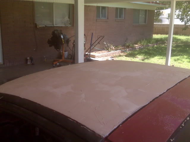

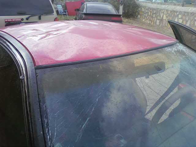

Ran out of ideas so i gave up on that issue for a while. Decided to try and bondo my roof
never finished the last sanding to smooth it out and get the shape perfect. Was alot of work. But its held up great over 2 summers without cracking one bit. I think the key is alot of thin layers.
Then accident number 3. This one was all my fault. Completely totaled the car. Sucks that it happened, but it did get me to stop popping pills.

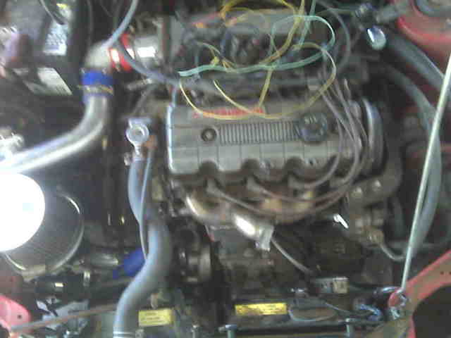

"fixed" the front end and got a new driver side door...and dropped old faithful back in and transferred all the turbo parts onto it.
Its no where near perfect, but it works...sort of.

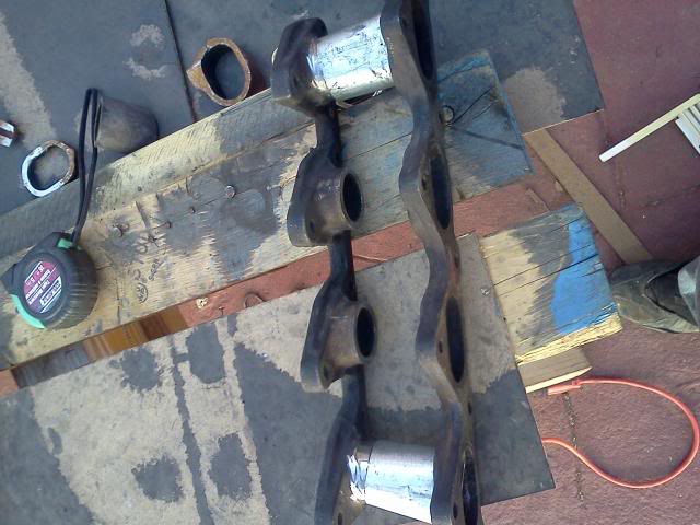

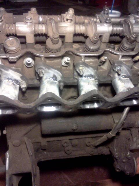

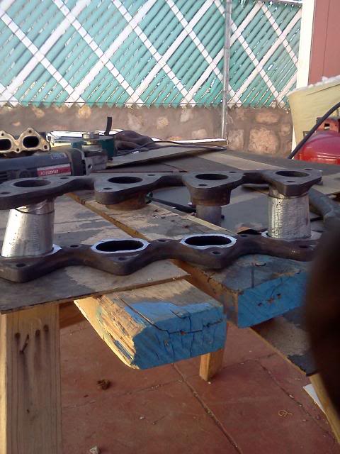

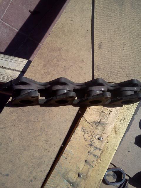

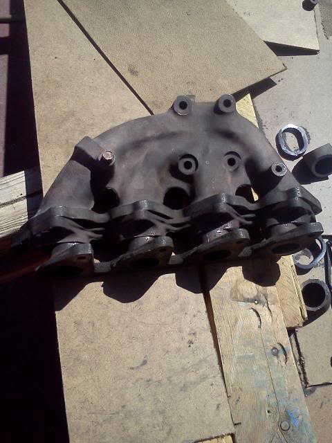

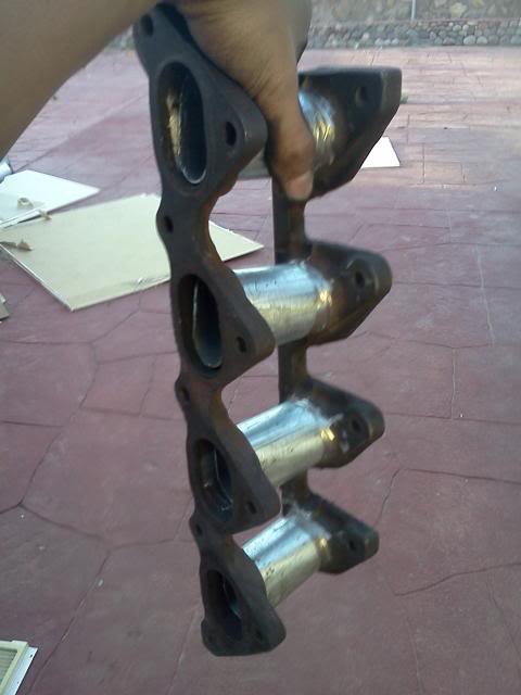

Right now im working on an exhaust manifold adapter. using a stock 1.8 and 2.0 flange to make it. If it turns out good and i can get a better spool up time out of it i will probably wind up getting an adapter made out of 1.5" thick solid steel.
Okay so got a little bit more done on the manifold adapter. Decided to use some pipe i had laying around to connect the two flanges. That way i dont have some rather big gaps to try and fill up. On the 2.0 flange i cut it shorter leaving mostly just the flange. On the 1.8 flange i trimmed down the outside diameter of the runners to allow the pipe to slip over them. So the the pipe slips over the 1.8 flange, and on the 2.0 flange i shaped the pipe to fit inside the flange.
As it sits its 3.25" wide. Once i get the other two pipes made im going to try and make it just a bit smaller.

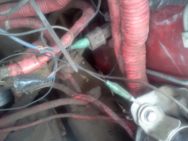

Hack #1 Static timing
I have my ignition adjustment grounded all the time.This keeps my timing advance static, it doesn't change at all from idle, to cruise, to wot. This forces the ecu to run 10 degrees of timing plus whatever you have the distributor set at.

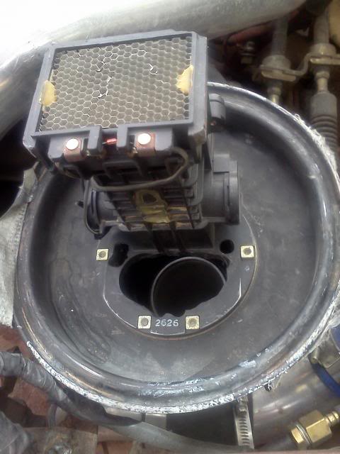

Hack #3 Maf mod
I removed the tubes and increased the unmetered air flow. This makes it possible for me to tune my 560's with just a safc. Since my 560's are about 150% bigger than the stock injectors and my base fuel pressure is more than double stock fuel pressure I would be way to rich without it.
Update on Manifold
Just need to trim the pipes a bit and then its ready to weld up. Should be somewhat easy to weld it since it holds together pretty nice.

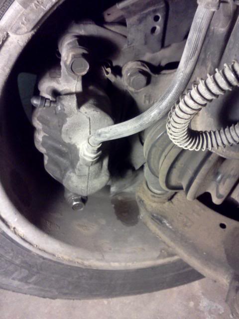

So changed a few things on the 1.8t. Decided to upgrade my front brake calipers. replaced them with 3000gt dual piston calipers and the rotors. With the normal brakes it would brake just fine but with the dual pistons i can tell it brakes a hell of a lot easier.
My radiator has been leaking for the longest time so i also replaced that. Swapped the stock radiator for a 3000gt radiator. Seems to have a made a big improvement in cooling.
I also changed my front tires since they were almost bald. I had 185/70/r14's on and swapped them for 225/55/r16's.
Got my exhuast manifold tacked together. Just need to finish welding it up and then make a new downpipe.
This is by far one of the ugliest dsms out on the road...
but with that being said I have to give you props for how much work your doing, and sticking with the 1.8
Its a road far less traveled with very little mods done to them,
but you obviously love the car so more power to you
Have you looked into getting a colt or mirage? possible pcm swap? just ideas to go faster,
Cant wait to see what the car can do when you get your megasquirt wired in, its by far the biggest thing holding you back
LOL! It is pretty ugly...Suzie's been through alot. It turns heads...maybe not for the right reasons tho. I do catch alot of people staring at my engine bay tho. I do plan on fixing the body and making her look pretty...but that probably wont happen this year. It will probably be a year before i can afford the megasquirt as well.
I'm always trying to think of ways to go faster. Not really sure if a pcm swap from a colt or mirage would be beneficial. The only swap i could see that would benefit me would be using a 2.0 turbo ecu with link. I know i could get everything to work minus the cam sensor. Not sure if the cam signal from the distributor would be compatible with the 2.0 ecu or not. For now im not worried about it, when the time comes i'll figure out which route i want to go.
So i developed this bad vibration under acceleration. Started checking the typical things. Wound up finding a missing bolt to the transmission, and a loose bolt to the transmission mount. Fixed those, still had the vibration. Saw that my passenger strut tower would move some if i shook the car. So i went and re welded it back up about 2 or 3 weeks ago. While i was doing that my cv axle popped out of the cup in the tranny and i saw that one of the 3 fork things had a busted bearing and the metal roller thing was wobbling around on it. So i need a new axle. Will get around to that one of these days. As for the strut tower, its holding solid now. Alot of the body roll i had is gone and the front end feels a ton stiffer. I plan on adding some extra bracing to it eventually for added security. But for now its cherry. As for my manifold adapter i got about half of it done. The end of it that has the 2.0 flange is proving to be a major pain in the ass to weld up. I'm almost out of welding rods so i'll need more before i can finish it. Also picked up a 3" inch downpipe to go along with the new setup, i just need to weld in a bung for the wb sensor. Hopefully i'll be done with it in the next couple weeks.
On a side note...at times i really hate having poly motor mounts and a solid metal tranny mount. Its ridiculous how much stuff vibrates itself loose. Last week sometime i was driving and i hear a thump and then something smacked the crap out of my firewall. Then all of a sudden my engine sounds like shit. I honestly thought i just lost i rod bearing, because it sounded like it was knocking bad. Turns out one of the turbo flange adapter to manifold bolts fell out. Haha. Thats the second time i've had one of those bolts fall out. And the rest have worked themselves loose a couple dozen times now.
How was that type of front damage repaired? If the car wasn't properly straightened and new parts for the front bracing welded back on I wouldn't be surprised if it had a vibration since the repair, your poly mounts could be the least of your concerns. Given how there seem to be not one single consistent panel gap on on sight on that thing I would seriously question the straightness of that frame.Another hint could be the dsm-chain-tree combo...
Frame hasn't been straightened. There were no abnormal vibrations after all the frame/body damage. Handling/stability hasn't been effected by any of it. They really did build the 1g's to be tanks. That and i probably got lucky, like 1 in a million chance that it could sustain the amount of damage it did and still be fine.

Well it finally happened last night. Something finally broke on the motor. Compression test reveals that i have zero compression in cylinder 2, all others are still perfect.
I already knew what happened when i posted. Once i saw i had zero compression i was going to do a leak down test, but that would of taken me some time to dig up all the parts i need to do it since i dont have an actual tester. So i decided to pull the valve cover since it was quick and easy.
This is what i found on the intake side of cylinder 2
I was relieved that it was just a busted rocker but at the same time pissed off. First off i dont really enjoy removing the rocker assembly, secondly i can't afford to order a replacement mechanical rocker. I have a ton of hydrolic rockers and lash adjusters laying around so im just going to swap one of those in for now. While im at it im giong to grind down my cam bolt some so in the future i'll be able to remove the cam gear without having to take off the driver side mount.
Wish i knew why it broke, probably due to an internal defect. Probably worth noting that it is a non oe part. with less than 30k on it probably. Might also be due to the fact the adjustment screw is almost worn flat. Which sucks because i have had no luck in finding a source in buying just the screws.
