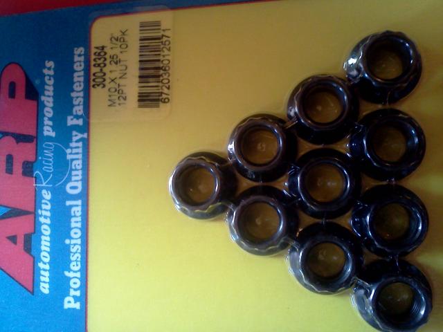

Okay so i got my arp head studs and installed them. So now that i'm satisfied with my head getting proper clamping force it was time to retune it and start having fun with it. Well so i thought. Was quickly disappointed again. Came to find out it has a nasty miss at 3-4k. I haven't put my foot down on it since i swapped out the head due to the boost issue, and the head nut situation, so this seemed to pop up out of now where(turns out its probably been an issue for a very long time). So for the past 2 weeks i've been trying to figure out just what the hells going on. Tried leaning it out, enriching it, advancing timing, retarding timing. Nothing made a difference. 99% of the time it missed in that rpm range, the other 1% it pulled just fine. Eventually figured out it was rpm dependent. It didn't matter how much boost or what the throttle position was, it missed at that specific range. So im thinking its something electrical. So i decided i had to get my data logger working again. Got it working and started logging. First off noticed my engine temp sensor was bouncing all over the place. Narrowed that down to loose pins on the plug. Fixed that but didn't make a single difference surprisingly. After that the logs looked perfect, nothing seemed out of the ordinary when it started missing.

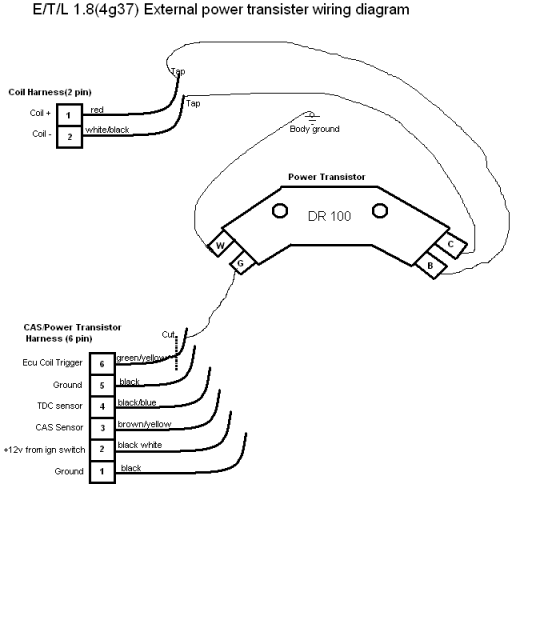

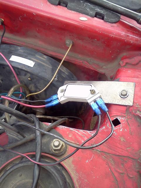

So now i'm convinced of the issue, the distributor is going bad. The upull it yards here don't have any 1.8s and i don't want to drop over 200 on a new one. Definitely don't want to order a used one either, so i start seeing what else i can do. Stumbled across a thread on talk in the 1.8 section talking about how the mazda mx-3 guys distributor may be similar in the way it works compared to ours, and how they run external power transistors and coils. Thread didn't have any solid answers just a link to the mx-3 write up. So i checked it out, looks promising. Dig up a circuit schematic for our distributor and see how the internals are set up. Pulled apart a spare harness i had to see how everything was wired together, and also ripped apart a spare distributor to see how it looks and to understand the schematic better.
As far as i can tell it looks like it should work, so i head out to autozone and pick up part # dr100. Wired it in, flicked the key, and its good Internal power transistor succesfully bypassed. Take it for a spin, First 2 pulls perfect! next one misses some but pulls through it and clears up. Play around and have some fun. Still misses but no where as bad. Just need to replace my weak coil and it should be golden. Hopefully in the next 2 weeks i'll be able to add a msd/accel coil.

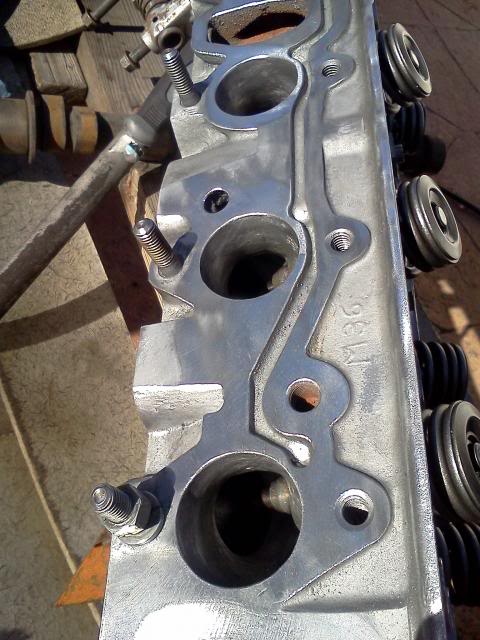

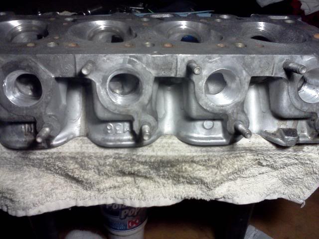

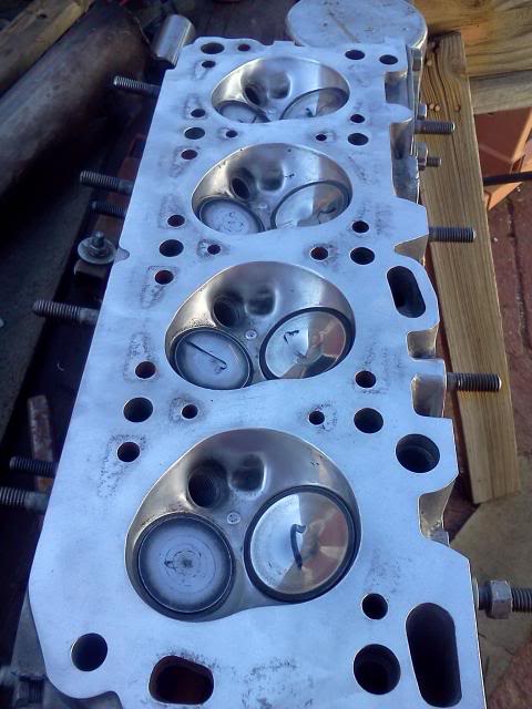

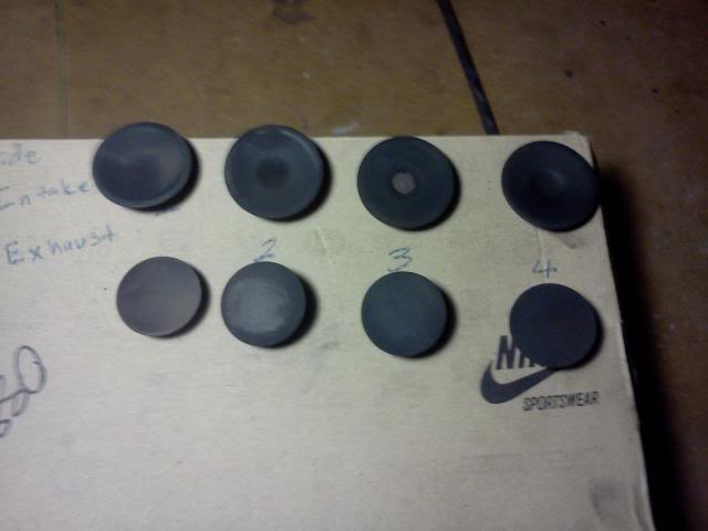

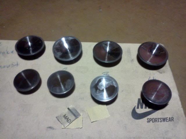

I neglected to mention some details about the head i swapped in since i wasn't able to push the car to see the fruits of my labor, if any. The work i put in it seems well worth the days i spent on it. Lapped all valves. Intake side was ported a lot, and i would say a good amount of work to the bowls removing the sharp edges and opening up the sides. Exhaust side got the same treatment, but it was also polished. Intake and exhaust(stockers) valve faces and combustion chambers were polished to help lower combustion chamber temps. The ass dyno says 15lbs of boost feels like 20lbs on the old head. And full boost 20lbs + is just wow. I actually get some wheel spin in 4th gear now. Need to come up with some more cheap traction upgrades now.
arp head nuts.
Valves before polishing.
Valves after polishing

Had ported this head along time ago. Went back and did more porting/reshaping on the exhaust, then polished it again.
Can't remember if i touched up the intake side some or left it how i originally ported it.
The power transistor wired in and mounted.
wiring diagram i made

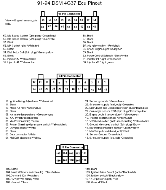

ecu pinout diagram i made.

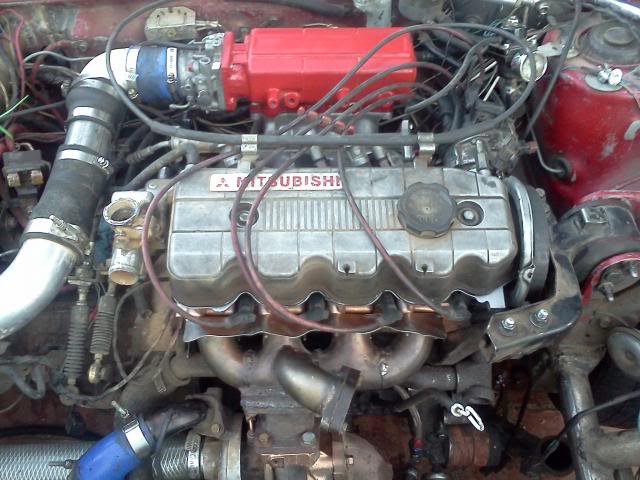

The 1.8
