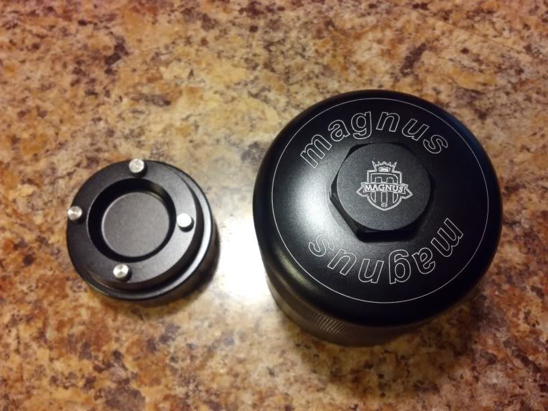

Magnus Motorsports reusable oil filter and disassemble tool.

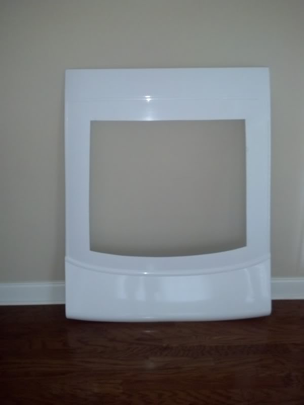

Franks custom fiberglass hatch
Waiting on the FAL window kit to arrive.

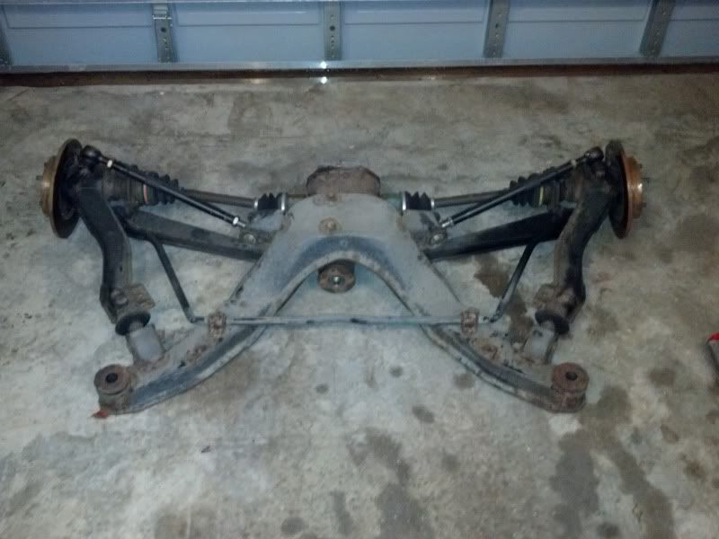

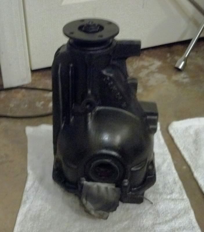

Rear diff and rear subframe was in rough shape to say the least.

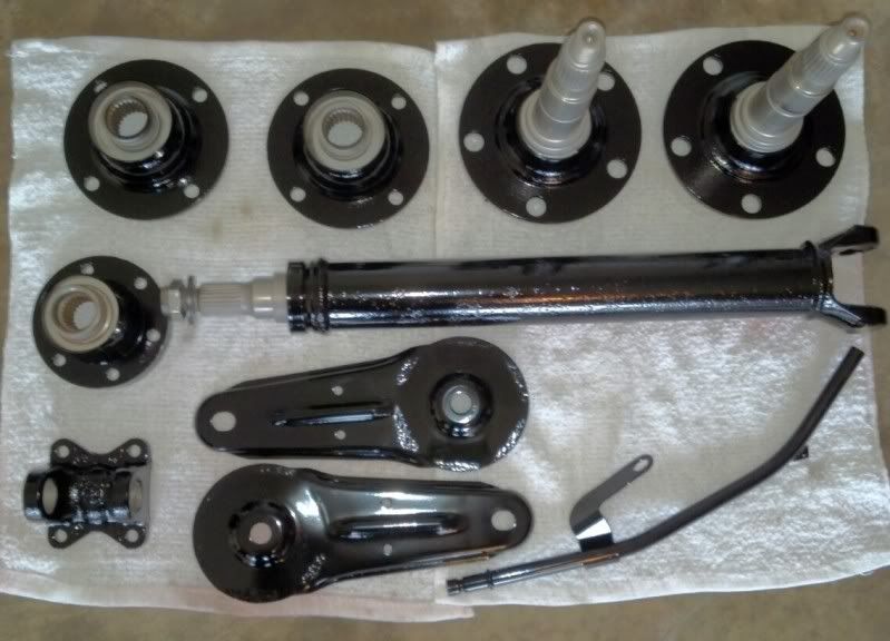

after wire brushing and wire wheeling the hell out of it and some high temp gloss black paint.

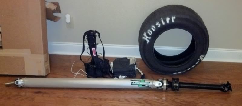

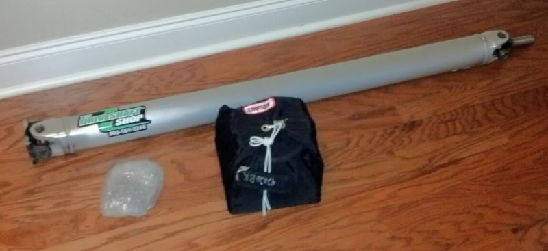

Driveshaft shop 3.5" driveshaft and Simpson parachute

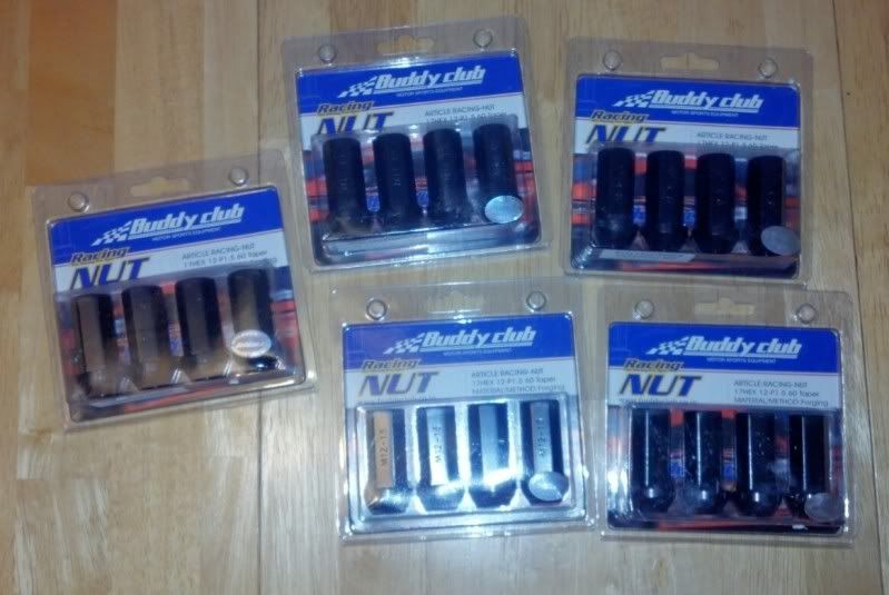

Buddy club chromoly open end lug nuts

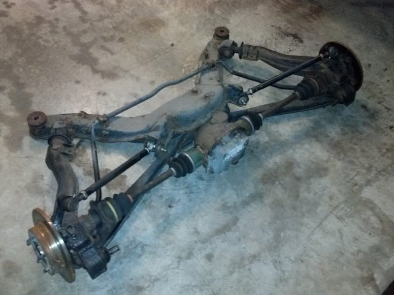

Here is what the rear subframe looked like after I pulled it. Everything is getting blasted, powdercoated and all new OEM mitsu bolts, nuts, washers.
I'll post after pics once its all back together.

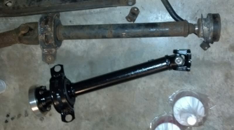

Rear section of driveshaft rebuilt and powdercoated.
before and after

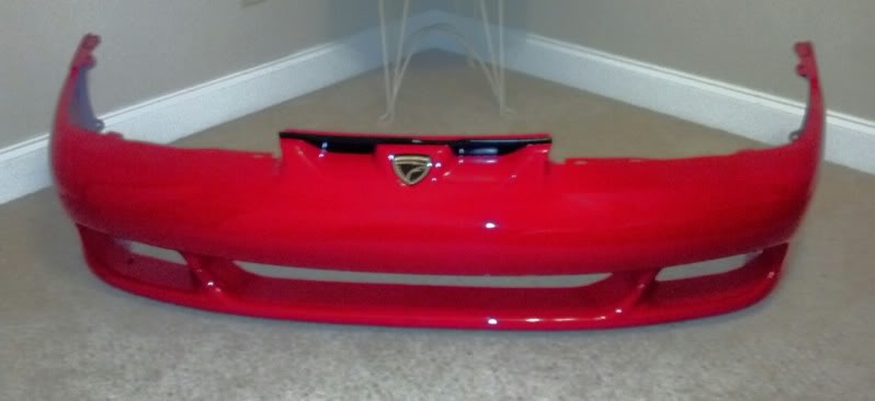

front bumper repainted and new Eagle emblem
powdercoated parts from rear suspension. just waiting on the trailing arms and rear subframe to be finished.

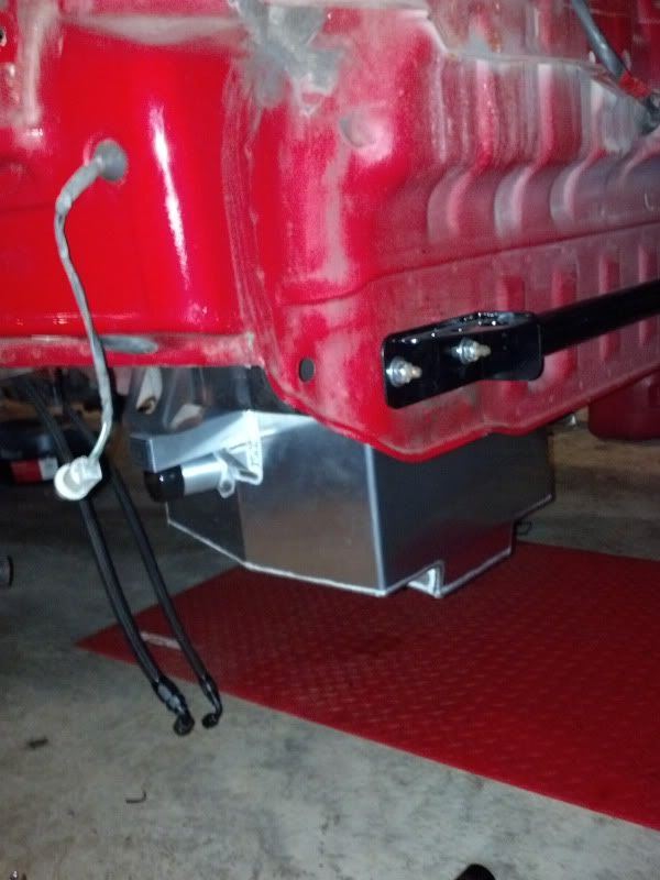

JM Fab Fuel cell bolted up

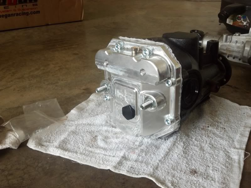

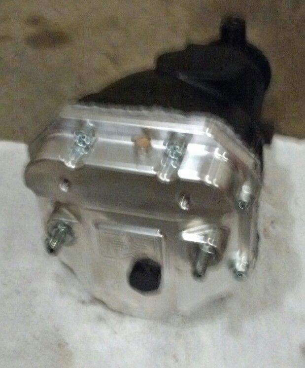

Frontline Fab diff cover bolted up, now the diff is ready to install.

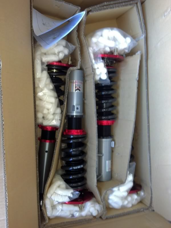

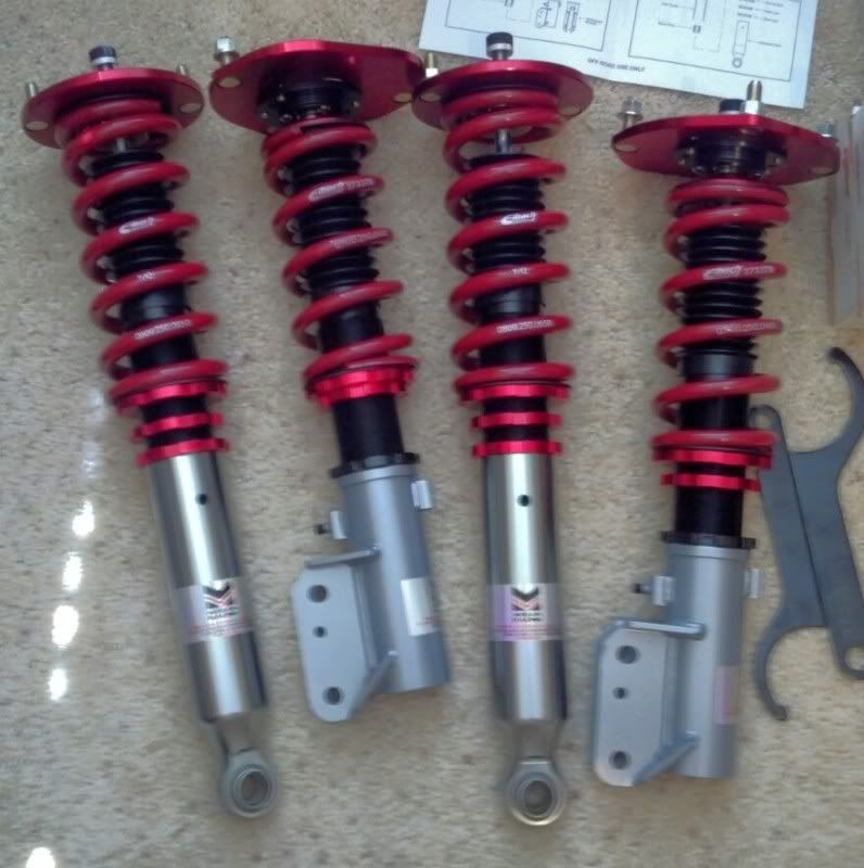

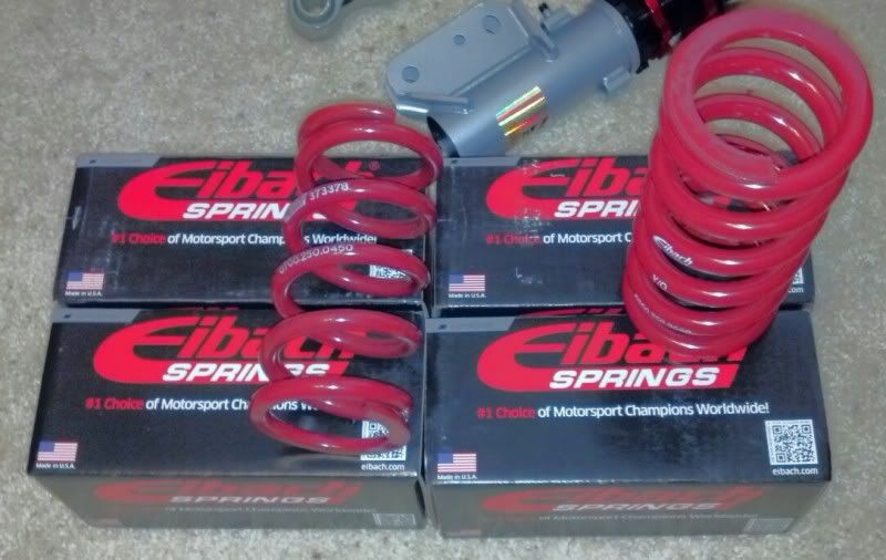

Megan coilovers. Waiting on Eibach springs to come in to install them.

What is the springs rate that came with the coilover?
Not sure on the spring rate, I know they aren't what I want which is 450 front and 650 rear.
Better pic of the diff cover. I trimmed off the excess gasket that squeezed out after I took this pic.

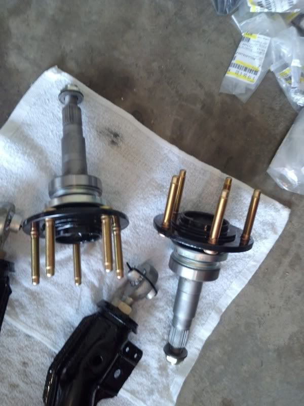

ARP extended wheel studs and new wheel bearings and seals.
Jay Racing Toe eliminators and new bearings and seals

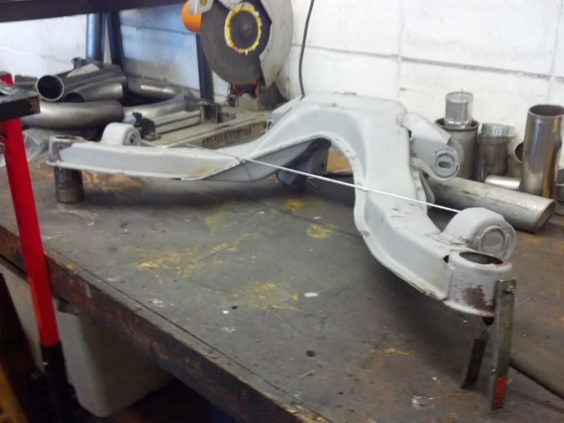

Waiting on my buddy to finish up on the subframe. He's tig welding up the seams and welds on it to help strengthen it. Then it will get reblasted and powdercoated. Also I have poly bushings to go in this.
Then everything will be reassembled with all new OEM hardware.

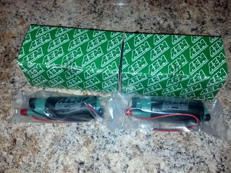

New AEM E85 320lph fuel pumps to go in the fullblown dual pump hanger.

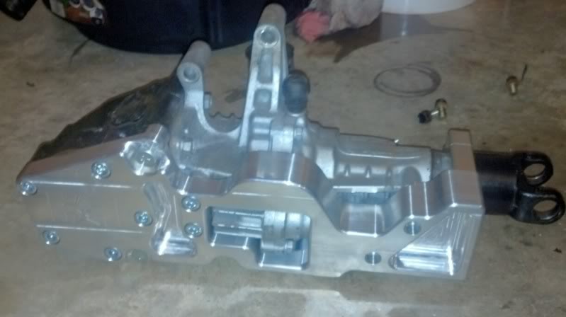

Finally got the Frontline Fab transfer case brace installed. Kind of a pain in the ass, It came with only 7 bolts, Andrew sent me 4 more, I had to go buy 2 more today. I had to tap the holes for the tailshaft clamp because they weren't tapped but 3/4's of an inch. I also had to pretty much destroy the old cover to get the race out of it so I could put it in this thing. ALso replaced the rear and side output shaft seals.

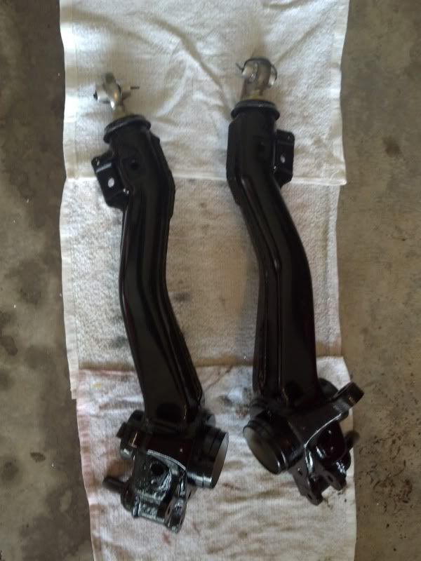

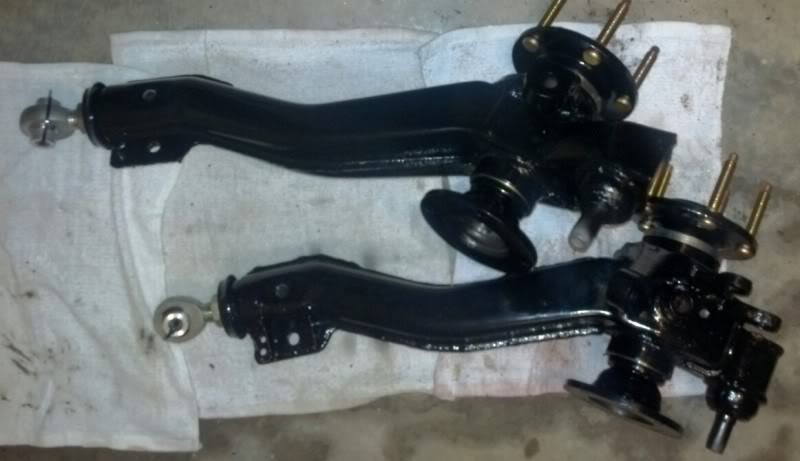

I got the trailing arms and bolted together and done.

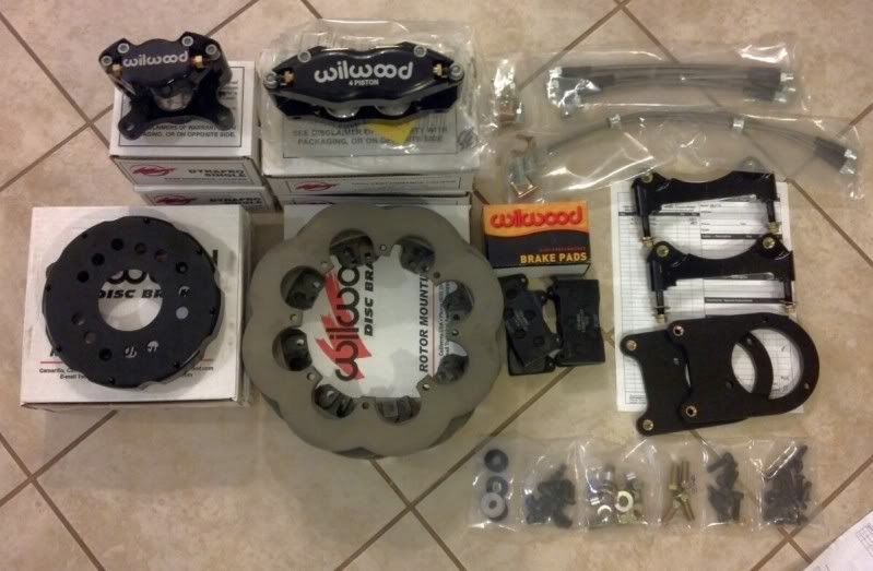

TCE drag brake kit for front and rear came in.
Also Eibach springs for the coilovers.
