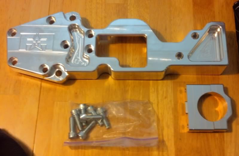

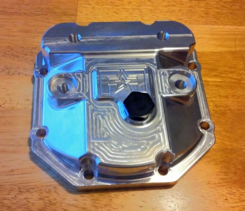

frontline fab diff cover came in today. Just waiting on the transfercase brace and driveshaft loop.

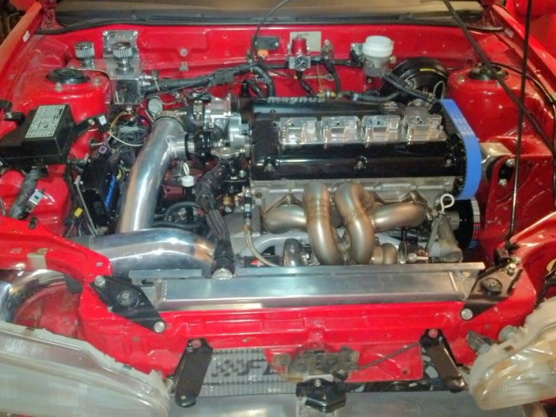

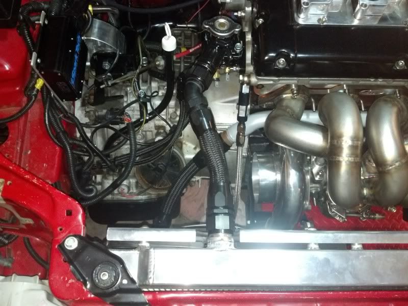

Don't mind the rats nest of wiring, that is going to be the last thing I do in the engine bay. Finally got my -16 AN radiator hoses done. Now I know why not many people do this, a total PITA and expensive! The weld on fittings were cheap (steel one was ARP $12, the other 3 were summit brand like $15 a piece, the hose and fittings were $250 all Earls)
Also, if you notice, I clocked the center cartridge upside down (DOAH!) So I'll be doing that again when I get another off day so I can finish the oil & coolant feed/return lines.

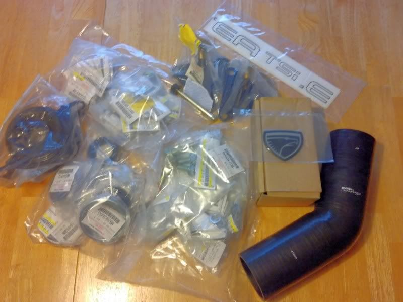

Also my order from JNZ tuning came in today. $500 worth of OEM hardware, time to get started on the rear subframe!
Also pictured is the longest coupler I've ever seen. Its a 12" long 45 degree 3" coupler I got from ATP turbo. With this coupler I will be able to have just one pipe on the cold side (a long 45 degree 3" pipe, and I'll have a long legged 90 2&1/2" pipe on the hot side.

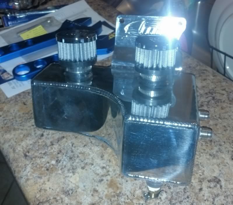

JM Fab oil catch can came in.

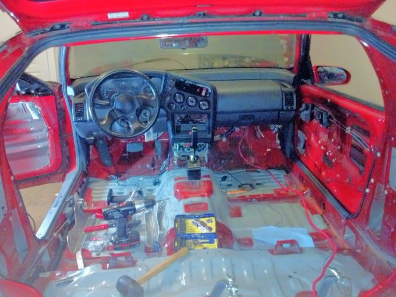

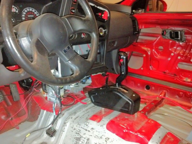

I've got the interior gutted out minus the dash, ready for a cage.

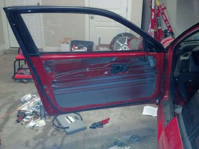

Also have the doors completely gutted except for the crash beams. Once I get some time off work I'll get back at it.

So I got motivated and and got a few things done on the Talon Friday and plan on getting more done tonight. I'm trying to get everything done in the engine bay and rear subframe before I take the car to the chasis shop at the end of May to get the cage installed.

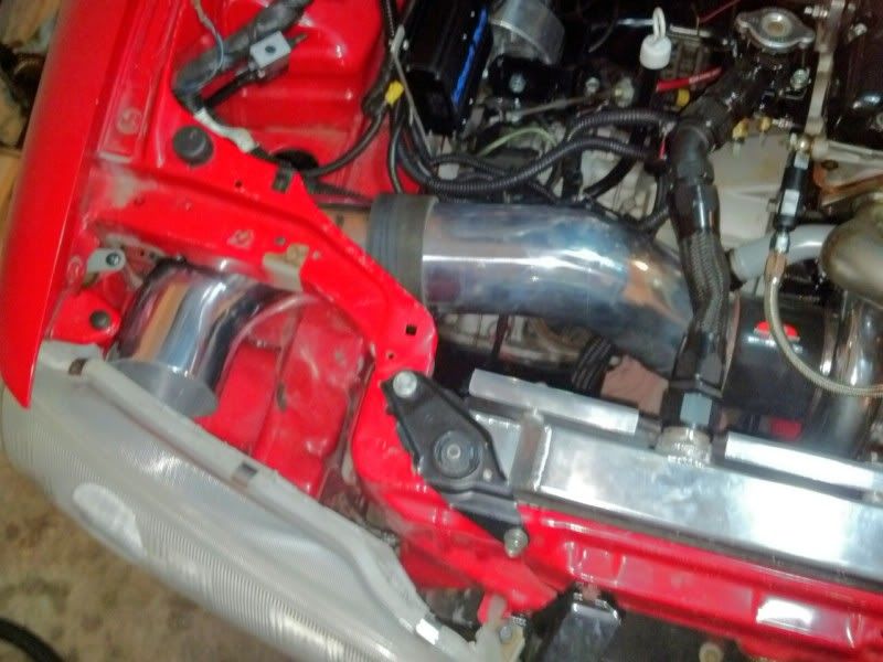

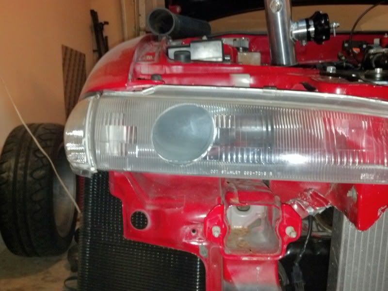

Installed the JM Fab catch can, and got the IC piping done on the cold side, as well as got the ram air intake all mocked up for the turbo, just have to get a 6" long straight piece of pipe welded onto the 90 degree elbow.

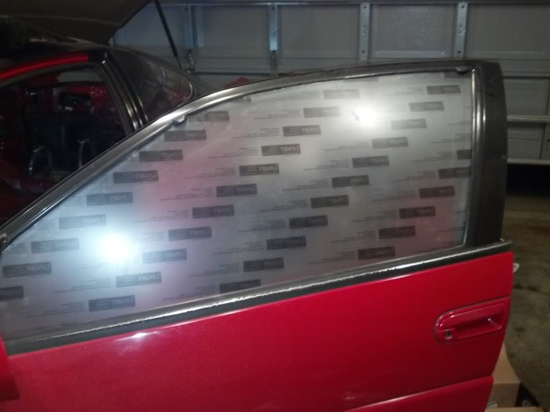

I got the drivers side door all gutted and got the lexan window cut out and installed.
I finished up the ratchet shifter as far as how I want it setup. I installed the cover it came with to make it look a little sleeker than just a bare shifter. I'm still working on removing spotwelds and some misc pieces of metal from the interior. Like the rear speaker braces that attach to the shocktowers, the hoops that the rear seats attach to and some other misc things that aren't needed.
