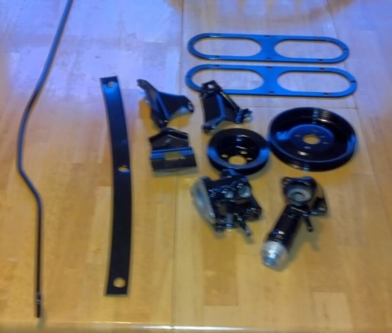

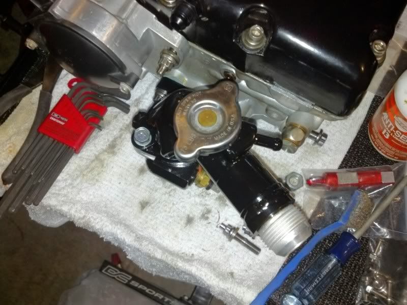

got some misc parts powder coated, also I got -16 AN bung welded onto my thermostat housing and the cold side of my intercooler changed to 3".
Hood prop, water pump pulleys, brackets for the front bumper, thermostat housing, JM Fab defussers

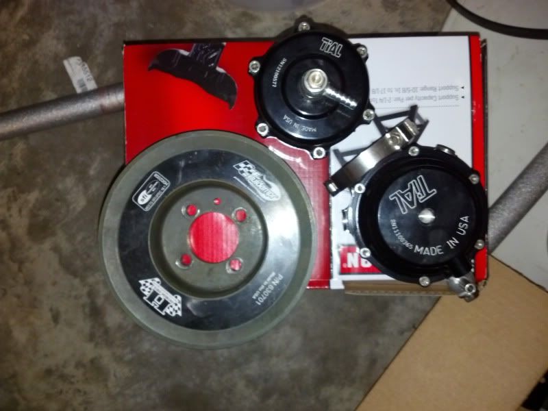

Also forgot to post these other parts I've had for this new setup.

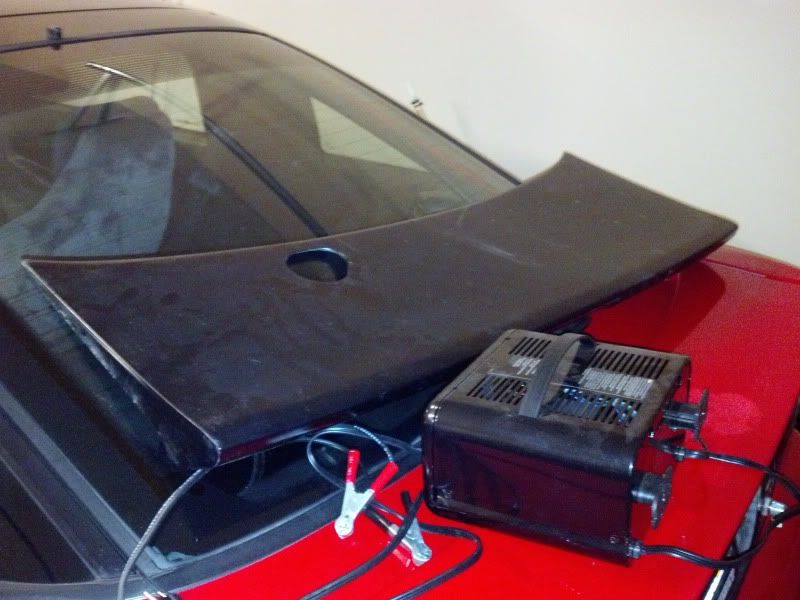

1990 center wingI'll have the hole for the wiper filled and painted to match the car. I'm debating to either go ahead and install it on the hatch on the car now or wait until I get a CF hatch.
Some expensive BLING from Sparktech, I went ahead and got the coilpack covers.
Tial Q BOV, Tial 44mm wastegate, Fluidamper crank pulley

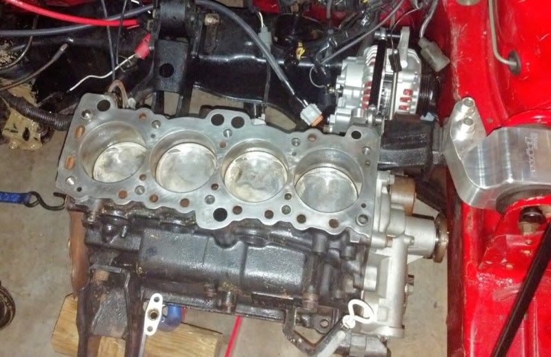

Okay, I'm pretty sure I've got everything here or on the way to finish putting the motor and trans back together and into the car. Now I'm getting my ducks in a row so to say to start on the rear suspension. I've got everything to rebuild the rear driveshaft and install it with new OEM parts, also I'll be ordering a Driveshaft shop driveshaft (the 900hp one). I have the Frontline Fab driveshaft loop on the way and the Torque Solutions carrier bearing bushings and new OEM nuts to mount everything.
The rear subframe will be removed, disassembled and everything will be blasted and powdercoated gloss black. I have the Jays Racing toe eliminators that will be installed, Poly Subframe bushings and ES bushings, I already have the adjustable camber arms, but I have pieced together a kit to replace the lower control arms that will take a couple pounds off the car. I also have the Chromoly Mustache bar to install. The diff itself I will probably just wire brush and wire wheel it and spray paint it with a high temp gloss black enamel paint. The rear diff cover I'm going to take to my powder coat guy and get him to do it in a "Show Chrome" color. I'm thinking this will make it stickout and kind of match the JM Fab fuel cell.

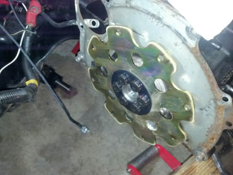

Actually got around to tinkering with the Talon. I got some more OEM parts in and the new Kiggly Fexplate.
Installed the new Kiggly flexplate, ARP flexplate bolts (lots of red loctite and torqued to 130ft/lbs), new spacer, and a new crank bushing.
After I took this picture I noticed how hidious my starter plate looked! I'm not going to remove the flexplate now since its already torqued down and all. I'll probably order a new one and replace it if I ever pull the trans again.

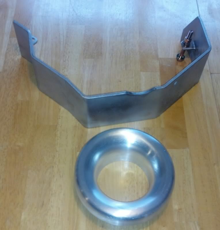

Three Speed scatter shield and 4" Vibrant vilocity stack
I was at first going to modify a stock headlight to turn the whole headlight into a ram air type device but my fiberglass skills are very poor to say the least so that idea was scrapped and I'll be going back to the junkyard for another headlight to modify. I'm just simple going to cut the back of it out and gut it leaving the full lense on the front and cut a hole in it and run a 4" pipe to it that will be welded to the vilocity stack. I'll then get a 4" 90 degree aluminum pipe that will turn into the Dejon intake pipe that goes to the turbo.
The scatter shield I'm probably going to get powdercoated. I'm still trying to decide if I'm going to go with a gloss black color or a show chrome color. I'd like for it to standout from everything else and I have enough gloss black on everything else already, I'd polish it but being steel it will end up rusting if I sand it. So that is why I'm probably going to go with the show chrome color. I also plan on doing my rear diff cover the same color once I get the engine bay finished and start on the suspension.

I would test fit that scatter shield. As far as I know and have scene it does not fit the automatic bell housing. Most guys custom make a scatter shield for the auto trans!
Son of a bi***!
You sir, are correct. :banghead:
It's a minor set back! I remember seeing guys usin 1/4 flat stock, bending and welding mount points on. I can't see it being hard at! I know there is pictures floating. Maybe go on google image and type in awd auto talon scatter shield or something.
Screw it. I was just trying to follow NHRA rules, but come to find out the Three Speed Scatter shield isn't even SFI approved. I spoke with a buddy who lives locally and has a manual 1G making over 500whp, he's running a Precision Turbo and before he bought it he bought feed and return lines and fittings for a FP turbo, so I'm going to trade him the scatter shield for those parts.

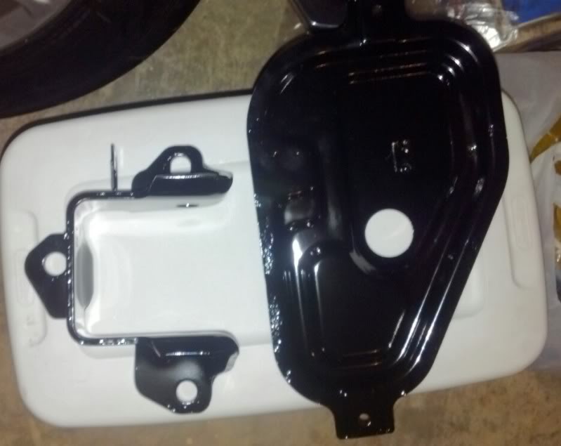

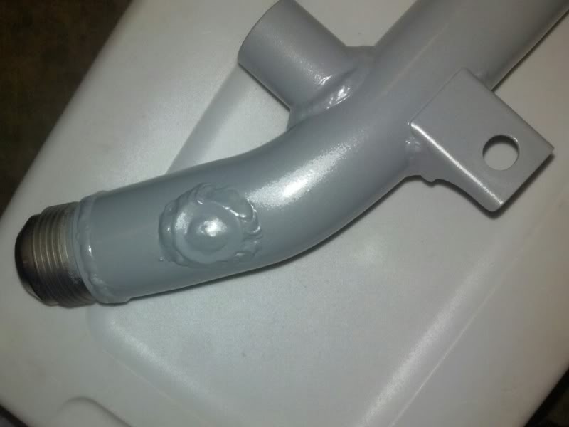

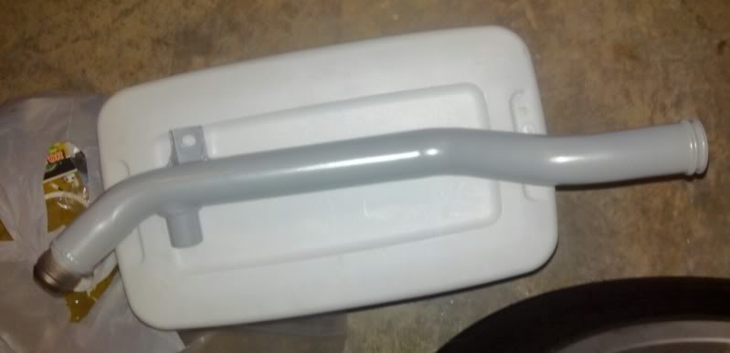

Got some more parts powdercoated and some fittings welded on.

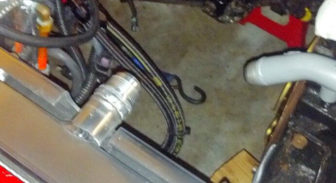

Radiator feed and return fittings welded on along with the crossover pipe.

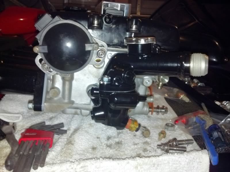

I got the part that goes to the heater core and to the TB and thermostat housing removed and welded up.

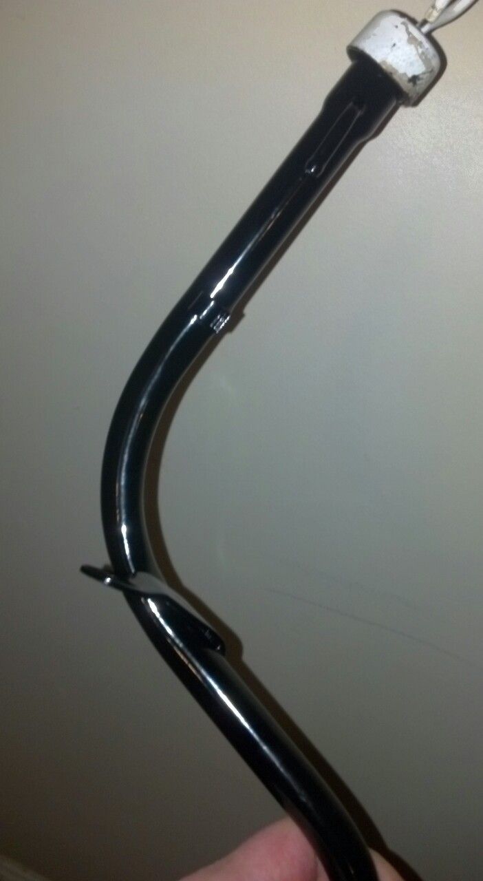

Transmission dipstick powdercoated gloss black. Now I need a new dipstick LOL
Transmission mount bracket and fuel sending unit cover. gloss black

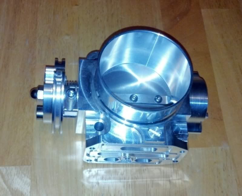

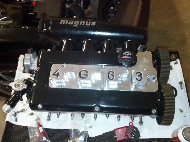

S90 70mm throttle body. I got another JM Fab FIACV bypass plate and I'm waiting on my adapter plate to come in from Magnus so I can mount this to the Magnus manifold.
