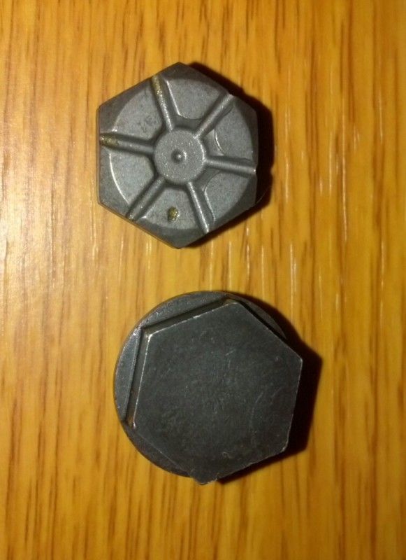

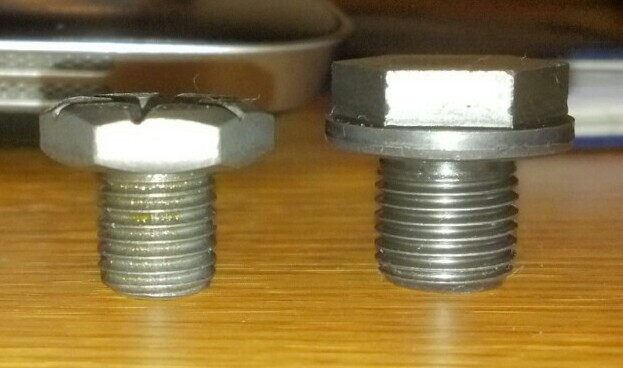

Ordered some new torque converter bolts after I got back from the track since they all backed out on my last pass.
When I got them in they sent me the wrong bolts, they sent me Flywheel bolts. WTF!!!
So I got the correct part number for the bolts and ordered them.

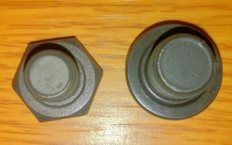

Bolt with the slits in it is a torque converter bolt.
Here is the difference>>
I mailed one of the torque converter bolts off to ARP to see if they have something to replace it. Even though they don't list or sell torque converter bolts for a DSM they may have something the exact dimensions as this bolt but sell it listed for another vehicle.

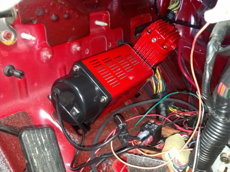

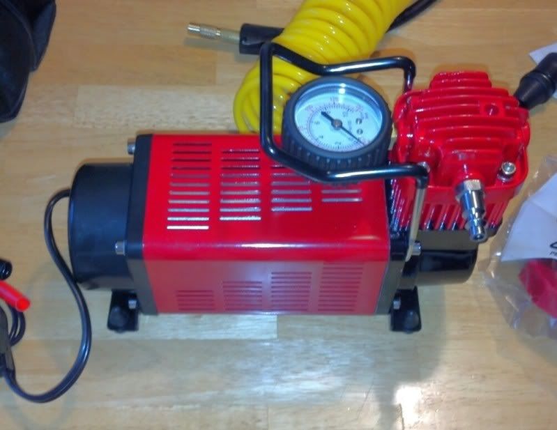

I sold the CNC Staging Brake and will be installing a smittybilt air compressor to help with braking while building the stall.
How this works is I will have it tied into the brake pedal switch and to a relay. So whenever the brake is pressed the compressor will kick on. On the side of the air compressor where it pulls in air for the compressor I will attatch a barb fitting and run a hose along with a check valve to the existing hose going to the brake booster. I will Tee into that line before the check valve going to the booster, So from the compressor to the booster there will be 2 check valves. I talked to Jeff Bush about this and he told me this is what he uses and is the way to go. It basically multiplies the booster by causing a huge draw with massive abouts of vacuum pressure. After its all installed, if its rediculas while any type of driving (tap the brakes, wants to sling me through the windshield) I'm sure I can put a switch in the circuit.

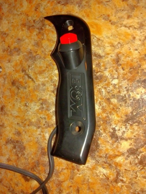

Next is something to spray the nitrous whenver I want rather than have ECMlink do it. Reason being I don't want ECMlink to say "start spraying at 3k rpms (to help build the stall) and cut off at 7-8k rpms. Reason being is because the whole time i'm sitting at the line above 3k rpms waiting for the light to drop of someone else to stage I'll be spraying a 100shot of nitrous. So with this simple thing I can spray at the line to build a quick stall, then spray down the track and stop whenver.

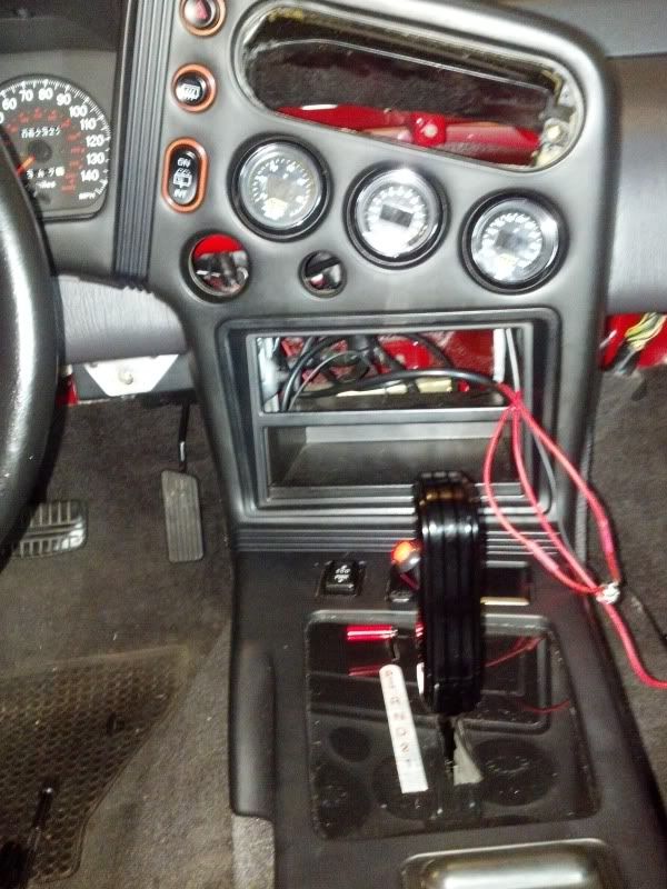

Simple attachment that B&M makes to go onto my ratchet shifter. It replaces one of the shifter handle pieces (5 total, 1 the base and 4 plates) with a plate with a button.
I'll be pulling the dash tonight and tomorrow probably, removing the heater core and some other stuff behind the dash to make room for the compressor and to wire it up and such. I also need to finish installing the trans cooler lines, and I'm waiting to get the center diff welded by English Racing.

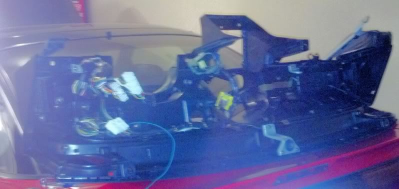

Crappy picture, but started on pulling the dash

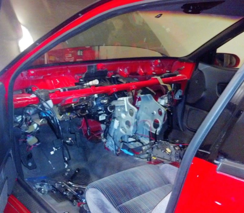

Only thing left is the bolts holding the dash in. I'll be removing the heater core, fan, and all the other stuff associated with that. Also the sound deading material and rubber padding on the firewall.
Well, I've got everything except the actual dash out of the car. I'll probably finish that project in the next couple days and put it all back together, then 8'll just we waiting for my center diff to come back from English Racing. In other news, the end of the Buschur 20G is near. Either the end of this week or next week I'll be ordering a new turbo (FP3794), turbo manifold, intake manifold, built head, and other supporting mods. I'm also thinking of making the switch to E98, the only problem is no one sells it around here or E85. I'll be calling MA performance and seeing how much shipping is for a 55gal drum.

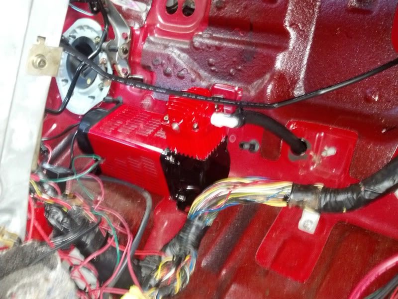

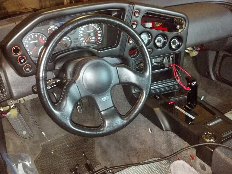

Got everything behind the dash gutted out, installed the vacuum pump, the got the dash and the majority of the interior back together. Just have to install the glove box and the piece that goes under the steering colum.
BTW, pay no attention to all the messy wires. I cleaned all of that up and tucked all of that away once I was done testing and making sure everything worked correctly.

nice car and setup, I just started my auto build, I'm going to have to do some research on the air compressor set up, never seen that done before

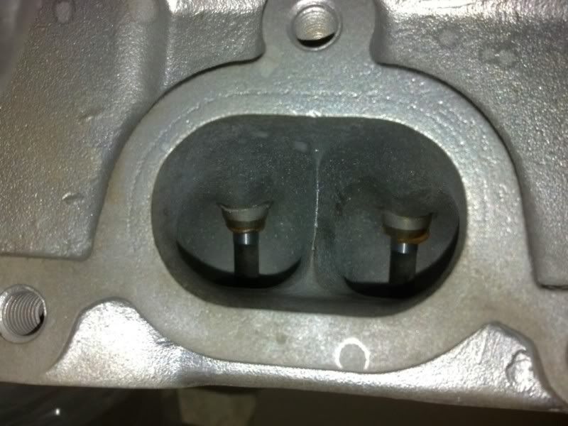

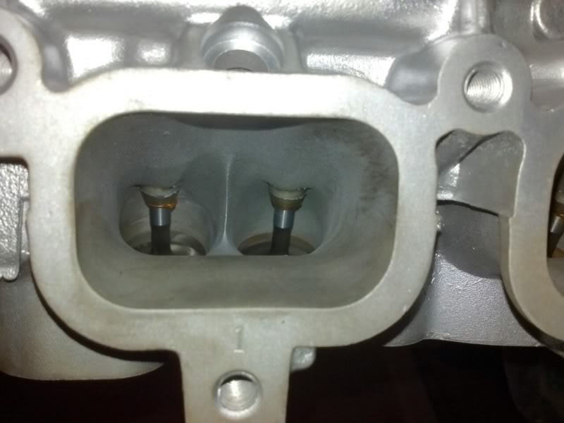

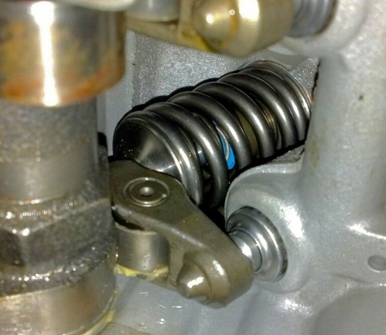

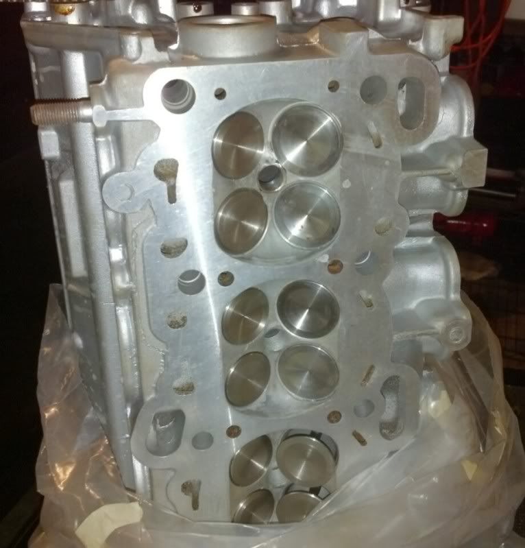

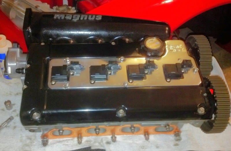

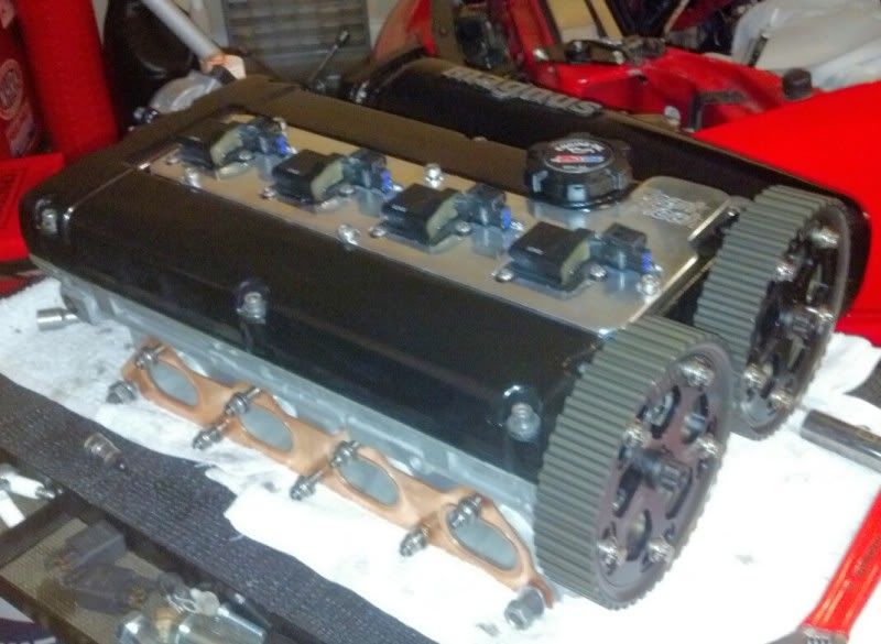

AMS ported & polished head with oversized supertech valves, supertech dual valve springs, vaton valve stem seals, bronze valve guides

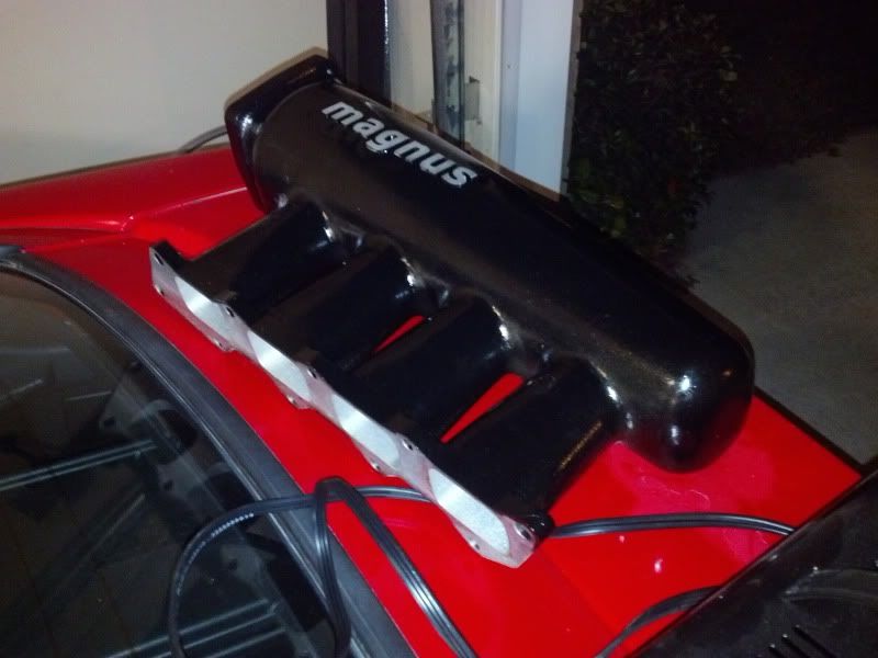

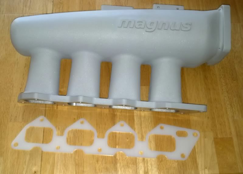

Magnus V3 cast manifold with heat barrier gasket, this will be getting powdercoated gloss black and the "Magnus" will get polished out.
^^^^ the magnus intake manifold if for ## 1g right??? if so then u going to be running it upside down. the place where ## throttle body goes needs to face the other way right??
^^ Correct, the "MAGNUS" is cast on both sides.
I got it powder coated today.
Still need to polish where it says MAGNUS.

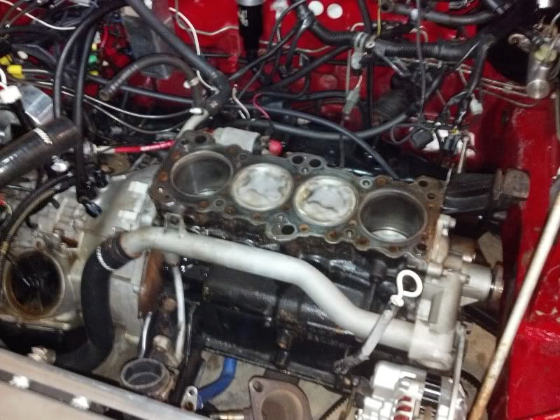

Also pulled my old head off and ordered Kelford 280's and a 70mm Wilson TB. The cams should be here tuesday, the TB is on backorder 3 weeks. Oh well, the turbo is going to take 3-4 weeks anyways before I get it.
Eventually whenver I pull the motor for a paint job I'm going to snatch the harness out and rebuild it. I can't stand the freaking rats nest thats going on.

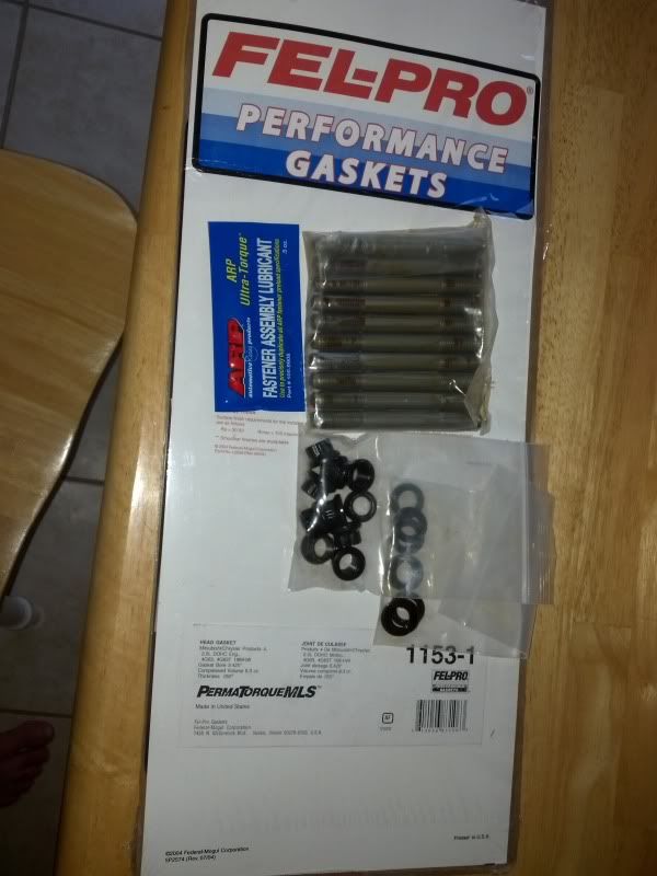

Modern Automotive Performance A1 Ultra Duty head studs and Felpro Perma torque headgasket came in today

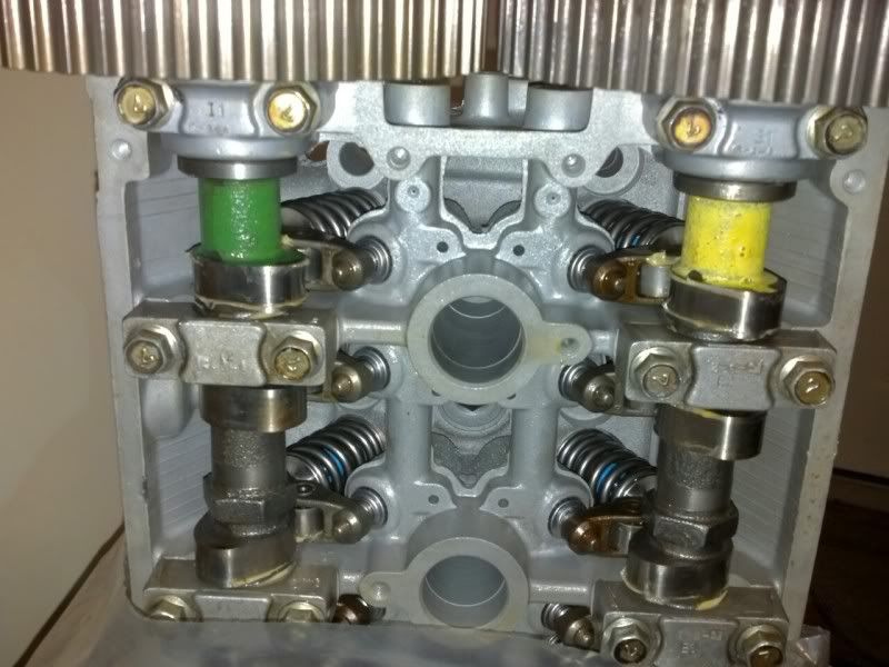

Kelford 280/280 cams

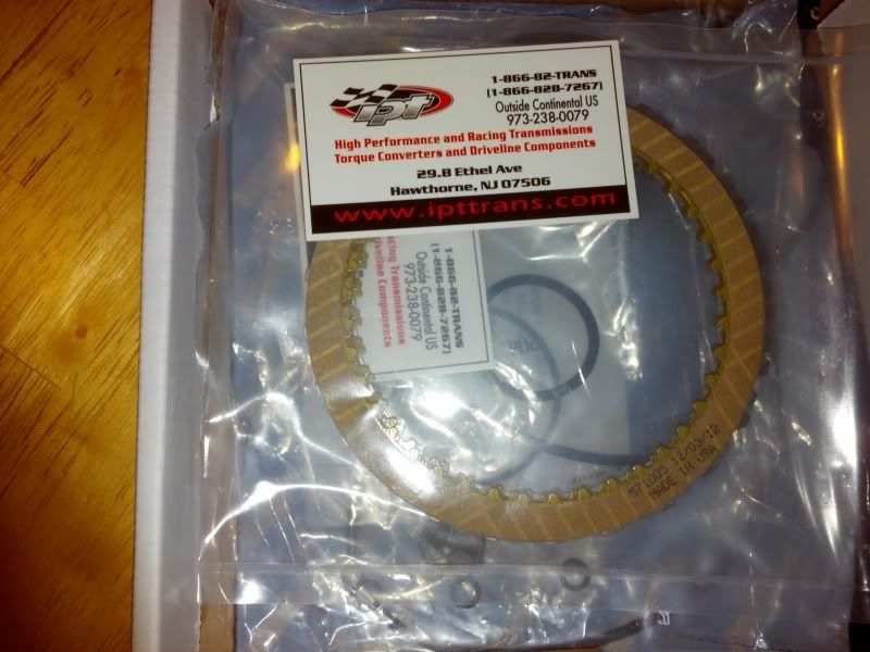

IPT end clutches

Did some tinkering in the garage this past weekend. I got the Kiggly front clutches I've had forever installed in the trans along with the IPT end clutch kit.
Also I've got the Kelfords in the new head and everything torqued town to spec. I'm just waiting on all the new OEM bolts, nuts, and washers I ordered for the intake manifold, thermostat housing and CAS to show up. I think since I'm swapping the fluidyne for a small civic sized radiator I'm going to do AN lines for the radiator and have the crossover pipe modified and powder coated along with the thermostat housing.

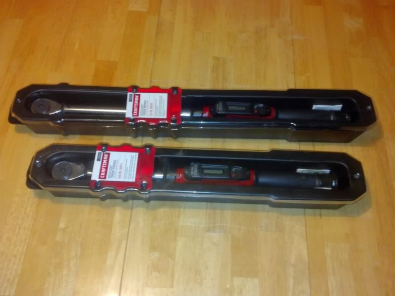

Also bought some new Craftsman digital torque wrenches for the build

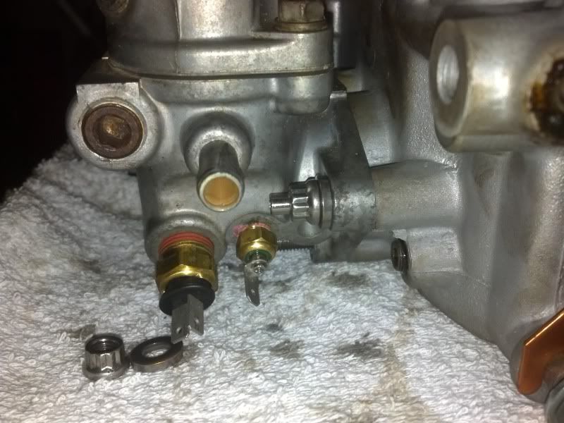

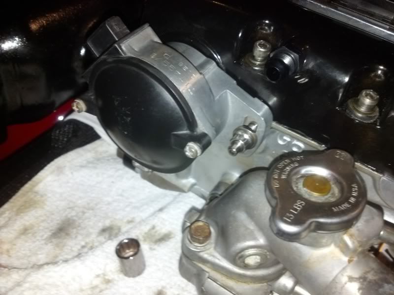

The new head I got was missing the studs, nuts, washers, and lock washers for the CAS and the thermostat housing. Trying desperately I've been contacting OEM Mitsubishi parts dealerships, as well as DSM vendors with absolutely no luck. Well I bought a ARP exhaust manifold stud kit from my buddy and it didn't have the outer larger 14mm studs or bolts. He just gave me some parts store nuts and washers that he used. I could not accept this and researched and found that Extremepsi sells a kit that comes with 14mm bolts so I purchased it.
I also was looking at the ARP studs, nuts and washers that I have now as extra and was looking at the CAS and thermostat housing holes where the studs go. Well wouldn't you know it, the manifold studs go right in! So problem solved and a plus as I have bling bling ARP stainless studs and nuts now for those areas LOL.
Pics of the ARP manifold studs being used for the CAS studs and the Thermostat housing studs.
Again, the only reason I done this is because the head I got was missing the studs.
I bought new bolts for the thermostat housing, a new thermostat, and some OEM plugs to replace the nipples on the back side of the housing that went to the TB and to the heater core since I won't be running them. I'm going to weld a -16 AN fitting on the upper part of the housing for the radiator since I'm switching to a half sized civic radiator. I'll get the whole thermostat housing powdercoated gloss black.

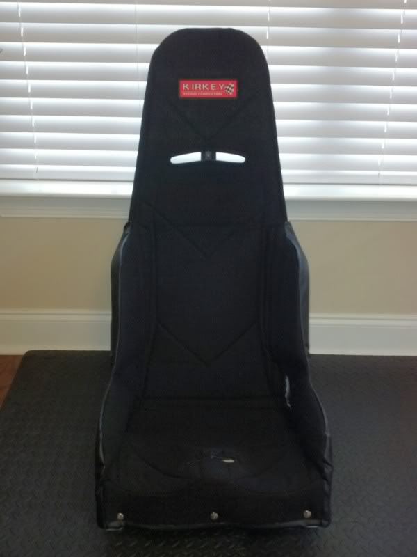

Got my -16 AN fittings in, now I just need to take my thermostat housing and crossover pipe to my buddy to have them welded on. Also got a Kirkey seat and some other misc stuff.
