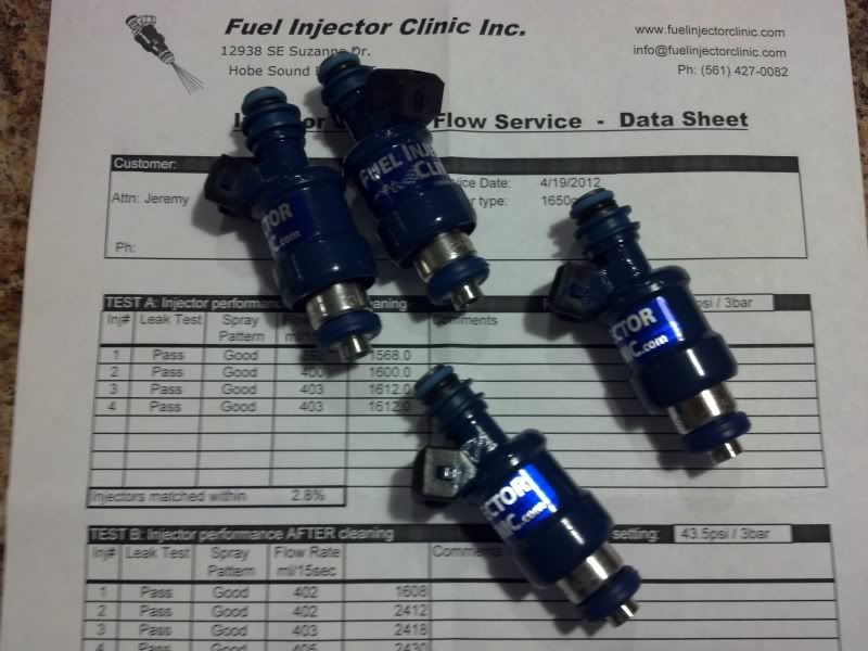

Injectors were clogged and one was stuck. I'm going to be sending them to FIC to get cleaned and tested. Also found out that my sparktech COP was wired wrong from sparktech.

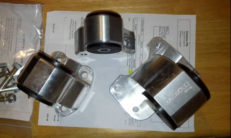

Avid motor mounts came in the other day.

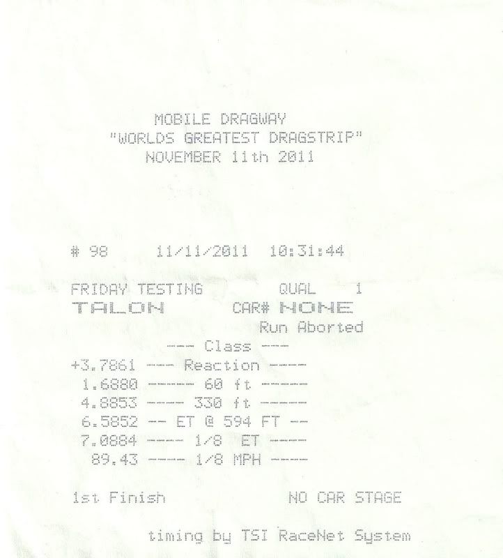

Here is a time slip from the 1/8 mile track. I made 4 passes, three 7.1's and this 7.0
This was on street tires, VP Q16, 28psi, and no nitrous.
I have since did several mods plus removed some weight. I can't wait to get my 1650's back from FIC so I can retune the car on the nitrous and take it back to the track on the slicks. Then its off the the 1/4th mile to make some passes.

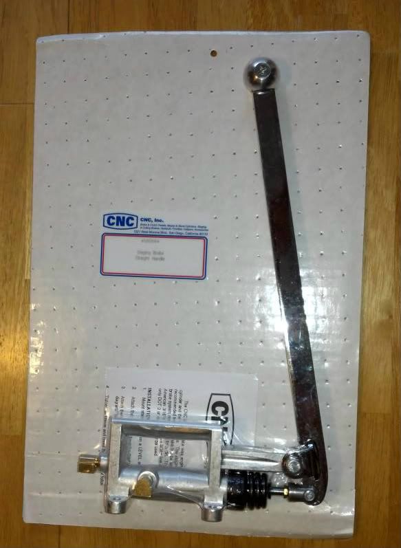

CNC staging brake came in today

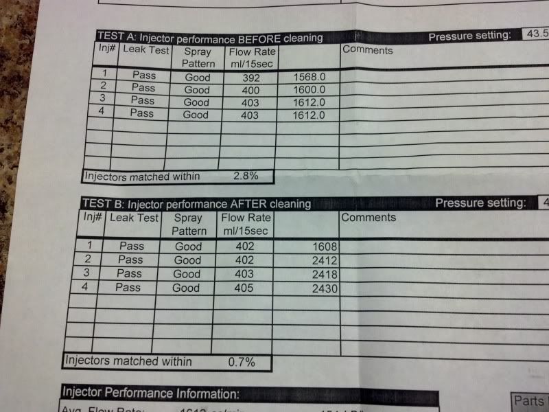

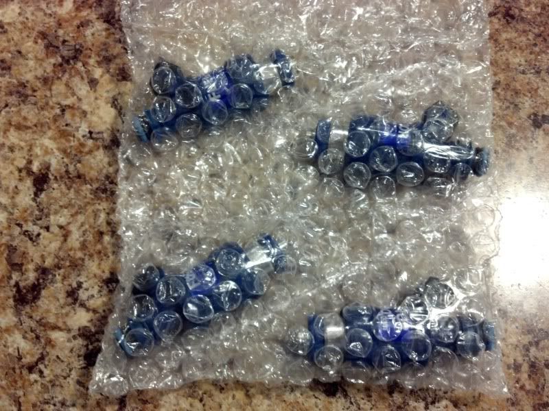

Got my injectors back from FIC. I mailed them off Monday and got them back Saturday!
To anyone that buys used top feed injectors I highly recommend sending them off to get clean and flow tested. For $20 an injector and $10 shipping you can't beat it. Plus they repainted them and supplied all new O-rings and seals.

Ahhhh, I just wasn't sure. I thought when you ordered the staging brake, you get all the lines/hardware also? Did I think wrong? I know you can route them how you want, but figured it was a full assembly.
unfortunately no. What you see in the pic is what you get.
I'm trying to figure out now where to get custom length steel braided brake line so I can plumb it. I got some steel from work (I work at SSAB Steel Mill) to make a mounting bracket coming off the trans tunnel close to where the E-brake was.
I've noticed some just do the -3an Earl SS lines and call it a day with no problems. Probably the same way I will do it.
