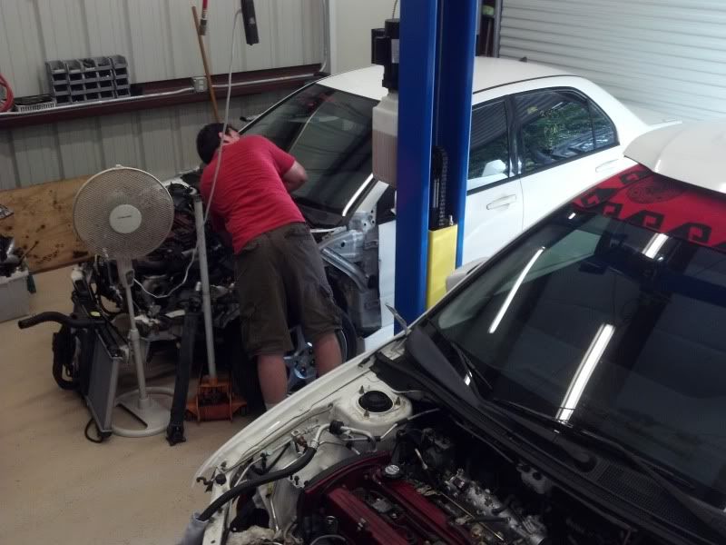

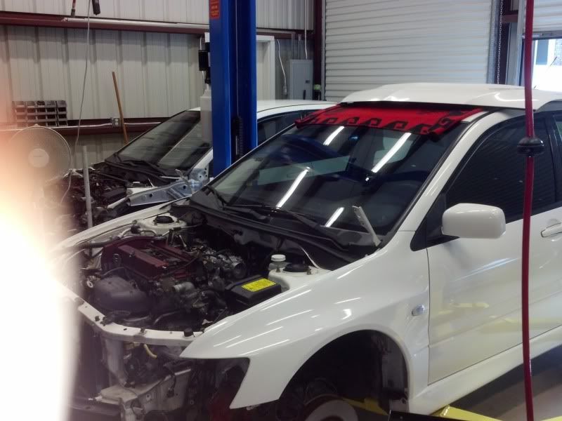

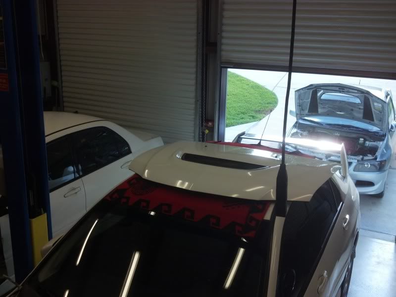

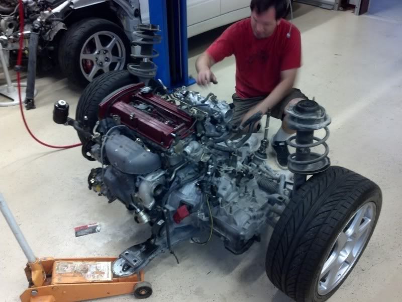

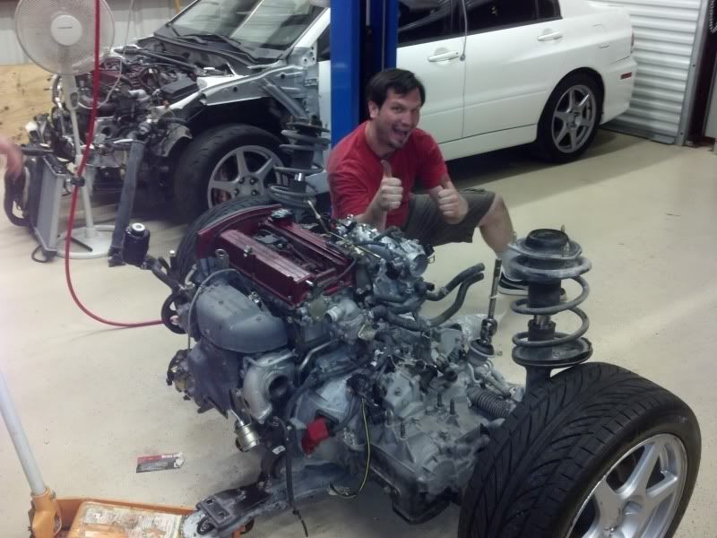

So here is what I've been doing since I haven't been messing with the Talon....

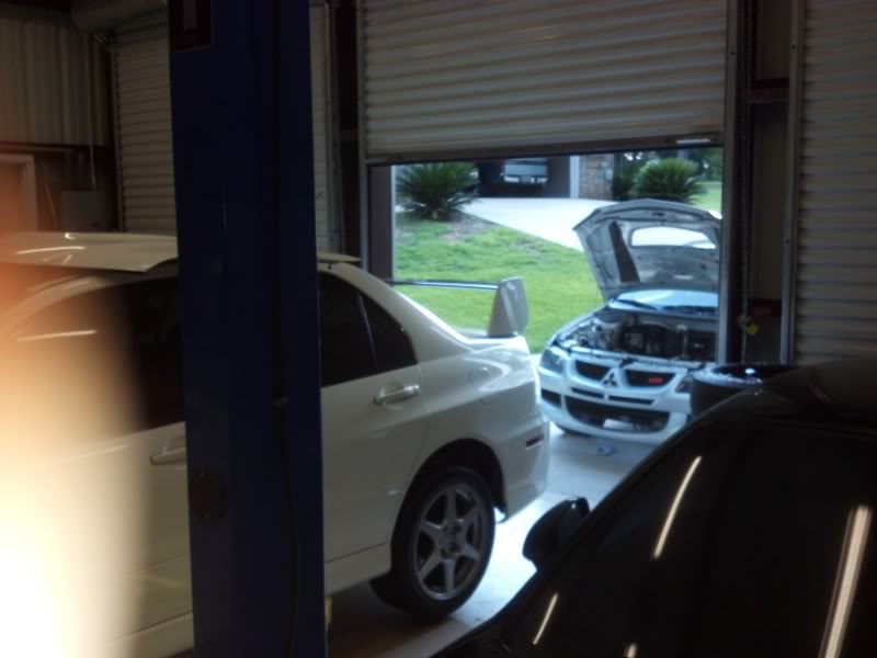

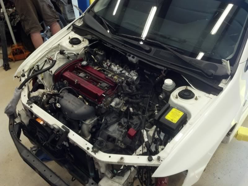

Let me say, working on an Evo is nothing like a DSM. They are a PITA! But i'm sure repetition is the thing, do something enough and you'll get good at it. After all of this I'm sure Chuck and I will be pretty decent at wrenching on Evo's. Deffinately a fun learning experience.
chuck that had the orange talon and bought the silver evo??
looks fun man and nice shop for sure
No thats Joe you're talking about. Chuck is the guy in the pictures. He had a turquoise 1G AWD that he had for 11 years. He sold it and bought the two white Evo's pictured. Its fun to use because its something new and different, the Shop is Chucks, 24x30 I believe (3 bays, lift in the middle, air and power lines on reels, 90gal craftsman pro compressor, badass fridge/cooler, sound system, Tig welder, all the tools you need, and soon to have wi-fi LOL

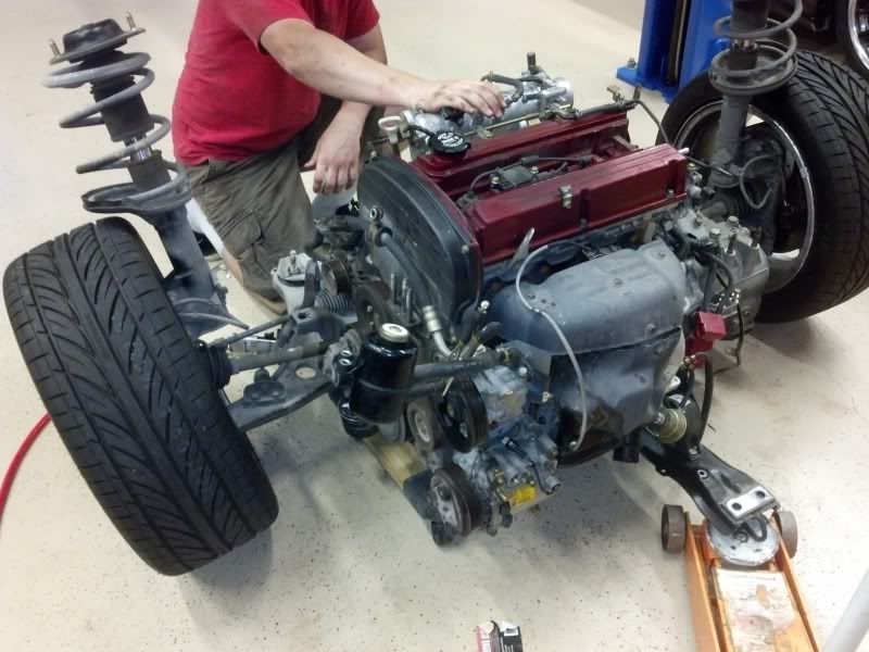

Any pics of the crashed evo?
The crashed Evo is the one on the left (white with no wing) in every picture. The front frame rails are bent. What the owner wants to do is take everything off the crashed Evo that is in better condition than whats on the 90K Evo and swap them. The motor/drivetrain, interior, so on. Then whats left I'm sure he'll be parting out on EvoM or some forum.

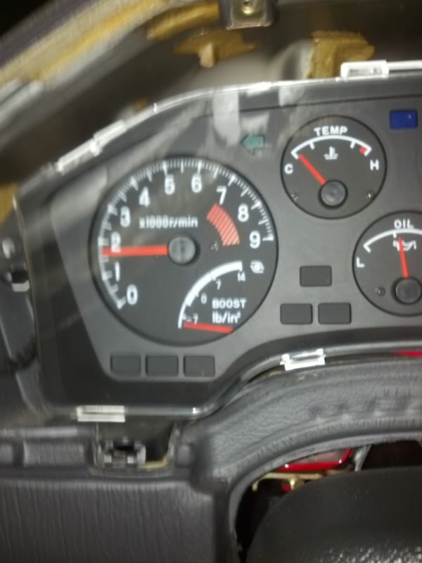

okay after a month off of messing with the talon I finally got in the mood to fool with it.

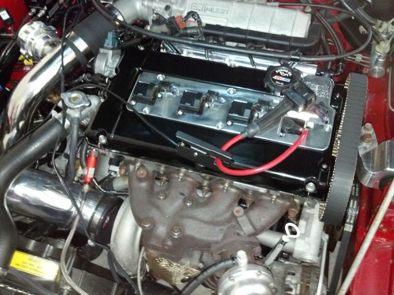

After installing the Sparktech COP (coil on plug) CDI (M&W pro-12 ignition box) Pro system, I found out the factory tach didn't work in the car. The reason is because the setup bypasses the connector that the factory coils plugged into that the tach got its signal from.
After calling Sparktech and getting the answer of "oh well most people who run this setup use an external tach" and calling other shops and getting no answer to my problem, I got the multimeter out and tried figuring out what the hell to do. There is a tach signal output wire on the CDI for an external tach, so I knew it had to go to the tach somehow so it can get a signal. Well I pulled the gauge cluster out and pulled the plug that goes to the gauge cluster out on the tach side and looking at schematics of the wiring I figured out which wire went to the tach and cut it in half. I ran the tach signal wire to it and tied it in then with my fingers crossed I fired the car up.
SUCCESS!!!!!

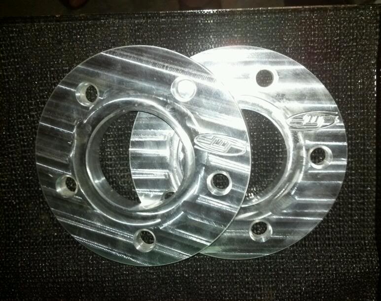

Also got four JM Fab hubcentric wheel spacers (10mm) for all four wheels. I needed these to run the FD wheels with the Hoosiers mounted on them.

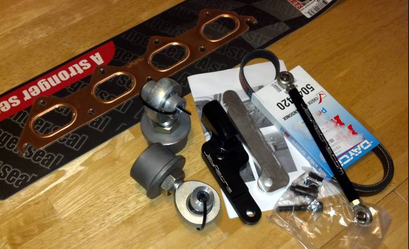

Also got some parts from my ole buddy Chuck who parted out his 1G and sold the chasis.
Jays Racing Alternator relocation kit, Toe Eliminators, and a copper gasket for the turbo manifold for when I upgrade the ported 2G one.

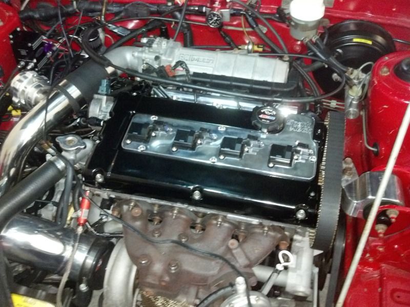

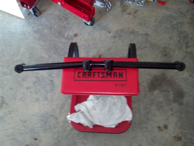

I got my valve cover and chromoly mustache bar powdercoated gloss black
Also, resetting the timing with a COP setup is a PITA!

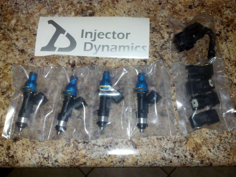

So I wasn't able to make it to Import Showdown. I went out Friday night and tried to retune the Talon but we couldn't get the injectors to cooperate. Fusterated, I came home and snatched them out and sold them, ordered a set of ID 1000cc High Z injectors with plug and play adapters and a resistor box delete plug.

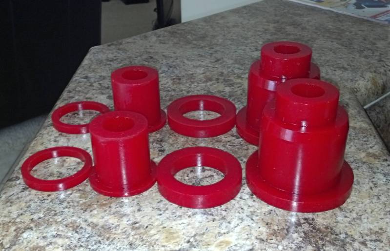

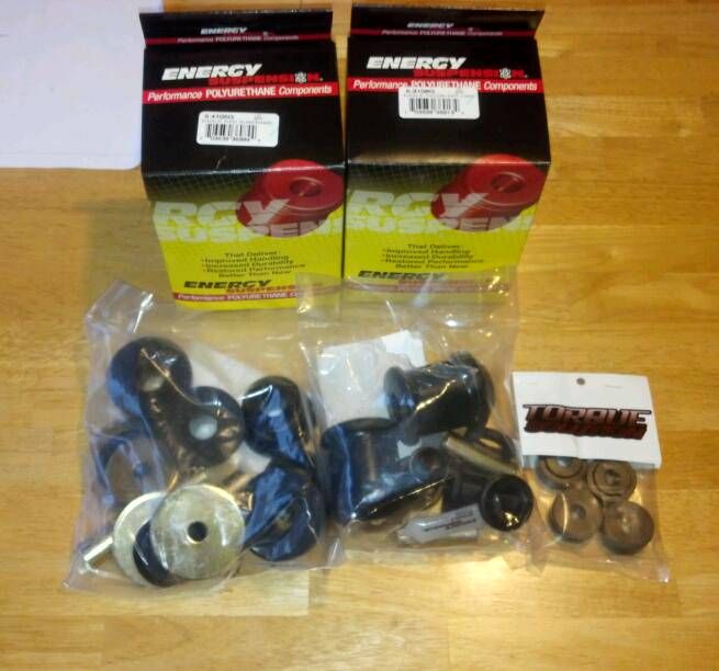

Last of my suspension bushings came in today.
Front lower control arms, front subframe bushings, and driveshaft bushings.
All of the suspension bushings won't go on the car until I get it retuned and back on the track and make some passes.

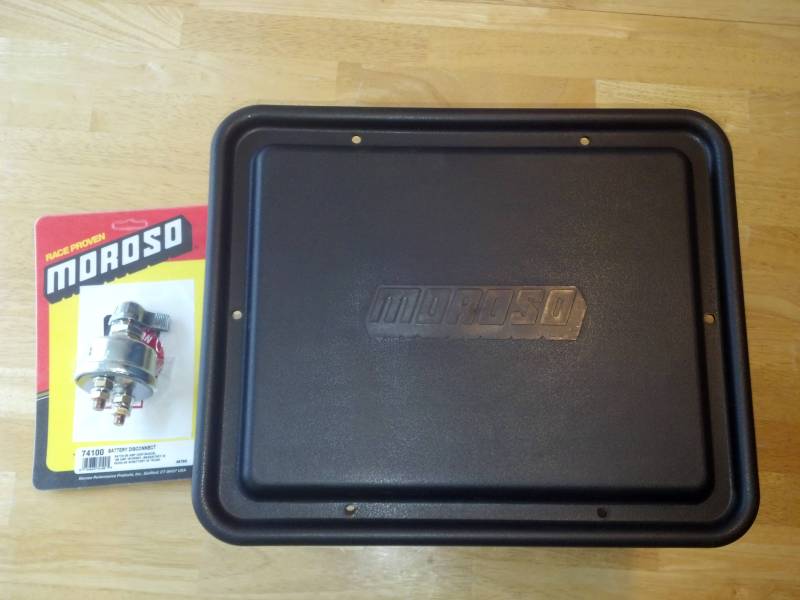

Got a Moroso sealed battery box that meets NHRA rules/regulations to replace the walmart special non sealed box I have now. Also got a Moroso battery cuttoff switch.
