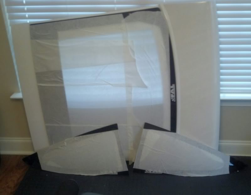

FAL window kit. Super light weight stuff!

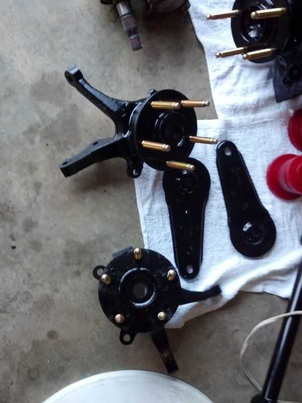

Front spindles powdercoated, new ARP extended studs, new wheel bearing and seals

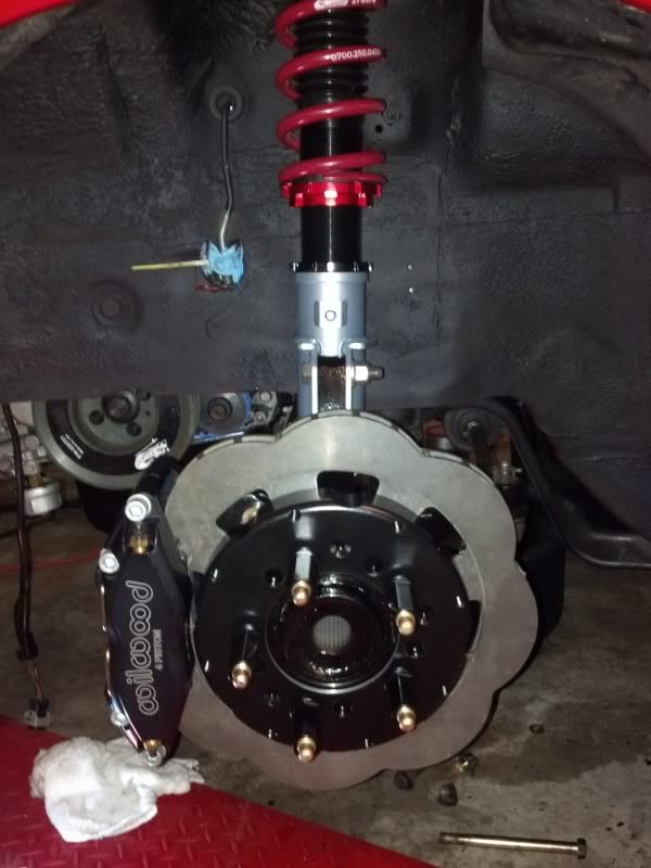

Got the front brakes installed along with the front coilovers, and resprayed the fender wells

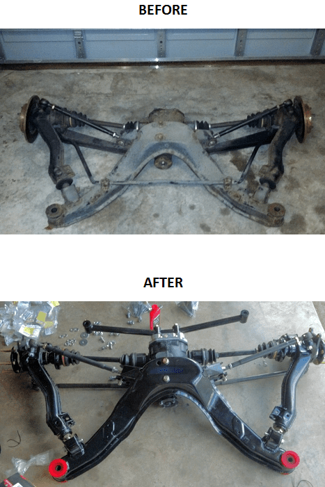

Waiting on the rear subframe to comeback from powdercoat and then I can finish the rear.

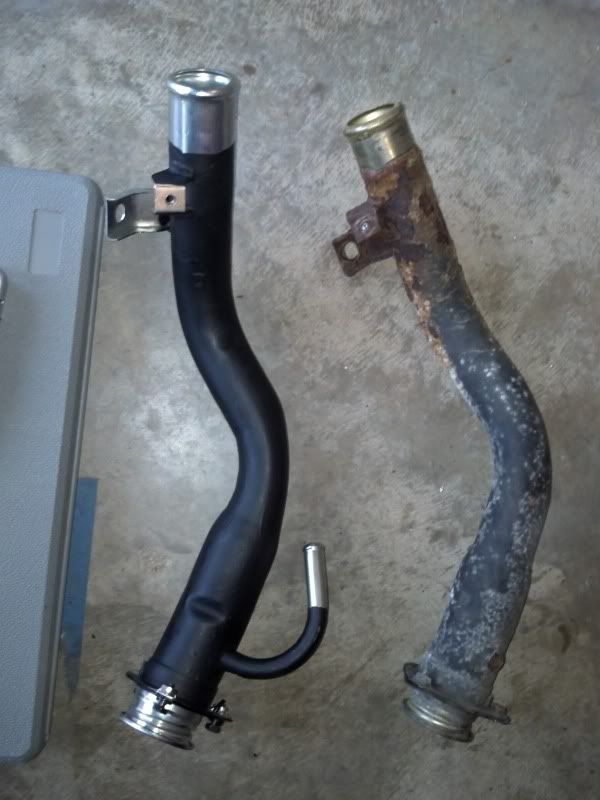

Oh, since I'm OCD and have to have everything as close to perfect as I can, I wanted to replace the fuel neck with a new one since the one on the car is rusty and looks like crap. I called Paul at JNZ and he first said they didn't make them anymore, but then found one in CT. He told me that it was probably the last one in existence.
Rear subframe is pretty much done. Just have to bolt everything together and install. I just layed everything together to make sure I had everything. Nope, Axle bolts, nuts, washers on the way from JNZ Tuning.

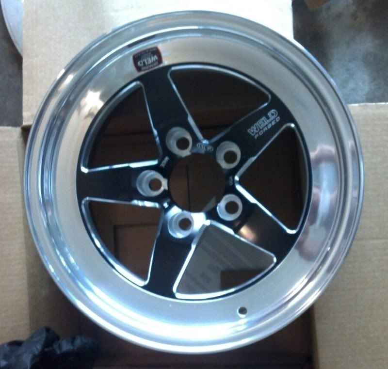

Wheels came in WOOT! WOOT!

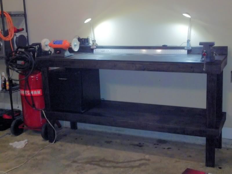

Also, I decided to build a work bench for the garage.
I stained it with minwax ebony wood stain, bought a mini fridge, Craftsman 5 ton vice, a buffer from harbor Freight (sears was out of Craftsman buffers), and attached a couple adjustable LED lights.

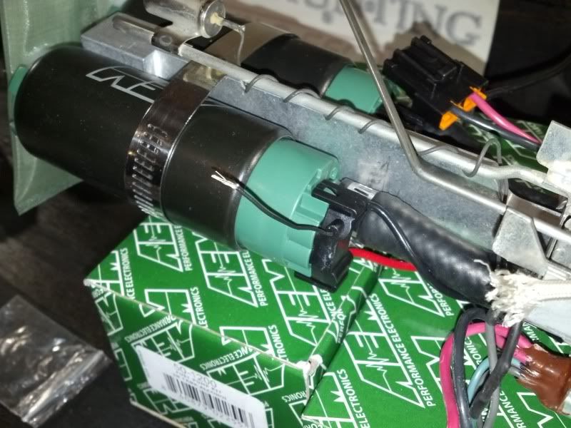

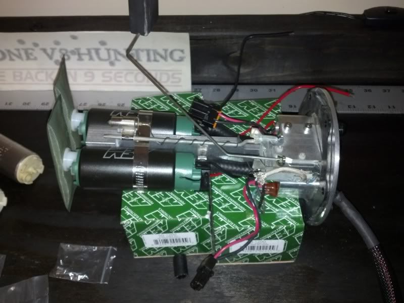

Why did you go with the dual AEM 320LPH over something like Bosch 044s or single pump? You will have to run more gas in the tank (more weigh) to help keep these pumps from starving.
In case these pumps came with universal socks/filters which might not fit into a 1G setup, the 4Runner socks will bolt right up and can be found at NAPA. Part# STS-49.

I got the fullblown dual pump hanger when they first came out before there were any big drop in fuel pumps. I didn't want to have to run an inline pump like a bosch 044 or Aeromotive because at the time it was a street car and those pumps are loud as hell.
The pumps came with filters, but I also have some smaller filters new from Walbro which will fit as well if the AEM ones are too big.
If I see issues with the pumps, voltage drop and such which would cause an issue like starving the motor of fuel I will switch to a mechanical setup which is belt driven off the cam gear like linked below...

AEM E85 fuel pumps attached to the Fullblown dual pump hanger. I just need to figure out what the heck this small black wire is for?!?!?!
Only bad thing I can say about these are that they are NOT a direct replacement for a Walbro 255, the plugs are completely different so you'll have to cut, solder, and heatshrink the wires.
Its a R&R. They don't make them anymore, its old.

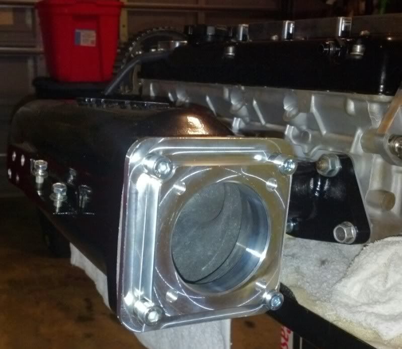

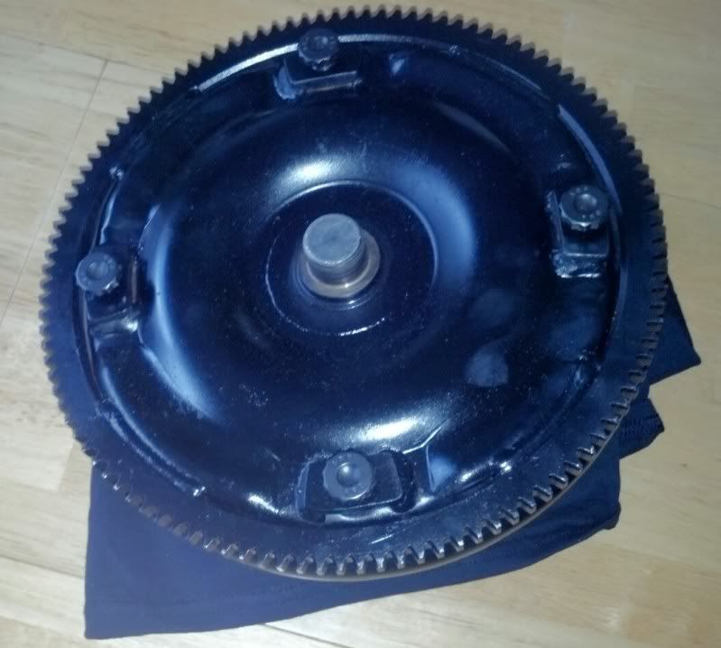

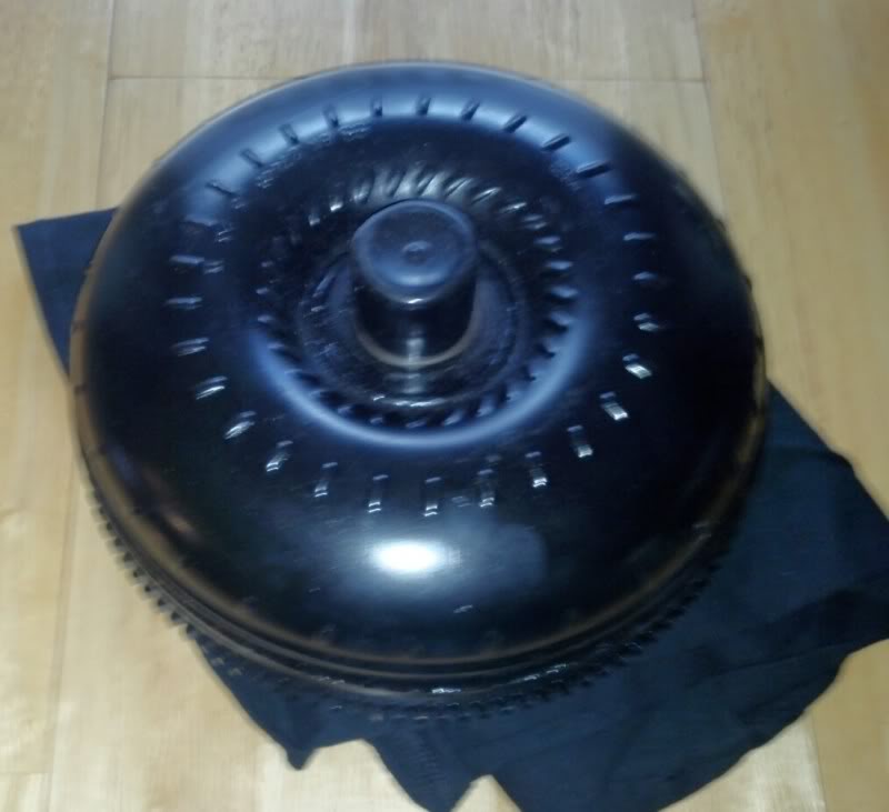

Bradco converter finally came in today along with the Magnus throttle body adapter.

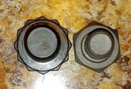

New converter to flexplate bolts
Throttle body adapter
So now I'll be installing the trans and head finally tonight.

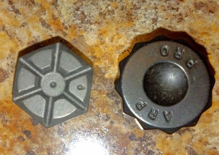

Very nice Build!! Would you happen to have the part# for the ARP TC bolts? I am having trouble finding an ARP 1/2"x 20 with a UHL of .625

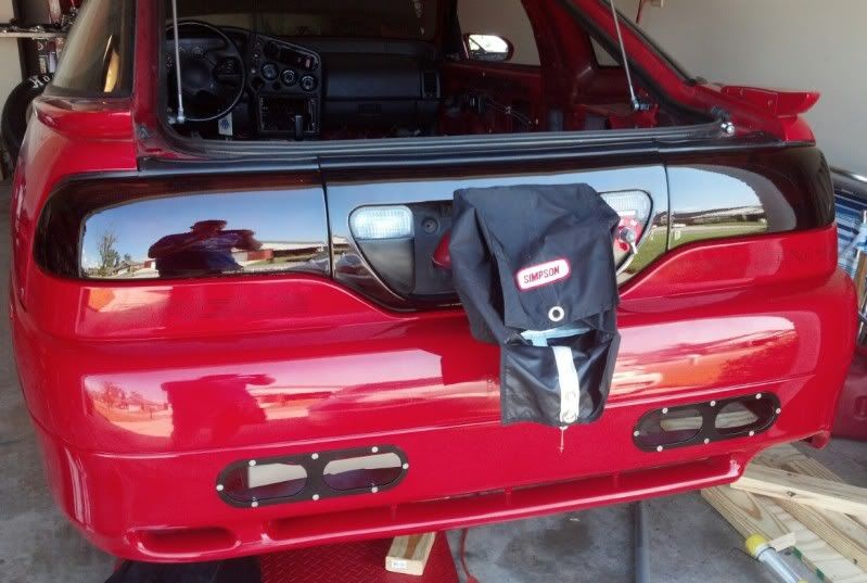

Well with this hot ass weather it's still been difficult to motivate myself to work on this thing. I finally got some progress done though. Suspension is pretty much done, just waiting on a couple bolts from JNZ, I got the rear bumper repaired and repainted and the taillights tinted. Now I just need to pack the chute and a couple other things.
Didn't notice you got those wheels! LOVE them! 9.5x should be no problem for you once you get the car sorted. Low boost will get you there...especially on that converter. Can't wait till mine arrives!
I ordered them with the correct back spacing and pad height so I don't have to use spacers.
The fit perfectly with coilovers and the TCE drag brake kit.

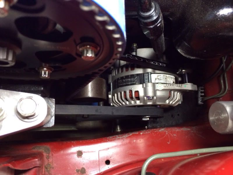

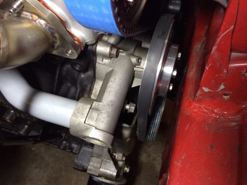

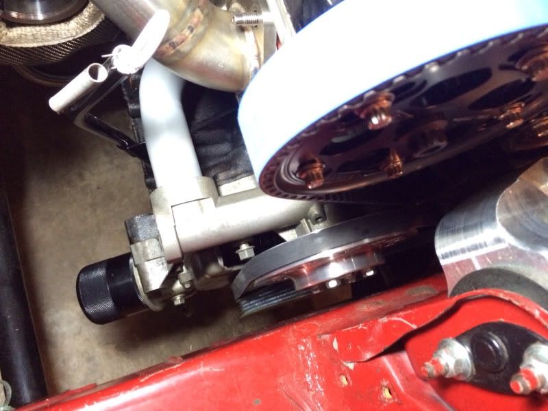

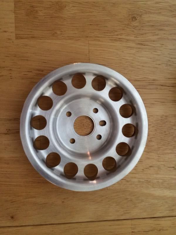

Got a custom water pump pulley that allows me to run the Jay Racing Alternator relocation kit without having to bash in the frame rail.

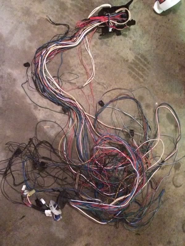

I also got the chasis wiring harness all stripped down and will be removing all wires not being used anymore and will be relooming it with Milspec sleeving.
The Rats Nest

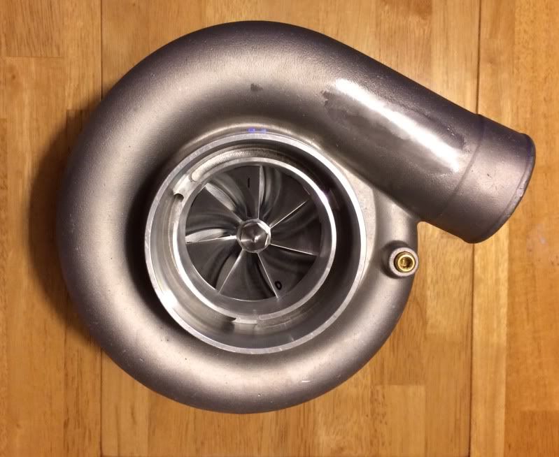

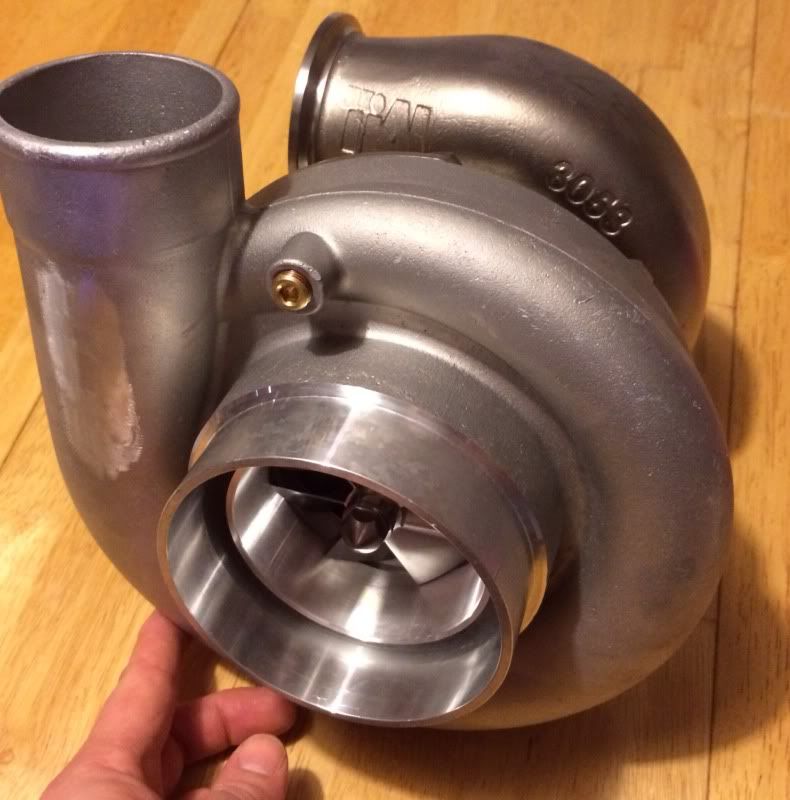

The new turbo came in the other day.
FP Super99 HTZ
Big Thanks to Michael@FP

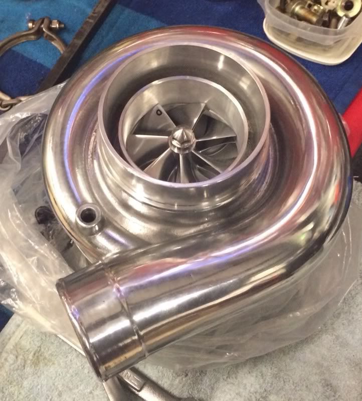

Now the compressor cover will be taken to be polished next week.
Compressor housing polished
