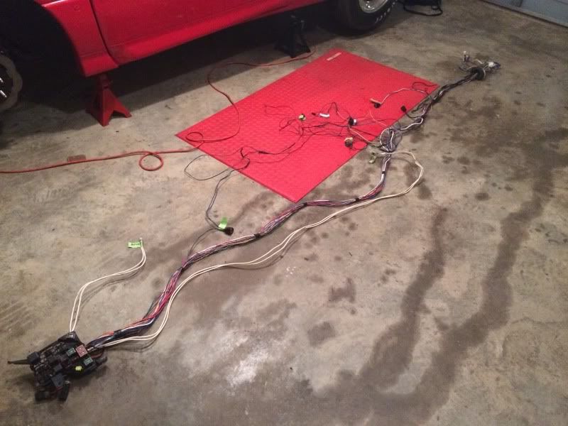

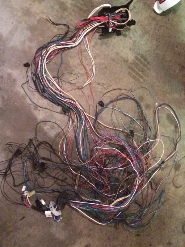

Tackled the chassis wiring harness.......
Here is what it looked like before

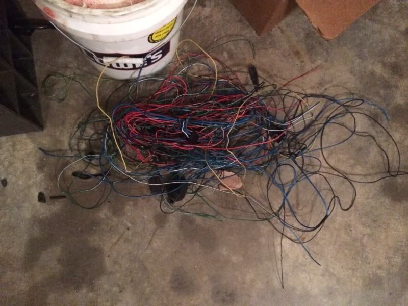

wires removed
end result, I may end up removing more before I finalize it and reloom and heat shrink it.

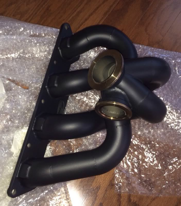

I got my manifold back from Boostin Performance. I sent it off to get coated, I asked for the silver finish but when I received it they had coated it black. Bummed out about the error I called and talked to Devin. He told me that the black has a higher heat resistance over the silver finish and that is what they do most exhaust parts with and that was probably why it got coated that instead of the silver like I had asked for.
I knew this already from years ago when I had sent off a set of 300ZX Twin Turbo manifolds to Jet Hot to get coated and that is the same thing they told me.
So instead of sending the manifold back to get blasted and recoated I'm just going to deal with it. Also Devin told me that if there is anything in the future I wanted to get coated that he would give me a discount on it. I still have to get the side exit downpipe made and I was planning on getting it coated as well so it worked out I guess.

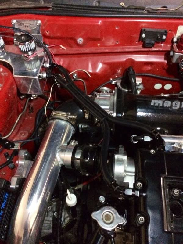

Also got some more AN fittings in to finish up my catch can setup and finish the coolant feed and return lines for the turbo.
Earls -6 AN pushlock with Vibrant performance silicone hose

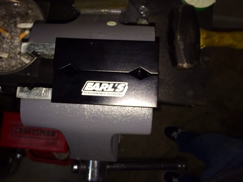

Also got this nifty tool, its a billet anodized vice insert to help assemble AN fittings so they don't get scratched up.

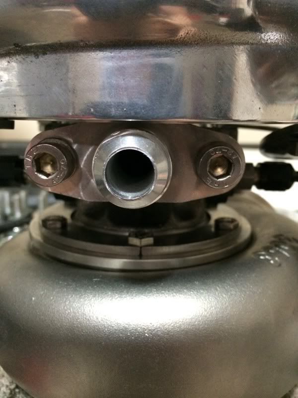

Last, the oil drain on the Super99 HTZ is a T4 oil drain versus a T3 like on the 3794HTA. So I had to purchase a new oil drain flange and gasket. The issue I ran into is that with the -10 AN flange on the center cartridge there is no room to attach the -10AN hose and fitting with the flange on the turbo like I was able to with the T3 flange on the 3794.
After looking it over and speaking to Chris Ginev I figured I'll try attaching the flange to the hose end fitting and attach it to the center cartridge like that. Hopefully it will clear the compressor housing. I've spent money on AN hose, fittings, flanges, gaskets, and bolts for this setup. I'd hate to have to scrap this and change the setup and buy more stuff to make it work.

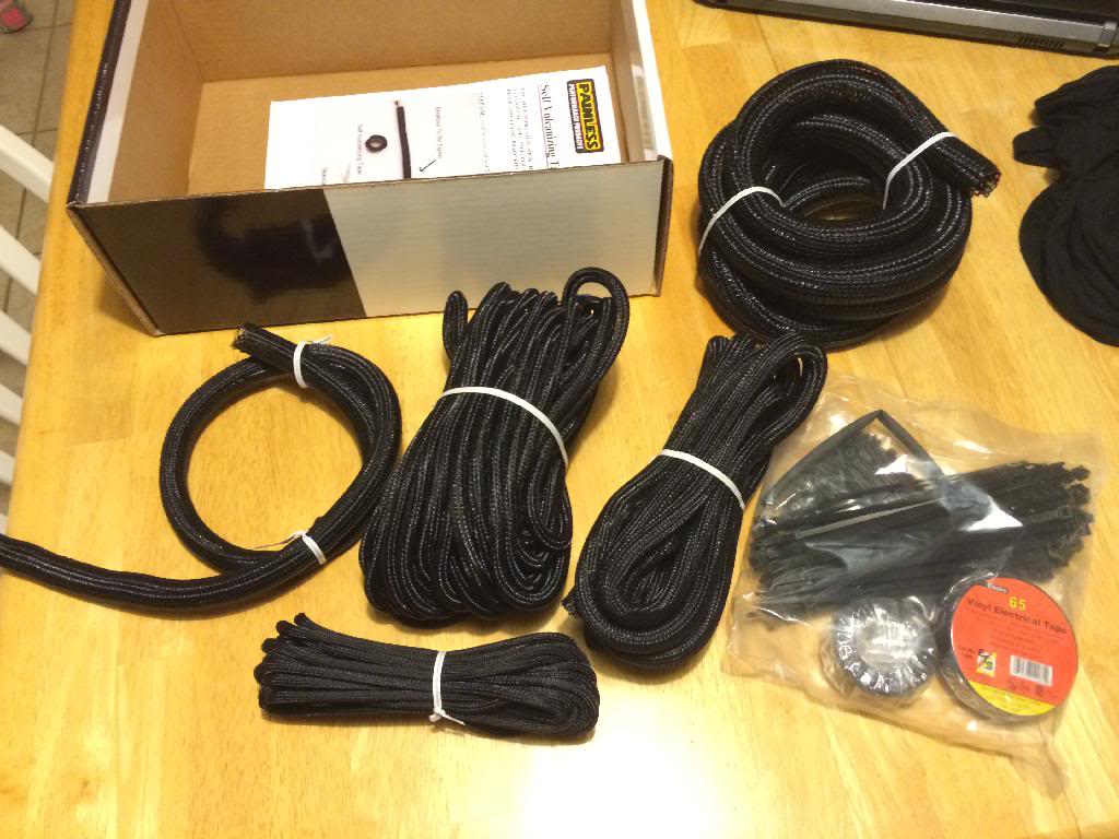

Finally got some lume in to finish the chassis and engine harness.
Its a Painless EFI kit

Also, I'm going to have to take off my oil drain line and cut some length out of it as well. With the new larger Super99 Turbo it hangs down lower than the 3794.

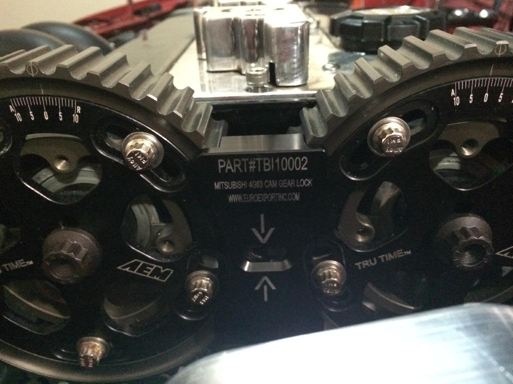

Euroexportinc cam tool, I already had the Jay Racing timing belt tool kit, but didn't like the nylon cam gear tool. This one is billet and has a hole on it where you can see that the timing marks are lined up correctly.

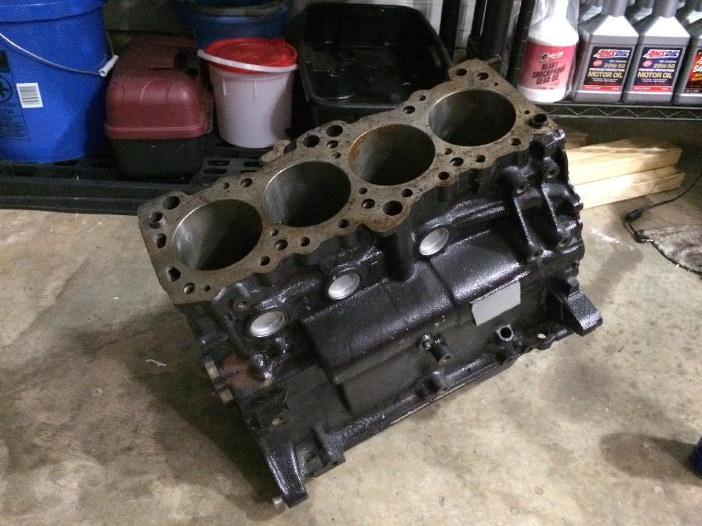

I also got a spare block to build. The plan is to send it to Boostin Performance and have them do a half fill high compression long rod motor.

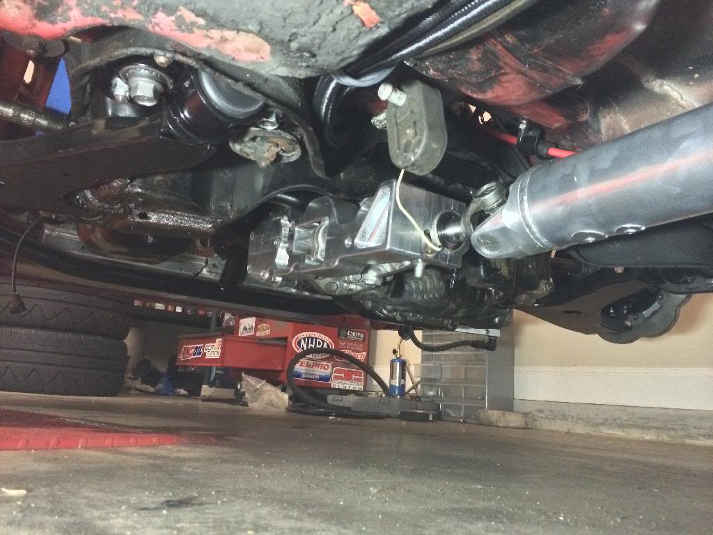

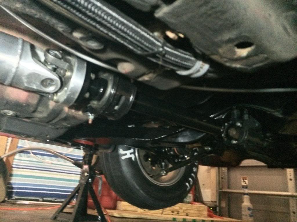

Driveshaft bolted up with all new hardware
Also, checkout the front, the yoke is sticking out a lot, is that normal with the dust cover off the transfer case?
What are these parts you speak of?
It's normal to stick out pretty far unfortunately. It'll twist the yoke in no time LOL, dss junk.
Aaron, has anyone spoke with DSS about this? Have them make the DS a little longer to take up the gap.
Because yeah, I agree with that much of the DS yoke sticking out no wonder it ends up getting twisted.
Like having your pecker half way in and having a girl go all full rodeo riding you. It's not going to end good.
Having lower ball joint sleeves machined, also a thicker rear driveshaft adapter to get rid of the gap. We spoke to them a while ago, didn't really get far.

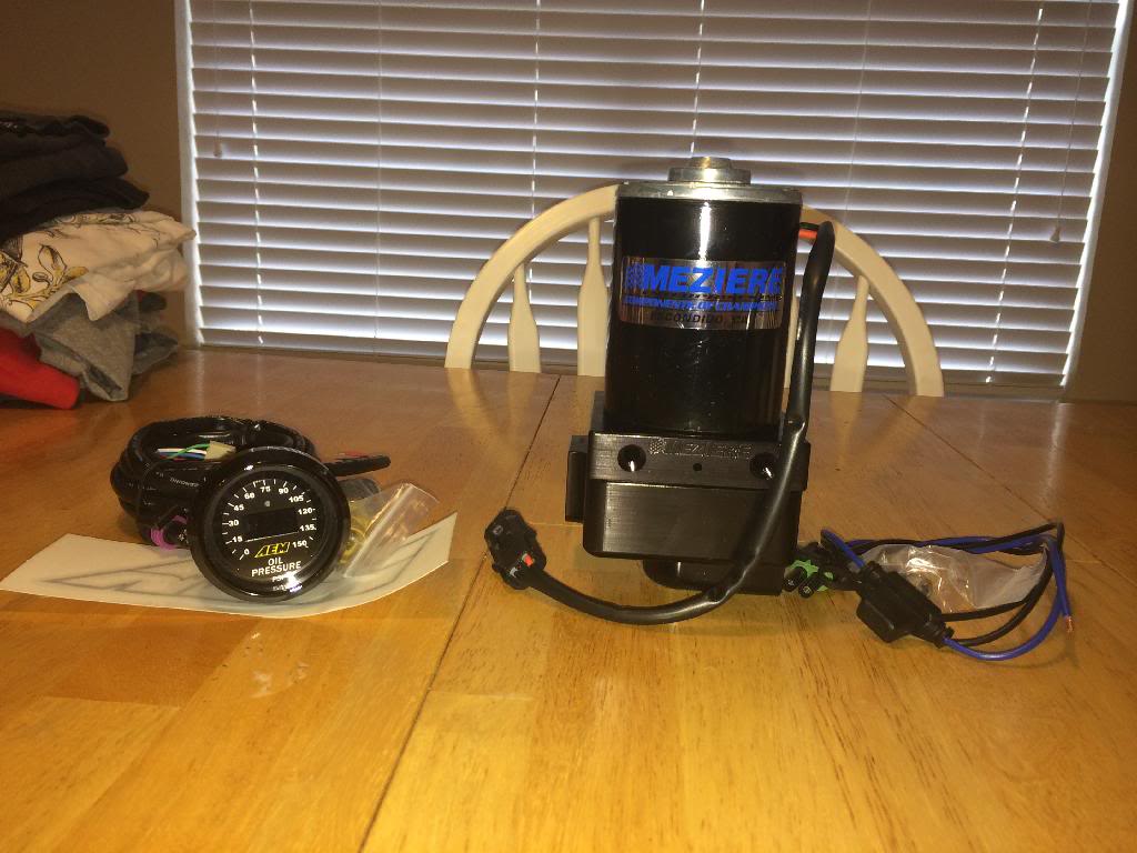

Oil pressure gauge and electric water pump came in today. Now waiting on the parts from Frontline Fab, STM, and Radiator to come in so I can start mocking up this new setup.
