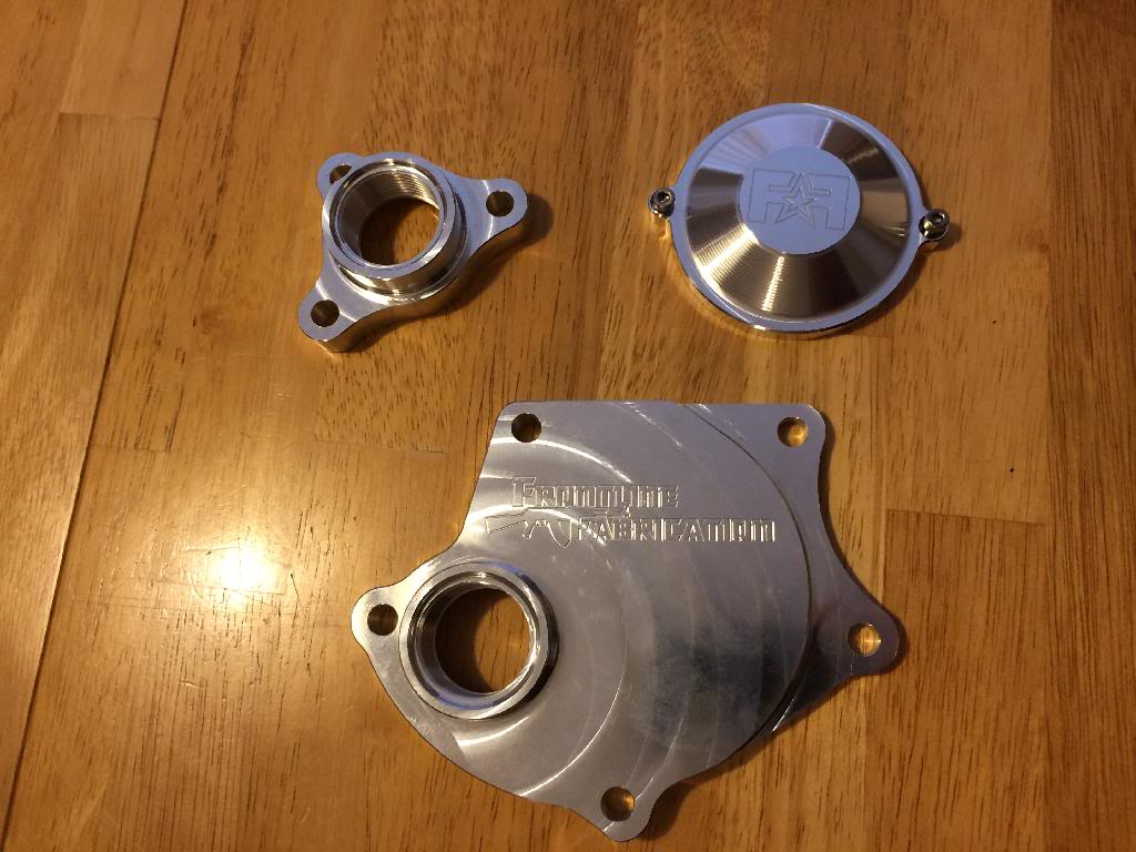

Some parts came in for the new radiator setup.

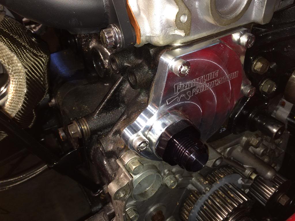

Frontline Fab thermostat housing plate, water pump plate, and CAS cover

The CAS cover from frontline fabrication hasn't been updated to their site yet. I think most people have been ordering them directly from him off of FaceBook. That's how I got mine atleast :)

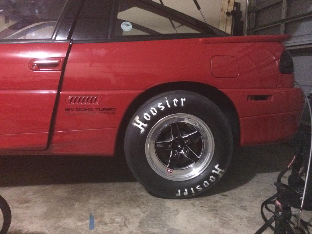

Amazing build so far man. You got any pictures with those new wheels on the car? They look gorgeous, will definitely need the specs from you. If you dont mind me asking what they run you a piece?
As far as specs go, it depends on if you're running coilovers or not.
