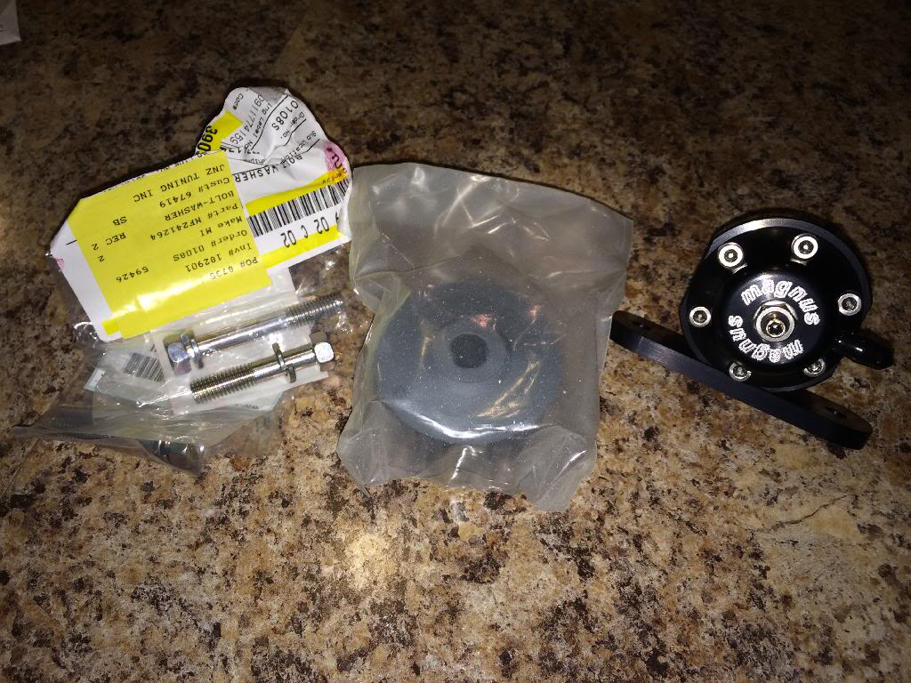

Some parts from JNZ....
New bolts for oil filter housing, new oil pump sproket, new bolt for oil dipstick tube

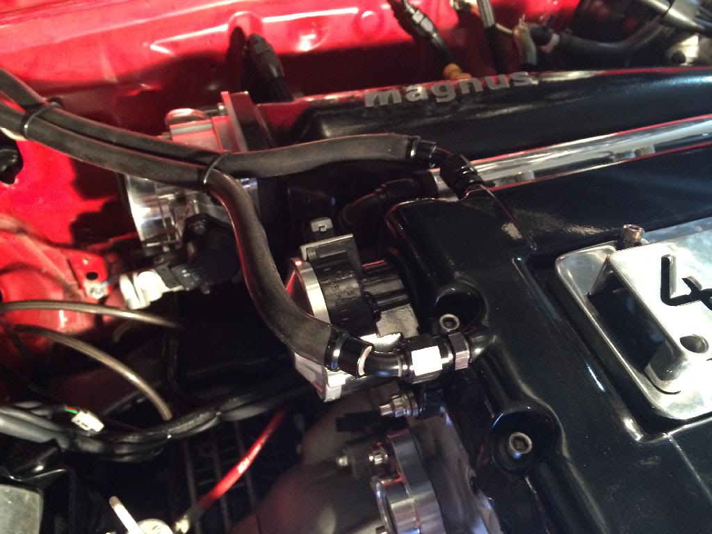

Magnus adjustable FPR
For those curious its a bit smaller that a Aeromotive A1000. I'll take a comparision shot of the two when I get the chance.

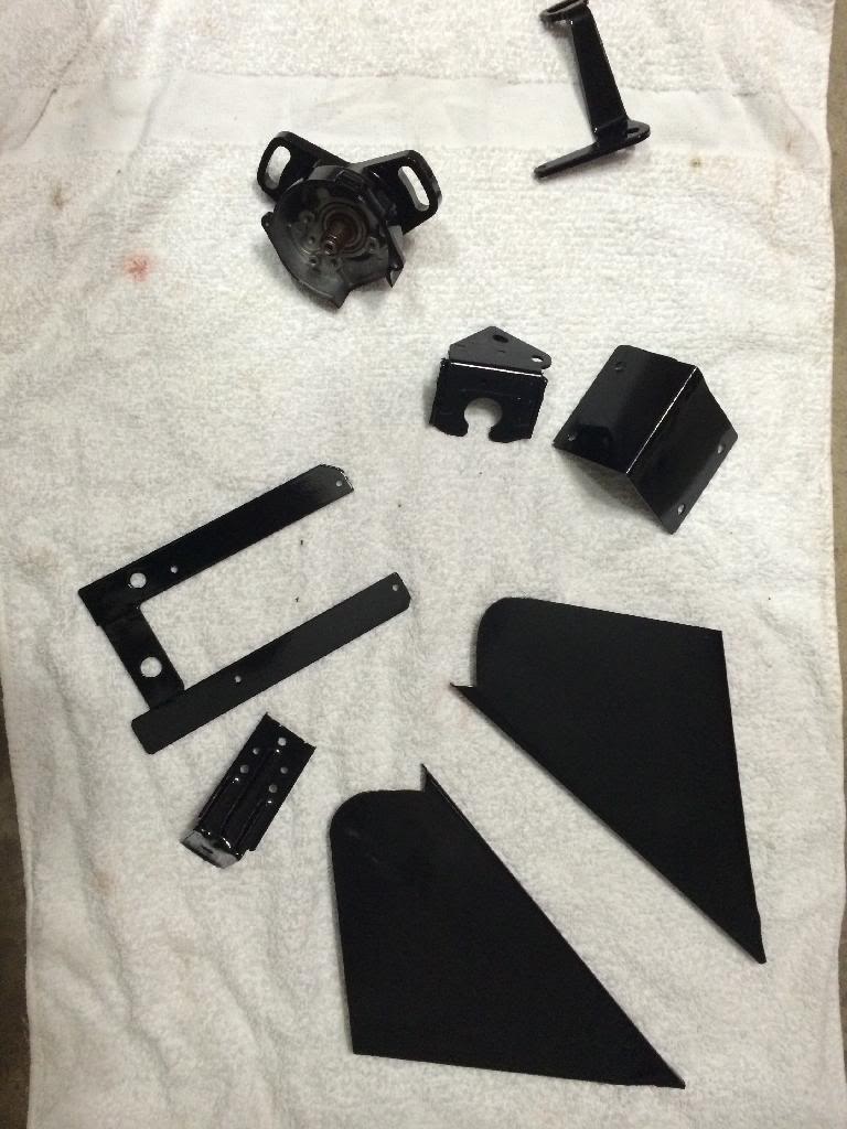

Took some parts to get powder coated.

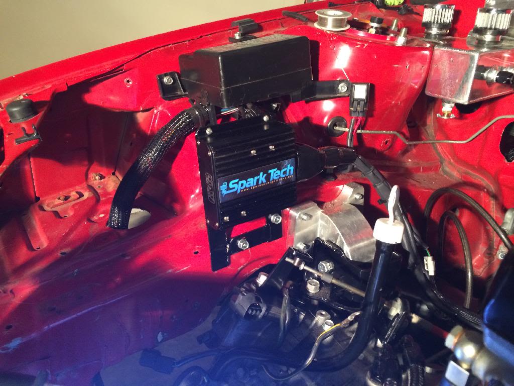

Buschur Racing mirror delete plates, CAS case, Transmission brackets for the cable, Headlight bracket, brackets custom made for the electric water pump and the Sparktech (M&W) Ignition box.

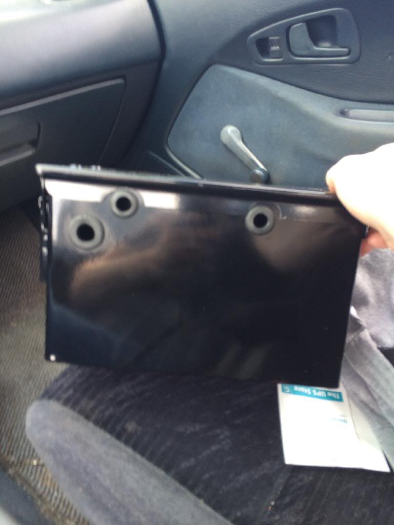

Buschur Racing Mirror delete plates installed
These things are a complete pain in the ass and I'm still not 100% satisfied with them. They came just cut out to a generic shape then its up to you to bend the 2 sides 90 degrees and then trim off what was needed to be trimmed. For the price of $140 (I got them for $70 due to an error in pricing on the website) I would think they would have came ready to install. Oh well, I'll do the job of taking up the empty hole left after removing the mirrors.
Ignition box and bracket installed
CAS installed along with the Frontline Fab CAS cover
Transmission brackets installed along with all new OEM hardware

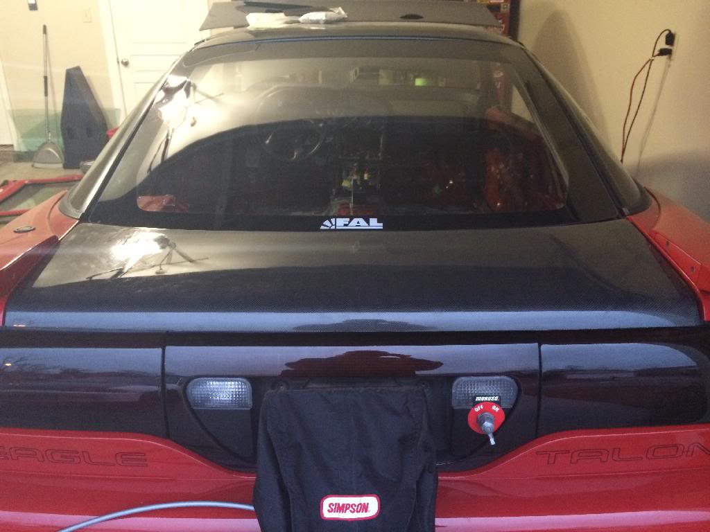

Carbonetics carbon fiber hatch came in today.
Went on real easy and fit just like the stock hatch. I didn't have to do any modifications to it or even adjust anything after bolting up all the hardware off the factory hatch.
Here it is with the FAL window installed on the car.
My personal opinion is 1G's look fugly without a wing but I can't get myself to drill holes into this thing to mount a wing. I have a 90 GSX wing sitting with all new OEM hardware but I think I'm going to wait and see if the wing is needed for down force at the track later.

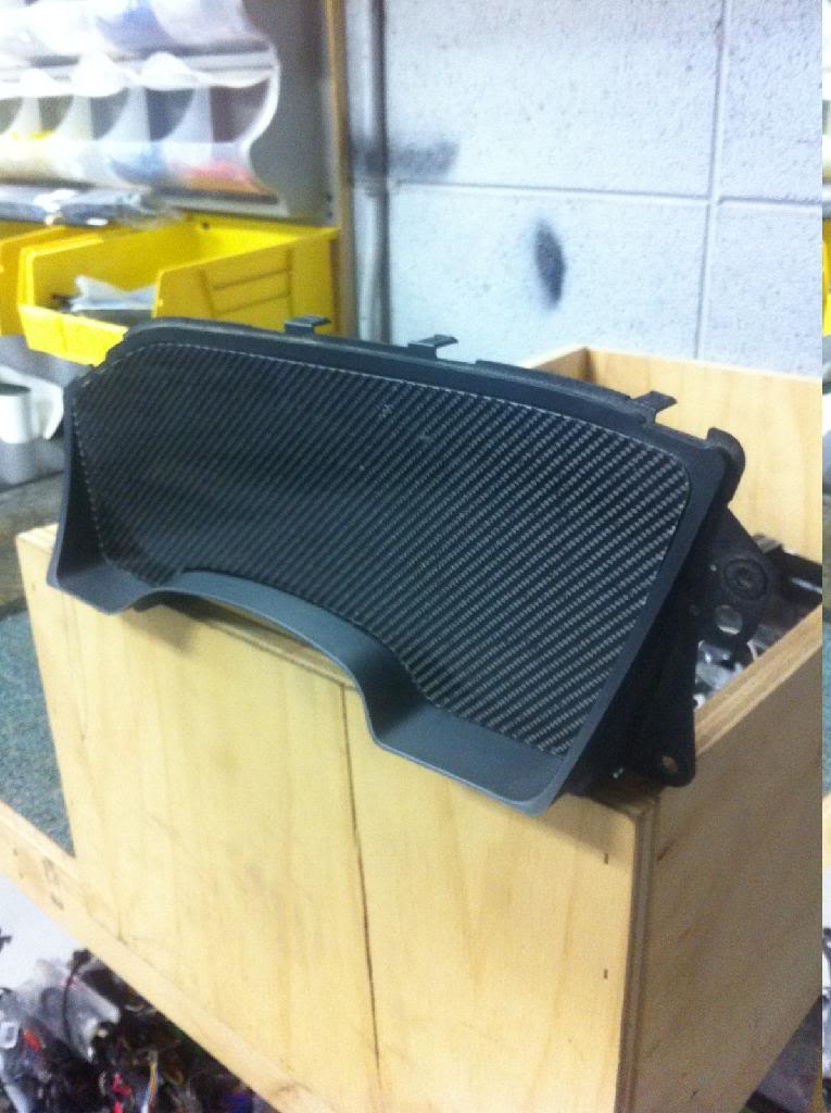

Got a sheet of carbon fiber in today for the custom gauge cluster as well as the center console piece. My buddy originally did it in ABS plastic which looked good, but I wanted to liven up the interior a little since the car will be pretty much gutted out and have a few things look decent and catch attention.
12x24 and 3/8th thick so it won't flex. This should be enough for everything.
Here is the center console piece done with the ABS plastic. The double din will also be done in CF and I'll mount all my switches there.

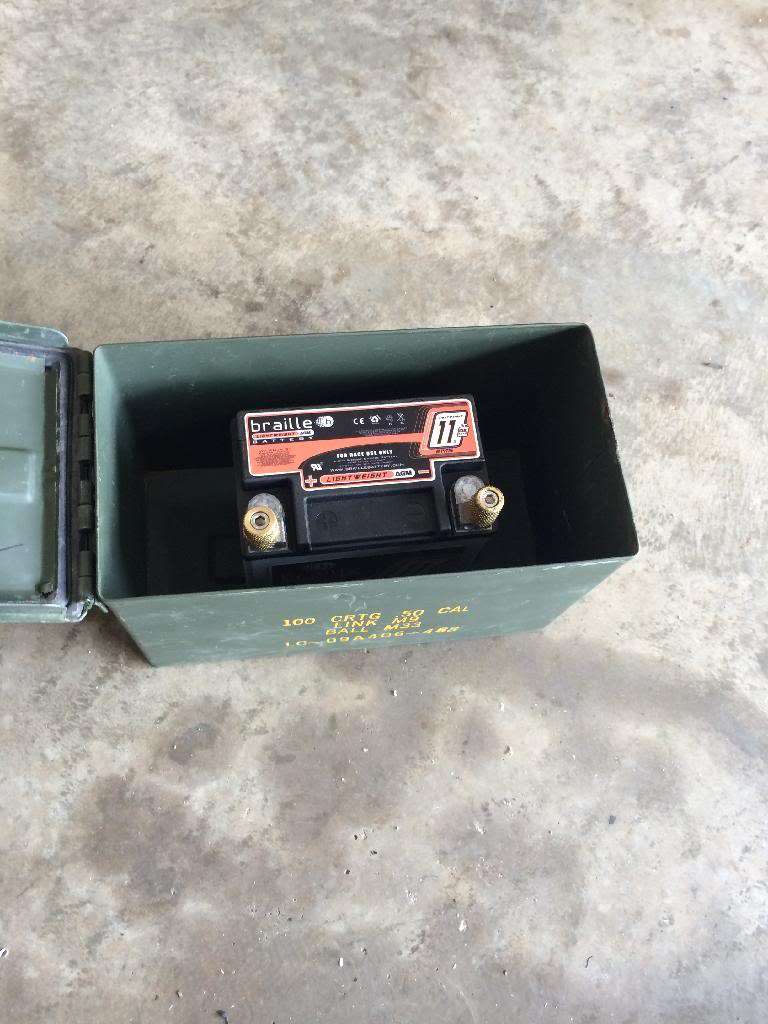

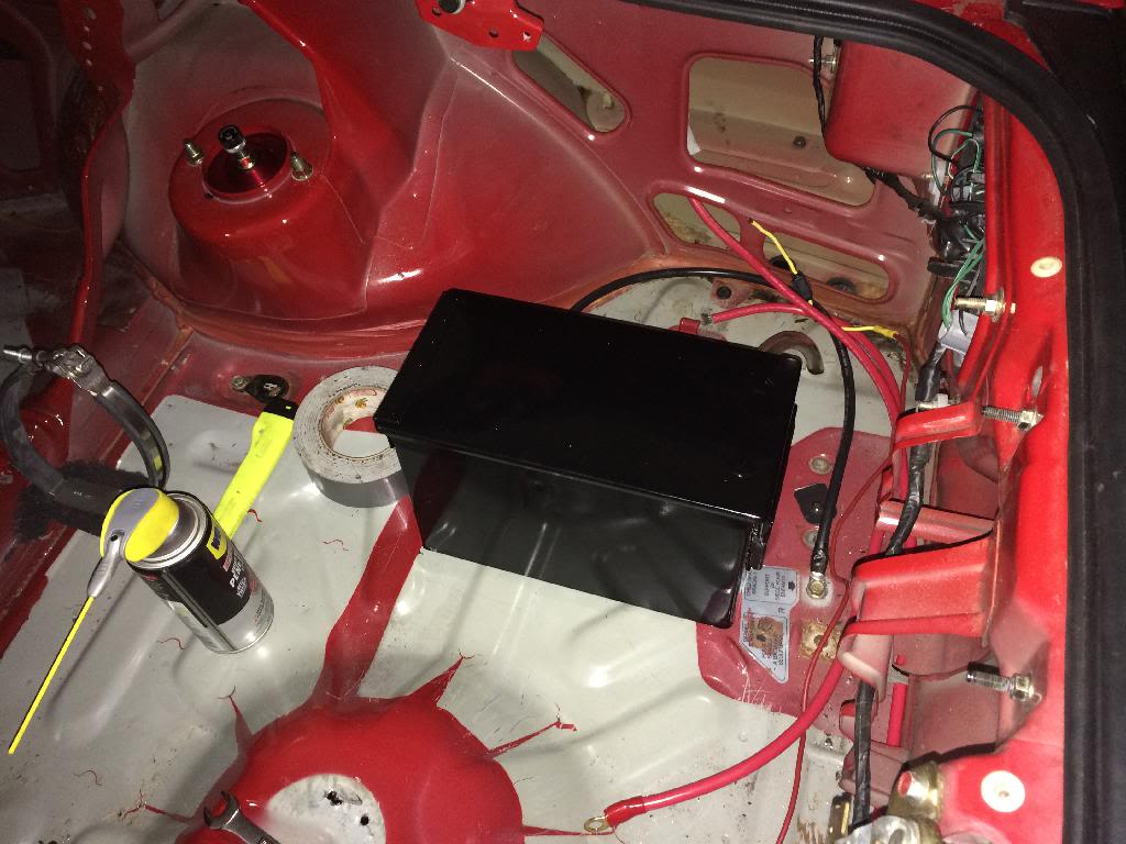

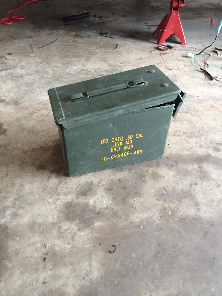

Also since I have the Braile battery the Moroso battery box is just way to damn big and overkill. Well I was thinking and it has to be sealed and vented (NHRA Rules) and I couldn't find a halfsize battery box online so then the Military man in me thought, Just use a 50cal ammo can! Its sealed!
So BAM!
Of course I'm going to clean it up and either paint or powdercoat it. I also went by Lowes and got some all thread and a piece of aluminum flat bar to make my tie down. This thing will take up less than half of the space as the huge Moroso box.

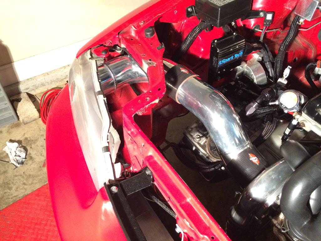

Also fully done with the ram air intake.

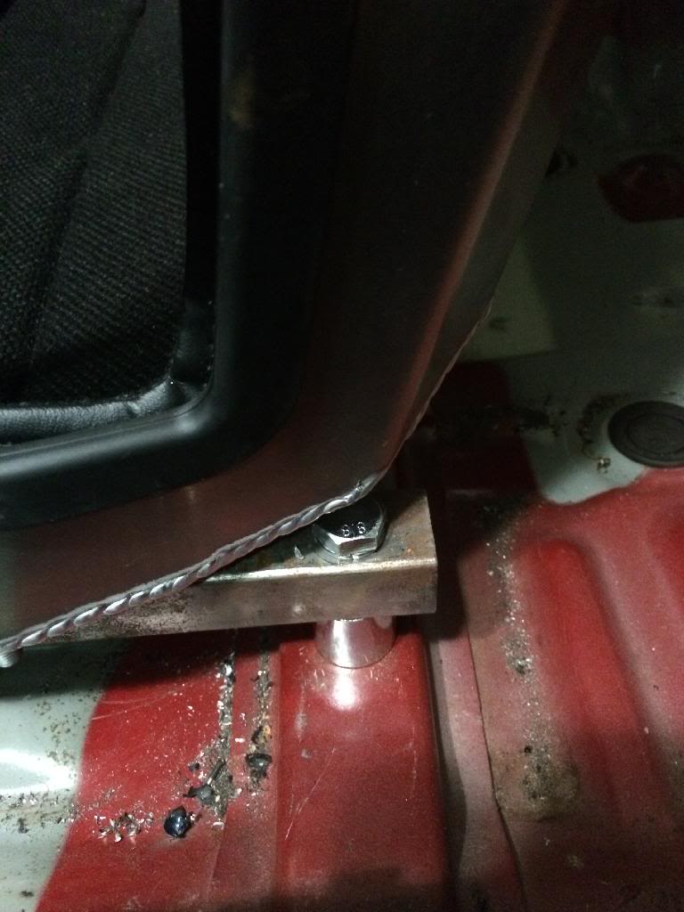

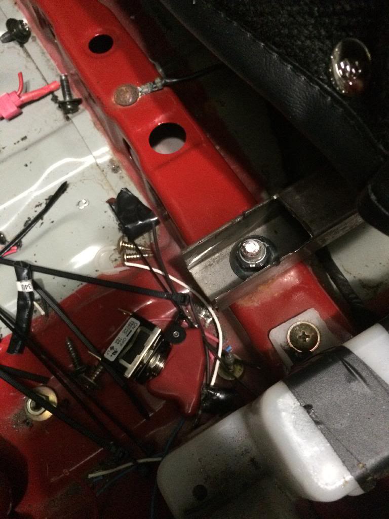

I just got some steel square tube and mounted it where the factory rails went. The Kirkey seat doesn't sit center on it because if it did it would be off center of the steering wheel so the seat has to go over towards the driveshaft tunnel hump as much as possible. I got everything to make it from Lowes. I plan on taking it apart and getting it powder coated along with a couple other things I've made like the ammo can battery box and tie down bracket.
I thought about running crossways support bars for the seat rails but I don't think its needed now that I have it mounted.
I'll take some pictures on my next off day when I take it apart to take to powder coat.
If we can come up with a good mount, I can have a friend make it out of AL or something that we want.
Here is my simple seat rail mounts. I simply used square steel tubing from lowes and for the front I just used OEM nuts that are used to hold the carrier bearings as well as the fuel cell on the car.
For the rear I just used some long bolts, lock washer, and a spacer.
Got my 50cal ammo can battery box back from powder coat and got it installed.

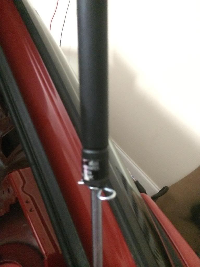

Also I was hoping that my blown factory hatch struts would be able to hold up my carbon fiber hatch and FAL window but unfortunately they weren't, When I installed the hatch it held it up fine but once I put the FAL window on it was the straw that broke the camels back and it wouldn't hold it up. So instead of continuing to use a pair of vice grips to hold it open since I can't install new struts onto it because it would snap the CF hatch. I decided to just drill a hold into the struts and use a cotter pin to hold it open. Works perfectly! I plan on attaching a lanyard onto the pin so when I remove them they'll just dangle and he close at hand to put them back in whenever I have to go into the hatch area.

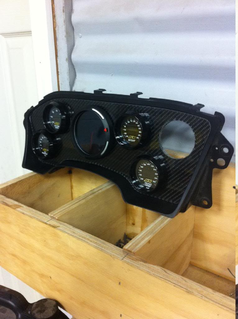

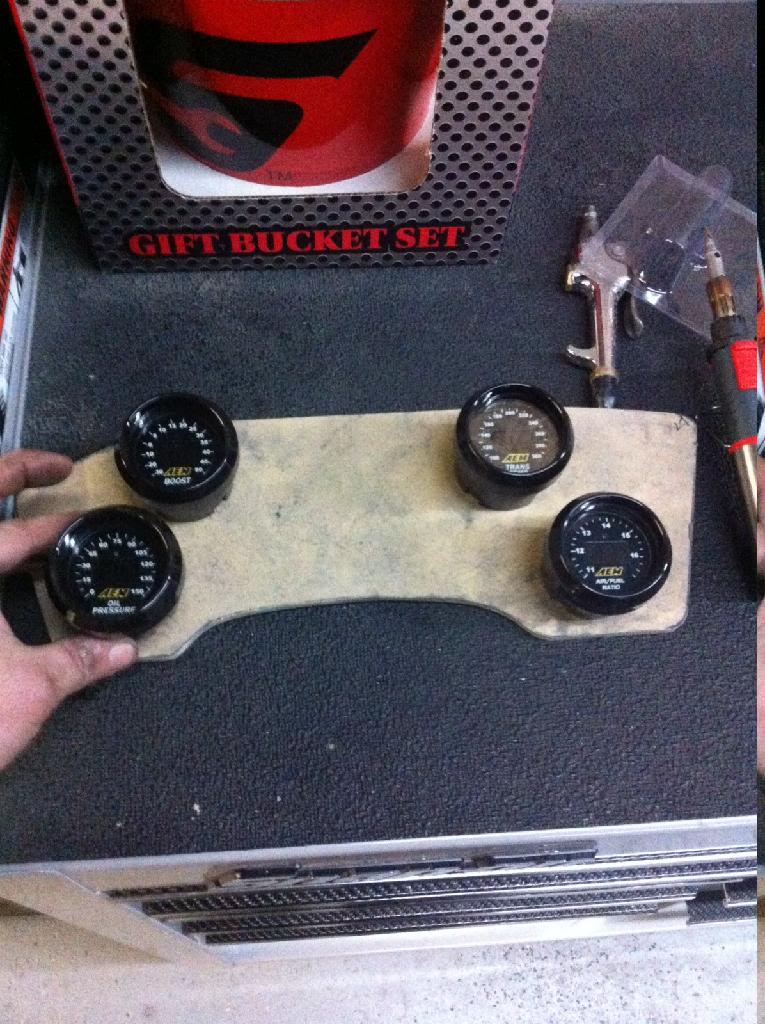

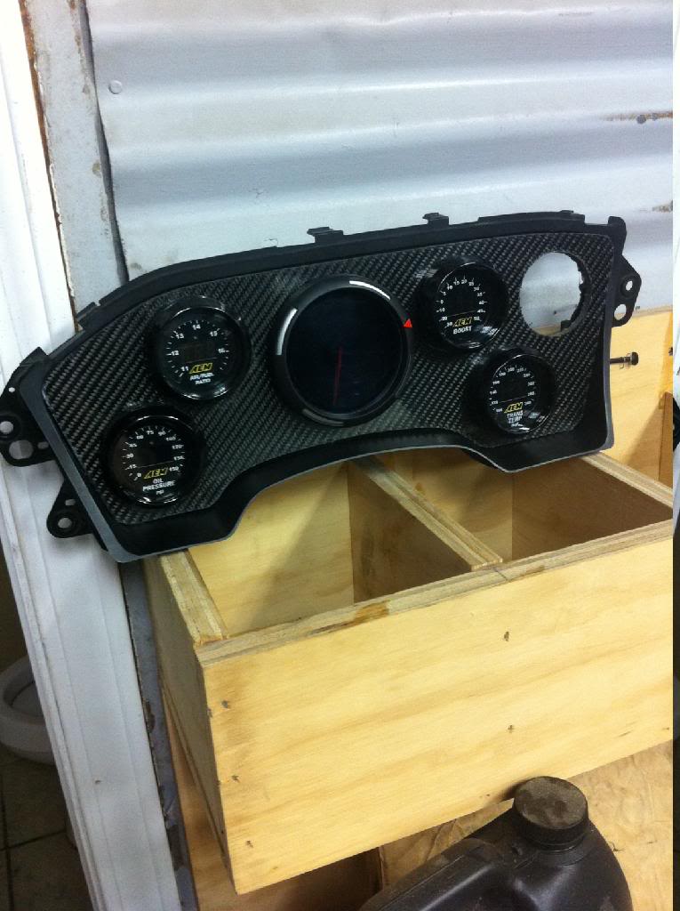

Also my buddy Ace who has done all of my wiring has been working on my gauge cluster and it should be done soon. I'll have 2 gauges on the left side, 3 on the right and the Defi tach in the middle with a carbon fiber back.
He's also working on the center console piece and it should be done soon as well. Carbon Fiber will replace all of the ABS plastic where he originally did the console piece to cover up where the climate controls and other buttons were. Then where the radio and din pocket were he's going to put one large piece where all of my switches will be mounted and labeled. One for the radiator fan, one for the electric water pump, one to arm the nitrous, and one for the purge. I'll post some pics once it's all done.

Gauge cluster is finished. Just waiting on the AEM water temp gauge to show up.
