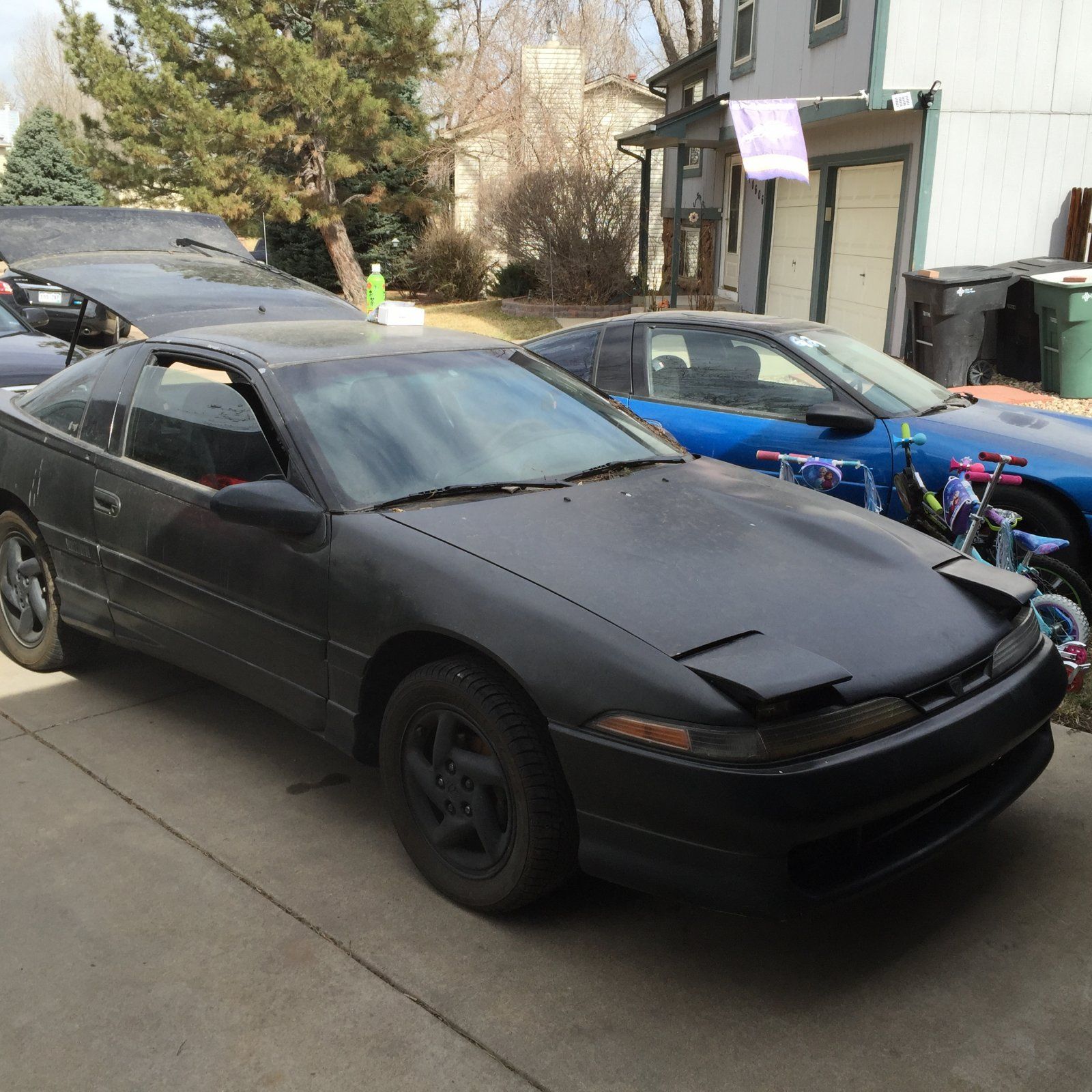

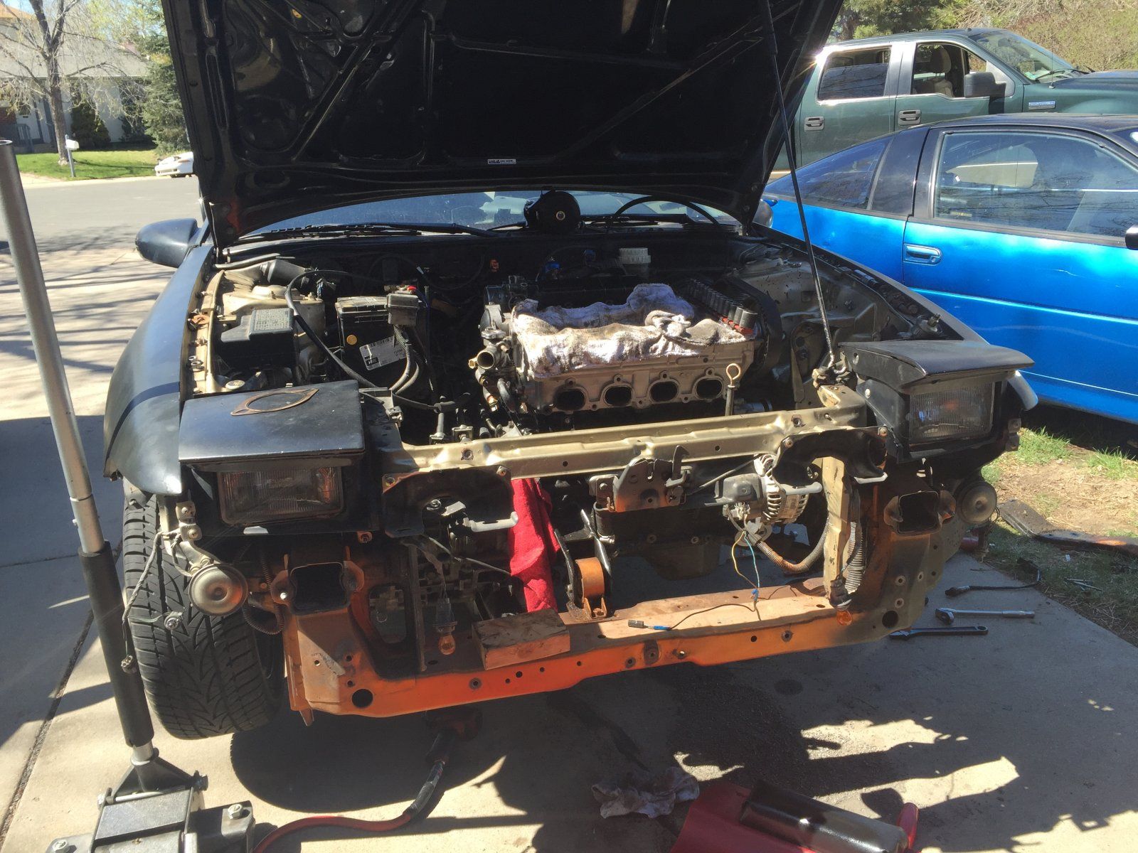

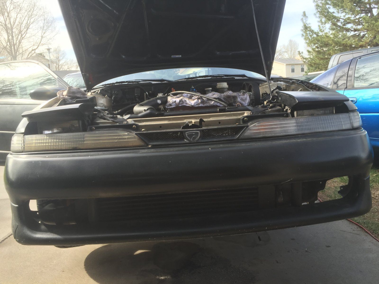

Hello all,
I recently purchased a 91 Talon. The good, it came with a Strictly Performance head. The bad, everything else.
Didn't run at the time, eBay parts galore on it (turbo, intercooler, exhaust manifold, 02 housing), random transmission with a cracked bell housing, timing was off, electrical issues, leaking oil everywhere.
It has turned into even more of a project than I had anticipated. This was supposed to be my "cheap" speed 1/4 mile race car. However, I am excited for the initial completion to get it up and running hopefully hitting 11s at the track this year. My ultimate goal is s 10 second car for 10k, just not sure if that will actually happen...

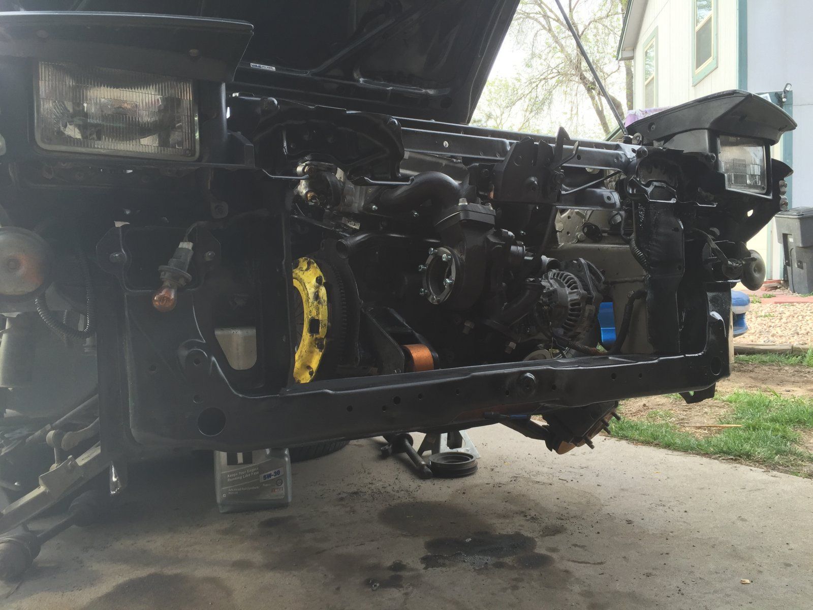

I'm off to a good start with massive help from the local DSM crowd. Current plan is to fix the little things and get it up and running. It's been a slow process, but that just makes it better at the end, right?

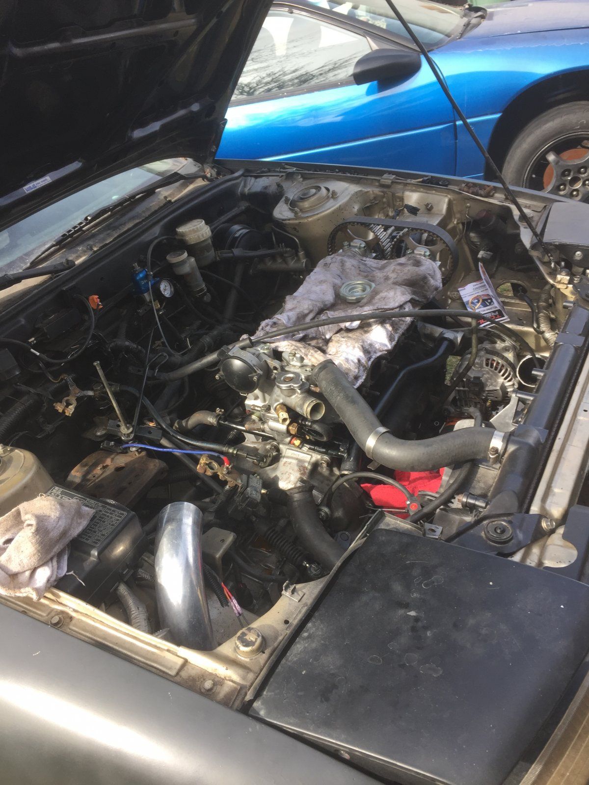

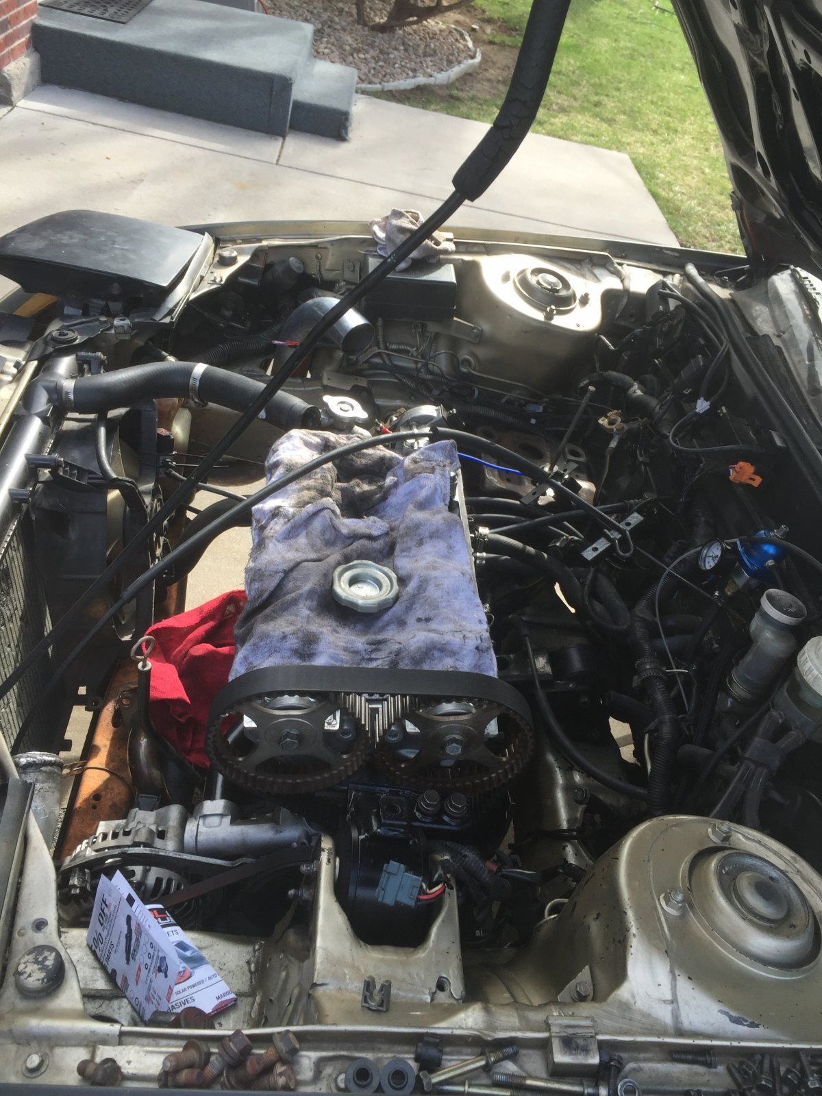

The current configuration of ugly and the future turbo.
Yeah, that's a common problem with DSMs. You get a lot of young guys that screw these cars up then need to unload them onto someone else so they lie about what the car has and what's wrong with it. I had the exact same mindset as you when I got back into DSMs last November. Turns out the crank and bearings were screwed and the guy put on a completely wrong head gasket that would have caused catastrophic engine failure. Oh well, just take your time with it and enjoy the ride.
Same boat here. Got a good body car with some quirks and a funky electrical system to sort out. Good thing I have nothing but time for it.
I'm glad I'm not the only one that had dreams of instant reliable speed. Rather unfortunate it happens to multiple people. However, I am encouraged by the amount of well built cars in this forum that are running very well.

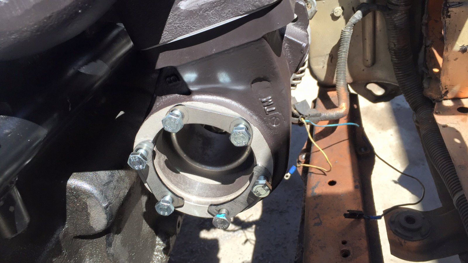

A pic of the orange frame.

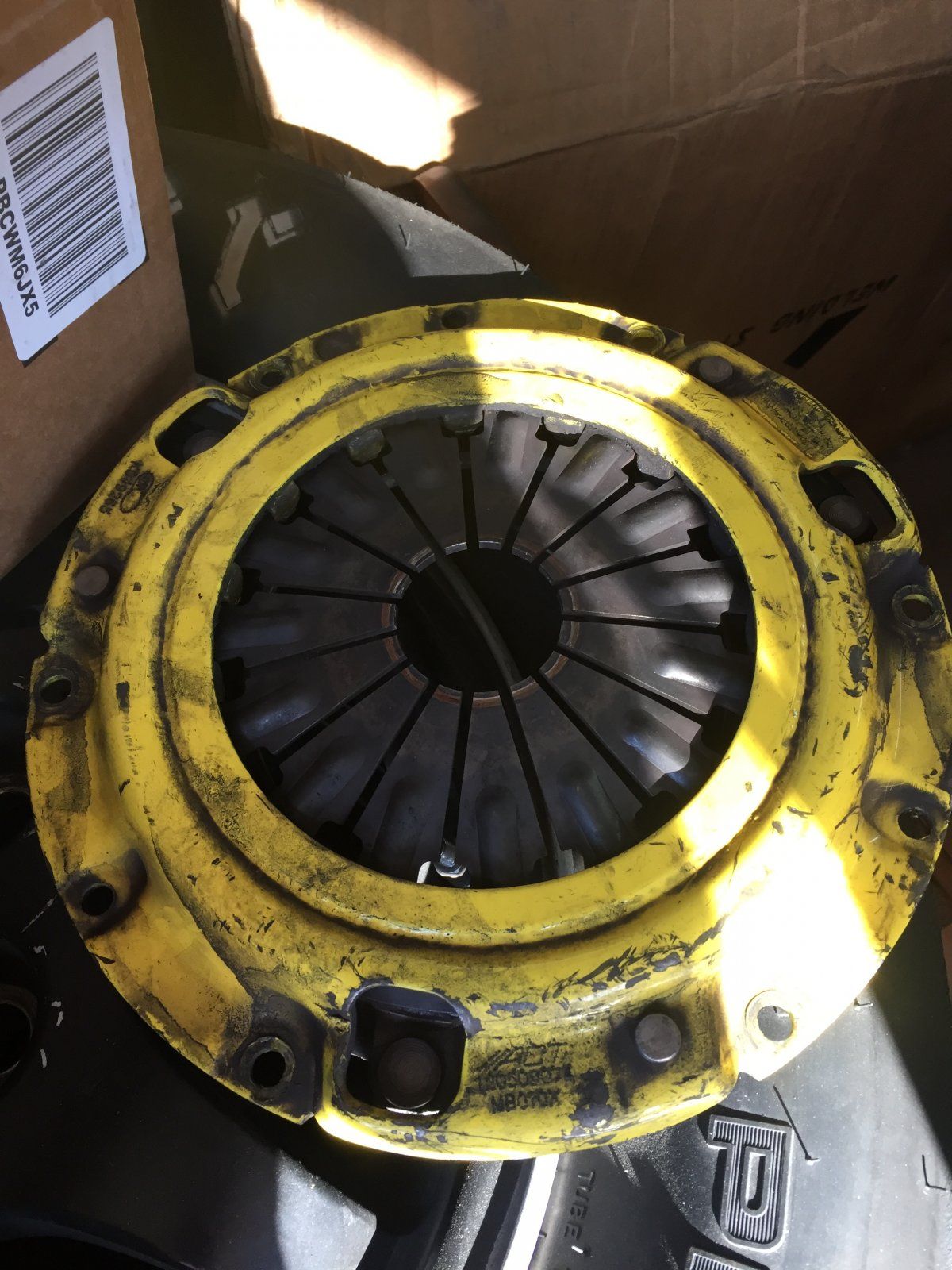

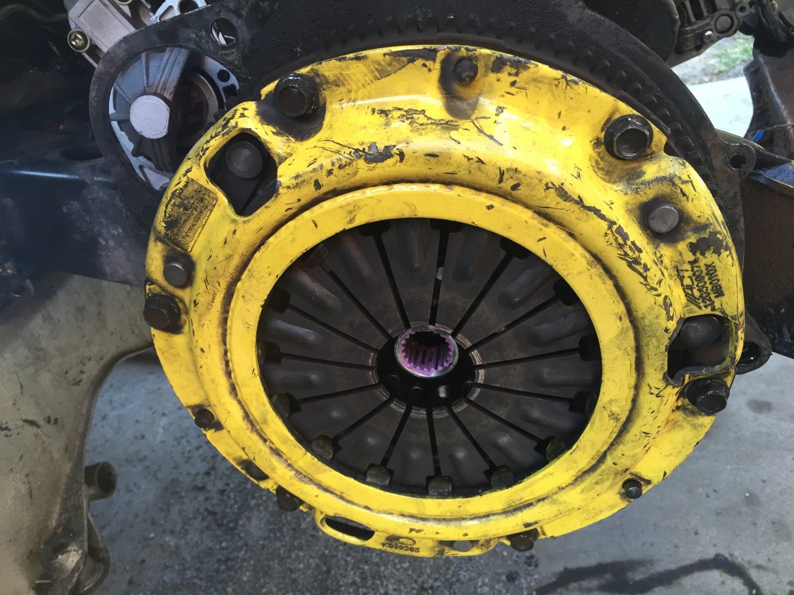

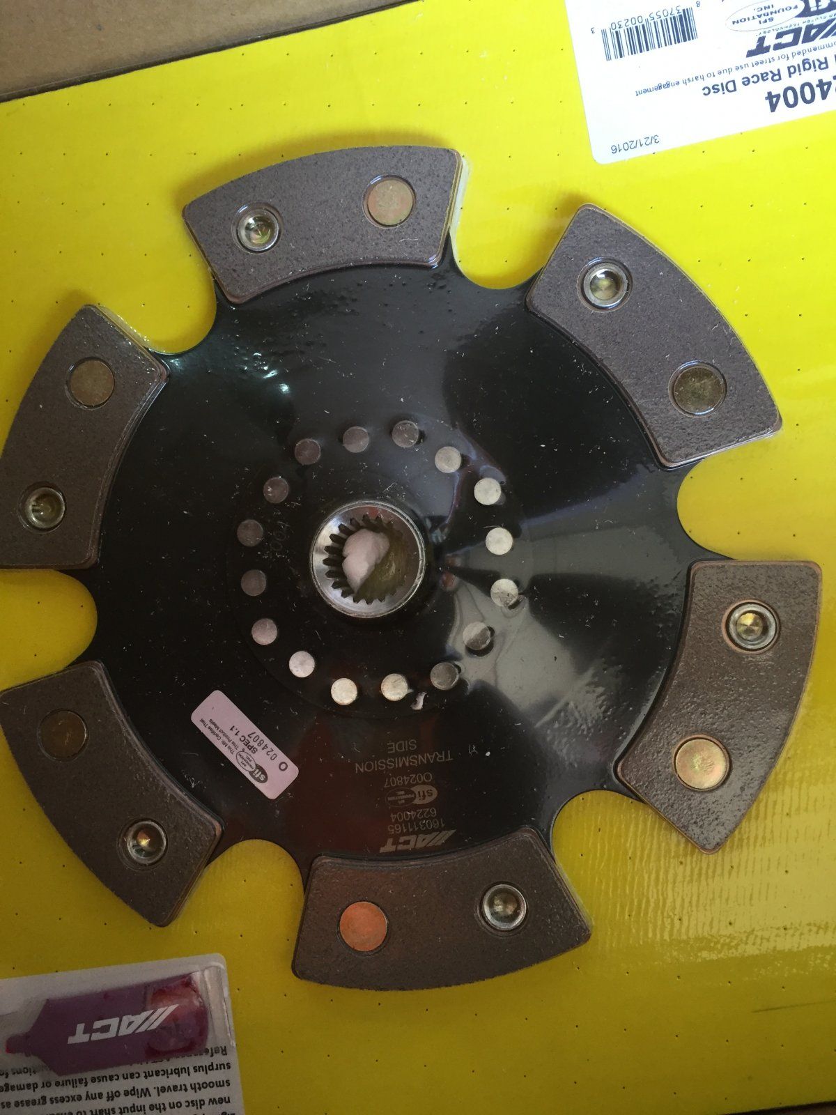

ACT 2600 clutch (pressure plate for free! Mad props to local guys). It actually did have a new clutch in it from AP Racing in it, but it was only rated to 320lb/ft.
Is the car fwd or awd? Fill out your profile so we can see ;). If it's awd that solid Hub disk isn't a good idea. I run one with my fwd drag car and love it ;). Keep at it bro it will all come back together for ya! You really should be using new oem bolts for the pp and flywheel. Did you resurface the flywheel or pp? How did they look?

I did actually. Was recommended by one of the guys out here, so I put in a OEM throw out bearing in. Appreciate the heads up though.
AWD, why is the solid 6 puck a bad idea? To much drivetrain shock?
Didn't resurface anything. Admittedly, I was dubious about it, but the pp had less than 5k on it and the flywheel was resurfaced with the new clutch which showed hardly any wear. Hoping I'll luck out with it. Hmmm didn't use new bolts either... Next time.

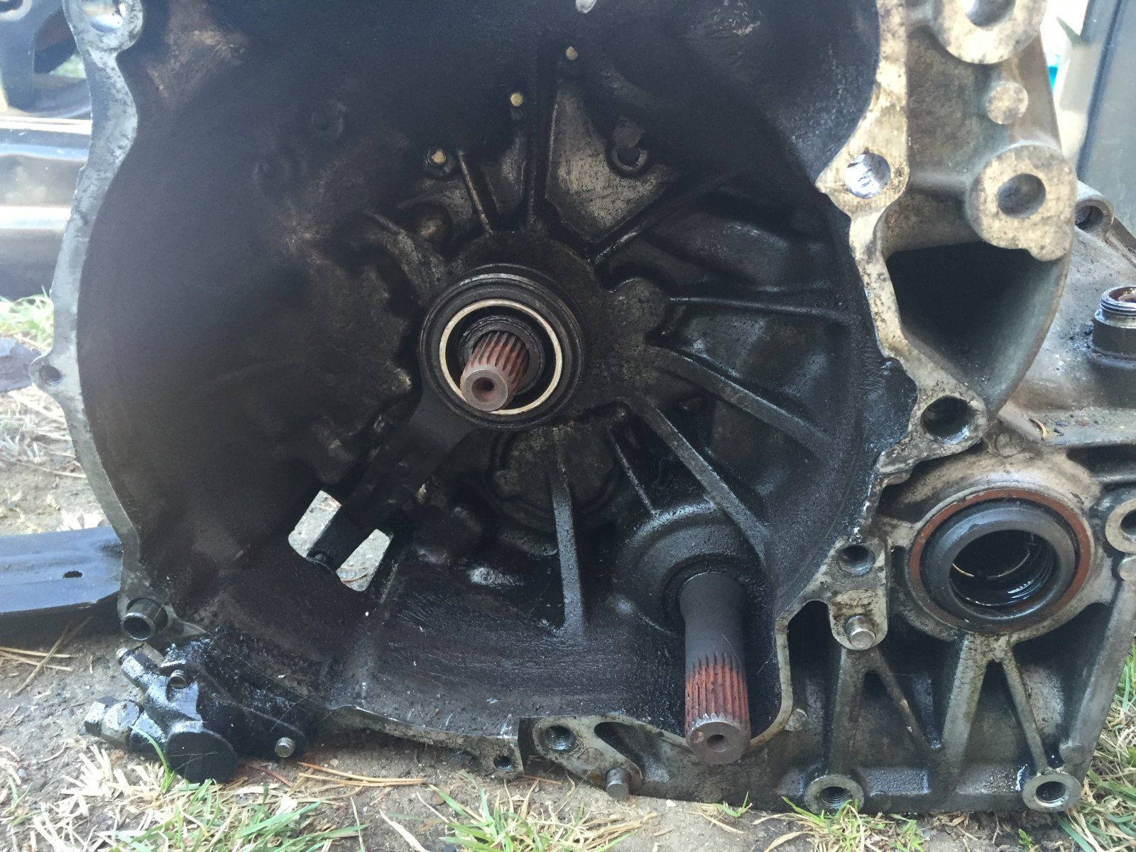

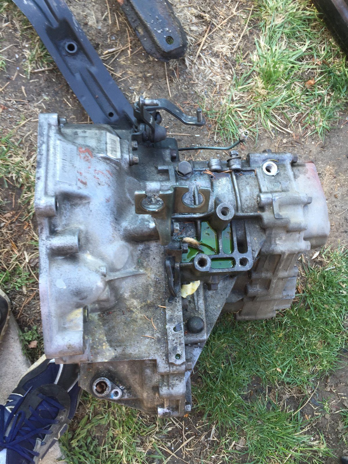

Mystery transmission is out. I purchased a used 91 transmission from a local guy for $150, only issue is, not sure if it works. Hoping to have it in in the next week or two with a running car to test. Fingers crossed!
Take it to a local trans shop and explain your story. They'll most likely throw it on the dyno for $40 or maybe even for free. Then you'll know and not have to drop your trans again. If it needs rebuilding and you have them do it they probably wont even charge you for the diagnosis.

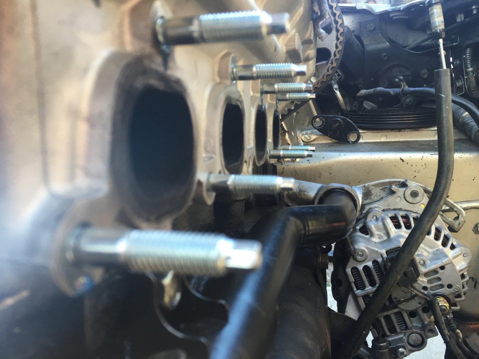

Also for allll your exhaust stuff. Use NICKEL Anti-seize. Its like $7 for the permatex stuff. BUY IT. Saved my butt sooo many times the stuff is magic.
