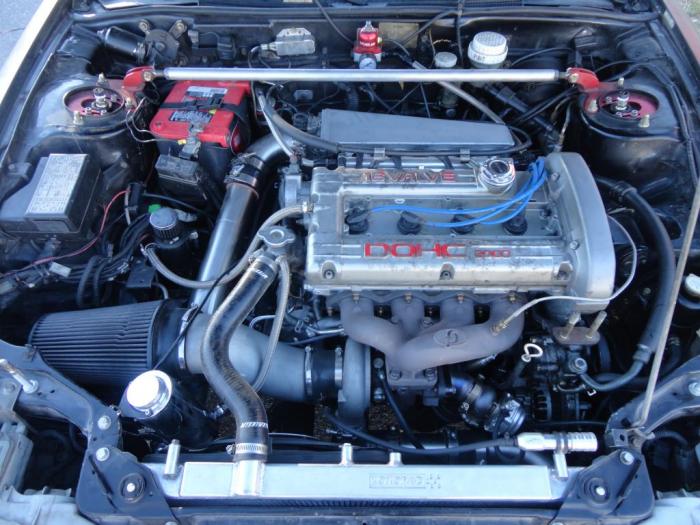

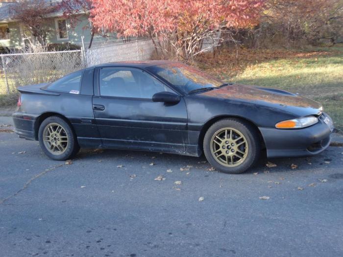

Ive been planning on building a 400hp car for some time, i had a stock 90 gsx i did a little to as i bought parts for a new motor, well plans changed a little and i bought a 1993 gsx for 4400, i figured i would get up to the 4 bolt rear. and grab some good parts as well.
one question the catch can doesnt have a vacuum line
So the guy i bought the car from said it made 419hp and 346tq on 25psi, my original plan was 400, so the new plan is a reliable 500 and swap to auto. The parts it has at the moment
stock imported block about 40k
rebuilt jacks trans 5 spd 40k for sale!!!!!
fp green
fp exhaust mani
tial waist gate
hks bov
fp intake
koyo radiator
stage 4 competition clutch
ets race fmic
fic 850s
magnus fuel rail
hks 272s
walbro 255 re-wired to alternator, not sure why?
fuel lab afpr
halman mbc
carbon fiber hood
ecmlink lte, need some help getting it to log my mtx-l
megan cat back
megan coil over
I have a good start for my new engine

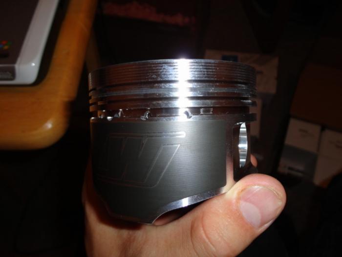

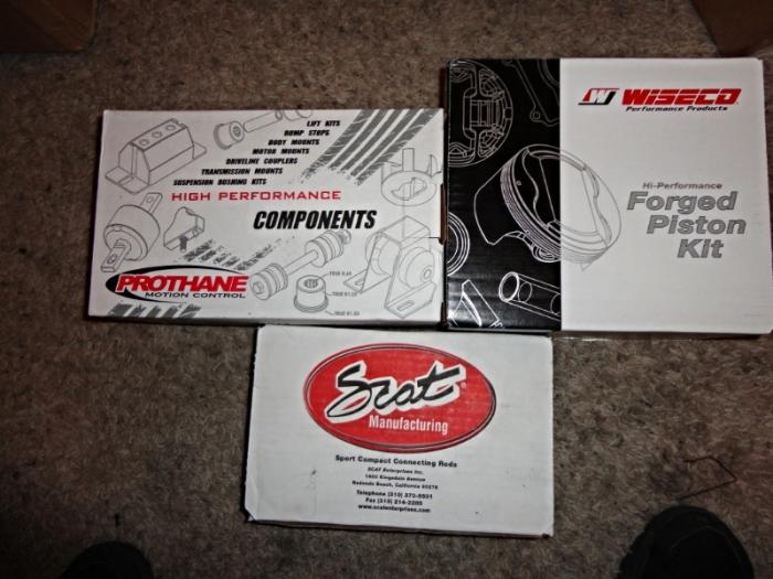

I have wiesco 8.3:1 .020
scat rods
blocks ready to get built.
no head though the one i had was decked to far already.
so thats where im at now i plan to do all the normal up keep stuff fix the small oil leak.
likei said my fastest dsm before thing maybe had 250hp so i have alot to learn.
Really looking forward to feedback and some help.
ill finish up my plan and get it posted here in a day.
in the end i want 10s with the auto and make the 2014 shootout.

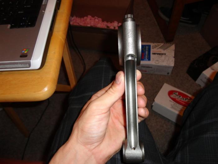

I took the scat rods over the eagle because scat has the oil holes in the pin

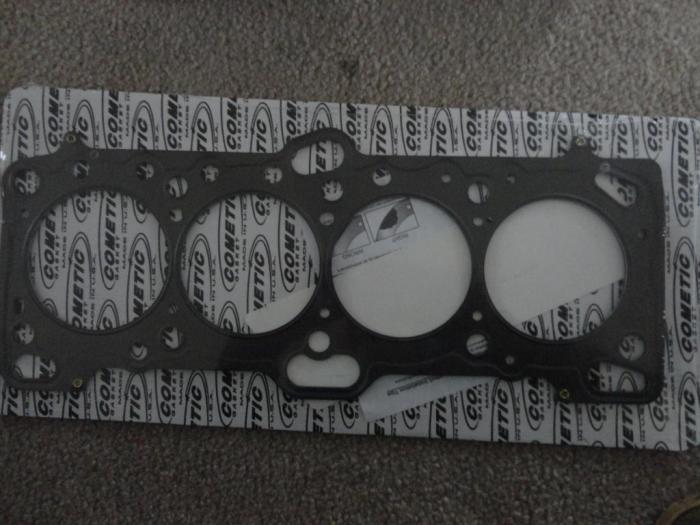

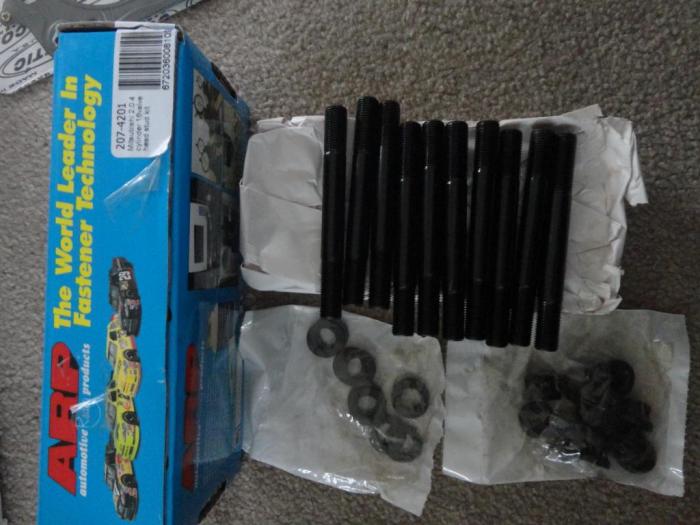

small update haha, so about three years ago i bought a junk 90 tsi and was planning a 300hp car, LOL , plans changed i now have about 400hp on the stock block. So the other motor parts i have are not ment for 600hp.
going with a different head gasket and the MAP h11 head studs.
just moved so willl start updating the engine build soon.
Nice start I don't have a hp goal yet because once I buy parts I want to make sure its well planned from the get go. Ill paint last too.
So you took a picture of the head studs and gasket you aren't using? Got it. I was hoping you didn't buy those from someone in the classifieds as MAP H11's... LOL
:dsm:
like it said, small update haha, i just figured id show that im chnaging these parts because they are not enough for the hoursepower and boost i want in the end.
