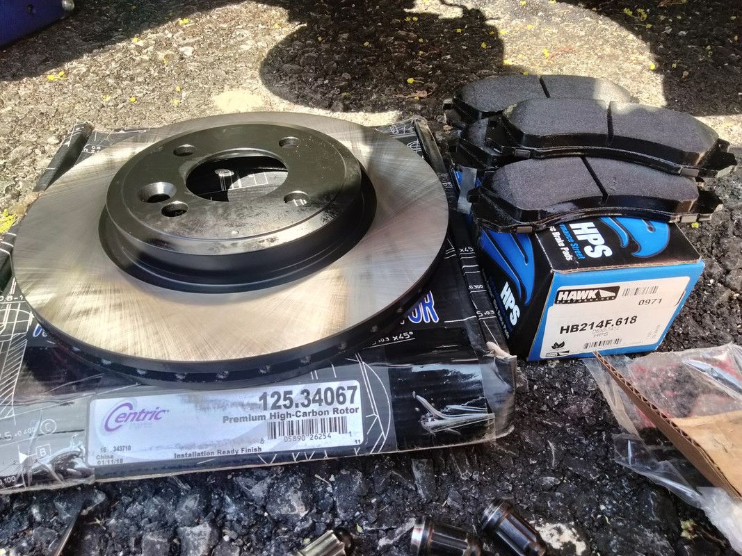

Im going mini rotors because:
-they are drop in
-gsx calipers on my hubs fit perfectly to the radius of the calipers
-they told me to use em on mirage forums LOL
-this setup will clear my wheels
-i can get them anywhere for cheap.

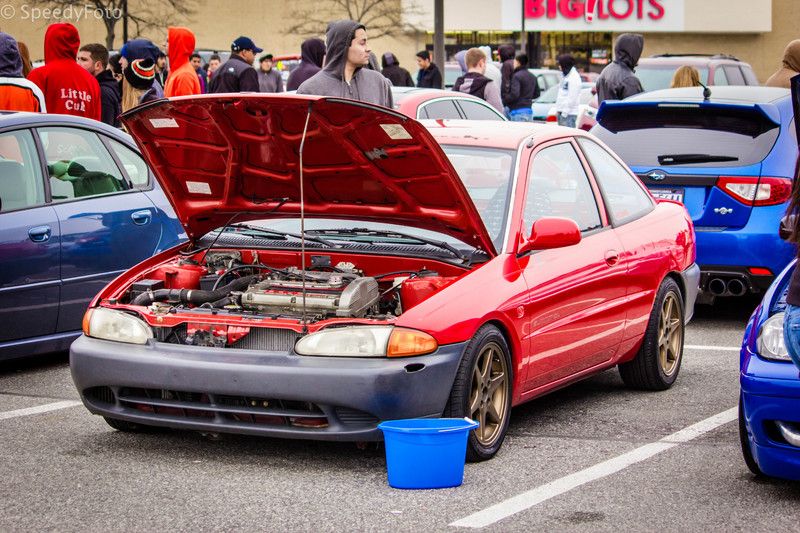

I went to a show today! the buckets were for votes.

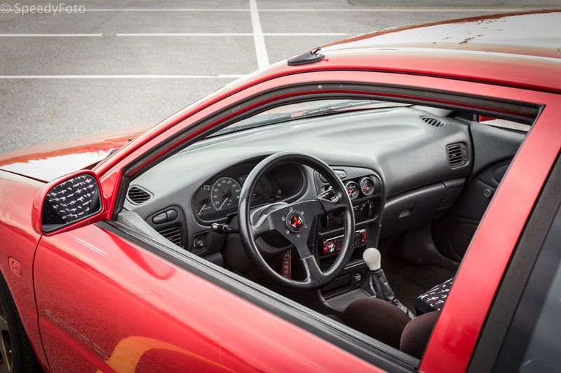

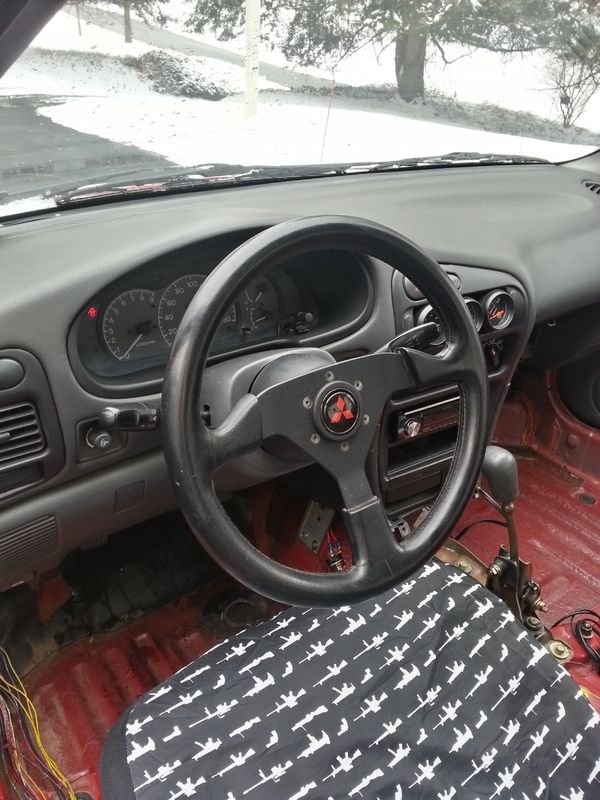

EVO I Momo OEM wheel installed. 100% bolt on.

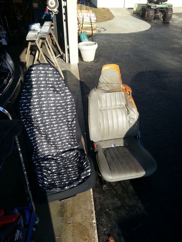

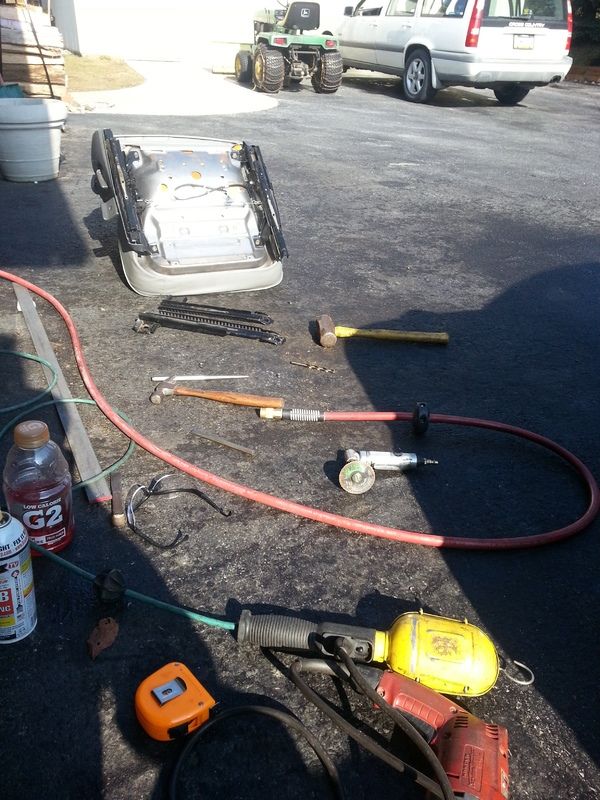

What I did today:

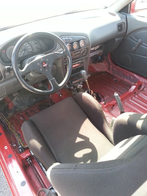

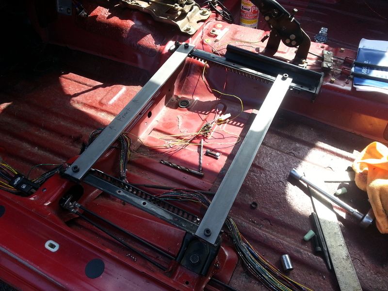

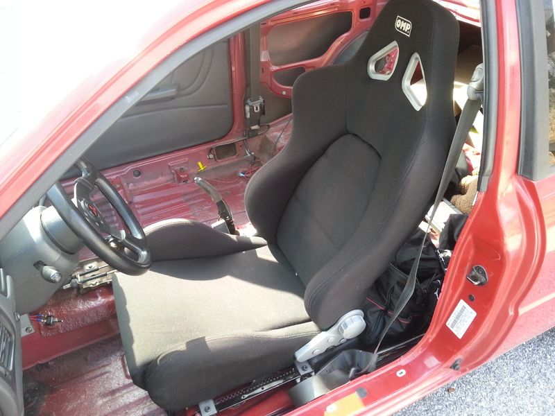

-fabbed up a seat base (4hrs)
-installed seat
-smiled
-drove to Rita's for a free water ice
-went to the gun range (pew pew!)

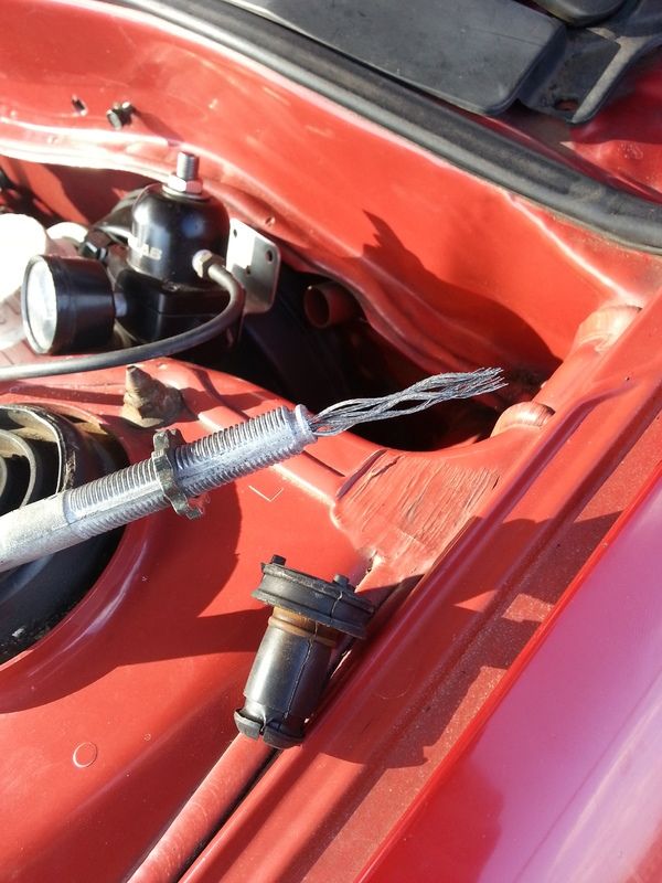

-broke clutch cable on the way home, RIGHT in front of my development
-LOL'd
-ordered new cable (arrives tomorrow)
-failed to McGuyver the old cable using crimps (ended up being too short, darn)
This REALLLLLLY needed replacing:

Making the base:
image hosting free
taking a screen shot
Seat in!

SNAP!!!!! You bastard.....

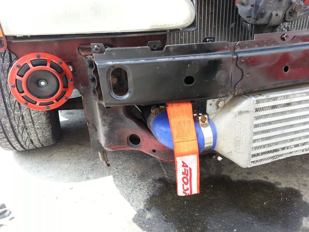

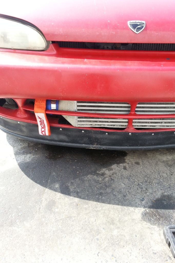

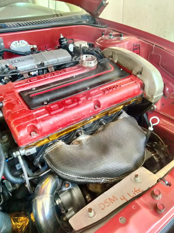

Precision FMIC and reused old 2G hard pipes that were cut to fit and re-beaded. I turned the boost up to 22psi, 15-22deg timing from 3500-7K. car is fun and not safe.

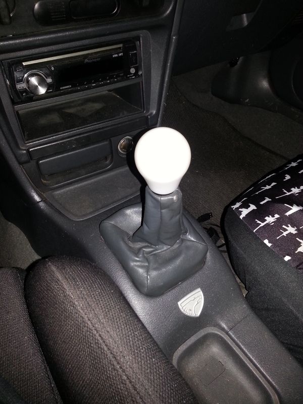

Delrin shift knob. and some proper pics :)

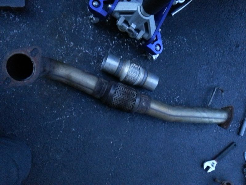

I got in a walker flexpipe. Nice and heavy duty. Mine is so bad and the car sounds really ricey mexicali bad haha.

-new shift knob! Woooot! Torque Solution Delrin teardrop.
DSLR Pics of my baby, my love, my coupe:
car is alive and well. 2g GSX brakes with mini cooper s rotors are on, HKS pads. 1.8L Trans is swapped.

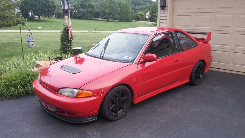

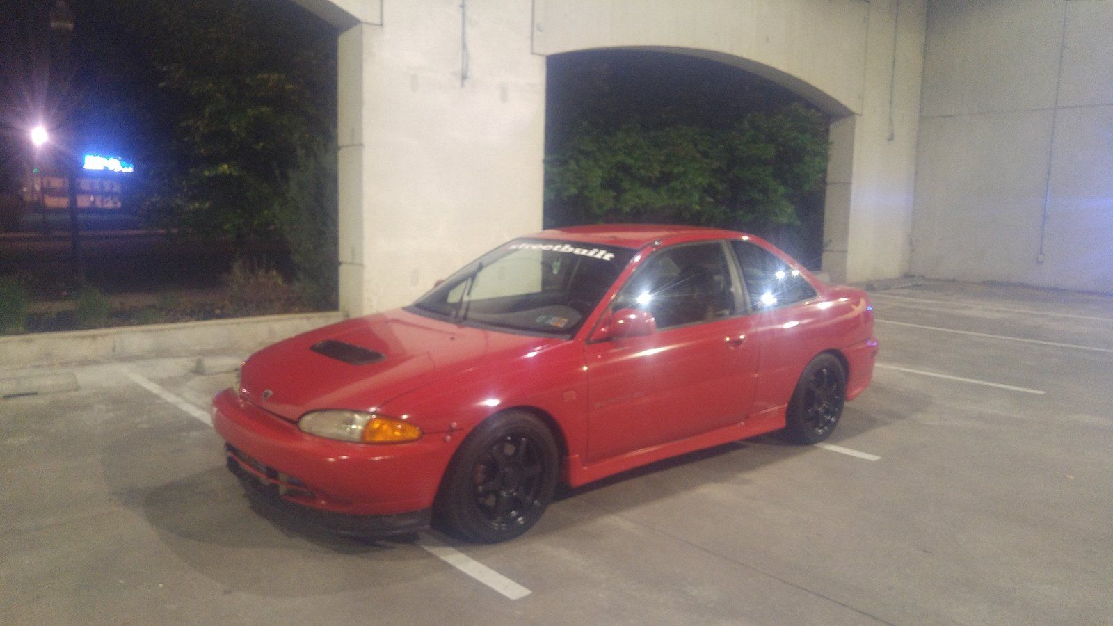

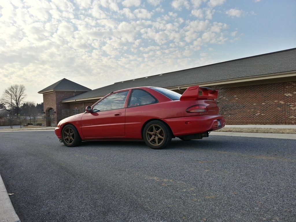

Wheels went satin black. I needed a change. Im lovong the new look. Veey pleased. Rotor rust was painted over and calipers will need more red paint applied soon.

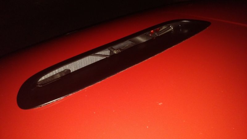

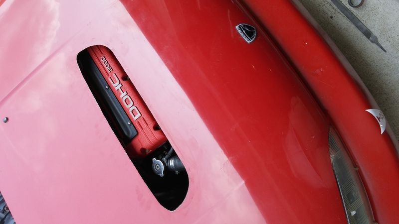

Subaru scoop is on. Turned out well. I need to do some minor cutting of the support so the scoop isnt flexing on it. No biggy. You can really feel the heat coming out of it. Im sure it will assist in lowering under hood temps and pressures
But wait, there's more! Lol

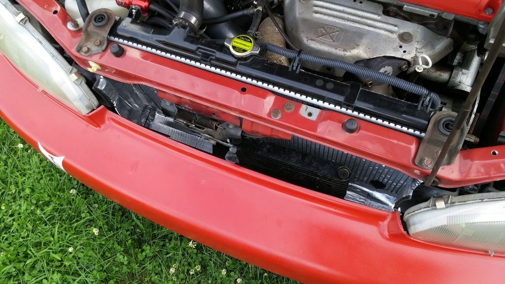

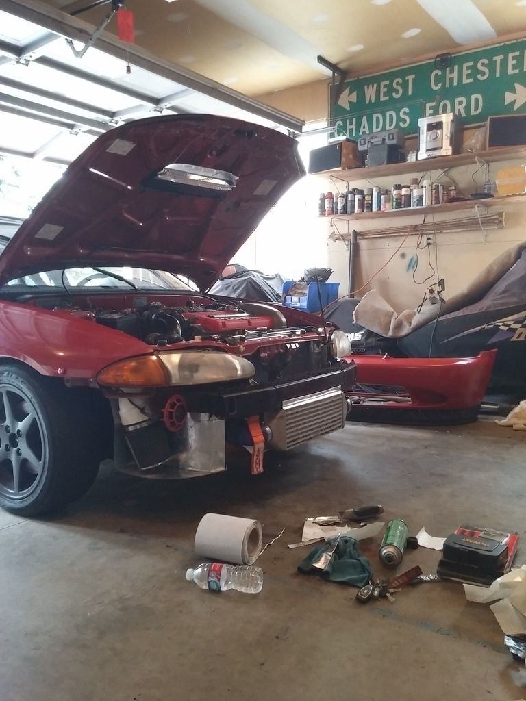

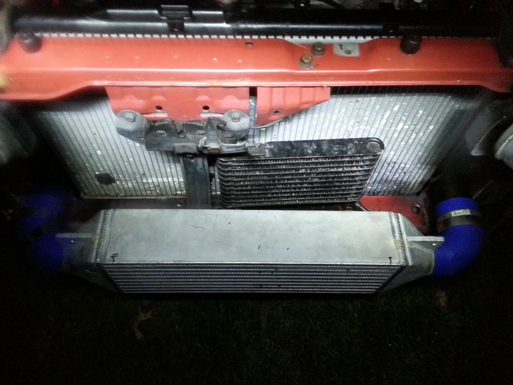

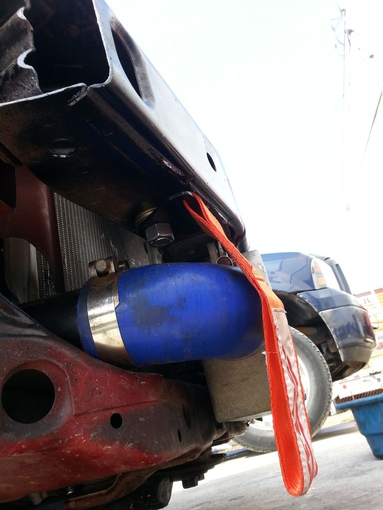

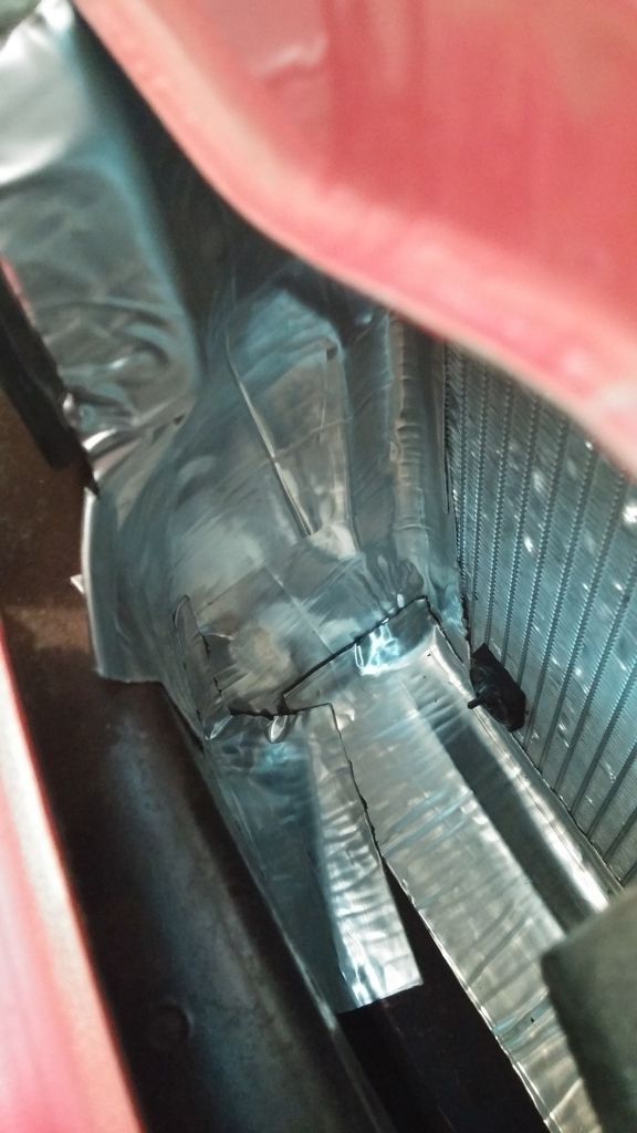

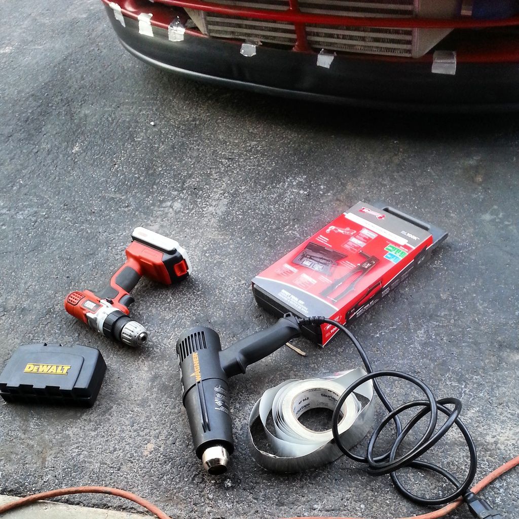

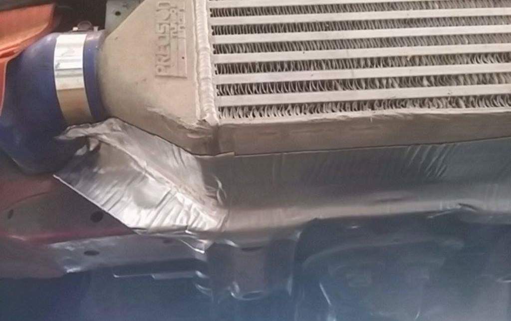

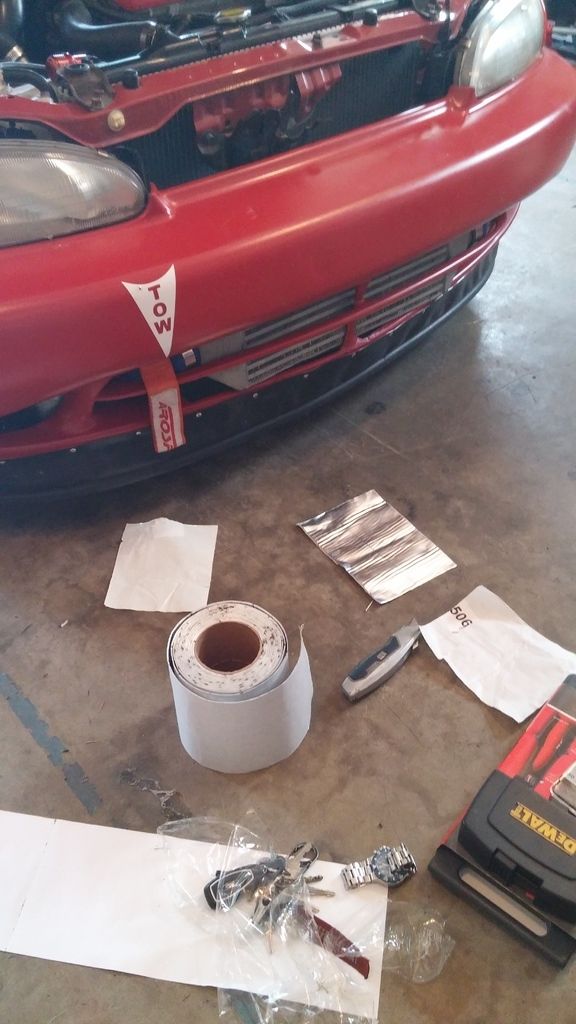

Vent is race car bolted on, and i used peel n seal to fully seal in the fmic to the rad for good air flow. I didnt have any cooling issues, but for $16 it will make a great difference and now the heat can escape put the hood as well.

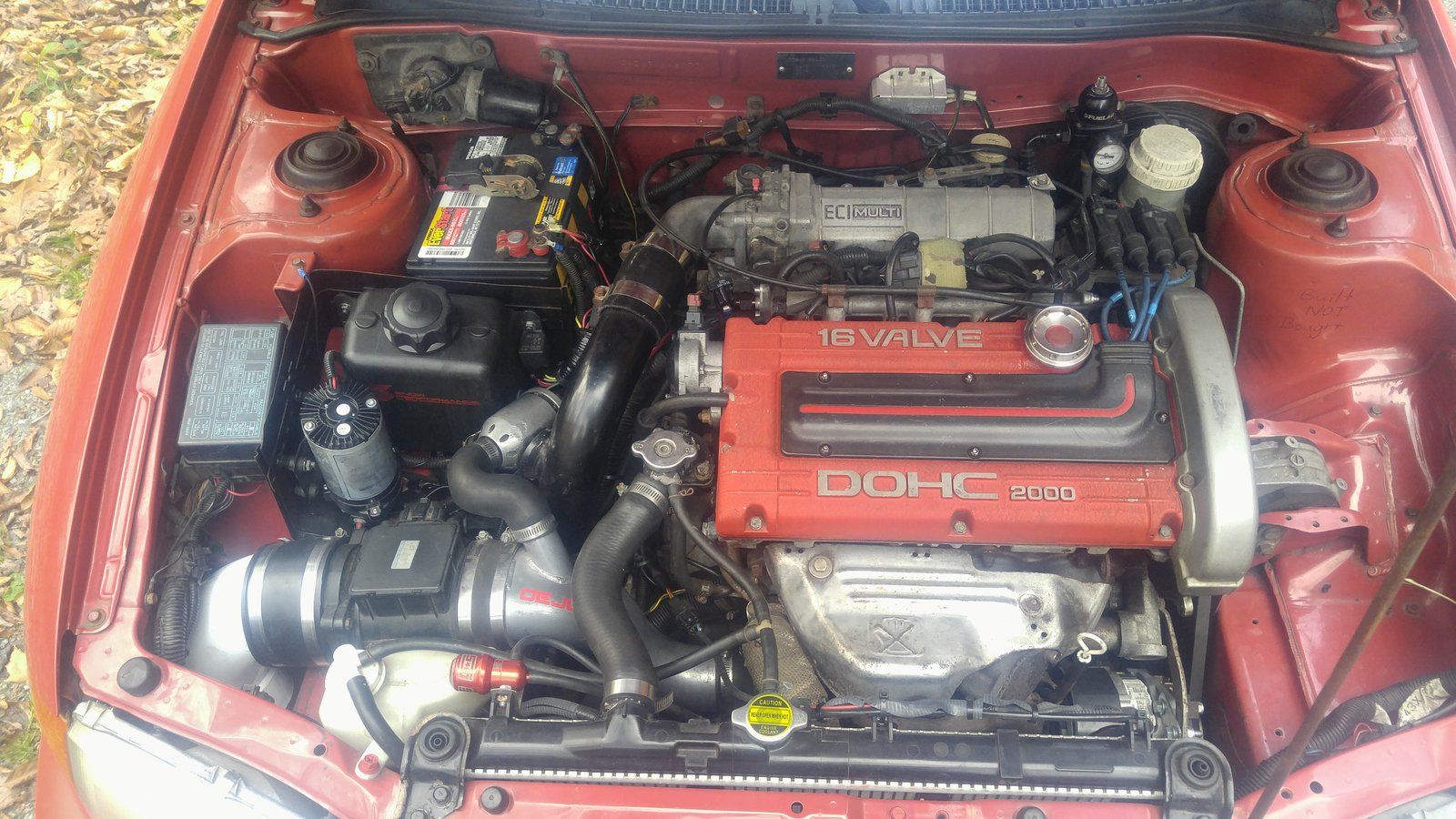

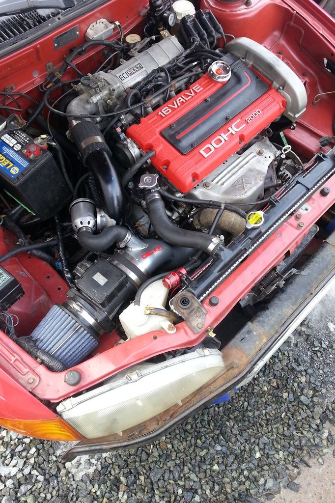

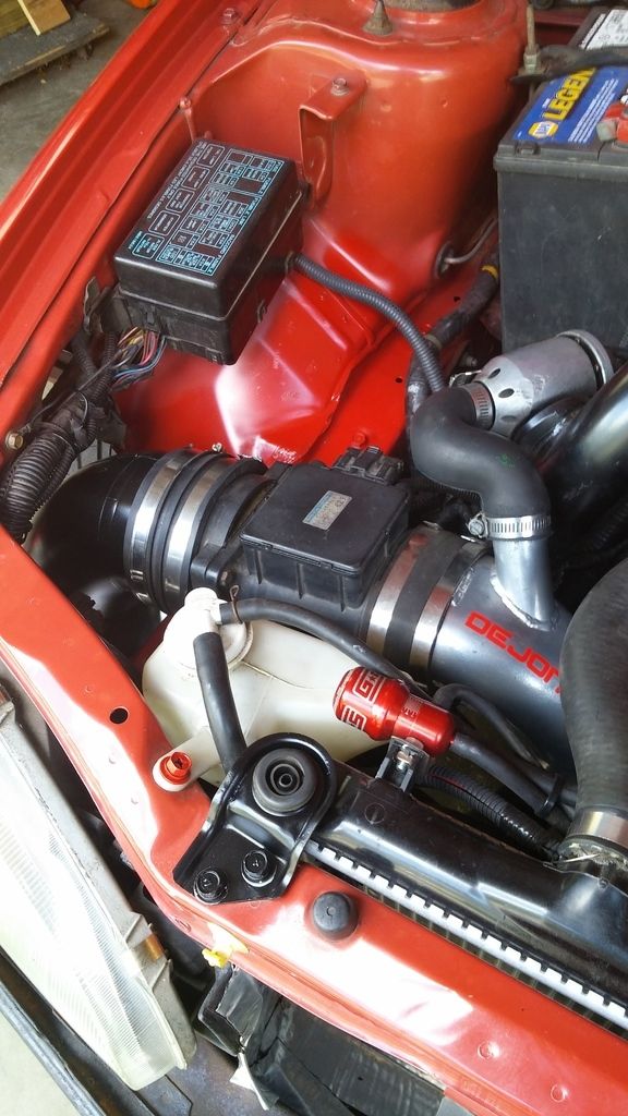

engine bay cleaned up a bit. nothing crazy.

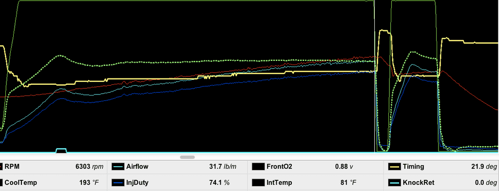

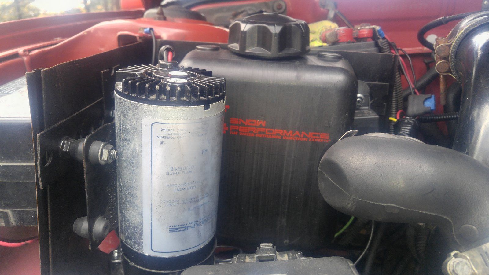

car is now on 50/50 meth!
23psi/19deg timing/11.4-11.7afr

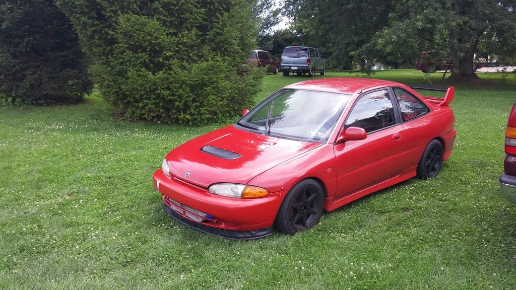

i decided to clay bar, deep cut compound and wax the car. still working on the rear bumper and the wing is off and repainted, awaiting cure time and some wax. it stays on because it reay does reduce lift above 100mph. its felt.
car looks and feels way nicer. original paint shines!

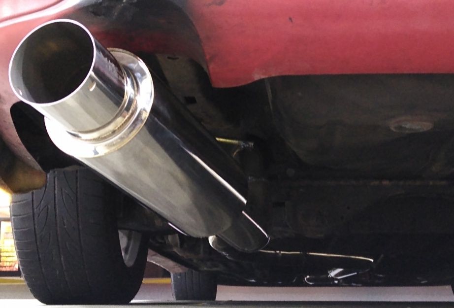

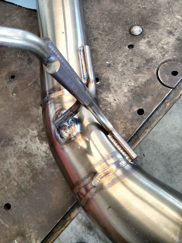

-3" full 304 brushed SS catback was custom fabricated and Tig'd by Elliot Maher, and reinforced at the muffler area for strength. i used the always wonderful Megan that sounds so good.

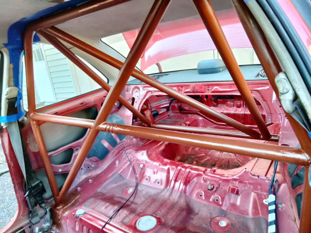

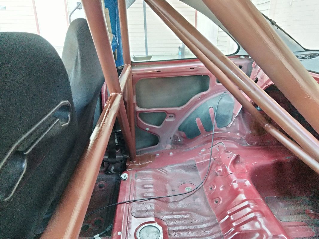

-4pt cage was just put in. working on painting that and getting fixed back drivers seat/harnesses in. its primered for now.

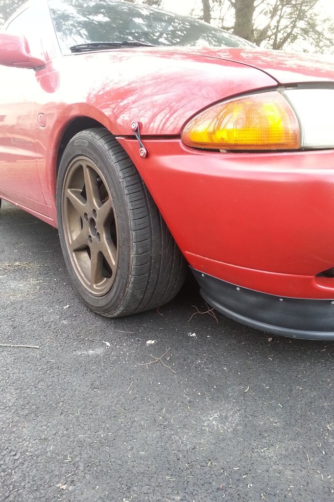

-225/45R16 toyo R1R on Konig Dekagras in the front, fenders pulled and rolled.

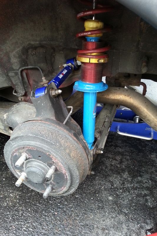

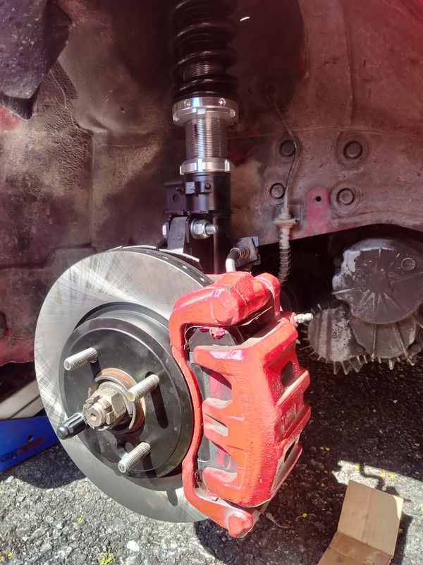

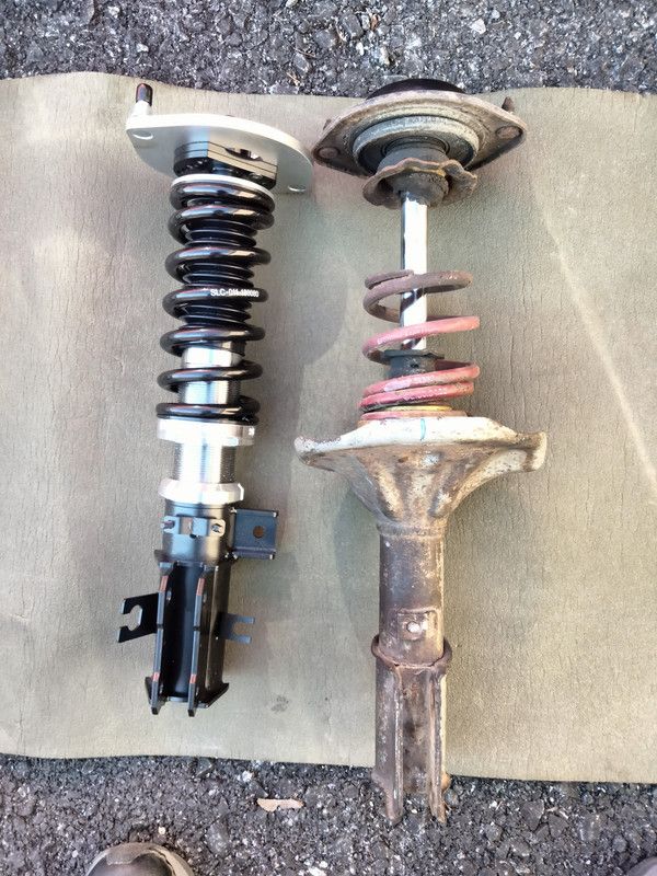

-Silvers Neomax coilovers are in.

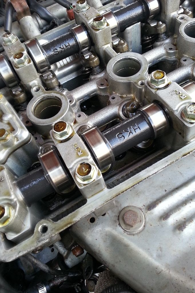

-EVO III turbo redone to a Billet Bastard Td05 20g by Jusmx141.
-38-40lbs min airflow peak.

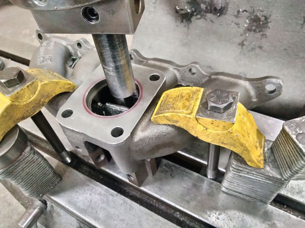

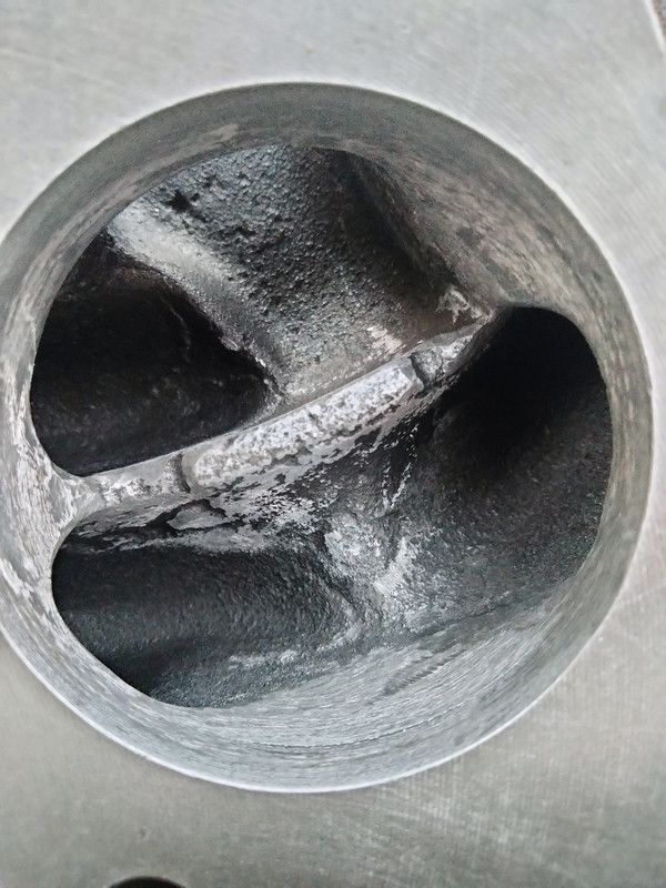

-new Doorman 2g mani ordered, and then bored to 60mm and smoothed all ports leading in as well as general cleanup of casting marks inside. also lightly corner broke the step in the hotside to smooth that in.

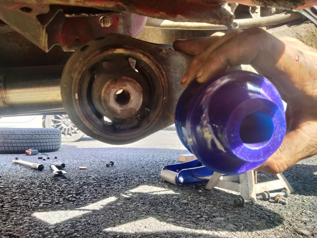

-I need to install the new trailing arm bushings and camber arms to finish up the rear susp.
