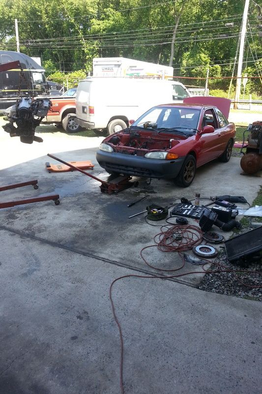

onto the pics. I will pull from my MFP thread and summarize it to this point. I just dropped in the 6-bolt this weekend so this IS a 4g63 car right now :)

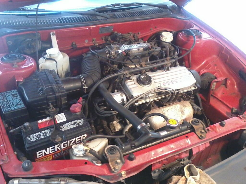

1993 Eagle Summit DL. BASE MODEL. no cupholders, AM/FM radio, no power steering, no airbags, no ABS, no AC, nuthin'. I have my EVO I RS coupe FWD base setup ready to have some fun :)
The day I picked it up:

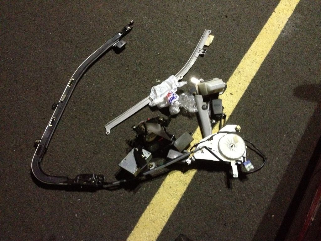

I removed the retarded auto-retracting seat belts...holy extensive mechanism!

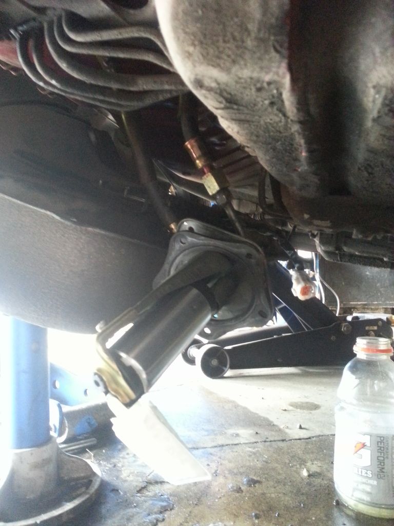

-2G AWD calipers WILL clear my wheels. thats a plus. pics of the 2g AWD front calipers clearing the 16x7.5, et35 wheels, and the fresh brake job with OEM pads n rotors for now.

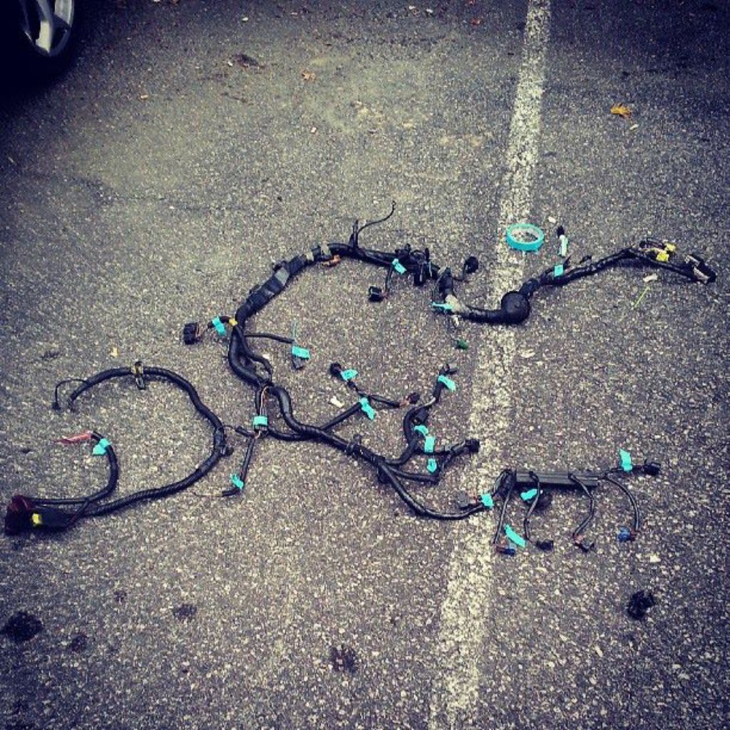

I picked up an EVO II ECU from TKR. it has some surface corrosion, so I have to send it out to Mr Dorris sometime. Pics of my EVO II harness as well.

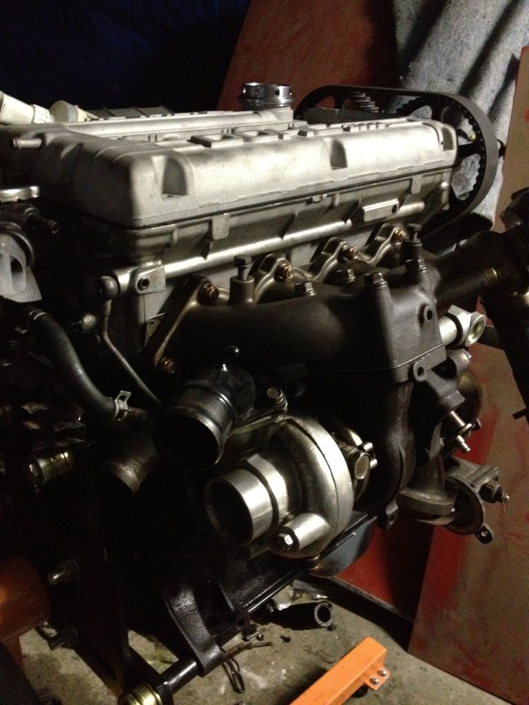

-TD05 16g turbo (looks like E316g)

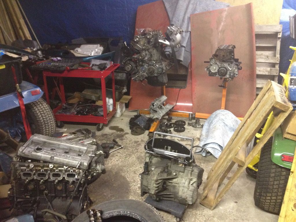

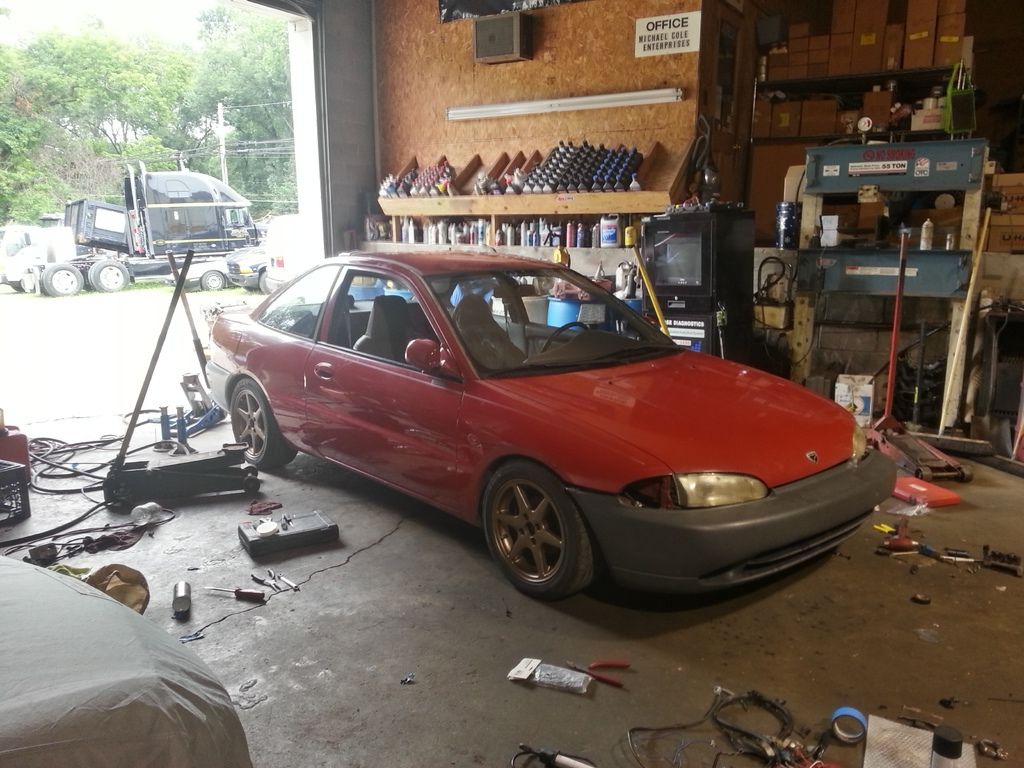

this is my horribly cramped (but free to use so whatever) DSM engine building area @ the local shop i go to. The other engine to the right is the fresh short block for the summit.

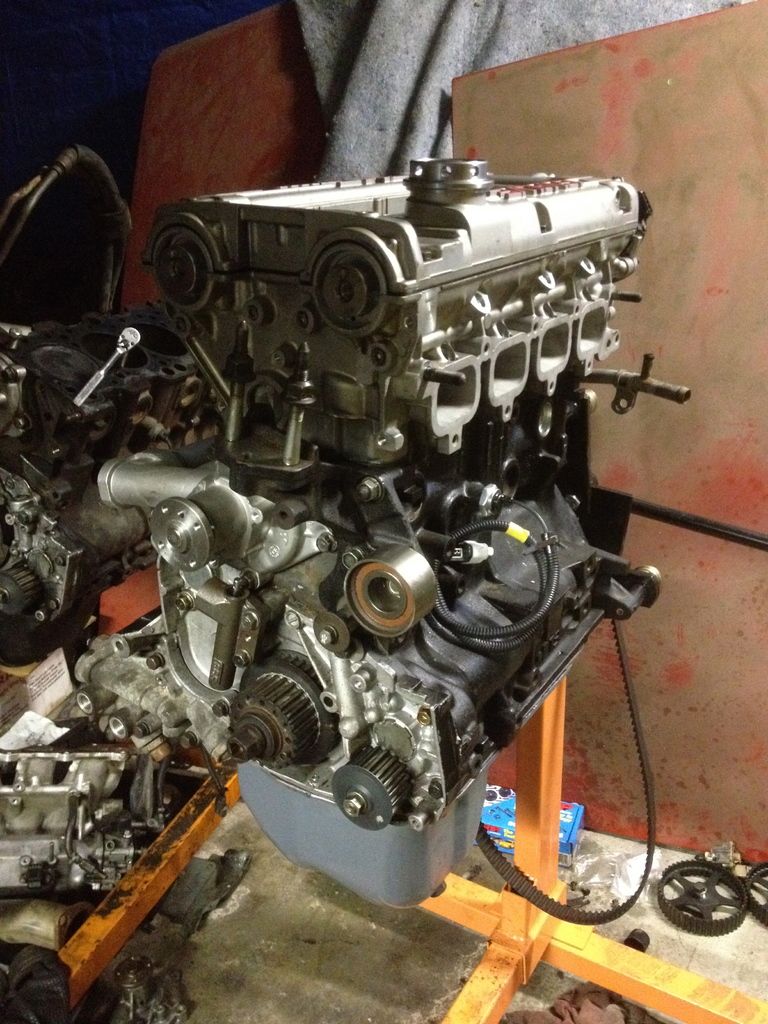

6-bolt longblock assembled. Talon was gonna get this...now it's back to the summit. this is the motor I bought in pieces at the top of this thread :). I went with a brand new HKS 272/272 combo with Kiggly springs, viton seals, ARP head studs, and OEM HG. bottom end is stock rebuild with a BSEK and new OEM waterpump.

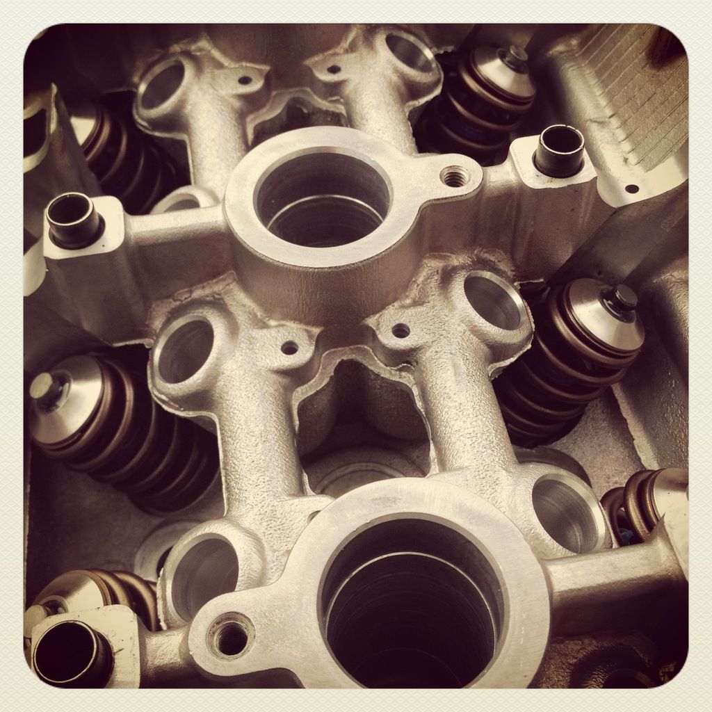

fresh redone head:
Bottom end with LOWWWW miles:
Kiggly's, 272's Viton seals
16g is on with HAFE mani and PTE ewg

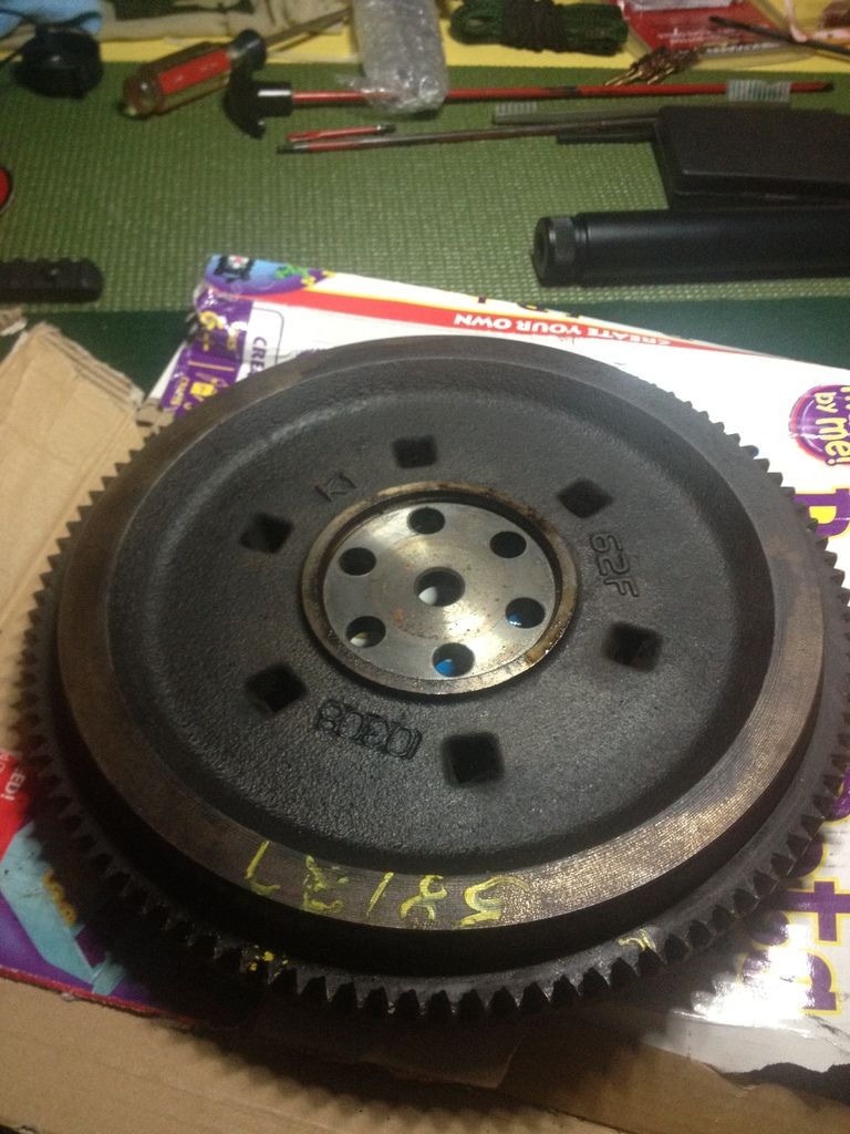

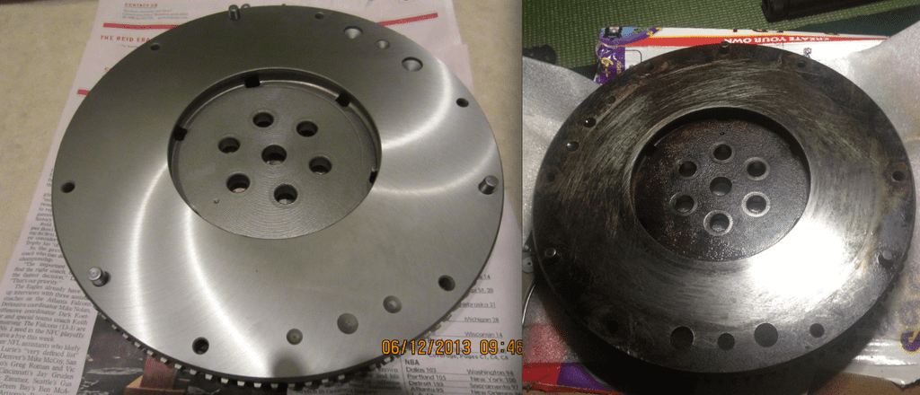

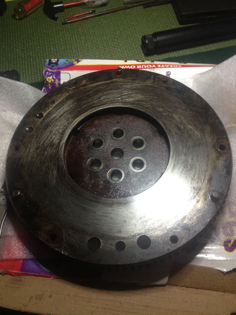

Flywheel is here! looks good, a $50 resurface job will clean it right up :)

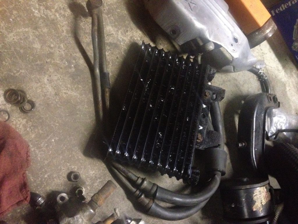

Cleaned up the Oil cooler and lines;

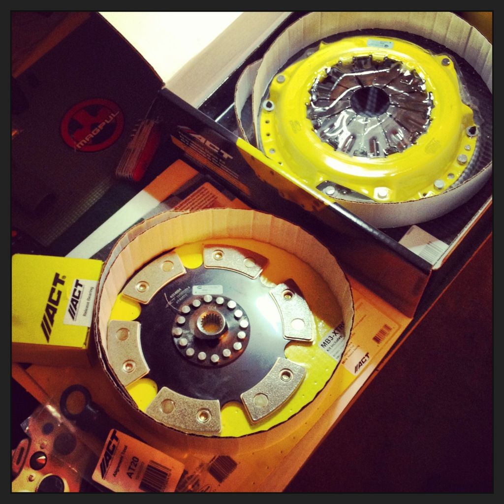

Some packages filled with sex came in the mail today:
hehehehehehehehhehehehe.....X-mas again!!!

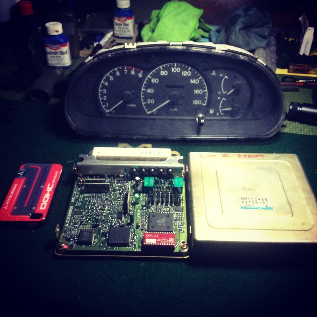

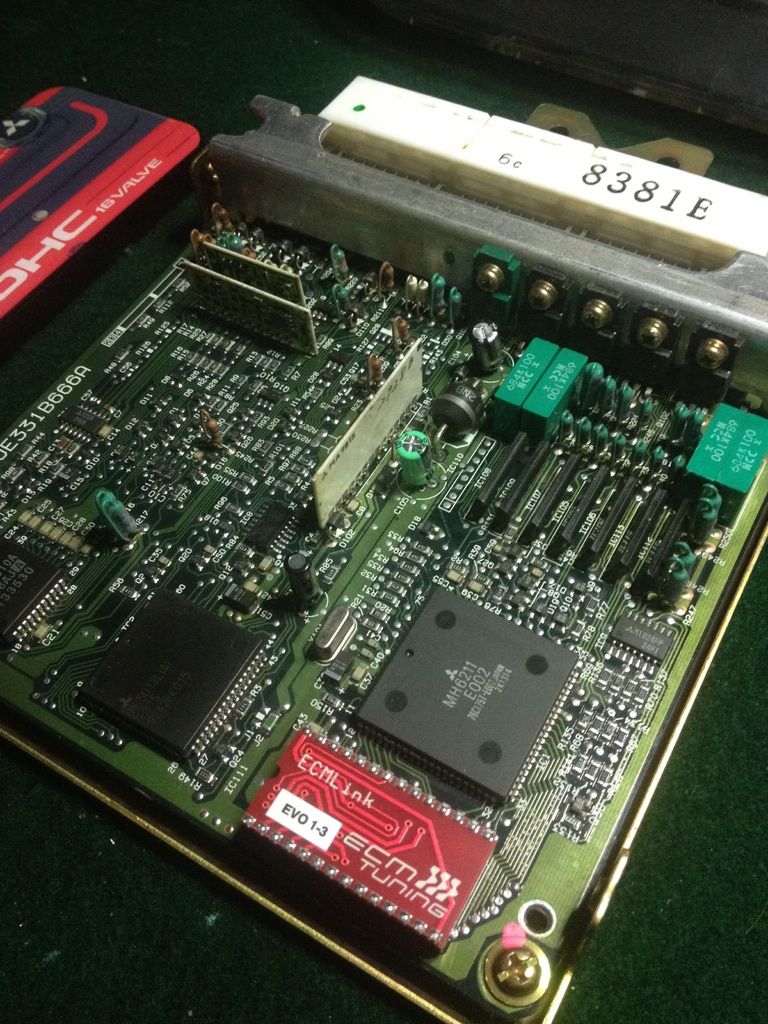

ECU professionally redone by Quentin Marchone. He is LEGIT, in Michigan IIRC. He's also a good friend of a buddy. He will beat Dorris' prices too. I had it back in a week and that's cause I was slacking on paypal LOL. He appreciates business, so find him if ya need work! he's on FB.
I used the Aus how-to ( Cluster with Tacho wiring • CE Lancers and Mirages • AusLancer ), easy peasy. looks to be within 3KPH accuracy with my GPS. I think one bulb is out, but that's minor.

DAAAAAAAAAAAAANG that's a nice flywheel :)

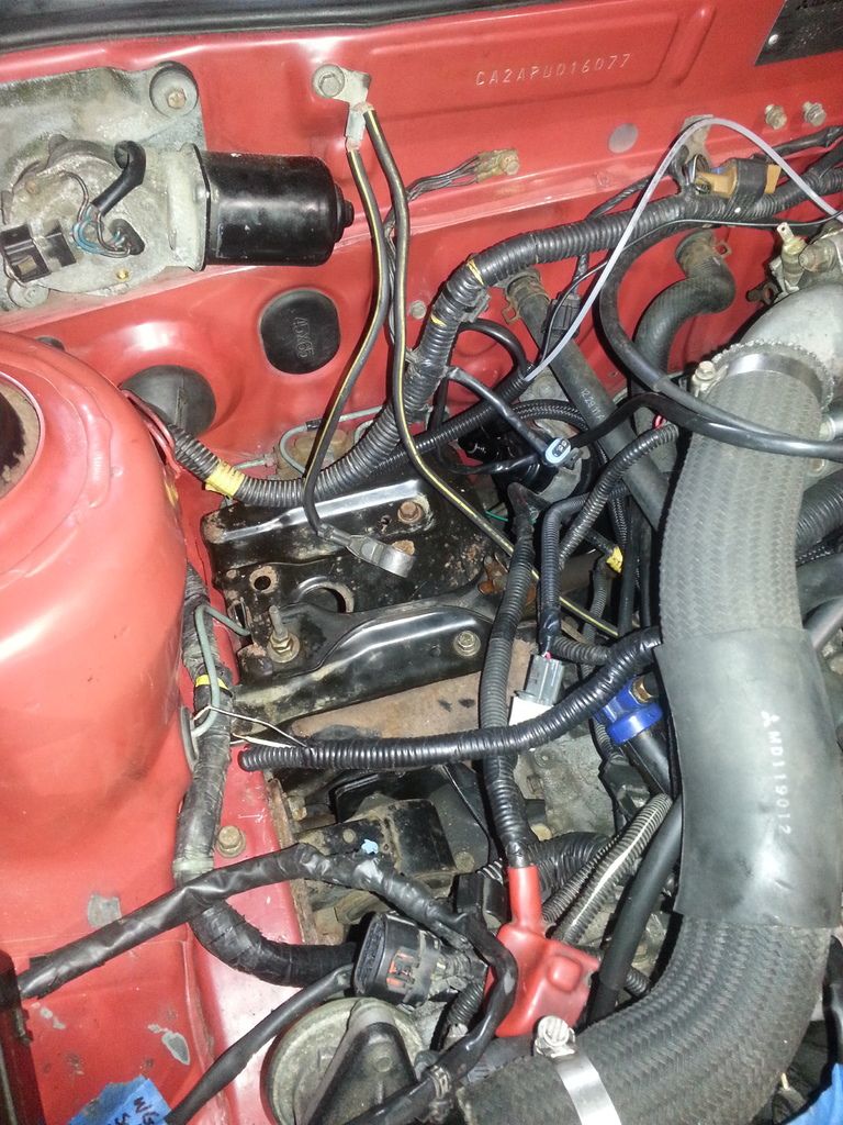

NOTES after install:
-I realized the EVO II engine harness is RHD....LOL. I am going to have to connect the clips, open the harness, delete what I don't need, extend what doesn't reach, and then re-loom it and maybe tuck it since I have so much room to work with :)
-clutch feels mushy, and not definite release point. I know it needs to be adjusted more. had a lot of slack on the cable. I also had no trans fluids in it and the car hasn't been run. I hope I can adjust it properly or that will be an isssue. I never did a cable adjustment setup before. I just looked up a new cable and it's $40. I will try a new cable as well.
-SMIC needs to be fitted and mounted
-fuel pump needs installed.
-rad needs fitted and mounted...not sure where the DS mount is supposed to go, I am swapping to a full rad from a half rad. I also need to pick a fan. I think one 14" 1500cfm fan will work ok for now.

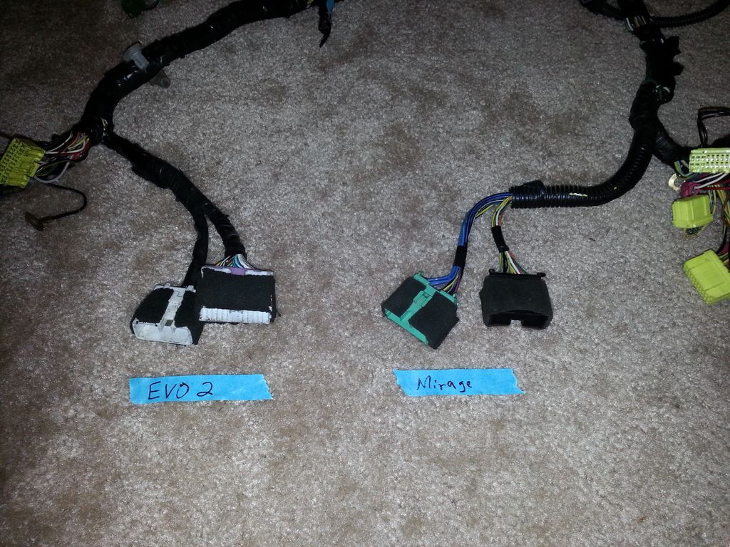

I need to know:
-Pin outs for Mirage DASH harness
-Pin outs for EVO 2 engine harness DASH connectors
I just need to know the pinouts so I can make it plug and play. I already know all of the EVO 2 ECU pinouts. I am guessing I need to know ignition stuff, tach wire, cel, all that stuff. I have the tach already wired up, I just need to know the pin to use for it. I will most likely cut off the EVO connectors and use the Mirage ones so I dont have to cut the dash harness as well.

I already have the connectors marked for most all of it. I am going to shorten the harness in the firewall area to make it LHD. it should be good to go once I do that.

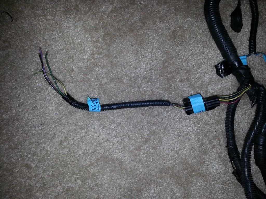

I was sold a cut EVO2 engine bay harness. the MPI pigtail and connector are gone. there is NO EVO 1-3 specific electrical diagram from MB. If I wire in an MPI relay incorrectly, I fry my $280 ecu + $450 link chip.
consider this shit on infinite hold, if not a part out. If I could drive to canada and beat some A$$, I would. I dont have his info anymore. it was last year. I'm walking that fine line of DiSappointMent.
FML

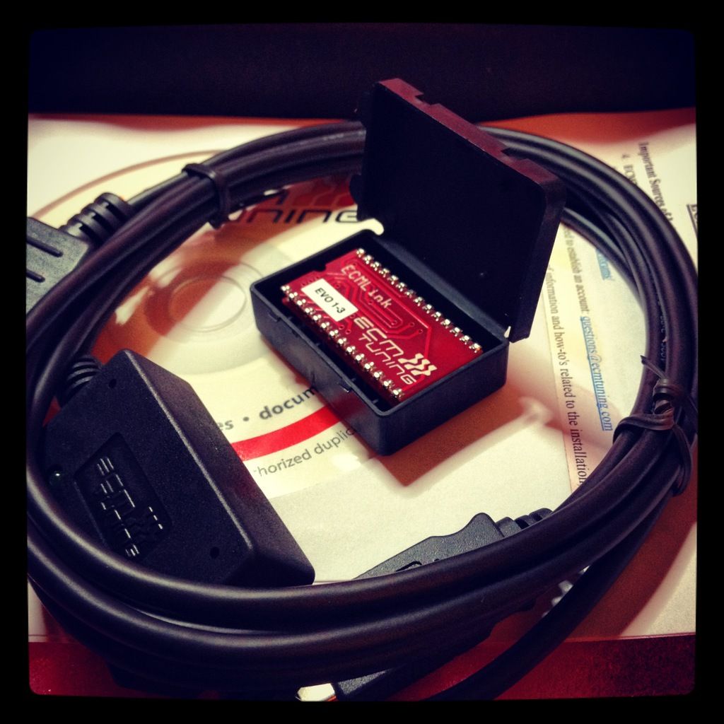

EDIT: looks like I'm going 2g Wiring harness, 2g EPROM and 2g DSMlink. I will update when I make more progress. Early EVO 1-3 wiring is a GREAY AREA!!!! BEWARE!!

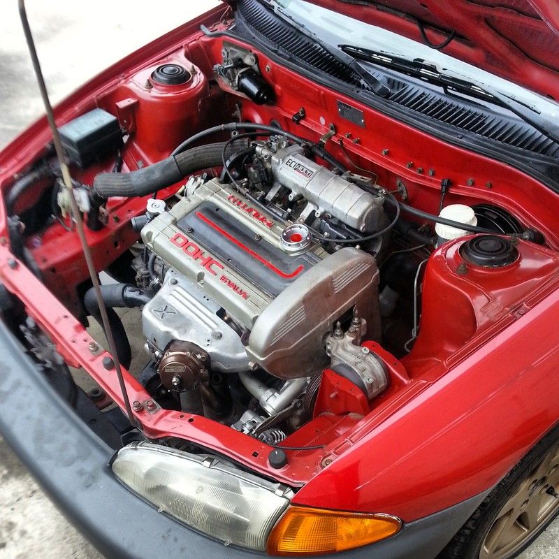

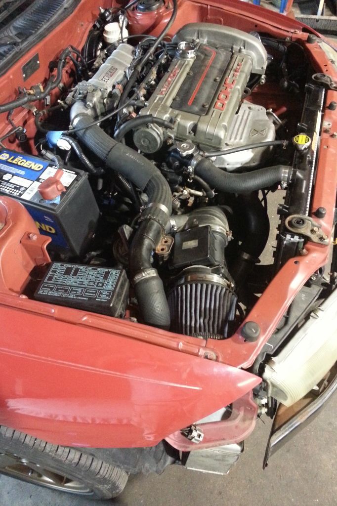

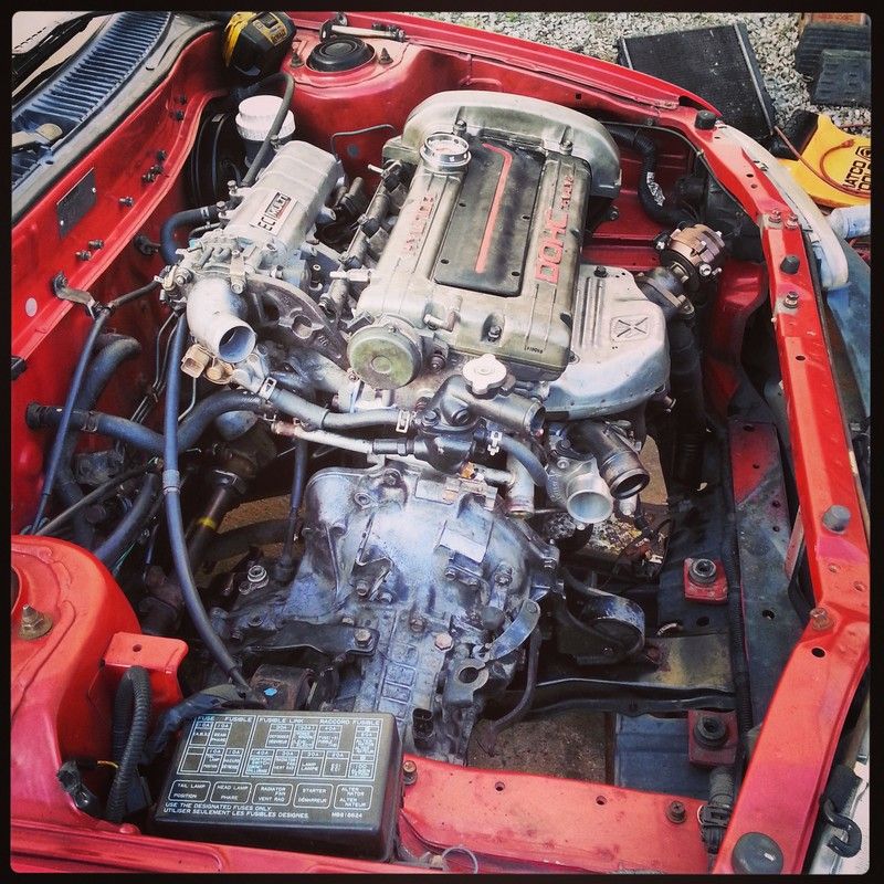

UPDATE:

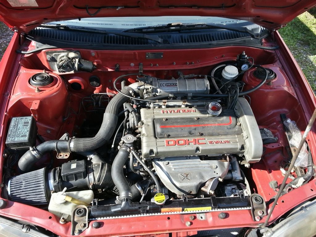

I worked on the car again friday and sat a little bit, more stuff completed:

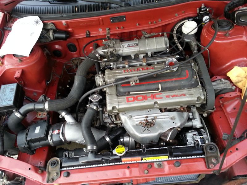

This is how the engine bay looks now:

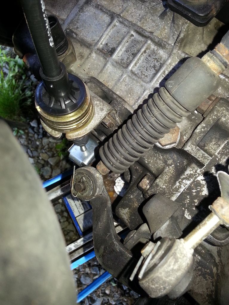

-I decided to "FIX" the way too low clutch engagement point by DSMing the clutch cable with washers so the actaully disengages now. It works great. It's fairly stiff as well. It should hold for a while.

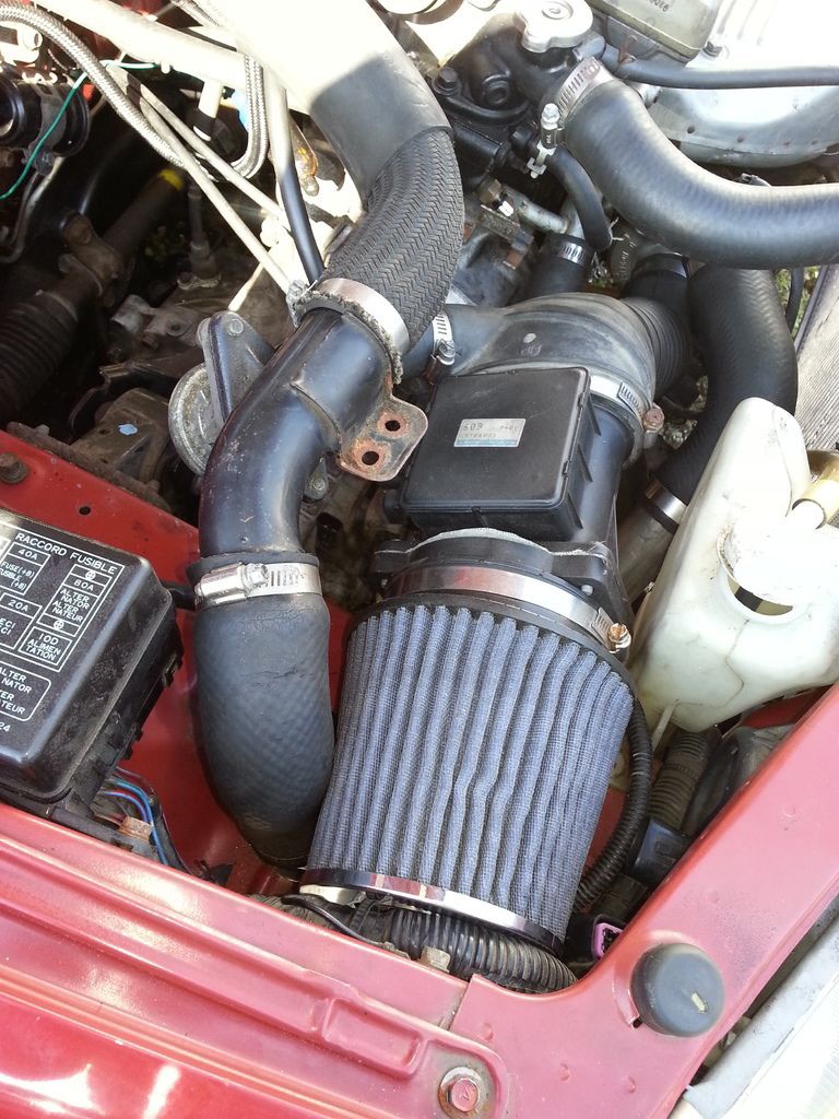

-2G OEM intake and MAF is in and fits with the Vibrant Filter. gits up to the stock 1g BOV as well, recirc'd
-New IWG boost line is on...I will be running stock boost for now.

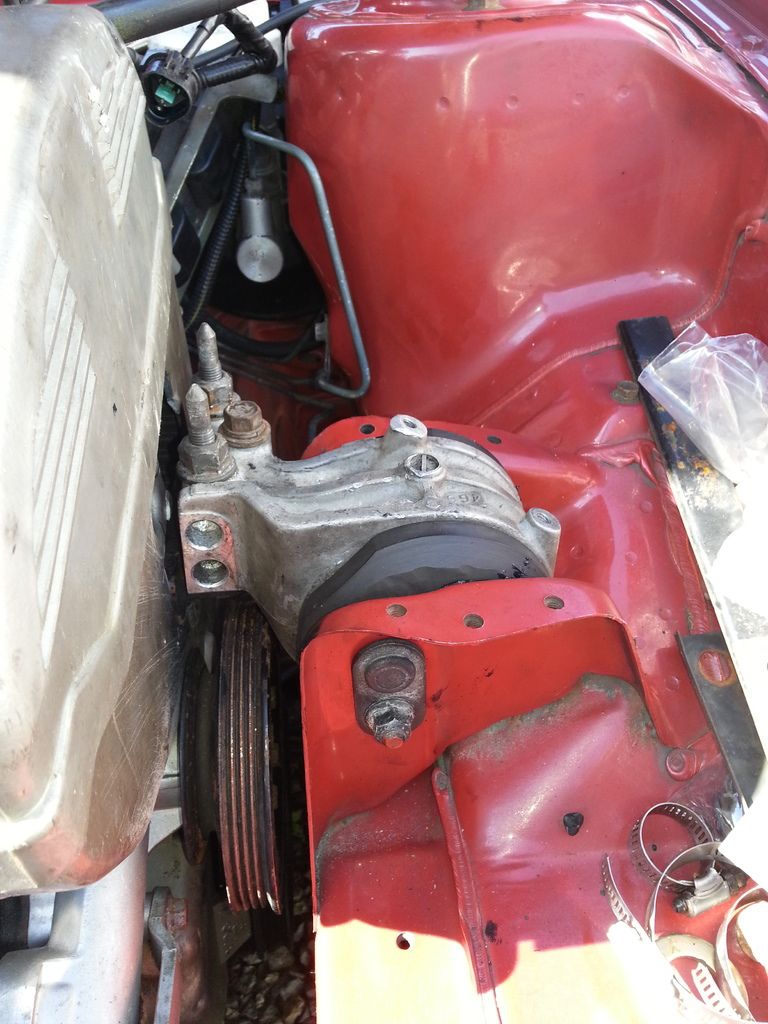

-I relocated the DS motor mount hole in the solid rubber mount. i think its a 13/16 hole saw size. after I drilled the hole I used 3M Windo-Weld to seal up the old hole and support the roll pin. It will have PLENTY of time to cure. I now have a drop in 2g mount that lines up perfectly and uses all stock mounting. :).

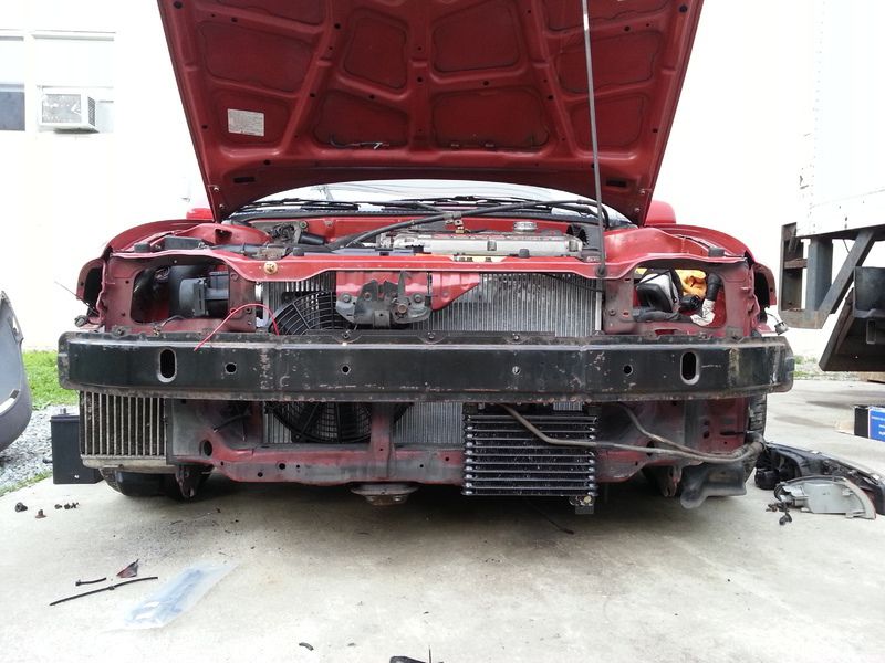

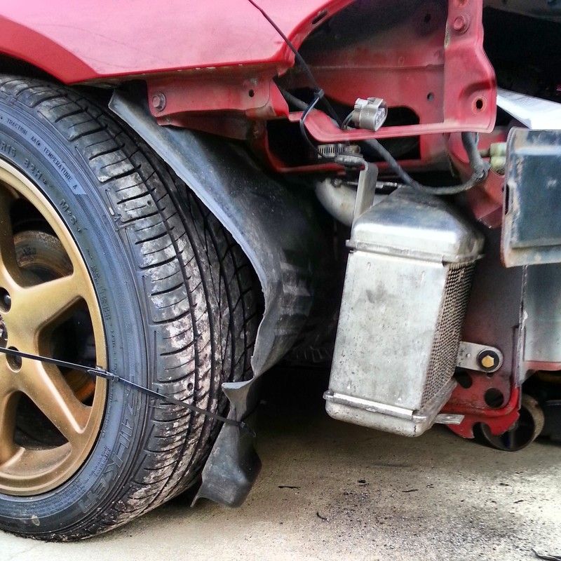

-Oil cooler has been reloacted to the dead space on the lower frame rail, behind the bumper bar. MUCH better, OEM looking placement. I notched the DS inner metal fender liner for the lines to pass through.
-I also painted and got the EWG hole plugged up. I might go back to a 2g mani if I don't go to an EWG and a short rad setup. This all depends on if I get boost creep or not. I'm running a smaller 2.5: Downpipe so I might be ok this time.

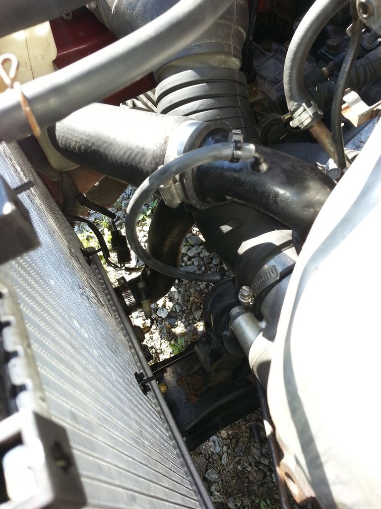

-Modded my 1g lower coolant hose to fit.

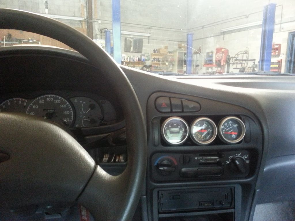

-Front 02, gauge install...thinking a glassed triple pod in the center dash vent area. I want them in my view.

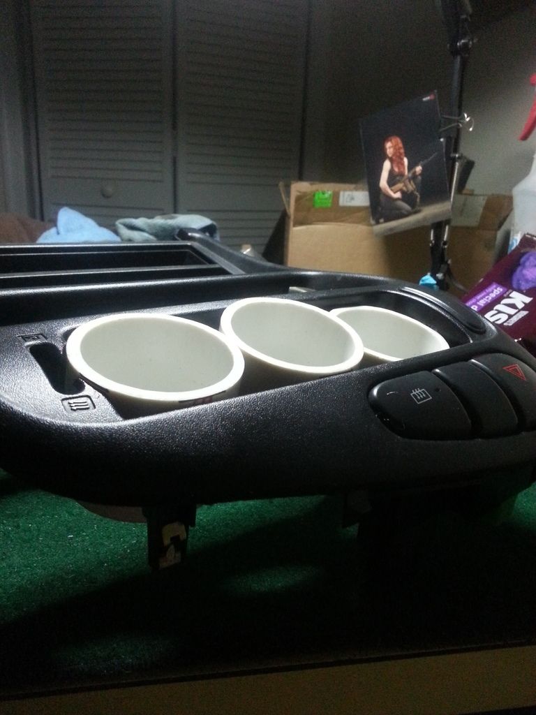

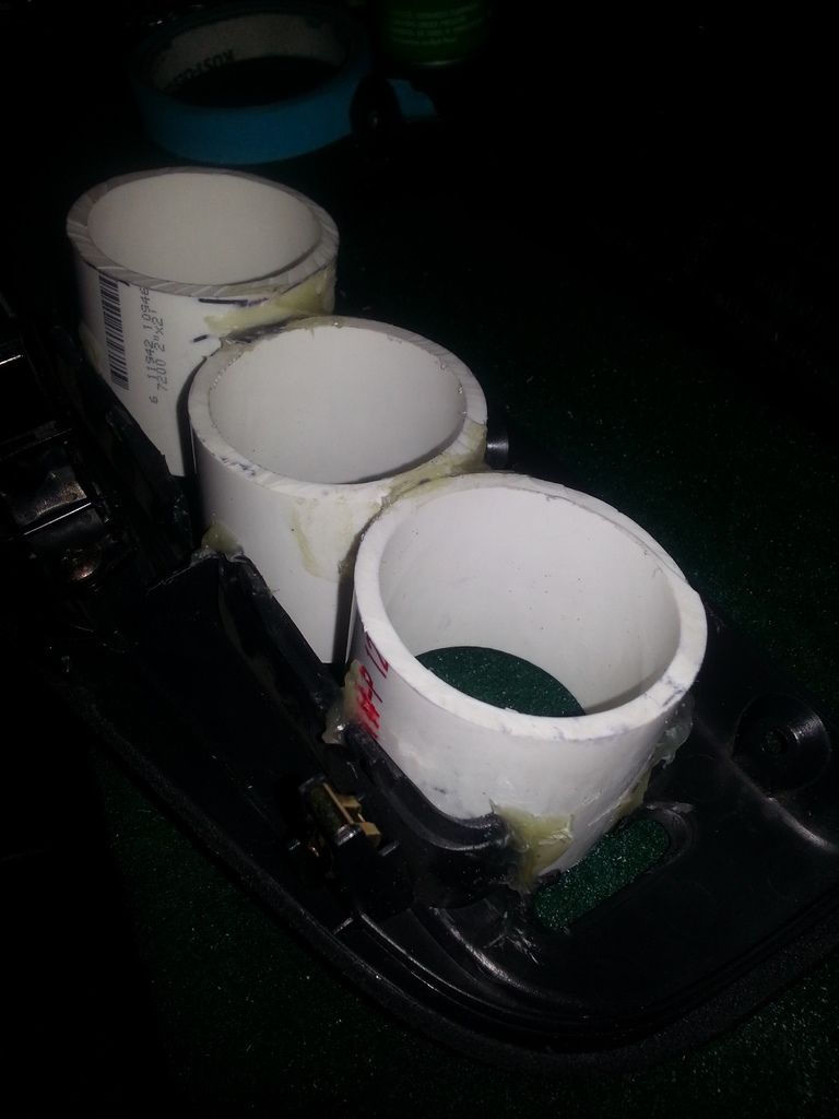

bored.........getting things ready.

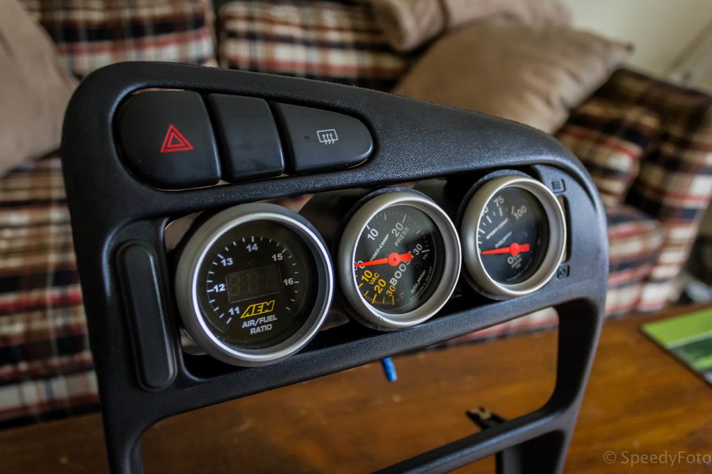

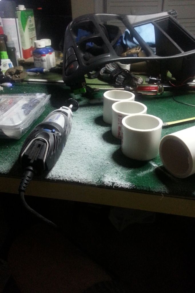

$9 got me this. the pods are offset for the AEM wideband to be flush with the Autometer boost and oil pressure gauges.
I will be painting the pods tomorrow and leaving them floating in the console. I will not be fiberglassing this. This isn't a show car this is a lightweight RACE KAR. LOL.

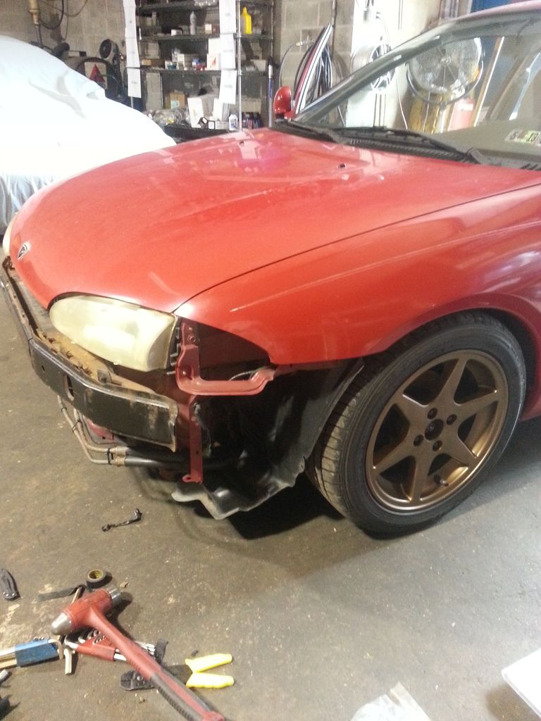

Hood cut and closes nicely: (I like to make a real MESS when I work on 8 things at once haha =D> :D :D )

I test fitted up the gauges...they need some trimming and fitting for the heater controls. I figured so.
