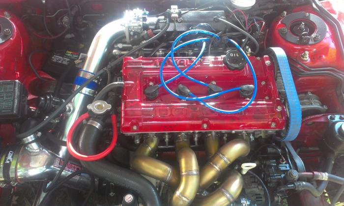

So in post # 113, you have the coolant overflow tube (left side of water neck) routed to the nipple on the right (for turbo). You obviously don't have the factory turbo, but why route the two together when you should have the overflow bottle?
Indeed spyderdrifter, my lines were looped in that picture. I've since blocked the turbo coolant line and re-routed the red coolant hose. Its on my list of things to do to get a proper overflow system in place. I had recently hooked up my coolant overflow bottle and the damn thing leaked like it had been shot up by a 12 gauge.

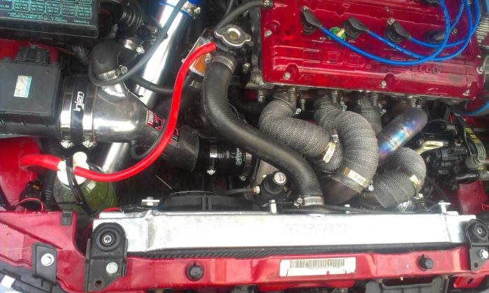

Finally installed a proper battery and (JM Fab) mount. Looks much cleaner. Alternator went out on me during the battery upgrade so I went ahead and threw on a reman from Beck Arnley, seems to have done the trick. Wrapped my O2 housing to try and reduce the ambient heat the Alt sees. O2 housing was missing a damn bolt to the 4-bolt hot side. After inspecting and tightening the others I came to the conclusion that I used the wrong type of crush washers, or at least needed to retighten them after the first few heat cycles. :ohdamn: Checked my manifold bolts and a few other things.
