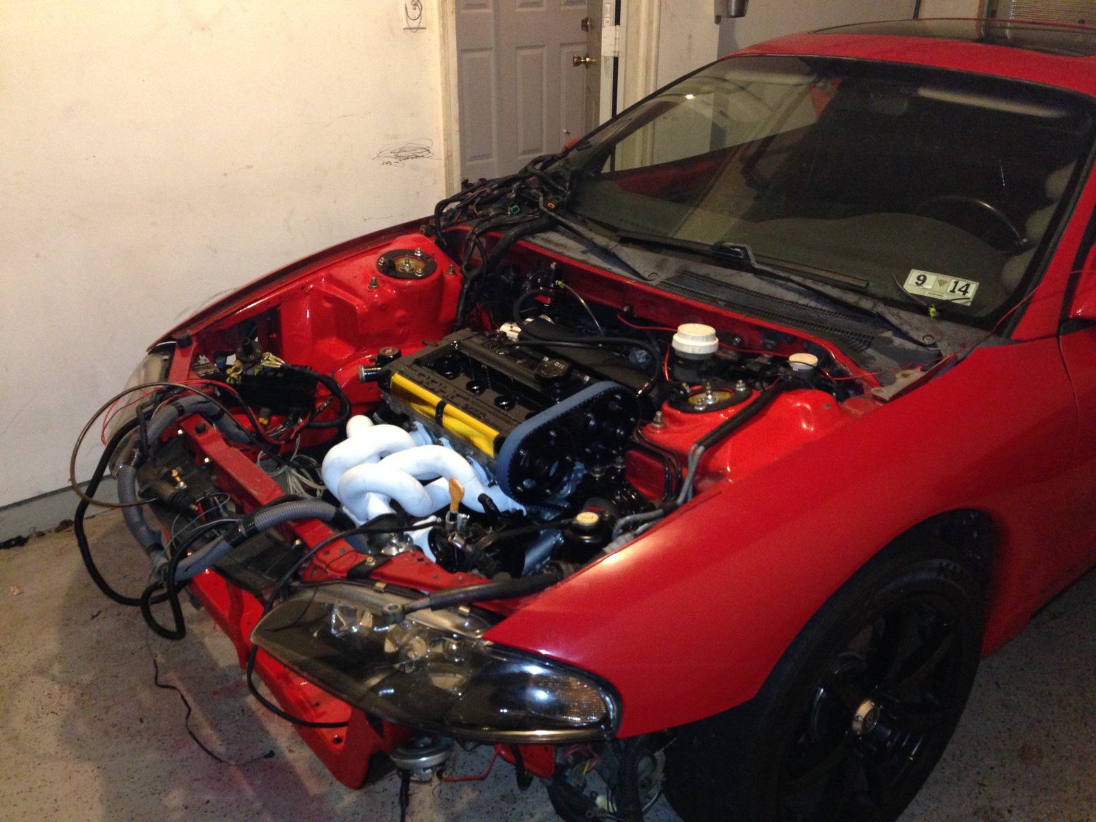

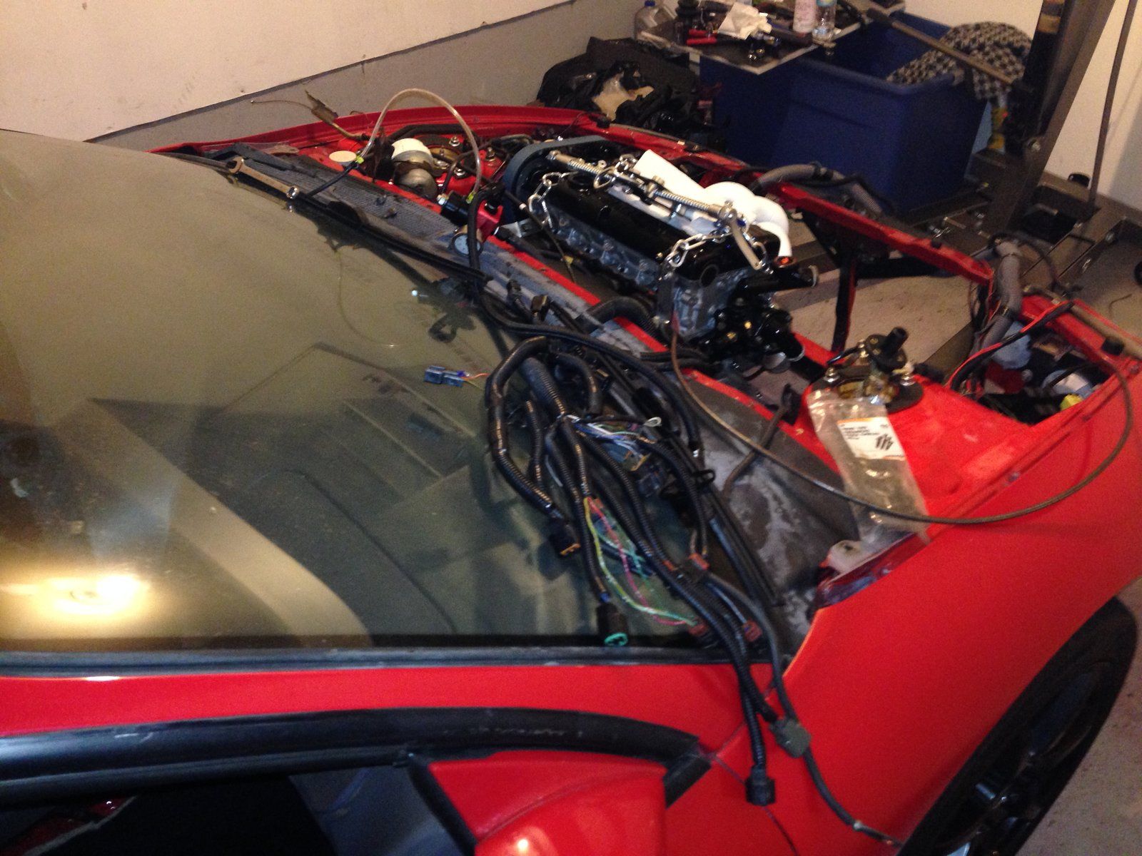

Updates: Pushing forward, got the bay and harness cleaned up. Re-routed the alt-lines, fixed a few things and wrapped it up with some fresh tubing. Looking to get everything connected and the fluids in next, but still have a lot of little things to take care of. First start deadline might be within reach.

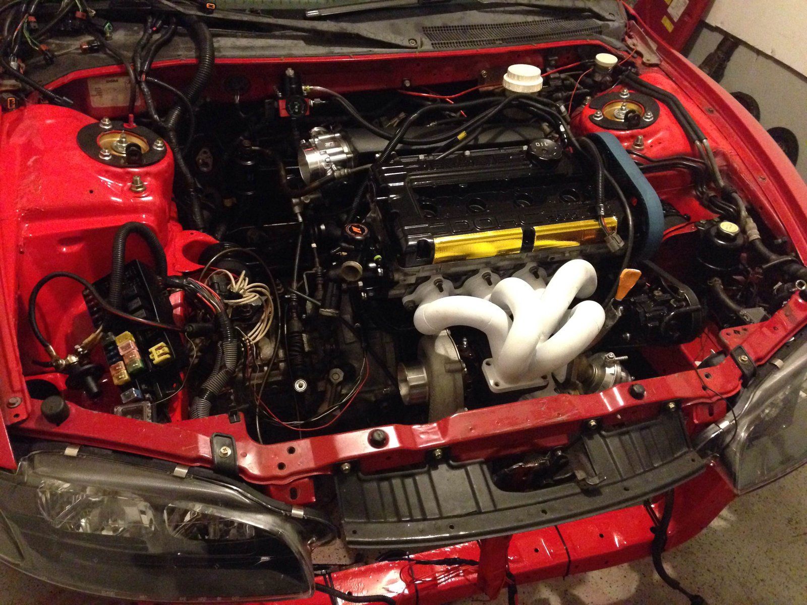

Not a big update but slowly making some progress in the home stretch. Finally got the power steering pump & accessory belt installed. I had to mess around with a few different size belts because the Jay Racing kit comes with belts meant for the stock damper. Did end up finding a perfect combo/fit for both the accessory and alt to go with the Super Damper, I'll post those part numbers up in another post later. Looking forward to seeing what kind of results this setup has in terms of belt squeal, or a lack there of. Got the CHRA oil return line & fuel rail installed. Really happy with the results on this one also, the oil return line is as close to straight as you can get at 4" long from push-lok to push-lok. Also got most of the front wire harness secured. Should be getting the last remaining needed items delivered tomorrow afternoon so it looks like things are still on track for a first start Saturday maybe.
