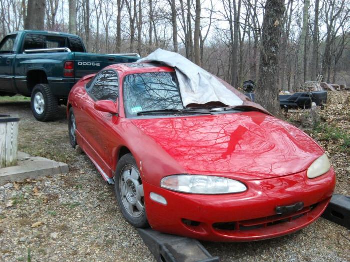

So after an almost disastrous journey (car carrier dropped a leaf spring on the way back) from MA, I have begun the process of stripping her down.
EDIT: I have to mention something here. I was pulling out of a gas station in PA when the whole carrier dropped on to the axle. I was driving slow, and was about to get back on the interstate. If that had happened while I was on the highway, I don't even know what could have happened. Lesson learned, don't rely on UHAUL to give you safe equipment. :|

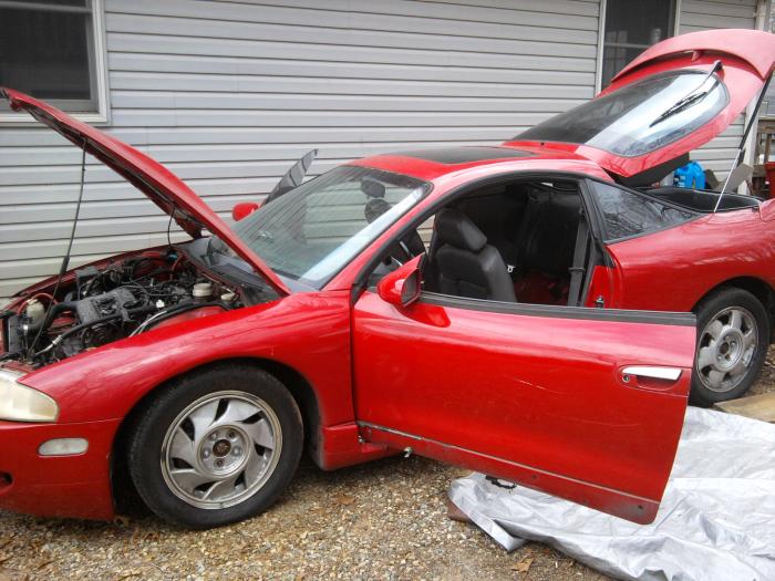

Didn't get too far today. Was only able to move her to a clean area in my driveway, organize some tools and throw away most of the trash in the car. Did start to dismantle a few things. It started to rain so I had to cover her up and call it a day.

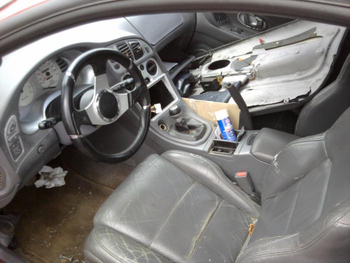

Have more pictures here, having trouble getting the seat bolts out. Wondering if there is a way to access them from underneath. I briefly looked and could only see a floor pan where the bolts would be. Also, the shock mount seems to be mounted off camber to the king pin seat. Is that normal? Noticed a crack in the passenger side strut tower. :ohdamn: Opened up the fuel pump access plate, no rust. :hellyeah:

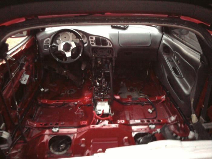

Edit: Got the passenger seat out. The drivers side is proving to be more of a challenge... Found some sort of plug on the passenger side floor, it almost looks like an old school main board connector. Might be from the ABS? Pans are in great shape. So freaking relieved.

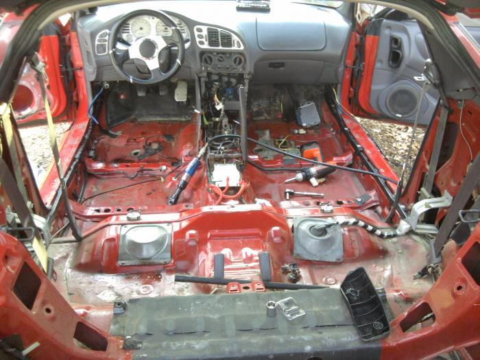

Removed most of the paneling
Removed the seats
Removed (trashed) the carpet
Cleaned out most of the loose gunk with a Dyson
Removed rear low riser
Removed mouse nest in the windshield cowl
Removed the metal panels that the ABS controller mounts to
Removed at least 20+ pounds of stereo wiring
So far, pretty happy with the condition. Only one small rust spot near the rear windshield washer reservoir. Shouldn't be too difficult to patch up. Any suggestions on what to use?
Hopefully sometime tomorrow I will be removing the sound baffling material, the rest of the sub box that's glued into the spare tire hole, and the rest of the old stereo wiring. Lucky for me, the baffling **** is hardened so i can just break it apart.

good luck with it! As for the plug on the passengers side, was it under the seat? do you have pics of the plug?
Most likely the plug is for the stock amp, I have one in my 98 gst should be the same.
@tom_and_case
In the picture above, its right underneath the cordless drill
@manny402
Its a MOMO
@1998dsm
I believe you may be correct

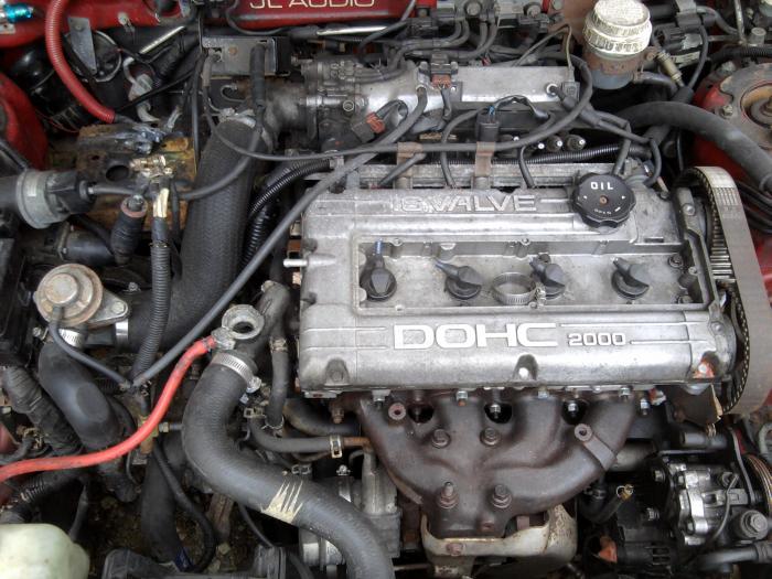

Removed the exhaust manifold and valve cover

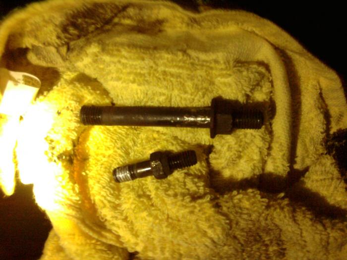

Discovered 2 broken/stripped studs. :tease:One just pulled right out, the other is still sticking out partially, so I might get lucky and just be able to back it out with my pliers. May have to re-tap at least one where the mani bolts to the turbo. Didn't feel any play in the lifters/cams. The lifters/springs look new. The cams are definitely not.
Pictures; Sorry for the bad lighting, it was dark. Comments welcomed :thumb:

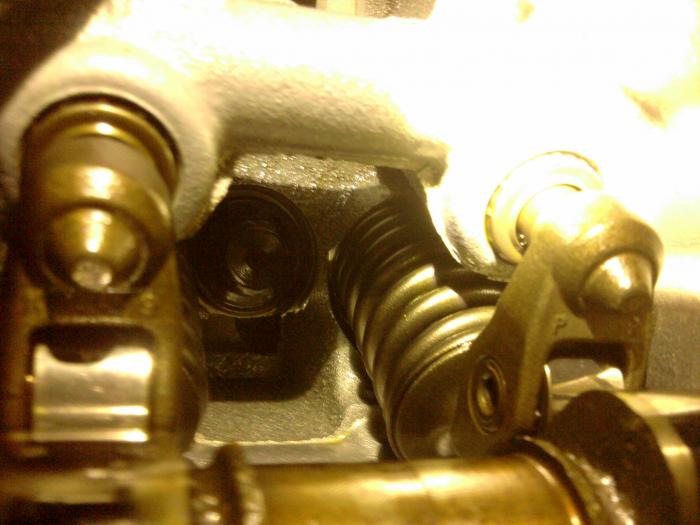

So, what did I find? I found 1 piston with damage. It looks like it made contact with one of the valves. I'm not sure why this happened, probably a timing issue. Its almost like something was left in the cylinder like a bolt or something when someone replaced the head, they fixed that and then it piston slapped. It has the perfect indentation of a valve, and then it has some substantial scoring. That or a valve broke, and was replaced with the piston still humped up. The four valves for that piston were different than all the others. That's my best guess.:aha:
The only damage I could see was the piston head, had a small nick near the valve seats. Cylinder walls were not damaged! The head looks like it has maybe 5k miles on it. The piston heads are also very clean for a 95? Maybe it was rebuilt at some point.
Educated opinions welcomed. :hmm:
Things don't look to bad except for the piston head where the valves hit. I would do things right and go ahead and send the head to the machine shop, and i would replace the pistons as well. Idk if there something you can do to that one piston where the valves hit, without replacing.
