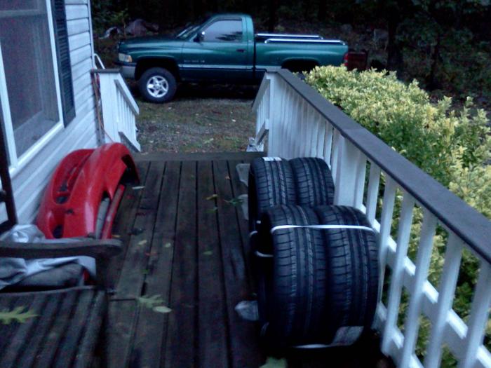

Black rims... White is for rice
Really? I thought red and white were Mitsubishi colors? Ah well, I was leaning towards black any ways. :hmm:

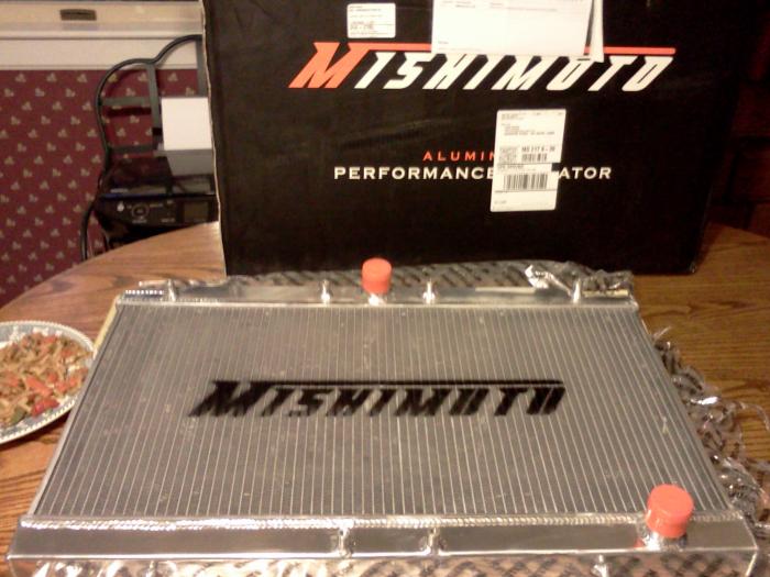

Anyone run the mishi performance rad? If its a capable rad for daily driver Ill prob go with it.
First start deadline is looming. :|
Tires and radiator :hellyeah:
Looking good!
Is that the 2core or XLine radiator?
Ended up going with the performance line. I figure if it works as well as, or better than the stock rad I should be fine. Long term performance goals are modest. I'm shooting for a reliable (as reliable as a DSM can be) daily driver that is somewhat fuel efficient, easy on the eyes and fun to drive.

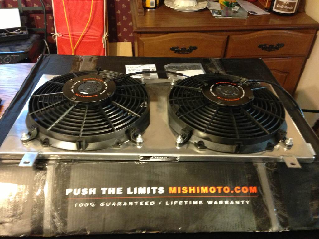

Ordered the mishi fan shroud assembly, Injen intake, some glowshift gauges w/adapter, ss valve cover hardware, water pump pulley, and a dipstick.

Installed turbo, intake, radiator, oil pressure adapter & slim fans/shroud. Also fixed some wiring issues. Just waiting on the FMIC which will be installed this week if I have time. Looking like a first start might be a possibility next weekend. :D
