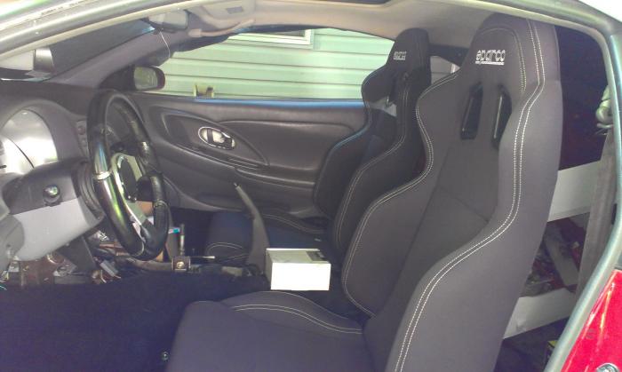

Sparco seats (black) and rails

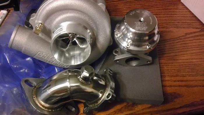

TiAL wastegate (10 psi spring, hint hint...)
Some other misc. parts NGK 7's etc.
And last but definitely not least, a new Precision 3431E turbo. :D

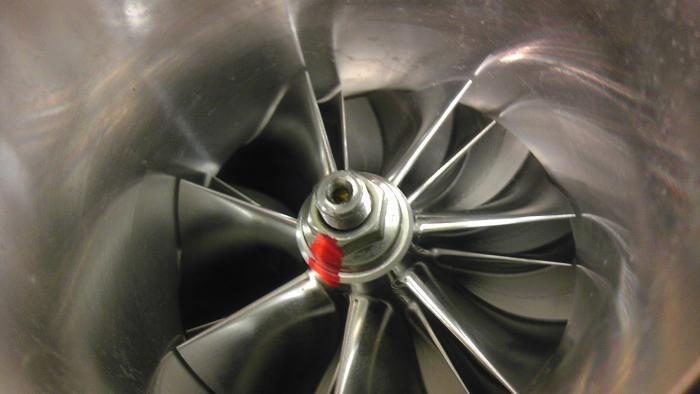

Decided to upgrade the PTE at the last minute. Went with the 5976E. This one has the billet wheel :hellyeah: 620hp? :shhh:

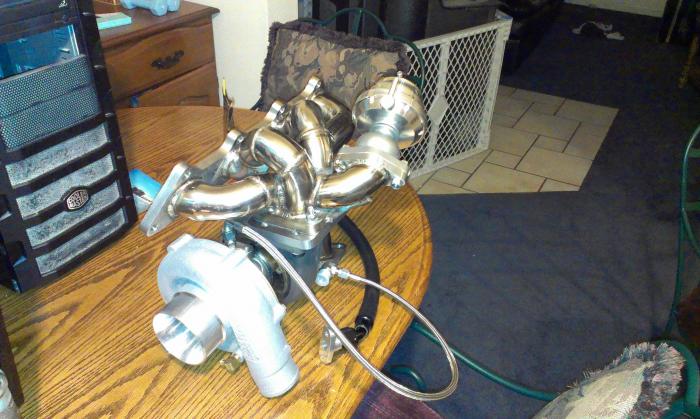

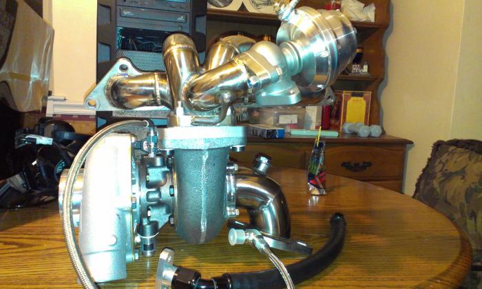

Finally got all my hardware together and was able to assemble/mock up the turbo. Everything looks and fits pretty well. Hopefully I can get her back together soon. :hellyeah:
Busted my ass this weekend. Pulled block & trans, installed new clutch and dropped block and trans back in. Installed cruise delete cable, which was nice because it wasn't a PITA. Finished installing seats. Weather permitting I think I can button up the new head and turbo install next weekend. Hopefully I have all the wiring mess sorted. Next major upgrade will be ECMLink. :hellyeah:

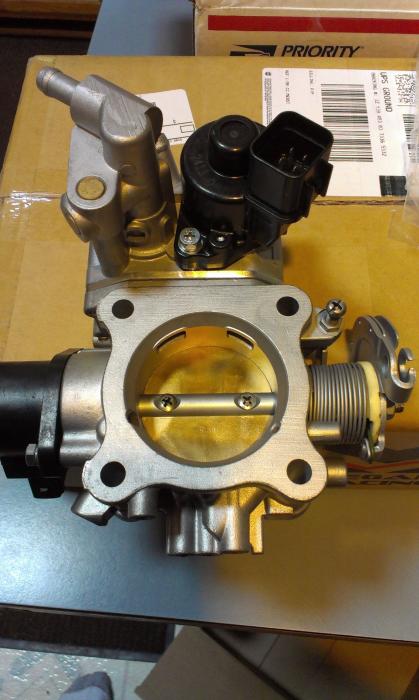

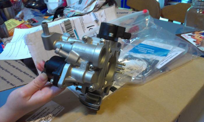

Throttle back from Throttlebodys.com

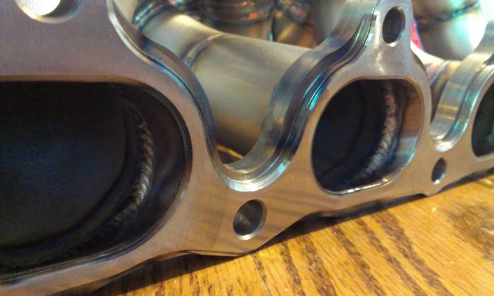

Last night in the middle of my head swap I had a chance to inspect the intake manifold seal to my old head. Low and behold the gasket was the wrong size. This of course was creating a huge vacuum/boost leak and would explain, well pretty much everything... Each runner rim had a 1/4" black streak leading to the outer edge. WTF
I had gotten the gasket with the car originally and ASS-U-ME-d that it was the correct size and threw it on. Now that I look back, I remember looking at it thinking how odd it was that the gasket didn't line up with the runner inlets completely but still lined up with the bolt holes. Wow, just wow...:sosad::banghead:

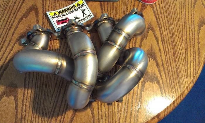

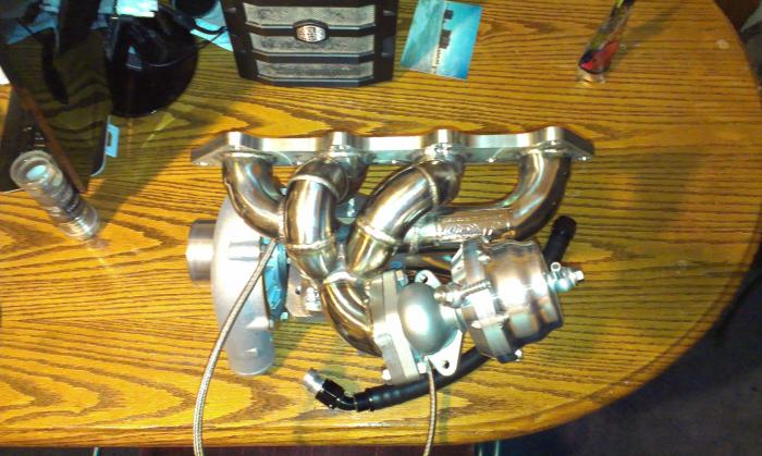

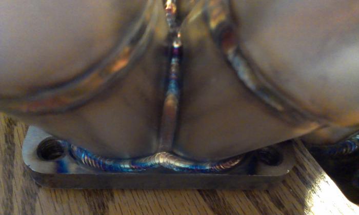

I attempted to mount my exhaust manifold/turbo the other day and ran into a fitment issue. The center housing comes into contact with the block where the front balance shaft bulge is. Of course, it was because of a single piece flange adapter I used that pushed the turbo half an inch too far down. Thats what I get for trying to piece together a stock manifold flange to a t3...
So I broke down and shelled out for a quality piece from Punishment Racing. Think I got the last one they were offering on sale. This should solve the fitment issue.
Still waiting on this manifold from PR. Waiting on this thing for almost 4 weeks now :cry:

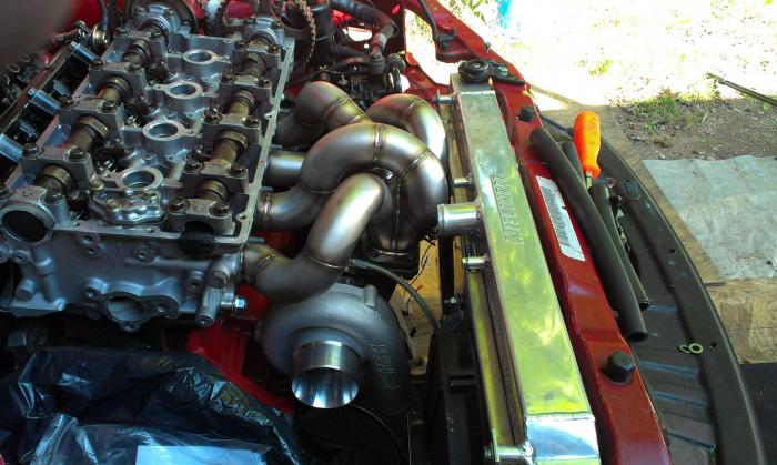

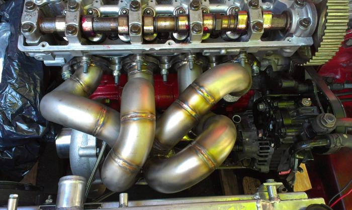

Manifold arrived today. Holy **** this thing is amazing. :hellyeah:

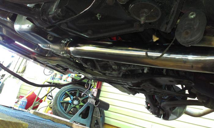

Everything fit pretty well minus one radiator fan. I may try and mount it to push from the front. Finished getting the belts on and the exhaust mounted. Still need to finish wiring up everything. Down pipe is close (not touching) to my oil filter. I will probably change over to the smaller filters, or ditch the sandwich adapter and run my oil pressure line off of the OFH somewhere. If all goes well tomorrow I may be able to take her out for the first time. Fingers crossed.
