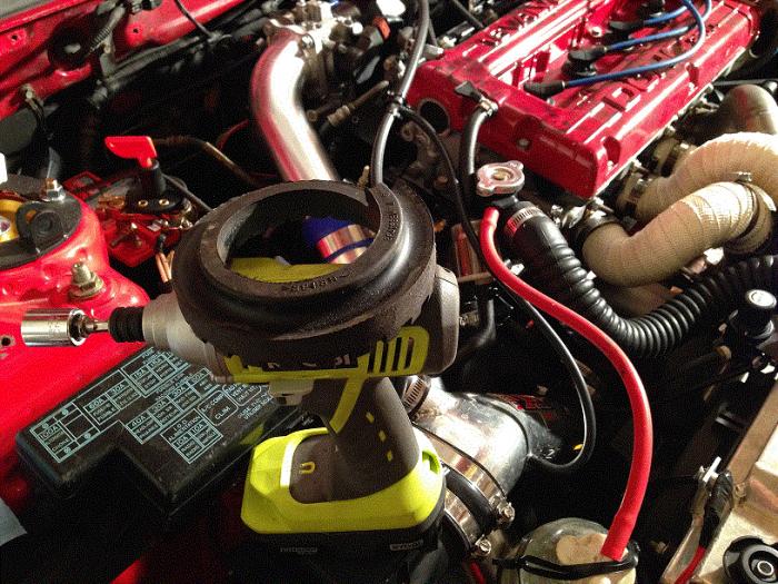

Was doing my shocks swap today & I may have missed something. It wasn't on the Tein directions so I didn't install it. Referring to the spring bushing.
Do you guys think it will be ok like this?
I think the suspension setup works fine without the bushing. The difference is like night and day, and that was only having done the fronts. Was really amazed at the handling difference compared to the blown out Tokicos.

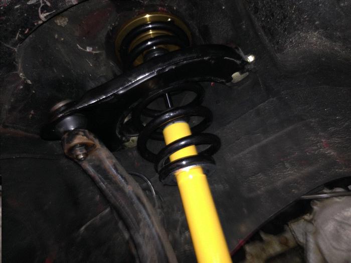

Got the rear shocks and upper control arms installed tonight. I tried to experiment with less shims but that did not turn out well. Although the ride is MUCH softer, there was a slight shimmy in the rear. Ill need to fix that this week hopefully. Also, threw in my turbo timer. Primarily because it has a voltage readout. Works great, getting 14.5+

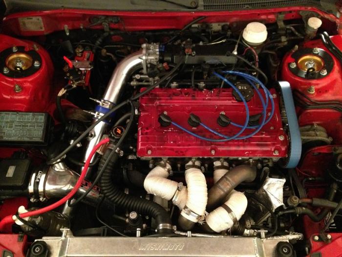

Looks good, what's the purpose of one exhaust runner without the wrap? Just ran out?
Thanks,
Was wondering if someone was going to point that out. The reason is because the stud on that runner has very small gap. I ripped up the first attempt and was going to add a shorter peice. But yeah, need more wrap.

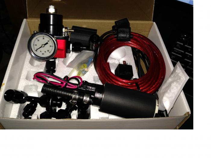

Sh*ts gonna get real this weekend. :D Still waiting on some AN -6 steel braided nylon hose. I was considering a evo VIII pump and fpr to match the injectors, but after some considerations on possible future upgrades I figured wth just get something that you can grow into if need be. Adjustable fpr with a wally 255. :hellyeah:

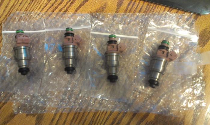

Installed the fuel pump, injectors and AFPR yesterday. Didn't finish in time to be able to start it so I had to wait till today. Had everything done except setting the base pressure with the the fp hot wire in the engine bay. Made a switch so I could avoid any possible fires :/
I got lucky, not one single leak. I set my base pressure to about 42 psi, tightened the set bolt and crossed my fingers. Cranked it over and it fired right up without issue.
Edit: Re-adjusted to 43.5 base.
The idle is actually better than before. I probably had some really dirty injectors that were in need of replacing/cleaning. My idle A/F held steady at about 14.7
The only thing I am unsure of is the pressure loss after turning it off. The needle goes to zero about 20-ish min after shutting down. Not sure how or if I can fix that.
Pretty happy with my first fp rewire/upgrade, no issues so far. :hellyeah:

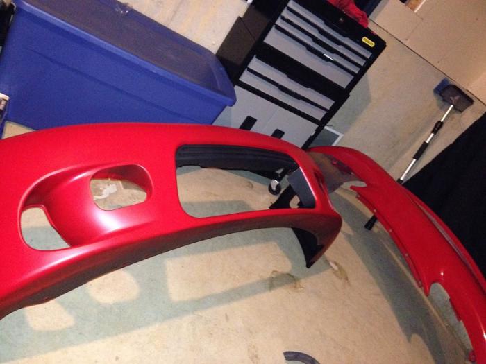

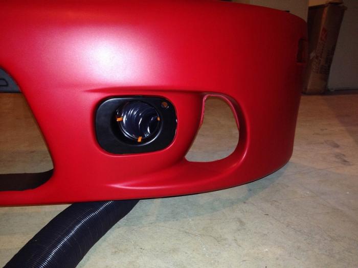

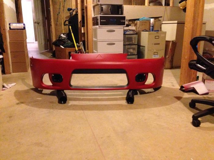

Getting ready to slap some paint on this bumper. I am trying some code matched color from AutomotiveTouchup.com. Hoping it turns out better than the duplicolor.
Ill throw some pics up for you guys after the first coat or two.
EDIT:

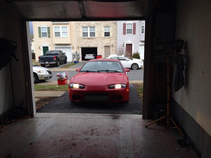

Still have some trimming to do on the bumper for the fmic clearance, and need to figure out what goes in the bigger spaces. I think there are trim pieces that go with the bumper that are suppose to go in the bigger duct holes. Overall I am happy with the paint. Could have used another coat but not really worried because I plan on doing a respray eventually. Also got some shots of the cooling ducts I rigged up. One is going to be fed to the oil cooler and the other is going to feed up into the air intake through that circular hole into a cold air box I am going to fab up. She did not like sitting in the rain, blinker fuse keeps frying all of a sudden. Waiting till it dries off to see if its a short caused by all the rainwater. :ohdamn:
EDIT: Blinker fuses blowing was caused from a passenger side bulb that was blown. Not water related/fixed.

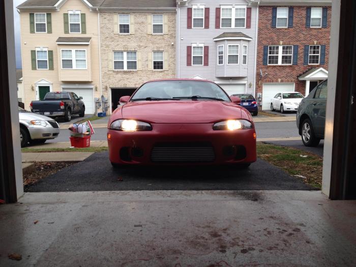

never seen anyone use the fog light holes like that! but, dang, that paint is nice!
wow love this build will read entirely soon haha. Looks so clean.
Thanks guys.
