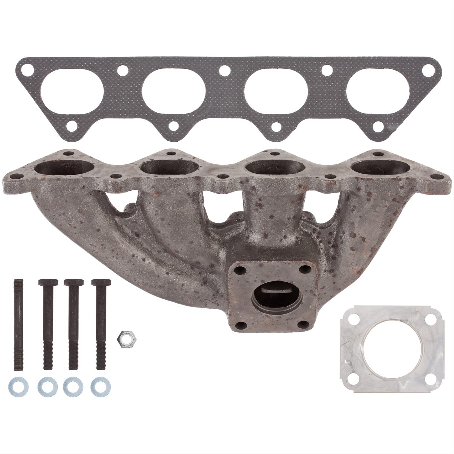

Found this on Summit's site. ATP looks like OEM replacement, anyone have any experience with this brand?
The Dorman casting is similar to the 1G, which is less desirable than the 2G or EVO3 The reviews I read were not altogether great. On the one hand, it’s new so it shouldn’t be cracked and ought to work well. On the other hand, the casting doesn’t lend itself to a super long life.
The ATP part number needed is 101138 for TD05 turbos (not the TD04 turbo from the 1G automatics, which is what you linked) and is unavailable everywhere as far as I am aware - and I looked for months. Neither the 2G or EVO3 manifolds are available, either.
