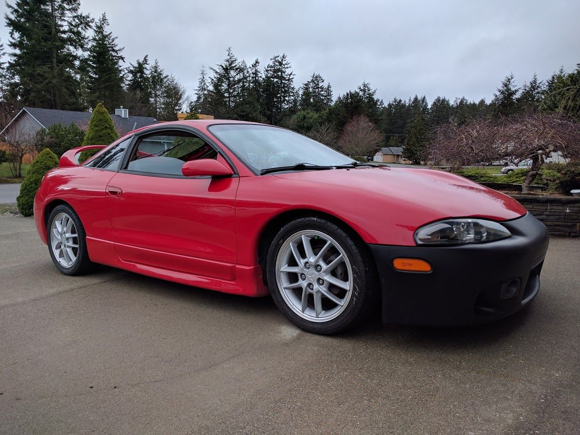

I picked up this 1998 Eclipse GS-T from a friend, it runs pretty well overall and looks good from 15ft away.
This is my 4th turbo DSM (first was back in 2001 I think), and it will be my last, it's going to be a slow "forever project" that I work on with my kids and keep forever. Once it's up and running, it will maybe get driven 2000-3000 miles per year, probably not even that though, just a fun and affordable garage queen that gets driven on some weekends and special occasions.

The car as it was the day I bought it (looks great in pictures other than the mismatched bumper!)

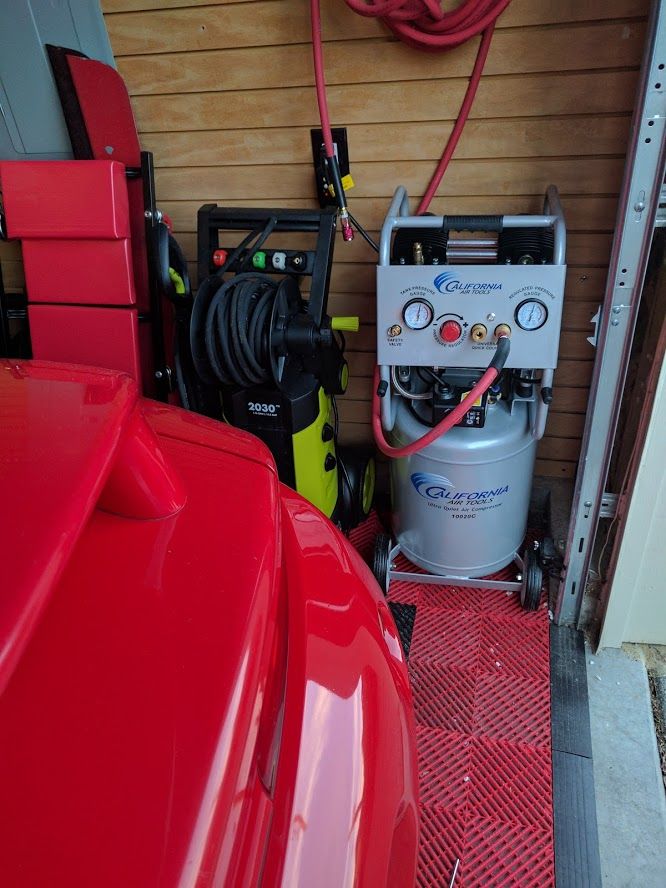

My painting equipment is low-level hobbyist stuff. I live in a subdivision and I don't want to bother my neighbors with a loud compressor, so I got a California Air Tools 2hp 10gal compressor. 10gal is too small to paint the whole car at once, so I'll be removing most body components to paint them off the car.
z9Hv04PuUFNrHVYEvhbcQMHC-kBHwkT0Q-xz1x0AszfWK_XsisF3jnKul0i15gqC-KHkcpuWqjwaF8NgtFn=w667-h888-no.jpg
I've ordered the guns and paint from TCP Global, a gallon of Saronno Red paint, gallon of clear, etc. The price is right at about $300 for all the supplies. A set of three entry level guns that will match my low(ish) CFM output of my compressor (7ish CFM @ 30psi). Should be fine for learning, a gun for primer, base/clear, and a small gun for detail work (door jambs) all for $75 with accessories.

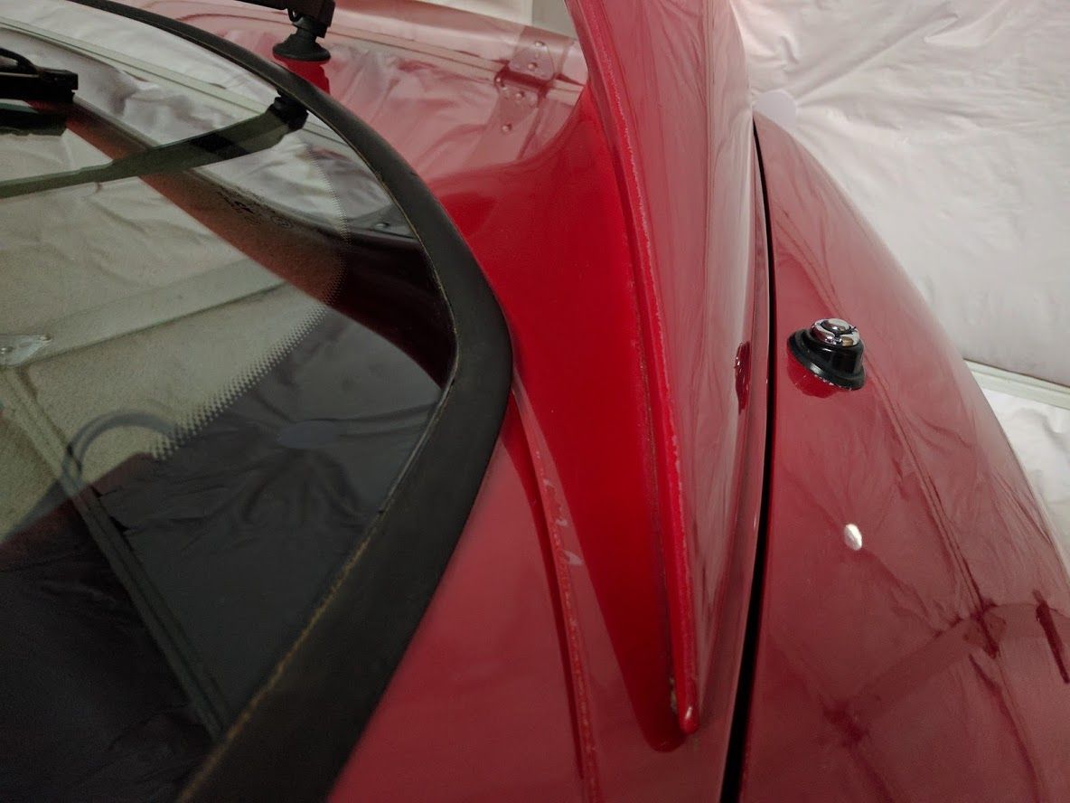

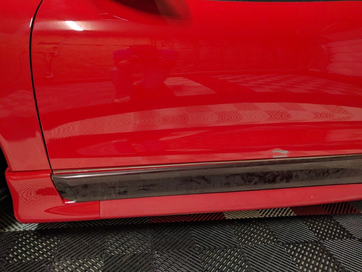

Pictures of some of the bad spots:
mxLkSX9xRjKdefn20SBMAtpJ8_koJWky1CHFVHQyrgt7hjUu9fBVrKYPXS5ErIGTMCsH-iZ19bFUDxBmqt=w1184-h888-no.jpg
EAZHcy18nxVRWh5rqEW014KLjOPtE5u8JhwBTwRR1Obhn7Oc85XQXbE2-rZdqfSPa_Uj9dky72wZTxZTXI=w1184-h888-no.jpg
The rest of the car is covered in chips and deep scratches, so it's going to be some work. Looking at a FRP OEM style hood this week from a local guy, if it doesn't need too much work I'll buy it for the weight reduction.

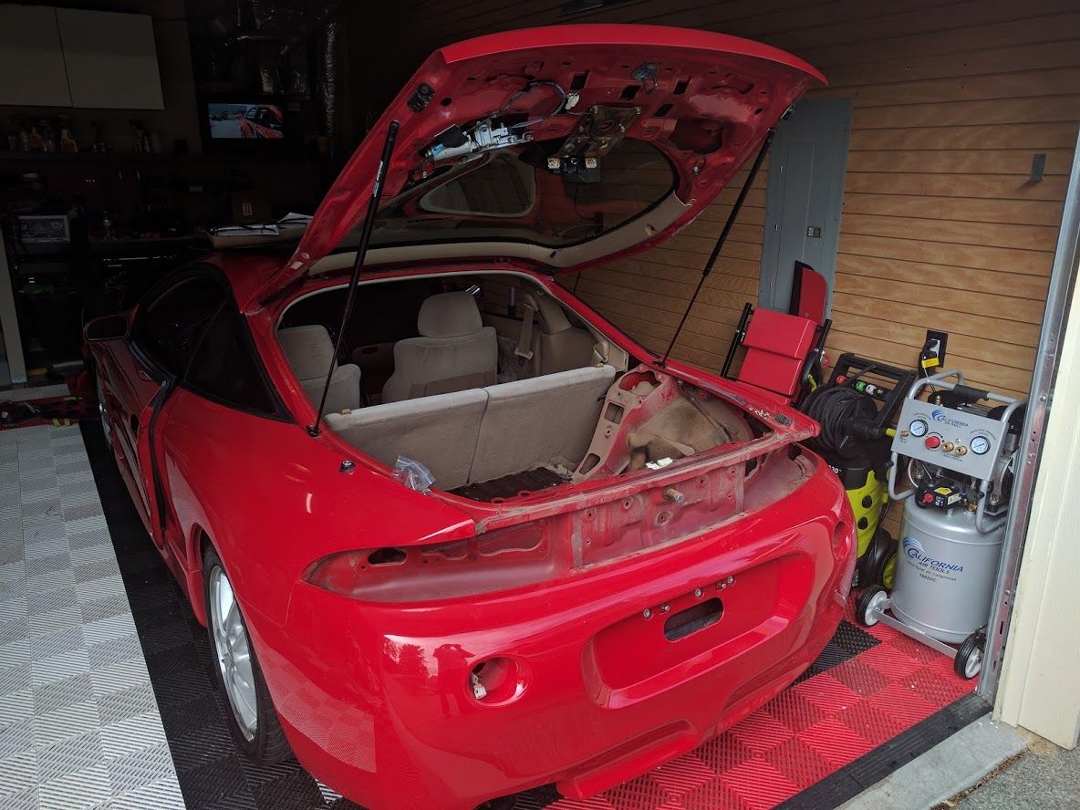

As the car sits now, got a lot of work ahead of me, but I'm excited for it:
3xCKsZRX_ICHBmOTN0zuqEgSf1L3RfREAqOSK1vl2iF4YJKhj225VIa3onsqMbeqB1gjPuJyRFNZzcuBr9=w1184-h888-no.jpg

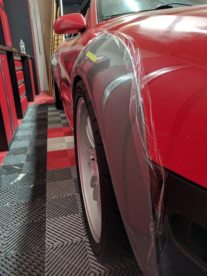

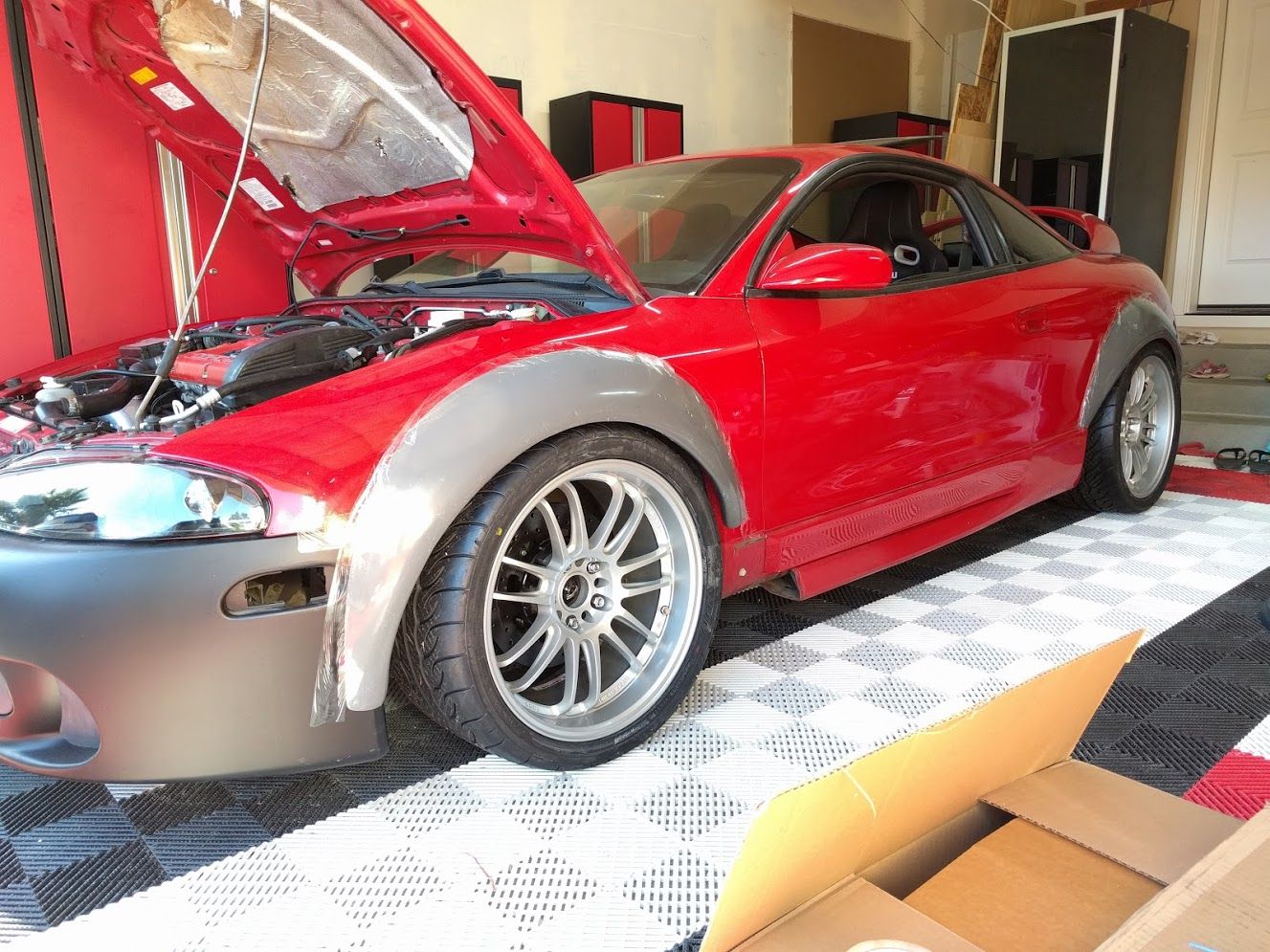

As things normally go with me, I've taken it above and beyond anything I originally intended. I see things that I like, find good deals occasionally, and go for it. These are the (infamous?) "Allen" fender flares mocked up on my car, along with 18x9.5 +15 Volk RE30. Neither were planned originally, but that's how things go I guess, I'm excited for my build even more now! Although I will be cutting the car up, it will be done right.
As it sits now, well, almost, I'm still playing with positioning the fender flares, I shifted the front one back and lower a little so it fits the wheels better:

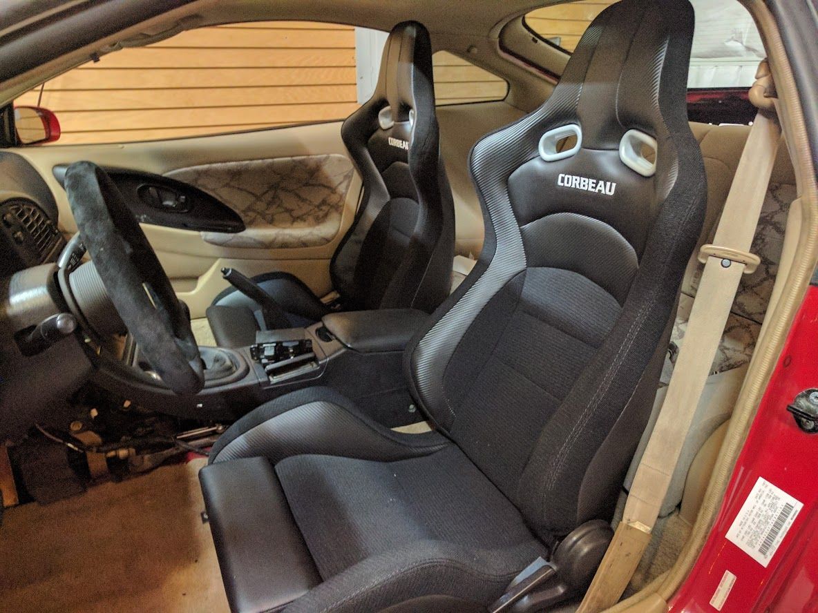

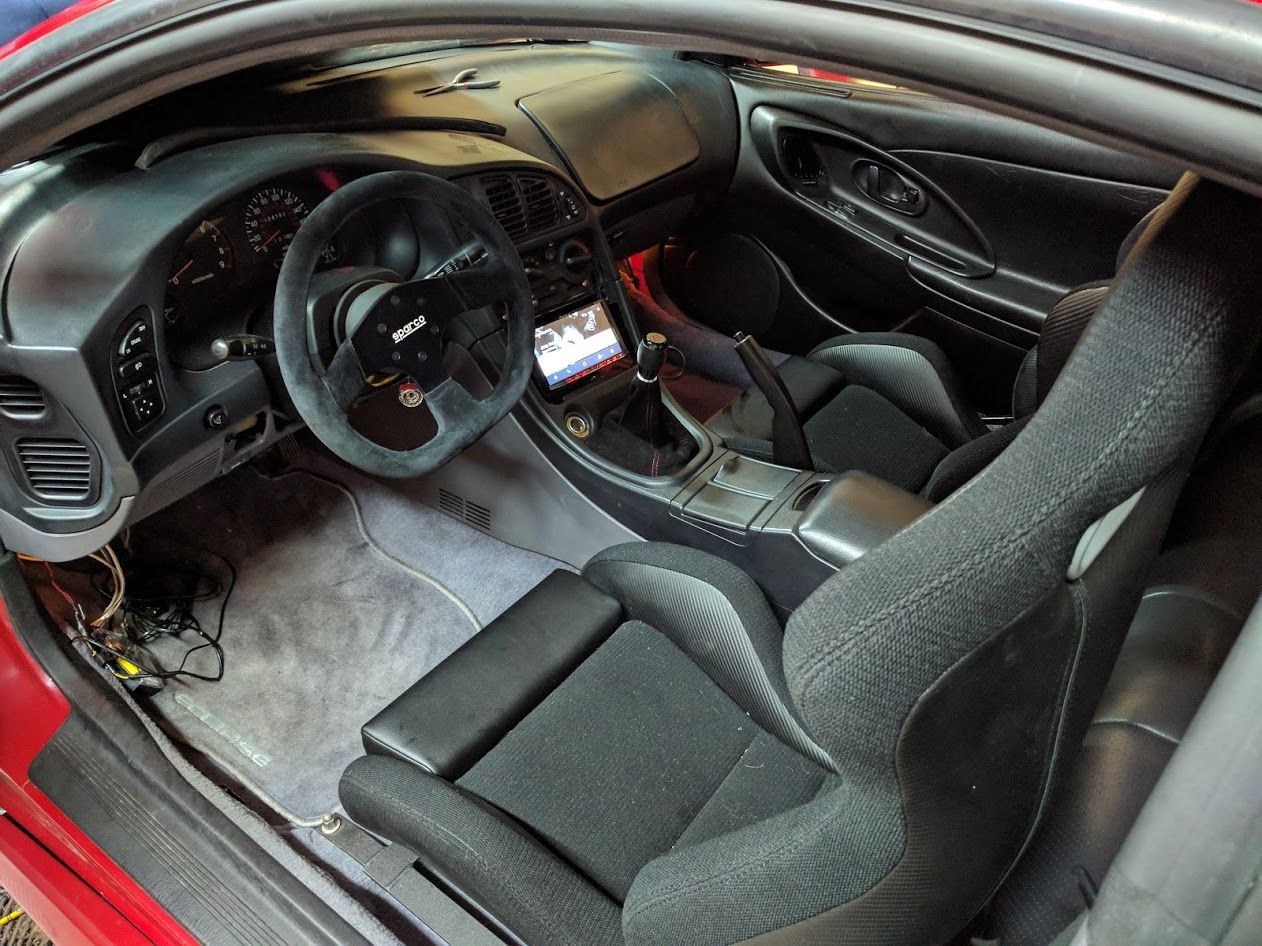

Corbeau RRX seats installed today (7/18/17). The seats are great, I gained about 1.5" of head room and a little leg room, which are both very welcome. The brackets, well, not so much. The way the seat is designed you have to install the seats onto the brackets and sliders, not unusual, but very difficult with this design. The outside rear bracket points inwards, under the seat, stupidly difficult to get the bolt in. On the driver's bracket it doesn't really matter, because it's a 1/4" off of the bolt hole anyways, no way to get it to line up. Will contact Corbeau for a replacement, for now I've got 3 of the 4 bolts in, but the car isn't being driven yet anyways. Also had to lightly persuade the front inside stud to move towards the back of the car a tiny bit to get it in the hole. Passenger side isn't installed yet, after the fiasco with the driver's side I was tired of messing with it, made sure all the holes lined up (they do!) and just set the seat in there, will get back to it later this week.
GA-d5WijVSX8z2Txynf01jh0vWsEiyol0amEDImKRnkzAG1736deBqLOGpJtp-FMEJ4l-3hdA_t6chi2fI=w1184-h888-no.jpg

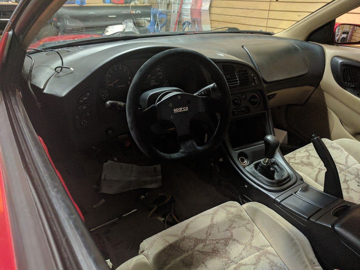

Steering wheel installed 7/17/17! Sparco R353. Will figure out a way to mount the cruise control switch and will wire a horn button somewhere. I love the size (330mm) and the flat bottom, gives much more room for my legs since I'm 6'3".
KF-A34CVvjGaHZm18ciPx5le0Qv6BSIQnoWNtWRNBmwLgNGp0kdTnBx-b-Ejw3nNrw8aSIXCxrMZmh9d_A=w1184-h888-no.jpg

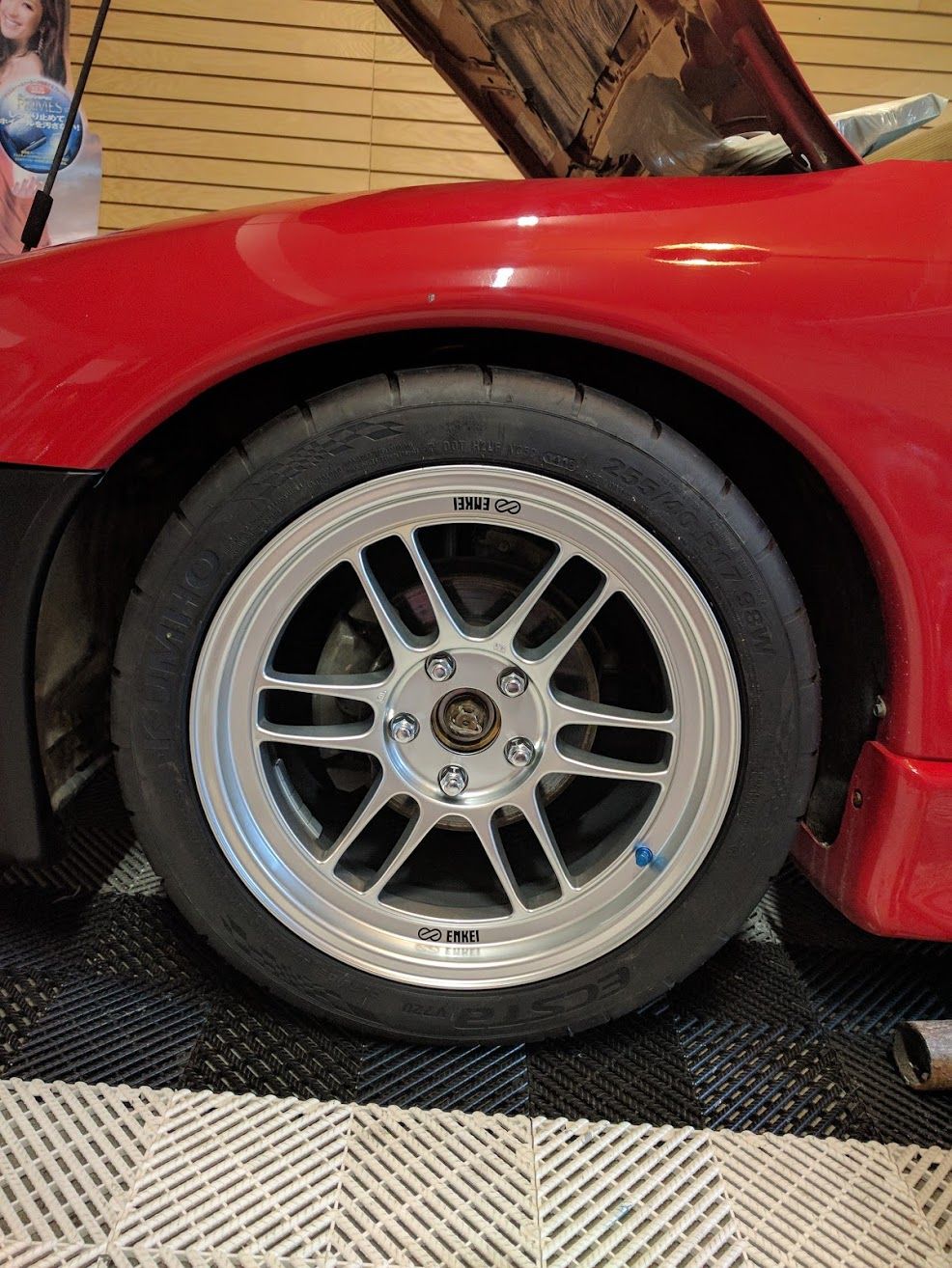

Wheels: Enkei RPF1 17x9 +45 (SOLD!)
Tires: Kumho Ecsta V720 255/40/17 (SOLD)
Suspension: Feal 441 Coilovers (off-the-shelf spring rate)
Will post better pictures once I get the coilovers in and installed. Maybe this weekend.

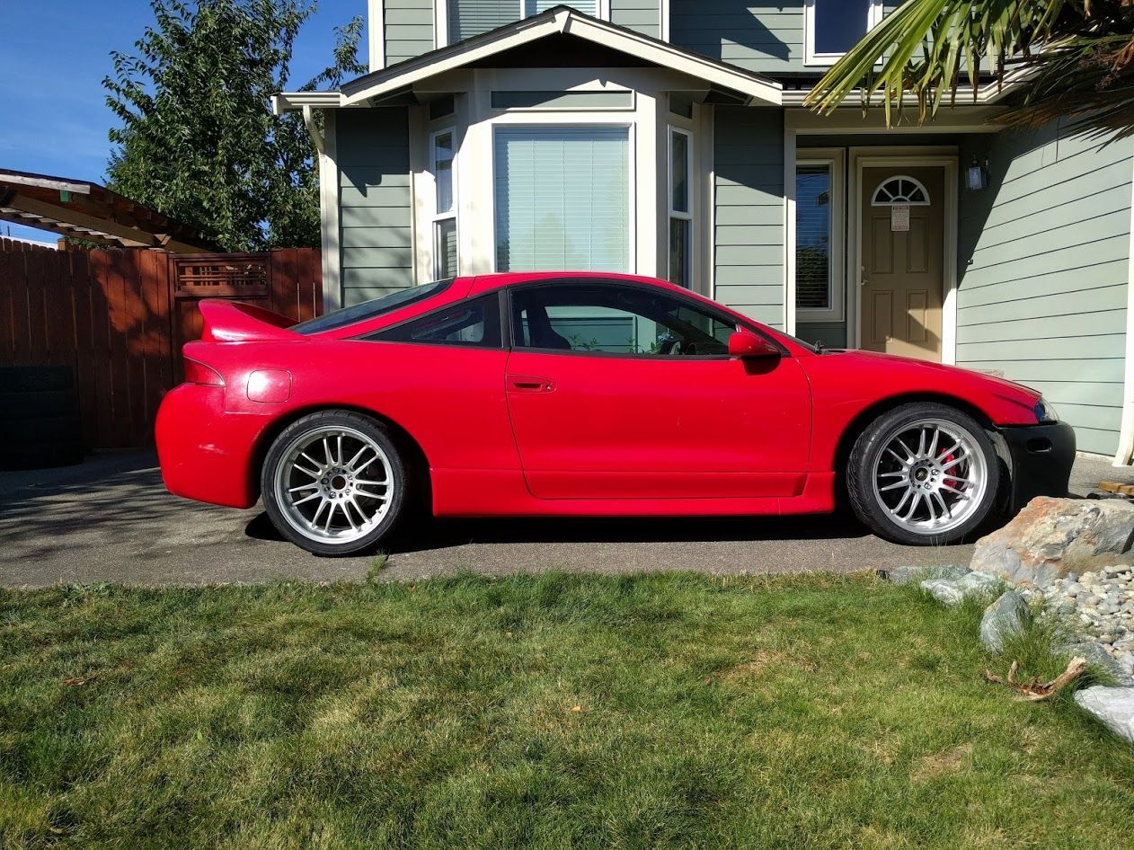

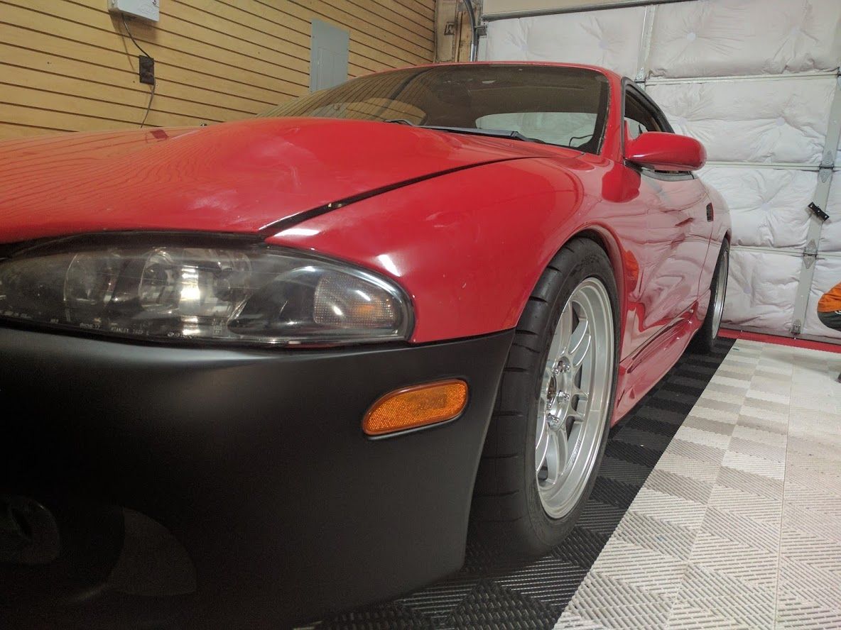

This is the car as it sits now, 9-10mm worth of spacing on the front, so effectively a +34 or +35, sticks out too far. Rear is +45, no spacer, exactly where I want it to be. Don't mind the ride height, the suspension on it currently is entirely too low and the car isn't being driven yet anyways.

No ride height shots yet, ran out of time today, here's a shot of the front though, I like this height.

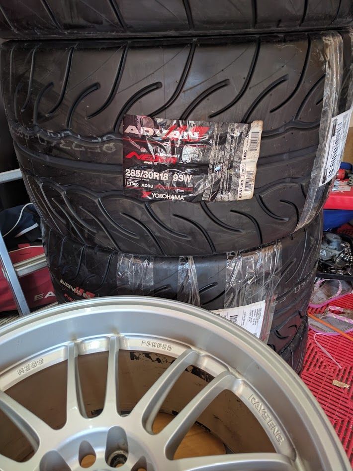

Found a great deal on my favorite wheels the Volk RE30 in 18x9.5 +15, and just by chance, Tire Rack had my favorite tires on clearance. The 285/30/18 is slightly wider and slightly shorter than I wanted, but they were on closeout for $208 each, I couldn't pass up the deal. Next tires will be a 275/35 for slightly better fitment on the wheels. But these have a very stiff sidewall, so the slight bulge shouldn't hurt handling too much.

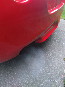

My exhaust smoke, happens once the car is warmed up and sits idling for a few minutes, smells like oil:
JvzX0SH5PV34sp_hkpijfE9tYRZ0LM-wE9sBZBPuVuLiW0J3rQrxjdWmOk_xtWTG4LqQeR-4Fo83aNU8dfj=w226-h301-no.jpg
smoke from the exhaust is most likely bad Turbo ..
I'm hoping not, but I guess if it is, no big deal. I'm going to try replacing the valve stem seals first, it's cheap and I've already got the tools to do it. If it is, I guess I'll just have to rebuild this 14b or grab a small 16g or something.
