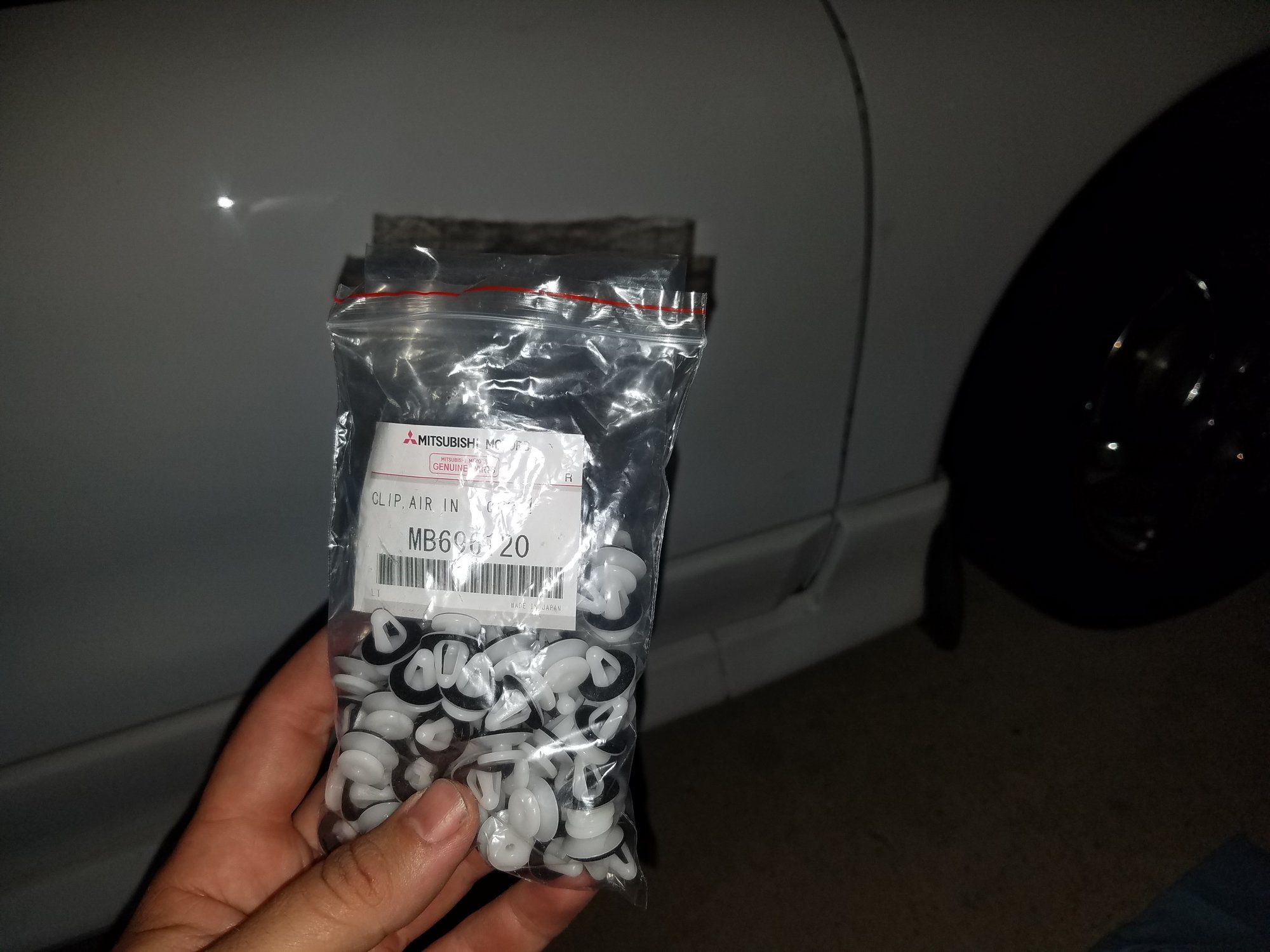

Replaced every side skirt clip on the car yesterday. Individually they are $2 on extreme psi, I found an eBay seller offering a pack of 100 for $8 shipped. They are identical to oem

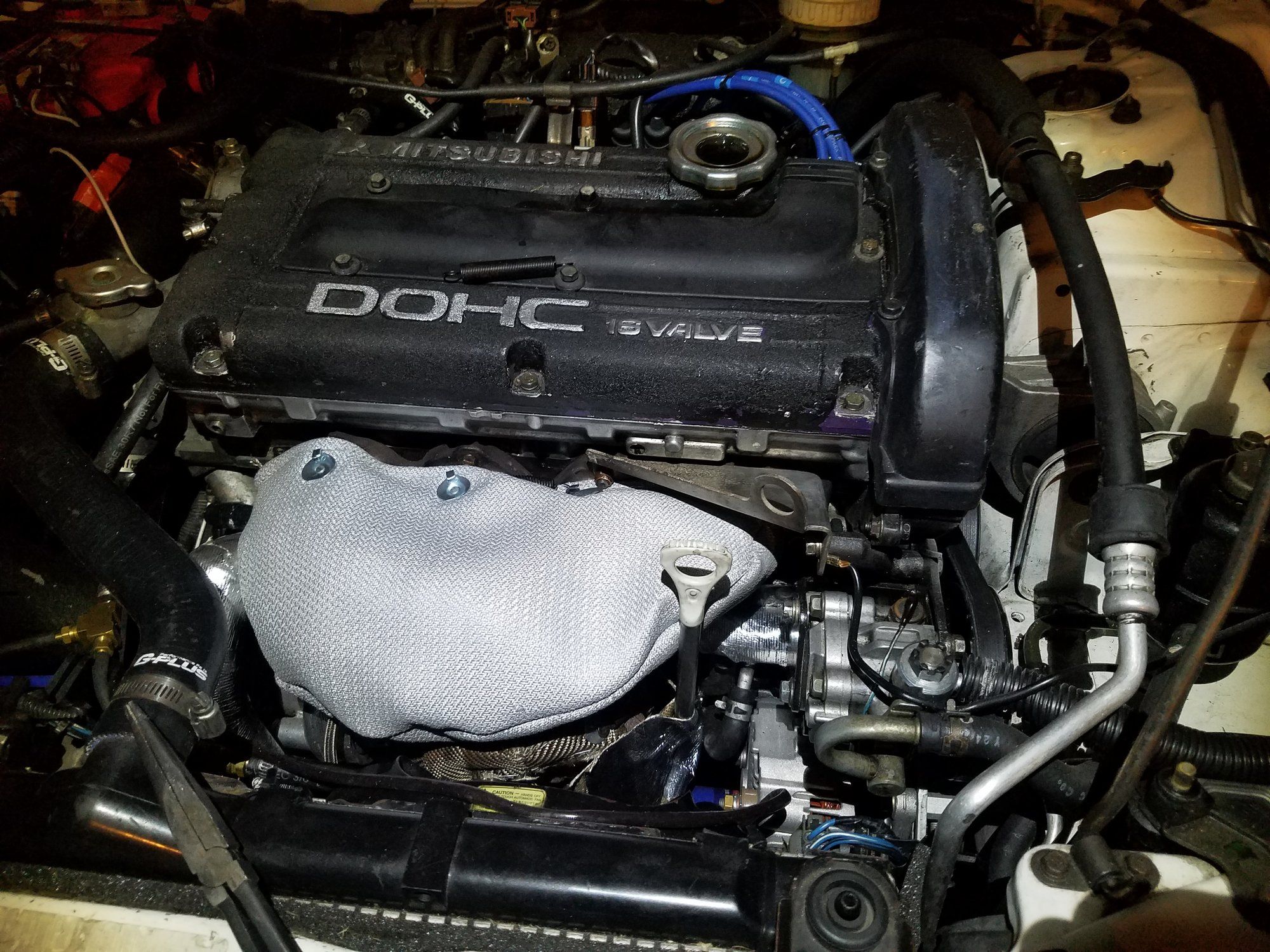

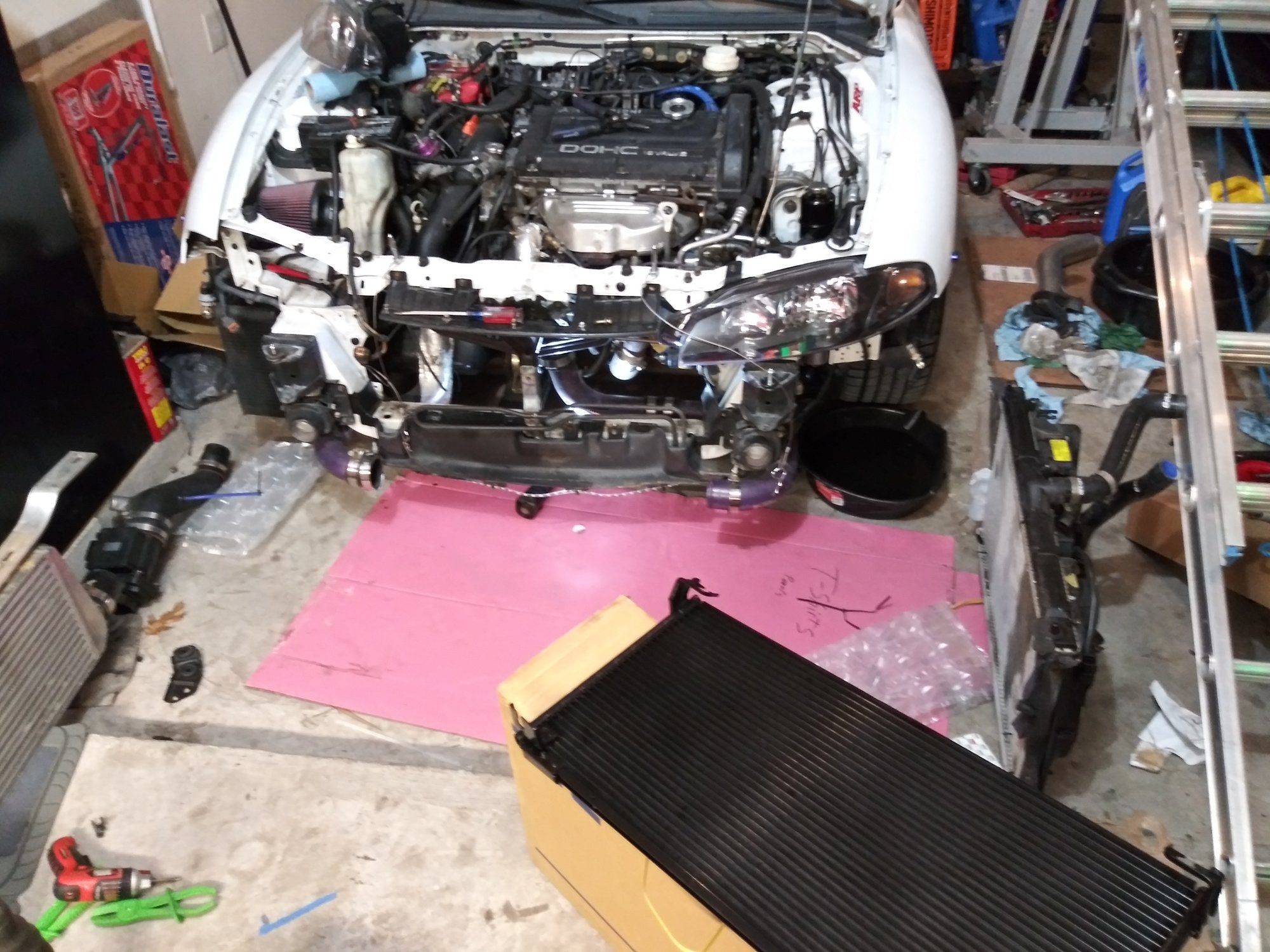

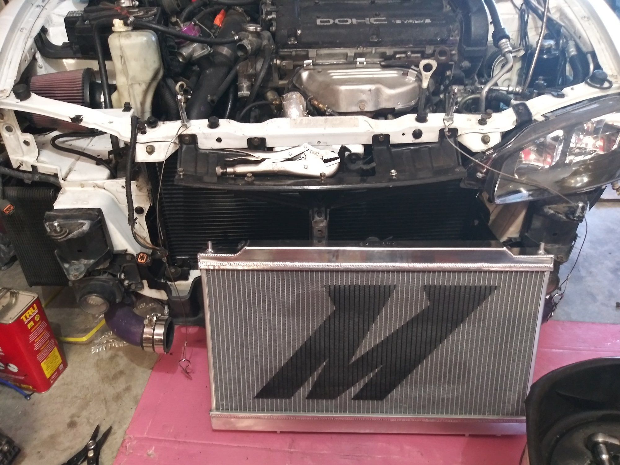

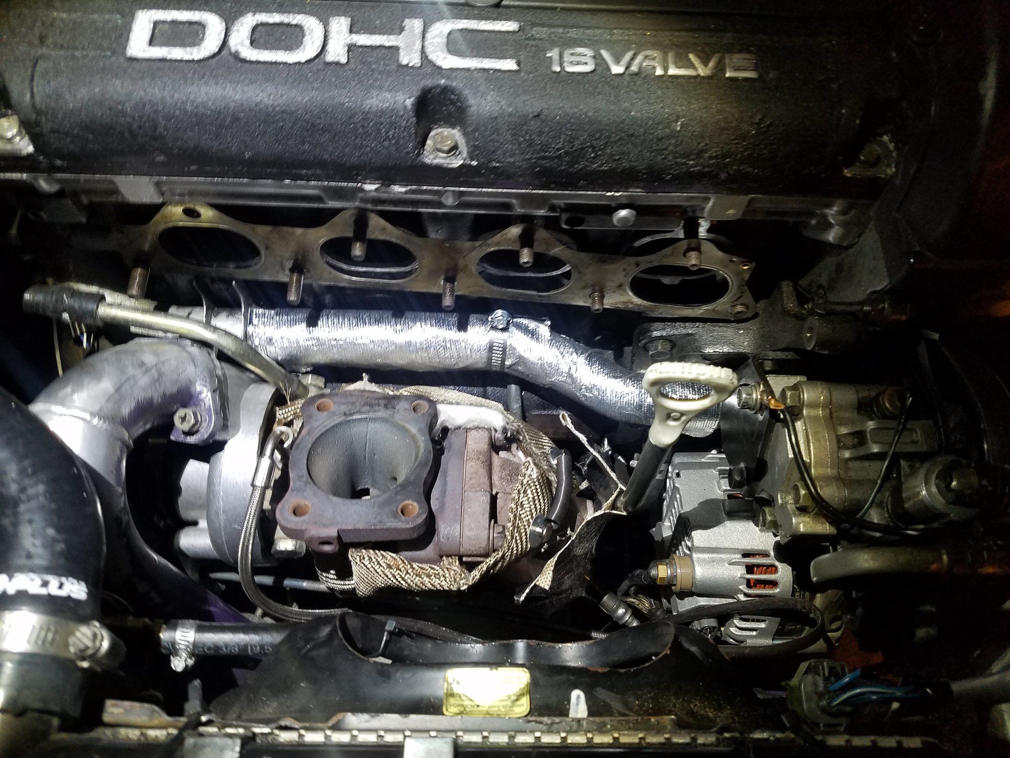

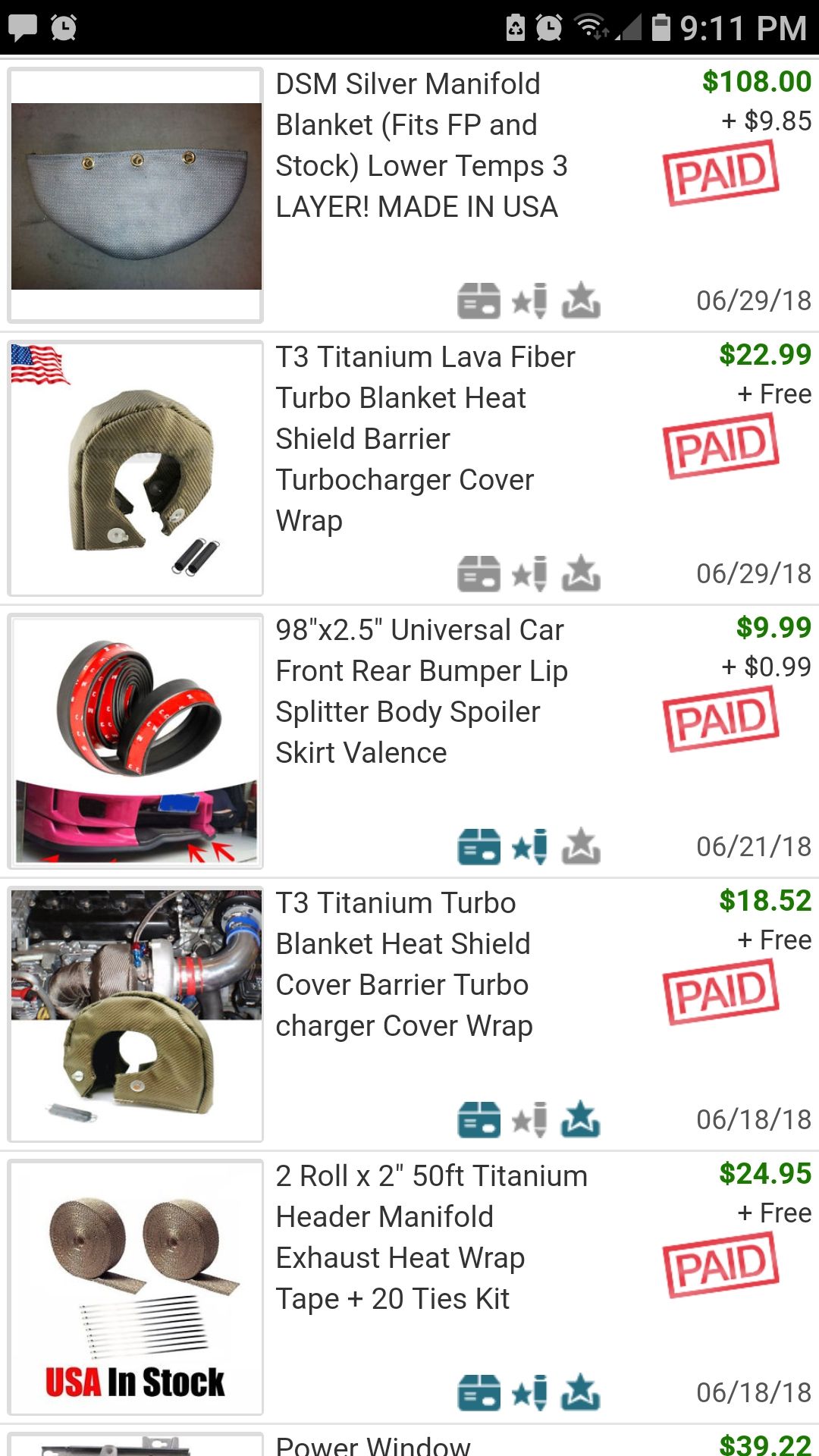

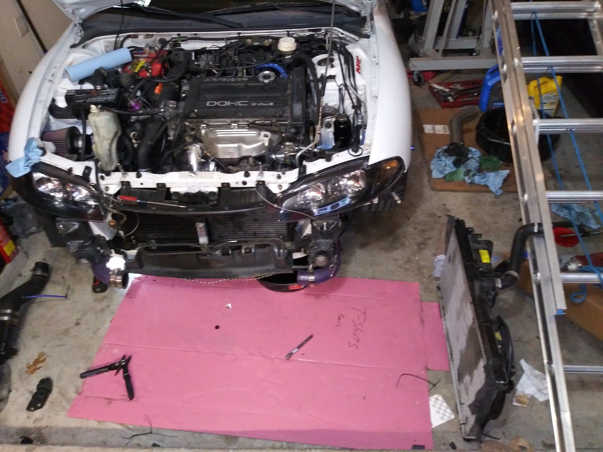

Eh it's still cycling the compressor a bit while I'm sitting in the car on lunch, so I've ordered a manifold blanket and another turbo blanket. Also went overkill on the heat wrap, I plan to wrap the hotside down to the flex pipe
I could half ass it and just make a cut above the intercooler for the condensor fan, but I haven't cut any corners yet so let's go with that theme. Also want to see if I can fit the factory heat sheild over the blanket. Want it to look factory

Got the first t3 blanket today, waiting on the manifold blanket and then I will be wrapping the 02 housing and downpipe.

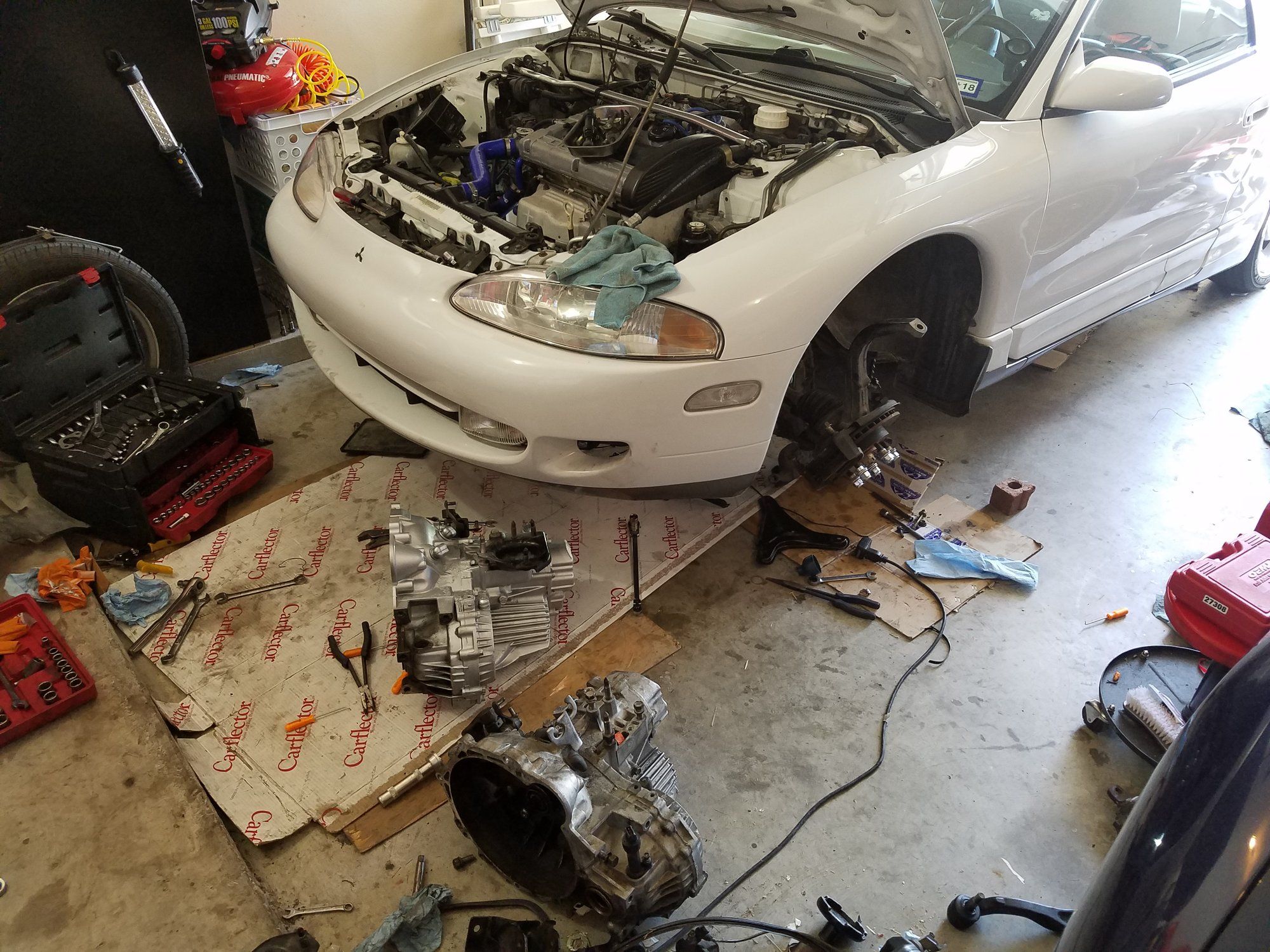

It's just dsm herpes rubbing off on you. The 96 is sitting in my garage with the transmission under it

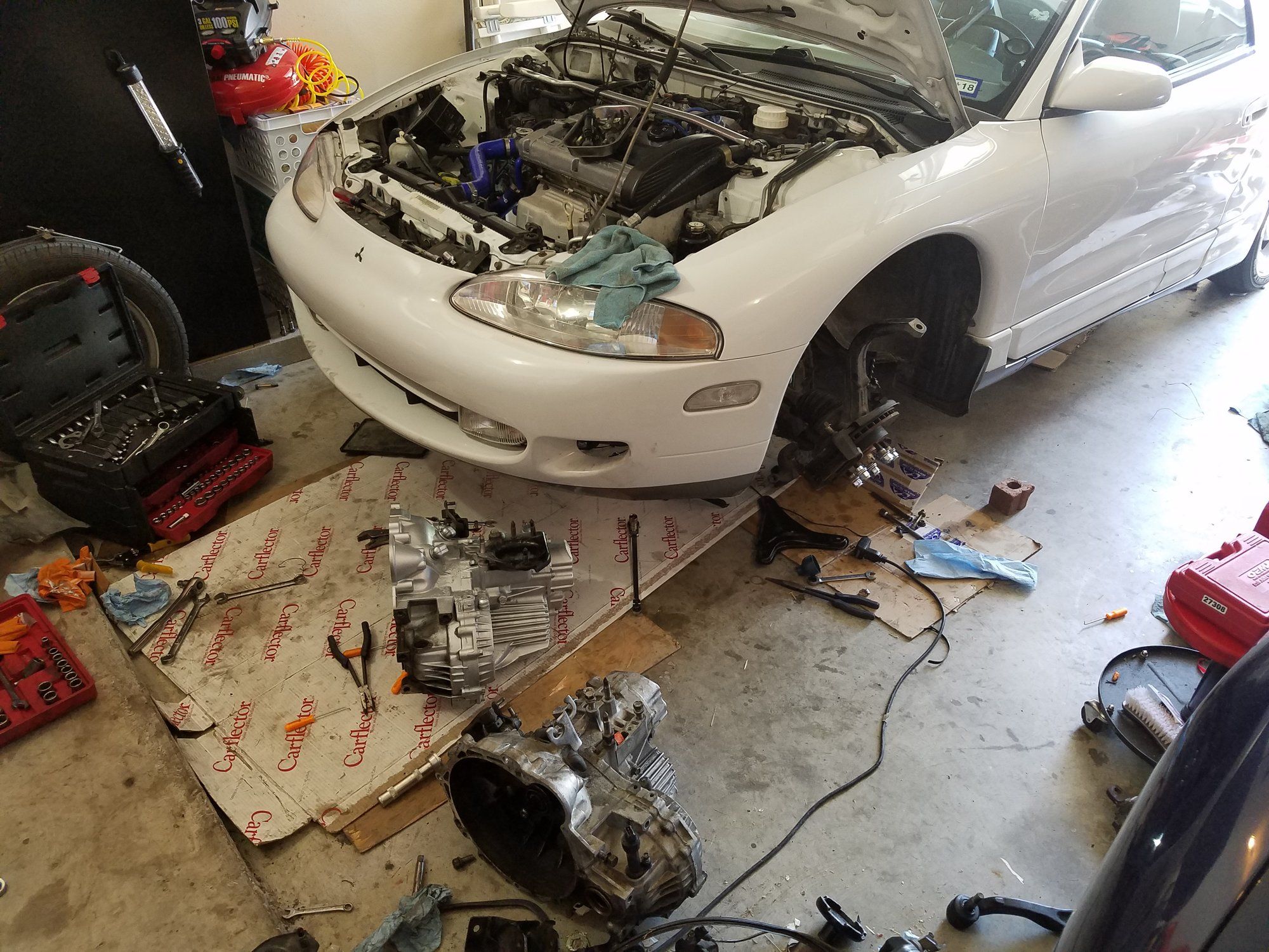

The trans went out at the same time as the steering rack, made my driveway look like a murder scene. And the new trans has a bad shift fork, I pulled it back out and promptly nearly lost a finger when the trans fell off the jack

Over kill mode engaged

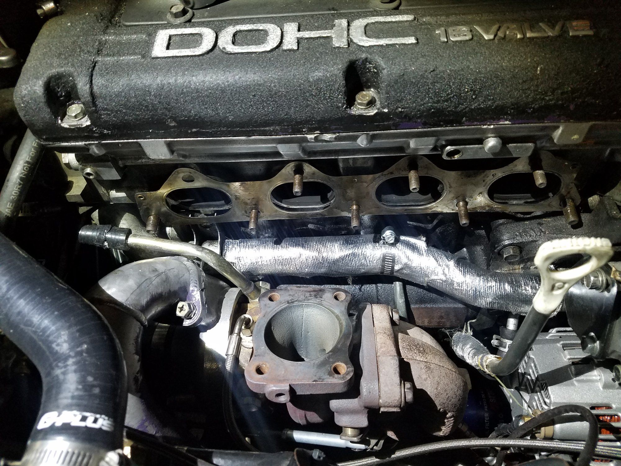

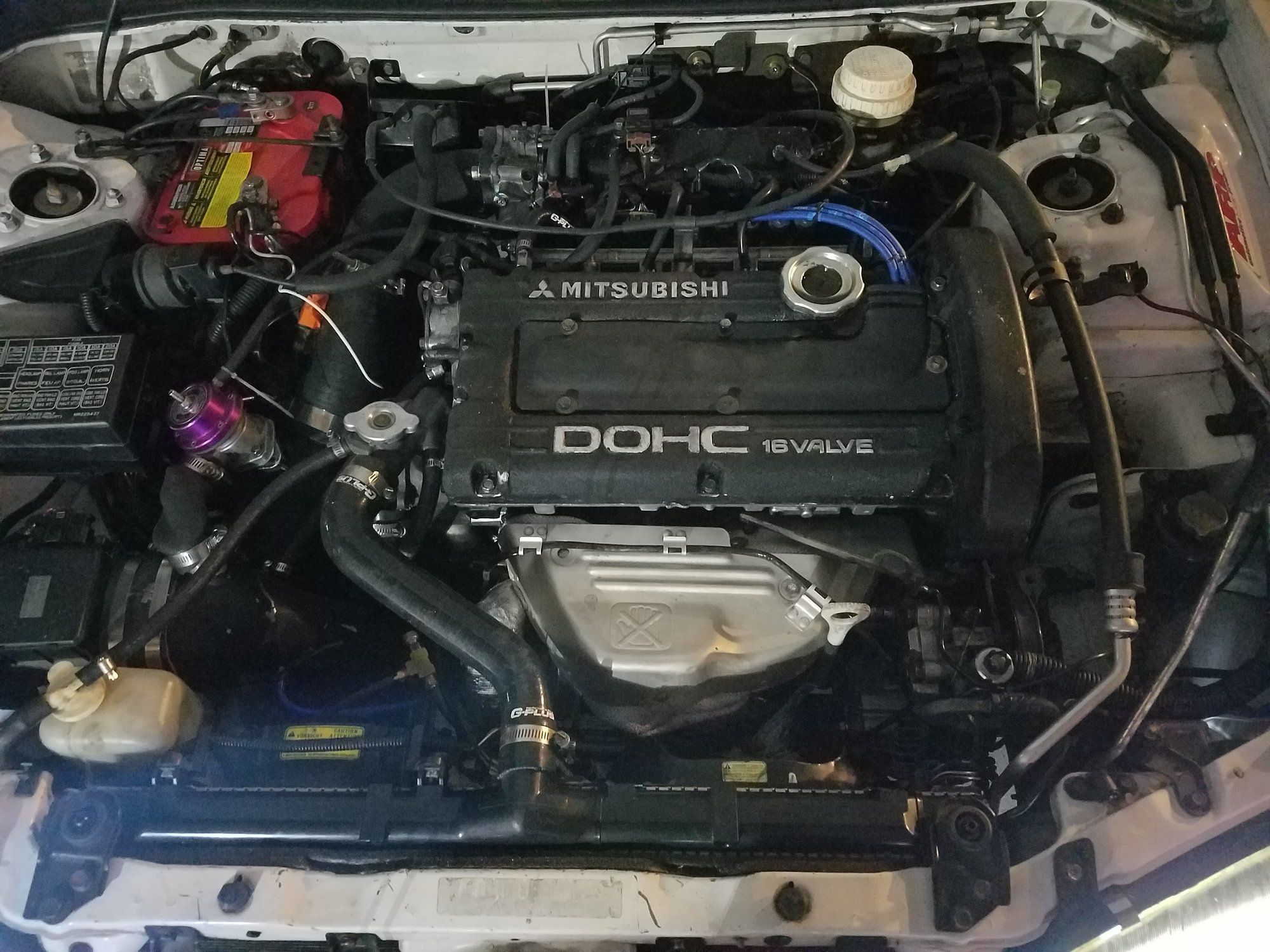

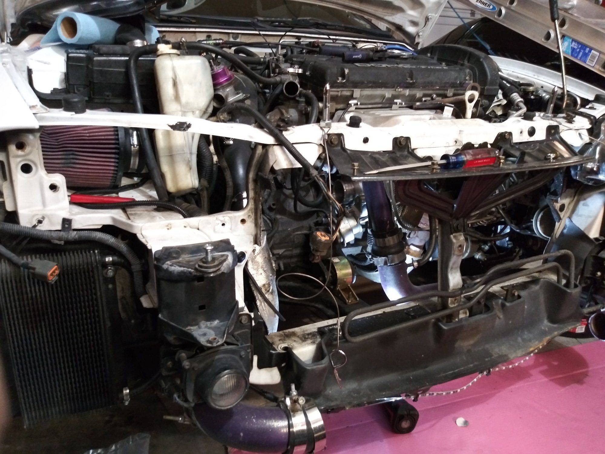

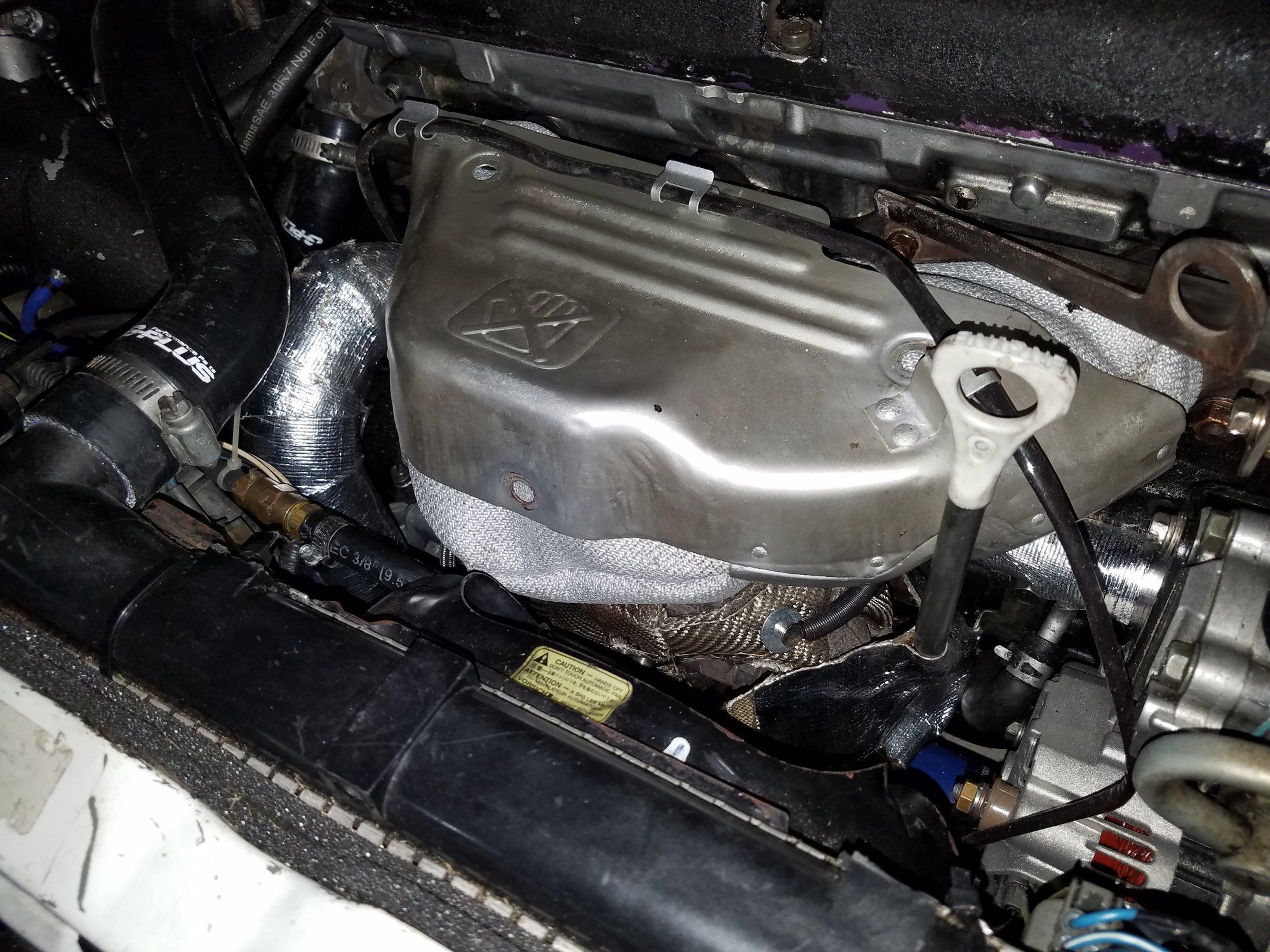

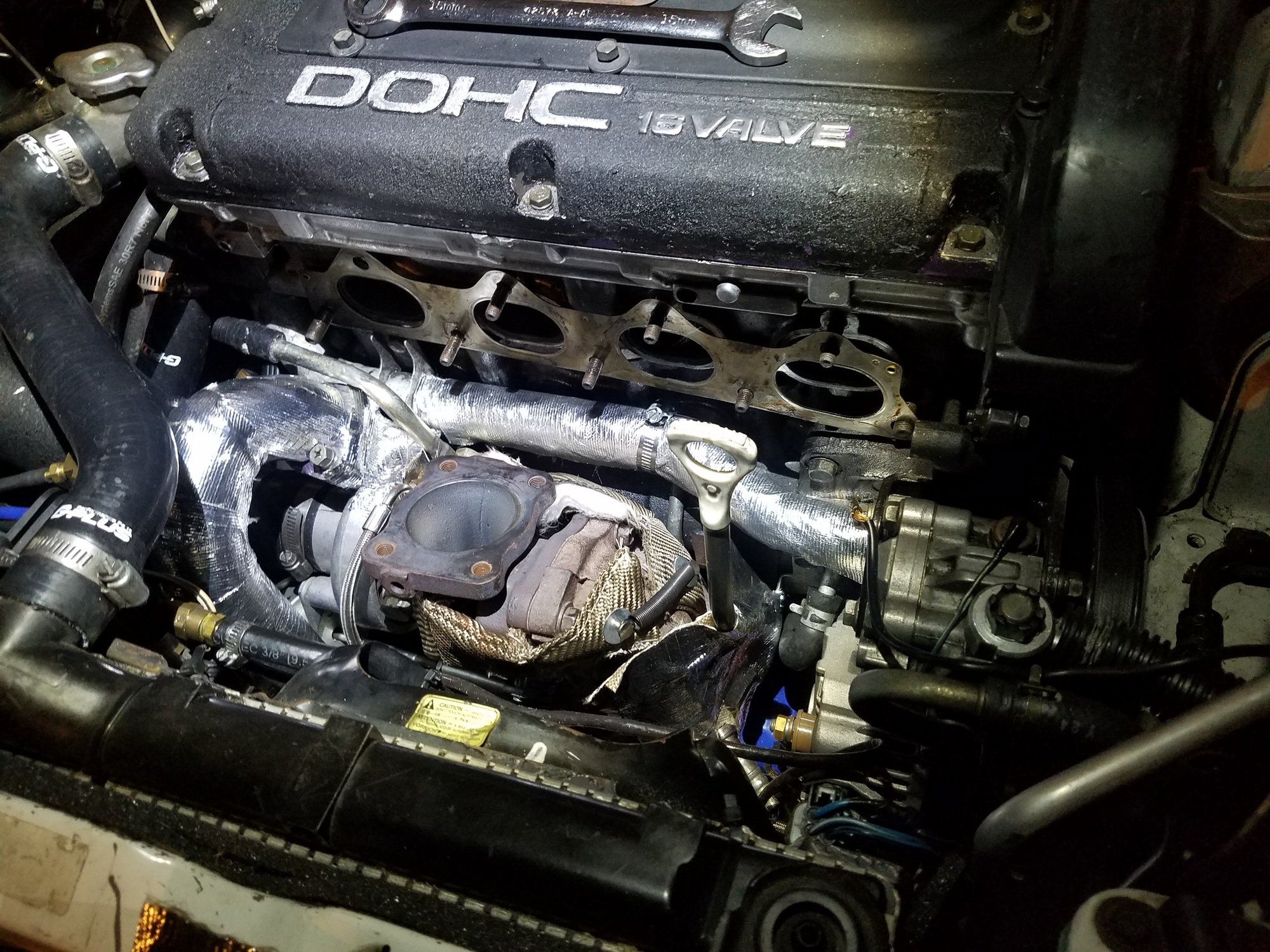

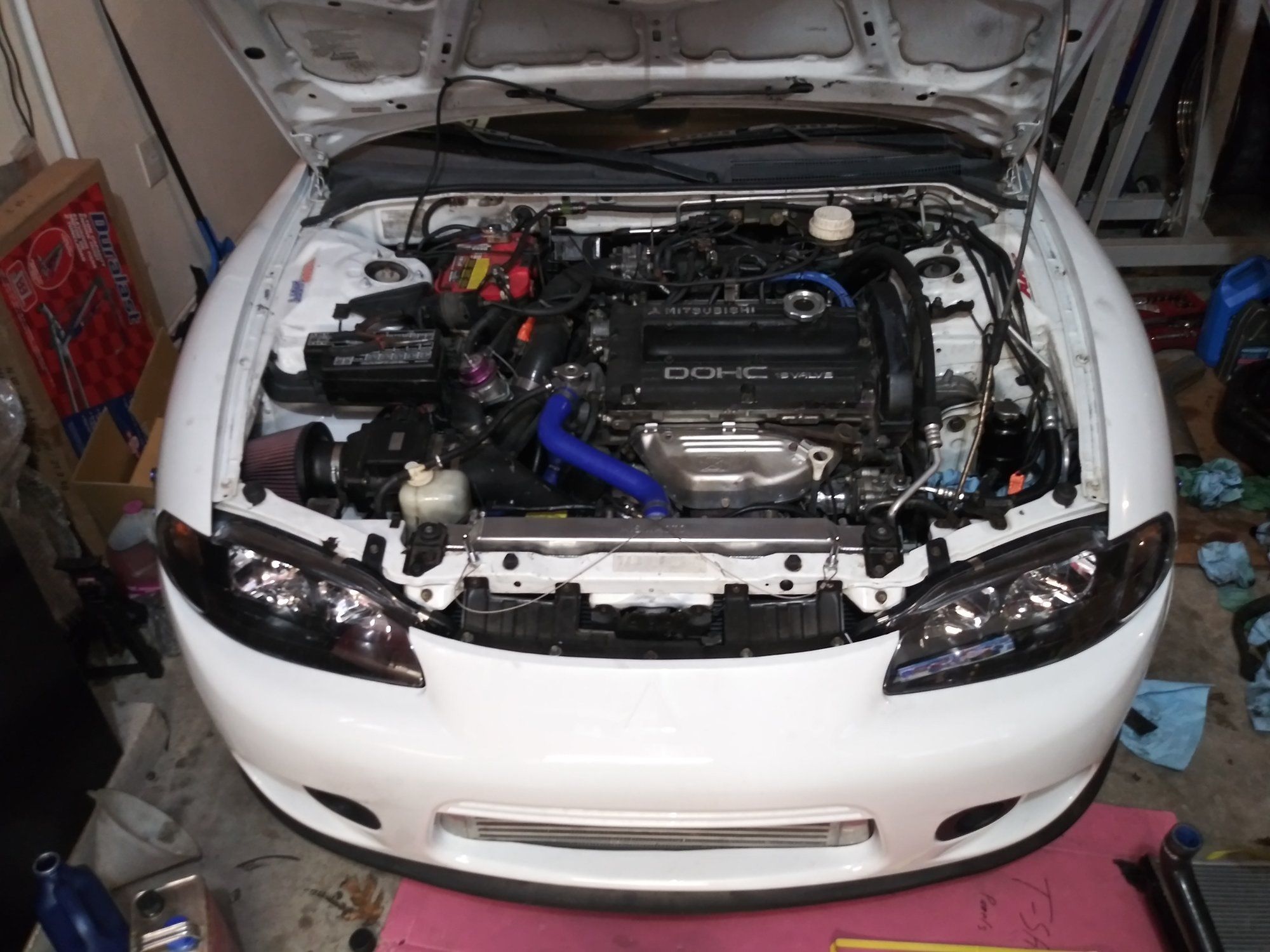

I used a reflective radiant barrier on the water pipe, and on the j-pipe and compressor side. I also modified the eBay t3 style blanket to wrap around the hot side and a bit of the O2 housing. Also used the radiant barrier on the dip stick tube to form a barrier to protect the alternator. And then to put the icing on the cake the manifold blanket covered by the factory manifold shield

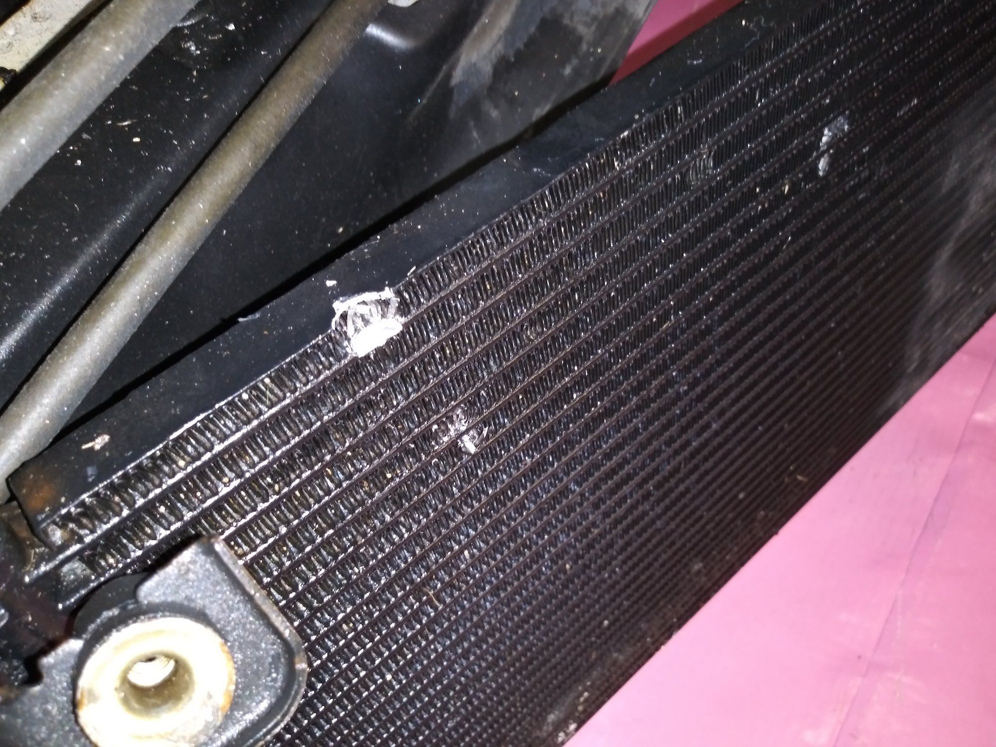

Saw the new owner a few times. The first time was for the turbo gasket to manifold. The eBay turbo bolts stretchted being under that turbo header blanket. It blew out the gasket and completely melted the condenser fan. Shockingly it also partially melted the radiator above the condensor fan use to mount. I got a new gasket and thread locker and we got rid of the manifold blanket and the issue has never come up again

He had a new front bumper put on, the old one was decent enough in my opinion, but what the hell it did need new headlights. Of course he asked for hood pins and drilled into the radiator condenser. Oh and you know how I think bumper quick connects are cheesey, of course he had to have a set

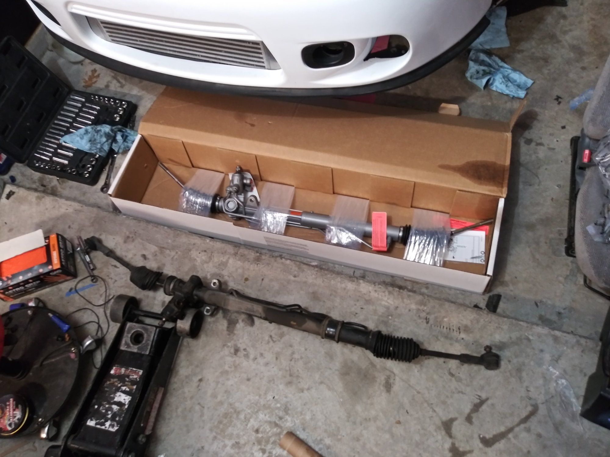

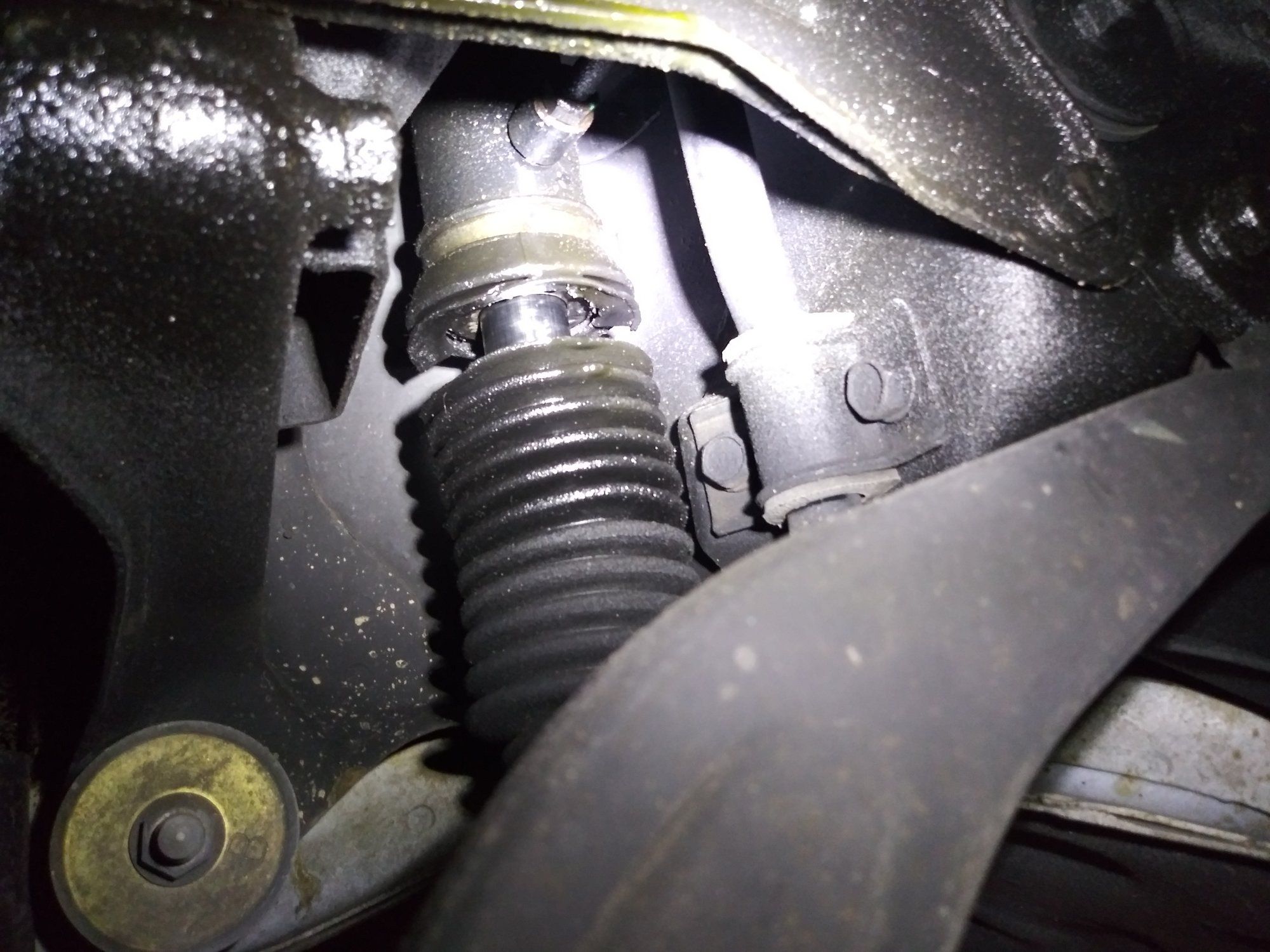

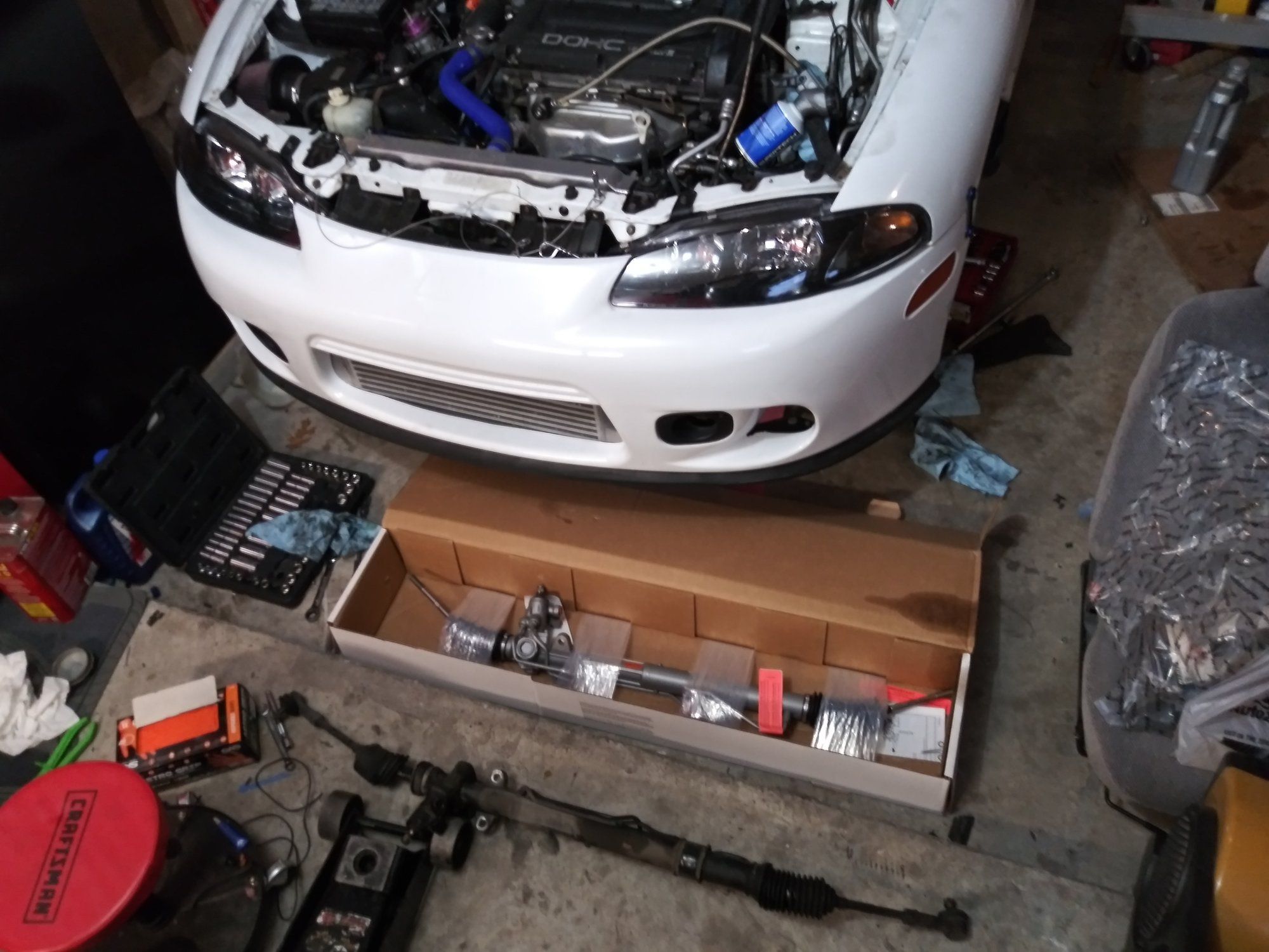

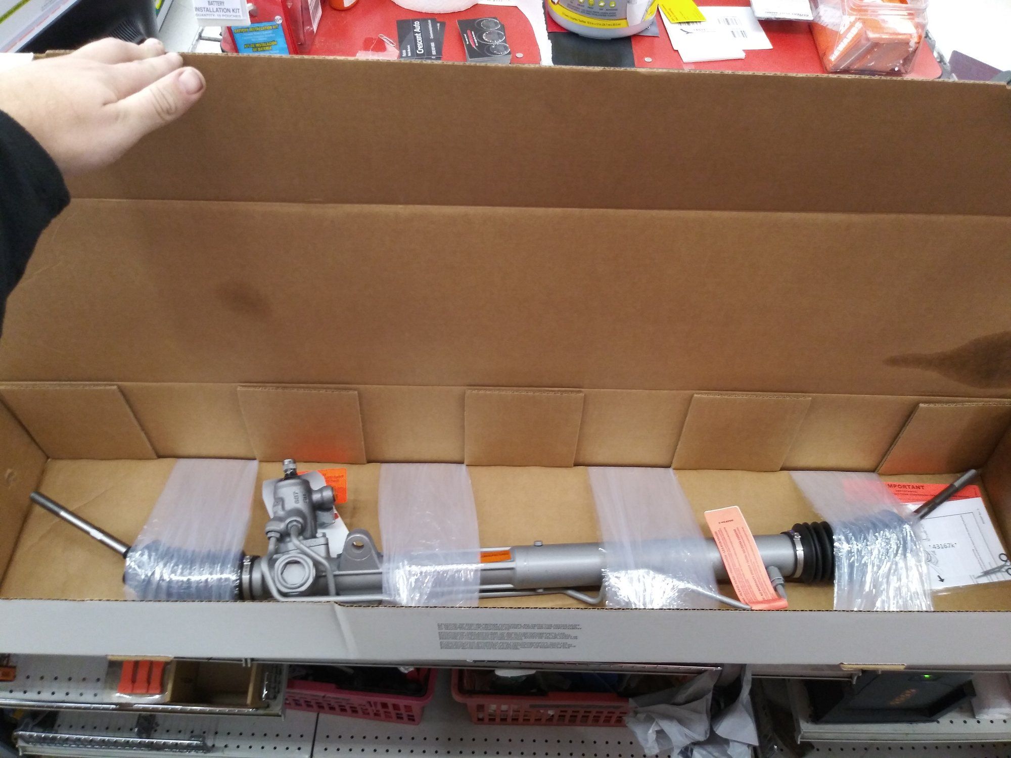

The rack and pinion took a dump. Probably the worst job on a dsm. Just terrible to do every part of the job
Fack man I really hate the rack setup in these cars. The racks should come pre-centered to make everything easier. My backyard alignments will let it drive straight but I can never line the splines up correctly to get the wheel centered.
