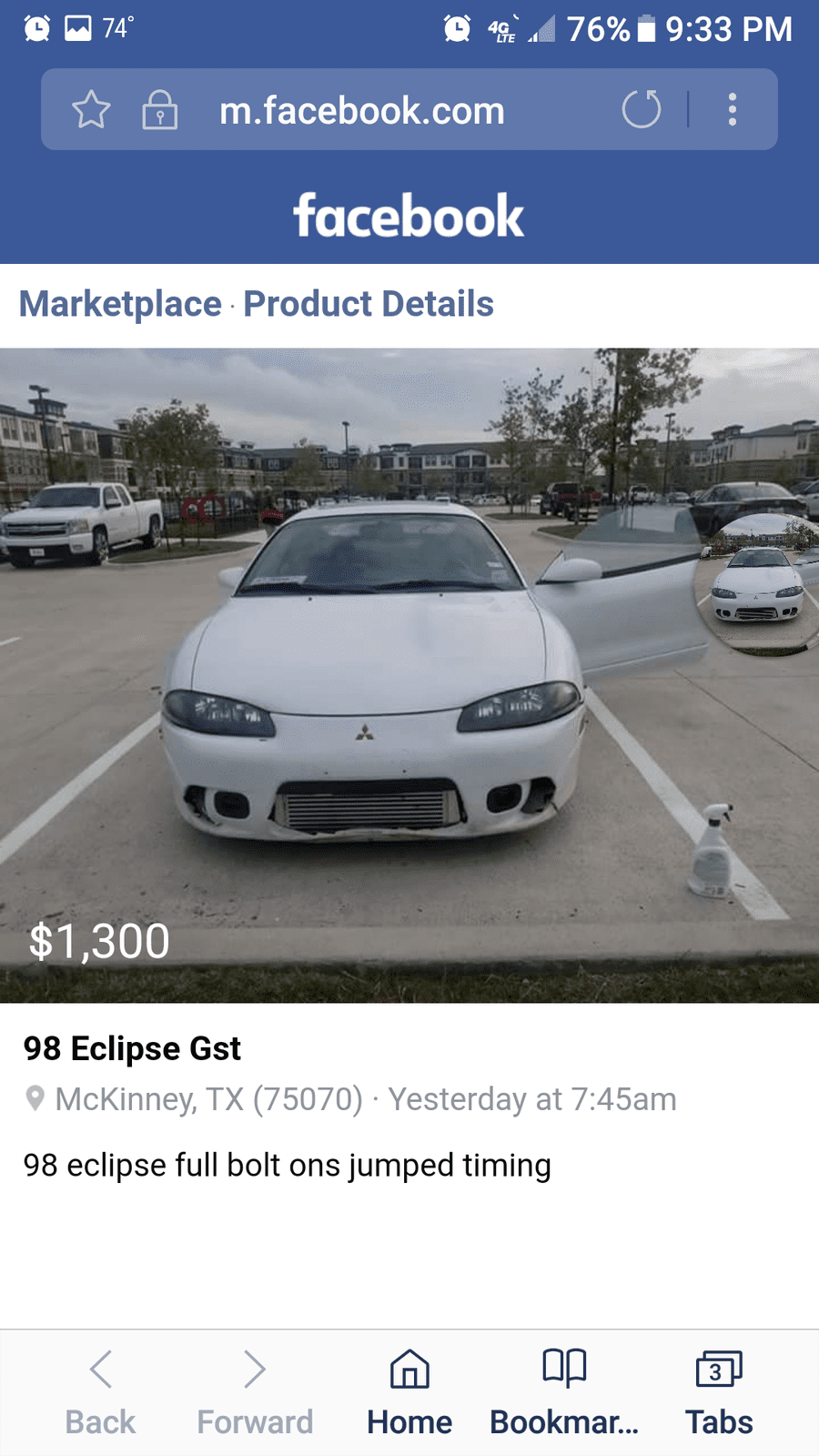

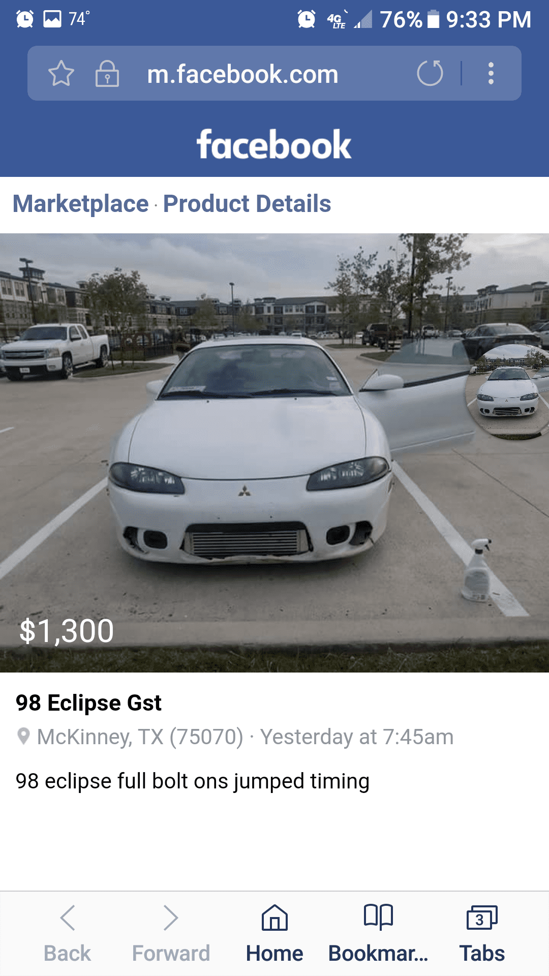

So I bought the car for $1300. I got it running in the previous owners apartment complex. It was literally covered in rice stickers, and towing notice stickers. I offered to walk away, the car was running and driving he could get more. He needed the money and wanted the car gone. So it was a deal LOL
The car is very complete, and did not deserve a junk yards death

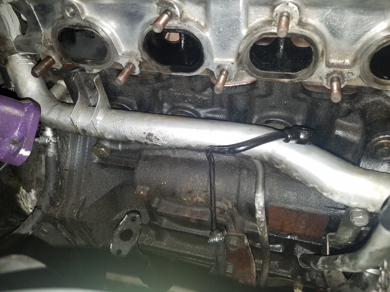

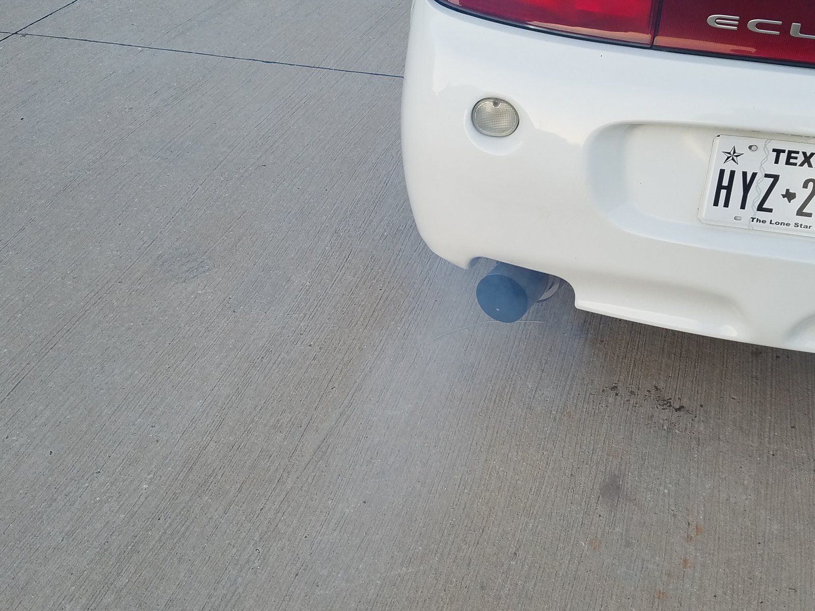

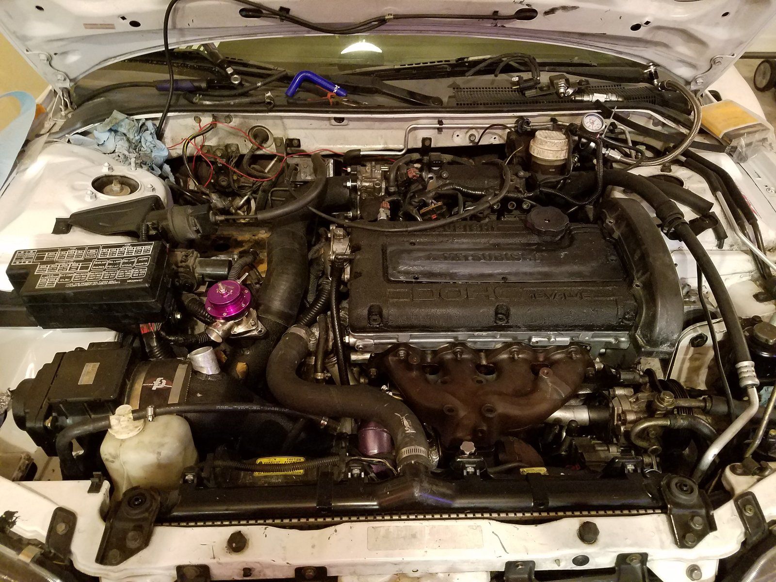

It had died from multiple boost leaks. The main boost pipe to the intake was popped off. After reconnecting it the car idled and drove fine. Smoked severely at idle.

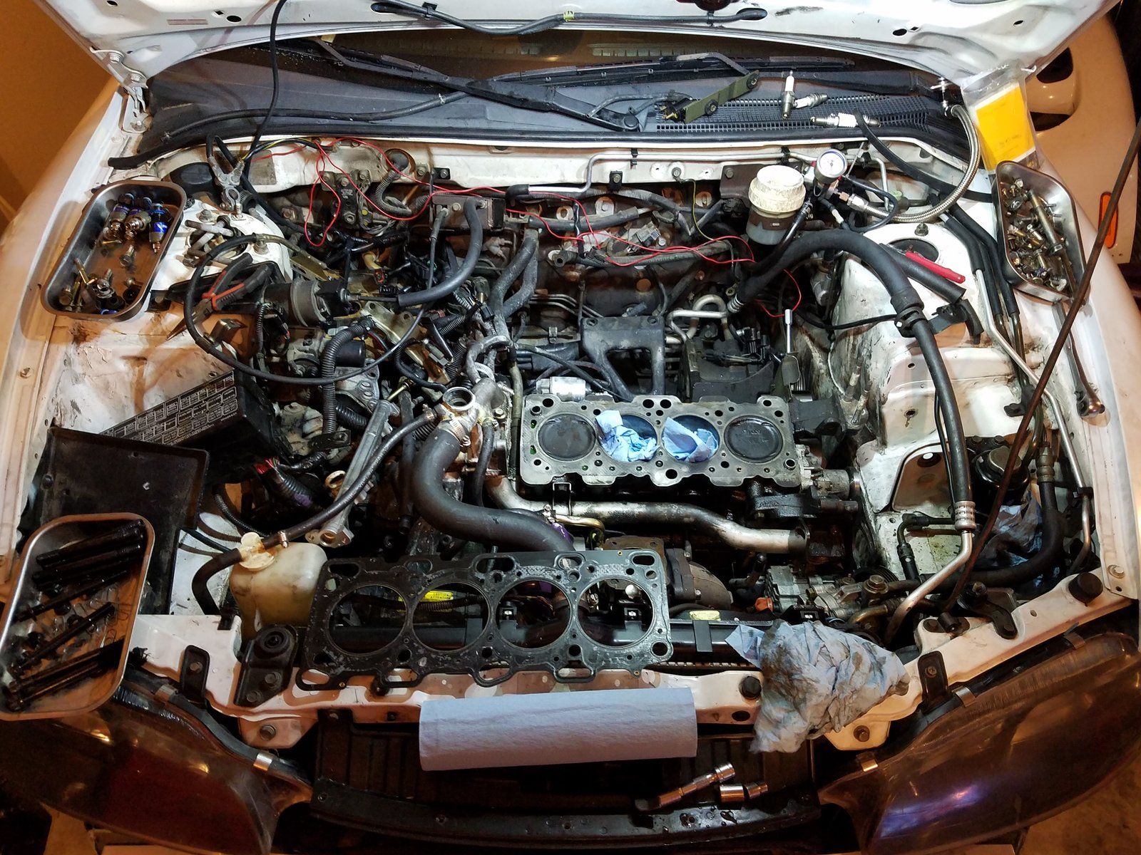

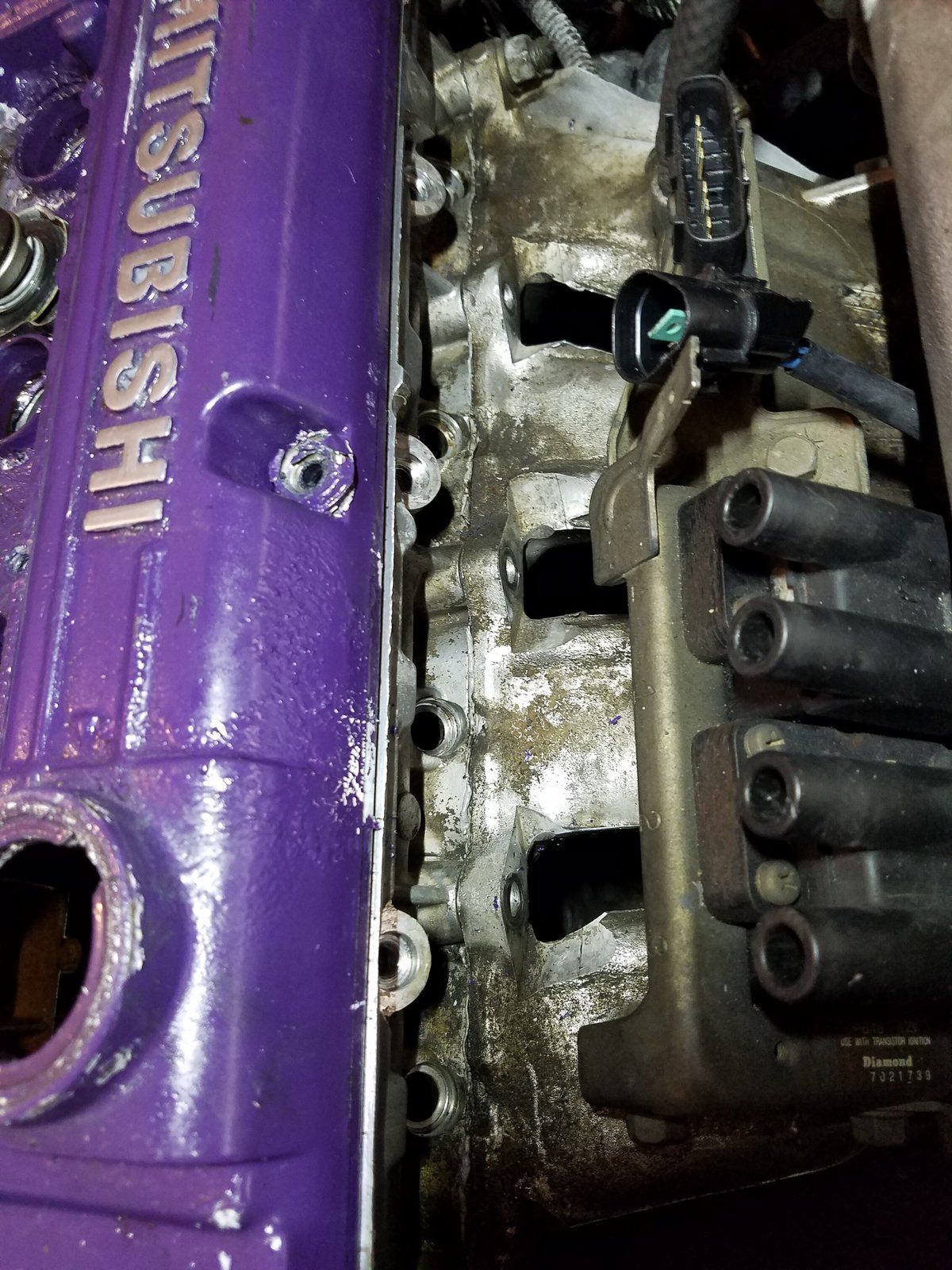

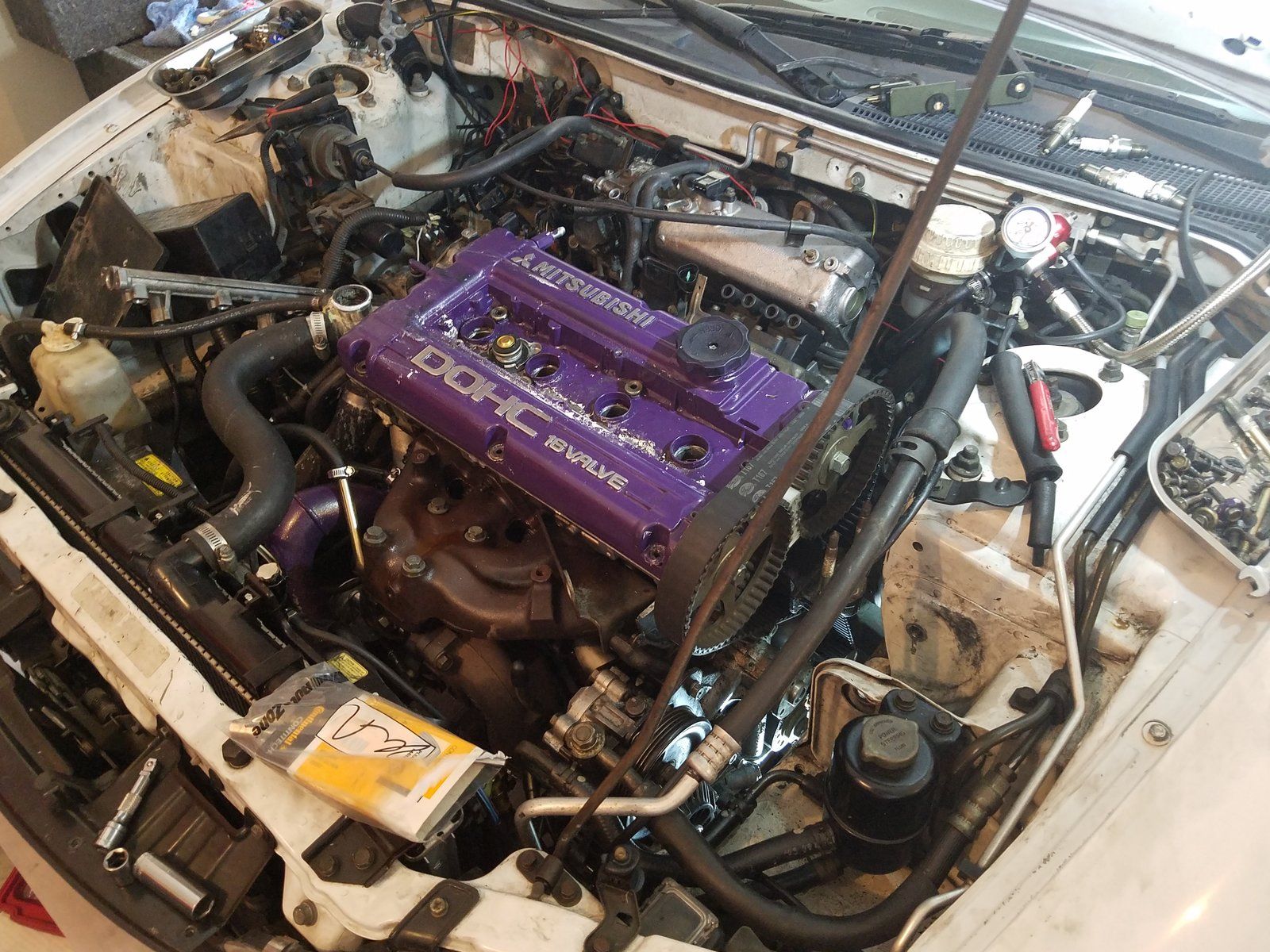

So the first thing I noticed after inspecting the engine bay was that the intake manifold was missing every intake manifold bolt and was being held on by the two studs at the end, and tons of RTv
The previous owner claimed no knowledge, that another shop had installed the head and the head studs and ever since the car has never been right
I'm not sure why anyone would want purple under the hood, but this guy went all out with it.

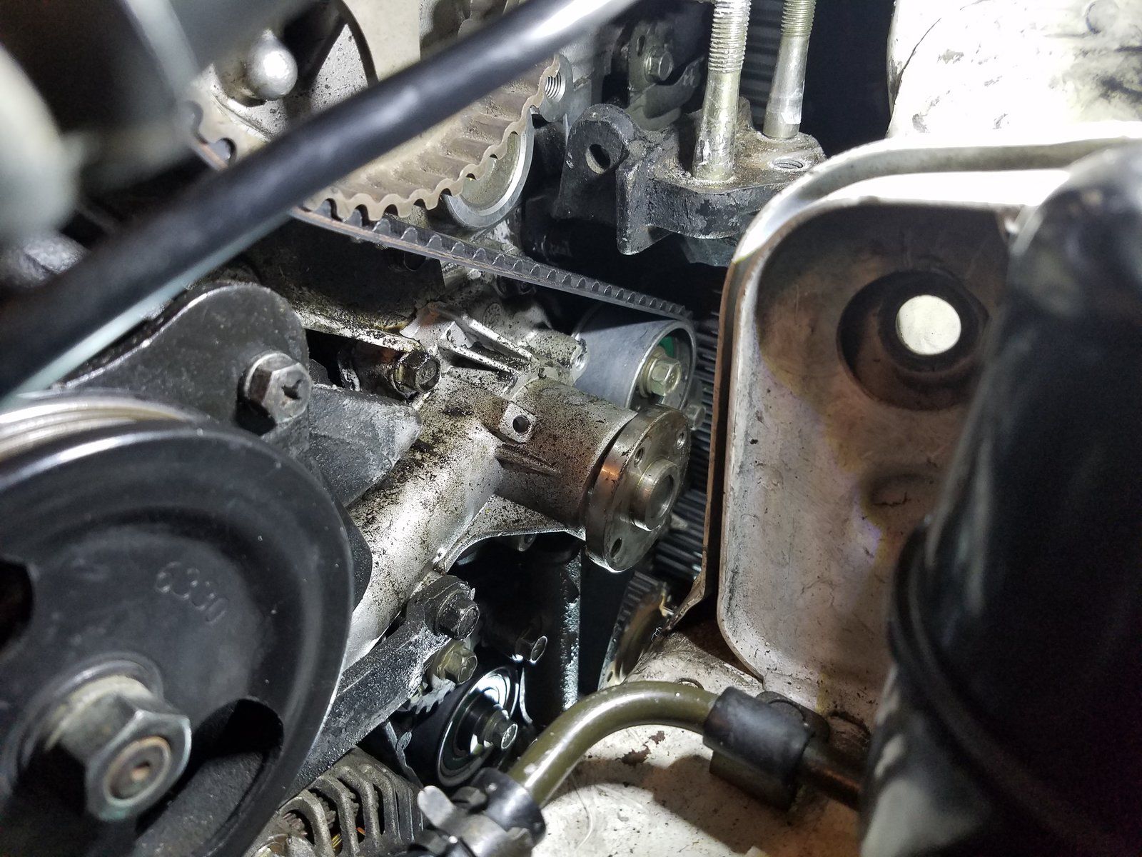

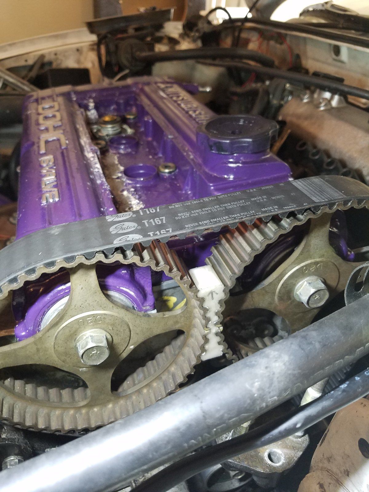

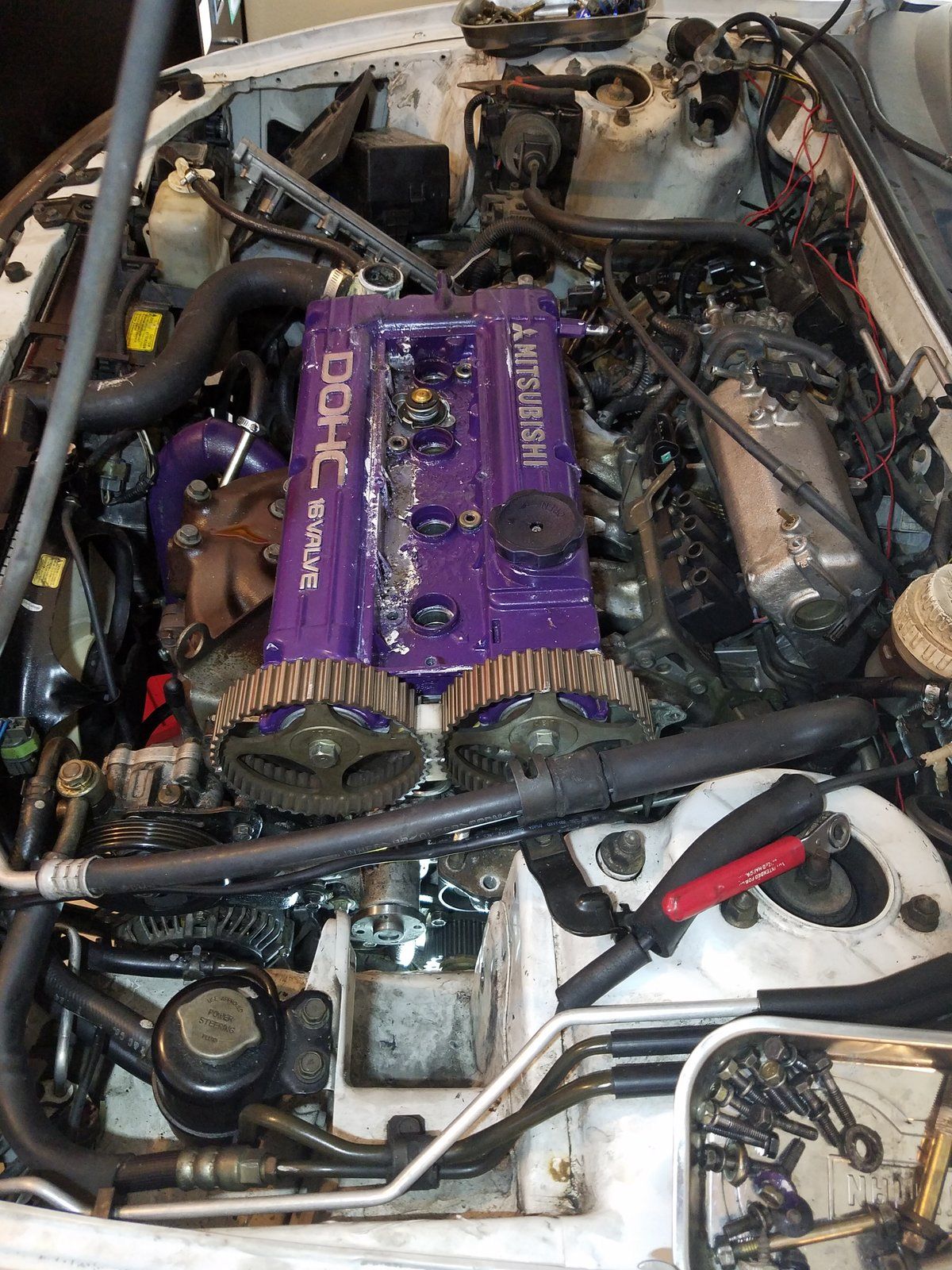

Checking my marks on timing. Got the belt lined up with the timing marks too on the first try. Good omen. Belt was good but the hydraulic tensioner was not set correctly. The timing pulley was not adjusted at all

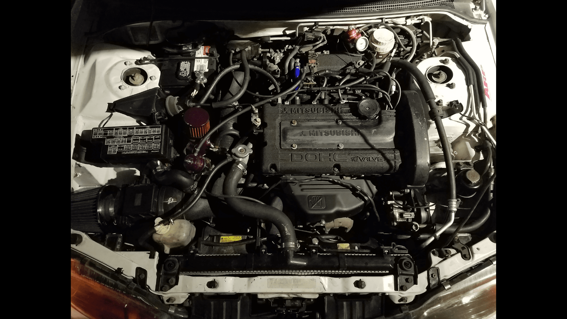

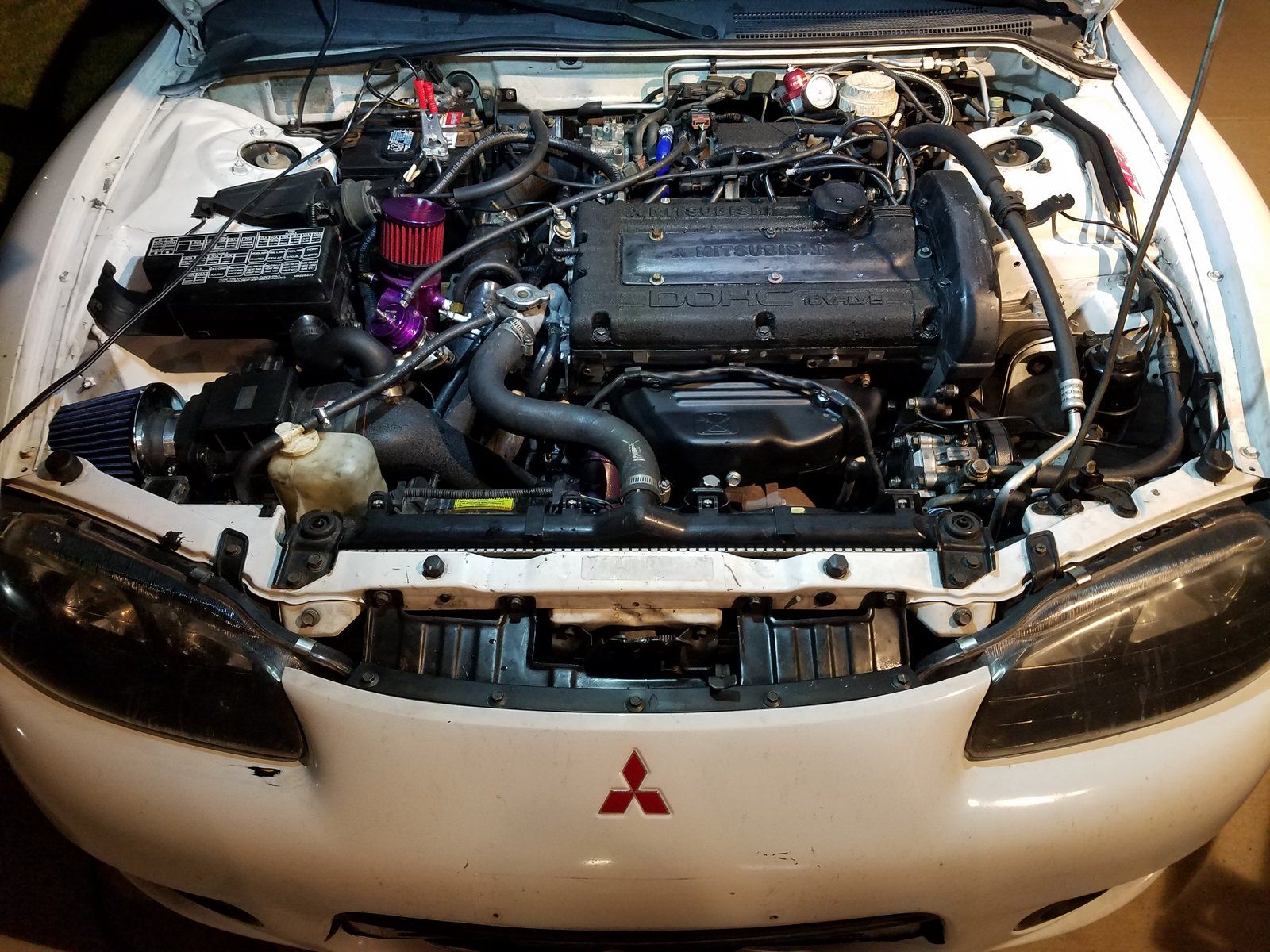

Car came with a lot of decent parts too, wideband, 850 injectors, evo scan with cable.

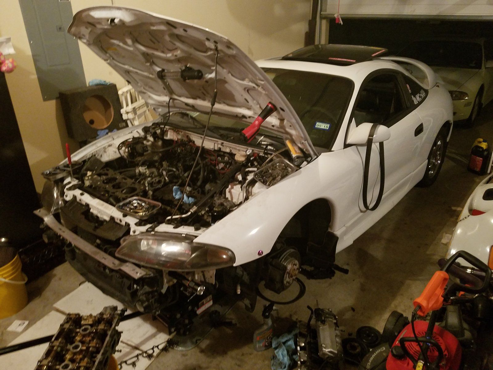

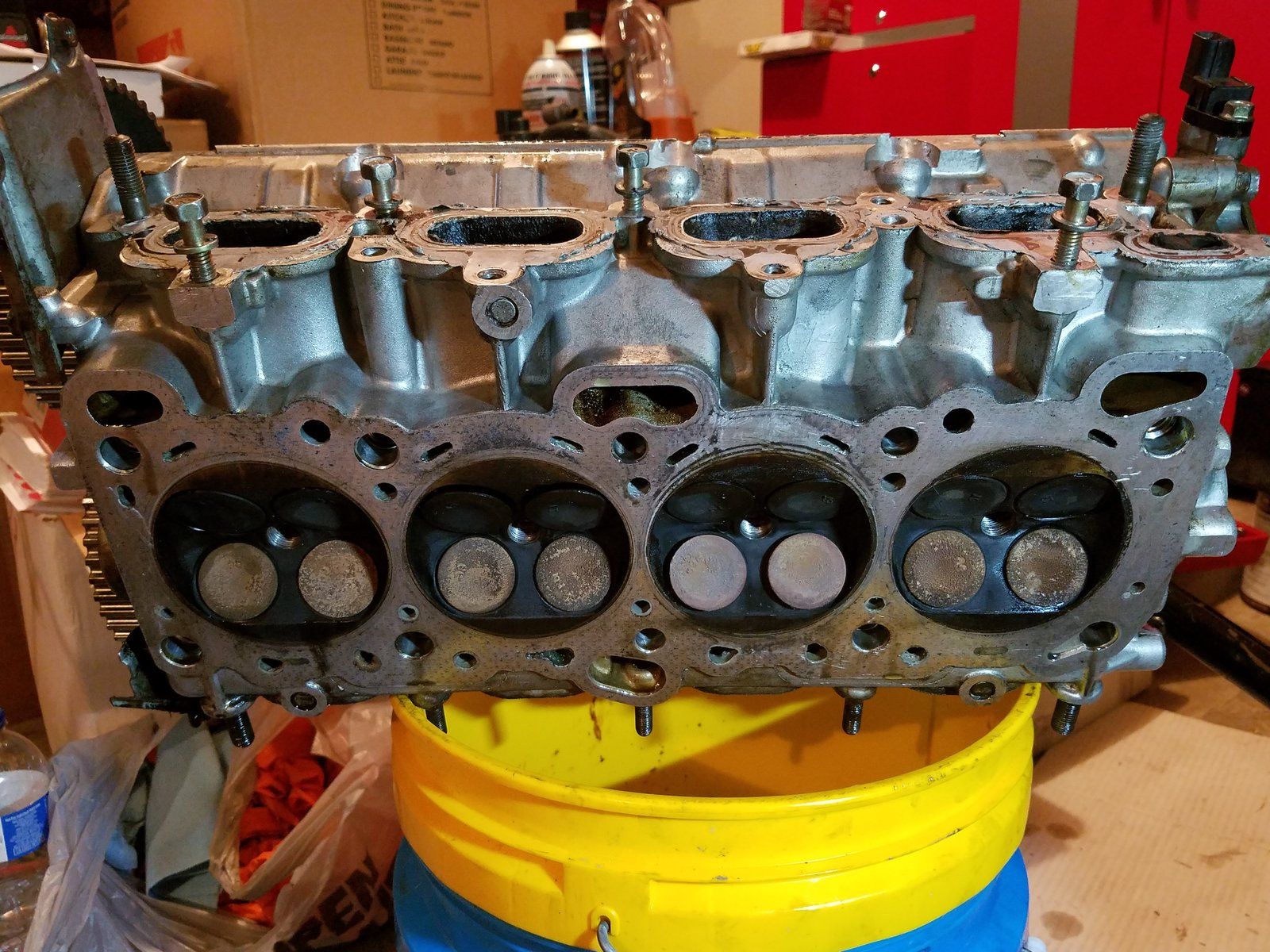

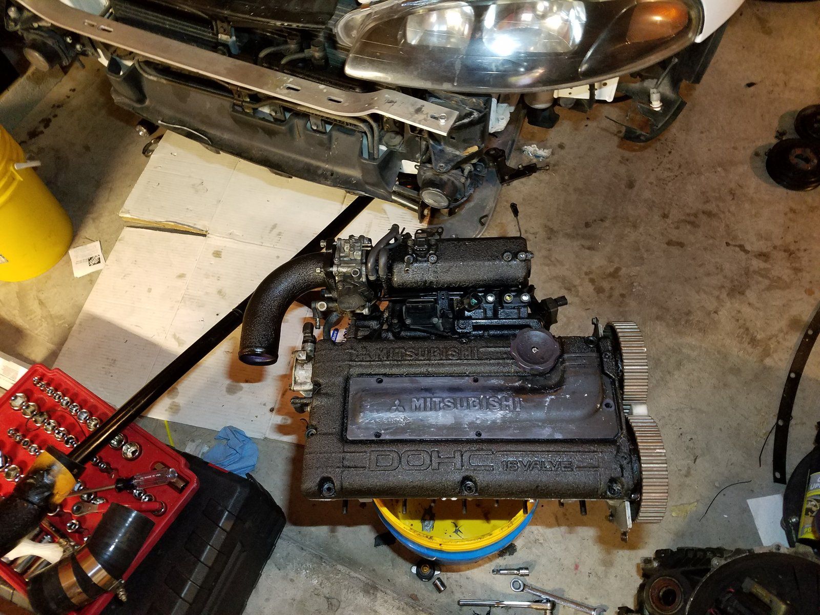

This broken stud was the first sign I saw when I popped the hood that the previous owners mechanic, was a complete idiot. Who removes a cylinder head and leaves a broken stud in it. Blows my mind. Have some pride in your work

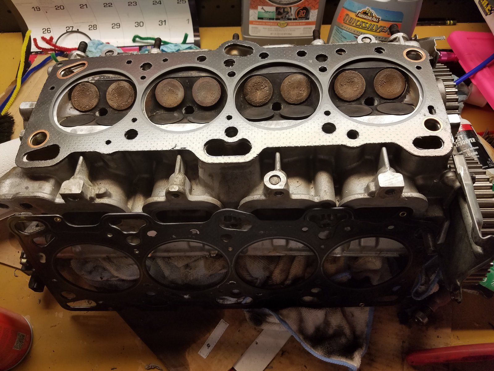

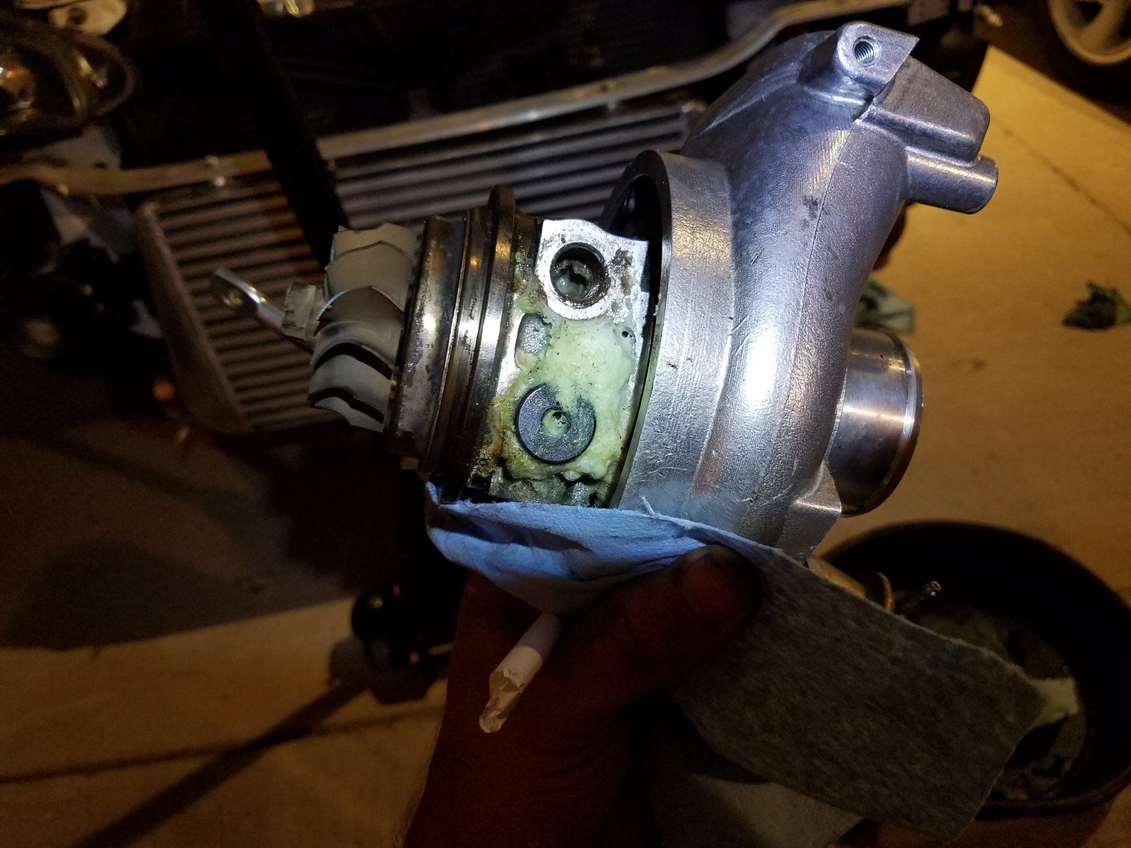

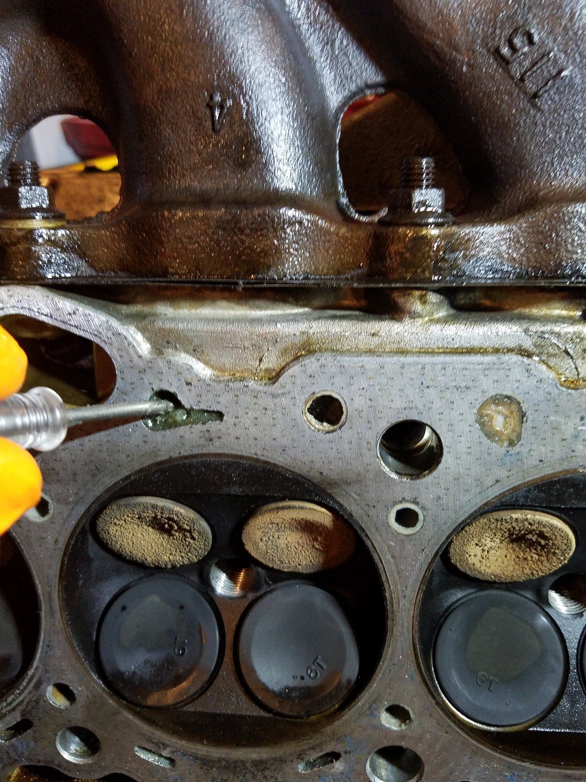

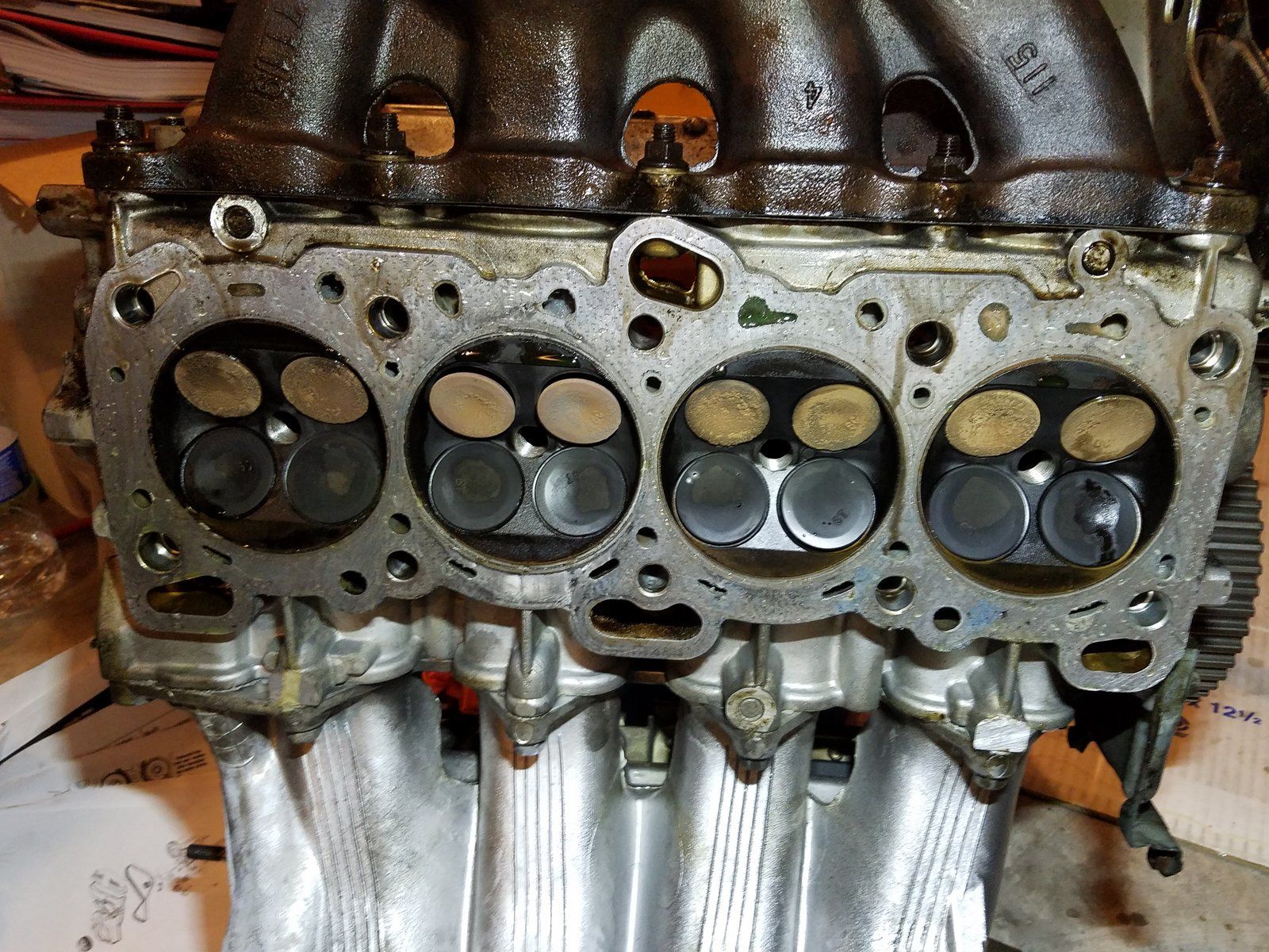

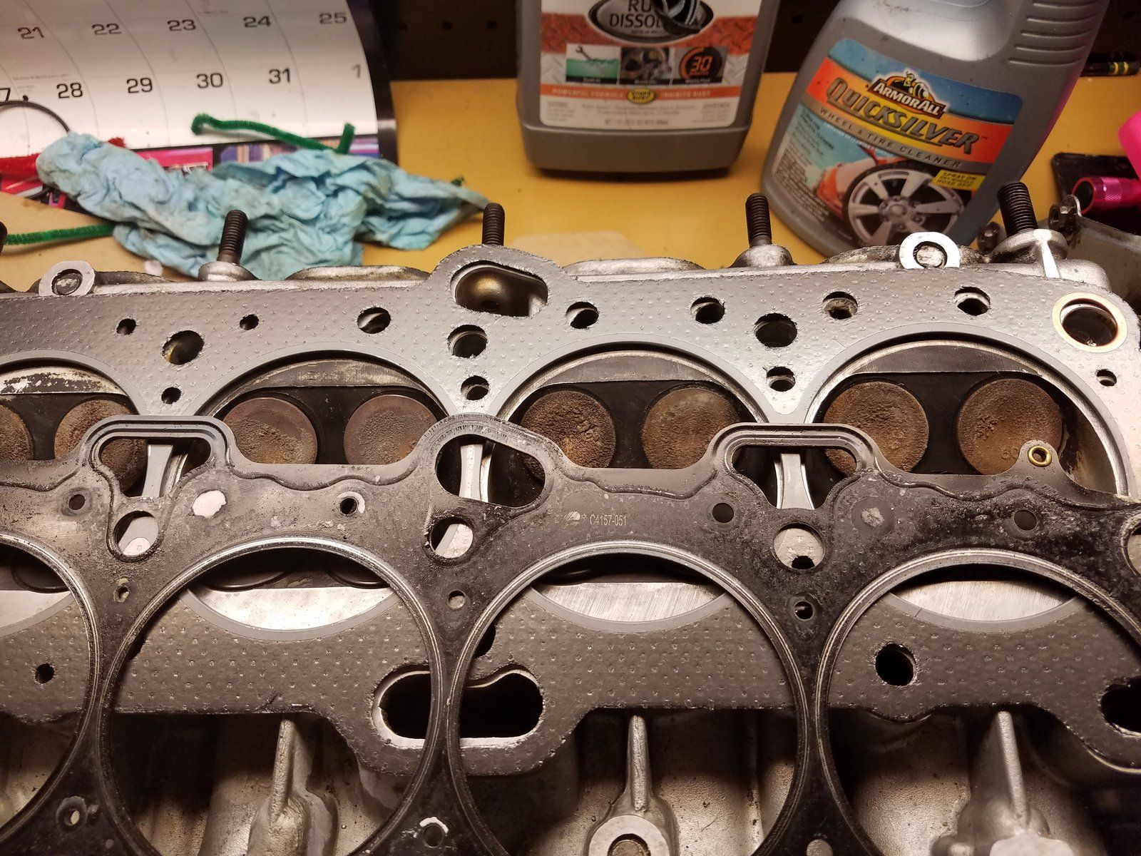

This head gasket sealer shit was all in the head coolant passages, and little did I know, all clogged in the heater core, and clogged in the turbo. Never use this stuff!

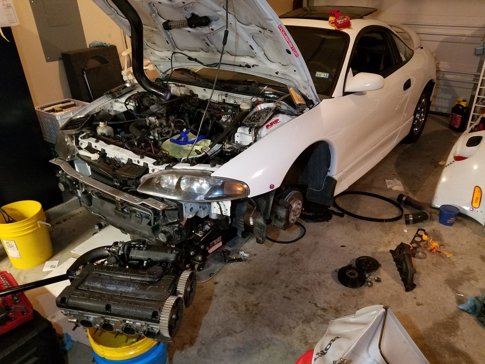

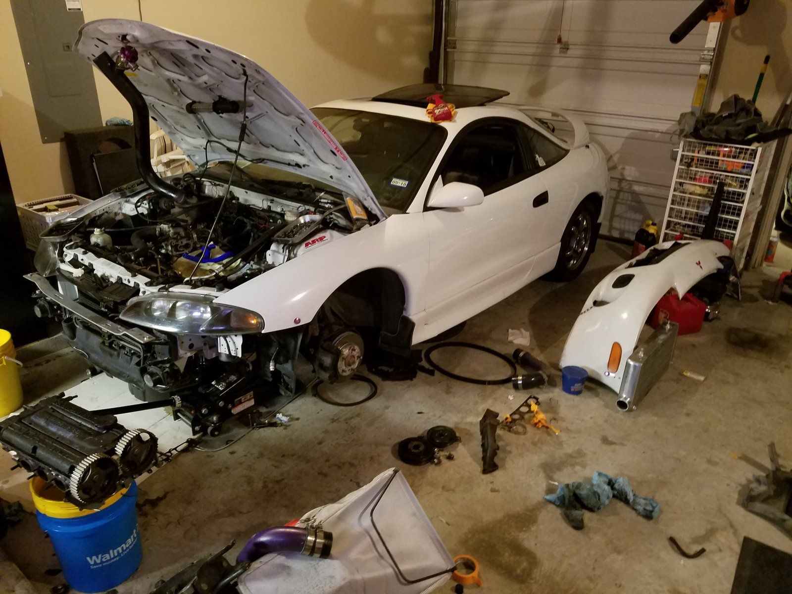

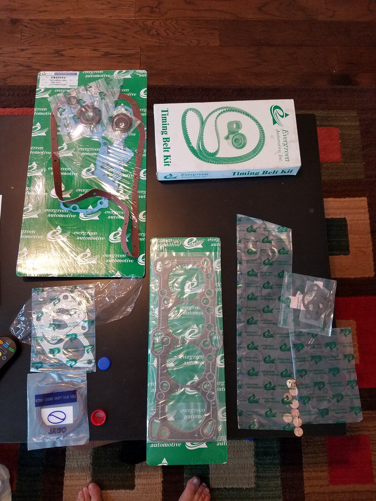

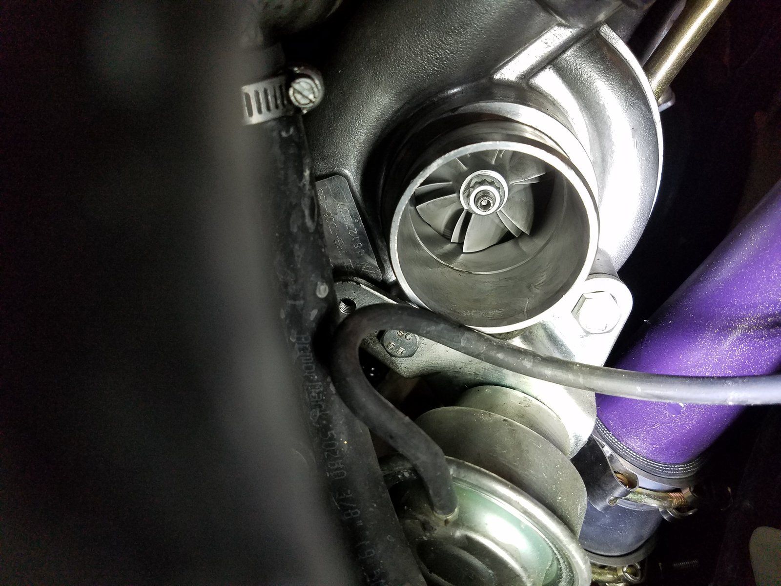

So after installing the new head gasket, new intake manifold, fixing all of the boost leaks it ran great. But once the oil temp got fully warm at idle she would smoke like crazy. So back in the garage she went.

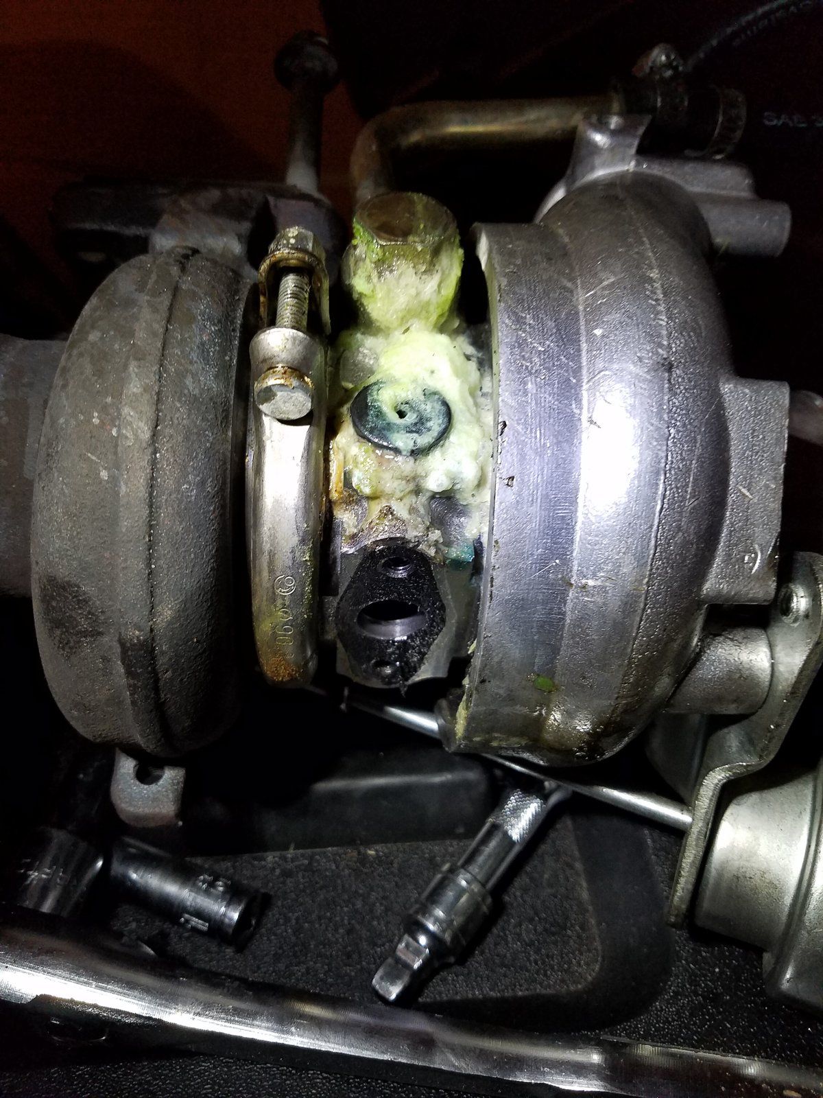

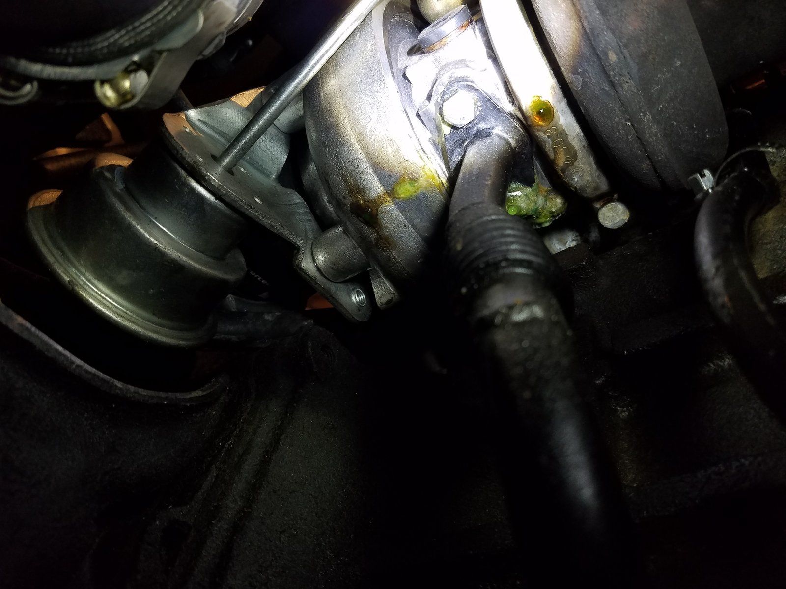

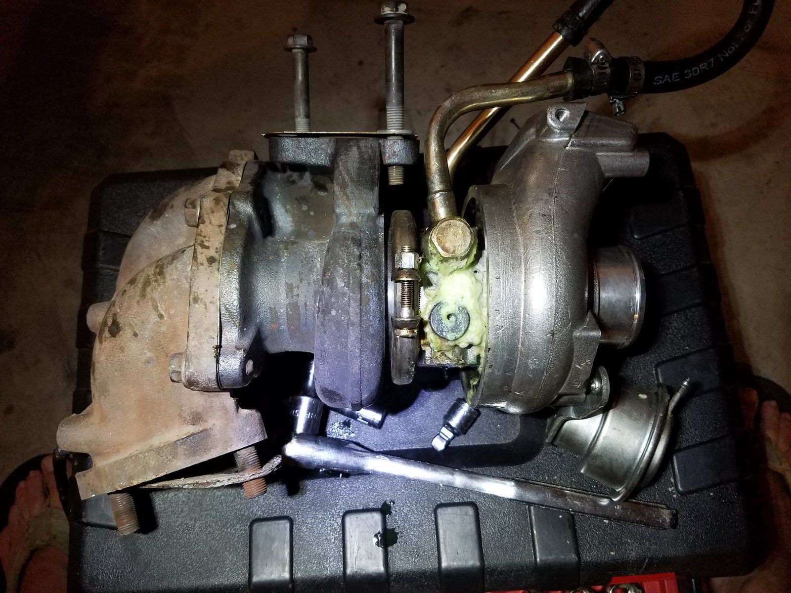

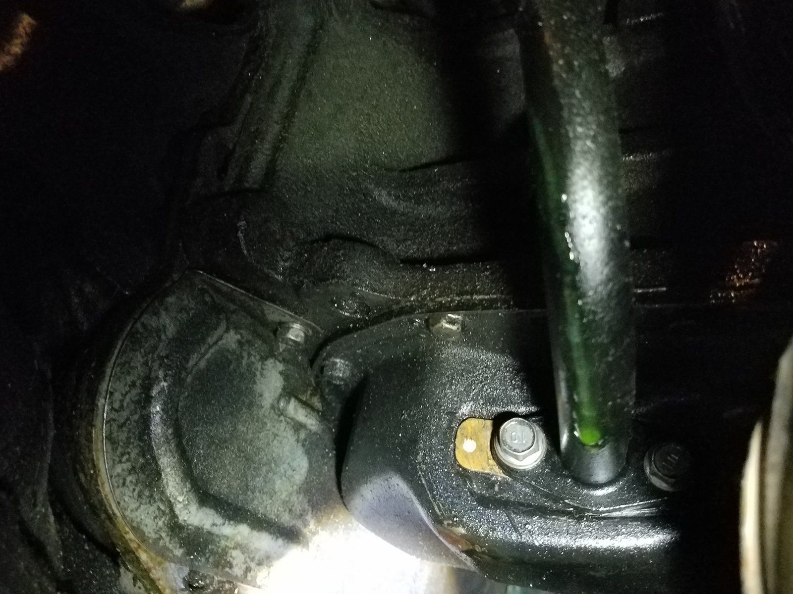

Upon further inspection I found a coolant leak from the turbo. Lead me to believe the turbo could be installed incorrectly or bad

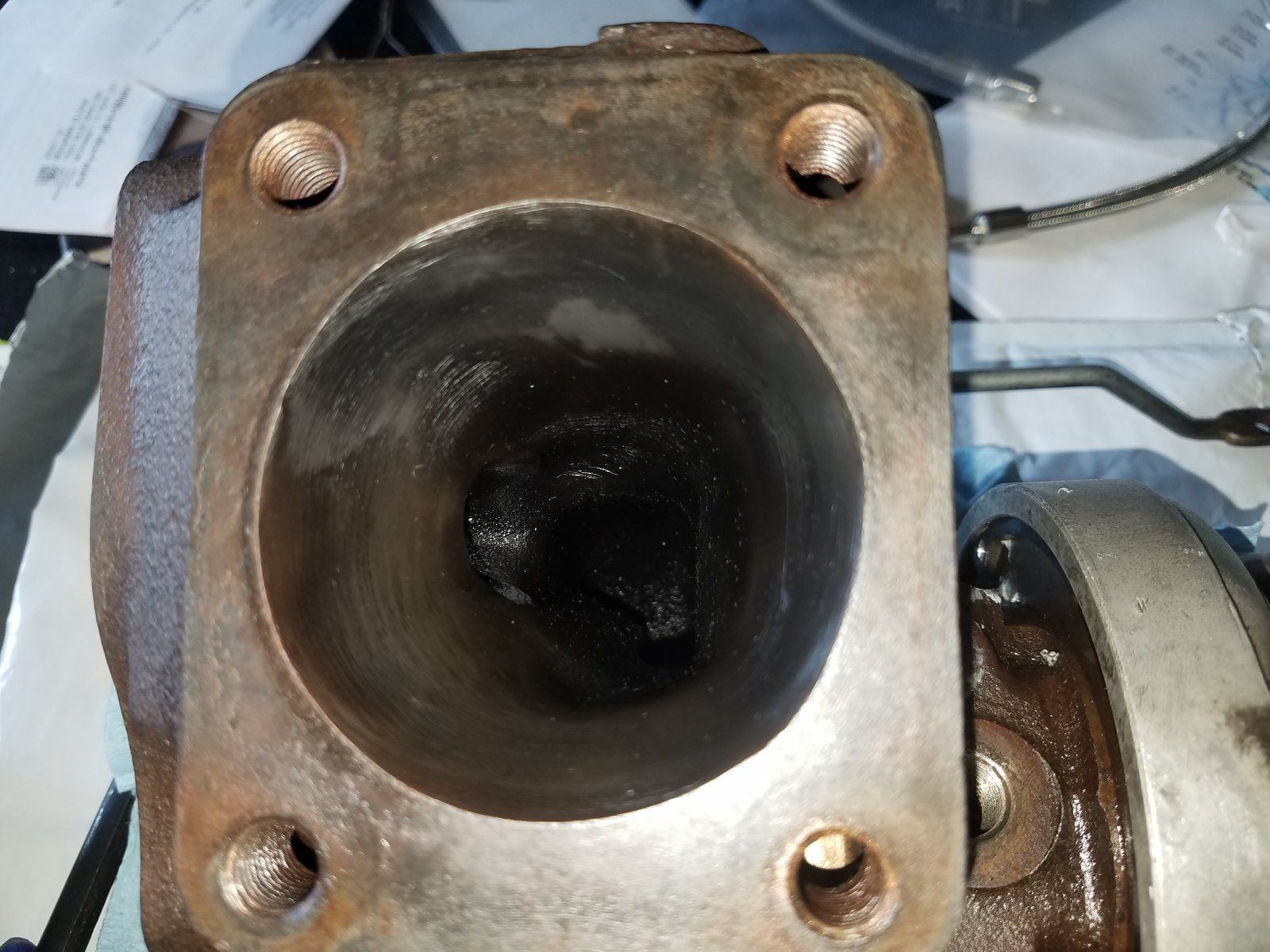

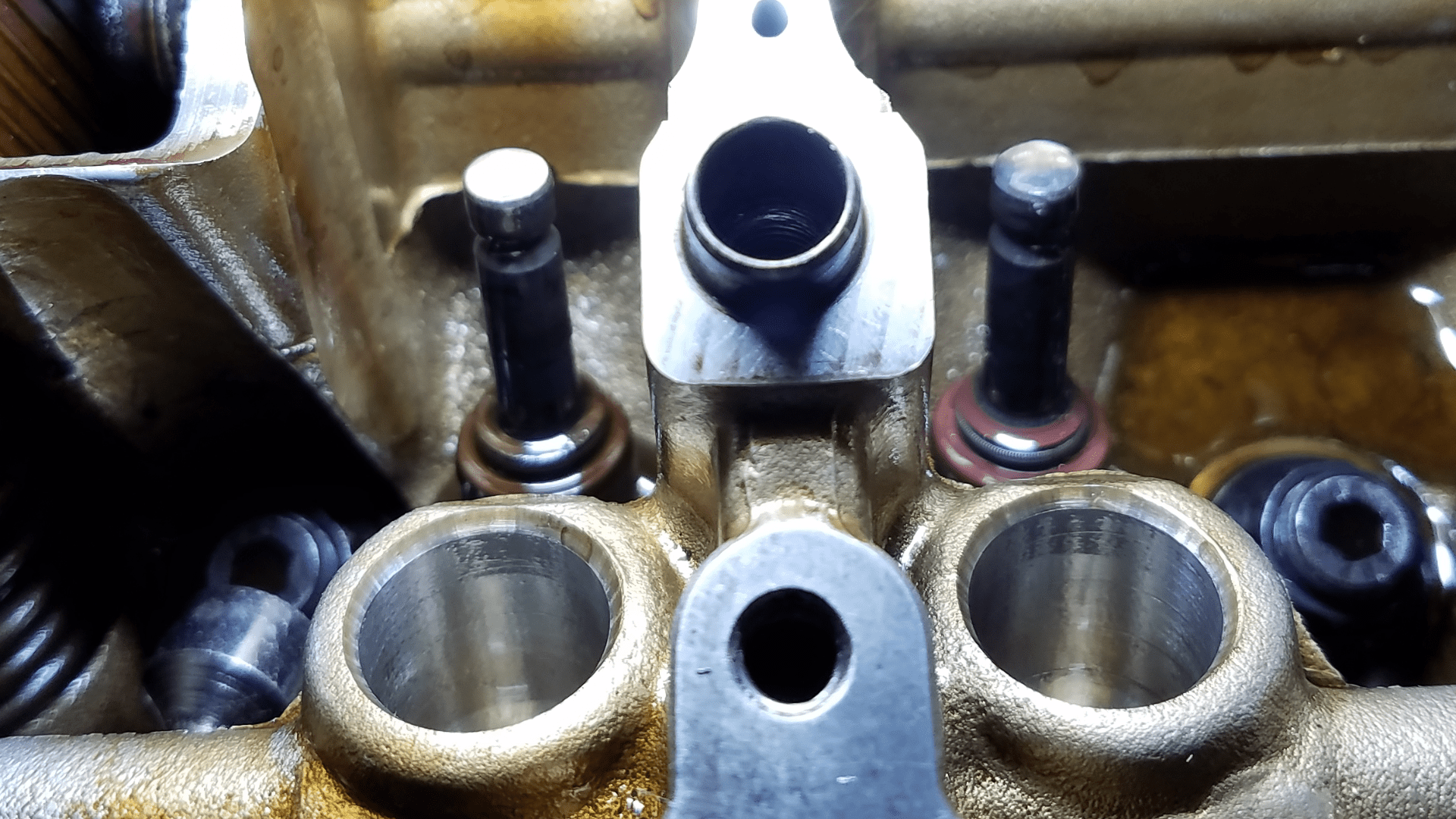

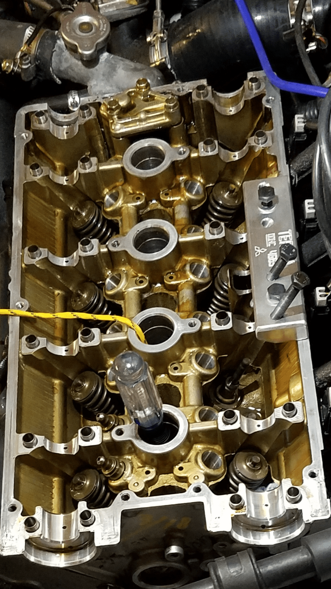

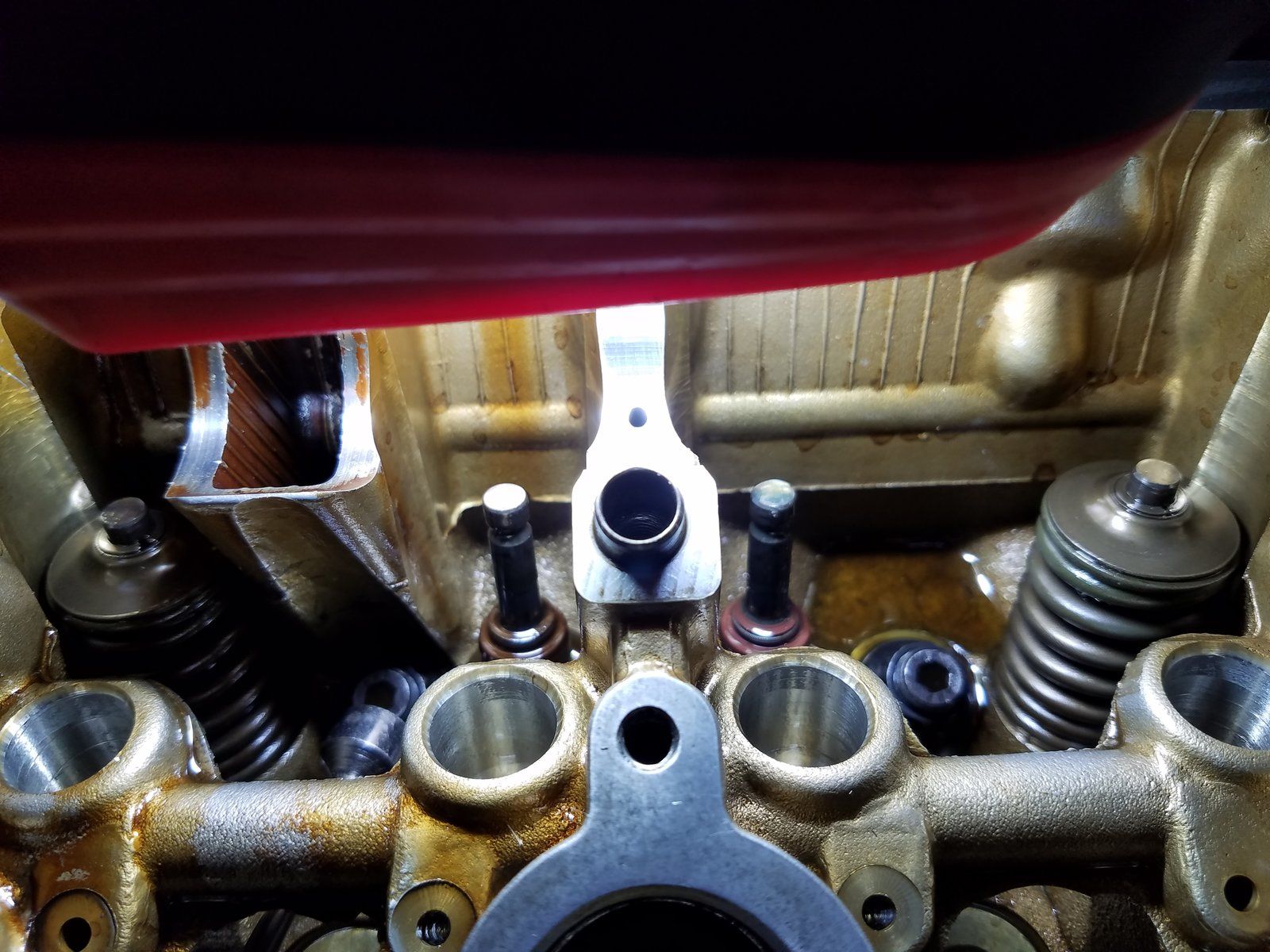

So this picture shows why it's smoking worse than before. My guess is that when I cleaned the head my brake cleaner un seated the valve seals.

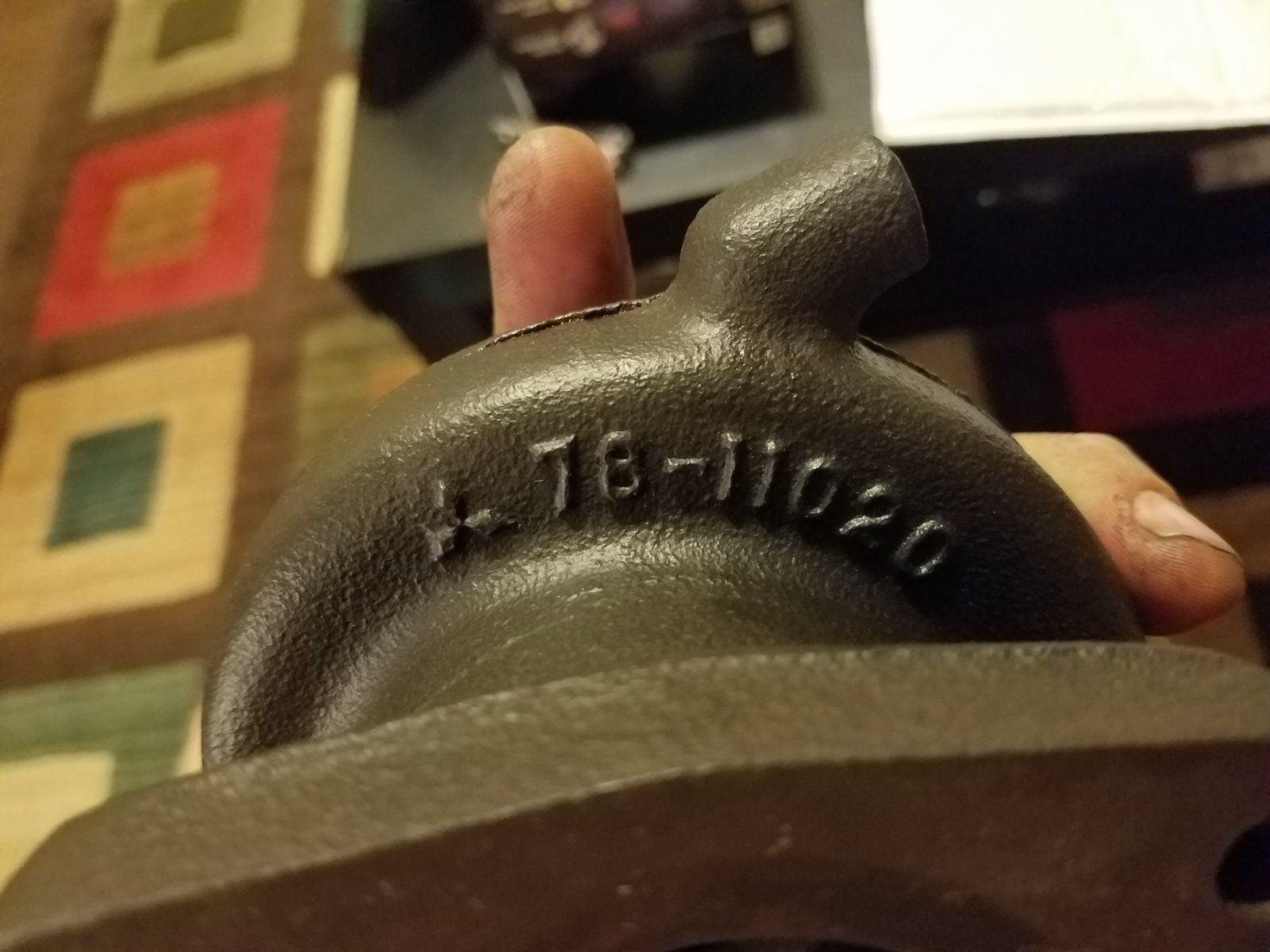

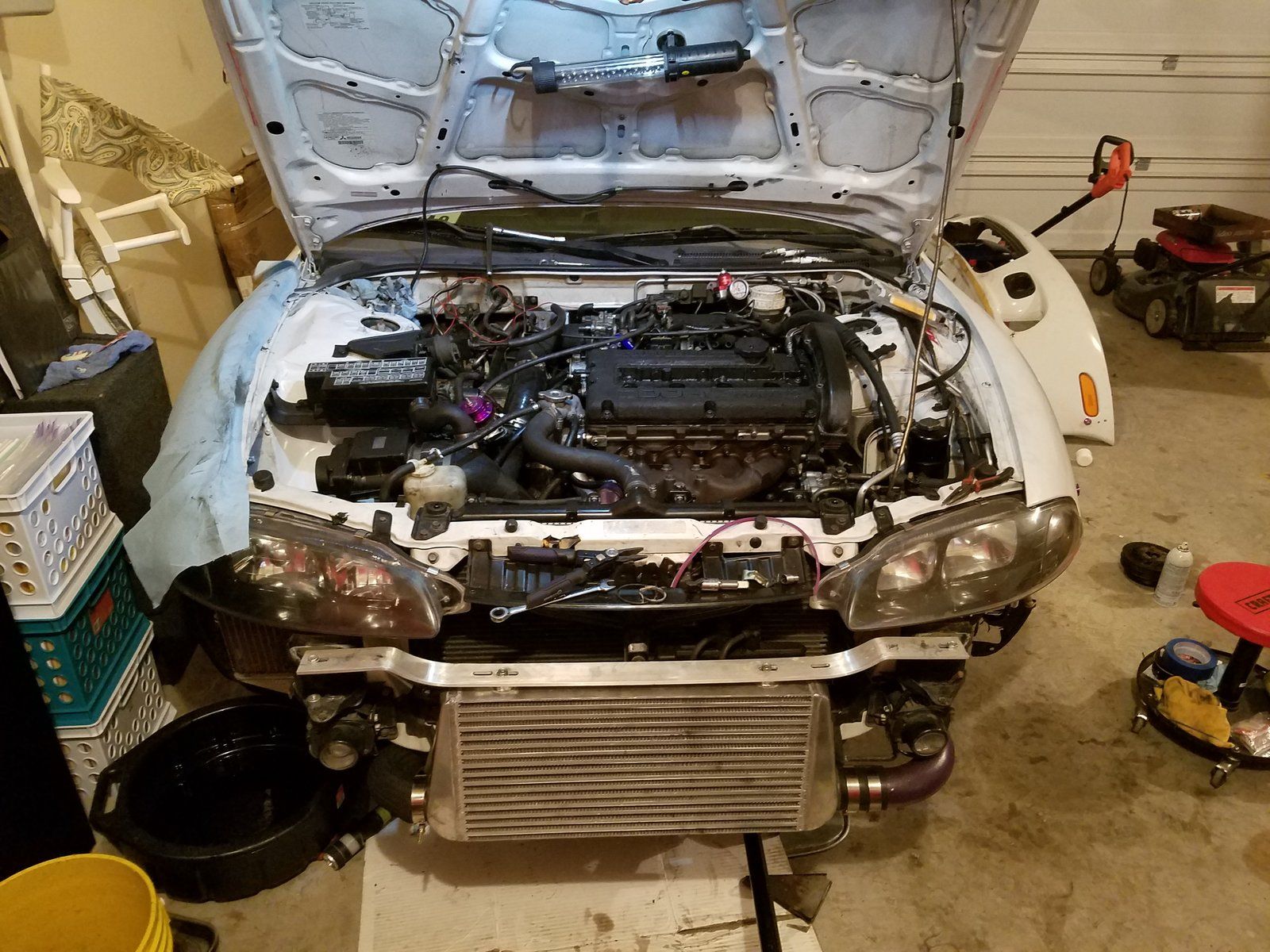

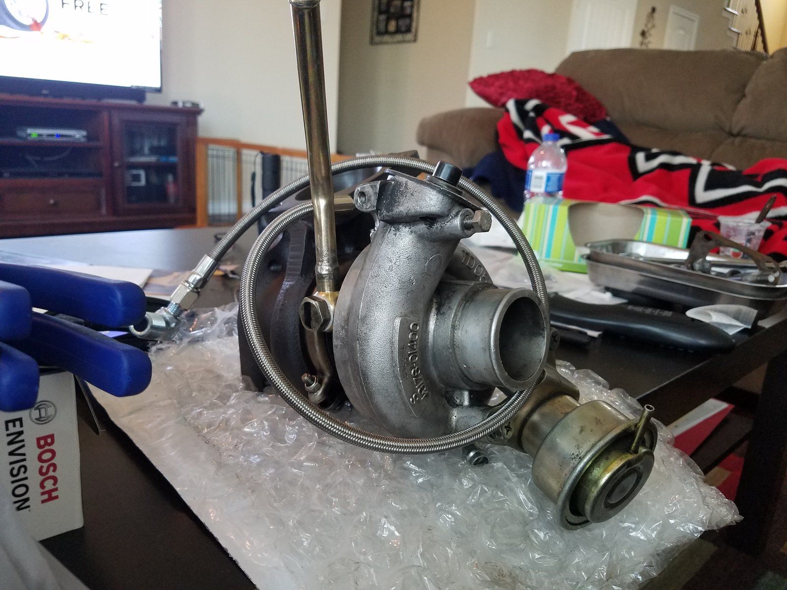

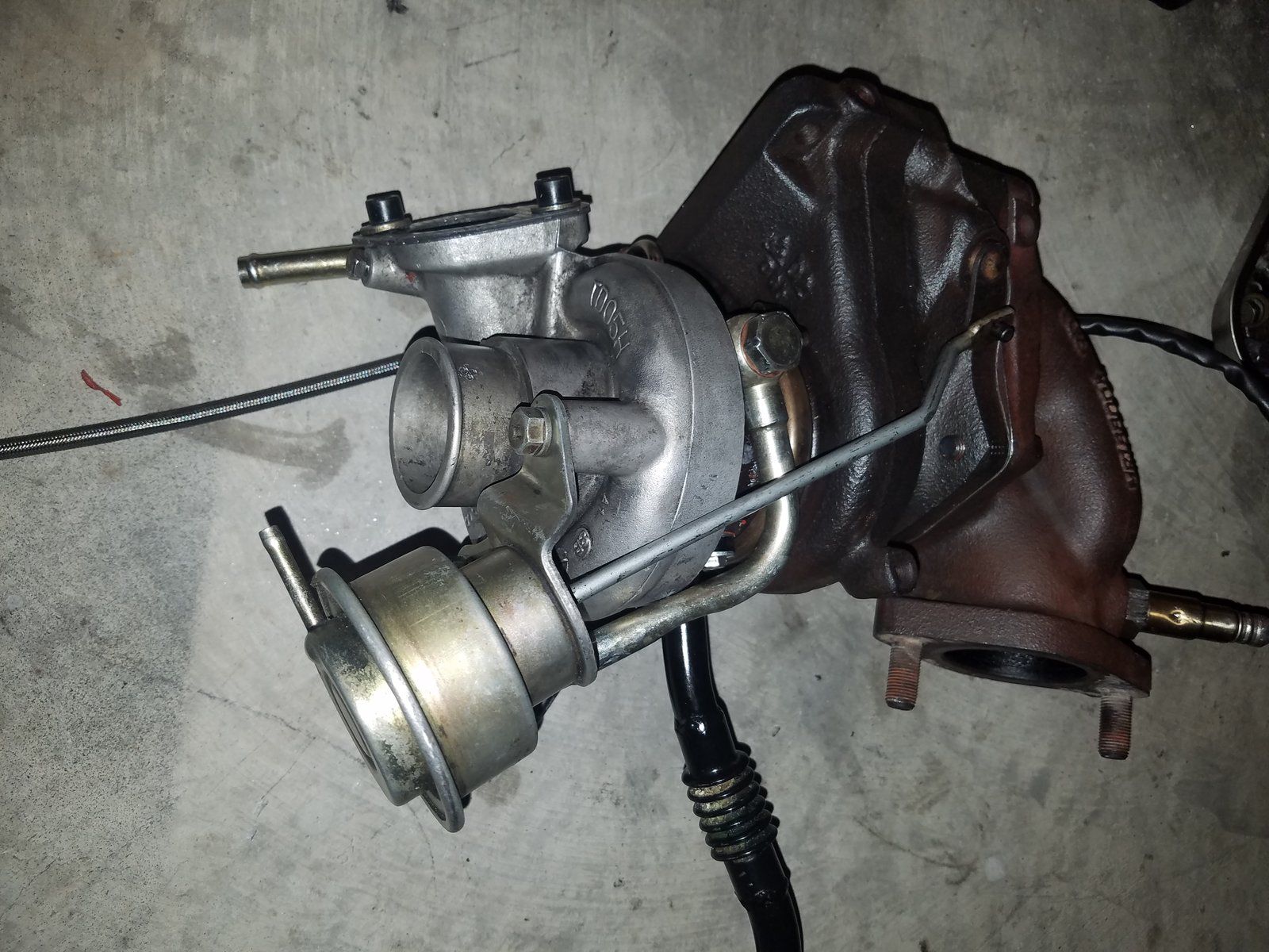

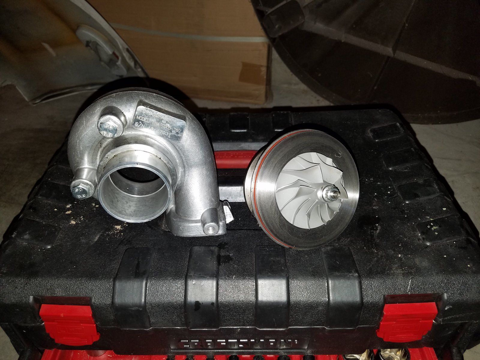

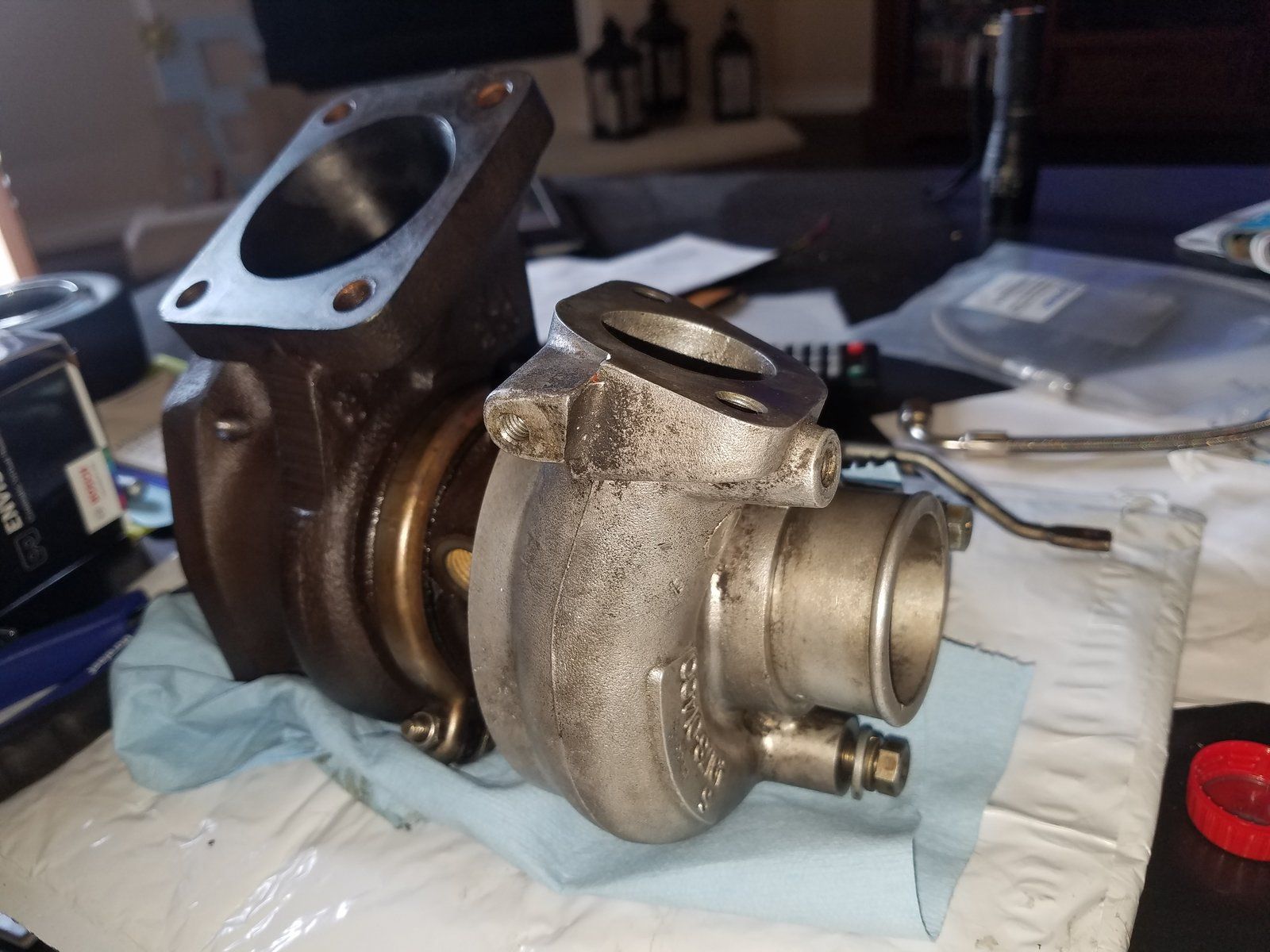

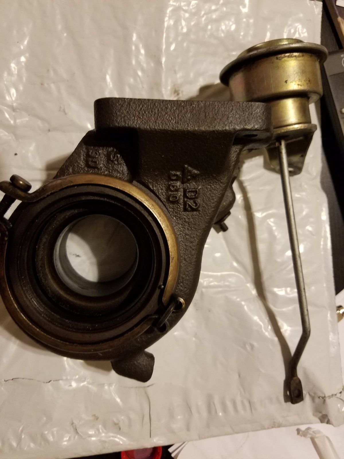

New 14b turbo
Under the wise premise that the old eBay 16g was bad I found a 14b and re resealed the internals. Good shape with minimal shaft play

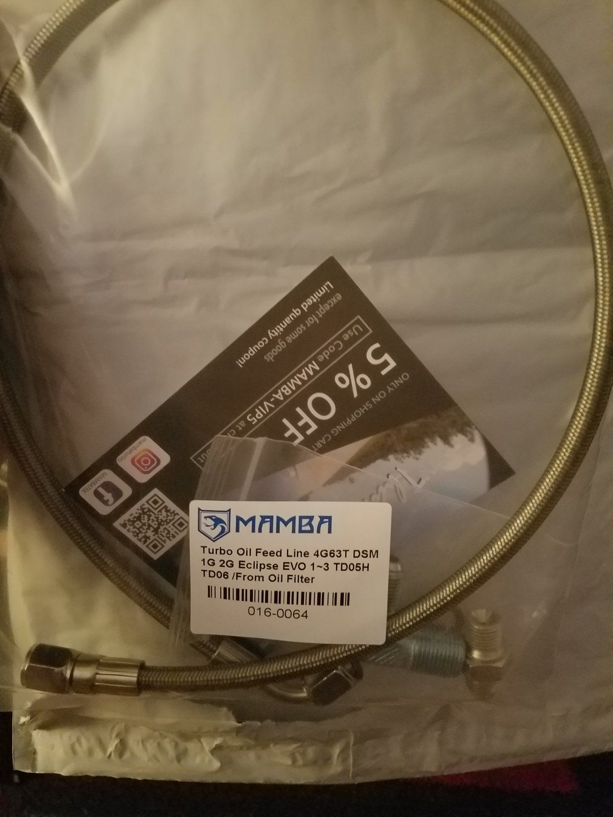

I also had to install a new braided oil feed line because the old one was so hacked up

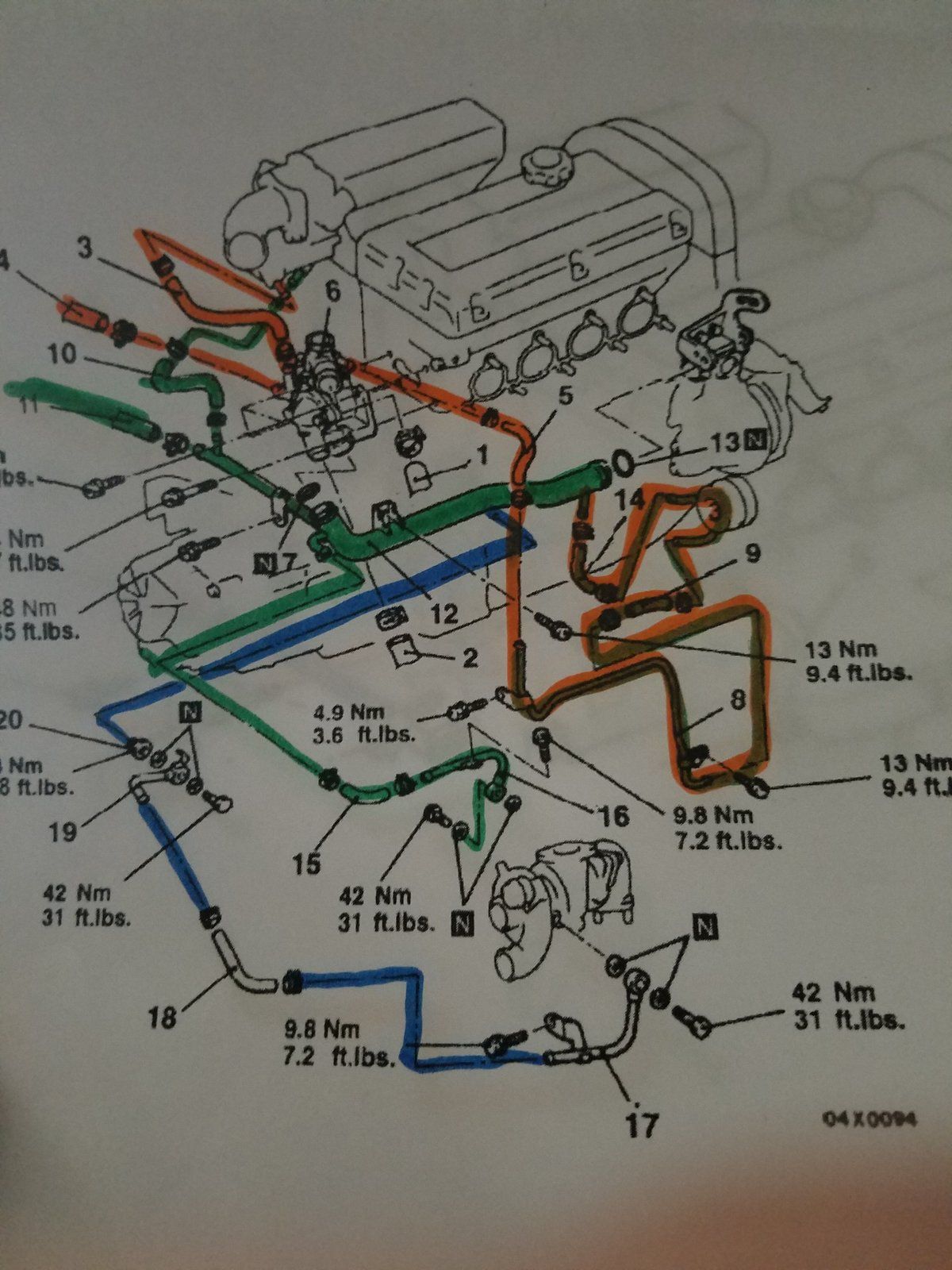

I also had to re bend the cooling lines. Not pictured I had to re do the heater core and flush the system
All of the build up on the turbo was from head gasket repair additive. Nasty stuff

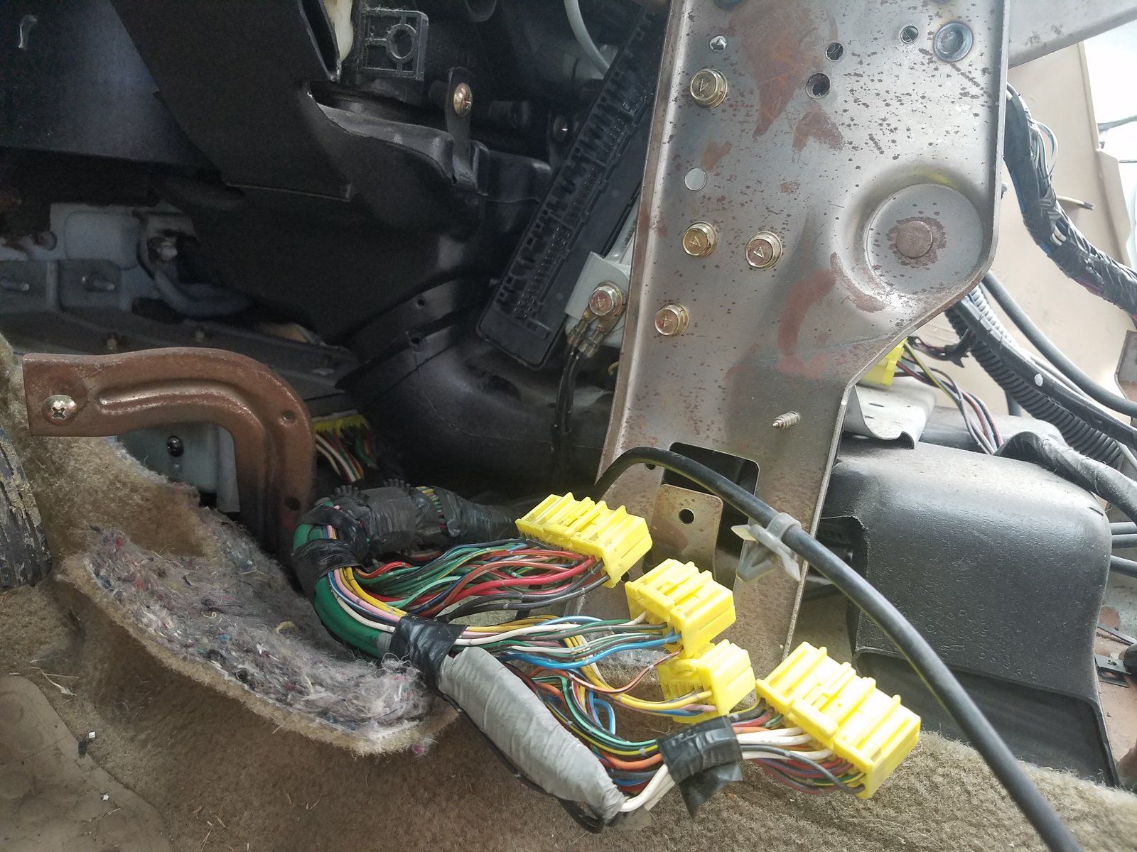

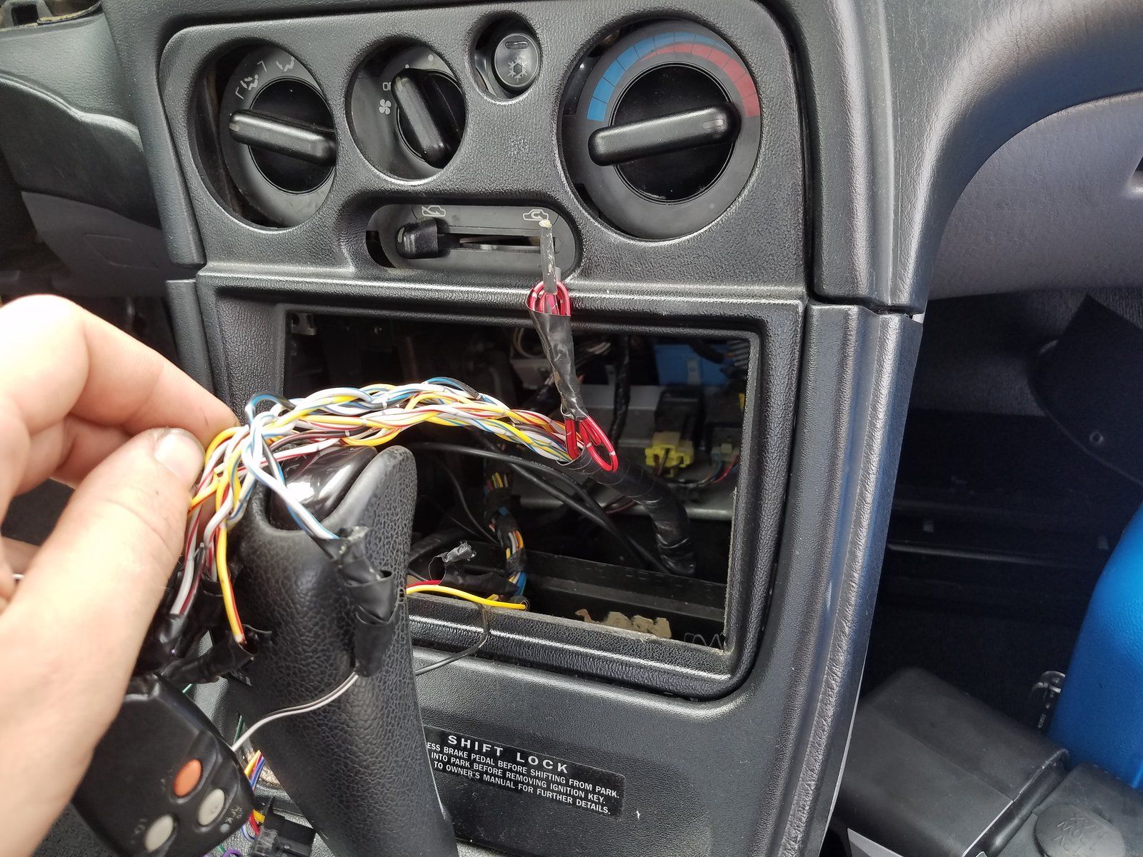

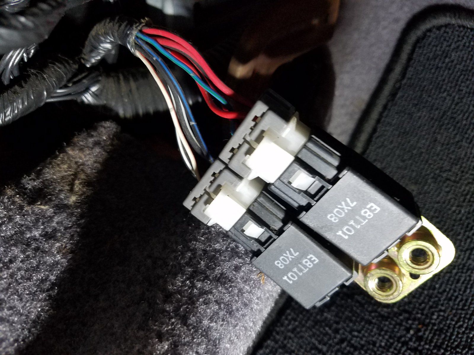

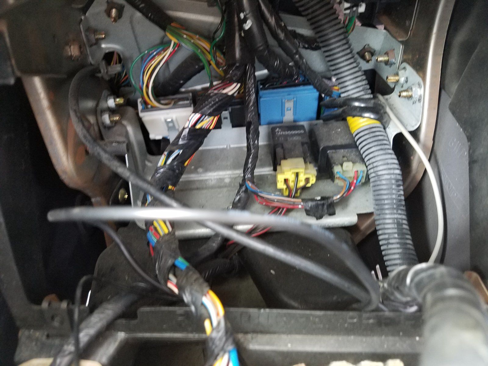

The wiring was a mess in this car.
There was a battery drain and a starting issue. The car would flicker hard with the headlights on, and the alarm was going nuts at random
So the first thing to do was remove the aem wideband, the boost gauge, and remove the radio. It was a rats best

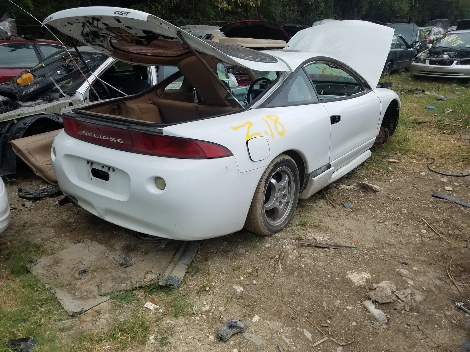

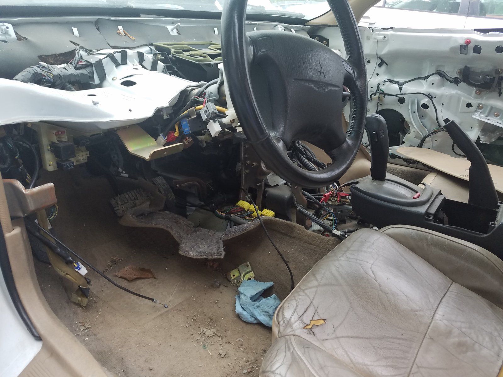

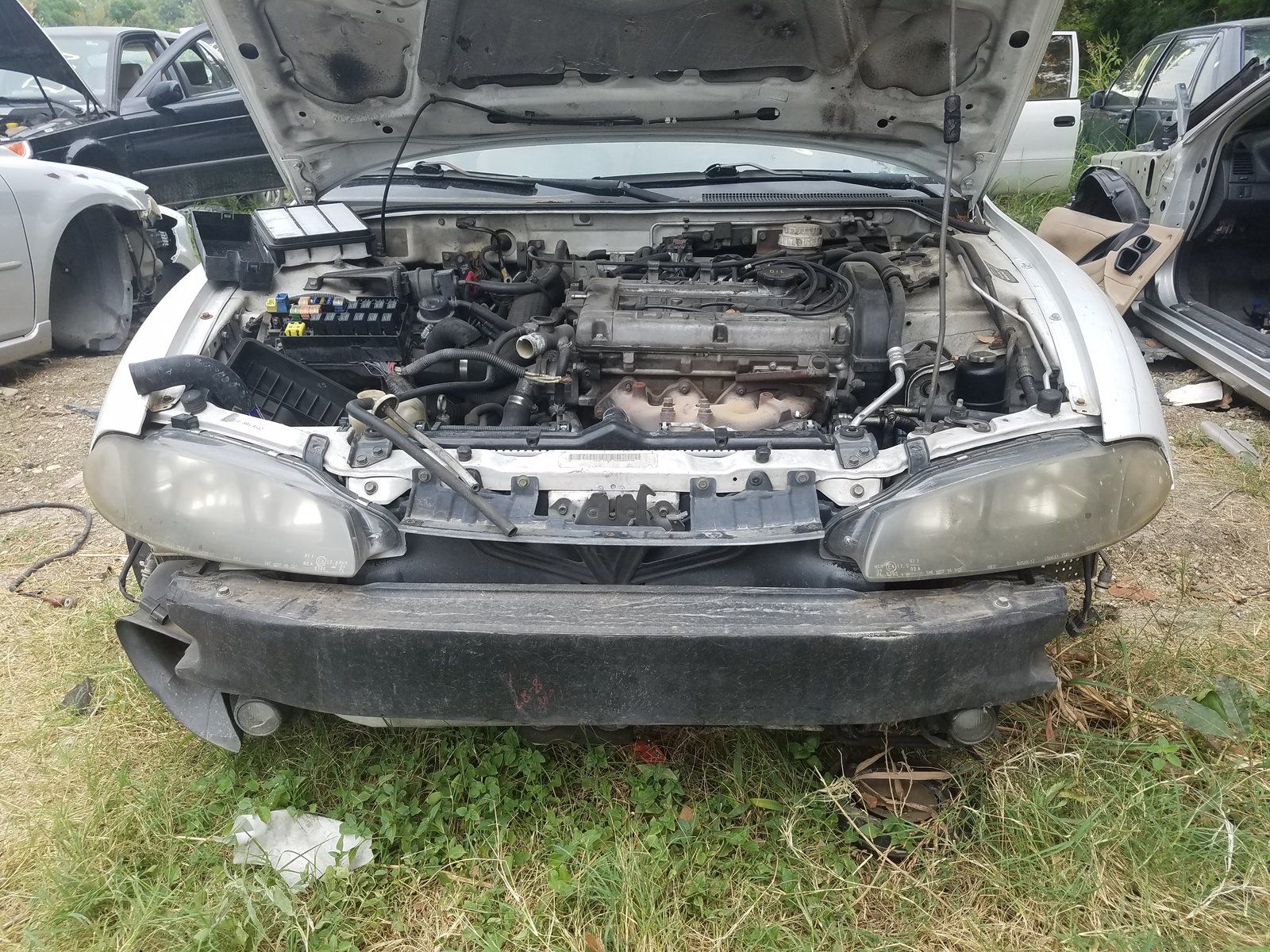

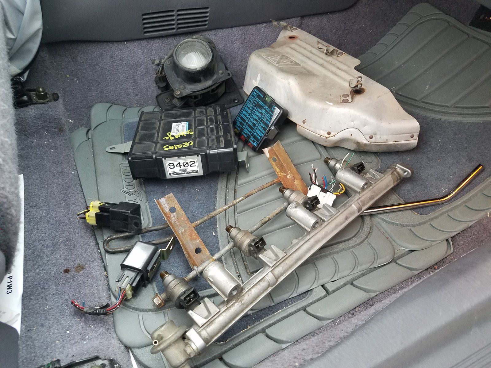

So it's off to the junk yard for spares. Need to find some parts and found a copy of my car
I think my total haul cost me $140. Could have gotten more but it was storming pretty hard by the time I got everything back to the office

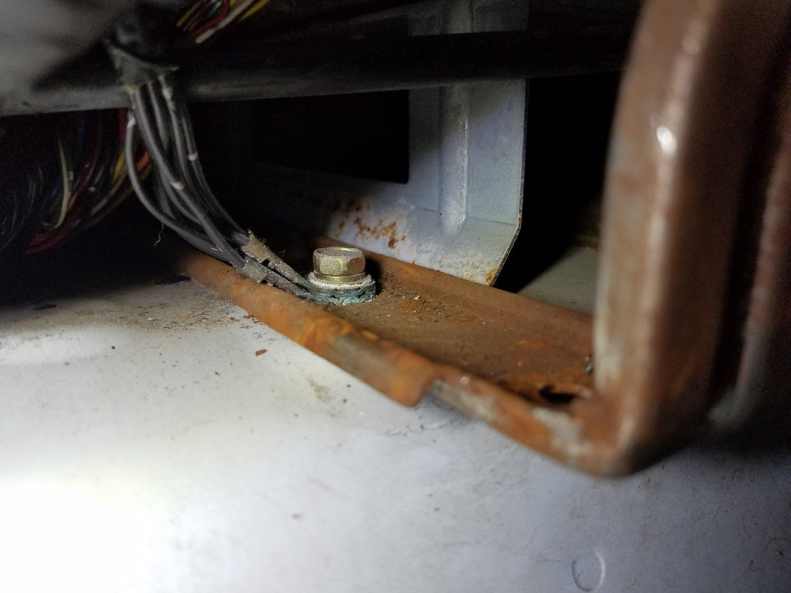

So after installing the ecu and having the same effect I went to tracing. Finally half way though the ecu wire harness I find the culprit, the main ecu ground harness
Almost up to speed on the car. Re wired the entire radio harness using oem connectors from the junk yard. Also put on the battery hold down, fuse box cover, re wired the dash and put in all new light bulbs in the dash and in the exterior brake lights and turn signals. Installed the exhaust heat shield and painted it satin black

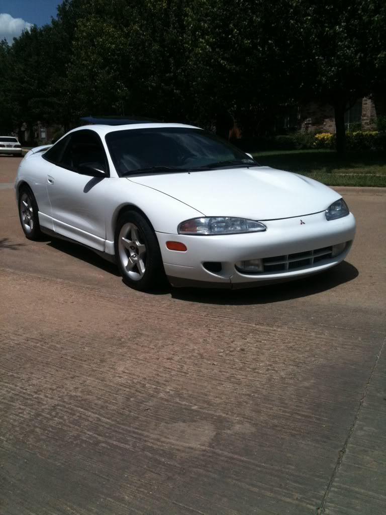

Hard to find them anymore. Have to know some one who knows some one to even find a galant. What was your screen name on Dfwdsm?

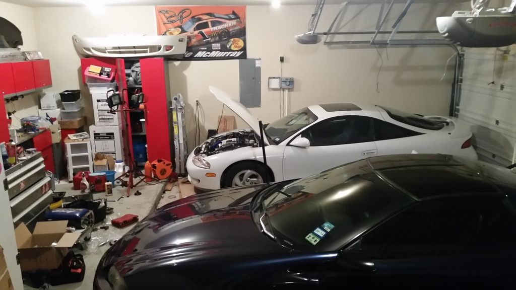

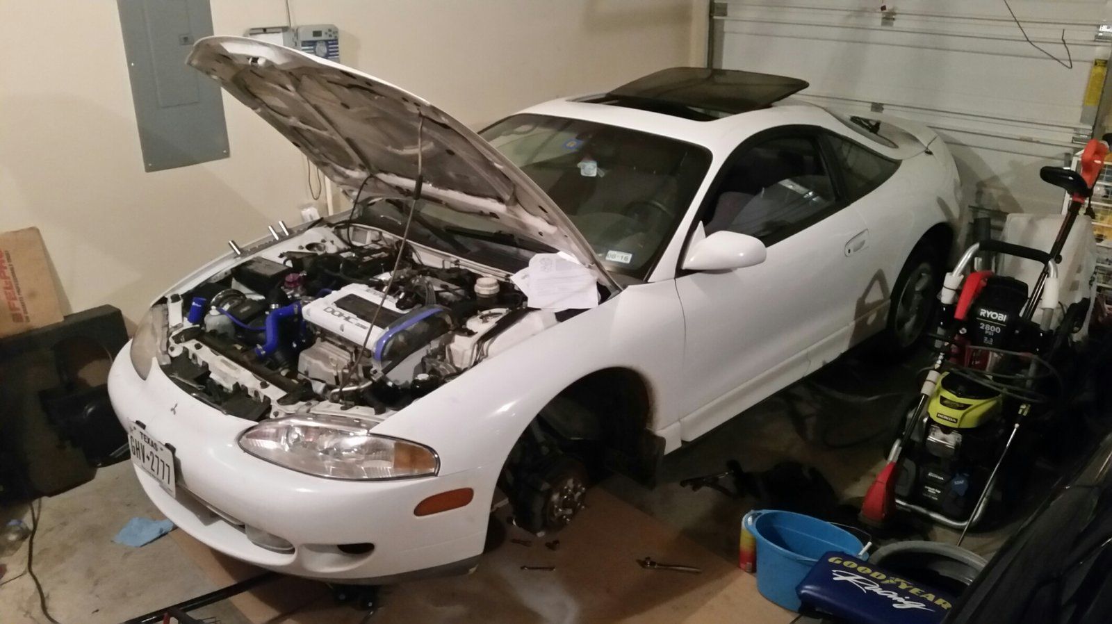

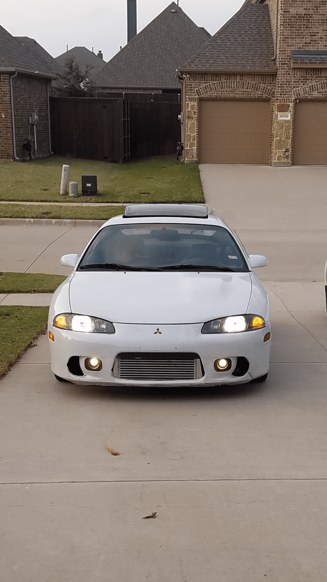

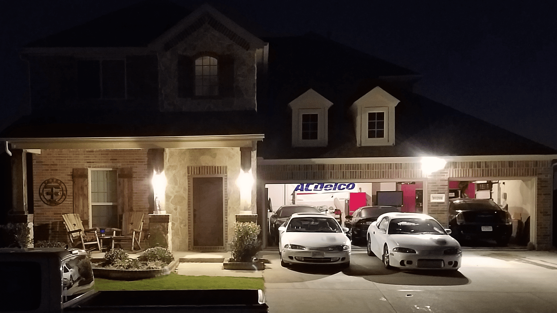

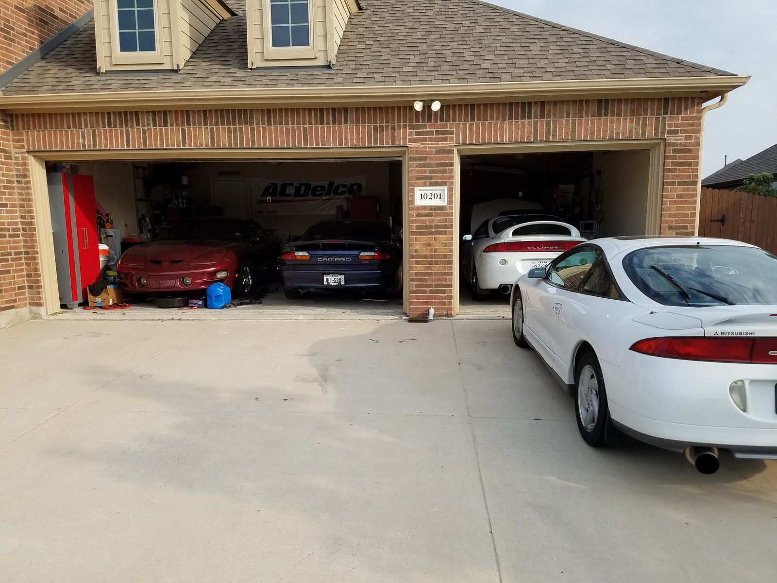

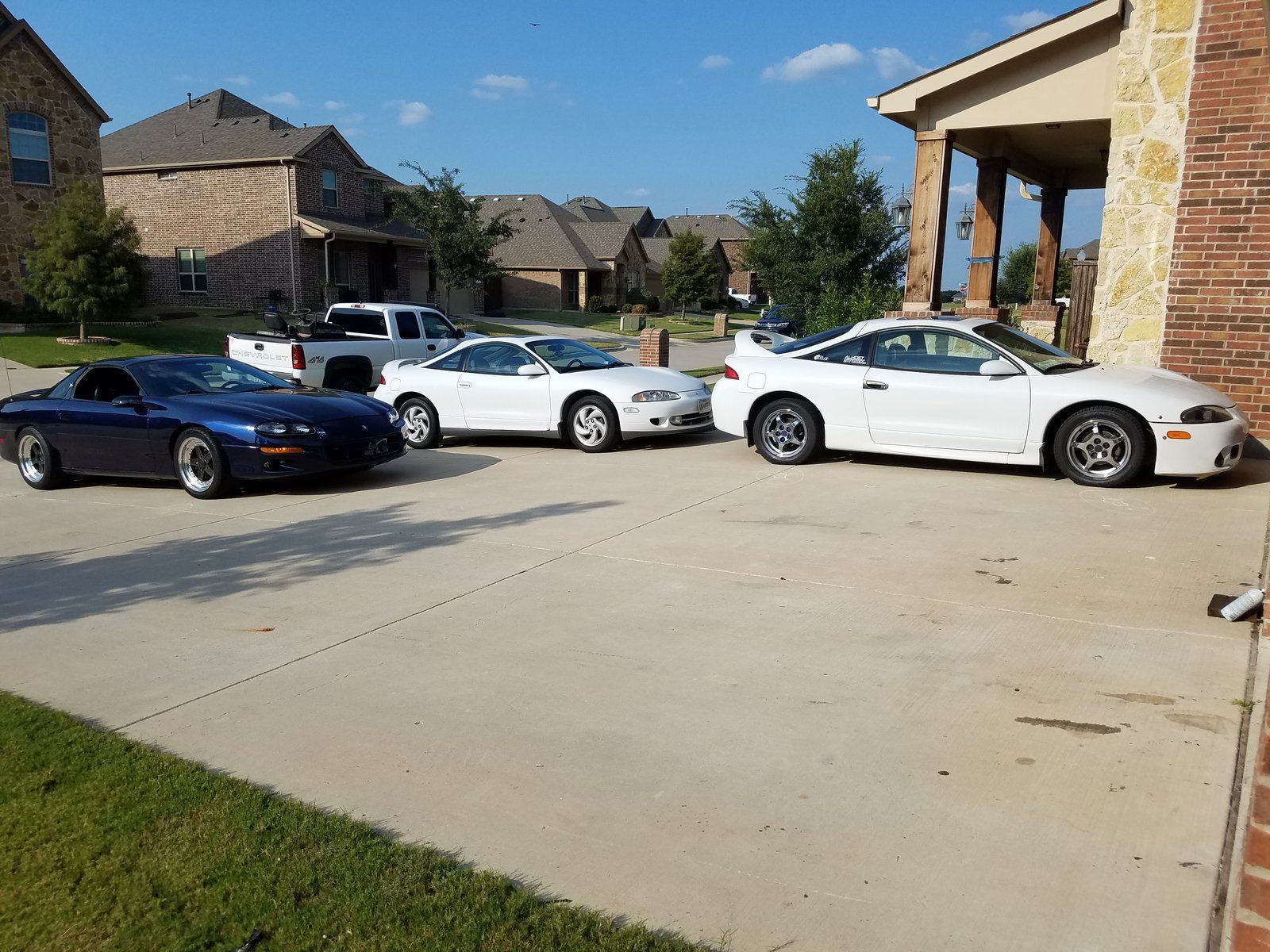

Wife made me clean up the garage so she could park inside. Shot of my car setup. My 2ga is my daily driver stock grandpa car.
Hey look somebody else has a TV in the garage ... my wife thinks its dumb.
Gotta have background noise. Also I completely lose track of time outside in the garage, tv helps me figure out what time it is. :p nothing worse than realizing your back is blown out and you forgot to eat and it's somehow 3am and you're so filthy you can't just fall asleep. Car binge I call it.

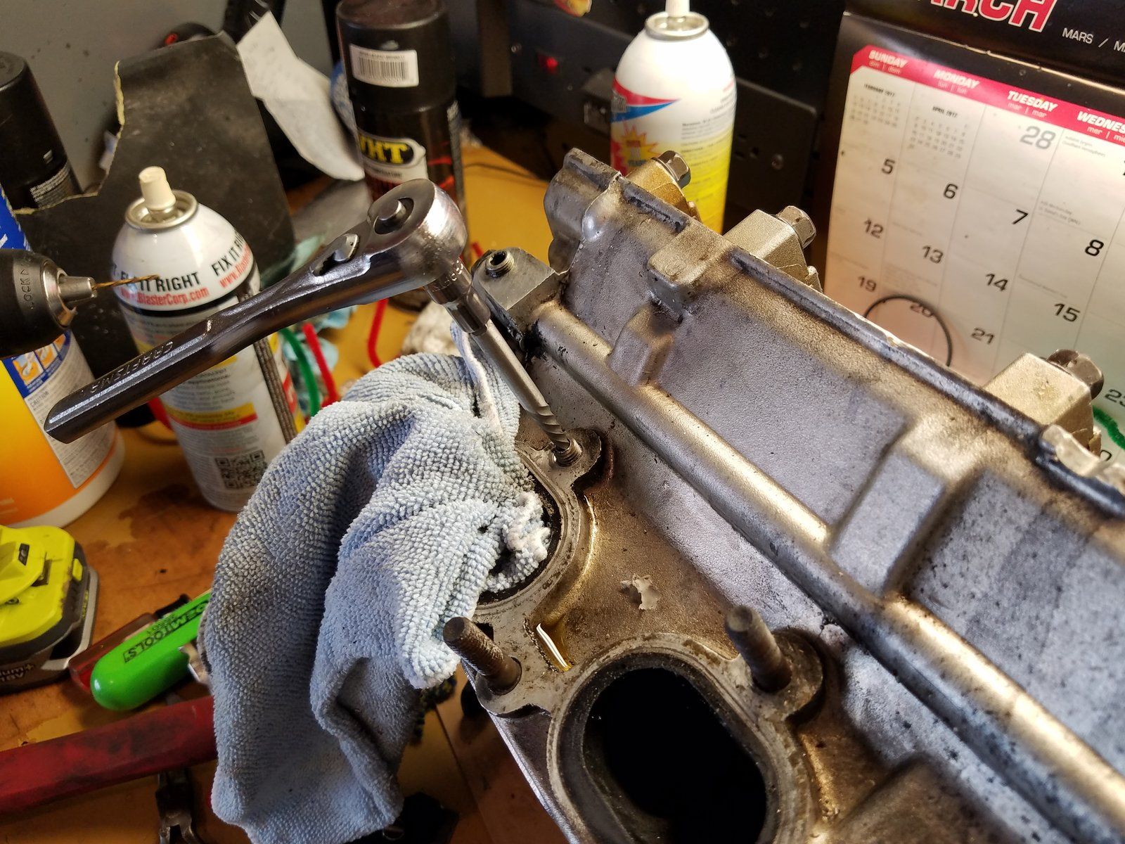

Pulled the entire oil pump off. New gasket with copper spray. Did the oil port mod. New fittings from a local company. High pressure thread sealer on everything. No longer leaking.

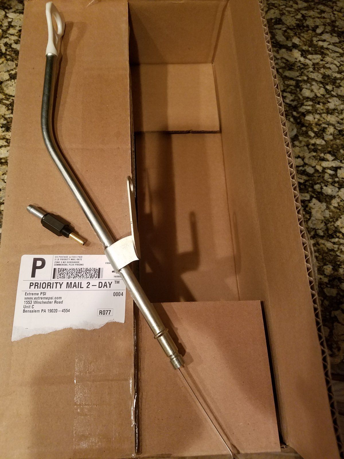

So about blowing oil everywhere out the valve cover, the pcv valve was bad, it would seal when I blow in it, but it would leak pressure. Car was missing the dip stick, looked like it broke or popped out and got lost, and had a cap, fixed the valve cover and blew the cap off.
So anyways new pcv valve, and ordered new dipstick and pipe. Blech, add another $50 to the parts list. And before you ask why I had to buy a new one, because a used one shipped would have probably cost me $30 anyways. Dsm parts are rare down here, the white junk yard car has had the motor removed and they only want to sell it whole now with turbo

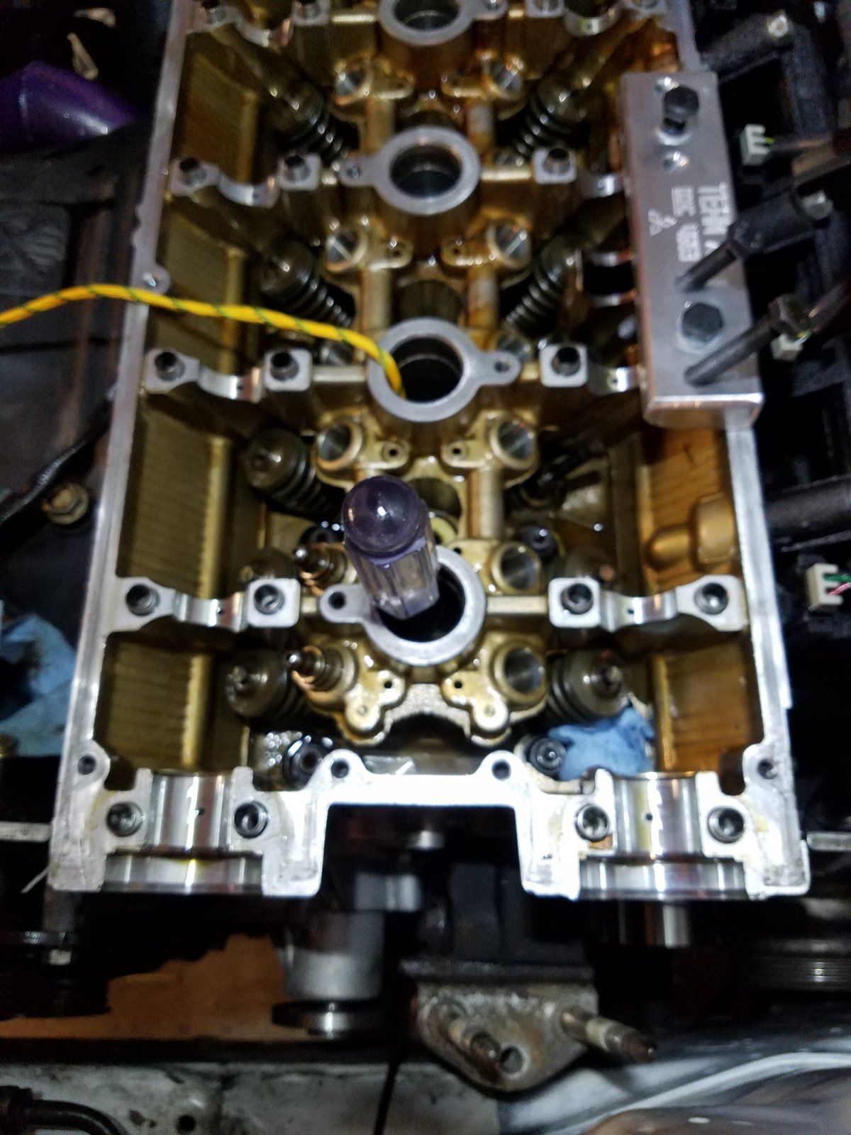

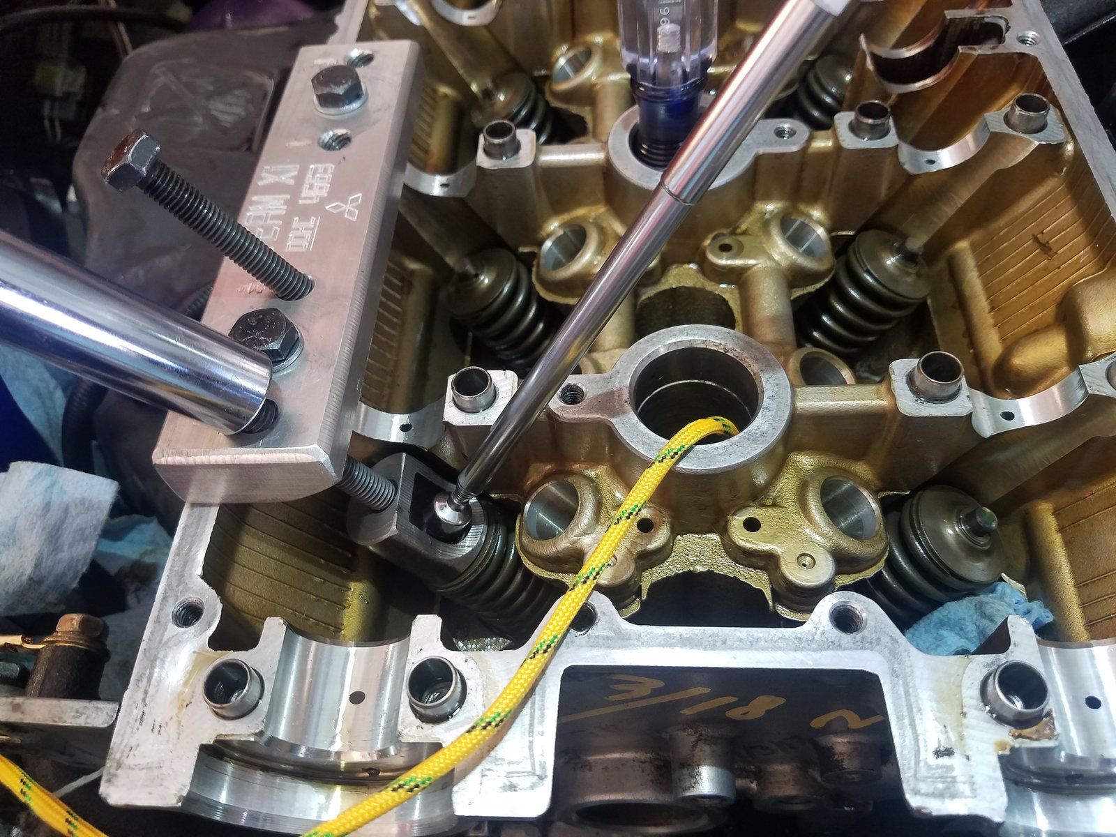

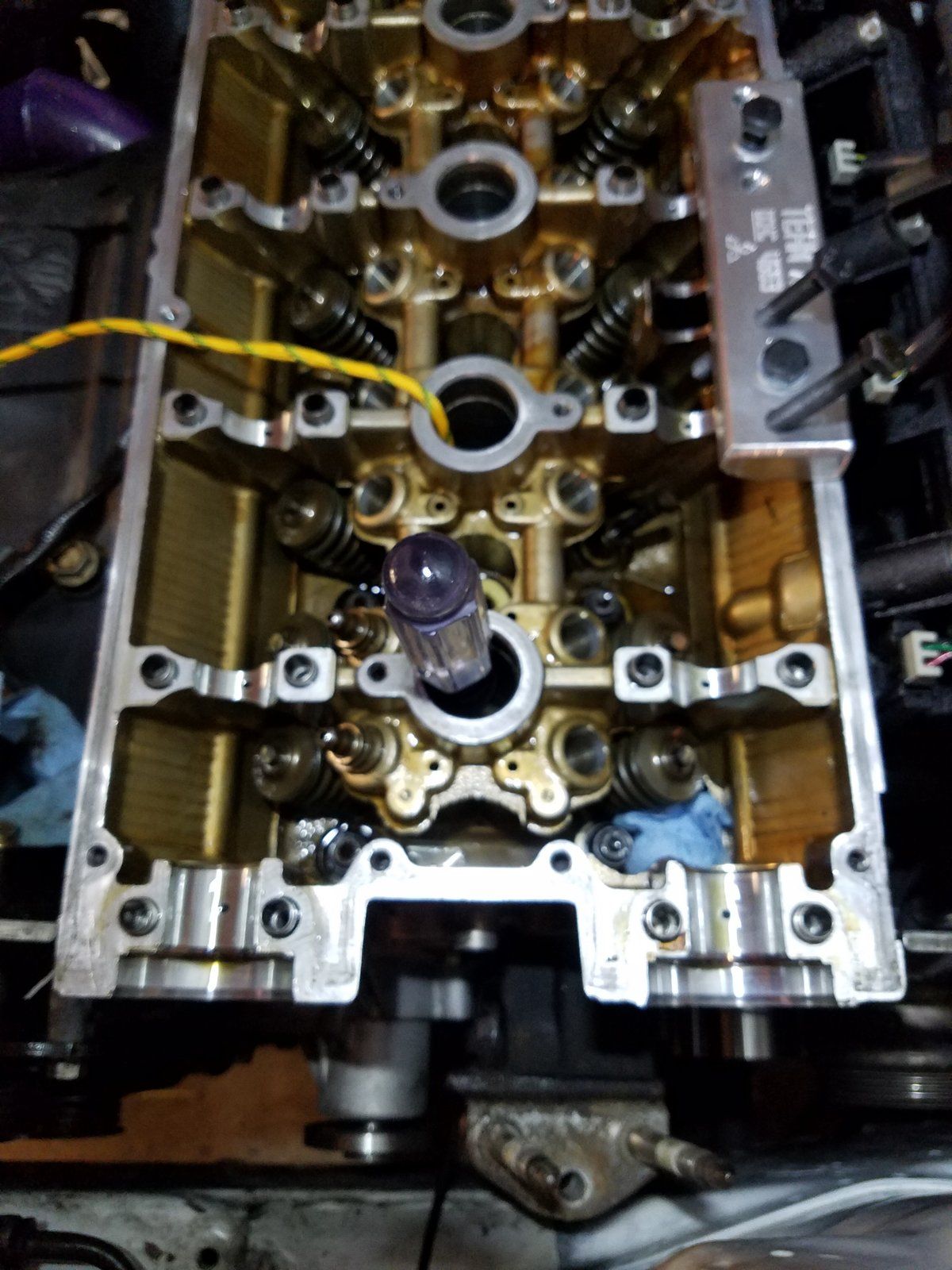

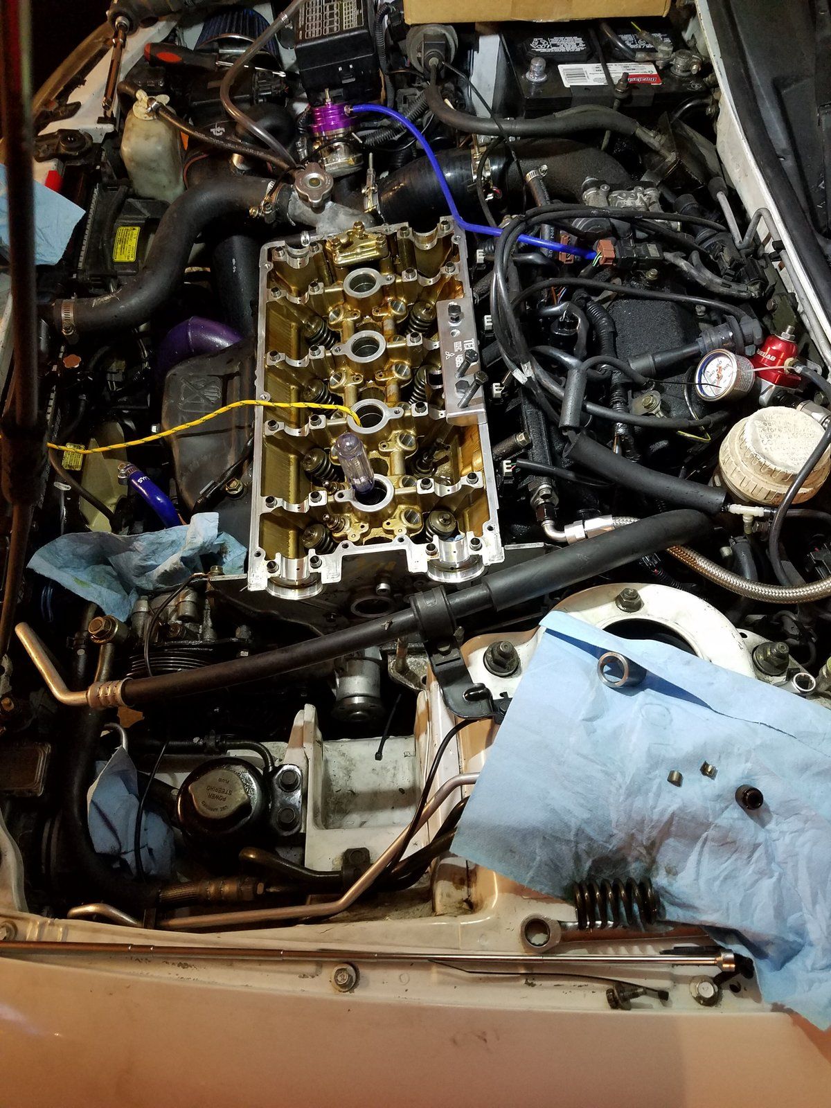

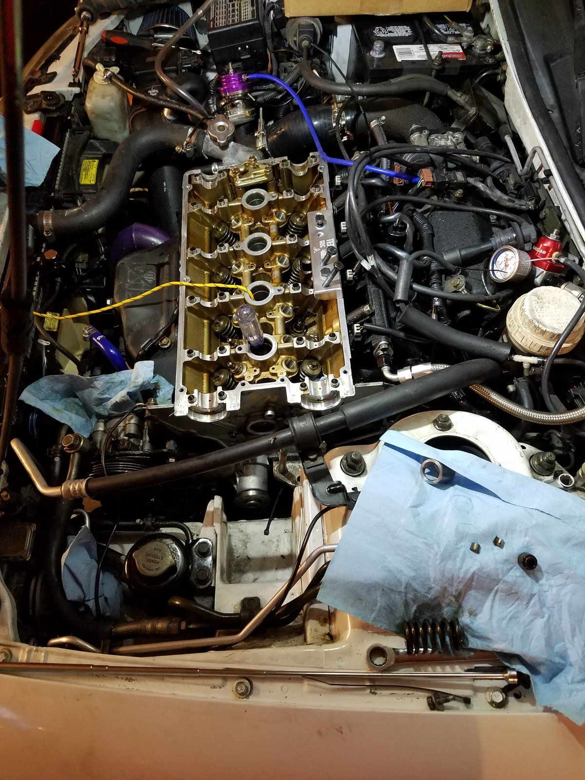

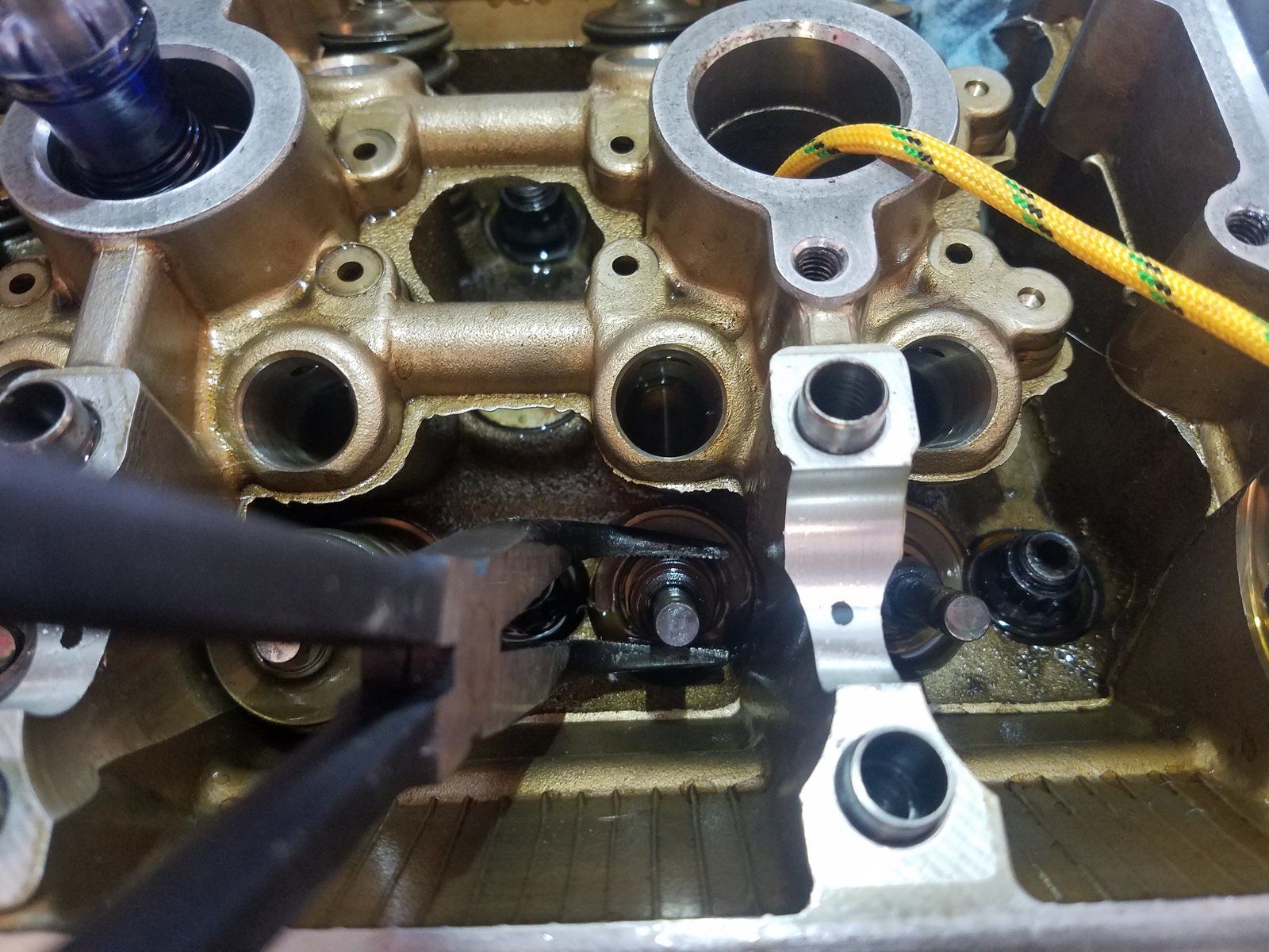

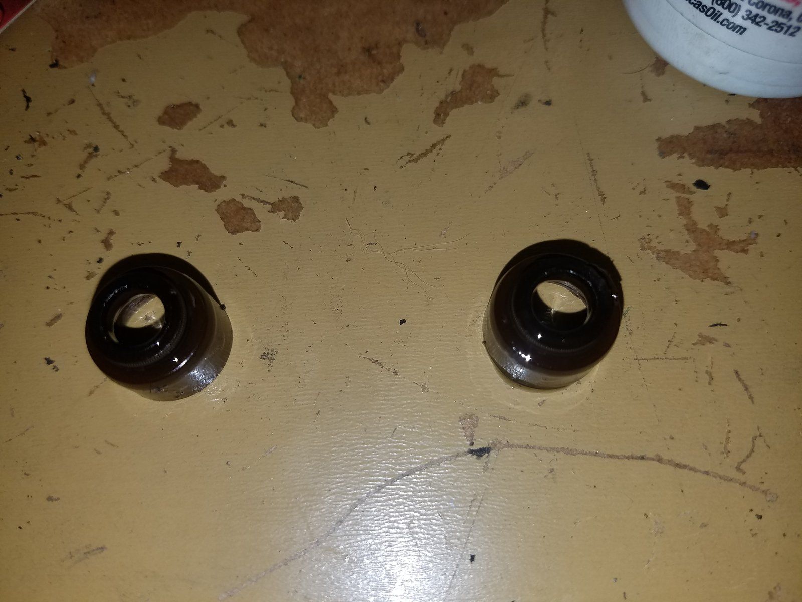

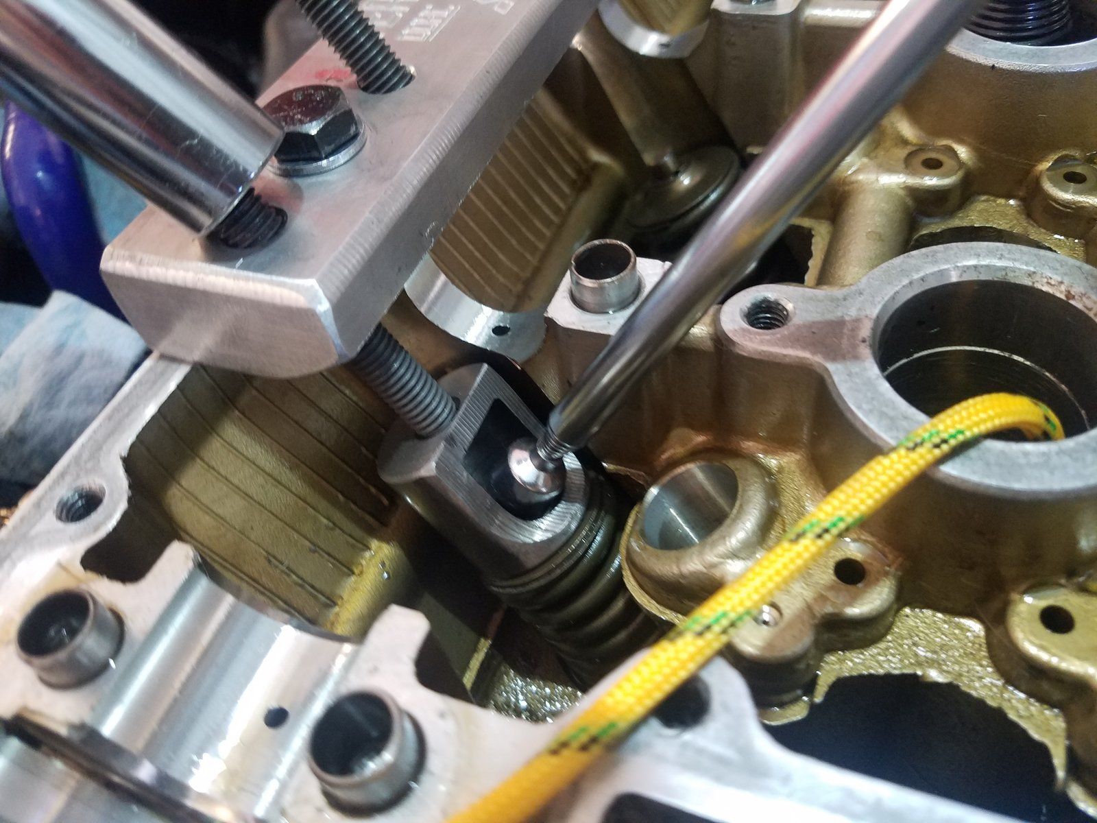

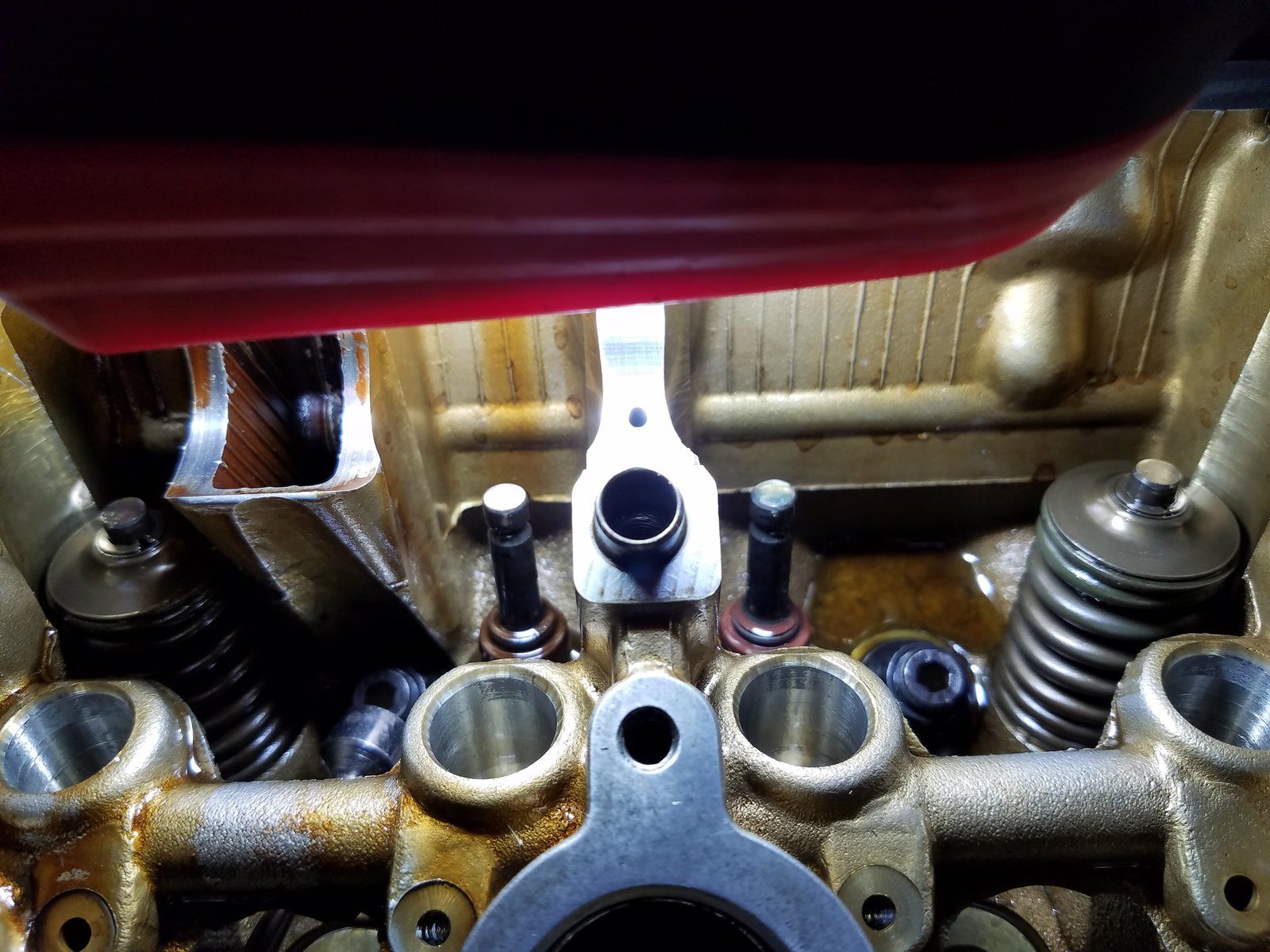

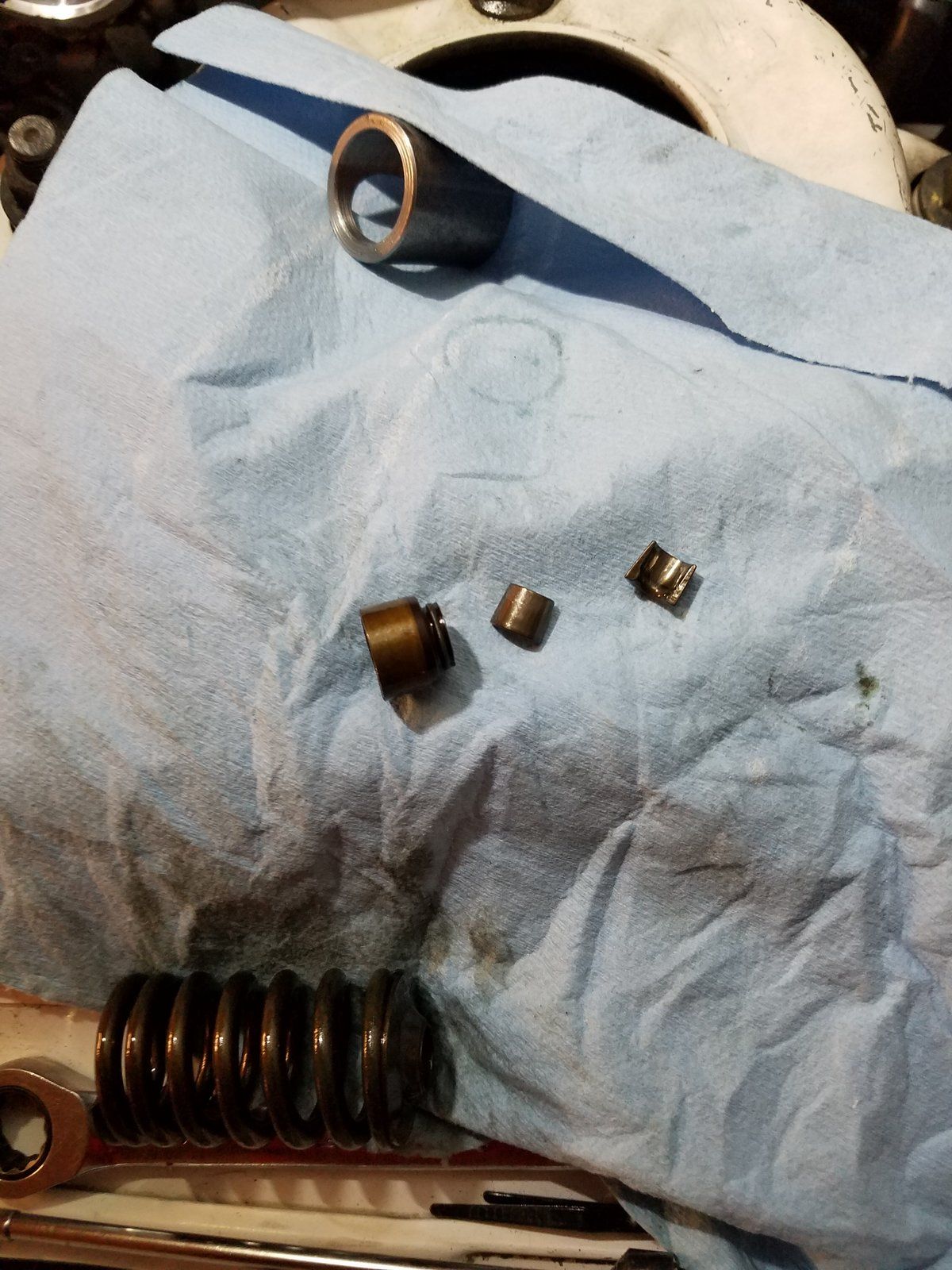

On to the valve seals. Old ones are pretty hard and brittle. Hopefully this solves my smoking when warm, or extremely cold problem.
And the old discolored seal vs the new seal.
