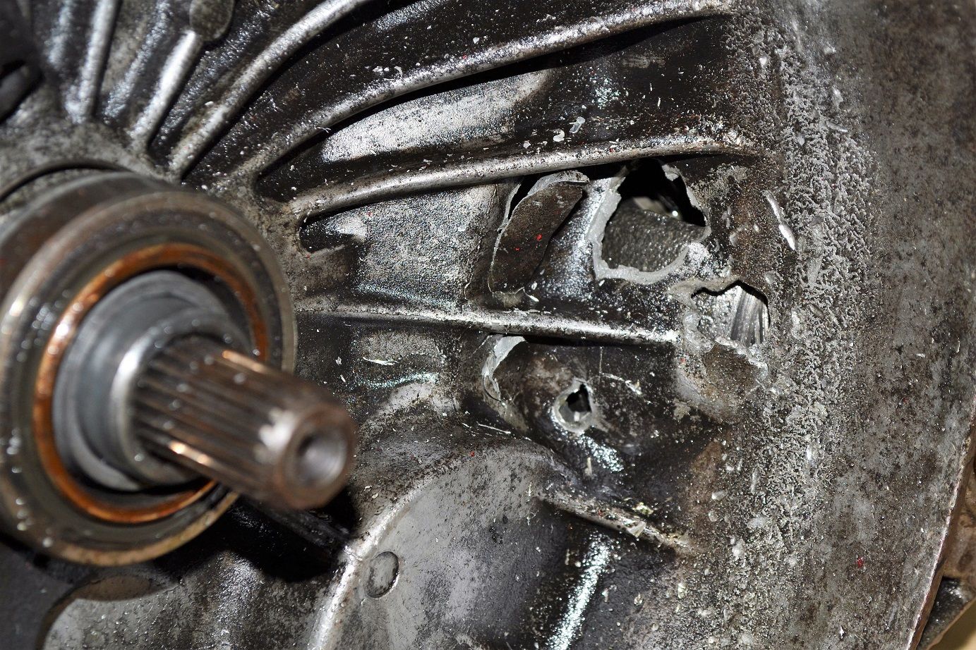

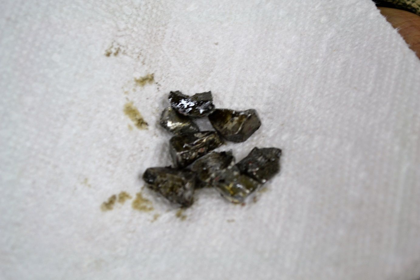

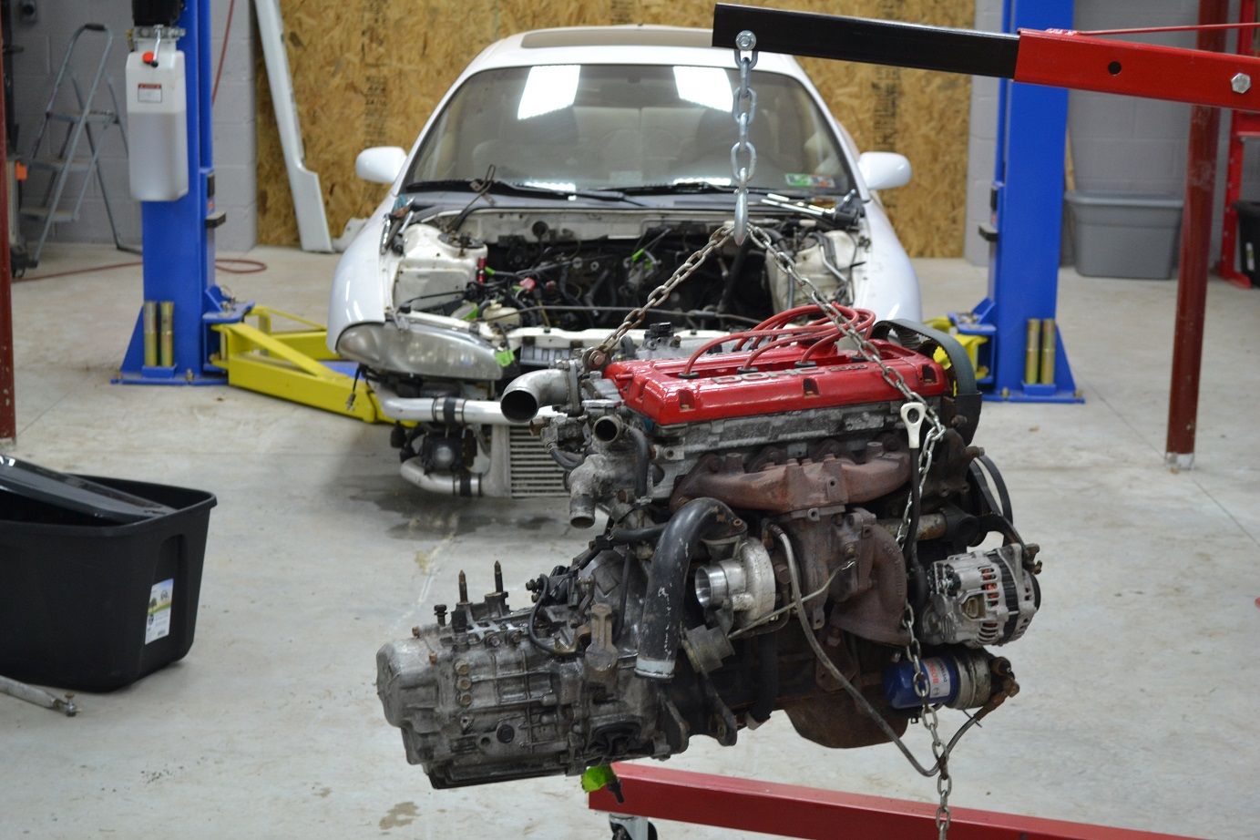

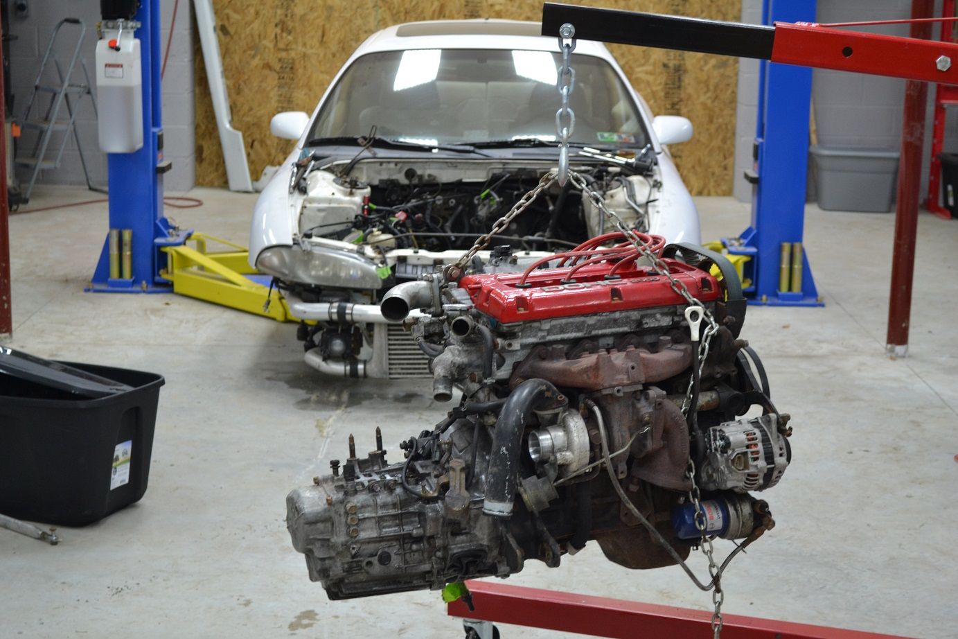

When I bought this car, the owner said he was hot rodding a bit and had tranny fluid leaking when he parked it. I pulled the tranny today to find this, trashed from the flywheel back with big chunks in the case exploded from the inside out. I believe it to be a result of too much HP without a tranny beef up. I do not know if I will rebuild this tranny or buy a used one but I need to know if there is a company I could order parts from to beef this thing up to handle the horse power...any responses would be appreciated. I know it will cost me some coin...you have to pay to play.

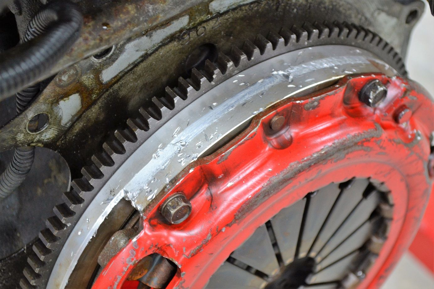

Looks like you have a nice South Bend clutch and lightened ACT flywheel so that's a good start. I don't know why that bell housing would break like that. Maybe wheel hop or something?
Well I got it on my work bench and will tear into it. By the looks of the piece of bell housing that is cracked but still connected, it looks as if something broke inside and was trying to get out since the piece is protruding outward. The flywheel is a Fidanza and I might be able to clean it up enough to use it. The face of the flywheel is still perfect. I am however having trouble finding internal parts that are high performance. I could replace with OEM but then what guarantee do I have that high HP will not tear it up again? Any advice on this would be appreciated.

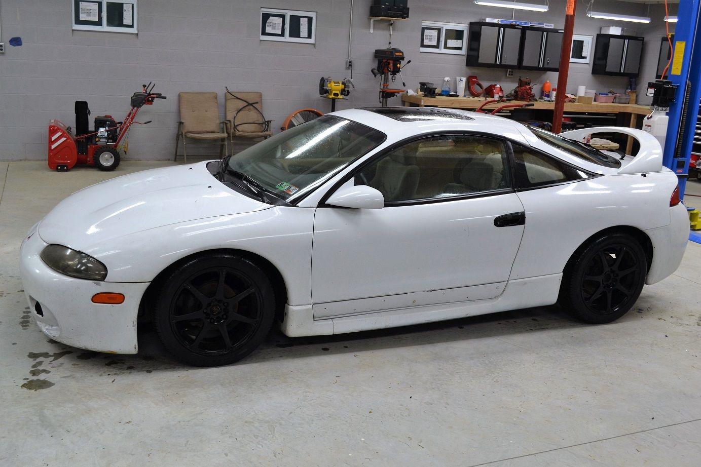

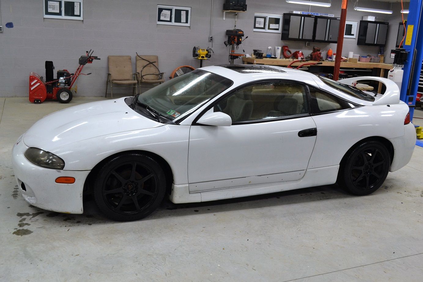

I bought this G2 for the wife and plan to restore it to like new condition. I found already that working on this car is far different from the American muscle I am use to. A full body restore and engine hop up is in the plans. I will probably have a million questions as I go along thus is why I joined this forum. I will post my progress and with all of your help hope to give the wife a ride she can be proud of. I am working out of a 3000sf hobby garage I recently built myself and plan to add on a 2000sf body and paint section by the end of the year. A custom paint job is also in the plans for this little street racer.
View attachment 324943 View attachment 324942
Looks good! I'm doing a 99 GST restoration myself but uh.. mine looks like I pulled it out of a lake hahaha.
Luckily it's rust free so body and paint and of course built motor and stuff and she will be right.
That thing is clean I wish I could have found one in that condition. Good luck!
