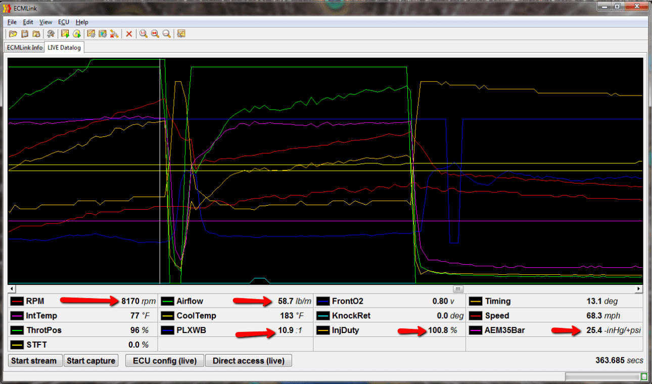

motor is really tight, runs well. I'm not really tuning much more out of it at this point, since my injectors are 1000cc & at 48psi base, I'm running 100.8% duty cycle and that's not quite at redline (car is now healthy to 9500, log was breaking up at 8100). Still healthy AFRs and the car seems happy so :idontknow:

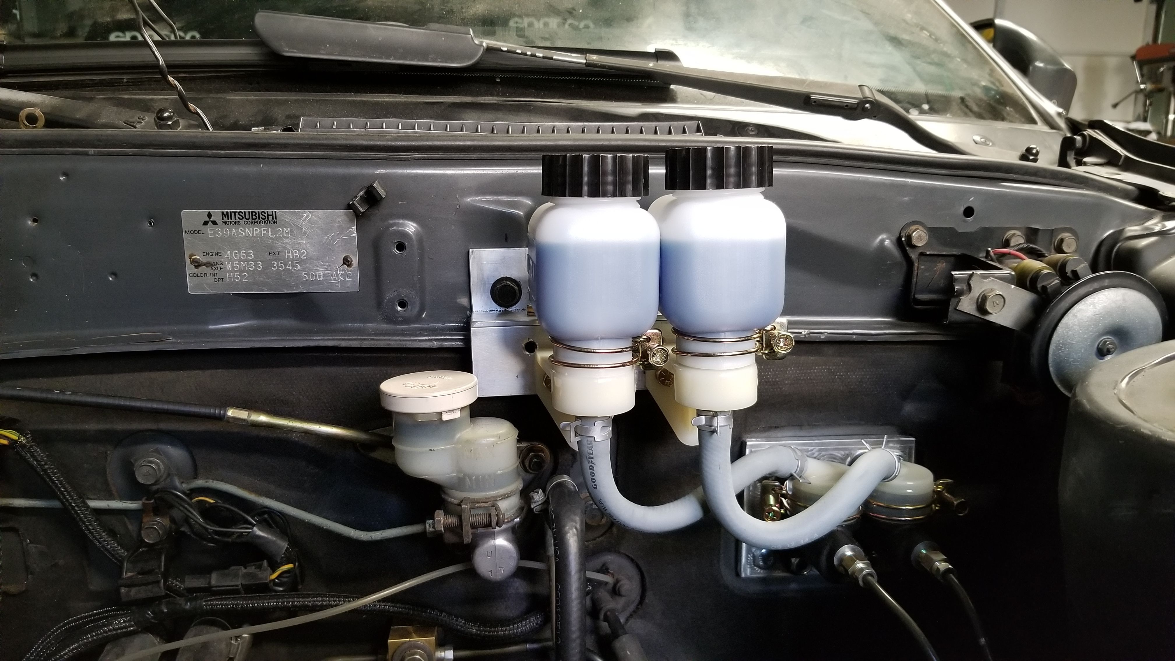

Also converting to a manual master brake setup, using twin Tilton MC's and a Wilwood balance bar. Hoping that turns out the way I want it to, but I'll probably hold onto the stock lines, prop & master until I decide I love it, before I sell them, just in case. :D

So I haven't done a ton in the last two years, partly because when I made the last post I had a kid who was under 2 months old, and life got busy. In the meantime I did a gut to the studs/rafters/joists remodel of my main bathroom... Y'all know how it goes.
In any case, the brake upgrade is done, and I'm adding a pic to this post, but the whole set of pics is on imgur and I don't feel like reposting, so click here
Finally, this setup is probably not easily duplicated, and realistically, the benefits versus something like an Ostar setup may not be huge- and that's cheaper and less complicated (and basically bolt in), so YMMV.
There's some interesting tech stuff I've learned throughout this though:
I will say, for anyone staying on power assist brakes, or going to the Ostar setup Craig has (liv4psi/mygsx2120), an adjustable bias valve (especially with a remote to adjust from the cabin) would be a big upgrade over the stock proportioning valve. Wilwood proportioning valve with remote bias adjust (definitely cheaper on summitracing though!). You'll also need one of these bad boys to handle the rear lines since there are only 3 output ports (2 front, 1 rear)
From talking to a few folks with adjustable bias on their racecars, generally you adjust bias towards the rear until you start getting rear lockup under hard braking, and then you adjust back towards the front a bit. It should result in getting the absolute maximum braking performance you can, since you're not under utilizing the rear. TBH, other than having to build lines (either SS or hard lines) to make it work, that's not really any more expensive than an OEM ABS delete, and you get a big performance perk IMO.
