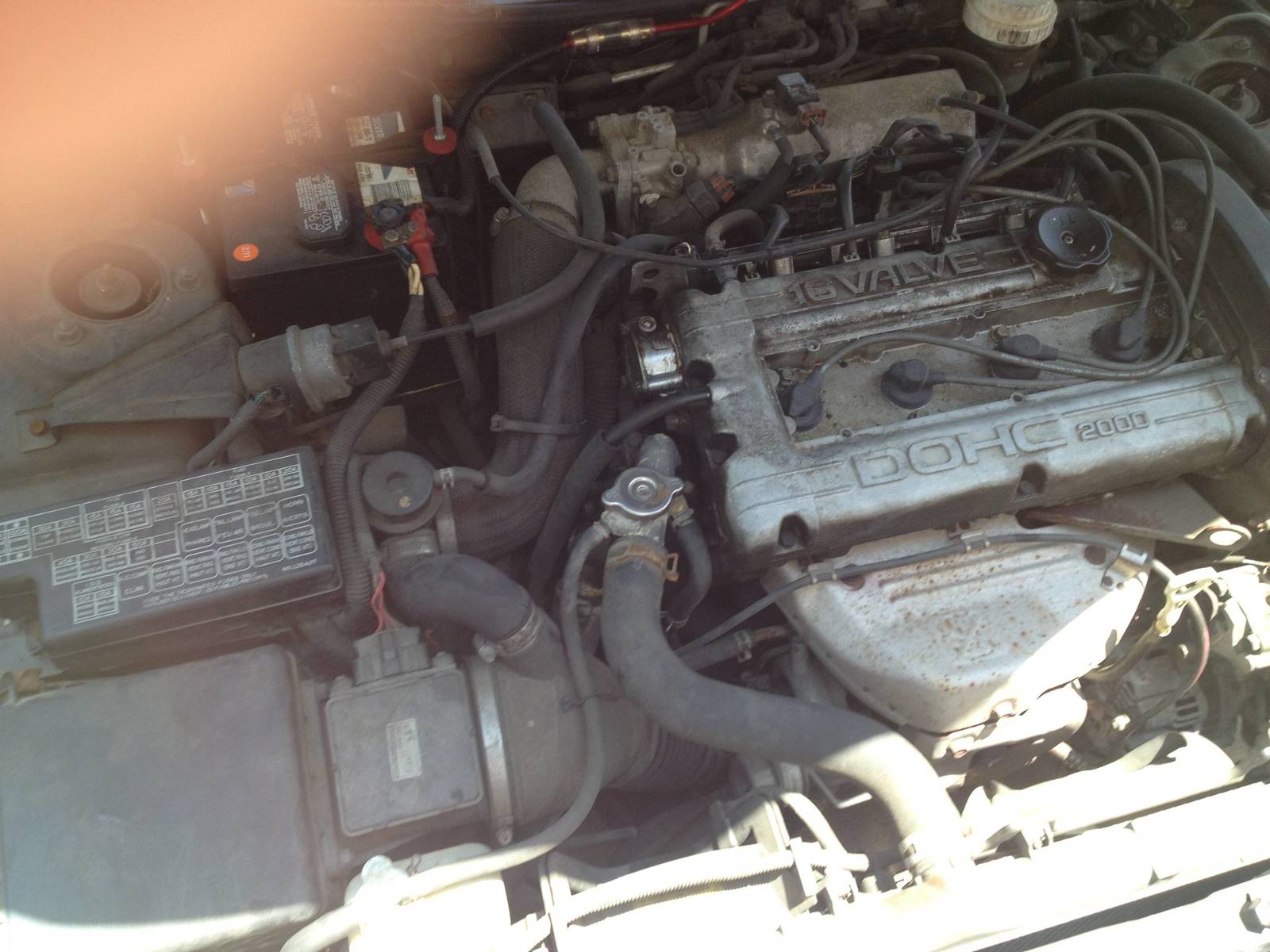

Well after I got her home and started taking a look at her I started in on the tune up.
SO FAR:
New spark plugs
New Mobil1 Oil Filter
New Mobil1 Oil
New air filter
Fresh coolant
3M Headlight restoration

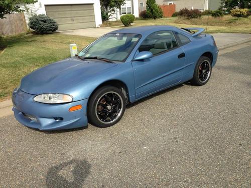

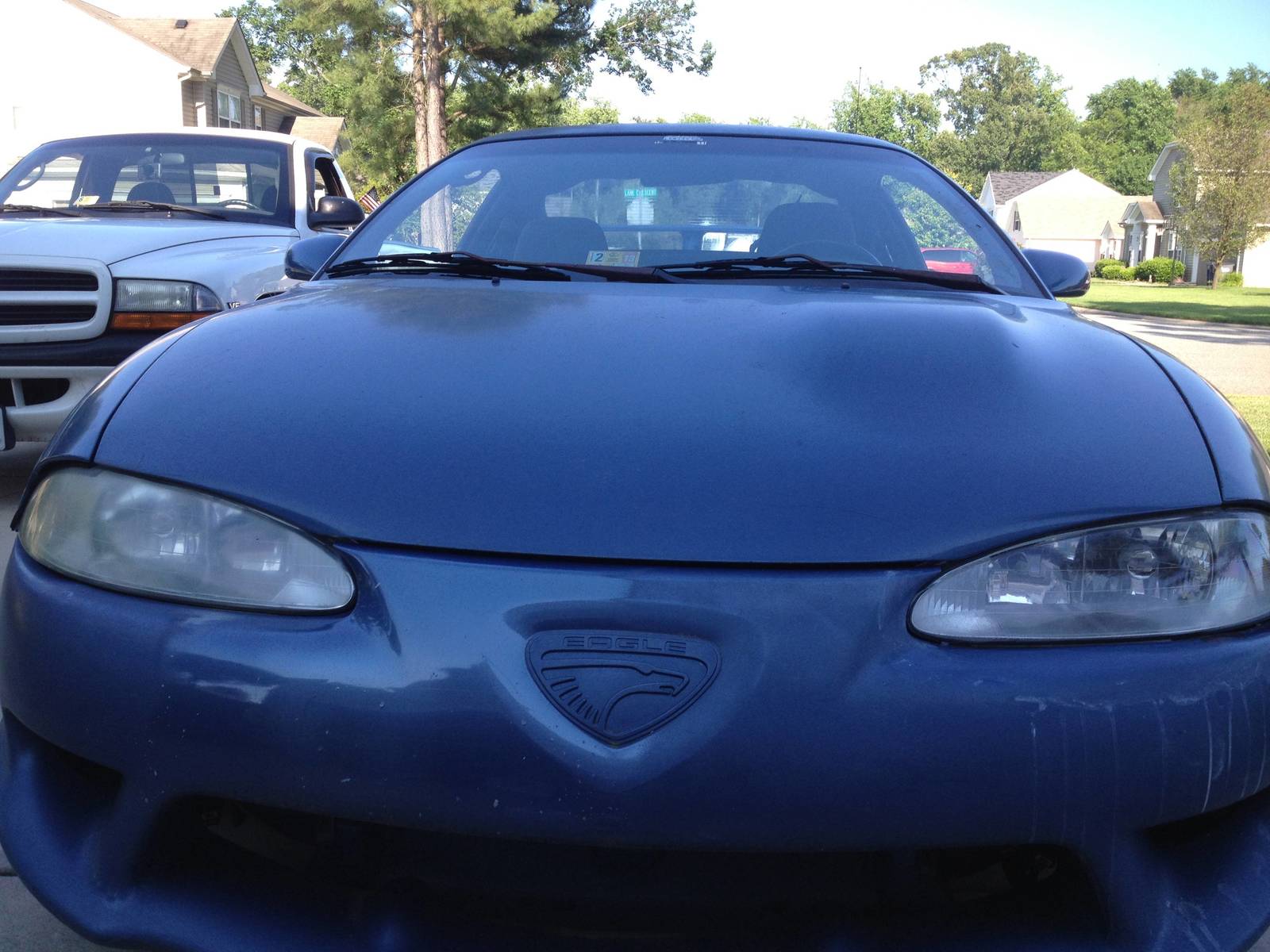

Passenger side (before) - Driver size (after)
Both Sides Done

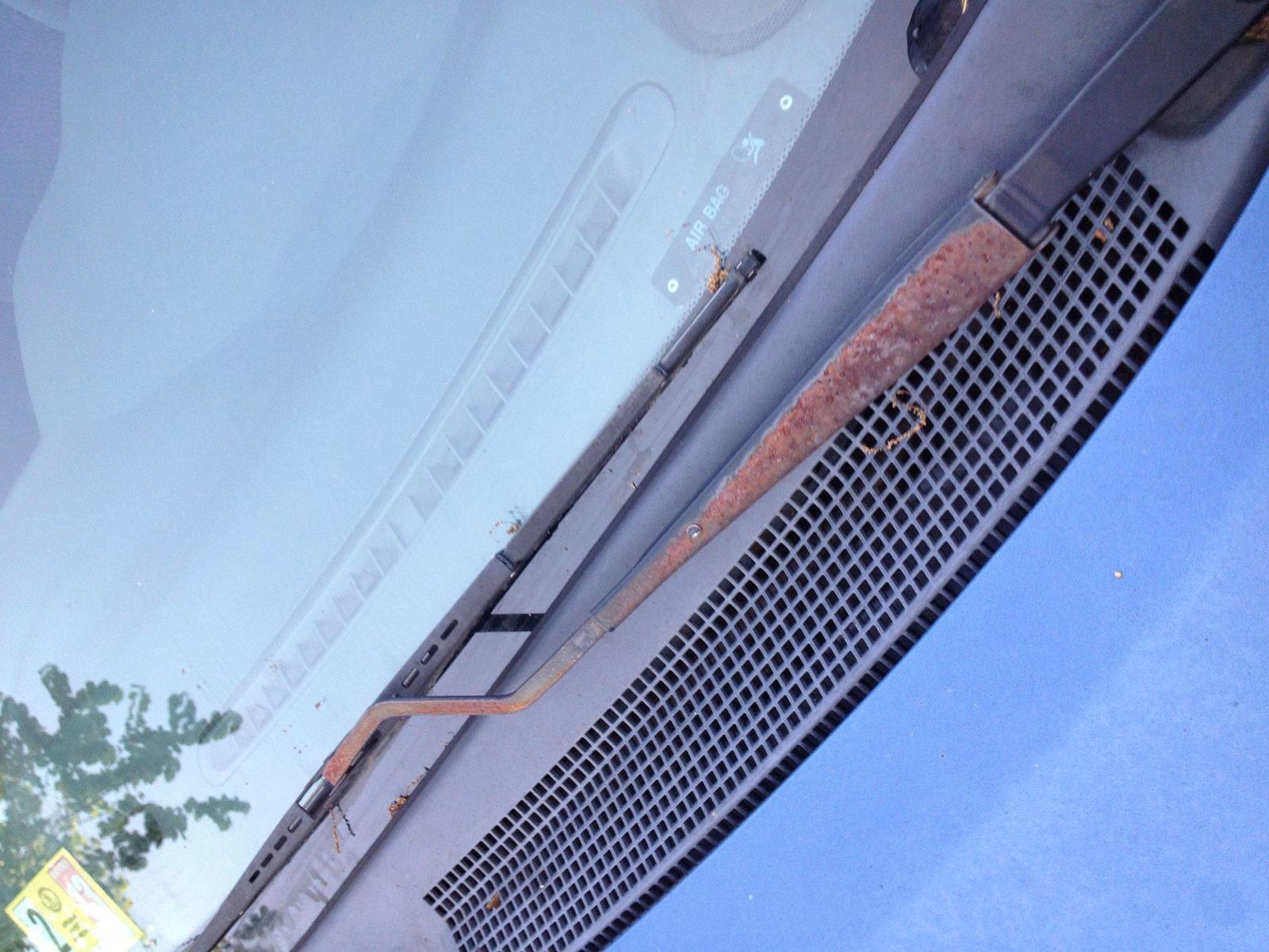

Wiper arms in not so good shape

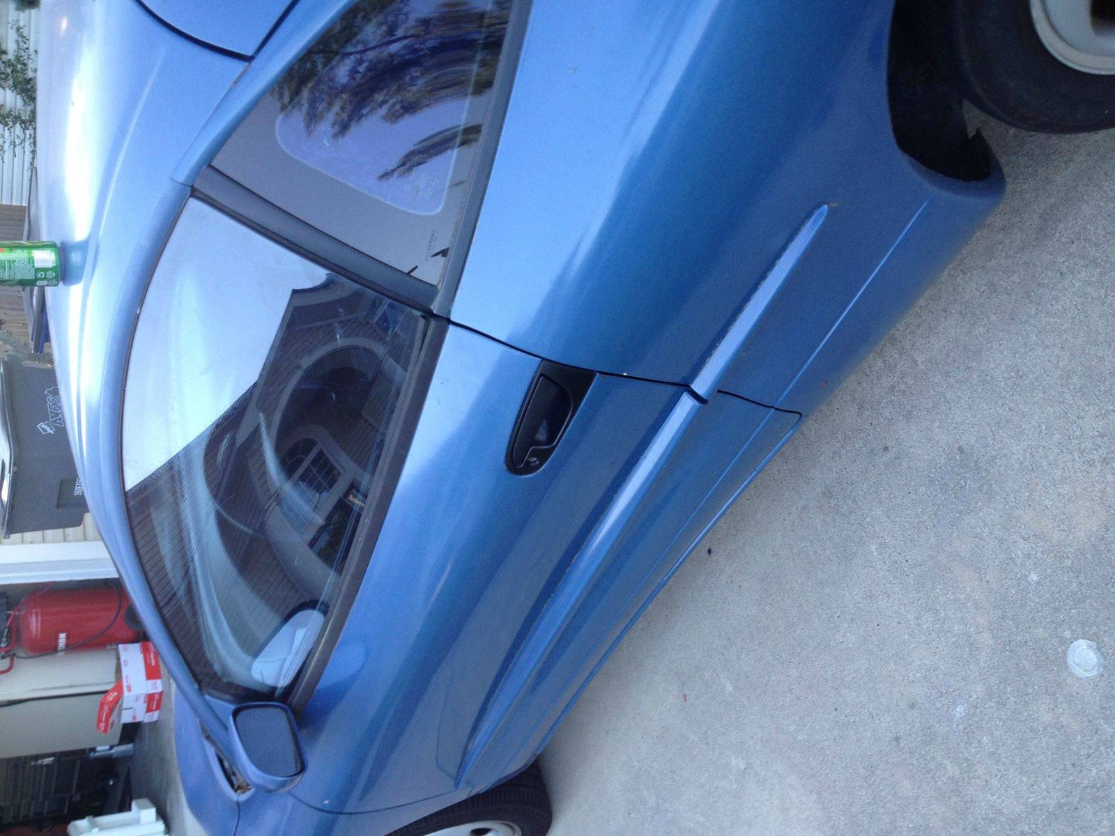

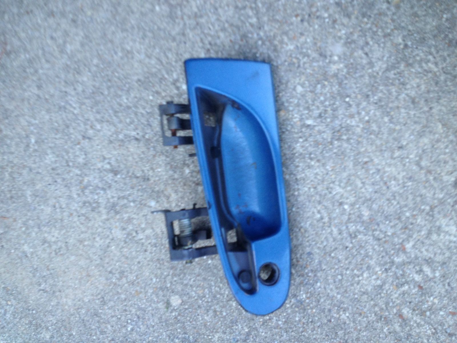

New door handle on
Old broken handle

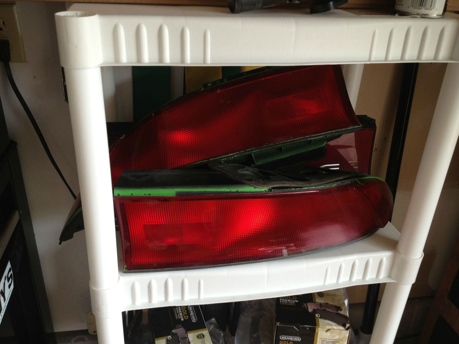

Got to the junk yard a few days ago and it was "so so" successful. I manage to get a few Dodge/Chrysler coils, 2gb rear bumper, and eclipse tail light assembly.

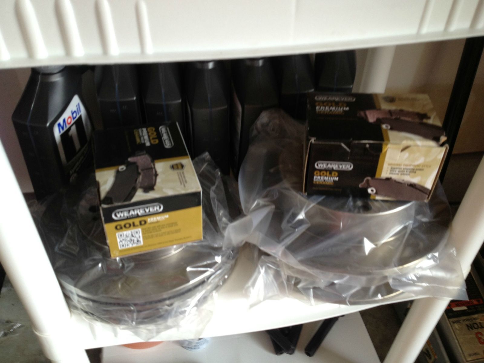

I have also purchased all new blank rotors and new pads. Then while searching CL I managed to find a guy selling a 2g front steering/ suspension set-up (Ball joints, UCA, LCA, and outer tie rods) which I managed to pick up for $150. Then noticed he had a spare valve cover, So picked it up for another $10.

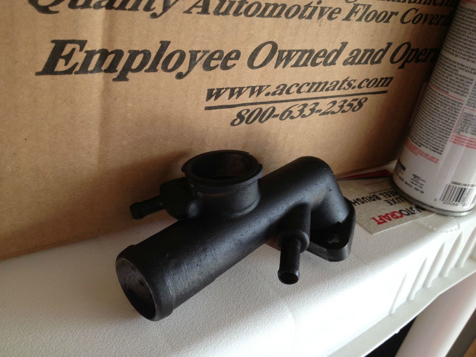

Also Picked up a new water neck
Pads and Rotors

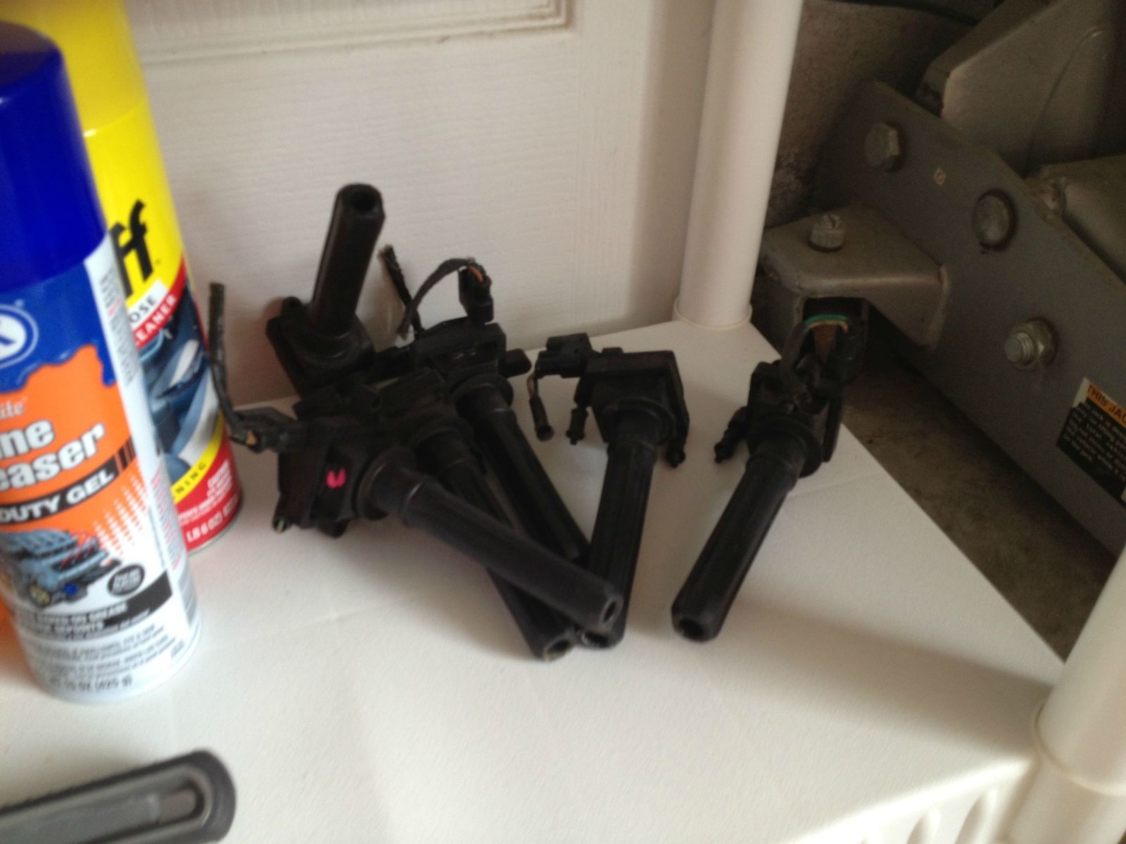

Coils for CoP plans
Tail lights... need to clean the the green off

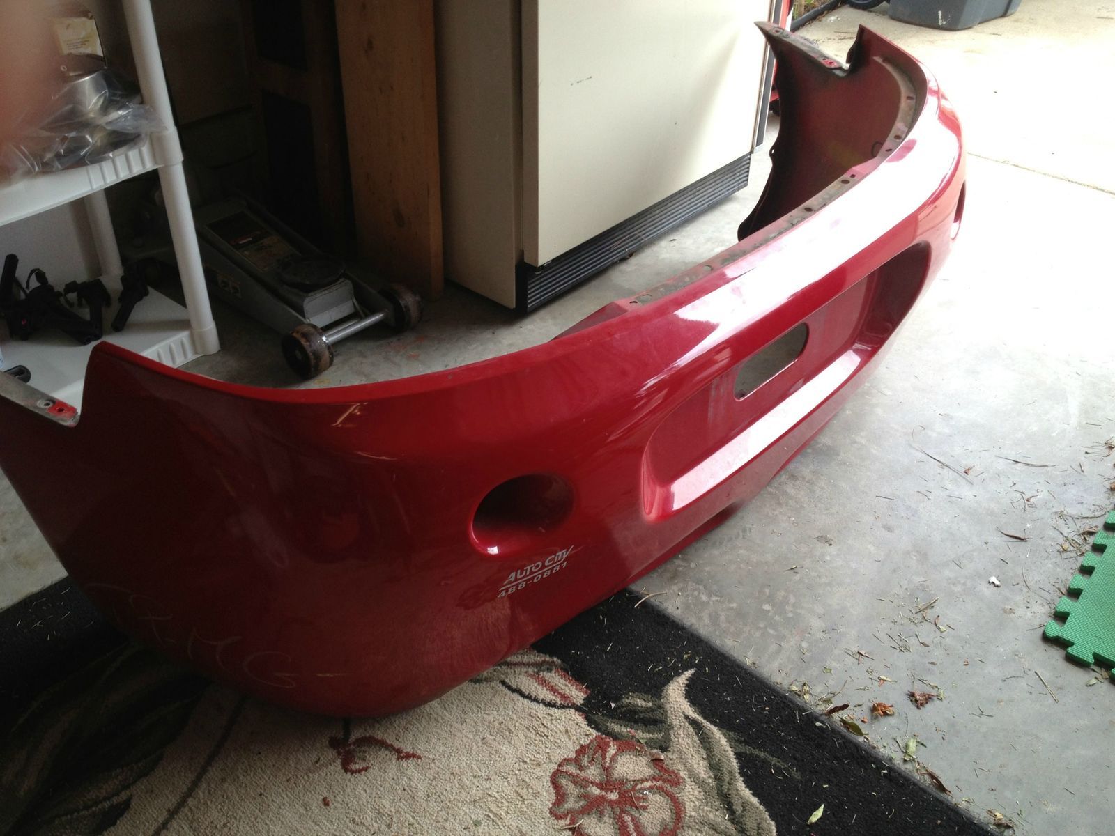

2gb Rear Bumper, pretty good shape, especially for a junkyard piece

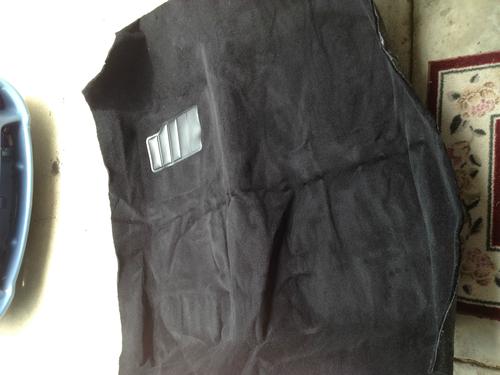

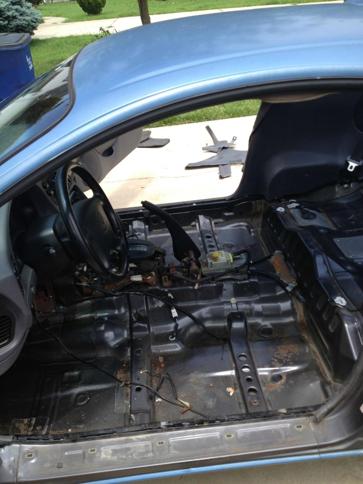

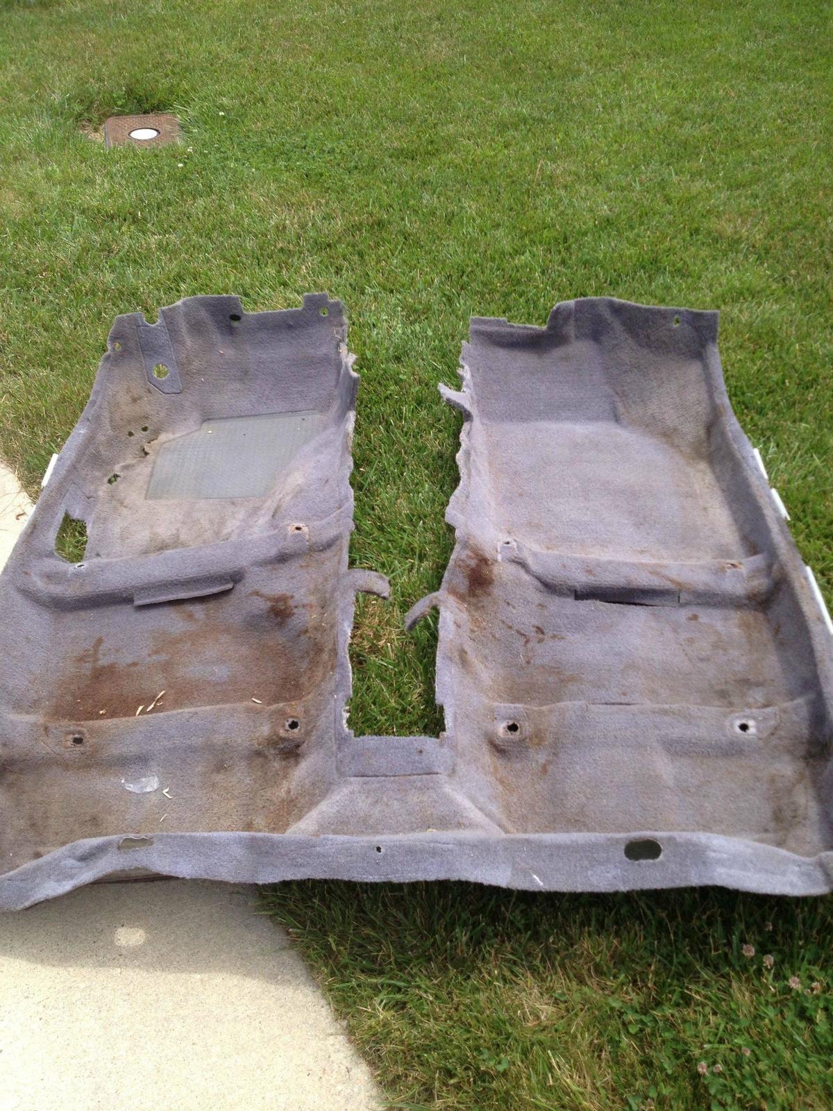

First thing I got knocked out was my new carpet
Everything ripped out
The Talon is funding it's self! All in all, I found about $2 and some change under the seats, center console, and even all the way under the carpet
Out with the old
In with the new

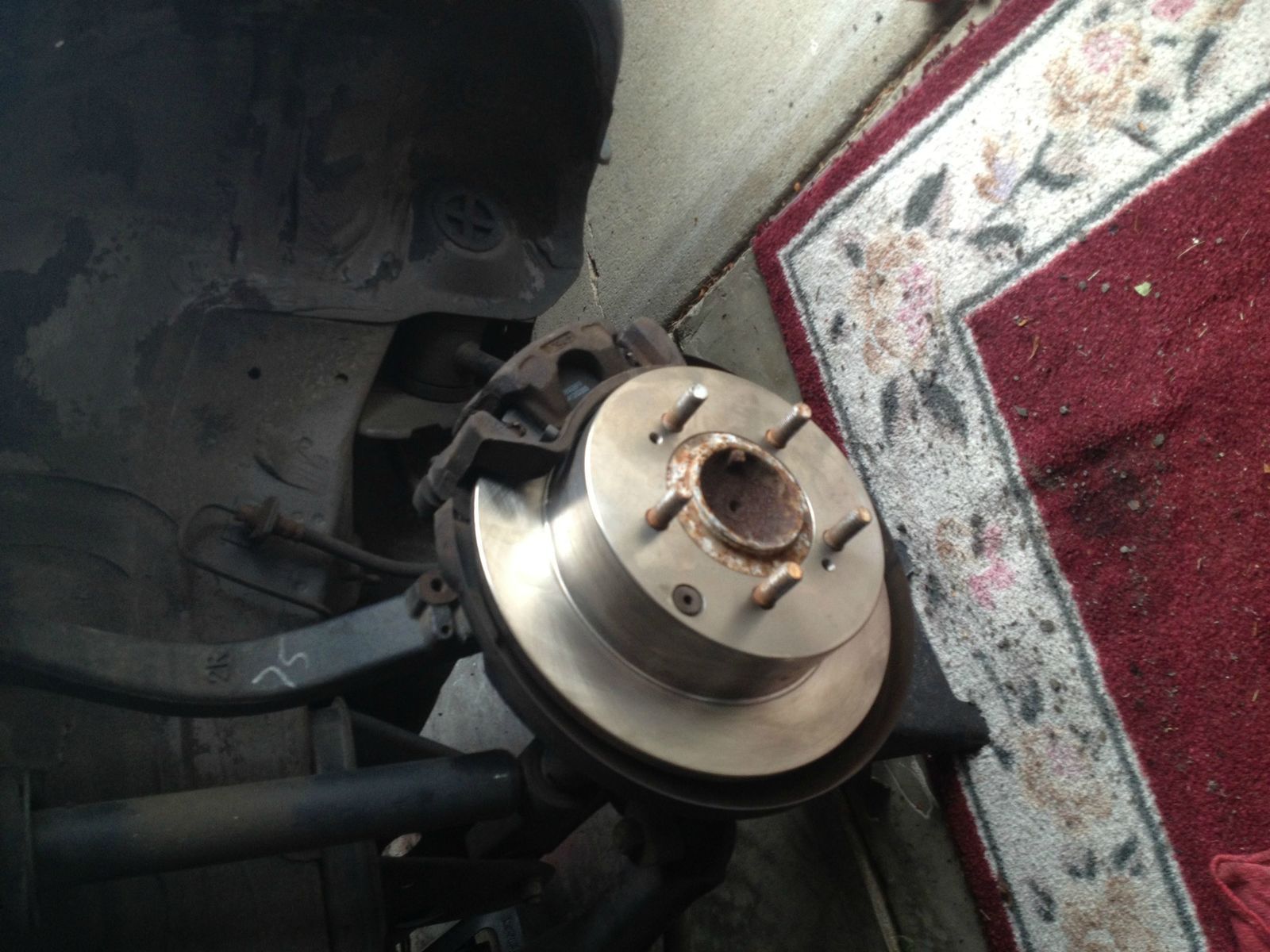

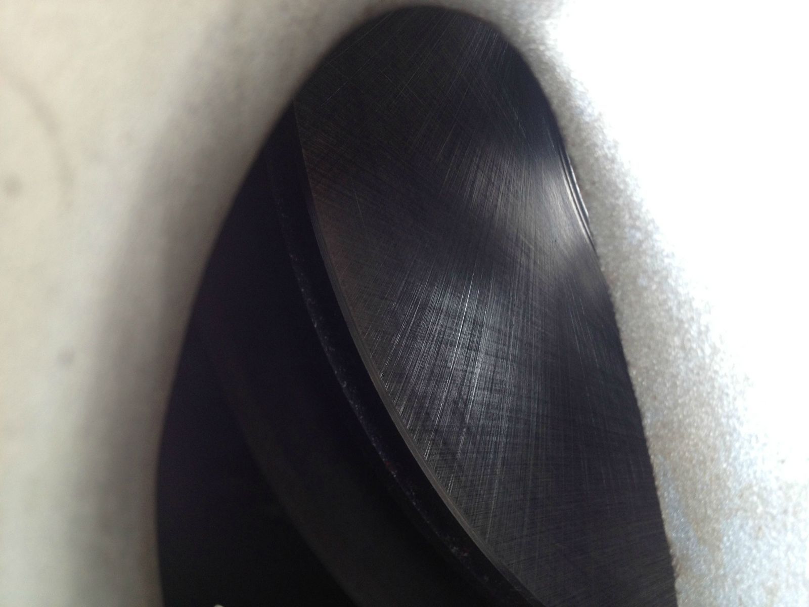

Then I got around to the new brakes
Front all buttoned up
Workin on the rears

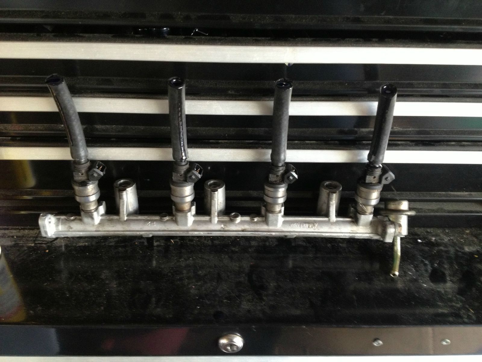

Thought I would work on the fuel system a bit, so I pulled the injectors and ran some concentrated injector cleaner through

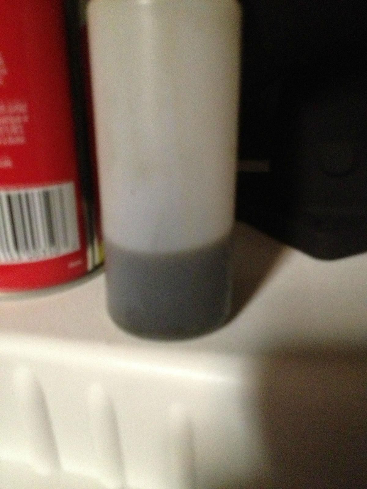

I also replaced the fuel filter... and I don't think it had been changed in the previous 170K miles. This is some of the fuel that poured out of it.

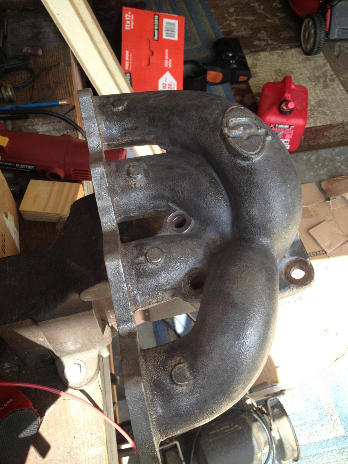

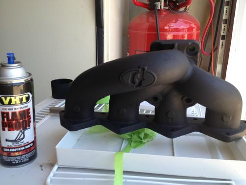

I also got my FP mani from a fellow forum member in so I got it cleaned up and painted with VHT Flameproof paint.

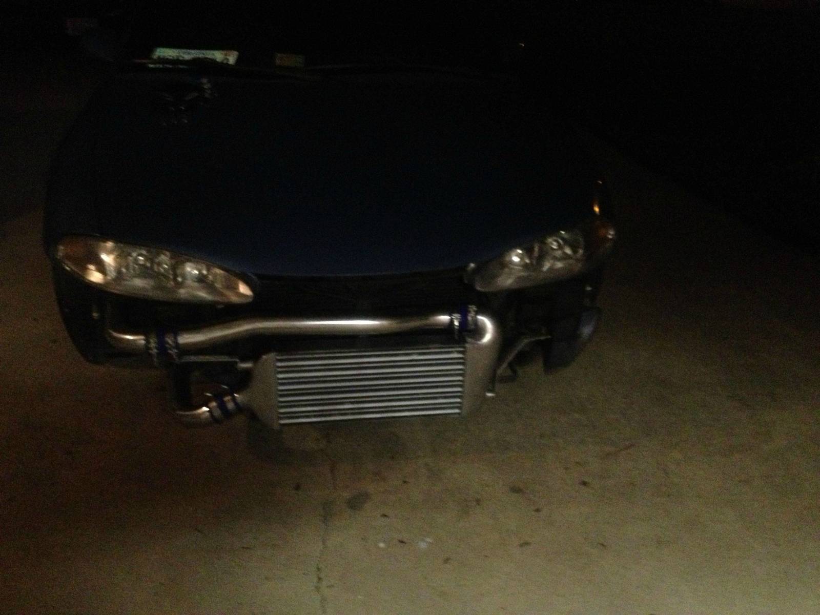

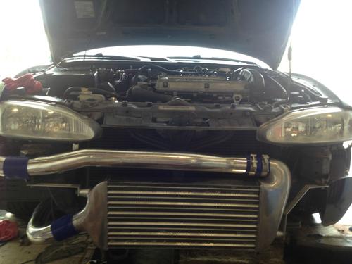

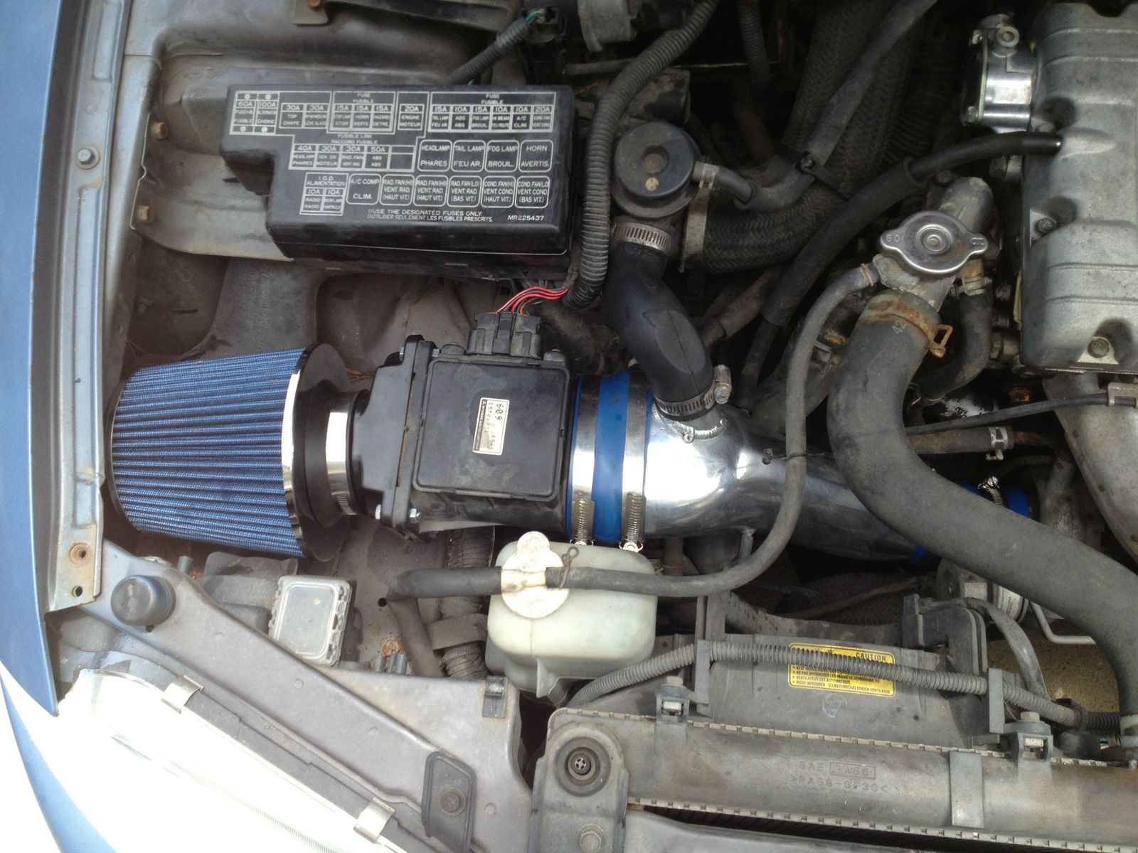

My Godspeed FMIC came and I got it installed after having to make some custom brackets
Got the new intake tube installed (oem tube was dry rotted and cracking, so it had to go)
Managed to get the motor cleaned up a bit, painted the upper heatshield with flameproof and new plug wires on.

Currently working on my CoP Set-up because I have a bad coil and I figured "Why not?"(will be a downgrade for now, but basically all stock for now)

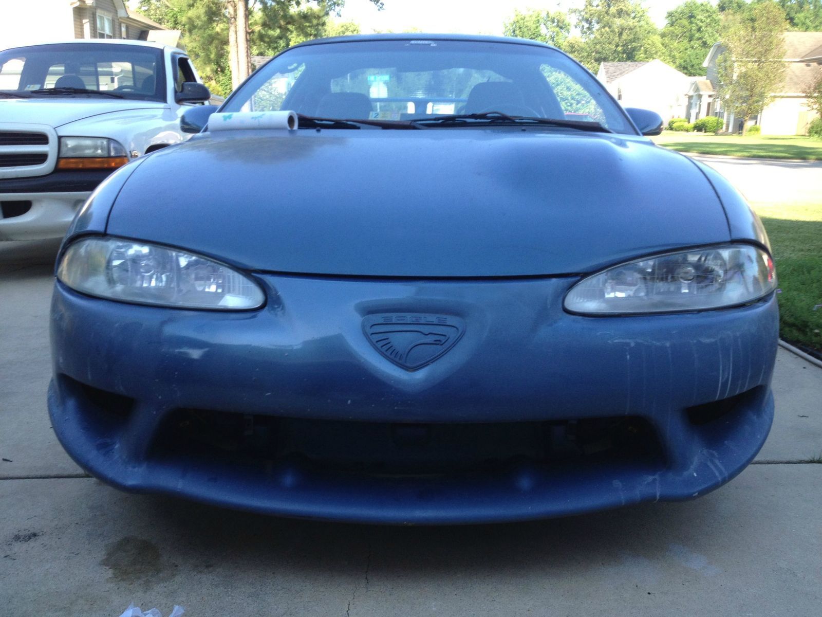

Nope, the blue is a cheap spray over that was done by one of the previous owners and it is flaking off all over. I will be sanding it down and putting a single stage coat all over and me any my buddy are going to vinyl wrap the car. Unless I change my mine, its going to be matte white with matte black top and hatch, and maybe the hood(dont wanna look like im trying to play off a CF hood).
