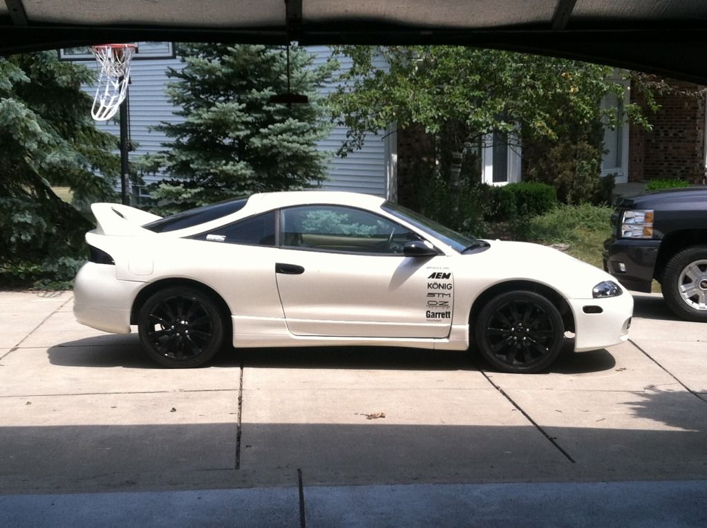

1995 Eagle Talon Tsi Engine Shave/Build

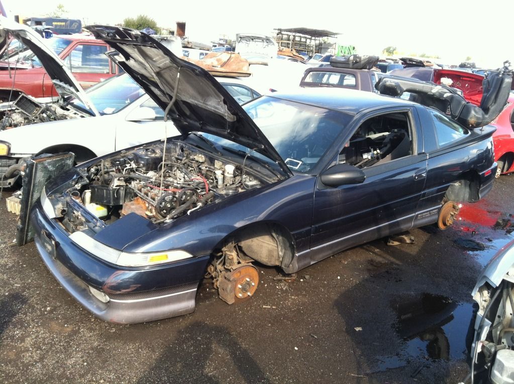

its been a long time since my last post so here is a few updates some guy locally is parting out his G so I snagged up some great deals

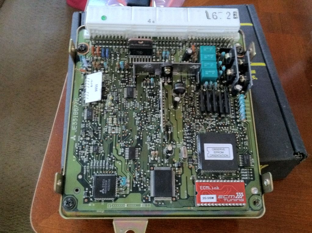

Ecm link V.3 full

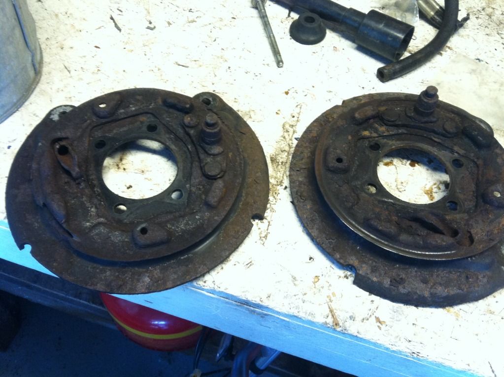

found rebuilt hand brake assembly and a set of used cables to replace my non-existent pads and rusted out cables.
the old rusted out pos brakes I had

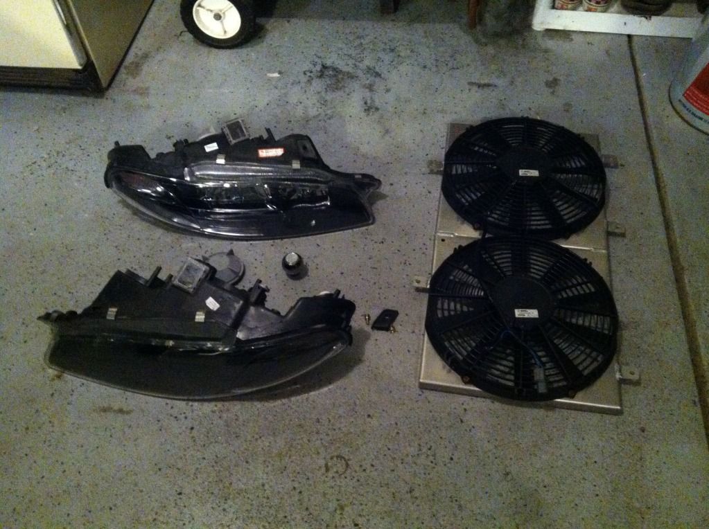

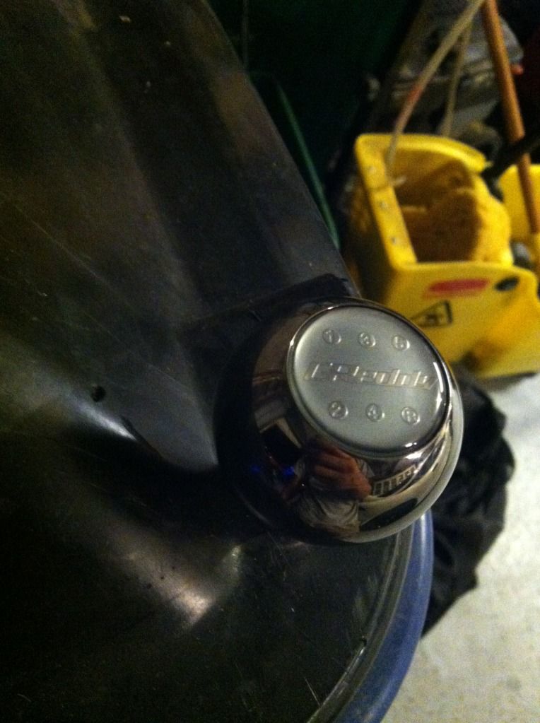

more parts: Headlights,slim fans and fan shroud, greddy shift knob
Oem headlights? Where did u get the greddy knob
They are oem eBay lights
Greddy knob came from the guy I got ECM from at $20 I couldent say no especially since people say their rare.

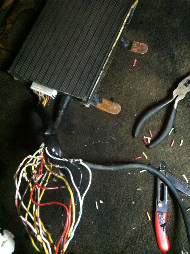

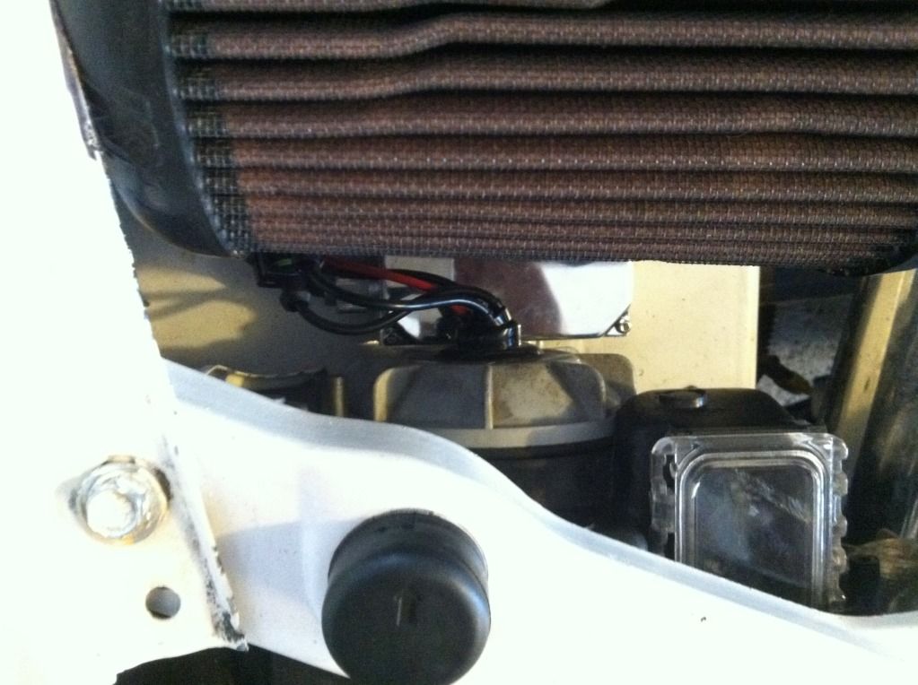

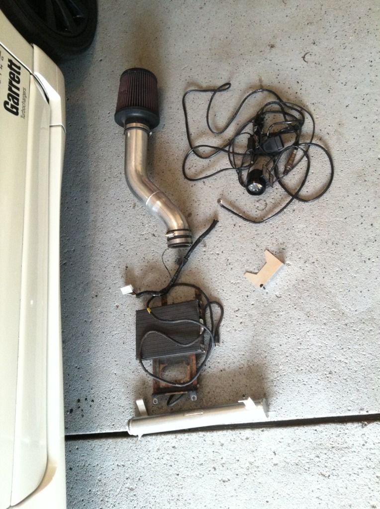

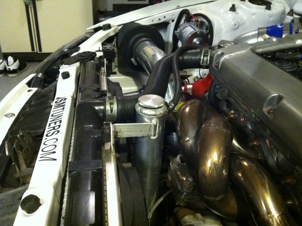

more parts: custom radiator overflow, k & N intake, AEM eugo wideband, factory amplifier and wireing.
had to splice the new harness into the existing wires that were cut

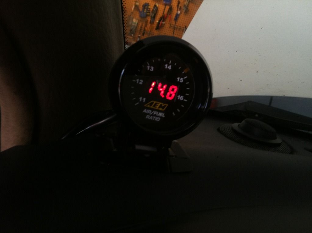

I attempted to install the wideband I removed my front 02 sensor and striped the threads in the housing I have new one comeing in this week so I can start to tune my car.

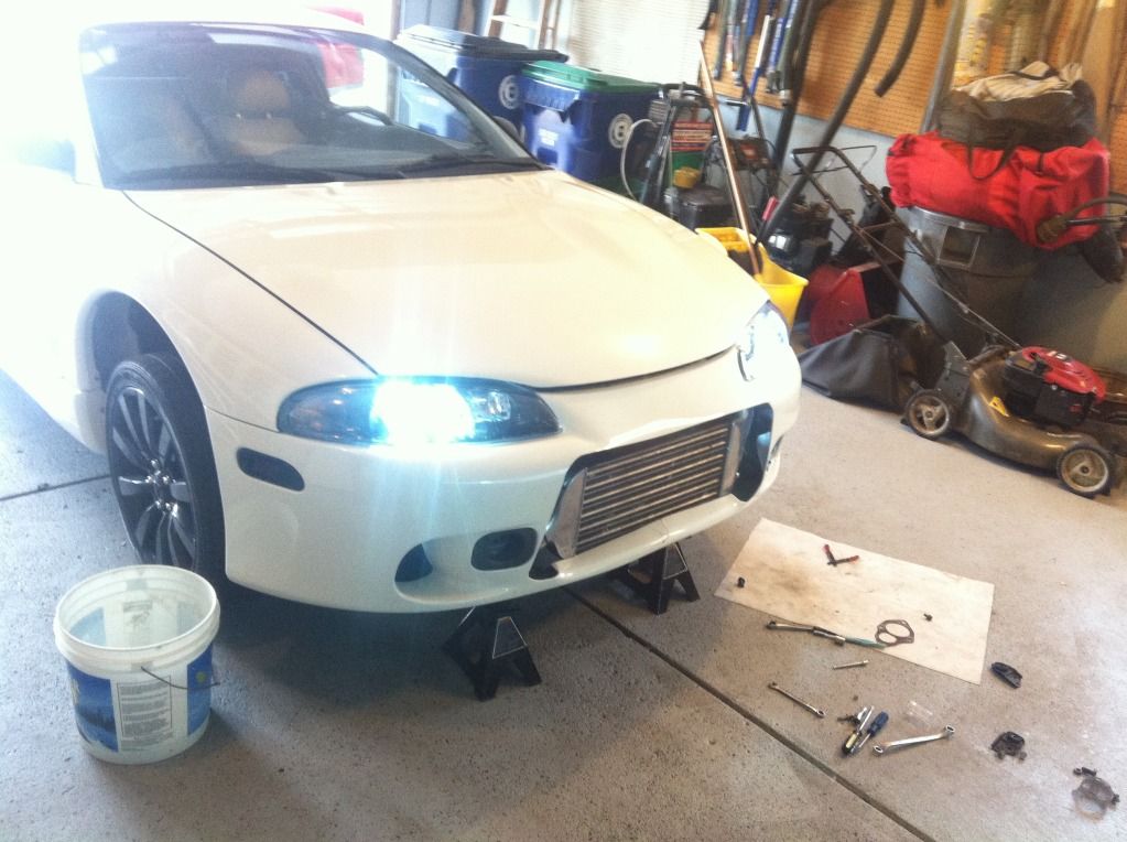

Got some hids installed and my lights straitend out
clean water tight install
new aem gauge

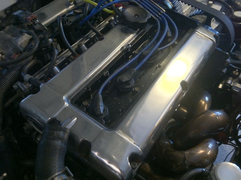

polished my valve cover again

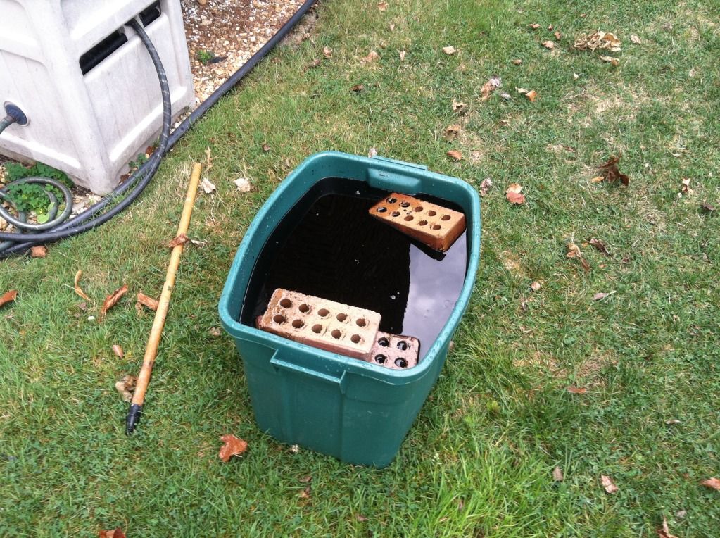

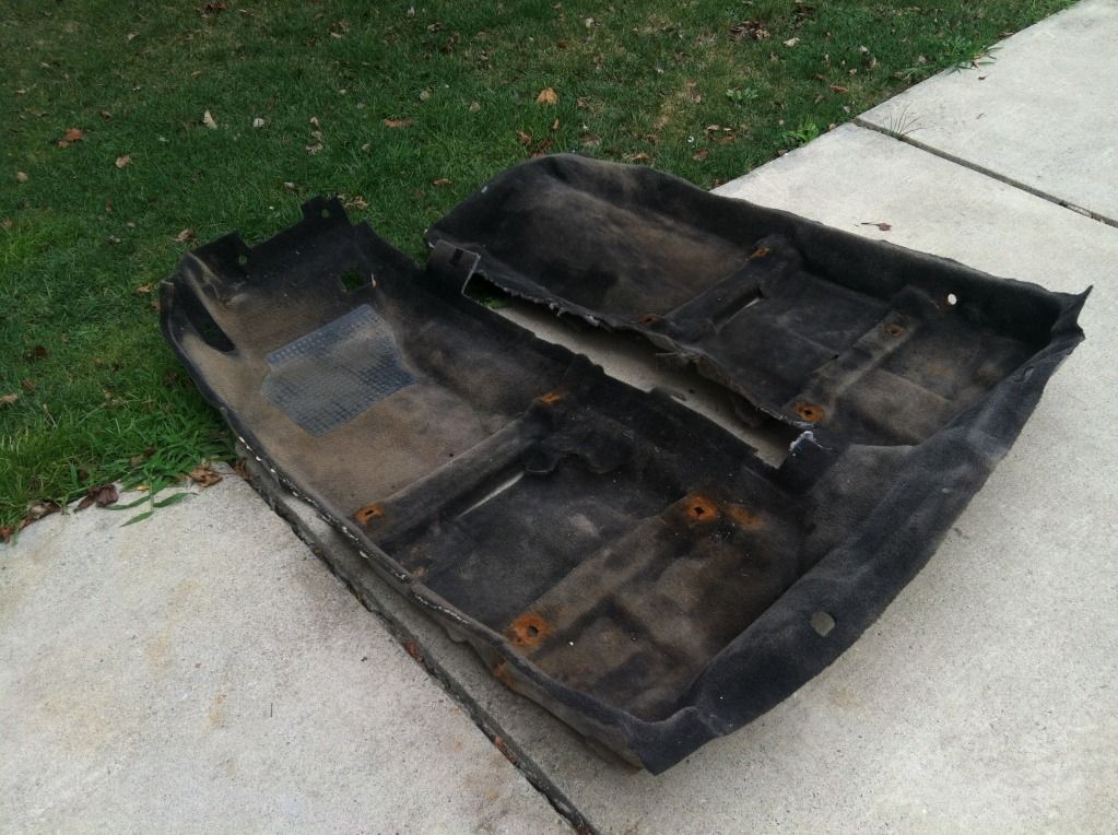

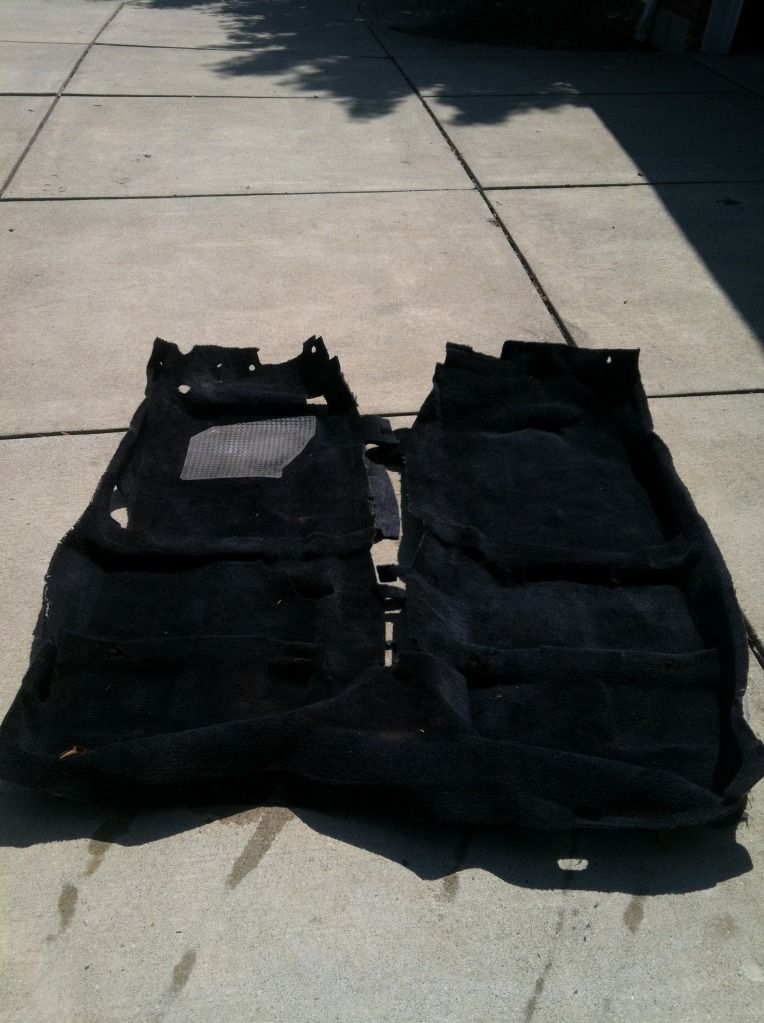

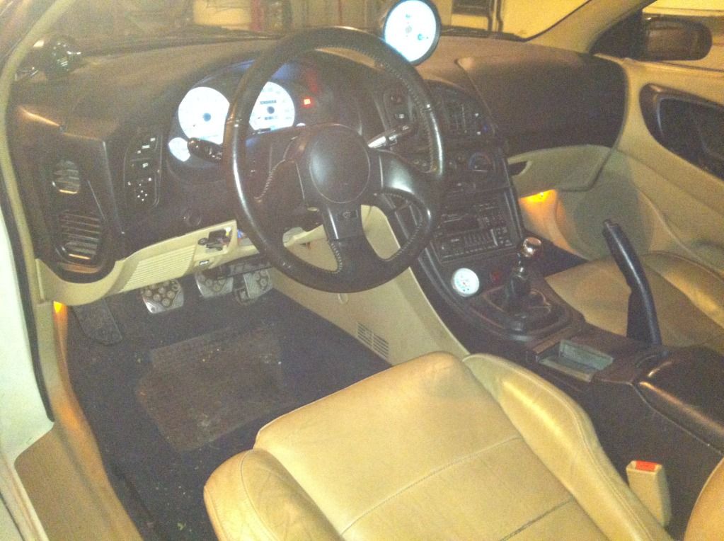

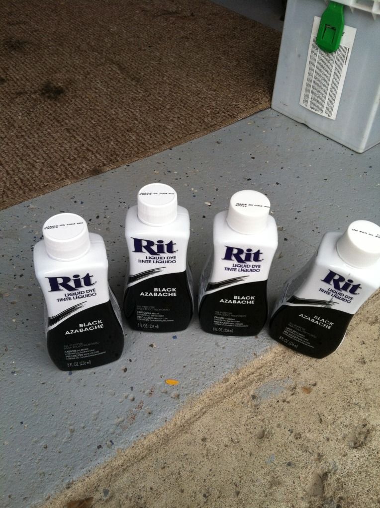

I saw thread on dyeing interior carpet so I tried to give it a shot. I power washed my carpet and washed with soap I have it sitting in a 30 gallon tote with 4 bottles of rit dye.I plan on pulling it out and washing it in the morning since it is going to be 85 out It should dry in a few hours.

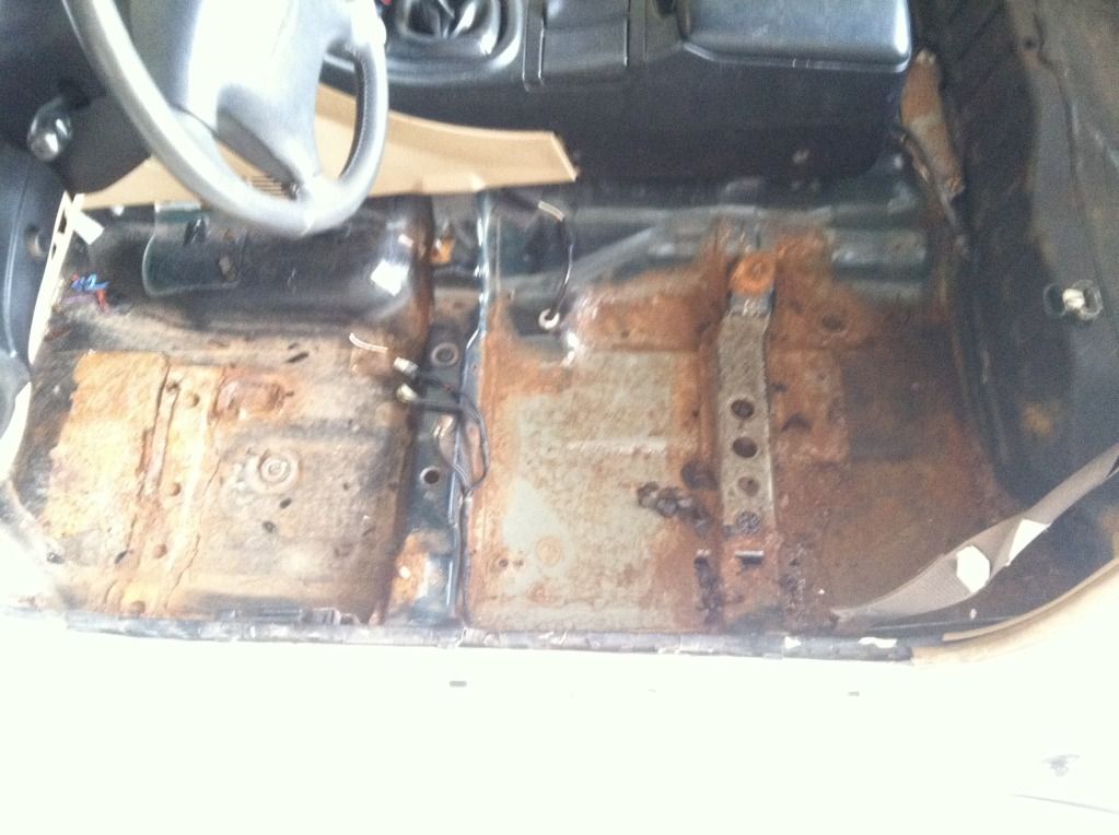

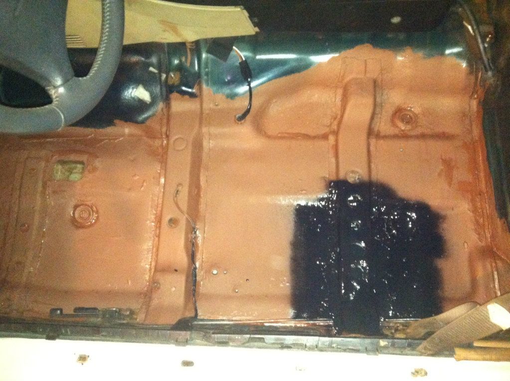

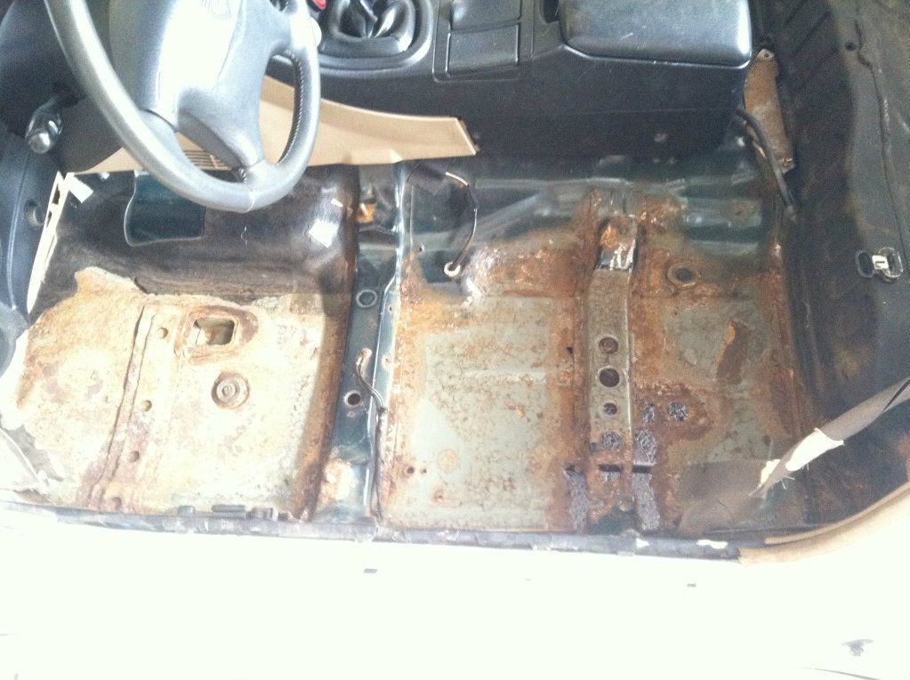

When I pulled my carpet I found a not so pleasant surprise
cleaned up a litte Just trying to slow down the rust process
patched the hole with sheet metal, self taping screws and undercoated it
I think thats a lot better what do you guys think?
I realllly like what you have done with this car!! Keep up the good work. BTW, What are those for rims? (I don't remember reading what they were) They are sexy as hell!:hellyeah:
I'm impressed with what you have done with the car, looking really good. :thumb:

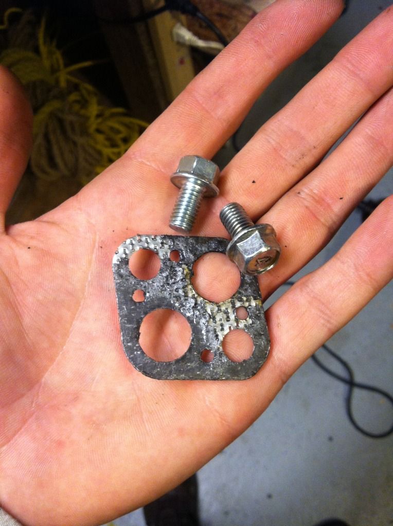

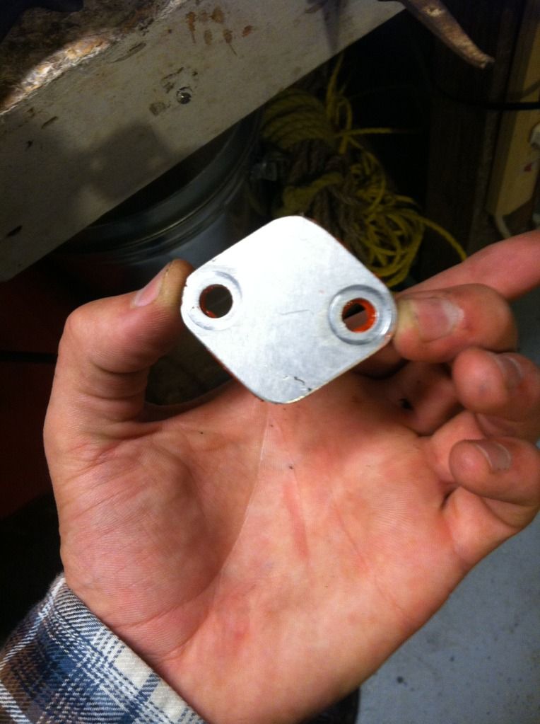

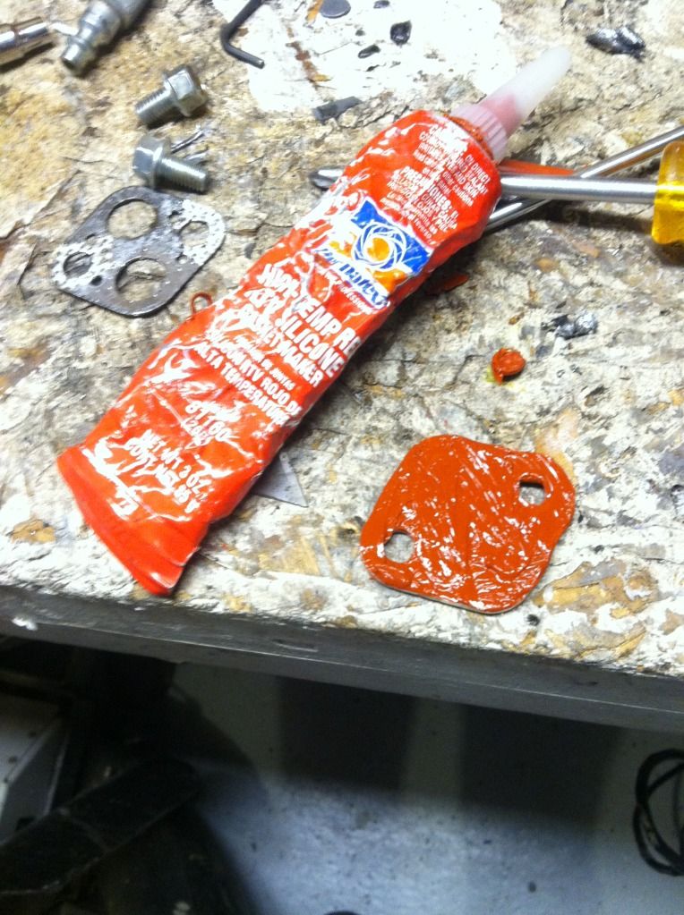

I was having major idle surge issues. After I boost leak tested i found that I had a big leak where my fake HKS bov bolts together and another at my EGR block off plate, It seems that the gasket melted after 3 miles...
coated it in high temp rtv and torqued it back down

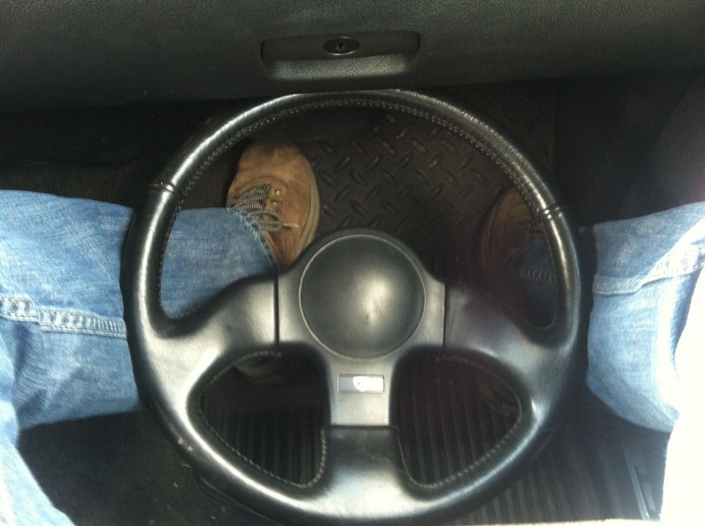

1g wheel into 2g
Any Modifications needed to swap the 1G wheel over? I have one and I love the feel of the 1G wheel vs the 2g
Build looks great!
The 2g wheel is a boat I hated to this one 1g wheel was the best 14 bucks I have ever spent. The splines are the same you cave to cut the back plastic part off of the 1g to make room for a wire connector and you have to cut and solder one wire for the horn there was a FAQ for it on here.
