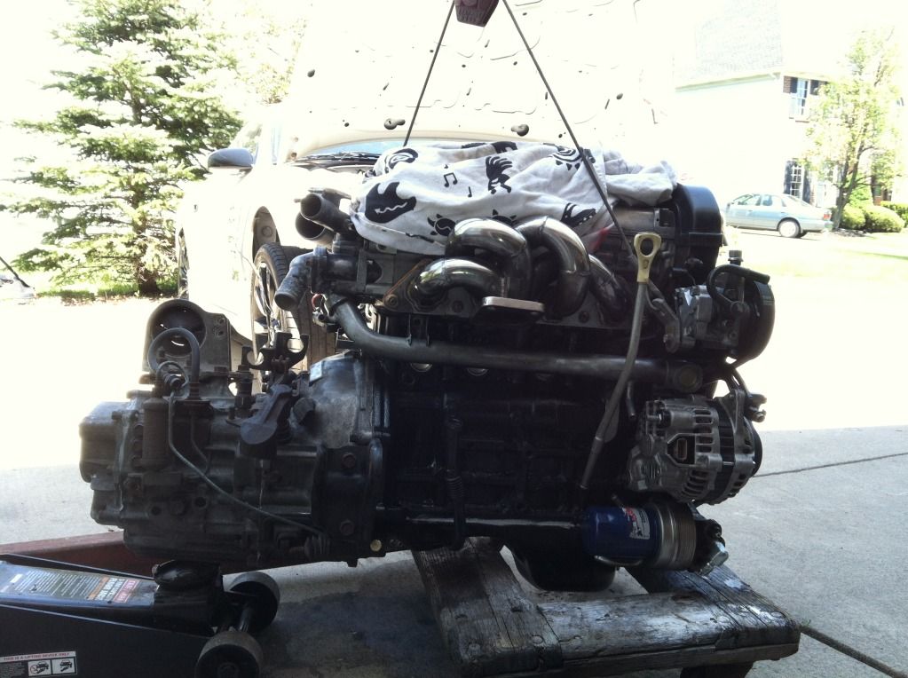

1995 Eagle Talon Tsi Engine Shave/Build

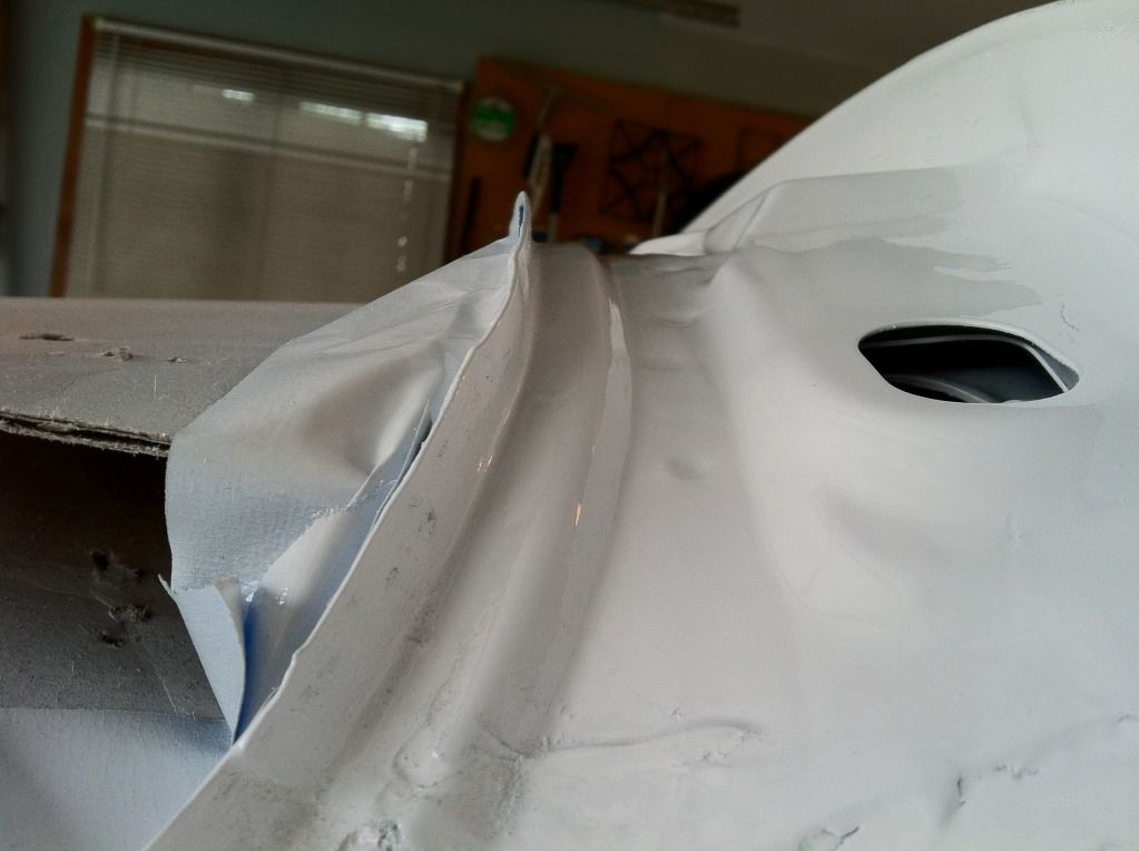

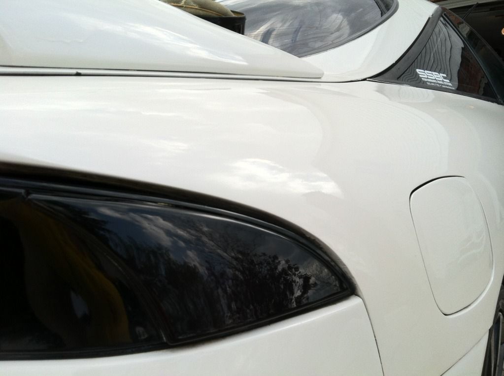

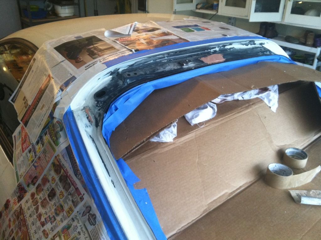

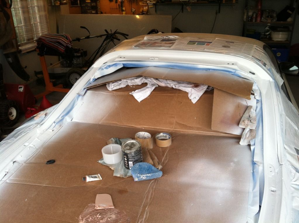

more work fixing the spots that were never prepped before paint
I have the trunk on now It matches very well because the clear I used had a little yellow in it making it look like my pearl.

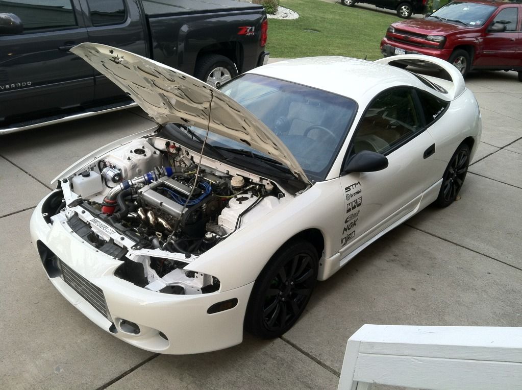

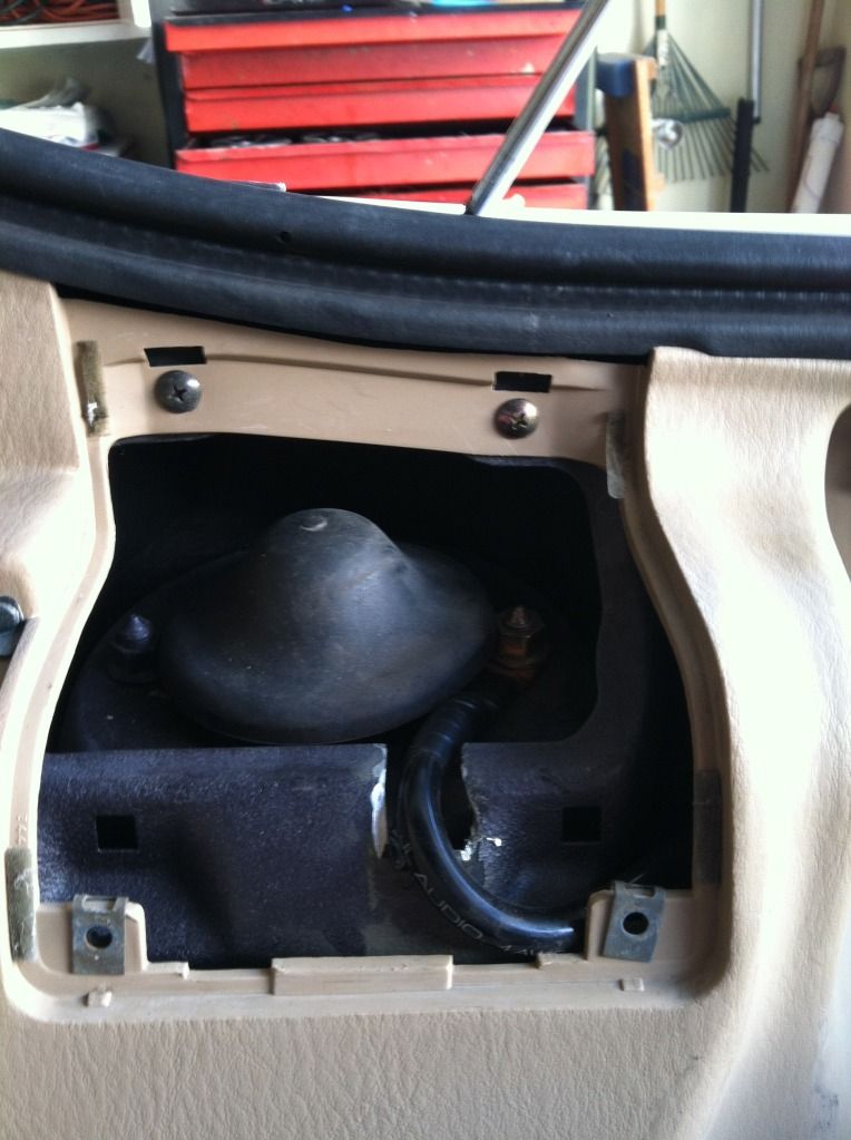

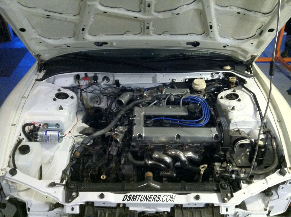

Lookin good but I would definitely find a different spot to mount that pump. It is even more bulky than the fuse box it replaced..
after getting over spray all over my car from paining the trunk I had to clay bar the car witch took 2 hours but I am glad i did it I removed a lot of what I thought were imperfections in the paint and where just black specs deeply embedded in the clear

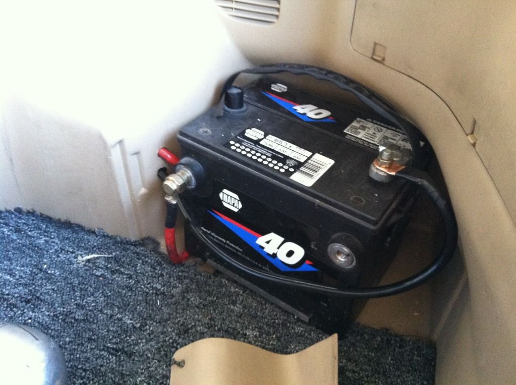

Hope you are putting that battery in a box.
I have a box for it just temporary for now and I'm haveing problems with my power windows and locks they won't work and no fuses are blown I took the power window relay and bridged the two points to do the "power windows with no key mod" but still no luck so its not my relay

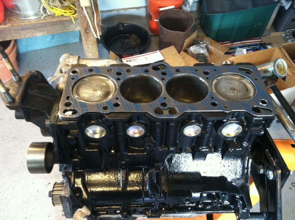

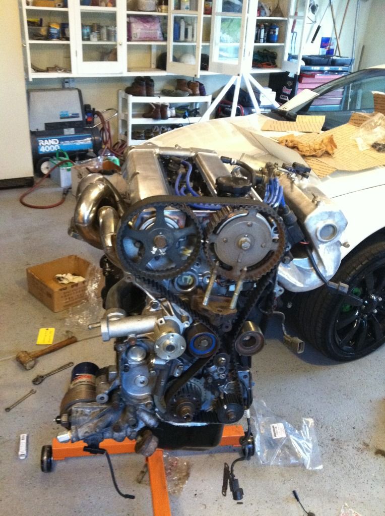

OK it seems like cylinders 2 and 4 are not firing because my exhaust manifold is getting hot on only 1 and 3 and when I turned up my fuel pressure a few psi 40-45 it started for 1 second
I had the crank sensor on wrong thanks to "colt4g63" for pointing it out i fixed it and now she is running. Just have to buy a new oil feed line and hook up my ic pipe and drop my axles in

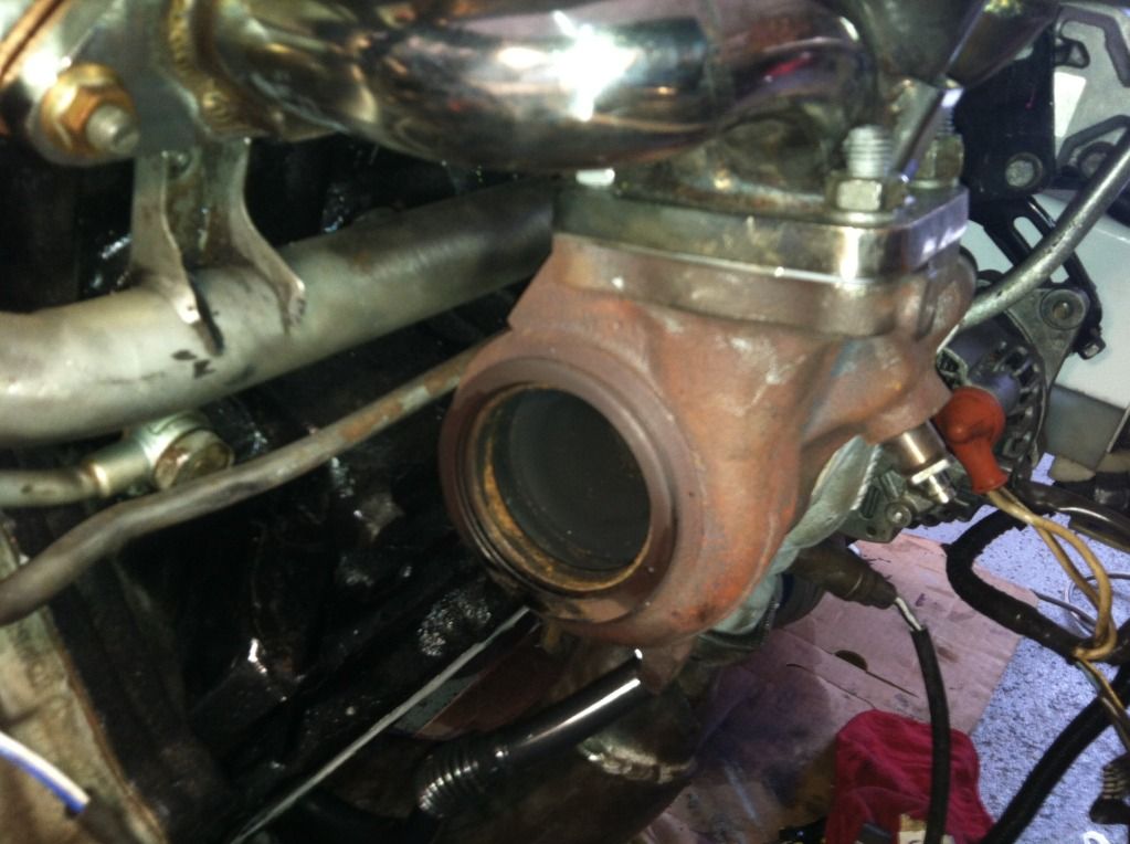

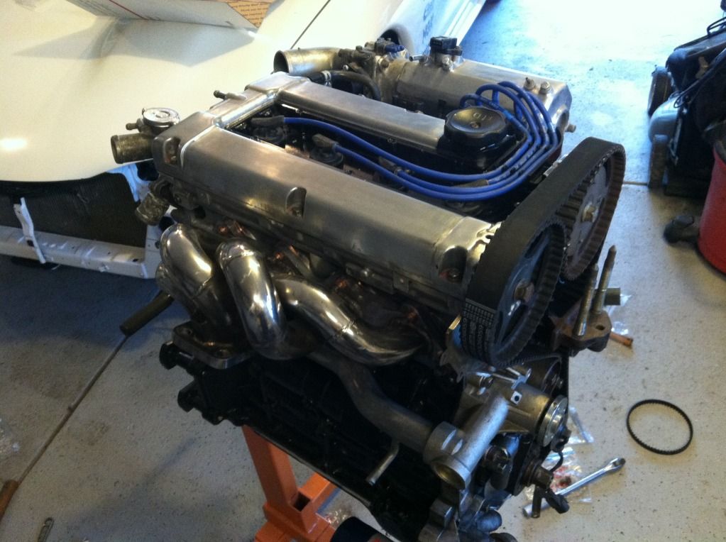

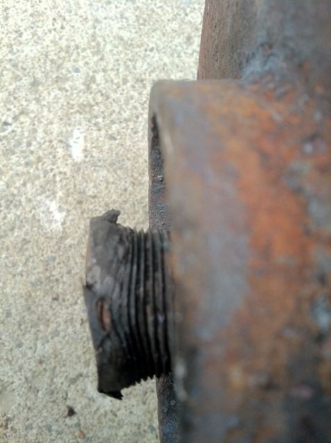

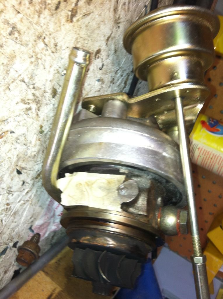

I ran the car for a few minuets finding that I needed a new turbo feed line and I was leaking on my drain line I tried to tighten the drain bolt and the bolt broke off in the turbo i was pissed there was no way i was taking the whole manifold off I unbolted it from the hot-side drilled out the bolt and re-taped it. Before everyone gives me crap about this I know its an eBay turbo and I got scammed on Craigslist from a guy saying it was a Garrett I'm not really blaming him for my stupidity but i wouldn't do that to someone else. lesson learned I guess I am going to check the turbo for play every 50 miles and I will begin to save for a precision turbo with an externally gated setup and a forced performance manifold

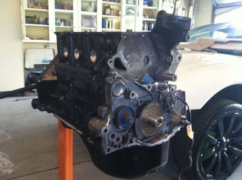

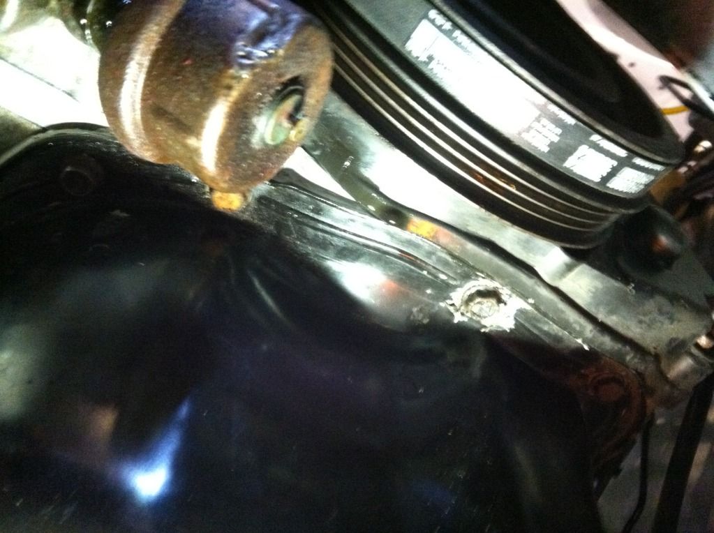

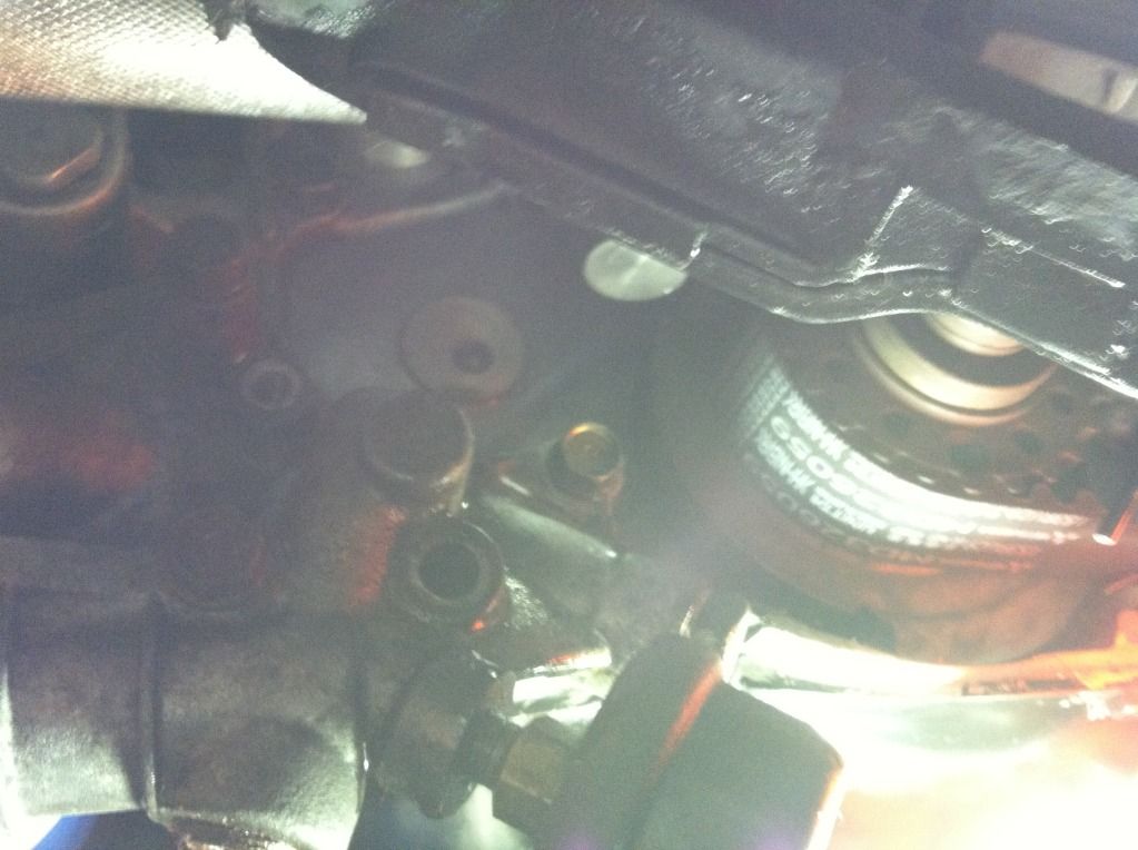

In addition: I ran the car again and was dripping oil near the oil pan/oil cooler housing so off came the lower timing cover and to my surprise It was leaking where the old balance shaft tensioner went not that huge of a deal I still had it set aside but never once did i see someone tell me that it had to go back on.

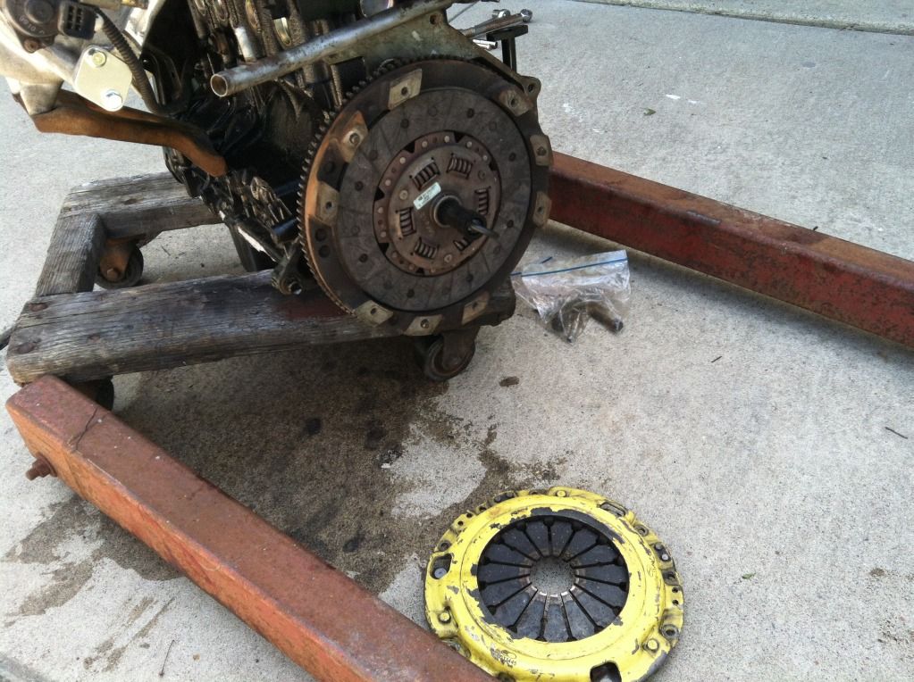

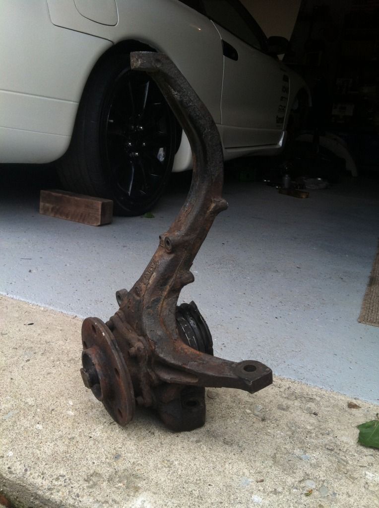

I had no luck removing my axle from the hub I even took it to my buddy's house who is a mechanic we heated it up till it was red hot and slamed on it with the sledge he said he has never seen one that bad before.
I need to buy a new hub assembly if anyone is selling one please pm me.

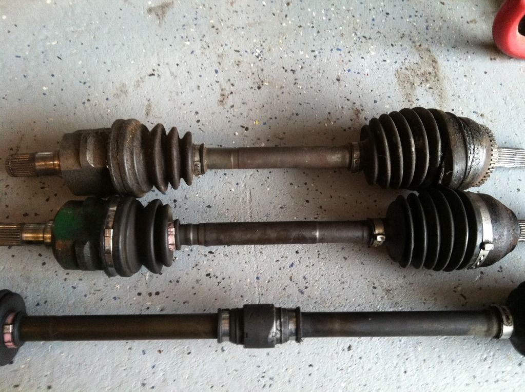

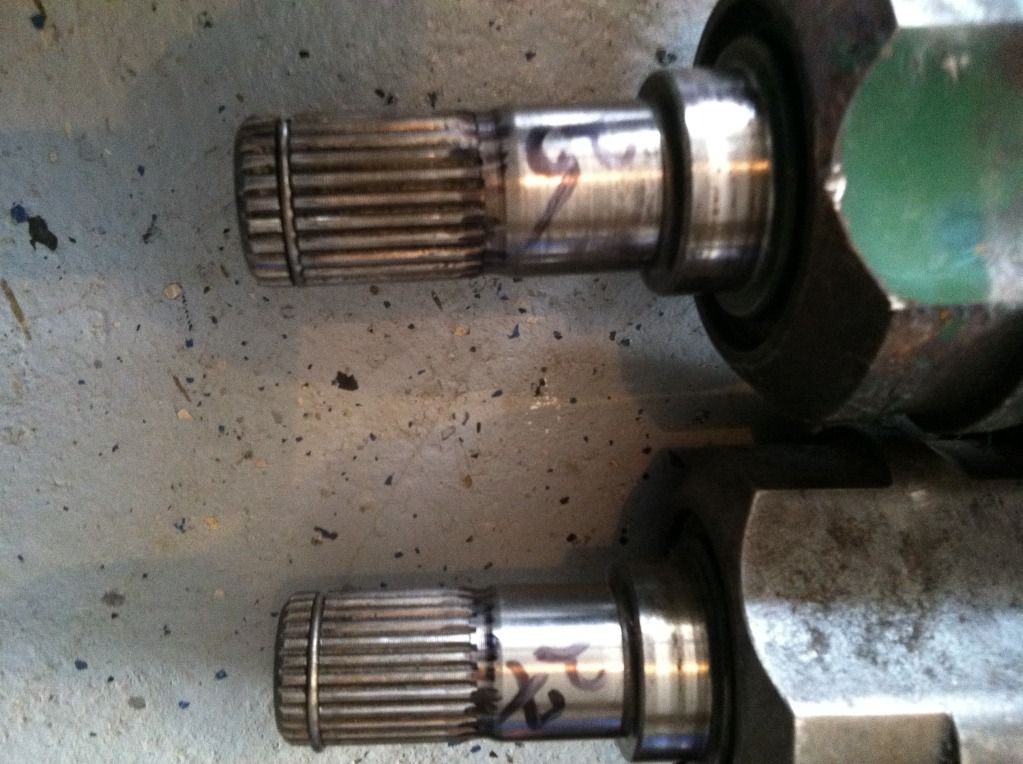

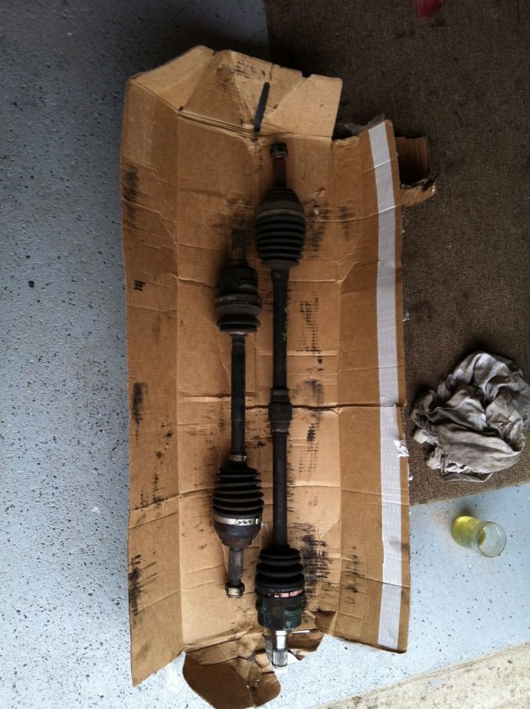

I ordered my new axles from s & M auto and they sent me a 25 spline short shaft for some reason i contacted them and they said they will send the correct 27 spline out I was just annoying because It took be about an hour to get it all in and together before i figured out that it was slipping inside the transmission and i thought I assembled the trans wrong It really had me worried
shafts they sent me before i cleaned them up
notice the difference from my old short shaft and the one they sent me
25 vs 27 spline surprisingly the 25 fit into my transmission

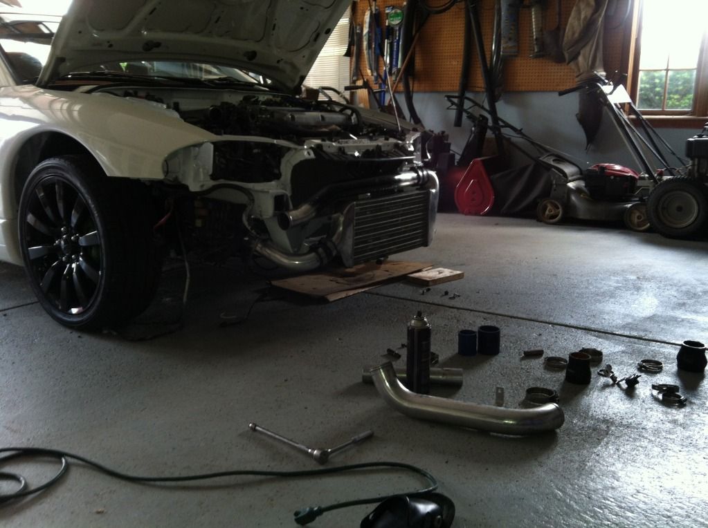

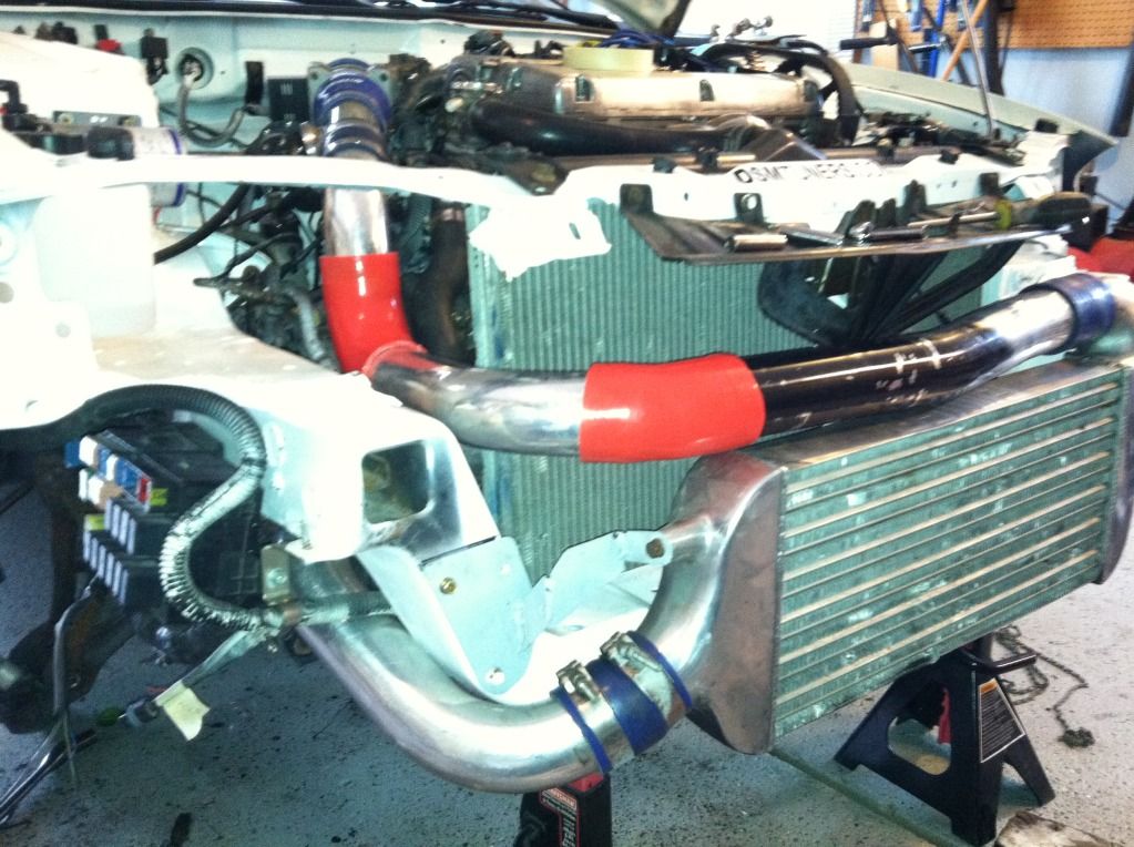

got my gm maf in and already its running better with no ic pipe hooked up.

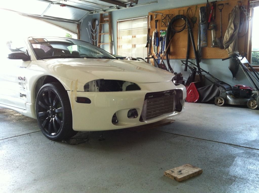

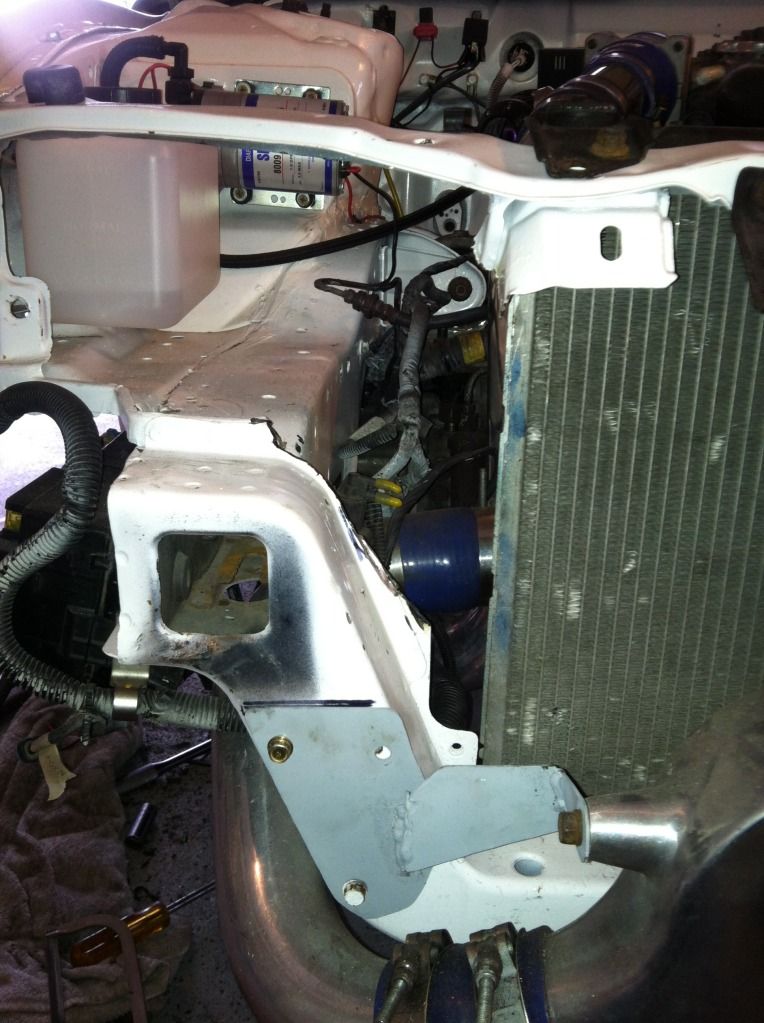

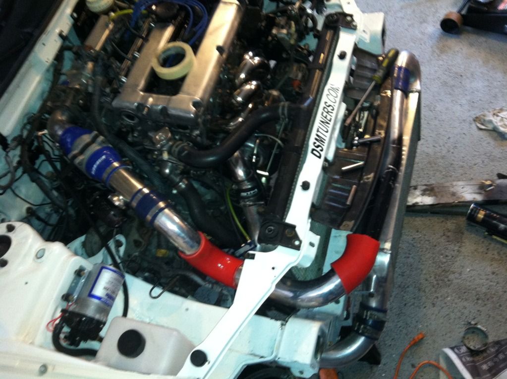

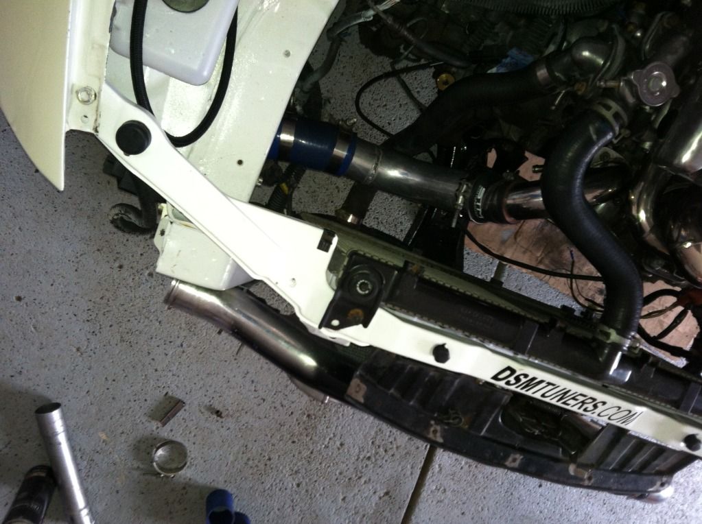

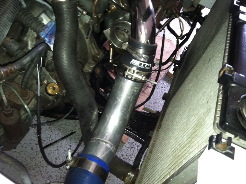

Here is some pictures of my new mock up for my front mount this way is a lot shorter and had less bends.
