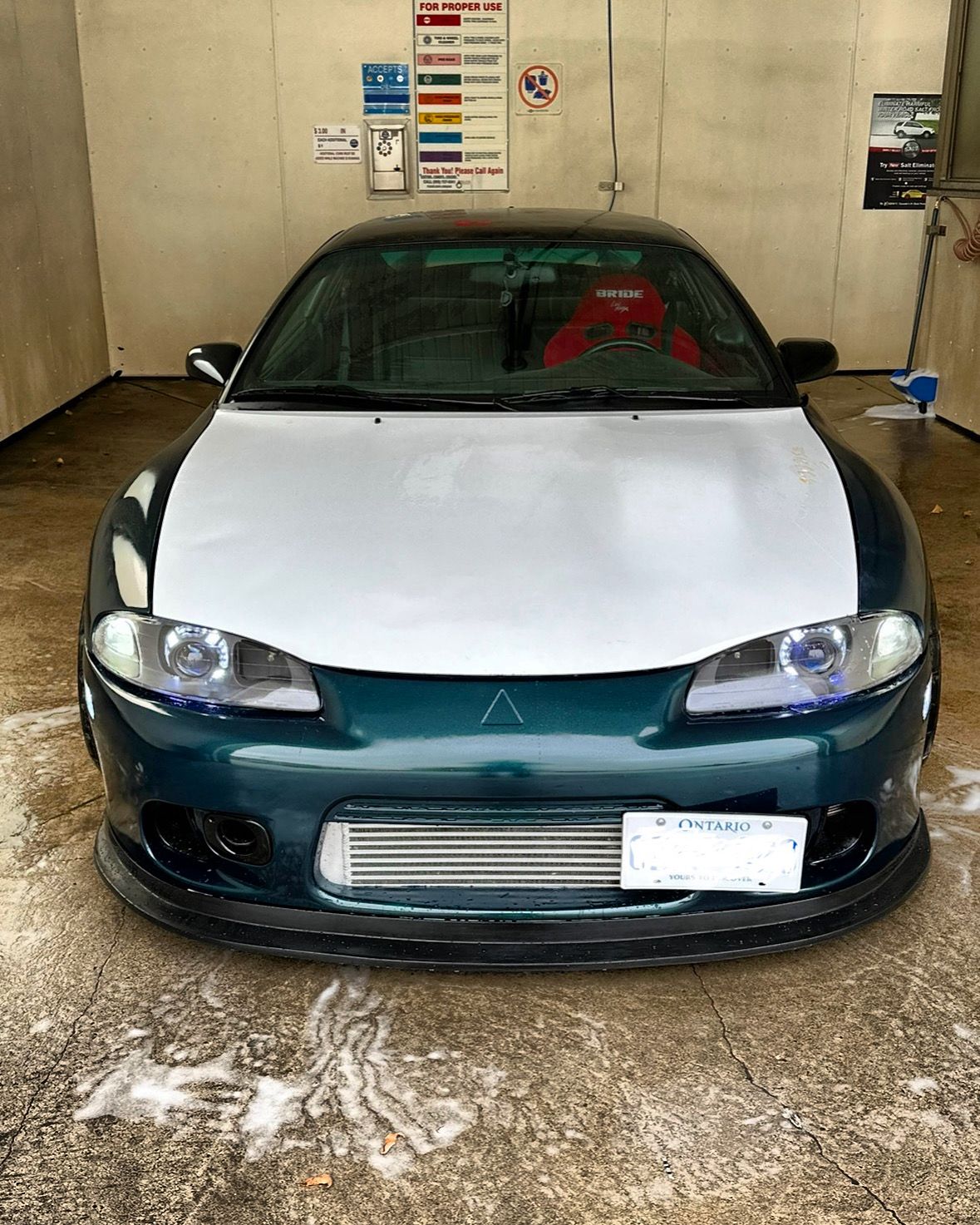

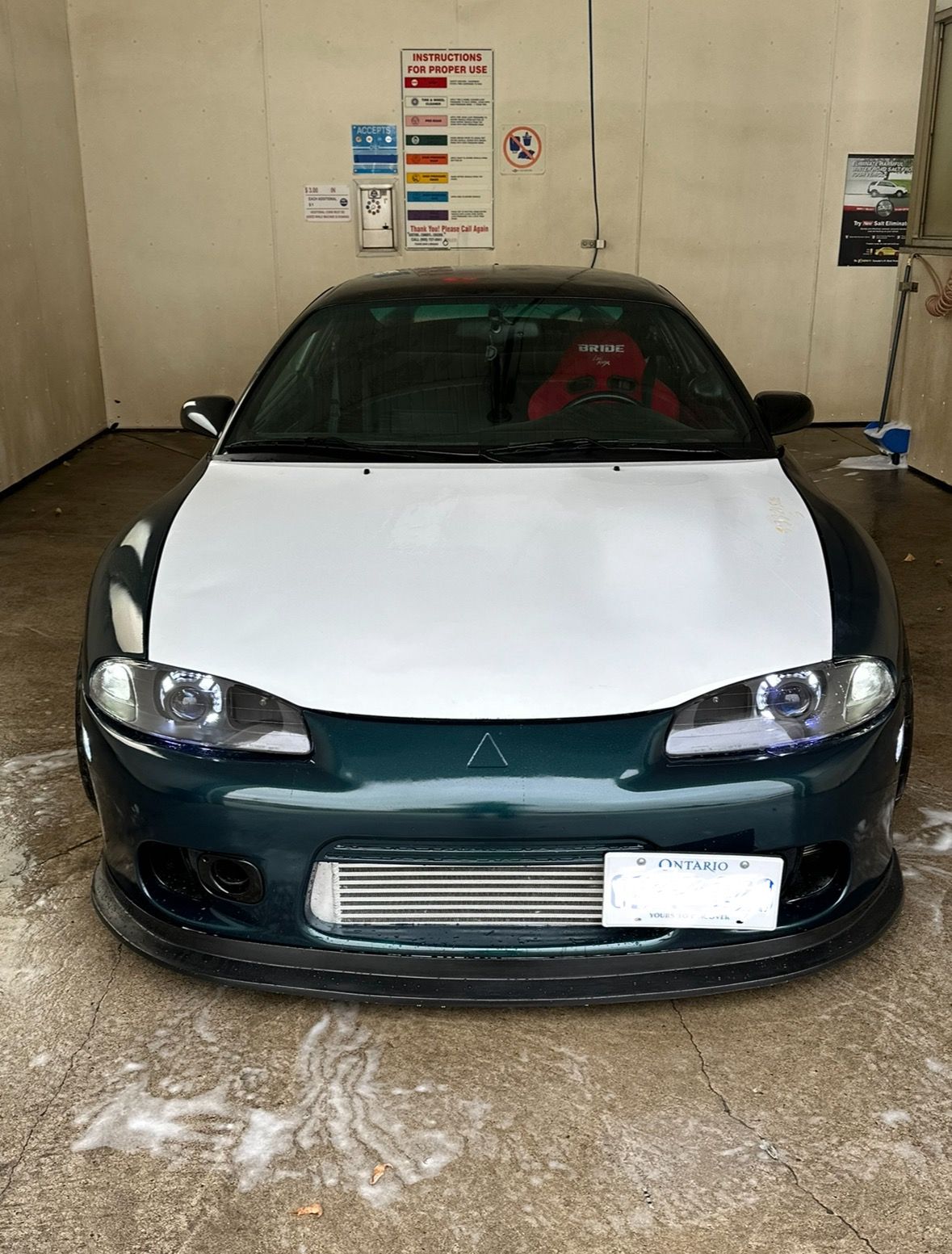

Went to the car wash the other day just to clean off all of the dust as the car was in the garage for over a year being rebuilt. Lots of work to do on the body and alignment of panels, etc. going to change the front lip but this is currently how she sits

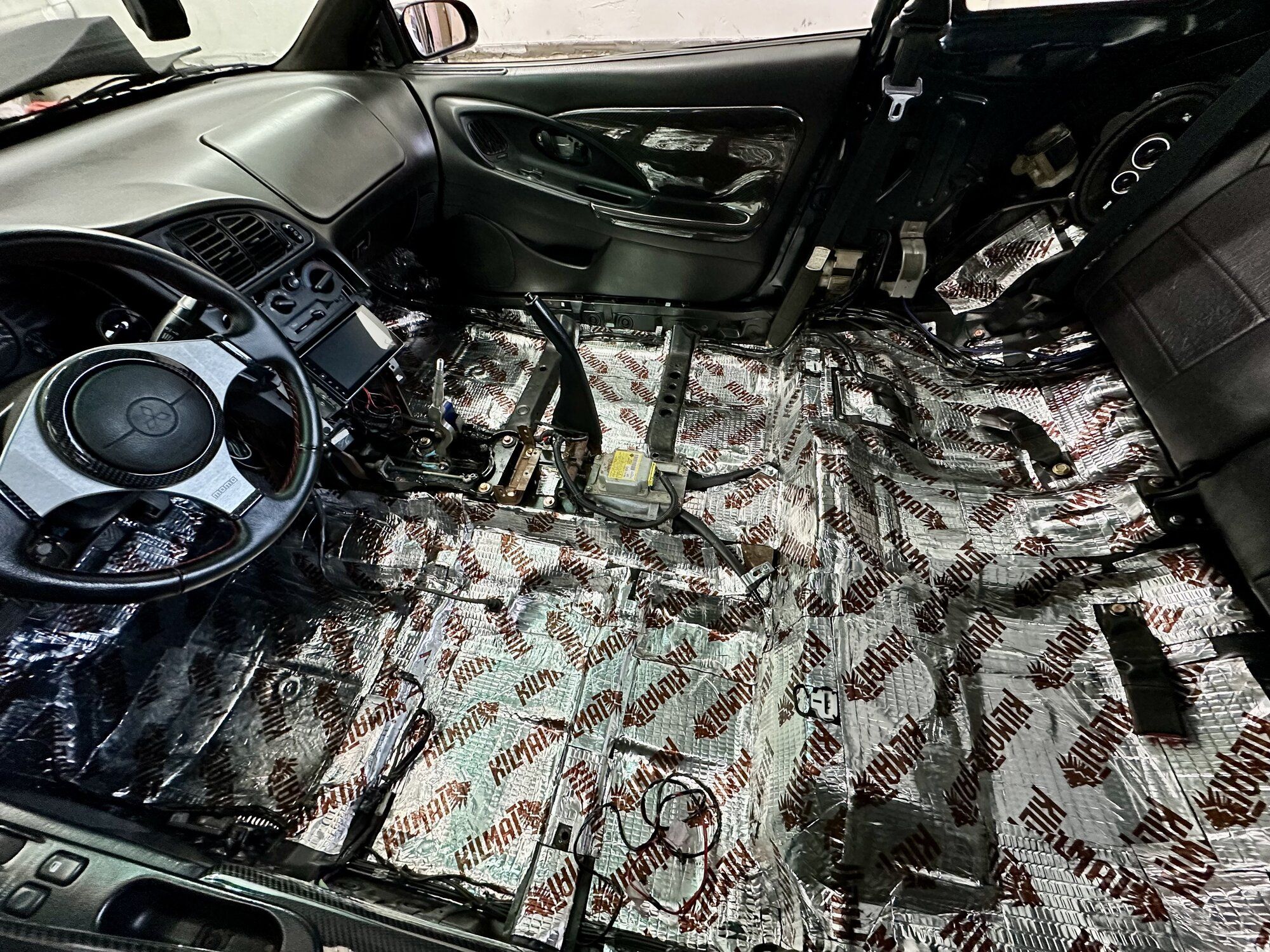

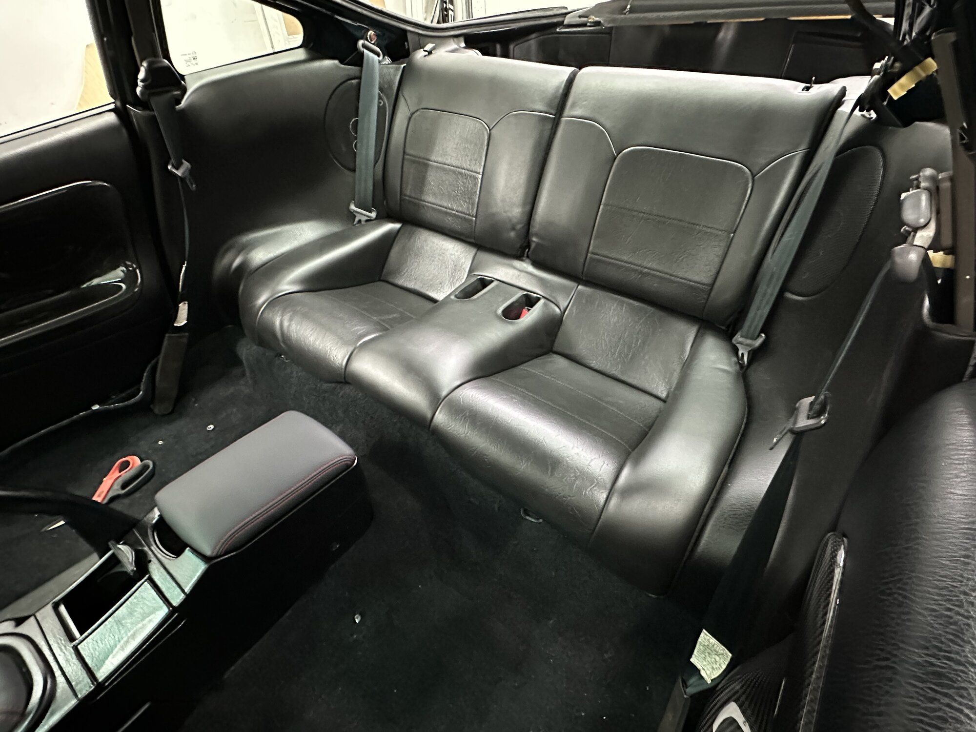

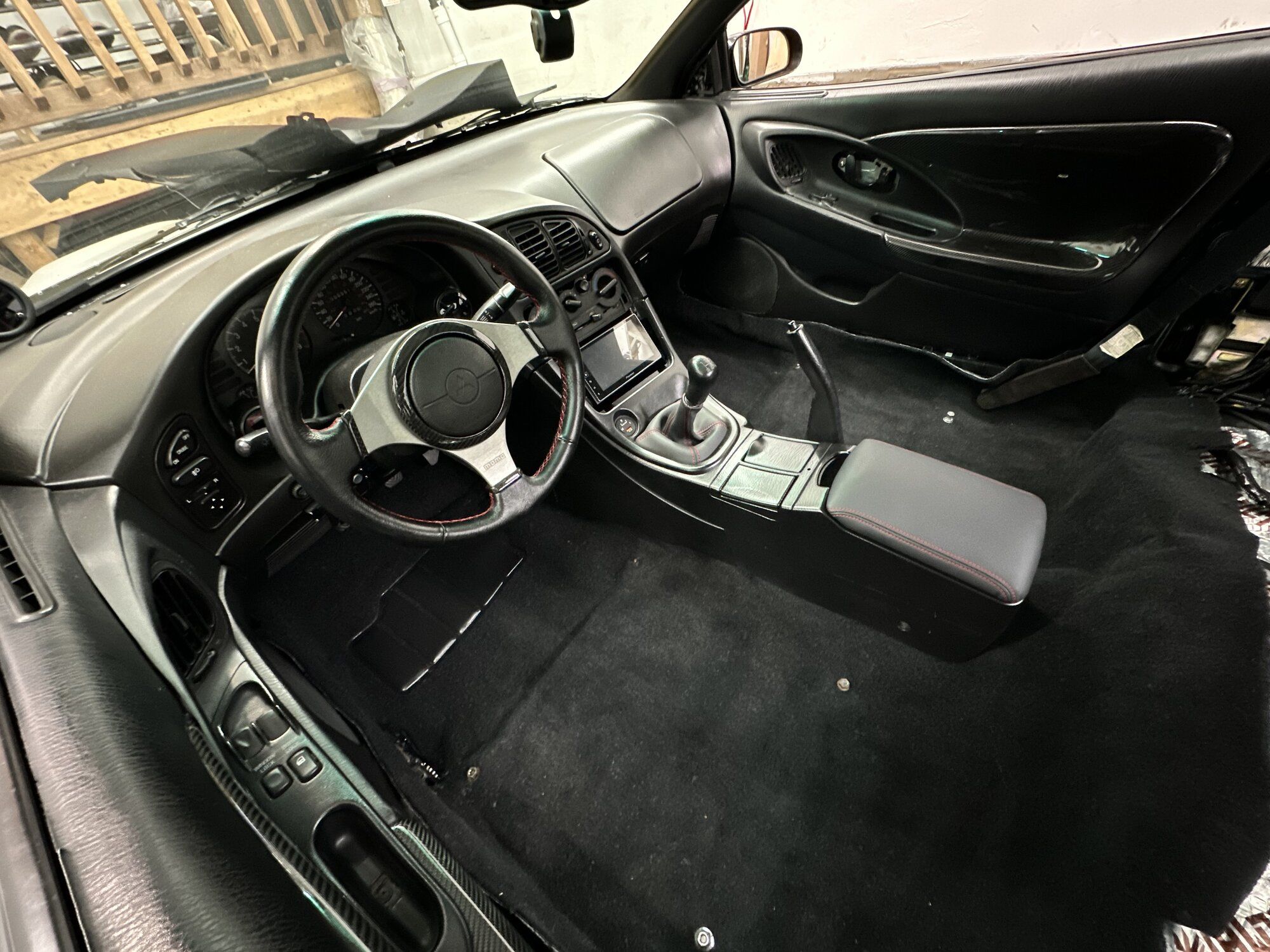

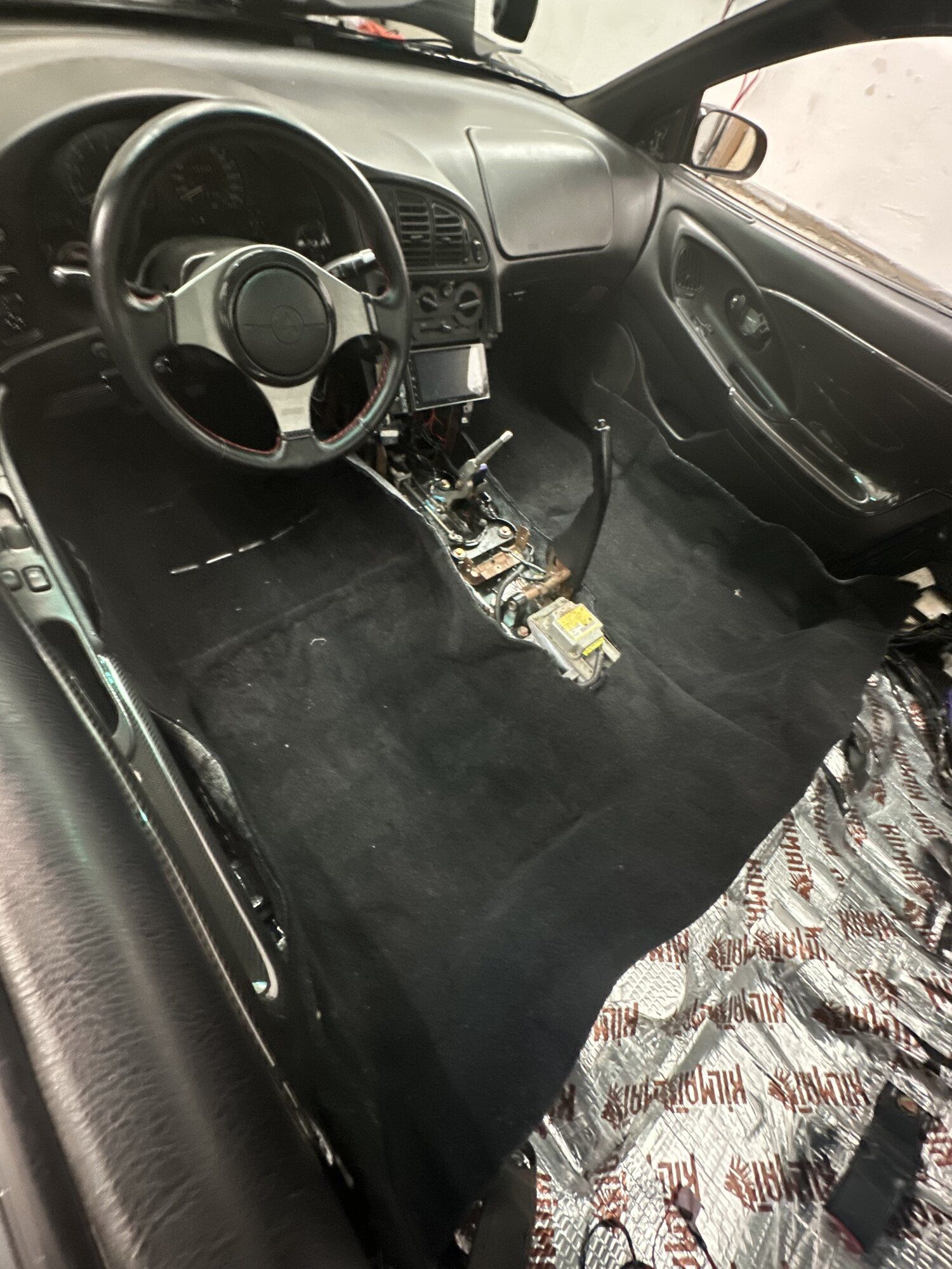

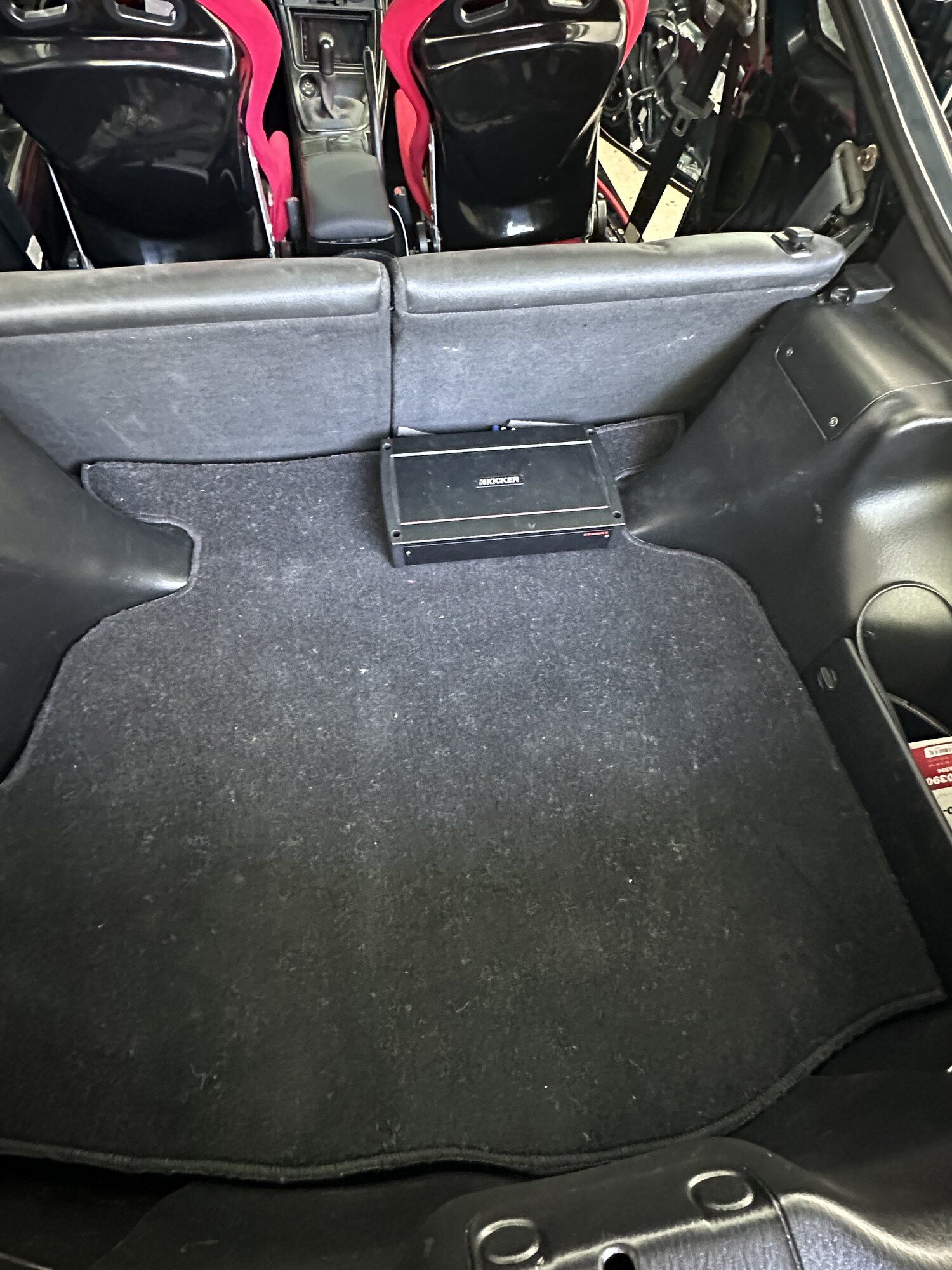

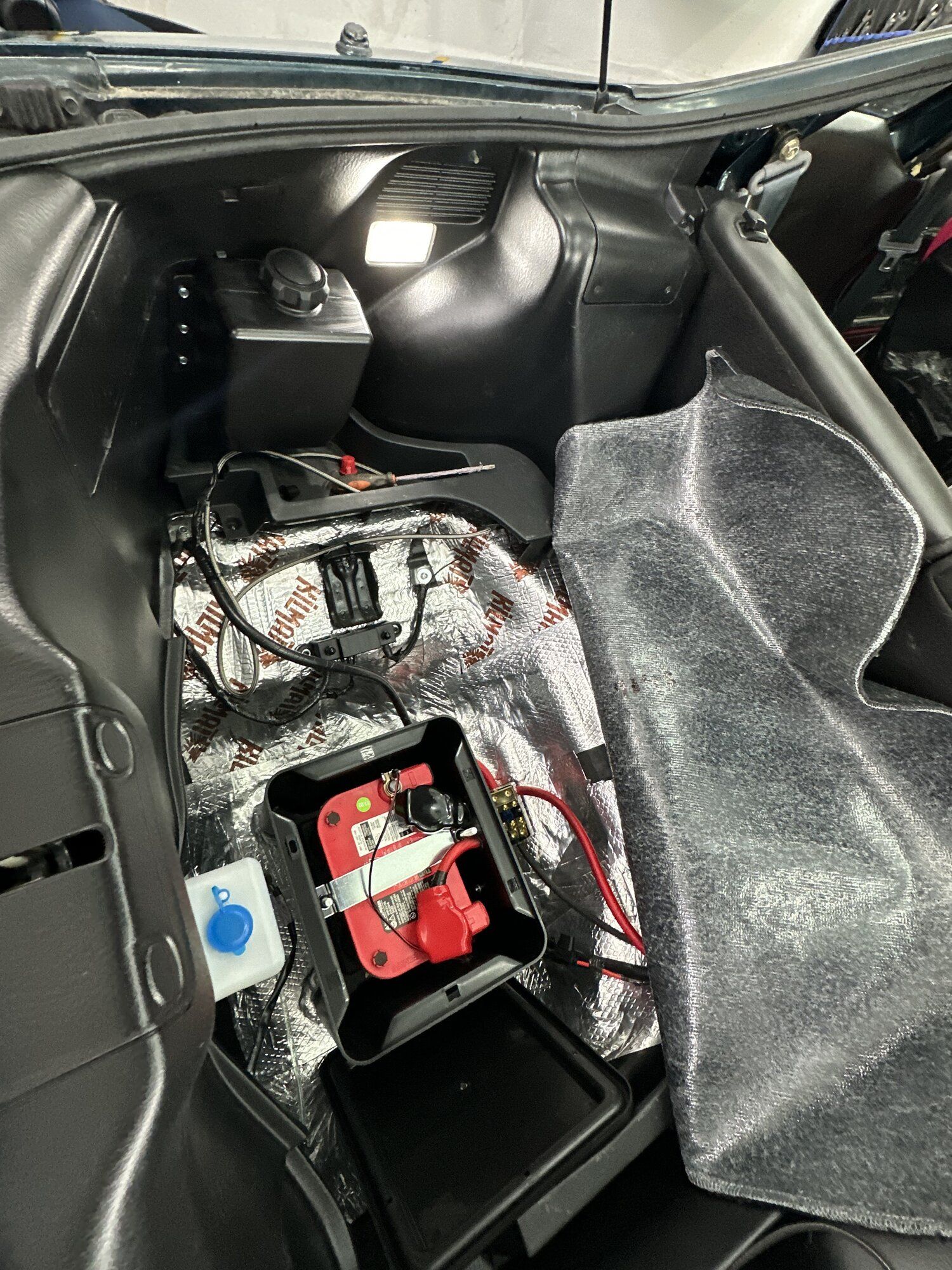

Started installing the carpet after I did some kilmat to drowned out the road noise. Rails and spacers are now on the seats. Few items left to finish the lower half of the interior. Upper trims and headliner will stay out until the car has the body work done in the spring

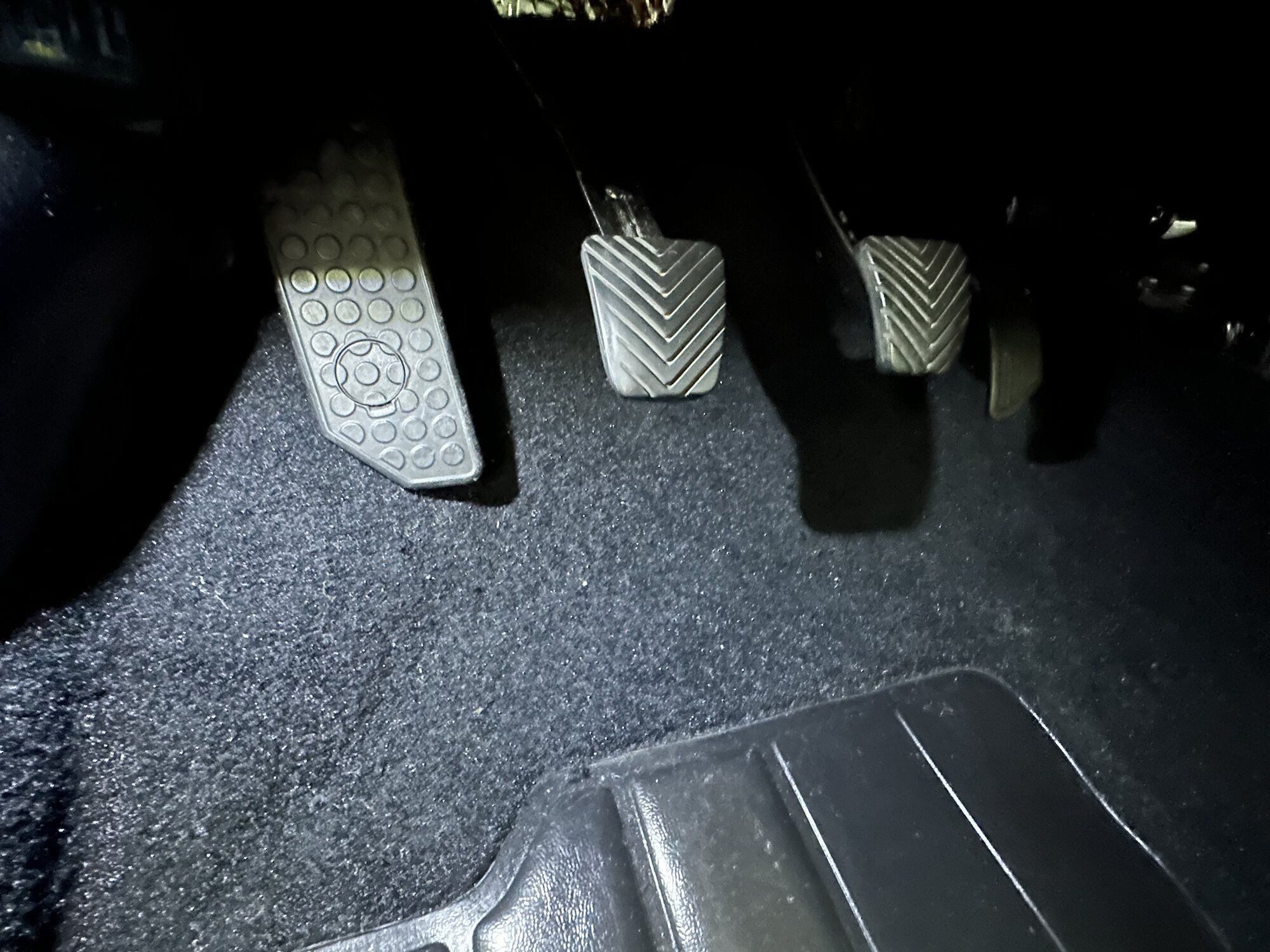

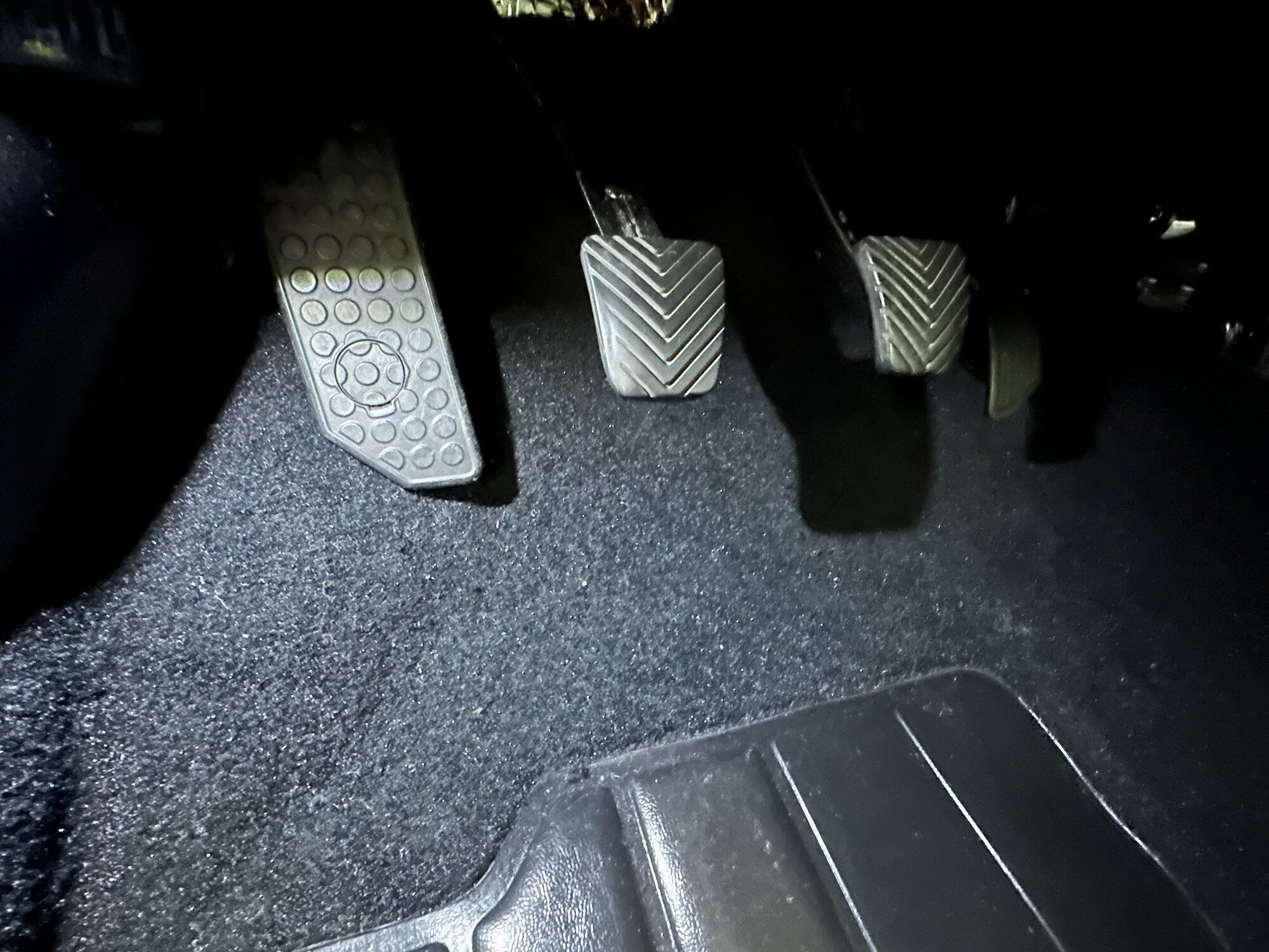

Does anyone have a photo of the pedal assembly showing the dead pedal. Even better if you have a photo with it not installed so I can see where it bolts in. I covered over the holes with the kilmat (fail) and the car never had it installed when I Got the shell
there should be a stud for the top bolt thatll stick out on your floor, you can use that as a guide with your dead pedal on it to find the lower hole. remind me tonight and i can send you a pic of mine

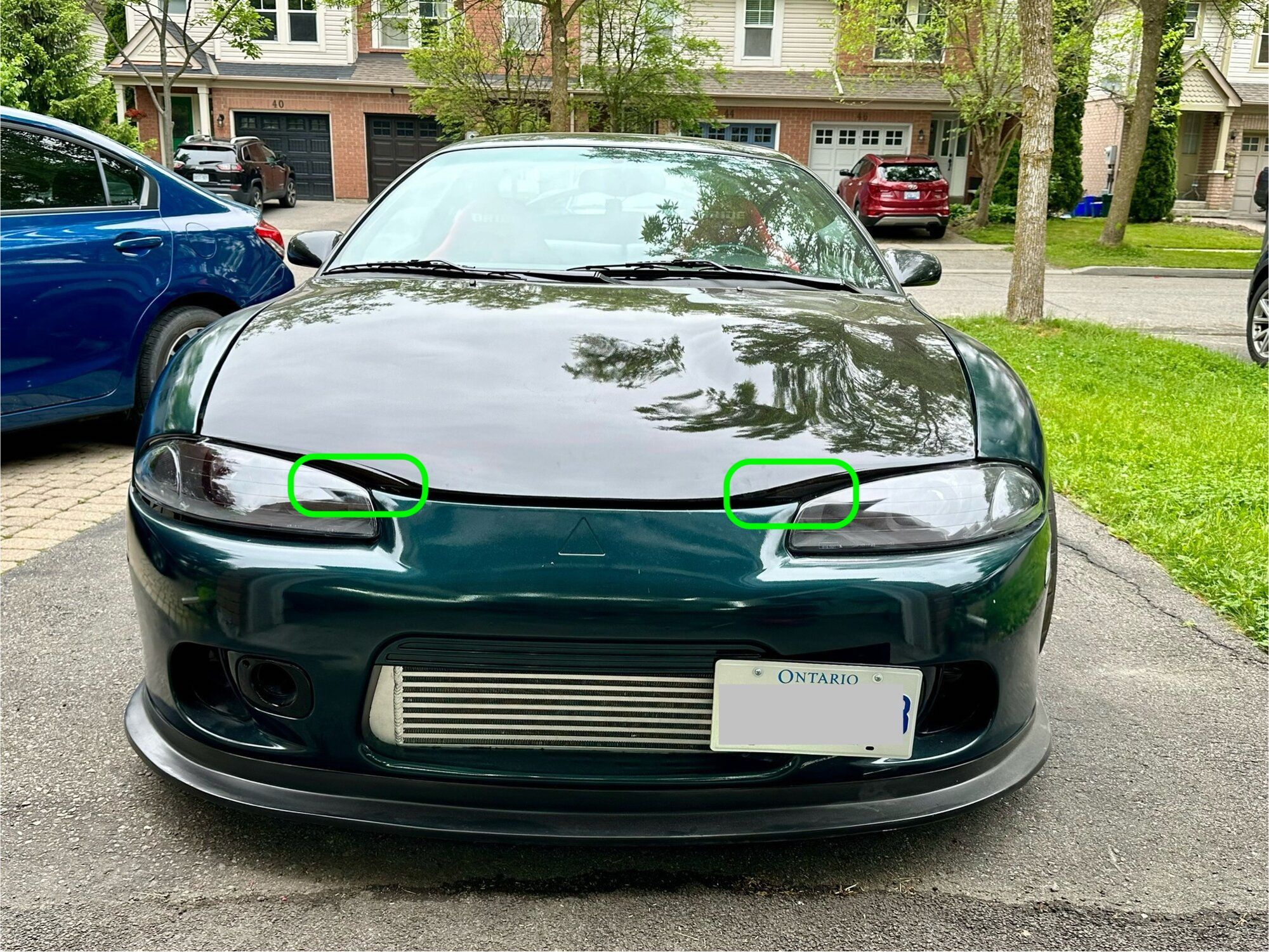

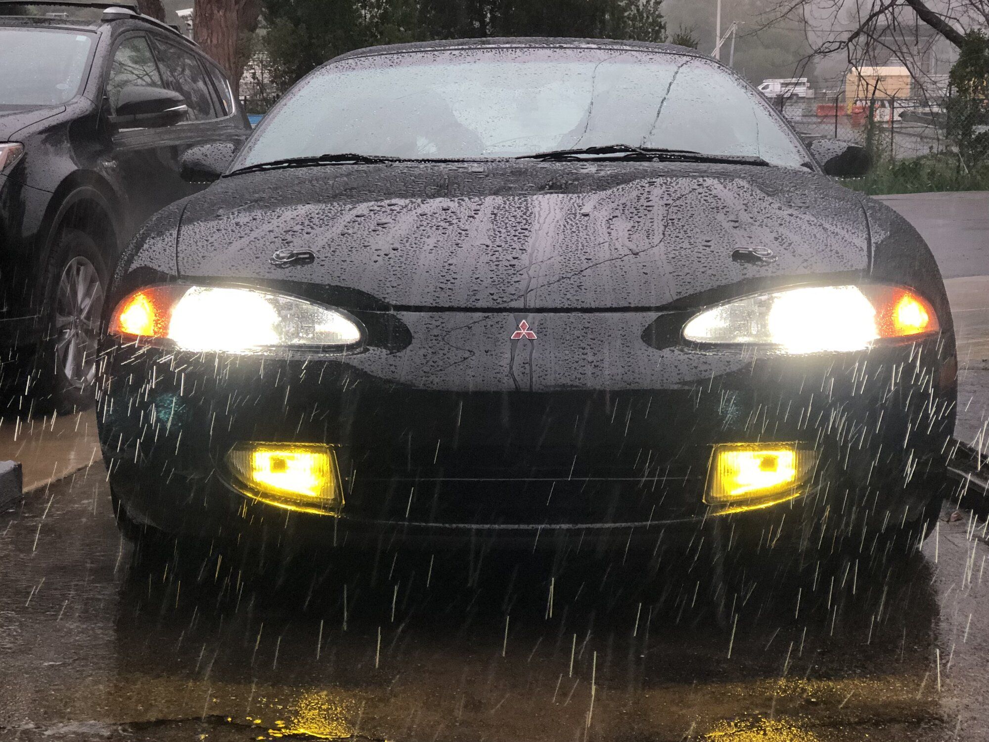

What is going on here? Is this an issue with the bumper or the hood? I've never seen this body alignment issue. I thought 2G's all had the same hood, but different headlights and pumper covers.
