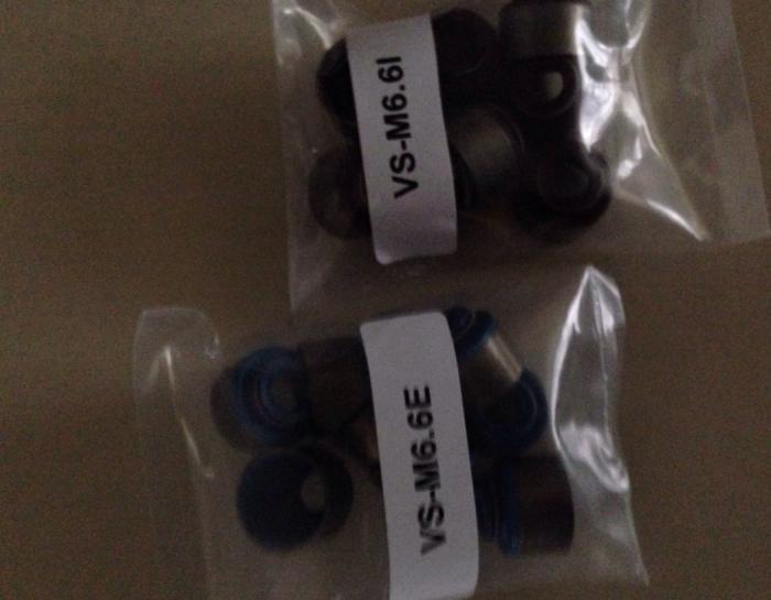

just ordered my viton valve seals for my evo 8 head. All i need are gsc s2 cams and off to the machine shop the head goes :hellyeah:

got my valve stem seals, next up are my gsc s2 cams. I'll probably order them this weekend. :D

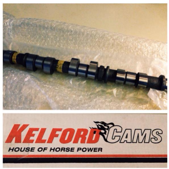

My kelford 272 cams just came in now its time to take the head to the machine shop and look for a short block. Im making progress.

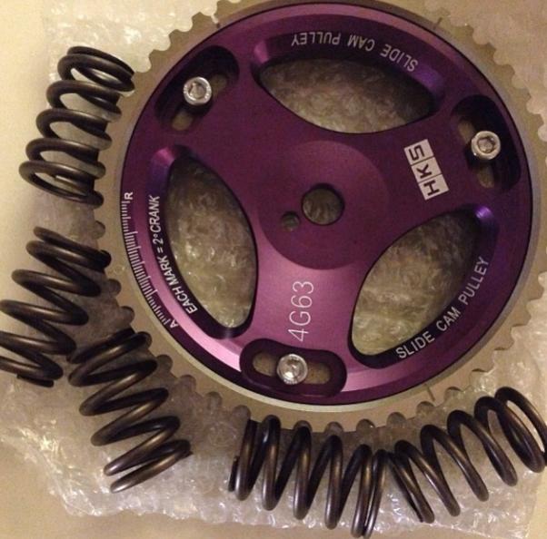

Just ordered a complete running evo 8 short block. Passed compression test with flying colors. Will be getting a 7 billet 20g turbo made for this engine. :D:hellyeah:
