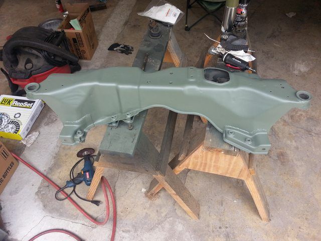

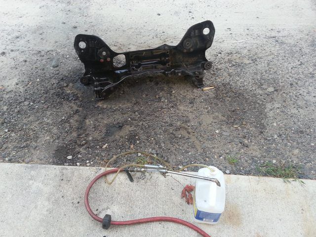

Cleaned it with the mineral spirits then hit the rusty spots with the wire wheel while priming previously worked on areas to alleviate any flash rust:
Fully primed and then sanded with ~400 grit sponge:

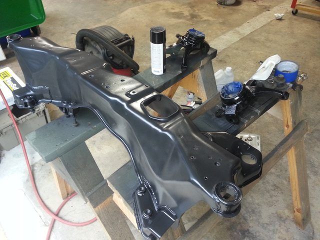

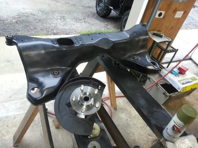

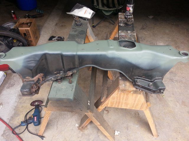

Got a few more cans of the duplicolor black caliper paint and hit up the crossmember and my front spindles (also did my rear engine mount arm, not pictured):
Popped in the poly bushings I found in my shed from who knows how long ago, and pressed the hubs back into the spindles:

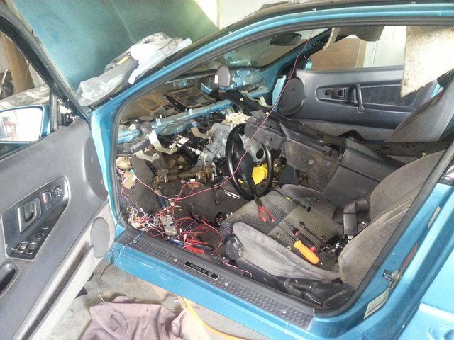

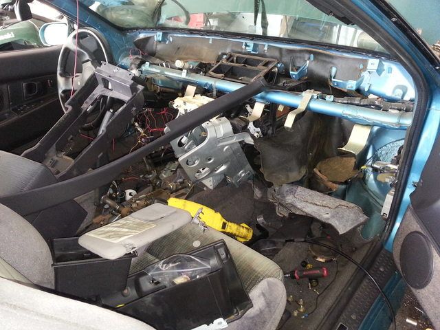

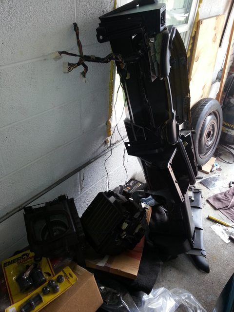

Earlier this week I ripped out the dash, wife helped me and it took about 1 hour start to finish:

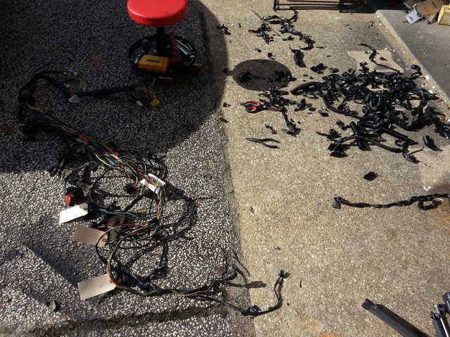

I followed one of the how-to's on here or dsmtalk, i forget, but the pictures from the how-to were long gone, so I had to guess at a couple bolts and screws here or there, luckily when it came down to pulling the dash out, I had only missed 1 screw I had to unfasten. After the dash it out, and you want to do a wire tuck, this is a great time to do it. The wire harness from this car is a little chopped up, because when the previous owner had it, when he installed the s-afc and maf-t, etc, this was before there were plug-n-play harnesses, so he hard wired everything. This means I have some soldering to do since I'll be doing DSMLink v3 with speed density.
So If you want to consolidate a bunch of projects on your list, taking out the dash is only an hour, and then removing the blower fan box and evaporator coil box is only another 15 minutes or so...
Unfasten all the 10mm bolts along the firewall, unhook all the connectors/grounds, there's a couple phillips-head screw-down tabs under the floormat and near the shifter cables, and she pulls thru pretty easily into the engine bay...
This week will be engine bay cleaning! Who knows what else...huehuehue
A pic from sunday, and while I was taking all this wire loom and tape off the ecu harness, I was wondering, is the poor guy/gal that sat in the factory all day and just taped these looms together still alive ? I mean, this is what that ONE PERSON did, ALL DAY EVERY DAY. Just tape wires together....and would they be mad that, 22 years later, I ripped it all apart ?

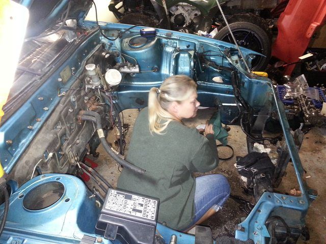

The other day I saw someone had their woman in the engine bay cleaning, so I wanted to duplicate that, LOL:

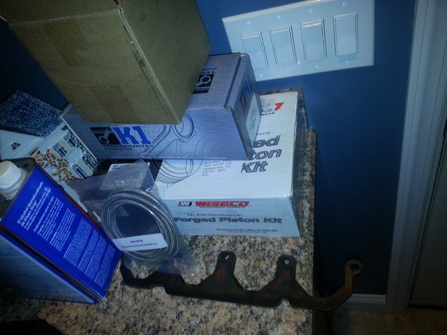

1400HD 40-over's came in, kiggly girdle is in, and some other stuff is here and/or on the way. But now that the girdle/pistons/main studs are in, I can drop that off to the machine shop so they can bore the cylinders and align-hone the mains:

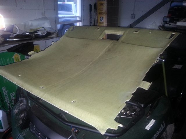

So anyway, got the headliner out and scrubbed off all the old foam:

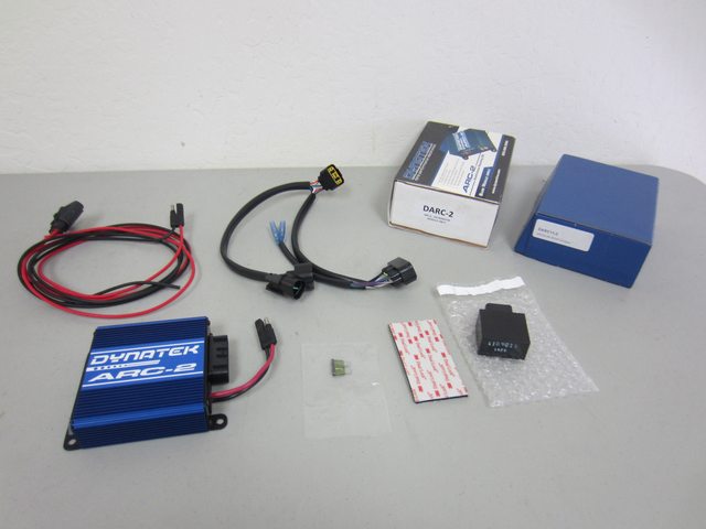

Arc-2 setup with mitsu wiring harness came in:

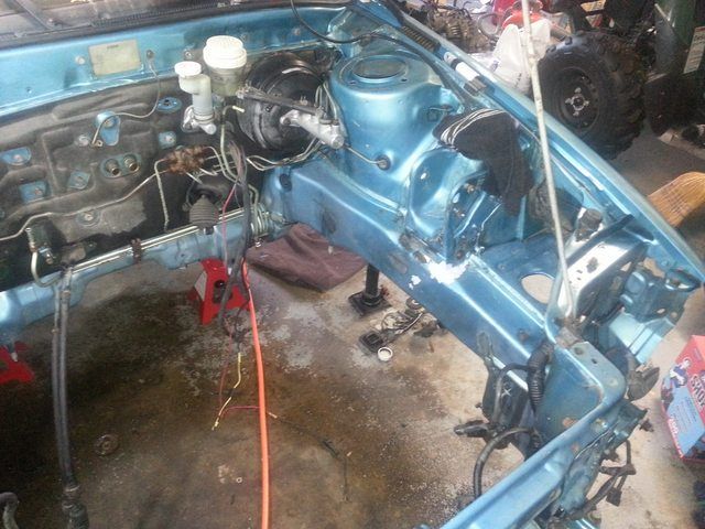

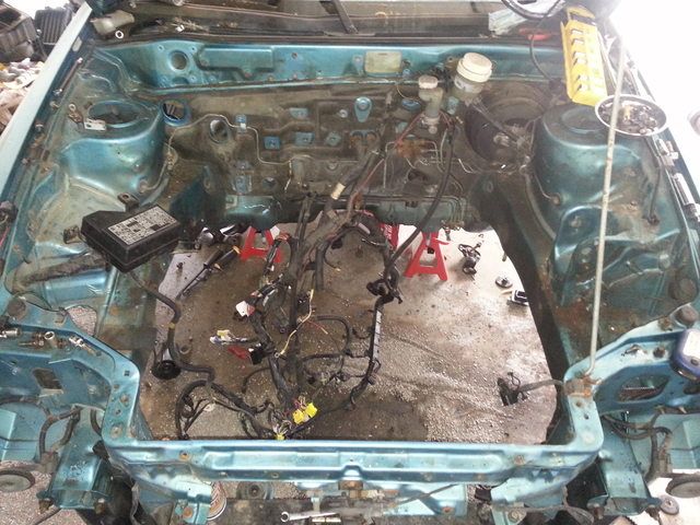

And engine bay cleaning some more tonight, with the lightspot near the driver's side engine mount being a test-spot for a little brush on rustoleum primer after I hit the weld with some wire brush action:
I ordered a "pen" and a 2oz brush bottle of the touch-up paint for the car, which should have come today but we missed the mail man. I'm not convinced I want to keep the engine bay the Tennessee Blue, but then there'd be even more work to take the rest of the crap out and paint it some other color.

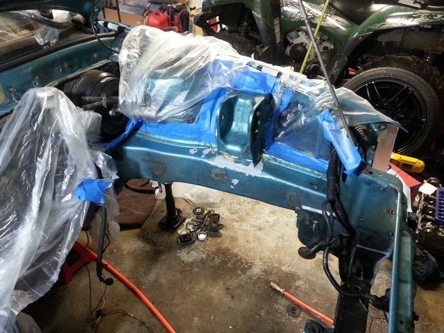

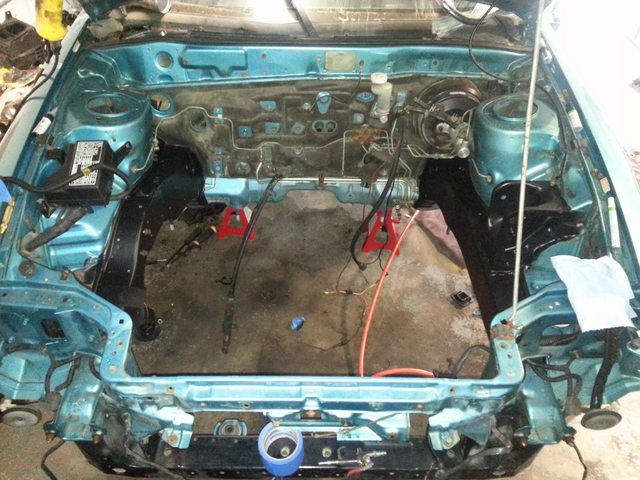

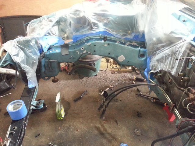

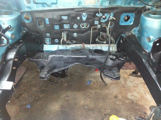

9/23: More engine bay prep, wire brushed all around the welds for the engine mount, plus a couple bolt holes that had rusted and the paint was bubbling around them:

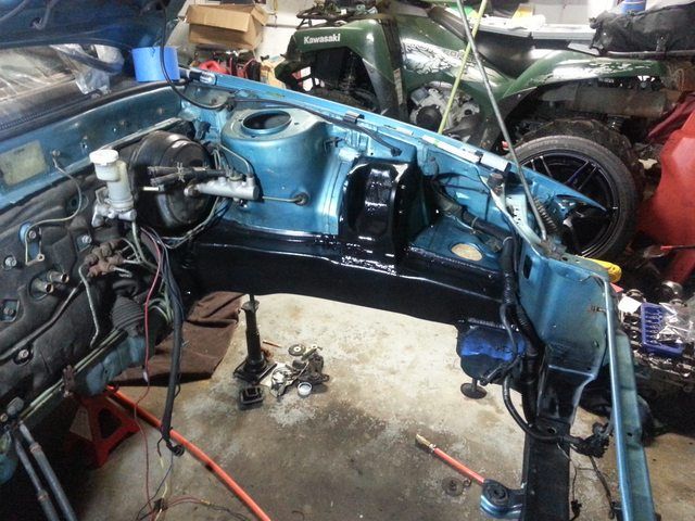

Hit Home Depot today for some Plasti-Dip in black, which is only $6 a can there, so I grabbed 3 cans. Never used this stuff before, and I figured that if I didn't like the results, I could just peel it off. But at least there'd be some sort of coat over the primer above.
The way I taped it off, kind of makes the unibody look like it has a frame rail, like a classic car (tell me the 1g isn't a classic LOL )
So here's how it looks after 3 coats of plasti-dip:
Yay or Nay ? What do you guys think ?
No, the rest of the bay isn't terrible, I'd like to keep it as original as possible without having to spray whole areas with Tennessee Blue, so I thought this could give it a sort of classic look, like it was a framed car and not a unibody.
That front lower rad support being black wasn't from me, it was like that when I got it. Not sure if that's supposed to be the blue or if it was repainted or what... doesn't appear to have any previously fixed damage from a front end hit or anything, plus that black lower half looks like its original. Beats me on that one, but it'll be covered up by radiator, condenser, and fmic anyway.

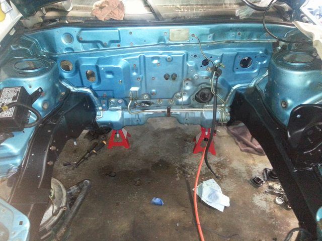

9/24:
Taped off and prepped the passenger "frame rail":
Here's the finished product:

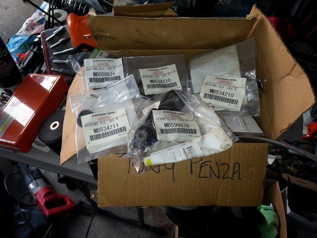

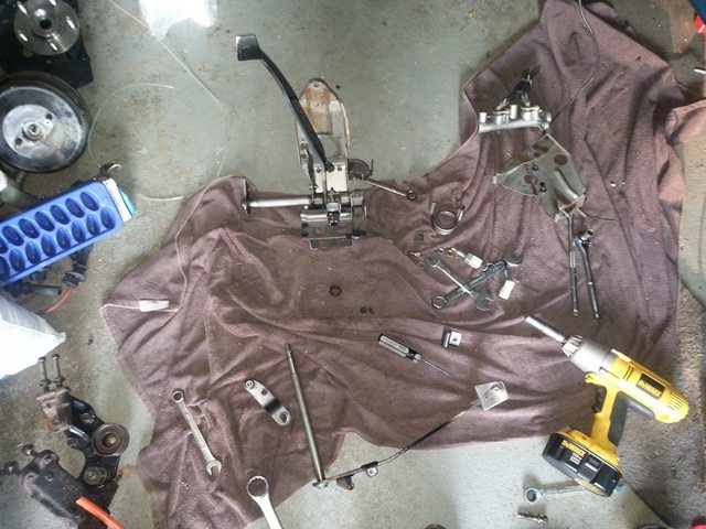

Got the pedal assembly out for inspection, the clutch plate isn't bad, almost looks like new. But it turns out I was about to order the new bushings for the pedal assembly and new plate, and for some reason, I happen to have these parts (Except the new brass bushing for the clutch pedal), in a DHL box from Josh from I don't know how long ago:
Everyone on the internet is right, its not a project you want to do again!

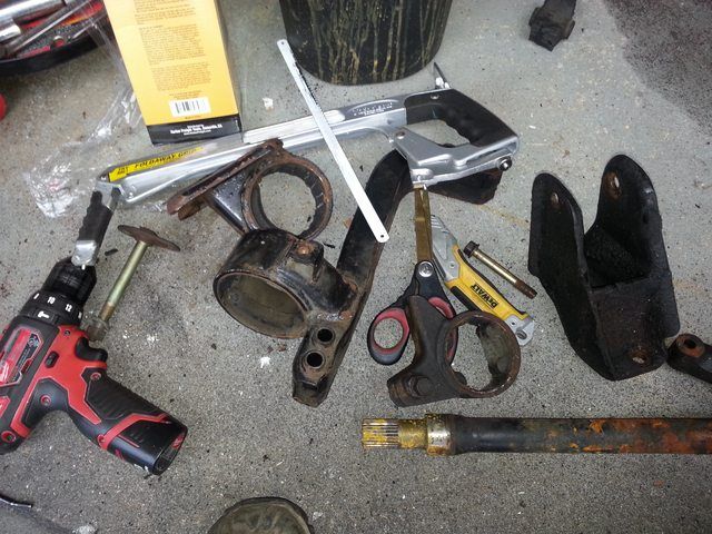

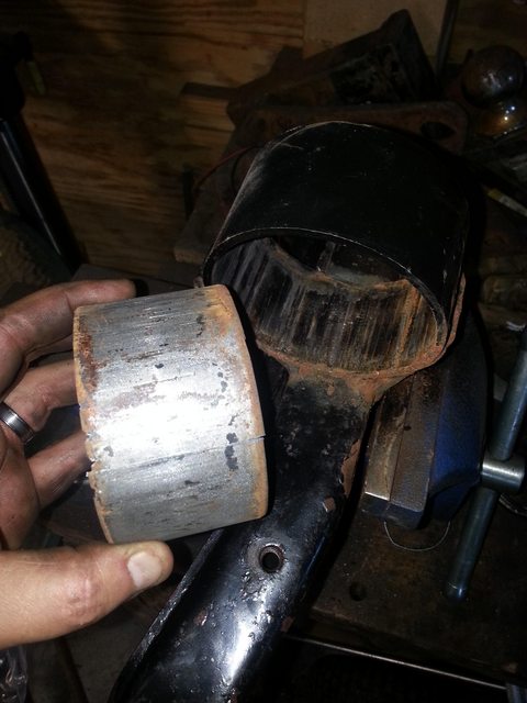

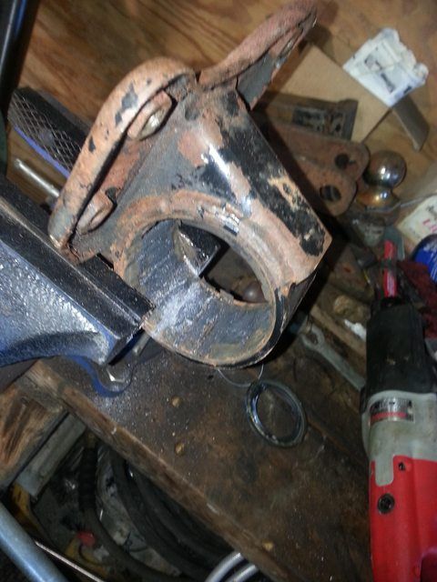

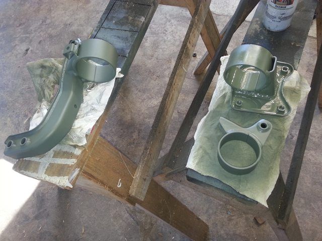

So on to the actual work I had planned for myself, which was get all 3 motor mount sleeves out, as well as rebuild the driver's front half-shaft "carrier" bearing/seals. Let's start with the mounts:
Since I drilled out the rubber the other night, just had to sawzall a slit in the sleeve:
Then grab a hammer and chisel and work the sleeve out:
** Important note on these, the first one I tried, I cut the sleeve in 2 places, and punched out the smaller piece, then the bigger piece just fell out. I decided to try it with just 1 cut on the 2nd sleeve, which also worked. Had to do a little more work with the hammer/chisel, but less work sawing. The 3rd one, I didn't even saw all the way thru the sleeve, and decided to work it out even tho it didn't have a slit. So you can get these sleeves out with just a hammer and chisel.

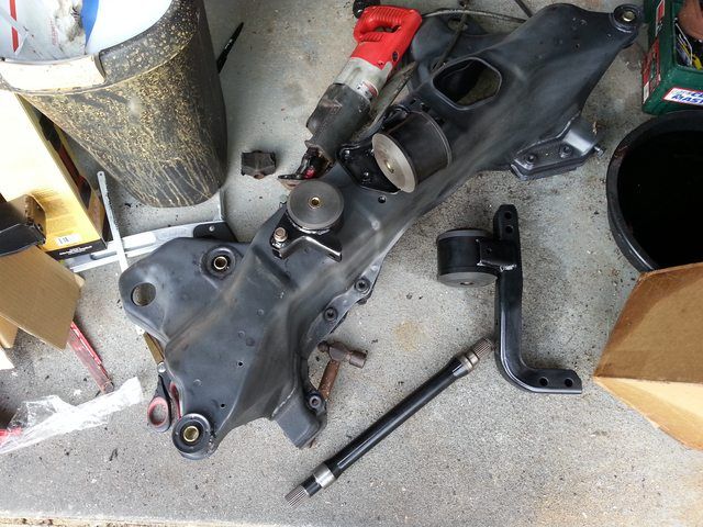

After doing all 3 (2 sides and rear, since I'll be ordering the Kbar 3pc kit) wire brushed/sandblasted and a coat of primer:
Finished product:
Turns out I'm an idiot. And that one on top there, with the bolt in it, is the FRONT. I pressed the rear poly bushing into it, but at least it's a 2 piece bushing and I'll figure out how to get it out so it can go in the correct place.

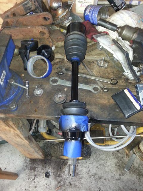

--Also disassembled the half-shaft, wire-wheeled it with the grooves, and repainted it with the caliper paint, came out really nice. Did the same with the axle-half of it too:

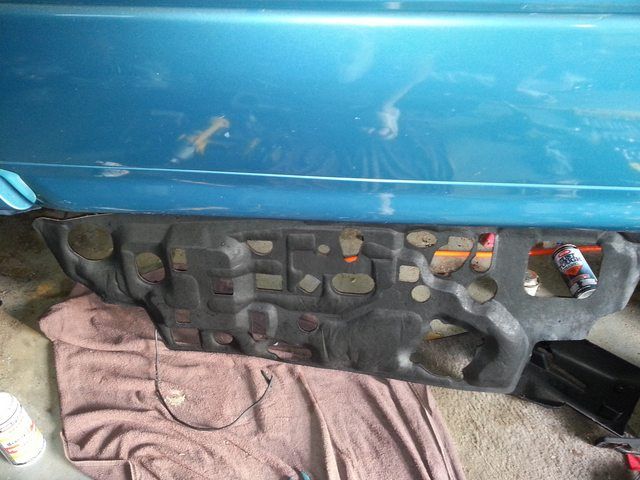

Oh yea, also used a can of the dupli-color black fabric paint and touched up the firewall insulator:
Obviously it looks better in person, and hopefully it'll look real nice in the cleaned up engine bay.
Here are the parts I found, so it looks like I have everything but the upgraded Brass bushing:

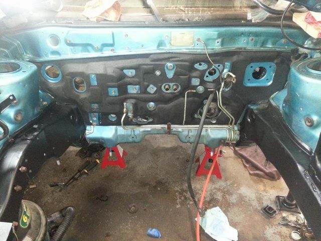

Cleaned up the rest of the firewall that was behind the insulator:
Threw the insulator on to see how she looks:

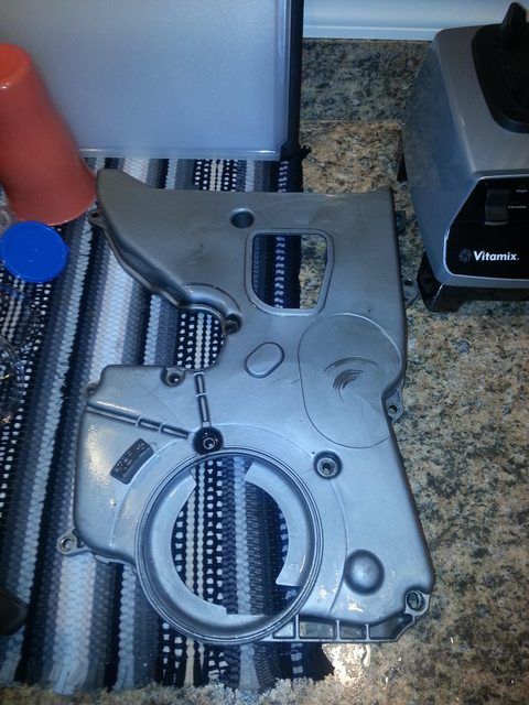

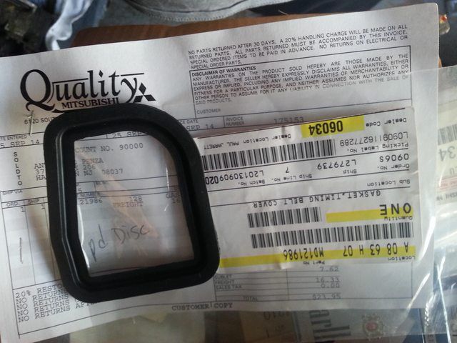

And this came in, apparently the last known 1g timing cover gasket in the US, which I found at Quality Mitsu in Colorado:
Also ordered 1 of 3 known US dust seals for the front driver's side half-shaft carrier, so I can finish and re-assemble my front driver's axle. Passenger side boots are toast, so I'll just get a new axle for that side. (RE this link: http://www.dsmtuners.com/threads/aw...er-seal-out-sourcing-s.429386/#post-153466922)

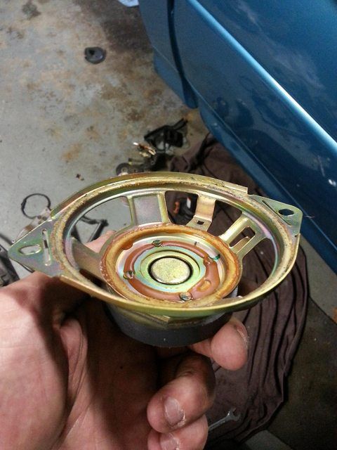

Unrelated, I want to figure out a way to use the OEM dash speaker, only as a mount for an aftermarket tweeter. So I cut out the speaker internals, and I can't really tell how the magnet is attached to the basket. I'll tinker with it more tomorrow:
This would be perfect for an aftermarket speaker mount, instead of having to make something. Figure I'll do a component set, so the woofer in the door, and the tweeter in the dash.
