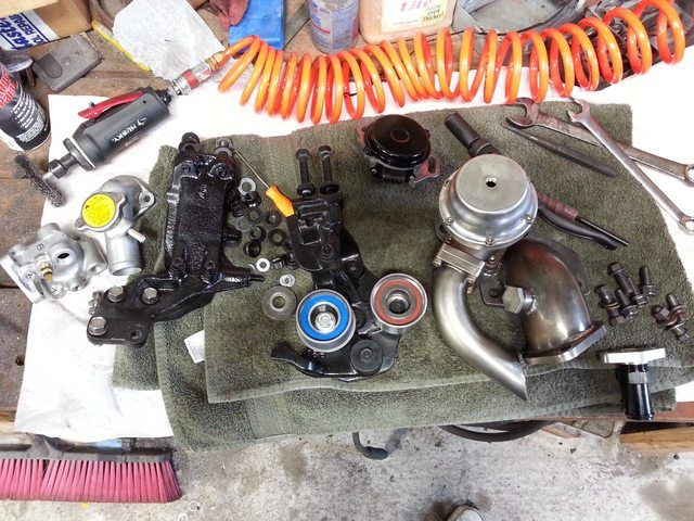

Here's that stuff I was working on a little yesterday:

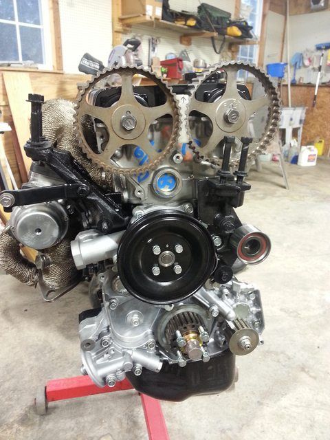

From left to right, New upper and lower t-stat housings, front motor mount bracket, side motor mount bracket w/ new oem timing pulleys installed. CAS (green top) cleaned and painted the top black, my o2 housing/tial wg, and the torque solutions 3/4" npt drain for T6 turbos w/ Jeg's 3/4npt-1"hose fitting.

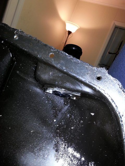

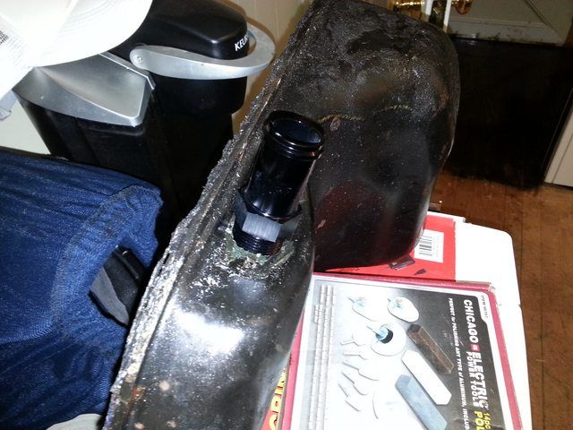

Also grabbed my old oil pan and drilled out the oem hole with the 29/32" drill bit I got, tapped for 3/4" npt, and its not a terrible fit with another 3/4npt-1" hose fitting:
This is just finger tight in the oil pan, but I think it'll work well.
So I'll just do some test fitment to make sure having 2 straight fittings doesn't make the 1" tubing bend too tightly, and if this does work, I'll drill and tap my new oil pan the same way, and find someone to tig the perimeter of the fitting, as well as the original bolt holes shut.

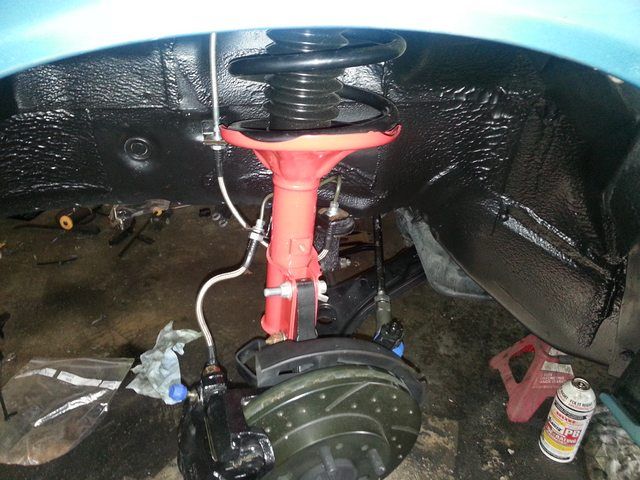

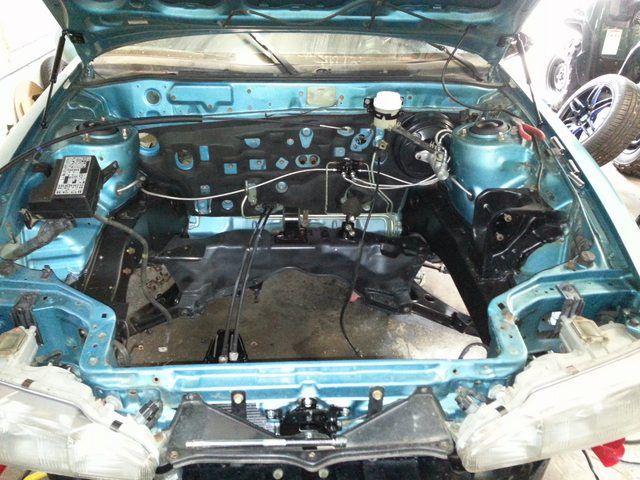

Had a long weekend, so wanted to get some work on the frame accomplished. Mounted up the steering rack, tried to center the wheel and the rack as best as I could, but when I eyed up the hubs, I screwed on the driver's outer tie rod end on 11 turns, whereas the passenger side was like 18 turns. So I might have put the rack up off a tooth to the steering column. Also installed the front brakes and brake lines:
Got the JNZ abs delete lines up (even tho I didn't have ABS in the first place, but damn that stainless looks nice!):
Also in that pic, new non-cruise throttle cable is in, newer shift cables installed (just have to bolt them in from the cabin to finalize), and stevie miller sent me that trim piece there between the headlights. Guess Jim left that off when he installed the fmic or something.
Just have to finish up the passenger side front brake, and install the front sway bar now.

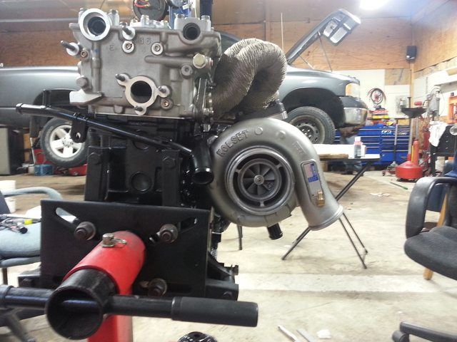

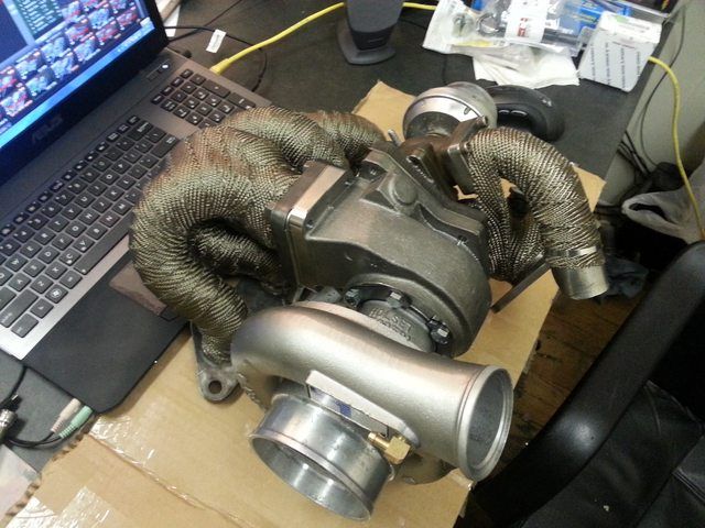

Finished wrapping the exhaust manifold and bolted the turbo components together for test fitment.

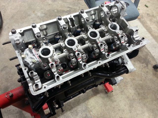

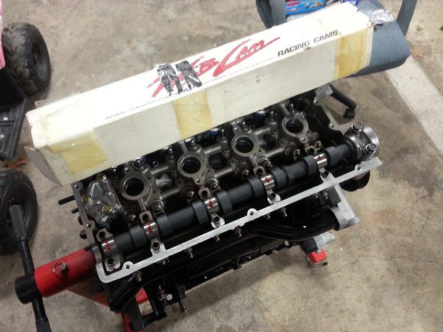

New ARPS went on the block torqued in 3 steps to 90ft-lbs., as well as new revised lifters and rocker arms:
Sexy webcams came next, so glad I found these:
Oh yea, when using ARPs, don't forget to grind down the front motor support bracket so you can take the head off, otherwise the bottom right exhaust stud will interfere with it:
Turbo test fitment, drain angle, etc:
Looks like we're a little cocked here, LOL, took the turbo back off and clocked the CHRA so the drain was pretty much straight down.
Double-checked the front cover, I did have the proper 25mm bolt in the bottom right, but swapped out the one I had where the balancer pulley would go, with a 16mm bolt as I read on here somewhere:
Also installed the new big crank pulley bolt, kinda disappointed it doesn't have the 1/2" socket insert in the middle like the 92 OEM bolt had. I enjoyed being able to turn the crank with just a 1/2" socket or breaker bar... now it can only be done with a 22mm socket. So anyway, have 4 new small crank pulley bolts there, and the cam sprocket tool installed there as well. Wasn't a perfect fit and I had to tap it between the 2 cam gears with a hammer, but its there now.

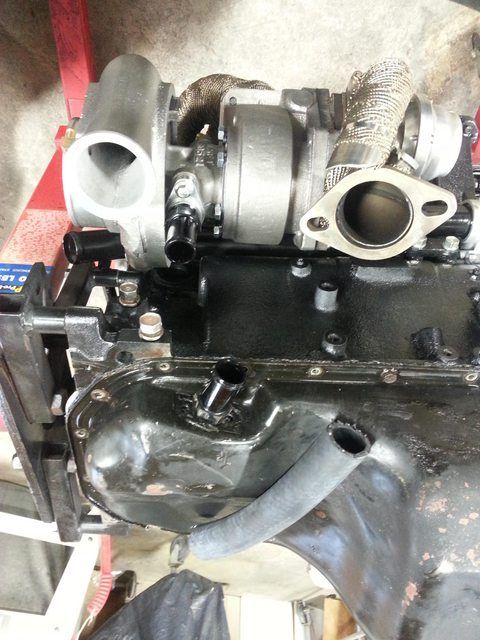

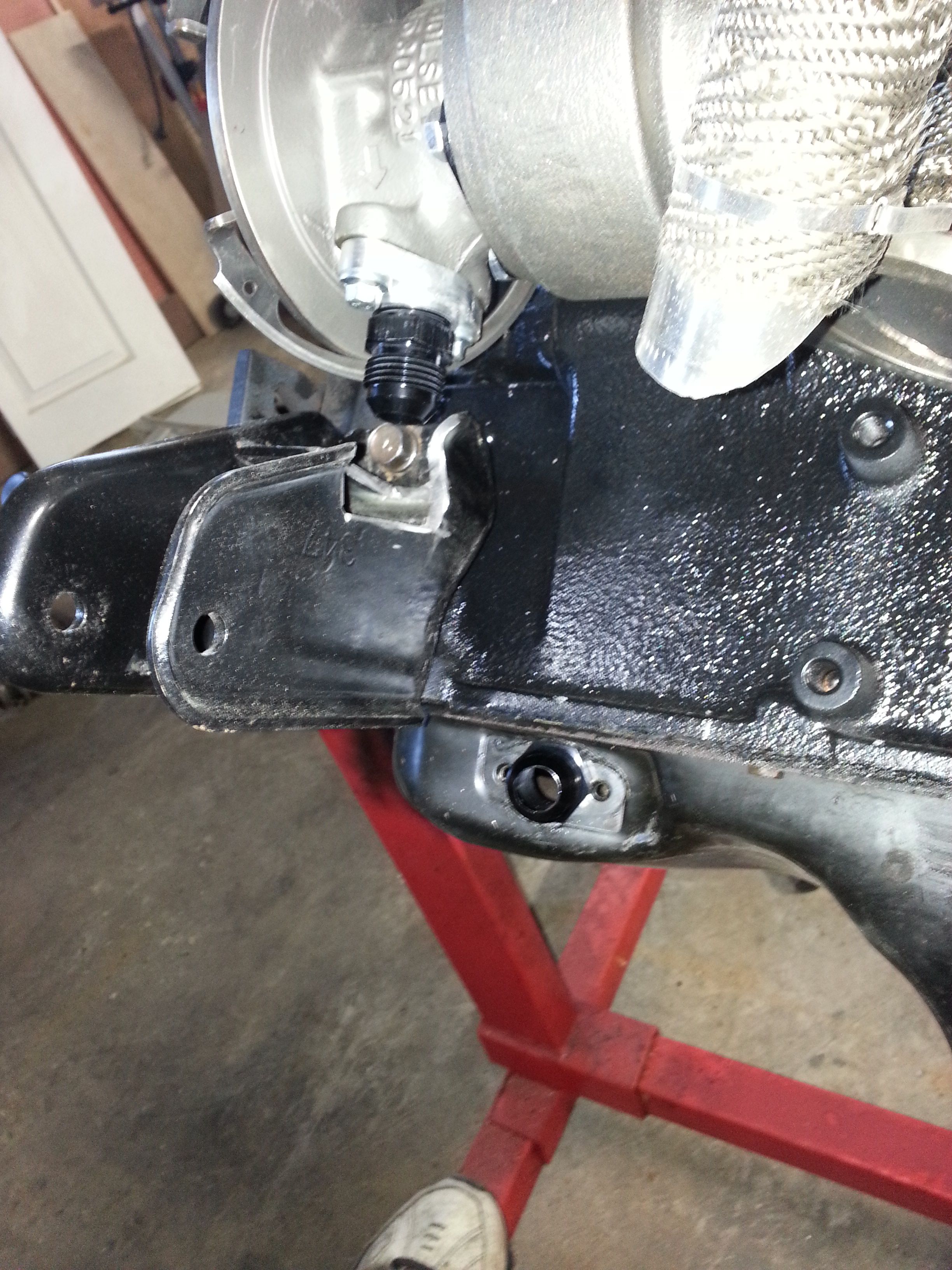

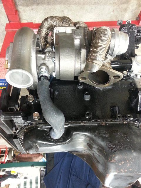

Now to figure out this oil drain. I have the 3/4"npt-1" hose fitting on the bottom of the turbo, and another one mounted on the old oil pan. Here's how it looks with the motor upside down:
and LOL, here's how it looks with 1" hose on it:
Will have to do some more RnD on the oil drain.

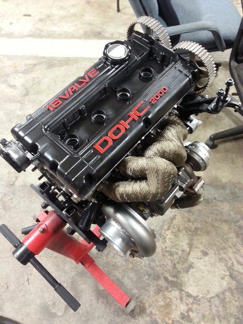

So I flipped her back over, and here's how she looks with the valve cover I painted, and the eagle talon logo oil cap :)

As for your current drain issue, run down to the local parts store and ask to see their hose isle. Find something that is pre-bent in the direction you need. It must be close or the drain will collapse.
Even if you find something to fit, those hoses will be made to handle coolant not oil. You will need to keep an extra hose in the car in the event you find the one your using starts to get soft. This happened to me before I switched to the AN fittings.
FWIW, I went through a lot to find a quick solution that was sub-par and ultimately failed. If I had not checked the hose, it would could have possible ruined an expensive build.

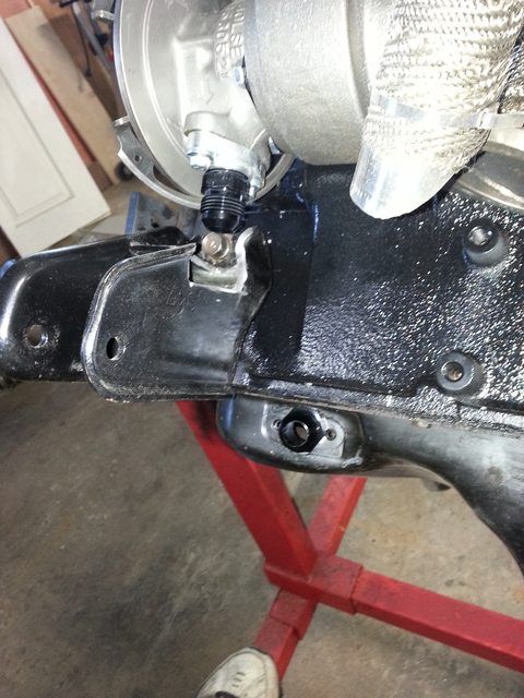

Another thought, welding that bung into the pan really limits what you can do because in will forever be straight coming out of the pan. I would suggest using a weld in bung threaded in 3/4NPT just like the turbo fitting.
Lastly, that front motor mount is going to be in the way. This is another reason why those straight fittings will not work. Before you make any permanent installations, I suggest you check the clearance of the front motor mount.

Rob,
I already researched a couple options for the oil drain/front motor mount issue. I found a 3/4"npt/16an 45 fitting, looks like it would work wonderfully right off the turbo and away from the motor mount.
Then thinking of finally doing a male 16an bung on the oil pan. Then connect it with a pre-made stainless braided 16an hose. I saw a couple different lengths on ebay.
Also, I'm staying away from cam gears. I know people use them, I know people time them, I know cams can come from the factory off a degree or whatever, but cam gear hardware can fail, and that scares the crap out of me. So I'm just gonna stay away from them.
You are using a tubular Manifold that may locate your turbo slightly different than the FP manifold that I used but my drain was hitting the block when trying to utilize a 45 off the the turbo. The only way to make the 45 work in my case was to clock the CHRA like your first mock up picture. The 45 may very well work for you, I just had issues so I am sharing what I can since our setups are similar.

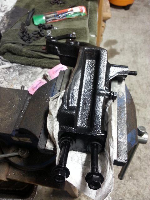

Finally decided to chop up the front motor mount bracket, looks like it might be a little more than @robertbaxley03 did, and I'll clean up the sharpe edges in the middle later, once my drain setup is complete. But for now, here's my old pan that I tapped for 3/4" NPT with a 3/4npt-12an fitting, plus the same fitting up on the turbo drain outlet:
I measured for the hose and it would be about 9" from end-to-end, fittings included. But rather than take a chance on a pre-made hose with ends, I ordered 2' of hose and some various fittings instead. So I'll just do a push-loc style w/ braided stainless hose.

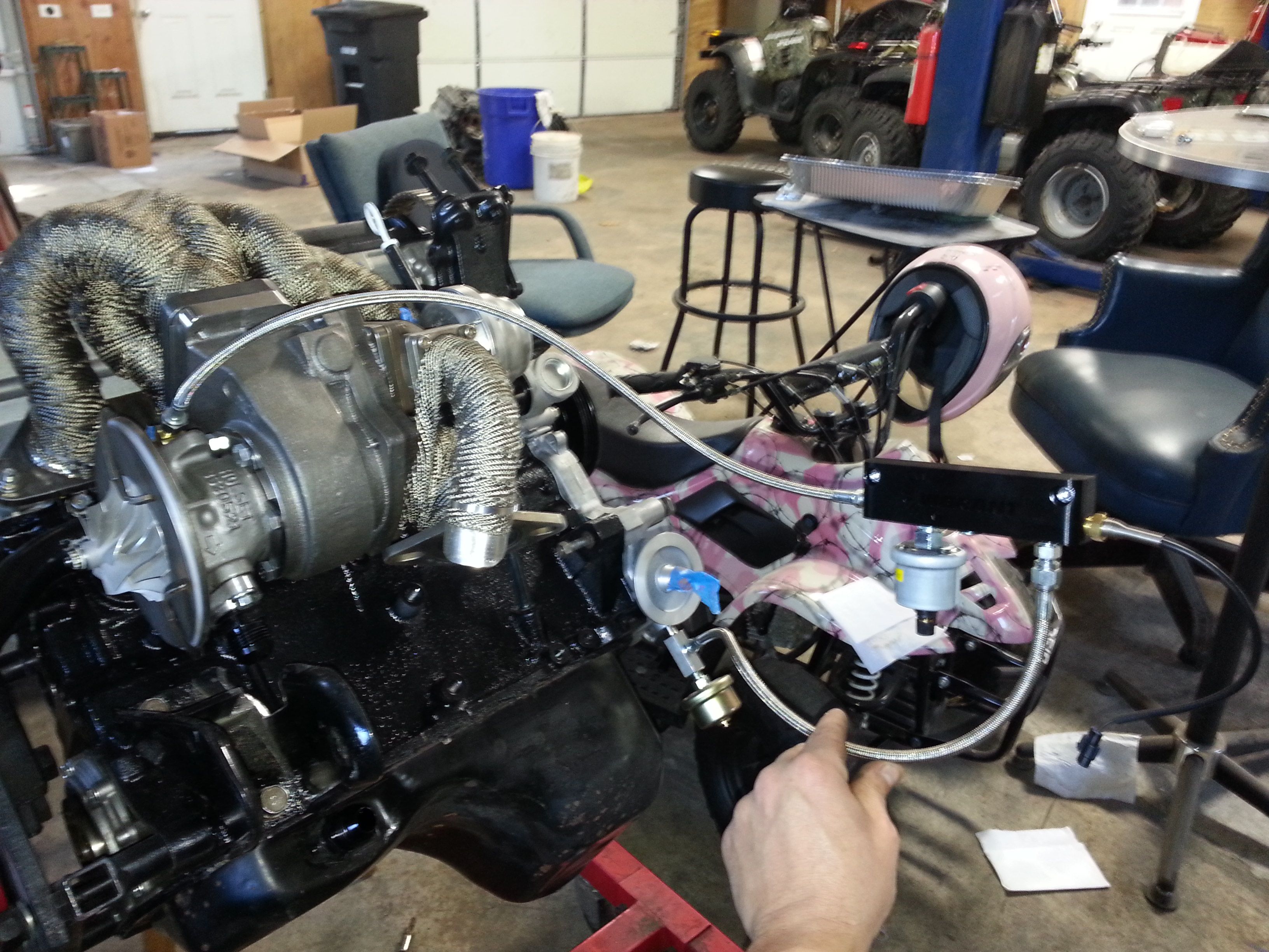

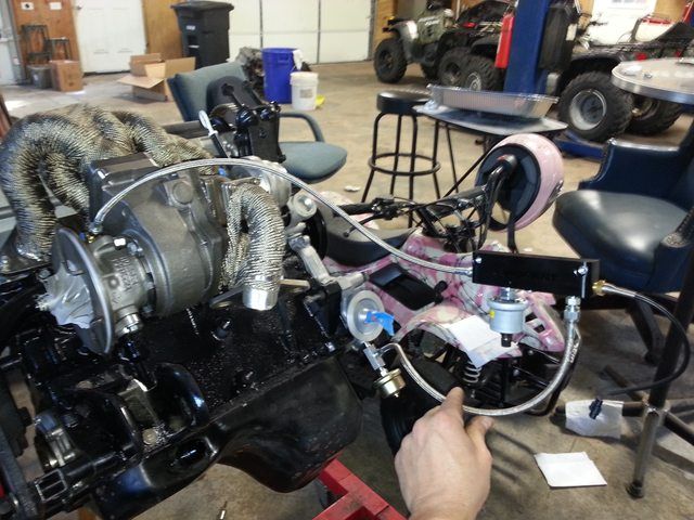

Then onto my oil supply project. I had ordered the vibrant vacuum block, which I'll be using as an oil distribution block. I also have the nifty 1/8"bspt-1/8"npt-1/8"bspt fitting, so I can retain the needle gauge on the cluster. (I'll just yank the bulb for the idiot light). I won't need it because I'll set the innovate mtx-d gauge to blink at say, 8psi, for a warning indicator. Should be a little more noticable than the idiot light on the dash anyway.
So here's the pic:
I have an 18" line to the block, and a 24" line from the block to the turbo. And there's the 2 senders for the innovate gauge on the block. I wanted to mount it to the engine, but I don't think there's really any room for it there, so I might just have to wait and do final assembly once the motor is in the car. If I mount this in the engine bay somewhere, then I'll probably have to order a longer feed line to the turbo anyway.
So I'll just be waiting for the drain fittings to arrive so I can finalize that portion of the build.
I used the push-lock fittings as well and really like them. I had to trim off one of the barbs for clearance but they worked fantastic for me. Just be sure to select the right fittings before cutting them up.
As for the front motor mount, a little more really would not hurt. My drain is fairly close to touching but I was trying to retain as much metal as possible. Can’t wait to see some pictures.
@robertbaxley03 yea, it'll be similar to yours. I ordered -12an barb fittings; 1 straight, 2 45s, 1 90, and 2' of stainless -12an tubing. So far the tubing and the 90 came in, hopefully the 45s and straight are in tomorrow's mail.
