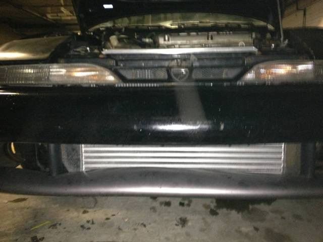

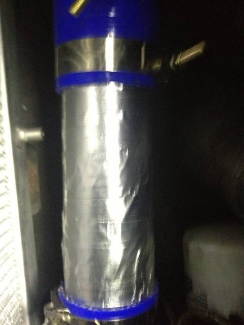

Since the purchase I bought a vrsf front mount to replace the stock smic that was leaking boost horribly, and also wrapped the lower intercooler pipe with dei cool tape to help lower radiant heat transfer as well as installed a halman mbc at this time

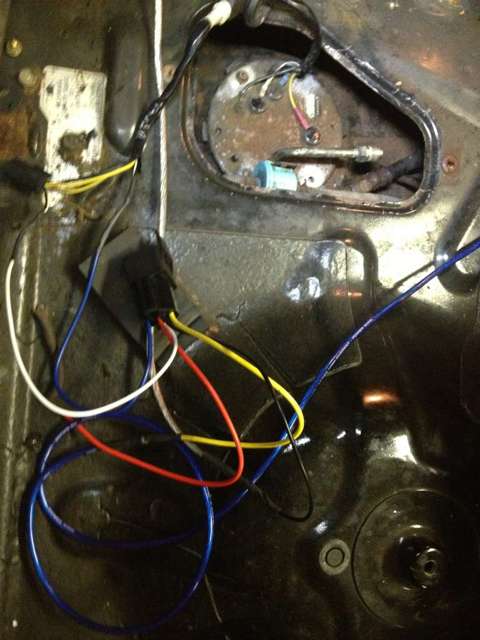

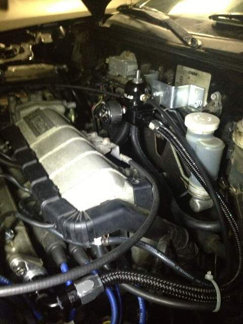

Next came the fuel upgrades. Picked up a walbro 255, fuel pump rewire, and a STM fuel lab adjustable pressure regulator kit.

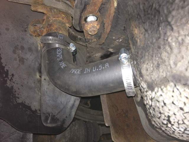

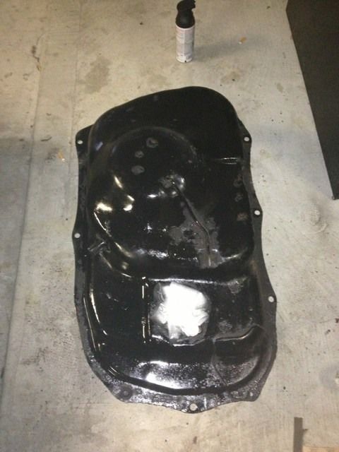

So I dropped the tank to redo the studs I snapped off
Re-drilled all the holes and threaded them for bolts to go in. Also sanded a good portion of the rust off and ran over it quickly with some rustoleum. The fuel fill hose ripped in the process of lowering the tank so I got a hose from napa and trimmed it to fit.

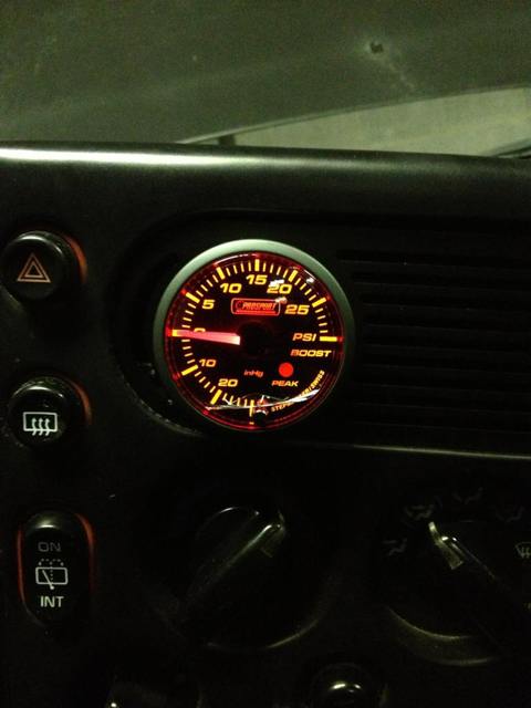

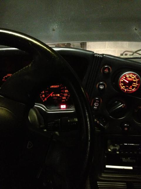

Mini update. Got my boost gauge back from prosport and it's finally working!
Matches the interior nicely

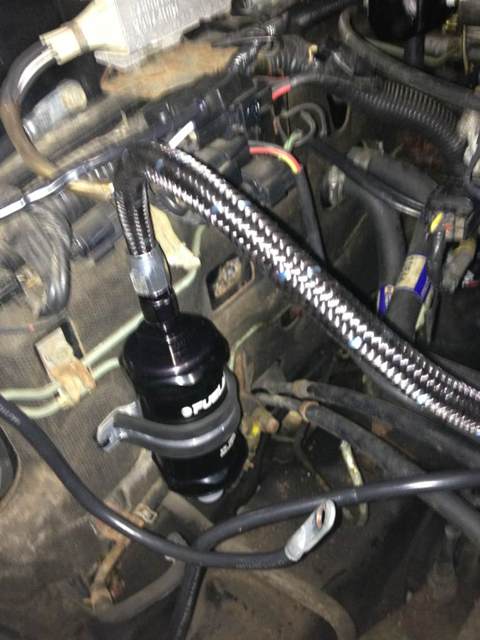

Update, got the STM fuel supply
Kit with fuel lab filter installed
All of the fittings are top notch and fit is very good.
Time to upgrade To compensate for all that adjustable fuel pressure ;)! That 14b and 35+ of fuel pressure and no way to tunes means your dumping fuel And not controlling it at the injectors.

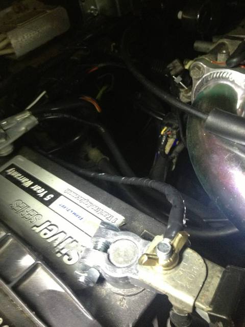

Yeah my plans for next mods are:
Battery relocate
All timing components

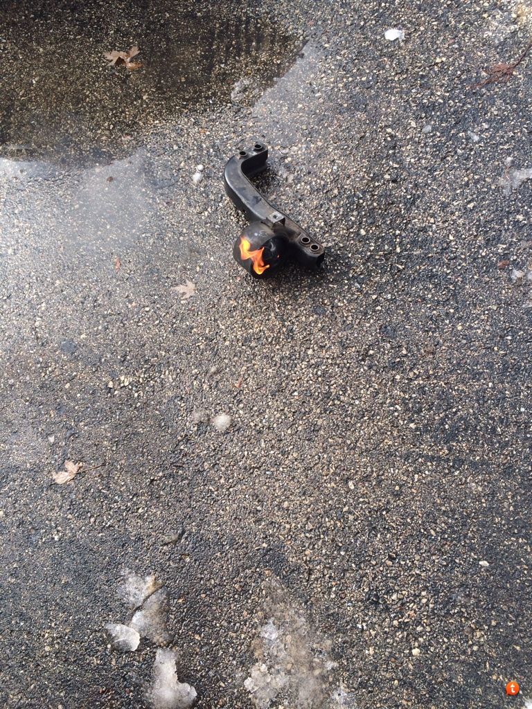

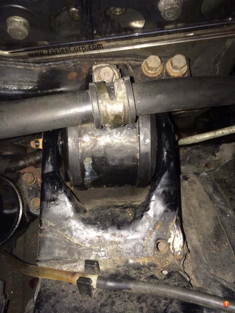

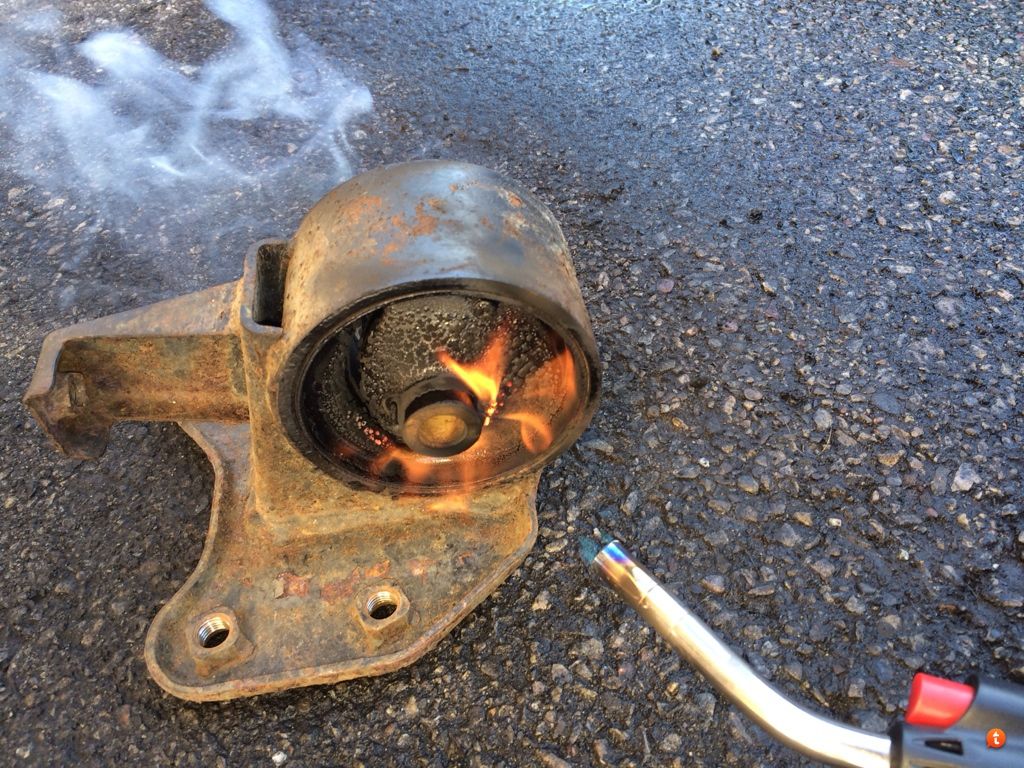

Swapped out busted motor mount bushings for pollys
I did not take pics of the install of the others

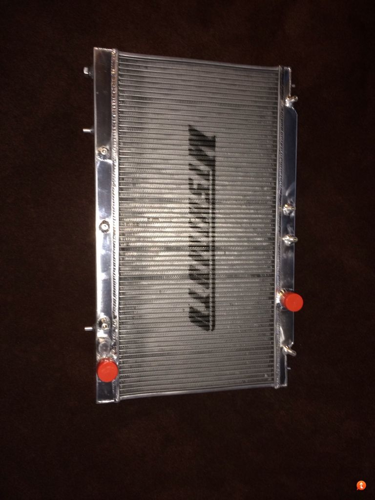

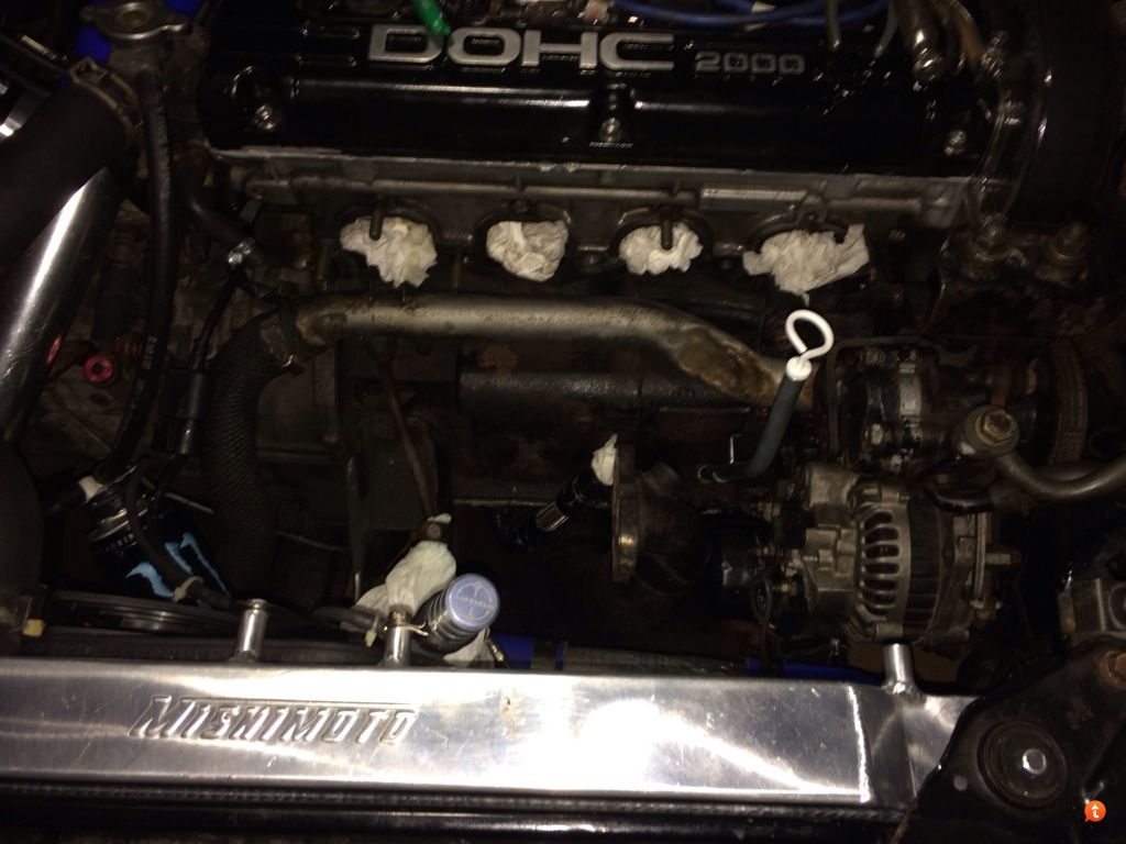

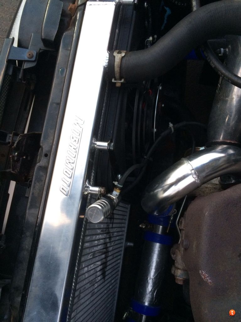

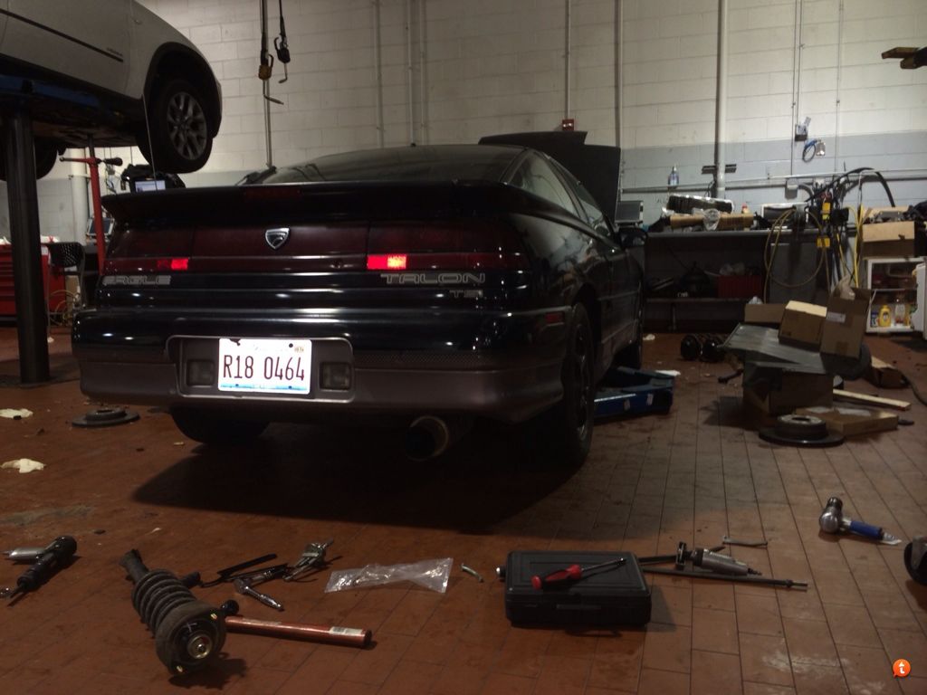

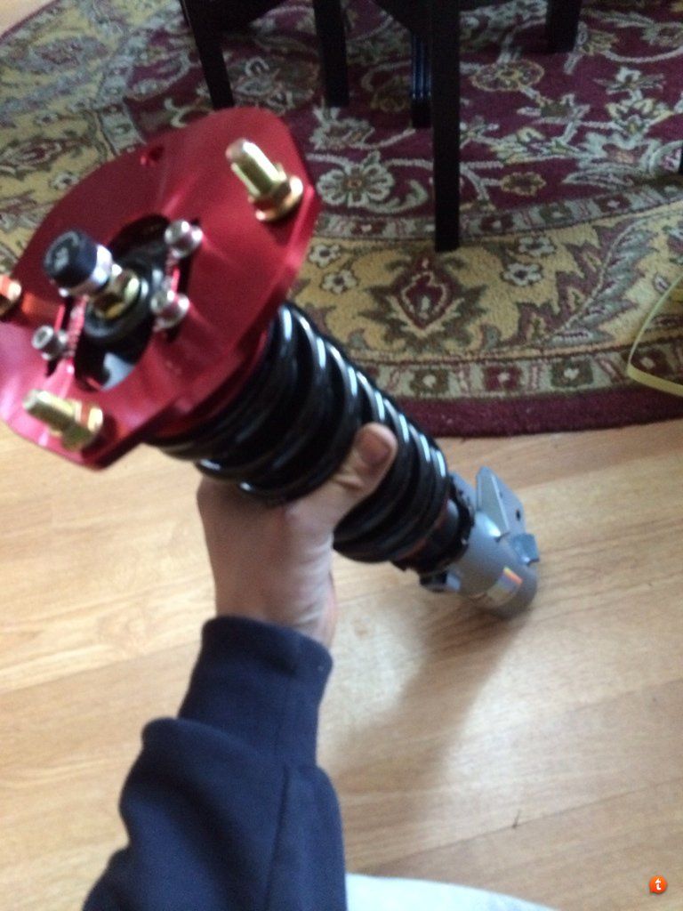

Then I decided it was time to ditch the blown shocks so I picked up a set of Megan coilovers and a mishimoto radiator with a fal shrouded slim fan. I installed the coil overs adjusted the ride height and did an alignment at work and set the camber to be equal when my weight is in the drivers seat

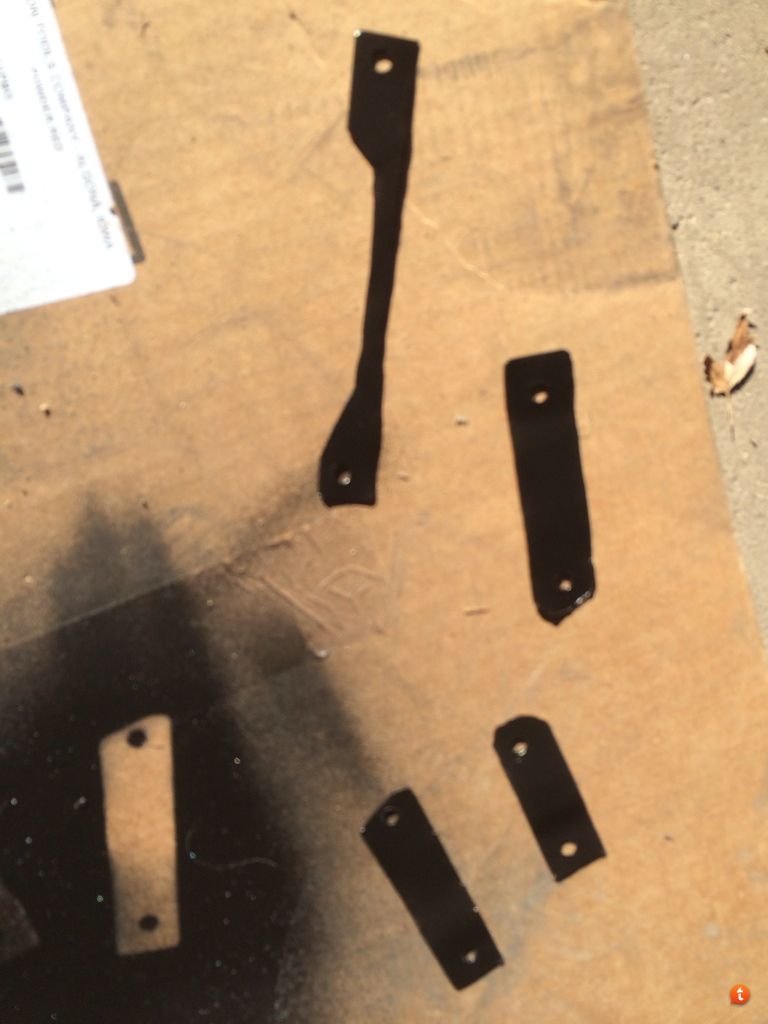

Went to drop in the radiator but the fan wouldn't bolt up so I had to fab some
Brackets
Bolted up

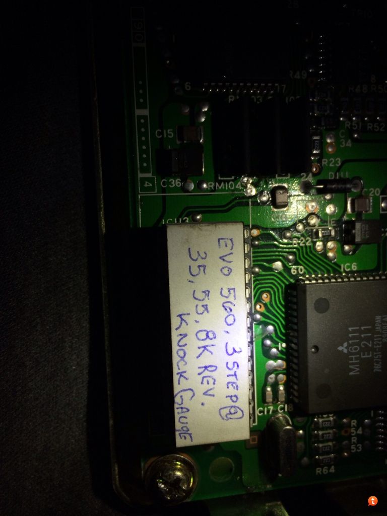

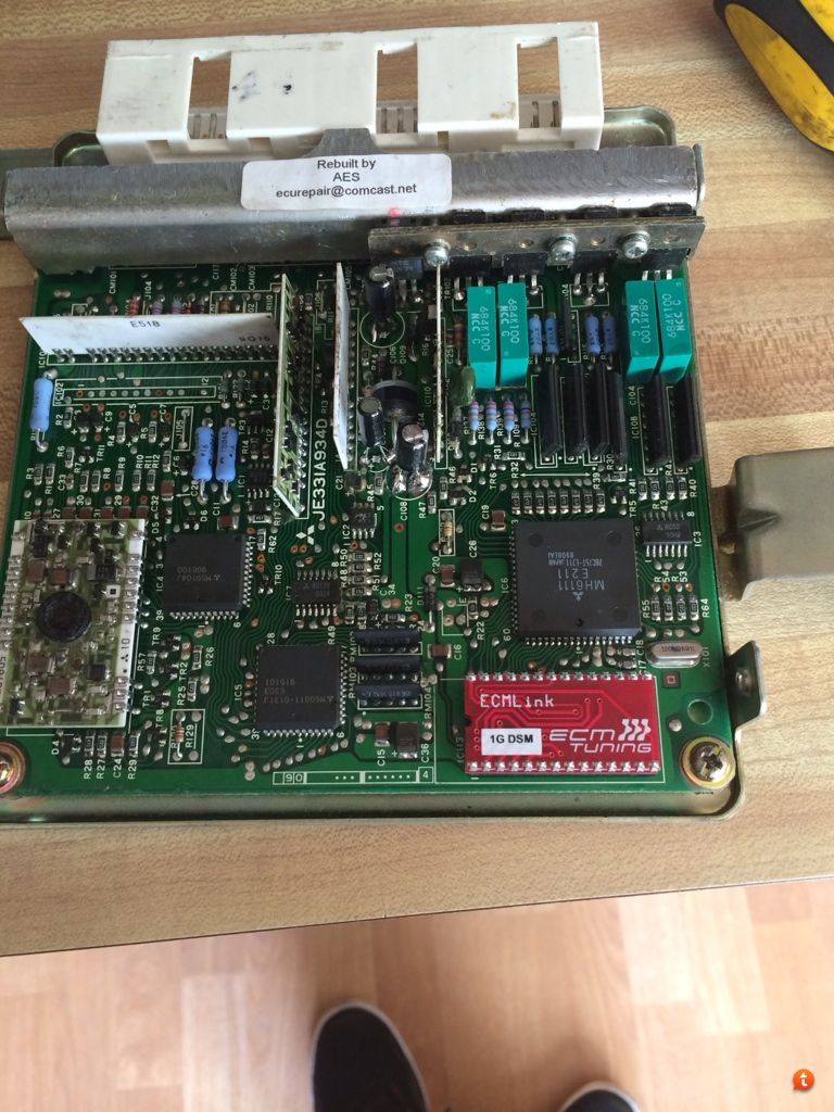

We'll now it was time to tune it to get a little more power so I pulled the ecu and found
That had to go so I got ecmlinkv3

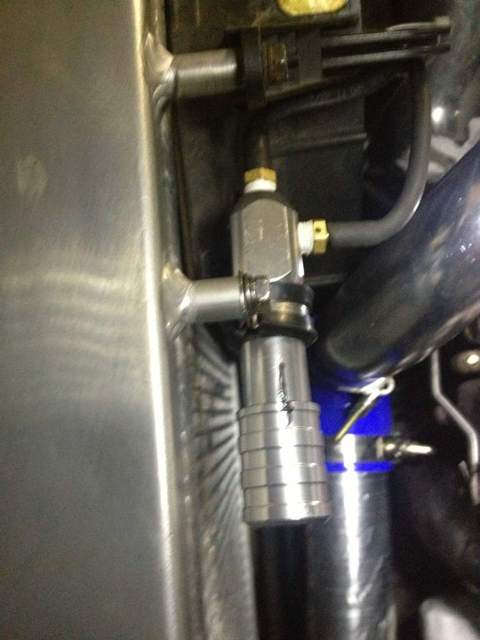

Next I needed a way to log my afr, so I grabbed a innovate mtxl from extremepsi
I'll have to take a picture later of it installed into the center vent, I decided to run it in the primary o2 location and simulate the narrowband through Ecmlink

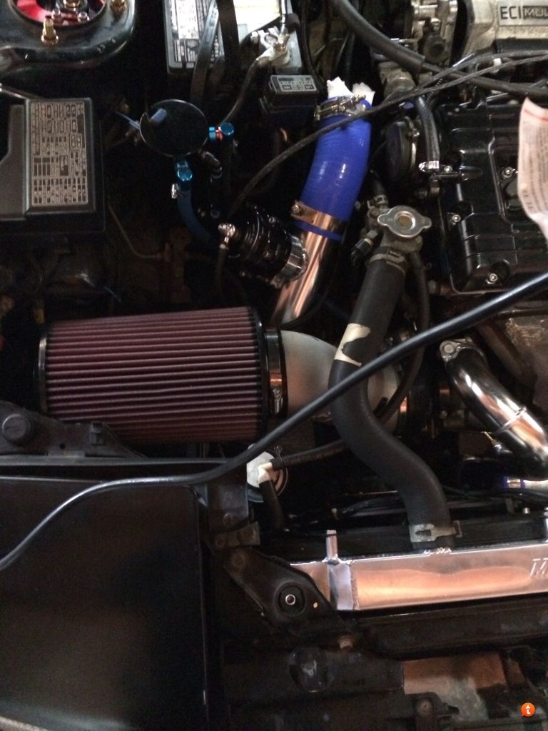

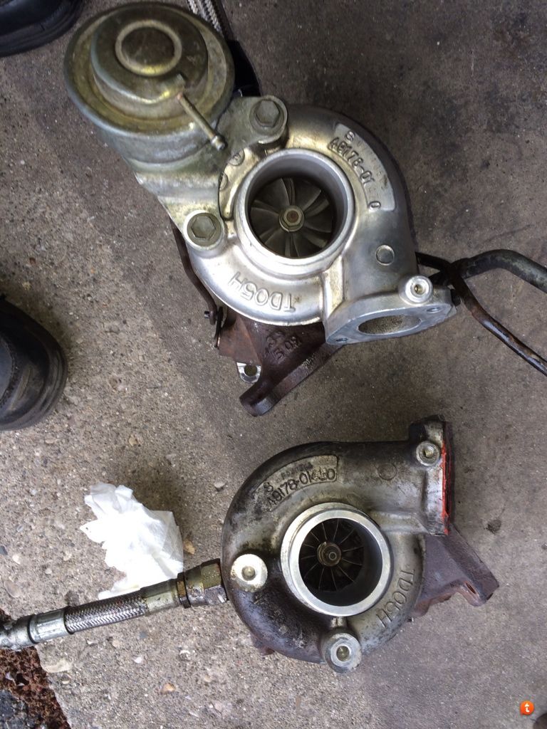

I could not recirc my 1g bov because of the vrsf piping that I had being too close to the 2g intake i was using, so I grabbed a tial q since I was running vta anyway, when driving it made the car stall pretty bad when using the maf , so I went ahead and got rid of the 2g intake and got a fp intake and converted over to speed density
Now I'm waiting on an e3 16g to get here to drop in, tune it and see how things go.will update soon

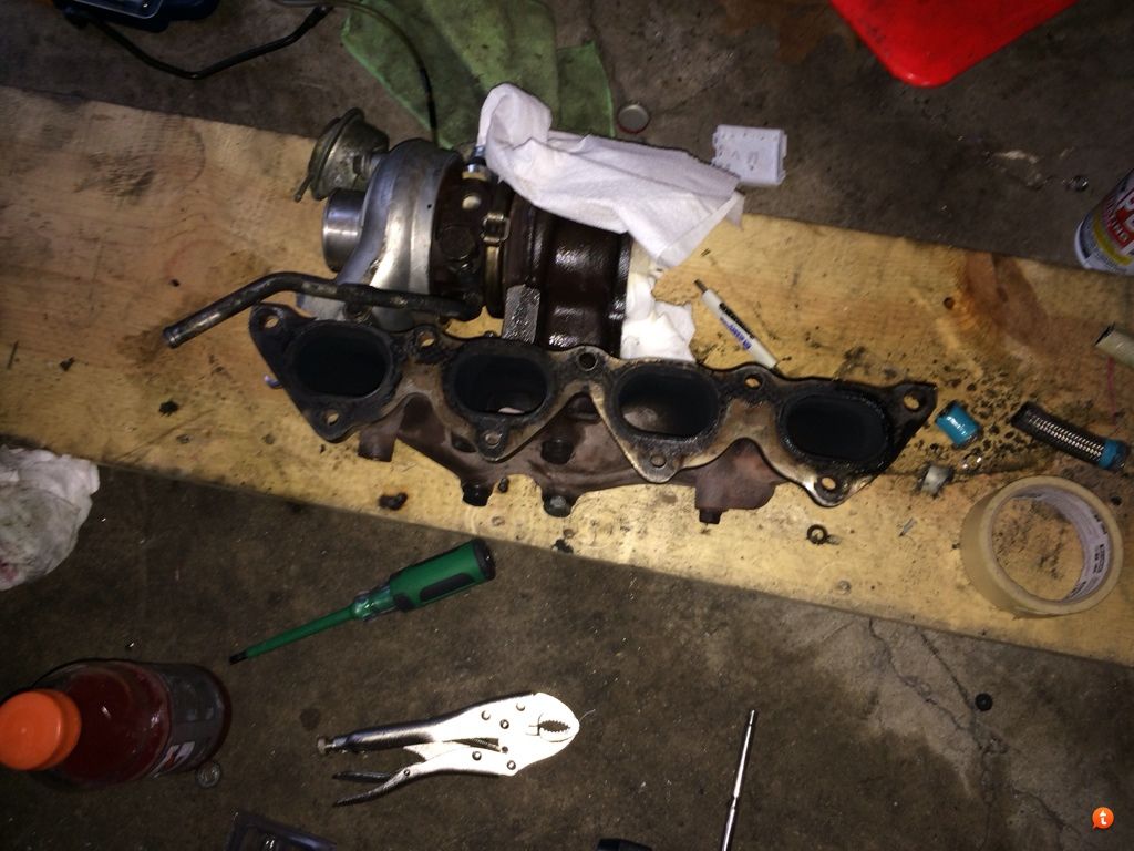

New turbo has been a straight up pain in the ass, 2 bolts were broken off in the exhaust side so I had to drill them out, and one of the threads on the downpipe side crumbled when I went to thread a bolt in, so I helicoiled it. Then the head feed pulled the threads out when I put it in. So I helicoiled that. Also found previous owner snapped off an exhaust stud, drilled it out and attempted to helicoil it but it had been done before so I tried drilling it out and somehow the helicoil went in..... No so sure how we'll it will hold but we will see.

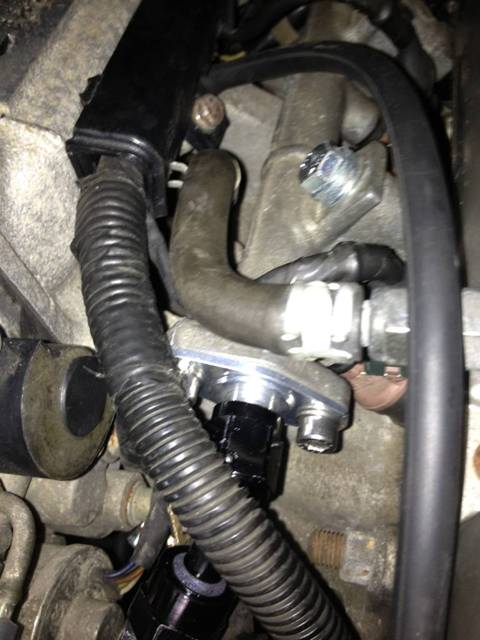

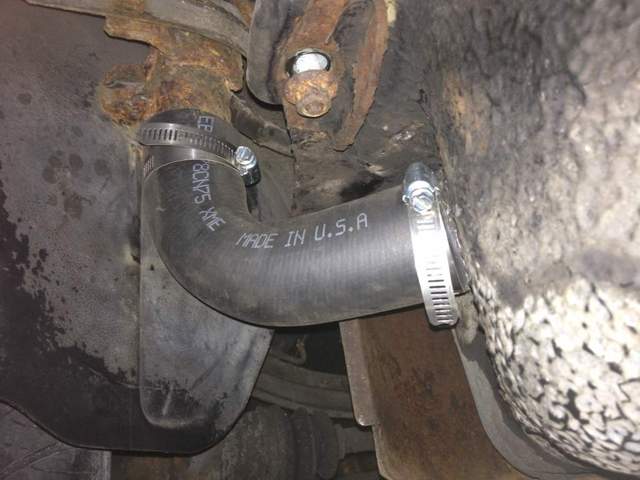

I am building my 90 also. Was just wondering what the waterpump pipe got crushed for or was it that way when you got it. I didn't seem to have any problems in that area. Is it cooling just fine? What are your goals for your car? Seeing if they are anywhere similar to mine.
Previous owner smashed it when he was trying to fit this o2 housing in, the sensor would have hit it. I ordered a new one but now I need to get a new o2 housing too. No cooling issues so far but it hasn't been driven much. And goals are around 350-375awhp , quick spool and a nice wide power band.
